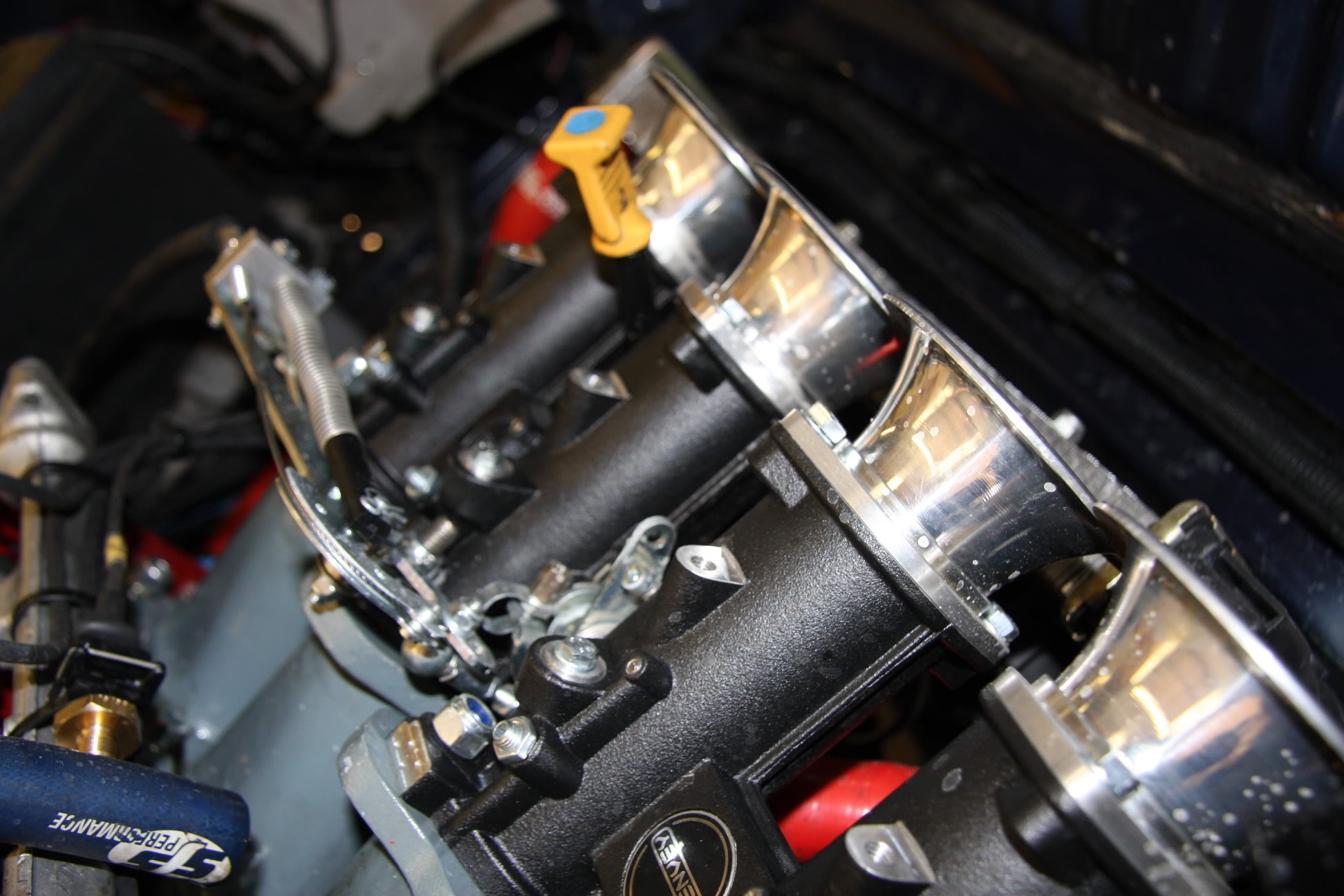

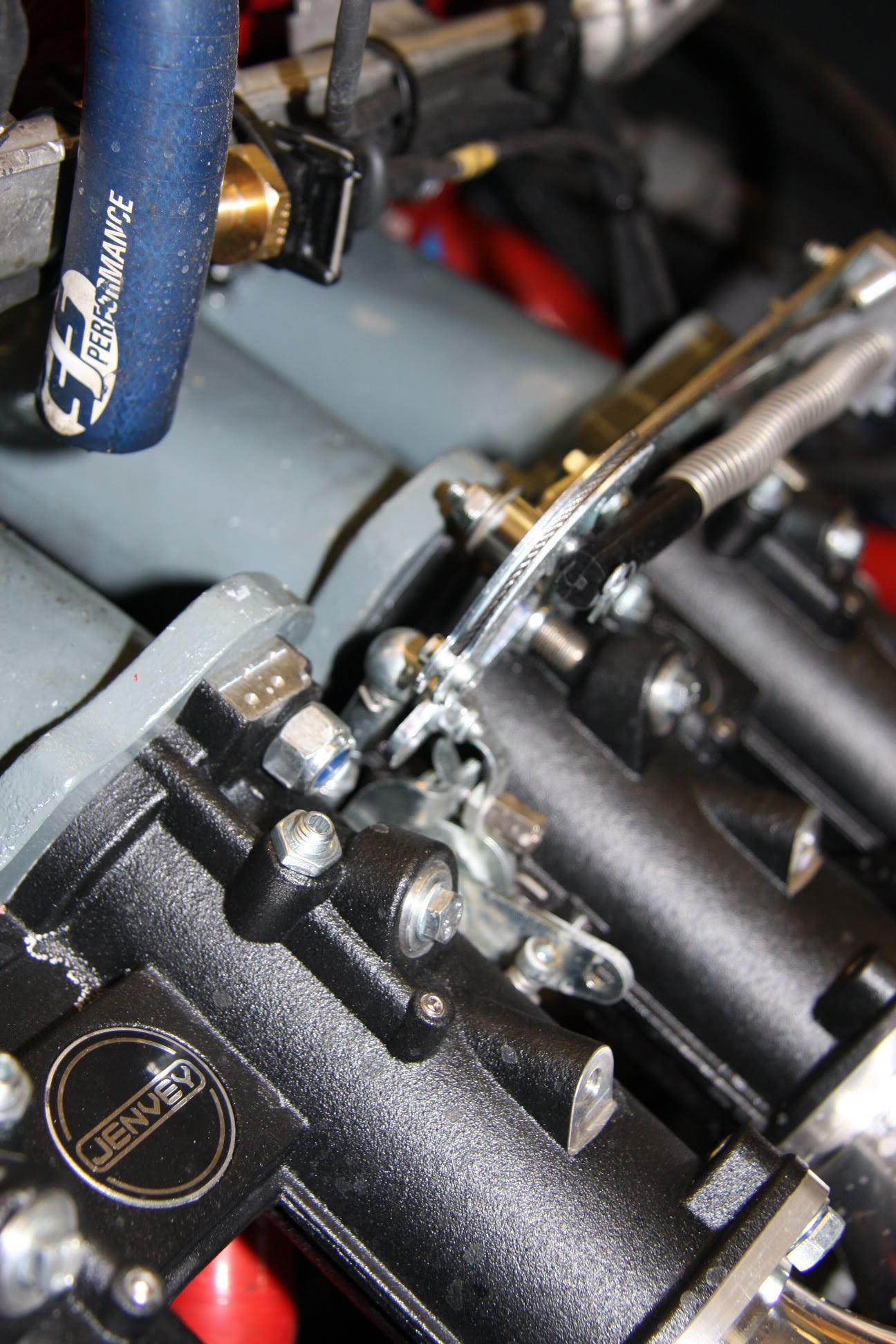

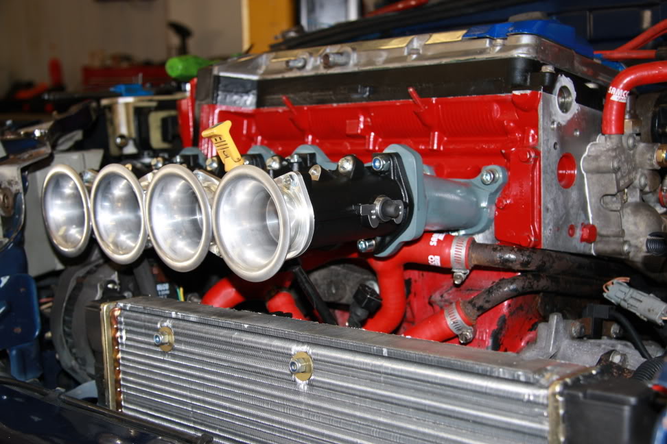

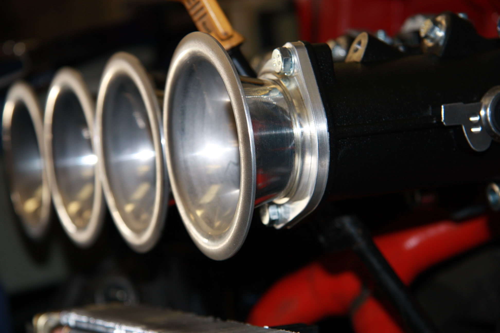

Williams Engined Valver with Jenvey ITB kit and Omex ECU and Race loom
Made 45 bhp more than std with Kent cams (not sure which profile as they were already in)
pulls very nicely above 5k revs, redline at 7000 rpm as the bottom end is quite worn (due a rebuild next yr)
Would have made more power as it was making peak power at redline....

wots with the bolts thru the rad tho??

uses std injector position
probably make more torque with some better atomising injectors
bolts are holding the race fan in place.

^^Mines got those plastic ones. How come the manifoldis really long, and the trumpets short? Where have you got the air temp sensor fitted on these?

:eek: Behind the breather hose. I see now, lol.

Until the airbox is fitted..... then it obviously goes inside it..
also the breather pipe is just there until the gentleman concerned fits his catch tank.

That rad looks a bit pikey being 'secured' like that. Would vibration not damage the cores?
  GDI Demo 182, Rsi Spider
well you cant see how its secured in the pics, so i am not sure what you mean..
if its the bolts you refer to, they are holding the Pacet fan in place.

Couldnt you have done something else? Looks a bit pikey bolted through crushing all the fins imo.

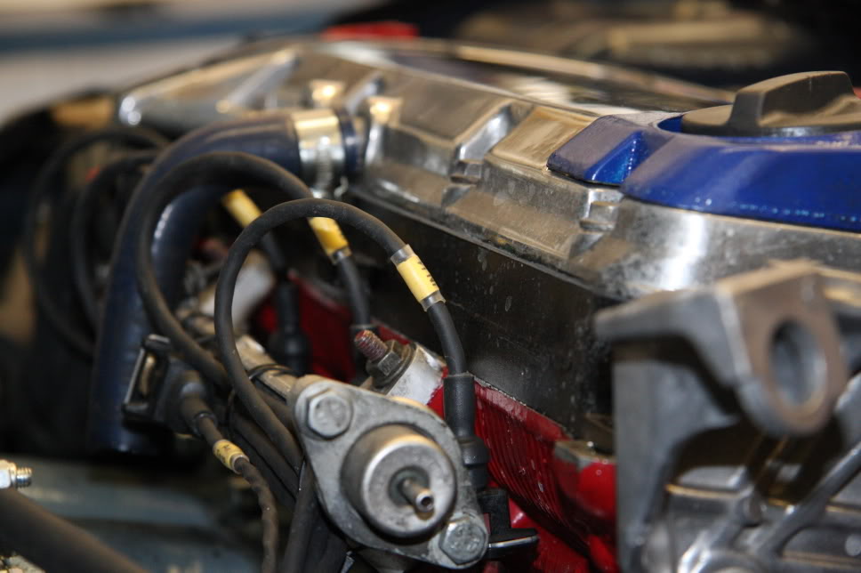

Sorry to rake this back up aswell, but isnt that a Renault 19 cylinder head? the little bolt head (thats been used to blank off the CTS hole) suggests so.
Not a full williams engine? fail ;)
  ITB'd MK1
It's in a valver anyway. And it's definitely a 2 litre head. Might be a 19 stat housing. Prima built it up years ago originally, I just rebuilt the head
