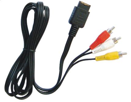

Just trying to figure out which cable I'd need for the PS3 if it would work at all,
Look right??
Or am I best finding one from the optical port as there are 2 unused ports on the PS3 as currently purely using HDMI

Do you not get something like that in the Box with the PS3??
The guy I bought it off believed there is a cable that comes with it that can be used, If not I'll order one of those
The cable you posted is fine. That is how mine is set up from PS3 to Video in. Will only get stereo though. You have to split the output on the PS3, HDMI to the TV and audio to the surround.

Fitted the PS3 cable last night and adjusted the sound settings and that works fine just need to sort out the Sounds for Normal TV watching now......Quick trip to Maplins and I should be good to go I hope.
