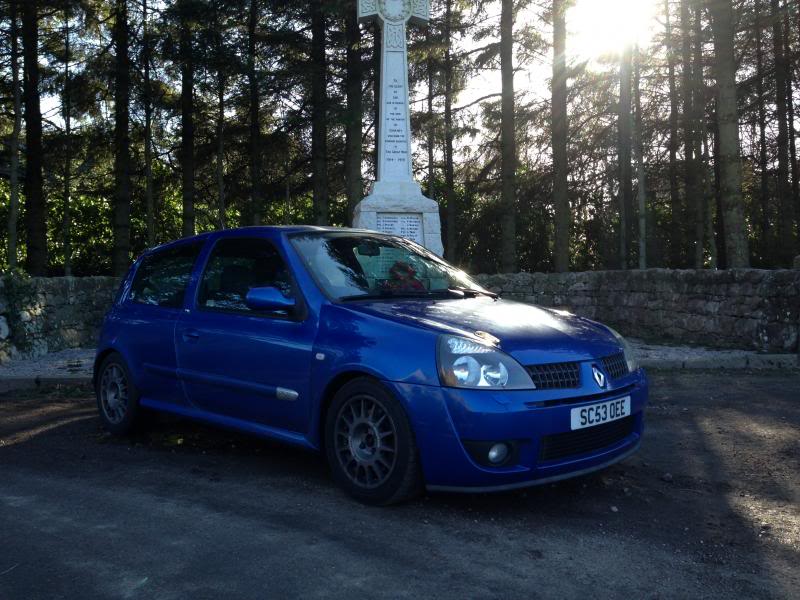

Standard crossing the border pic

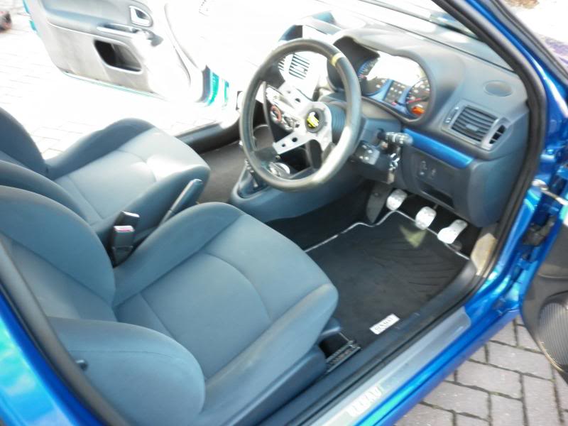

New pioneer head unit with iPod connection
Uprated front speakers
New black headliner
OMP deep dish wheel

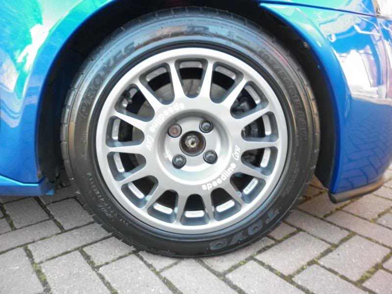

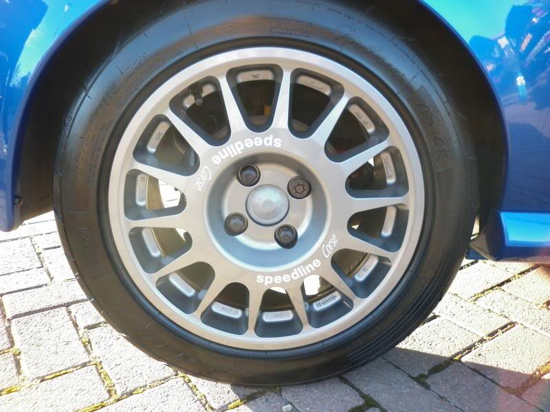

wheels and tyres;

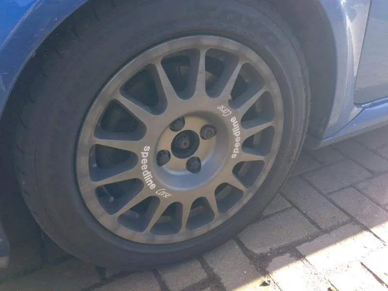

15" speedline 2118s in mint condition
Toyo r1r's on the front
Nankang NS-R 2's on the rear

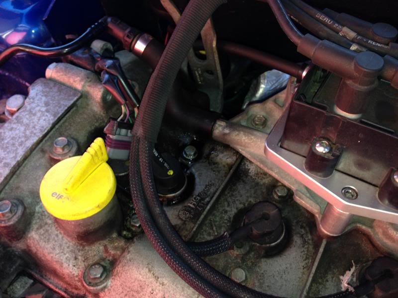

The dephaser solenoid seal needs replacing too.

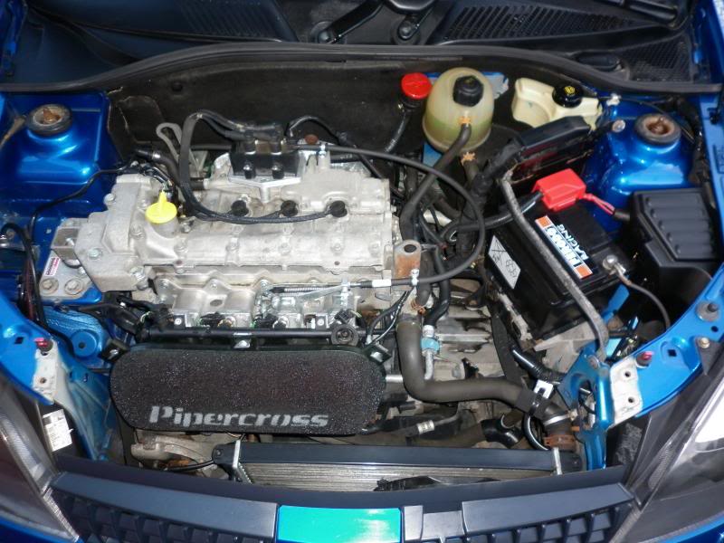

Fit a breather tank as I'm not keen on having a filter on the end of the breather pipe, it gets messy and the Pipercross filters with age have been known not to provide enough escape for the system.

Get the front seats out, fab up some extra low subframes and mount my Corbeau Revenge's and Sabelt Cup racer harnesses.

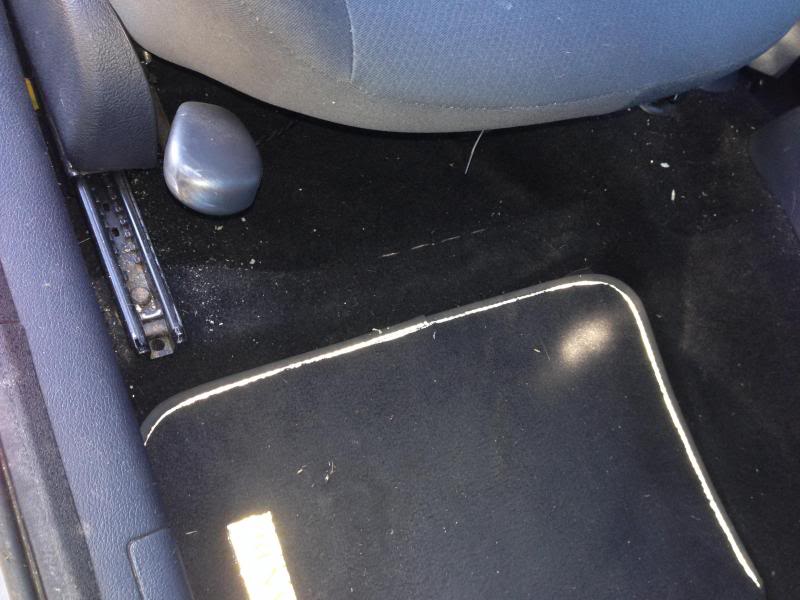

Wet vac the rear bench and carpets

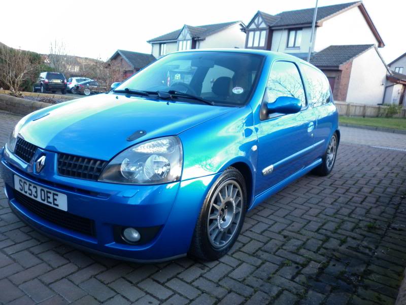

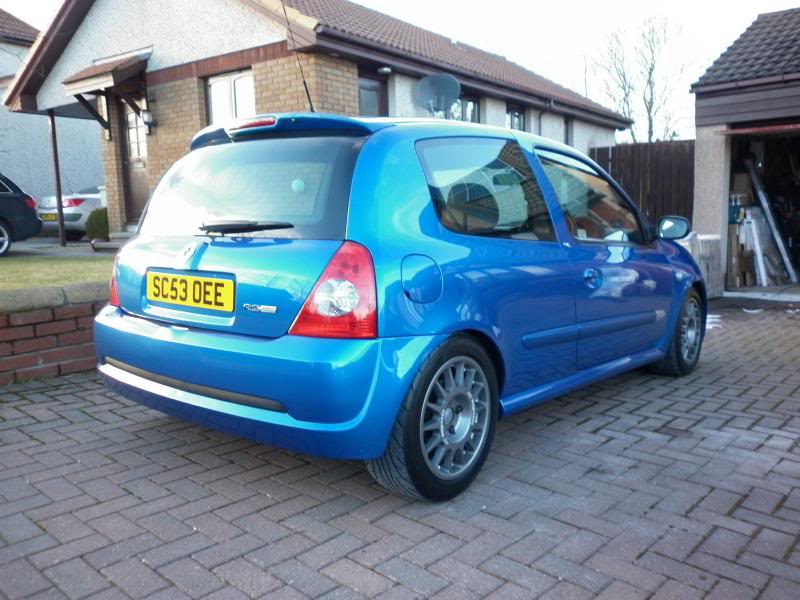

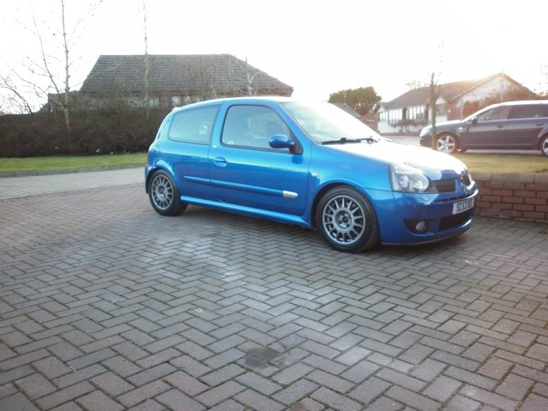

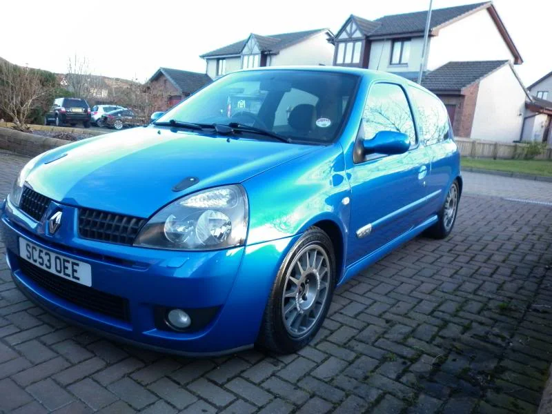

I have a track day booked on the 1st of March so 90% of that list will be done before then. Today we had lovely weather up here so I set about valeting the car and just a general tidy up.

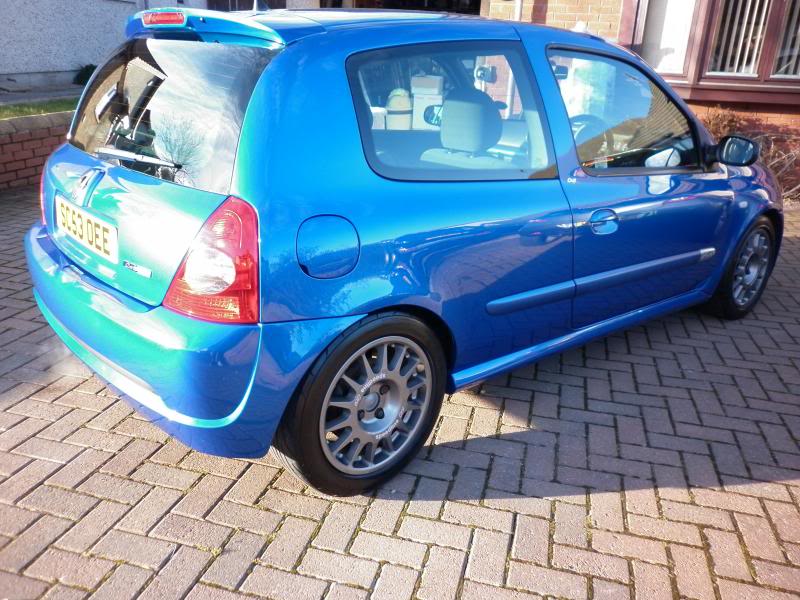

The car as it stood after its journey to its new home.

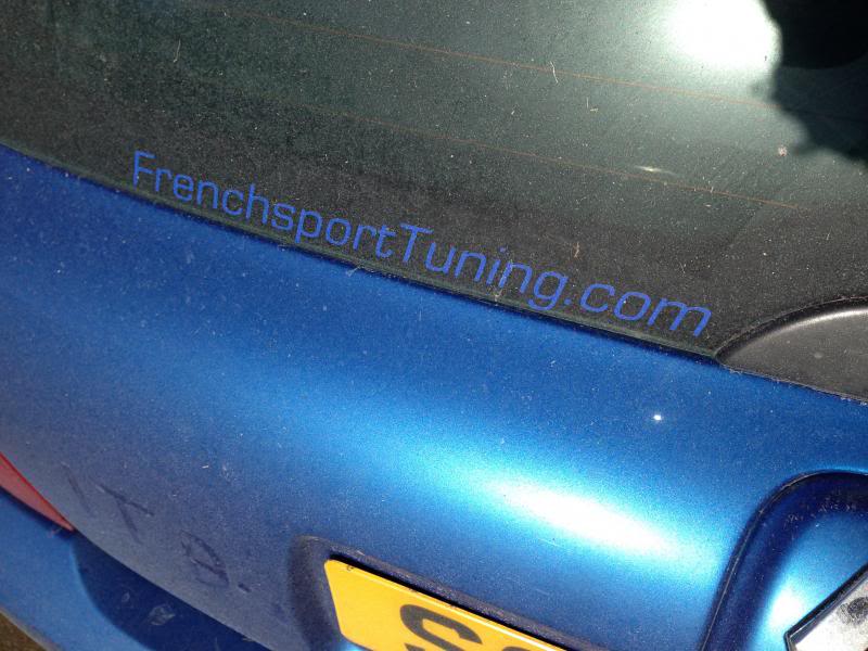

Boot sticker removed, not to my taste.

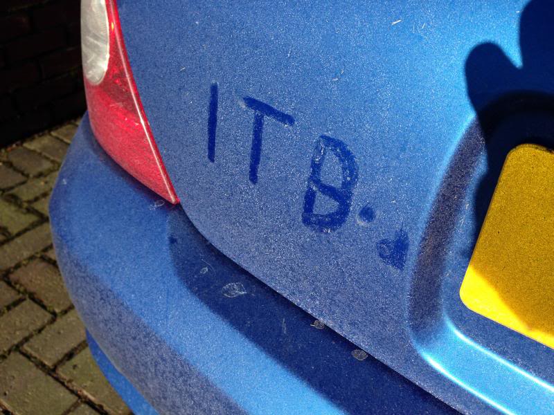

A mate thought he would be funny

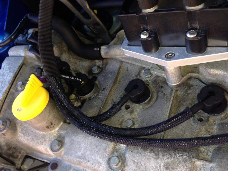

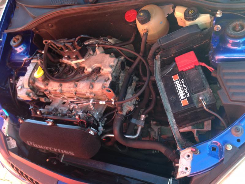

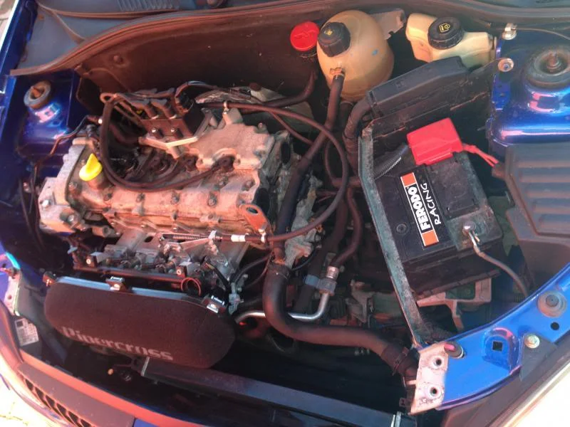

Engine
After a wash, hoover and the engine jet washed (CS meltdown material)

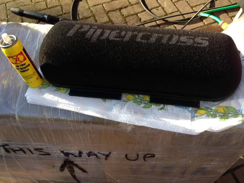

Sausage filter cleaned and re oiled

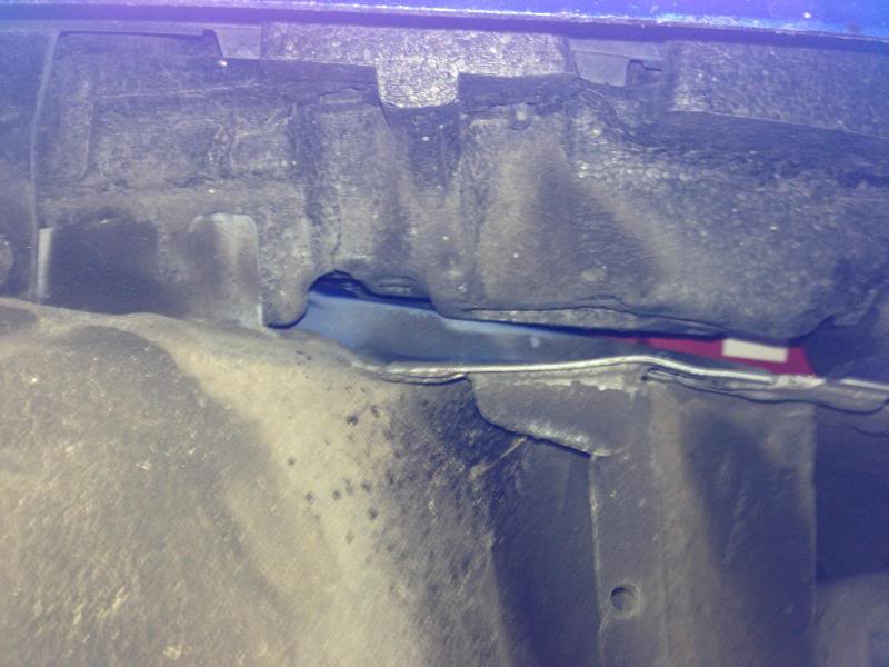

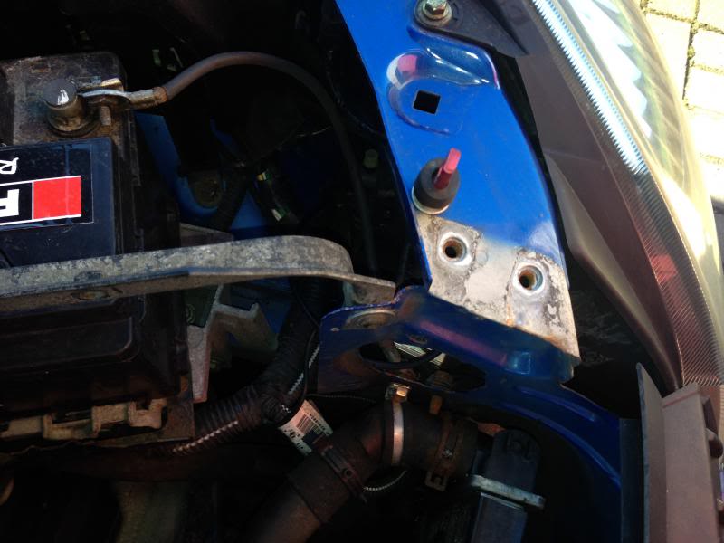

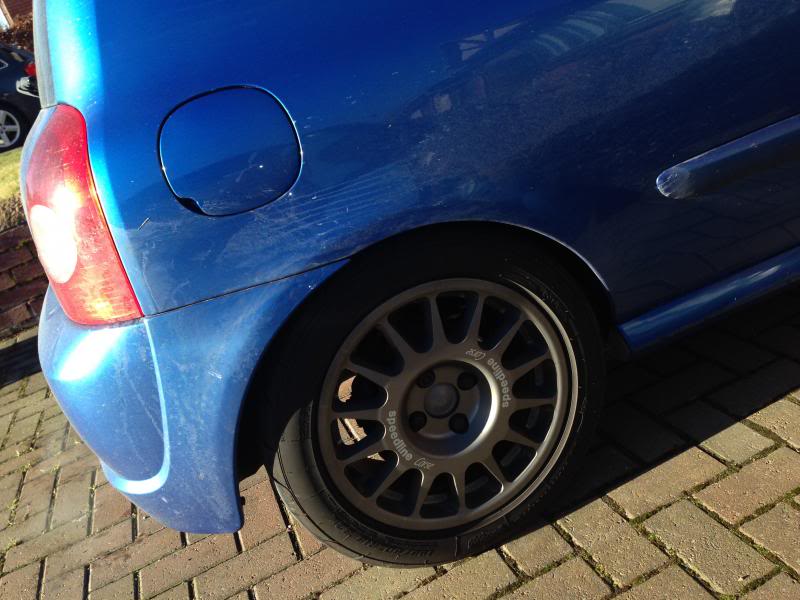

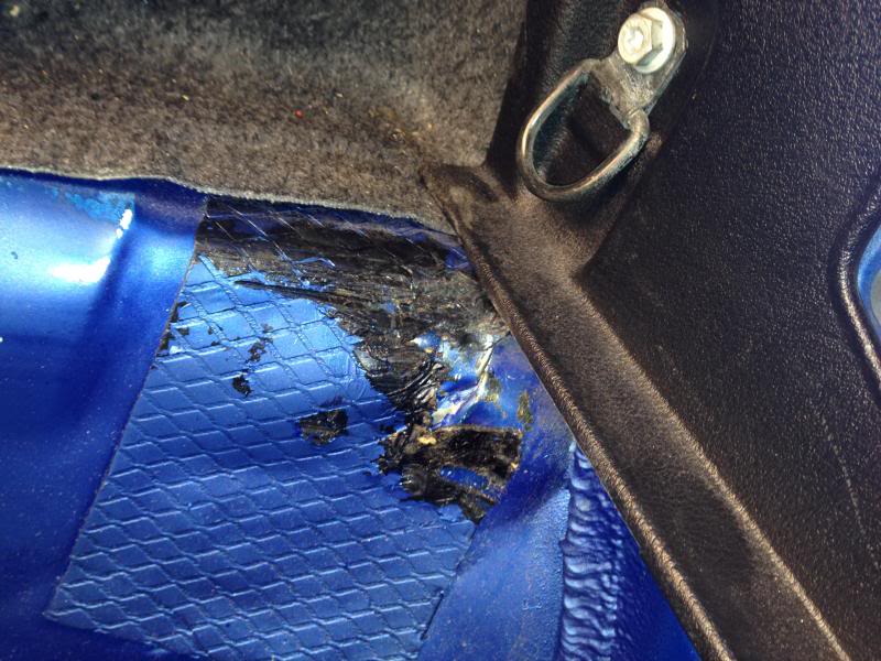

The damage that made it a cat d, very small kink in the boot which is minor, I'll strip it all down and paint the bare metal to seal it off.
No other damage to be seen.

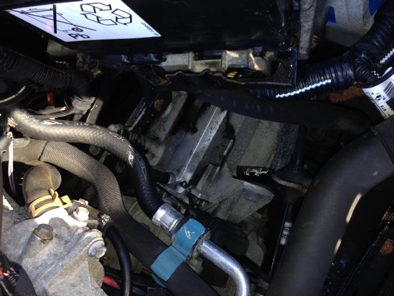

All the standard parts came with the car too including the mapped standard ecu for when it just had the cams so it will change back to standard in a day, I think this will happen after the summer (sorry Jim :eek:) but it wont be broken into pieces and scrapped, it will live on just in a lower spec.

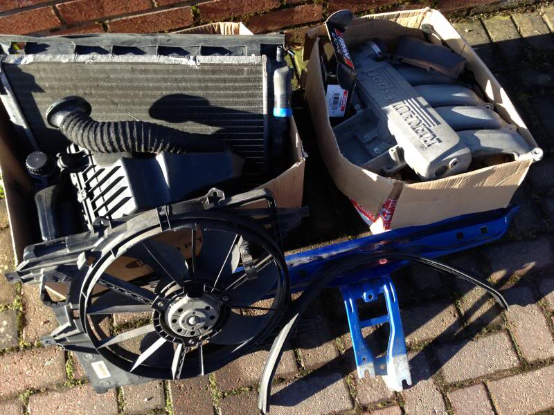

  Cup In bits

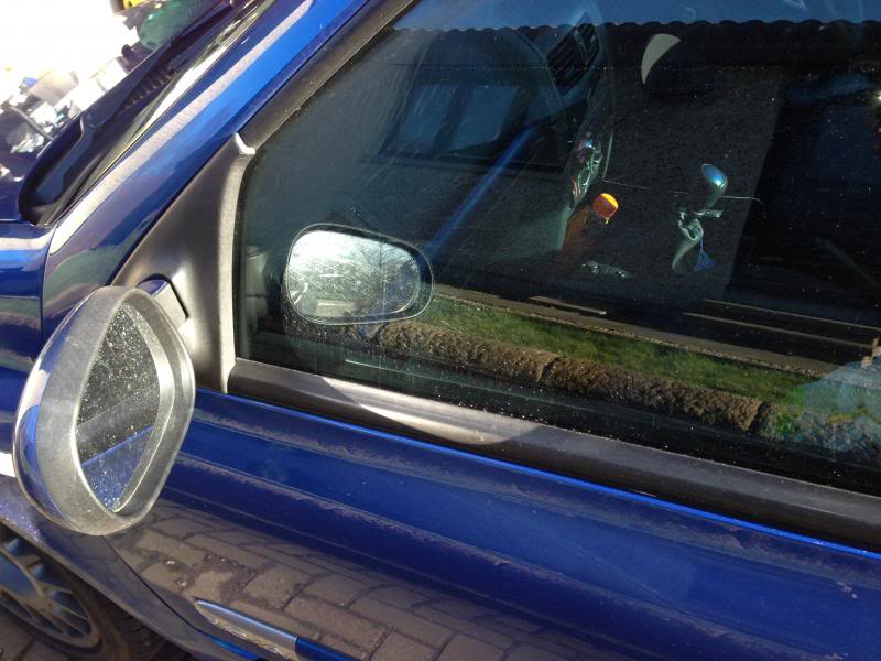

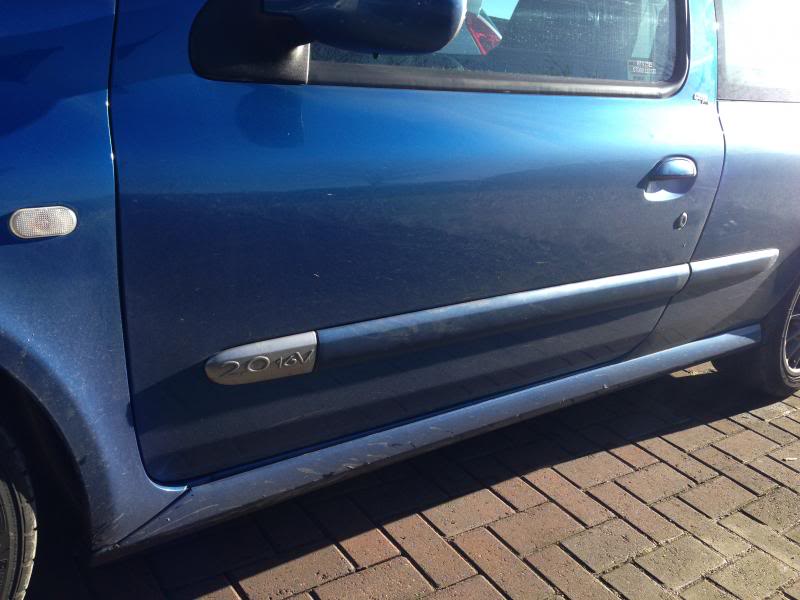

Has anyone treated the side strips on a cup, it seems someone has tried to t-cut or use some aggressive polish on them when they are either a matt paint finish or just plastic. I'm looking for something to bring them back up before I try a machine buff and wreck them.
