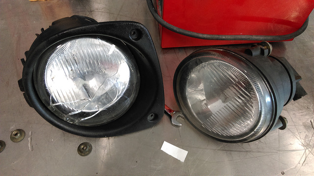

Thanks for all the offers on the foglights guys but @dmallett sorted me out :smile:
Cracked old fog and replacement
New foglights

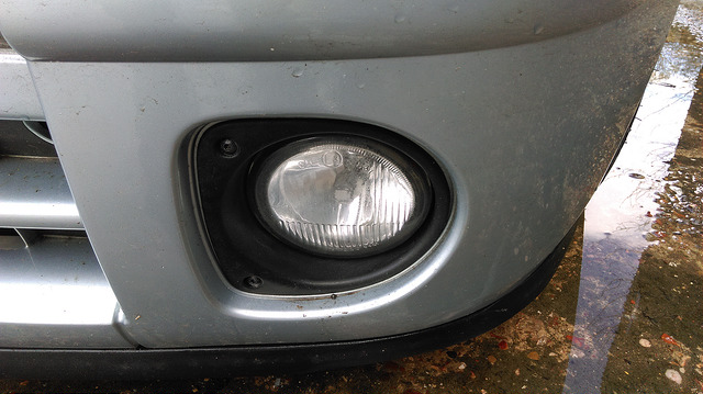

Fitted

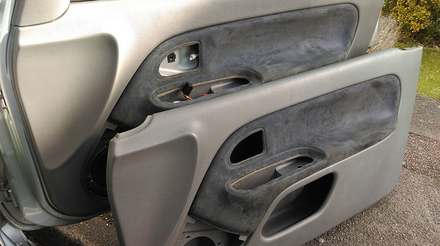

Got some better 2nd hand door cards as my drivers was tired looking. I didn't change the passenger side as that was ok but swapped over the drivers side. Gave the door pulls a clean too.
Clean door cards, wires and pulls

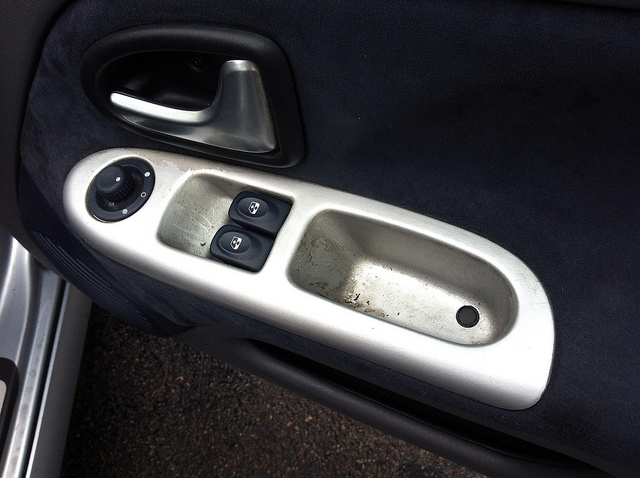

So glad I painted these. They look great compared to when I first got them and they look as good now as when I first painted them over a year ago.
Grubby right grab handle
