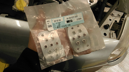

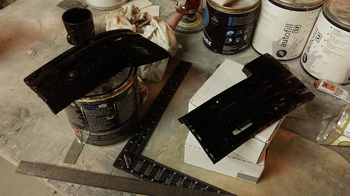

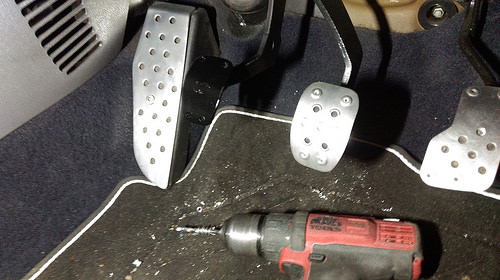

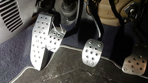

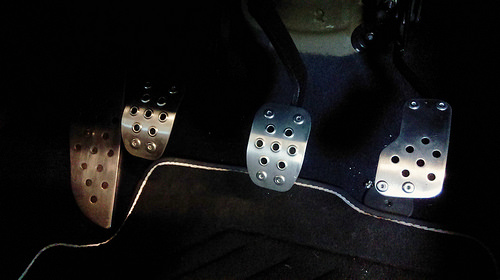

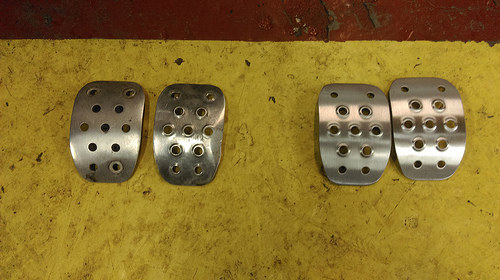

Fitted my new pedal plates that ive had for a while now. The pedals themselves looked a tad tired with a few bits of chipped paint so I drilled the old plated off and gave them a lick of etch primer and satin black before I riveted the new plates on.

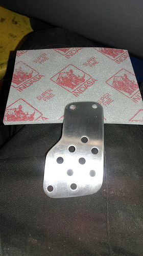

I also cleaned up my existing throttle pedal as a new one from Renault was silly money and this one was in fairly good condition.

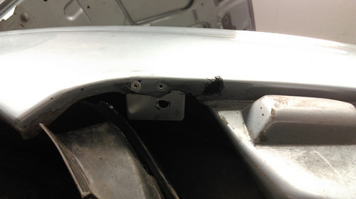

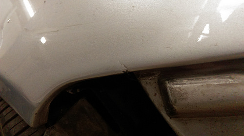

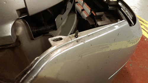

Next job was to try and fix the bodged bumper. It was fitted by a screw going into the wing which had strated to work its way to the edge of the wing. This was like this before I bought it. Upon removal I somehow managed to crack a bit of the wing paint. I was a bit pissed off but it would of happened sooner or later. I superglued the crack back up and from a distance its hardly noticeable but up close you can see it.
The wing doesn't actually have a bracket for the 10mm bolt to hold the wing and bumper together and I wanted to make away with the screw so I made a bracket out of 2mm ali and riveted to the wing. Not perfect but not seen once the car is on the ground and held in by a 10mm bolt which is better than a rusty old screw!

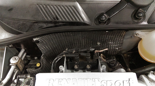

Ive also finalised the shape of the Nimbus heatshield and used the existing bolt holes in the scuttle to secure it. No pics but ill get some as I want to spray the rocker cover again.

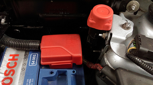

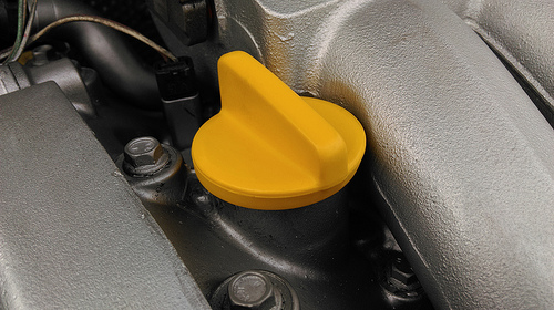

I did buy a new genuine battery terminal and cover and oil cap, although only got a pic of the cover.

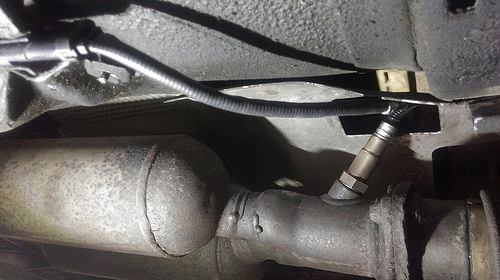

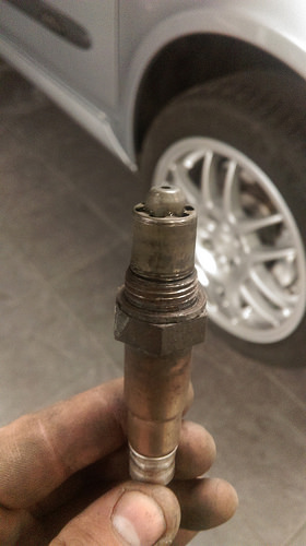

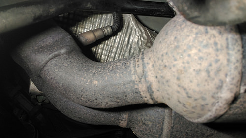

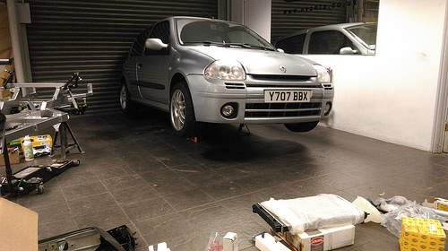

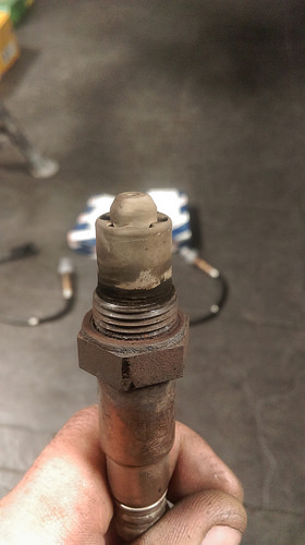

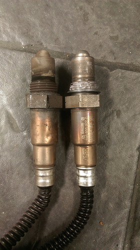

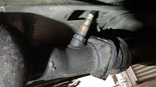

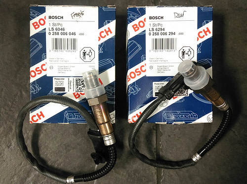

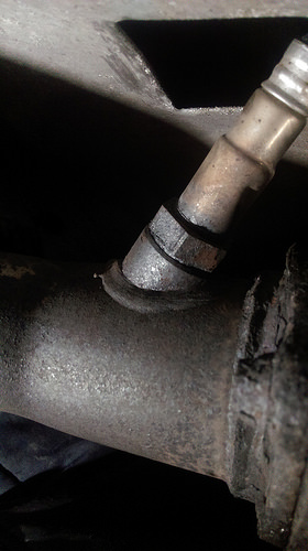

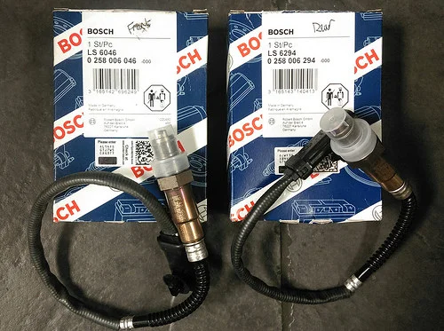

I knew my lambda sensors were out and tbh I think they always have been in my owner ship but it always seemed to run ok, however since ive had the engine work done, it became apparent that they needed changing. On idle it would be fine, then it would run extremely lumpy. It was like it was going to stall. After about 2mins of this the revs would jump back up and would be fine. After a quick PM to @G 172 I had ordered 2 genuine Bosch lambda sensors. Ordered on Friday late afternoon and arrive Monday morning. As always great comms from George and great delivery times :smile:
Pics of swappage.

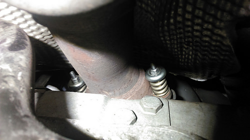

While I was under the car I took a pic of my new genuine cat fitting kit, just because.
Idles fine now but the EML light has stayed on and MPG is still low so going to get Alex to plug he's computer in a nd see whats the cause. Runs fine though :confused:

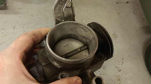

I also had a sticky throttle so I kindly got one off @dmallett

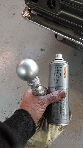

Ive also decided to spray my other ph1 gearknob as I felt that my current colour has too much pearl in it and it doesn't go with the interior so ive done this one Iceberg silver.

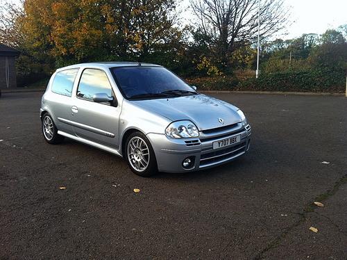

Pic of when I first got it:

Genuine Bosch lambda sensors (pre and post cat)

Not too sure what happened on the last pic but here is a pic of when I first got it:

I was still getting poor MPG after fitting both lambda's and the light was still on. Alex came round and plugged in he's laptop/clip and turned off the light for me. It was also saying that the pre cat lambda wasn't connected. We looked and it was but it was slightly loose. I remember when fitting it that there was no clip on the loom side for it to clip into. I went to work and got some thin cable ties and looped them around both end of the sensor to hold it in place. MPG is now back up to 34-36 :smile:

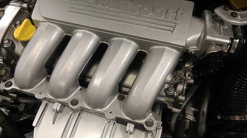

I decided that I didn't like the black cam cover so I took the inlet off and covered everything up and gave it a few coats of silver, along with the lower inlet.

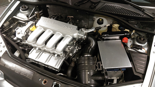

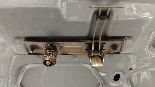

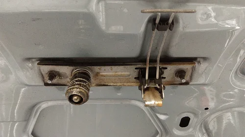

While the bonnet was up I gave it a clean and recleaned/repainted my bonnet catch. I had rushed it last time and it was looking manky so this time I gave it a good few coats of paint and lacquer and left to dry before refitting. I know the underneath of the bonnet is rarely seen but its come up great tbh, probably better than the upperside!
Fitted new genuine oil cap

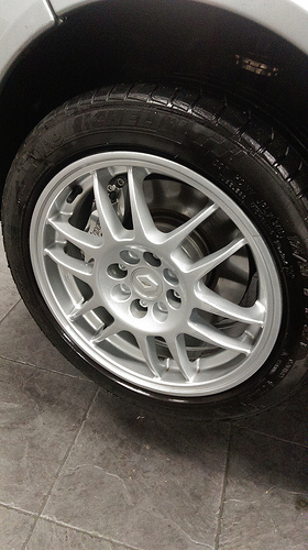

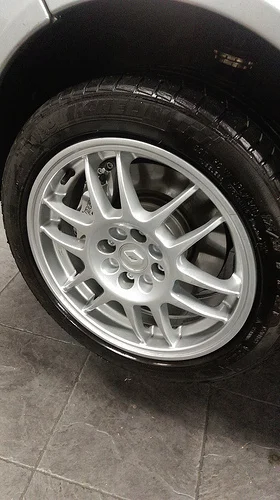

Once that was all done I decided to clean it. Started off with the wheels and exhaust but then ran out of time/light to do the car :blush:
Pics of the finished Nimbus heatshield and finished engine bay :cool:
