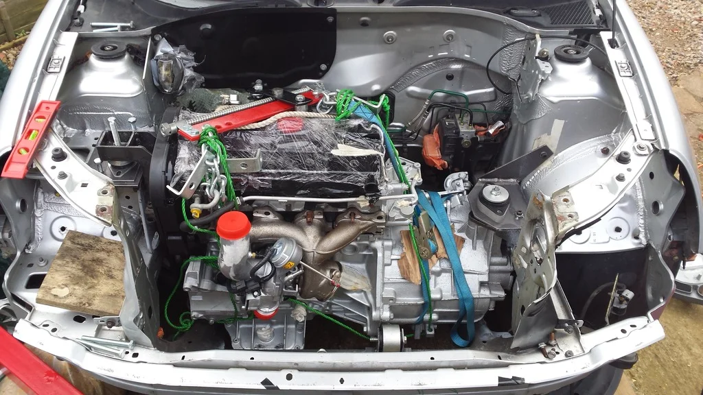

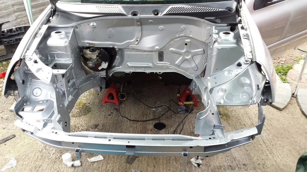

Finally got round to sorting out pictures from my project car, here to share them if anyone is interested.
A mate had a Z20LET converted Corsa C which I got involved with, and another had a 182, one thing led to another and here we are.
Rebuilt the Vauxhall Z20LET engine from an Astra GSI with Astra VXR turbo, running the F23 5 speed with Calibra Turbo 4x4 clutch and new machined S155 solid driveshafts.
Converted to hydraulic clutch to suit the F23 gearbox.
EPAS conversion due to clearance of the hydraulic pump and rack.

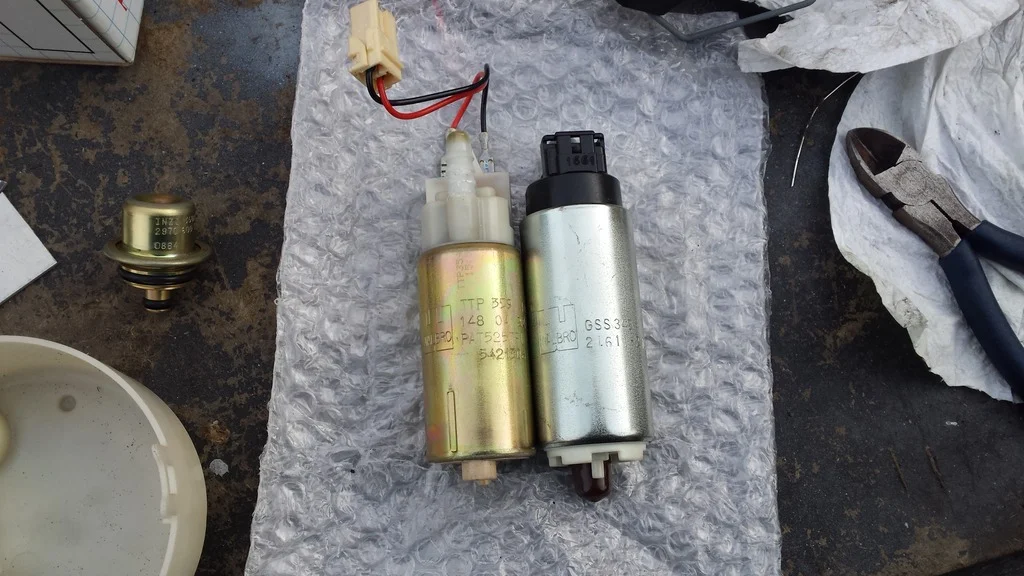

Runs a Walbro 255 in tank, with fuel rail pressure regulator and external filter.
Runs the Astra ECU and clocks, with the clio fuel sender all works great.

Shes not mapped yet as have only had it on the road for 3 weeks or so running it in, but approx 220,
Engine as built capable of a bit over 300 but project target is 280.
Goes and sounds fantastic though, very pleased.

Great workmanship, but i kind of have to question why when you can boost the F4R reliably now for not a huge amount of money.
  Clio 182
I was expecting some real 'back yard' mechanics, but that looks impeccably executed - top drawer.
I love the clocks too, they look better than the Renault ones!

Thanks bud, I am in engineering but not motorsport, like to keep my cars as a hobby at the mo! Commute in this is the one though!
