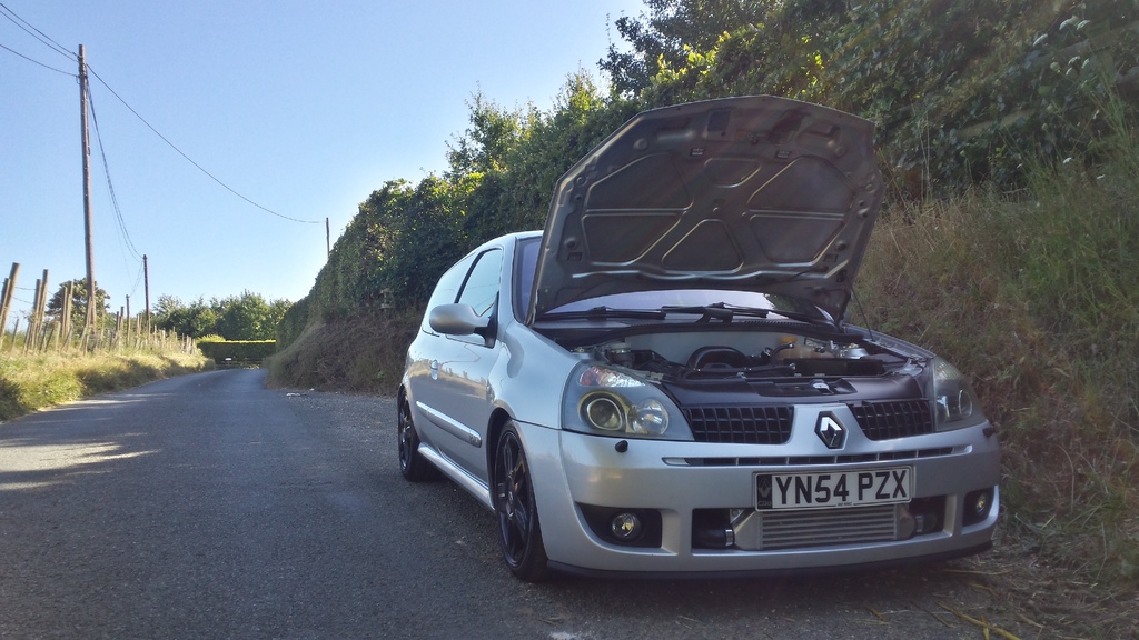

Great workmanship, but i kind of have to question why when you can boost the F4R reliably now for not a huge amount of money.
Hah yeah had expected this question at some point! To be honest there wasn't much more logic to it than looking at my mates Corsa LET and thinking I wanted that in a Clio Sport...
There were times when I did look at it and think I should of just turbo'ed it deffinately! This created a lot more work with the mounts, clutch system, driveshafts, wiring etc etc but in the end the only rationalization was 'yeah that'll be sweet,'

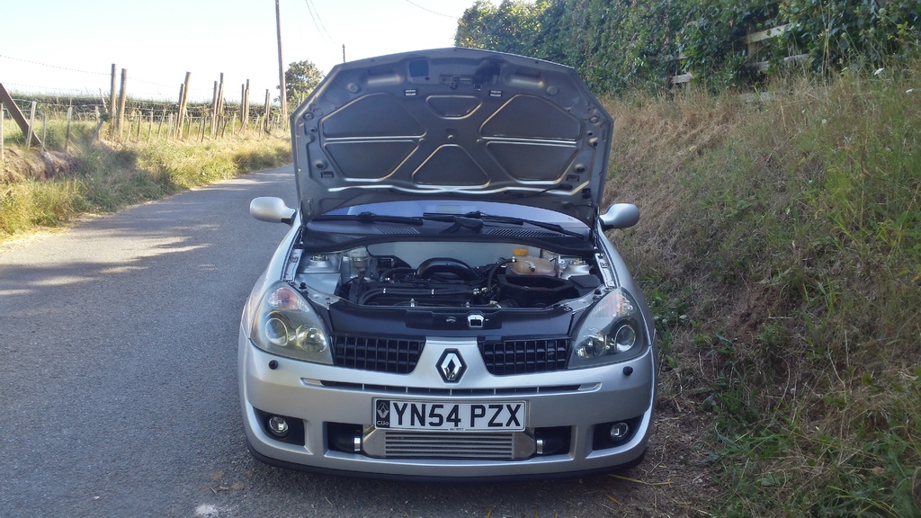

Looks brilliant mate, hat off to you. What fabrication is needed in something like this?
Thanks a lot man,
Nothing too crazy but lot of measuring required!
Needed all new driver side, gearbox and dogbone mounts, and a new front torque reaction mount on the subframe as it runs this in the Astra, quite similar to whats required for the 225 conversion. Took a while to find the right bushings for the torque mounts, came from some Peugeot / Citroen model in the end, running one front and back to keep the stiffness matched.
Boost pipework to make up, made a crude beading tool to bosh in the press which worked pretty good.
Exhaust to make up, turbo on the front makes the route trickier than before, has to go up and over the subframe at the back,
In pursuit of reliability moved the rad forward as far as possible and heat shielded the turbo and wrapped the downpipe to reduce the radiated heat soak, running the 182 radiator, works really well controls the heat spot on. LET has a oil / water cooler as standard.
Mounting the intercooler without compromising the front cross member.
Quite a bit of work to get the gear shifter cables to work in this application, surprisingly.
Driveshafts to mock up, Astra inner CVs with the 182 outers
Pedal box work for new Astra throttle pedal reworked to keep the pedals all looking OEM, hydraulic clutch conversion using a mix of megane pedal, clio arm and astra master cylinder, new rigid and braided lines as required.
Went to town making a new cup holder arrangement as the old one was out by 1/4" with the Astra gear selector fitted ffs!
Had to mod the sump a fair bit to get satis clearance to the subframe, hasnt really affected the volume just relocated the forward most flange internally and plated a small relief on the bottom.

thats one hell of a tidy conversion, it looks factory! to tell you the truth it looks better than most of the installs in corsas

I was expecting some real 'back yard' mechanics, but that looks impeccably executed - top drawer
Was this because you read it was a Vauxhall engine conversion, because I did? I thought "oh jesus, its gonna be classic back yard bodged engine swap".

I opened this thinking, why on earth would someone do that? In reality, it's a bit of a mad and pointless conversion, give you can use Renault bits. That being said, there is nothing wrong with being a bit mad and pointless sometimes, and you've done a great job with the install. The dials look factory and the engine looks really good in their. Really nice job, bet it raises a few eyebrows when you open the bonnet!
