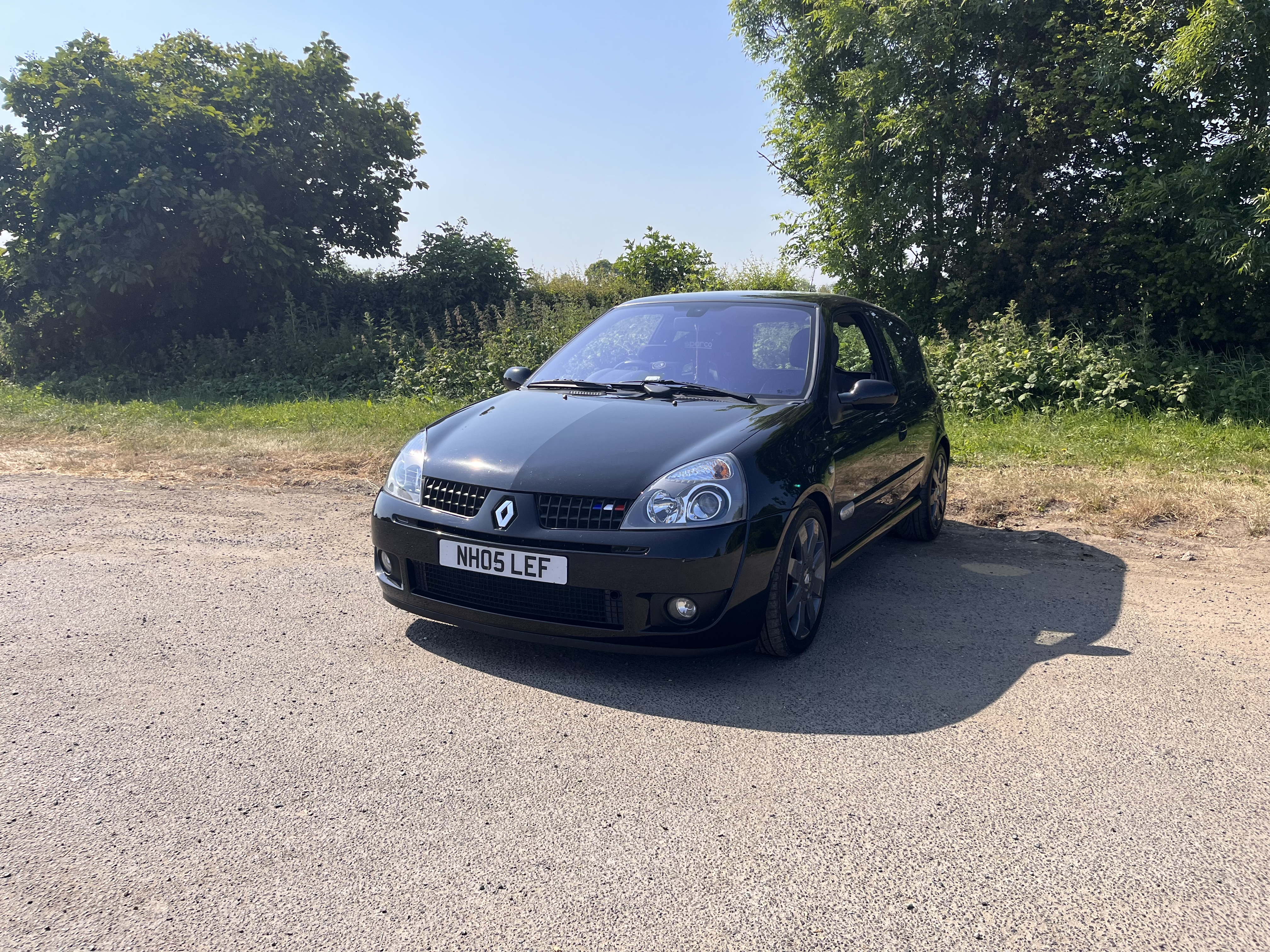

“Charlotte” The 182 FF
At last some pics and the start of my (probably slow) project thread.
Picked up with limited history but from a friend who’s spent £1400 on lots of new bits like brakes, calipers, clutch, exhaust etc etc only to get a mk3 and sell this one.
I got it at a fair price but it needs some love as you’ll see. My intention is to not modify it but maintain it as stock as possible with some minor mods that I think really benefit the overall car.
I’ve done this before and termed it Stock+.
To first part will be to get and fit the missing bits, like the 182 steering wheel and gear knob, then sort out some odds and sods that are broken as well and deep clean it, as it’s pretty grubby.
Having been over it with my paint depth gauge it’s all original it would seems which is good, there’s some age related marks on the Bodywork that I’ll fix and the interior is, in places disgusting, but more on that to follow.
Here’s some pics to start with,

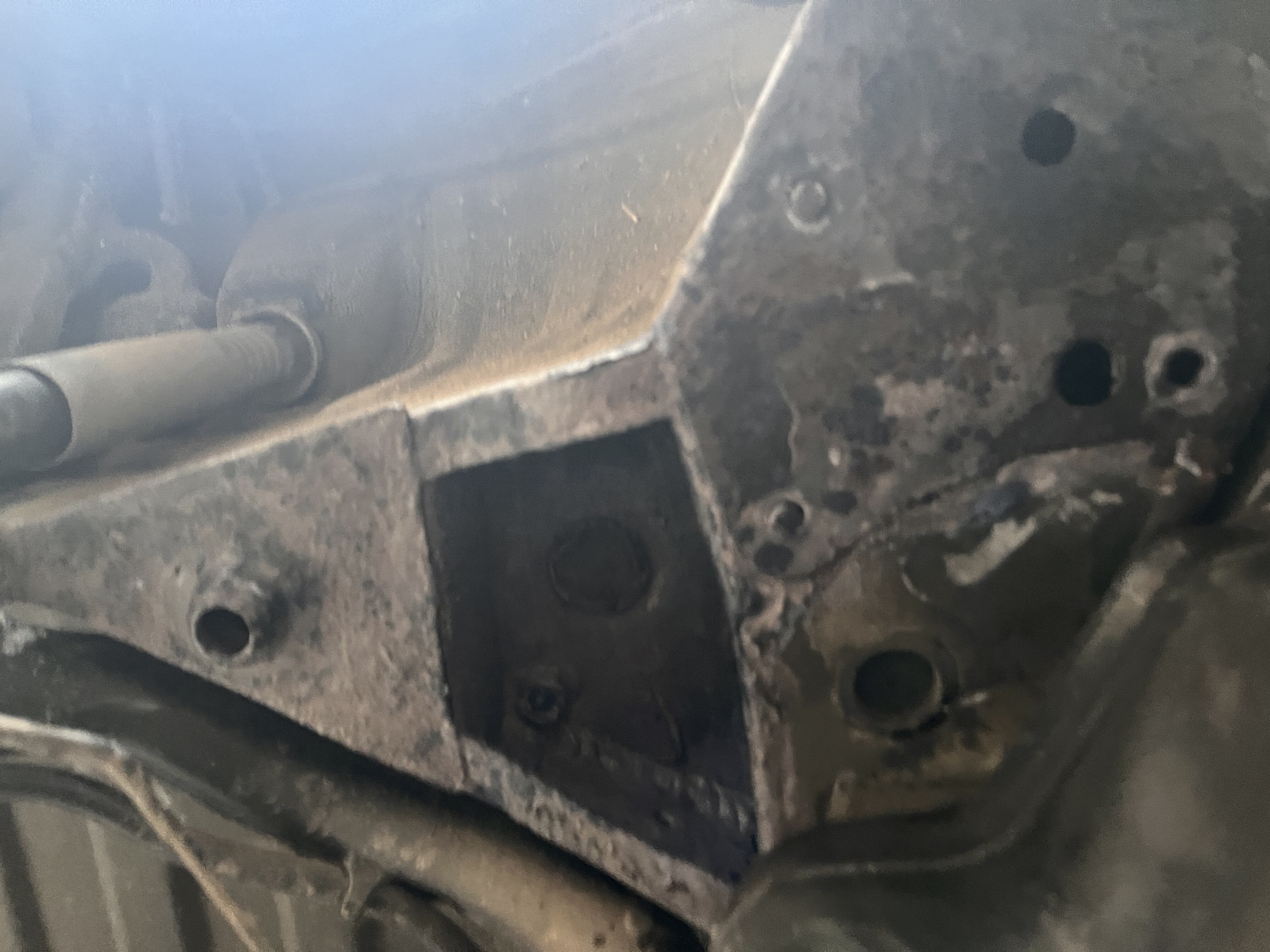

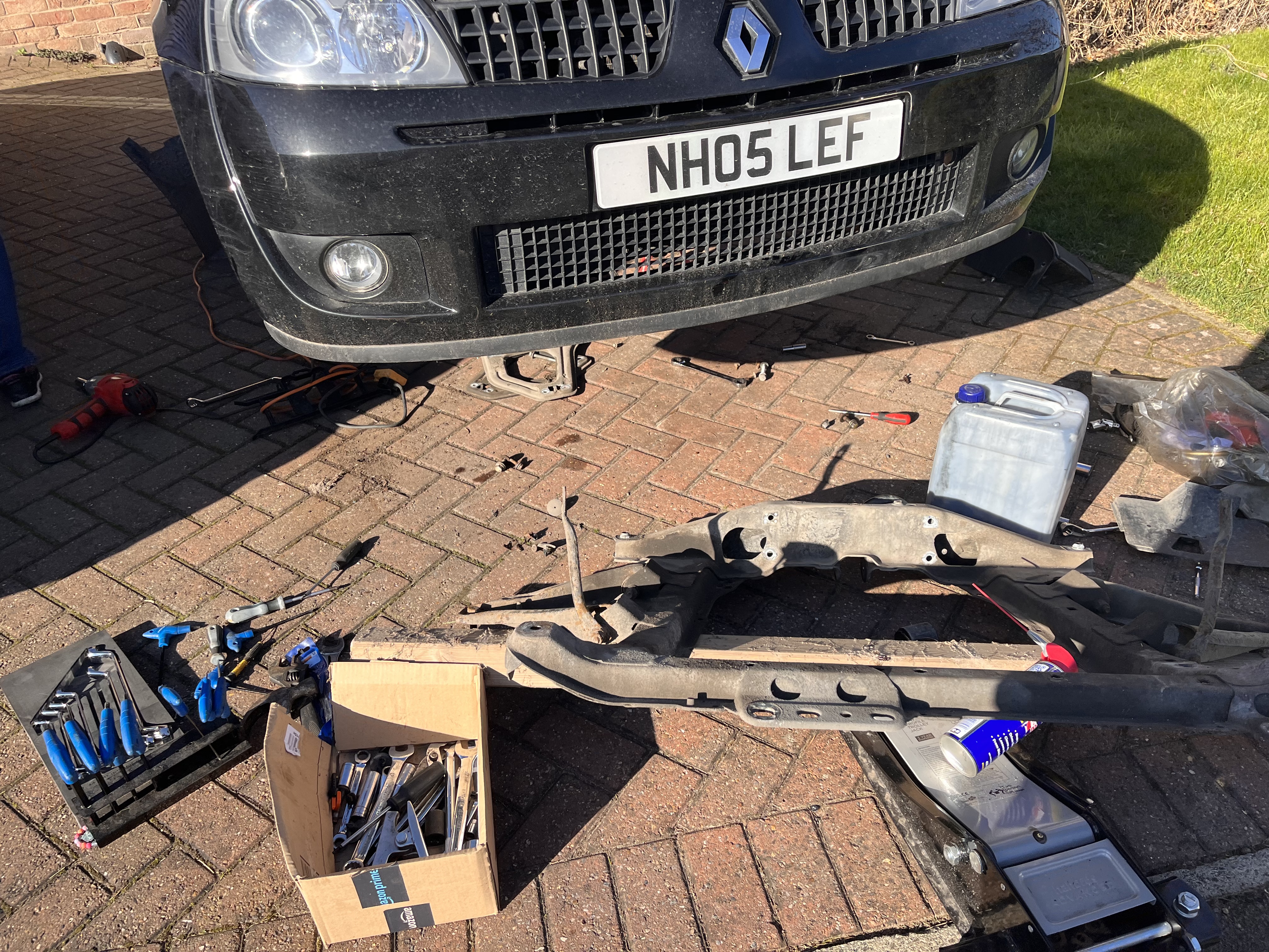

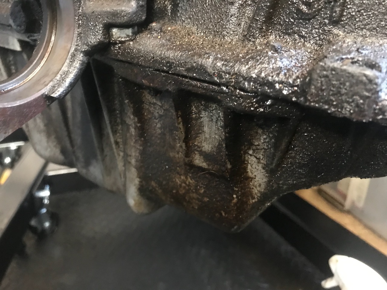

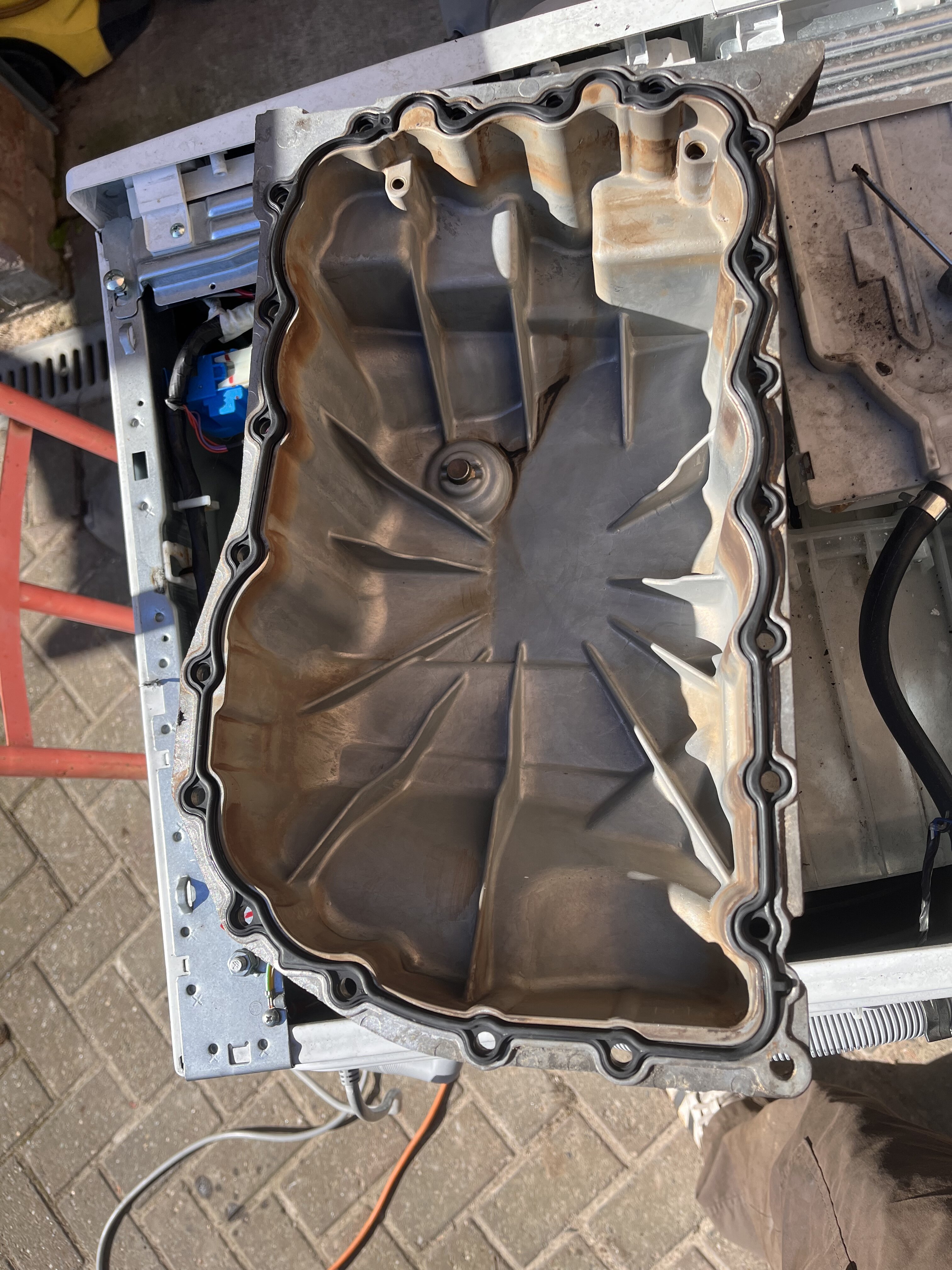

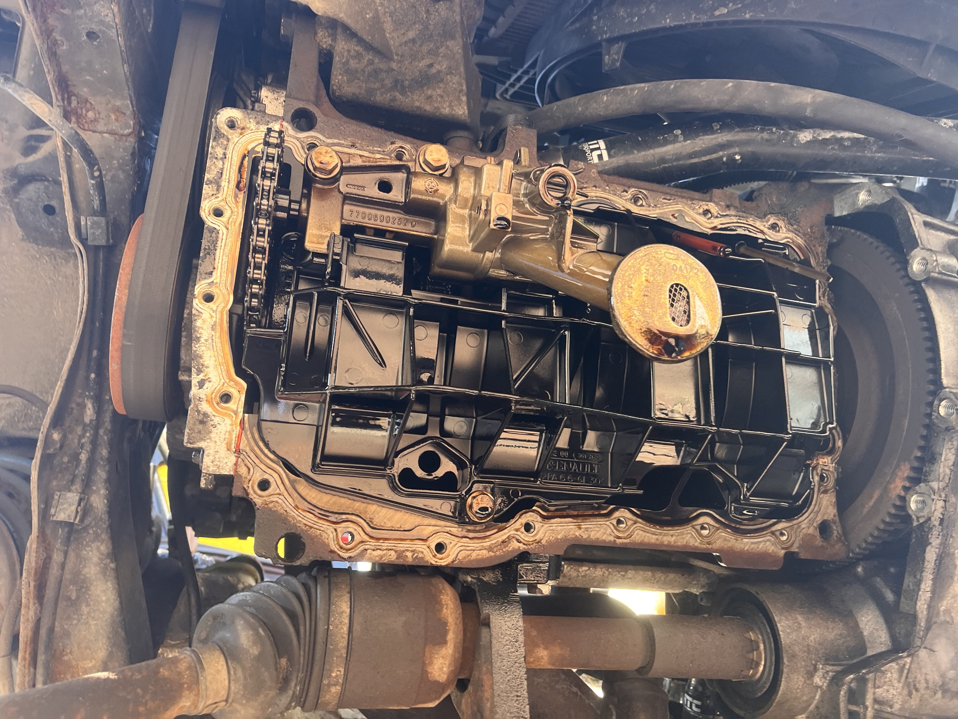

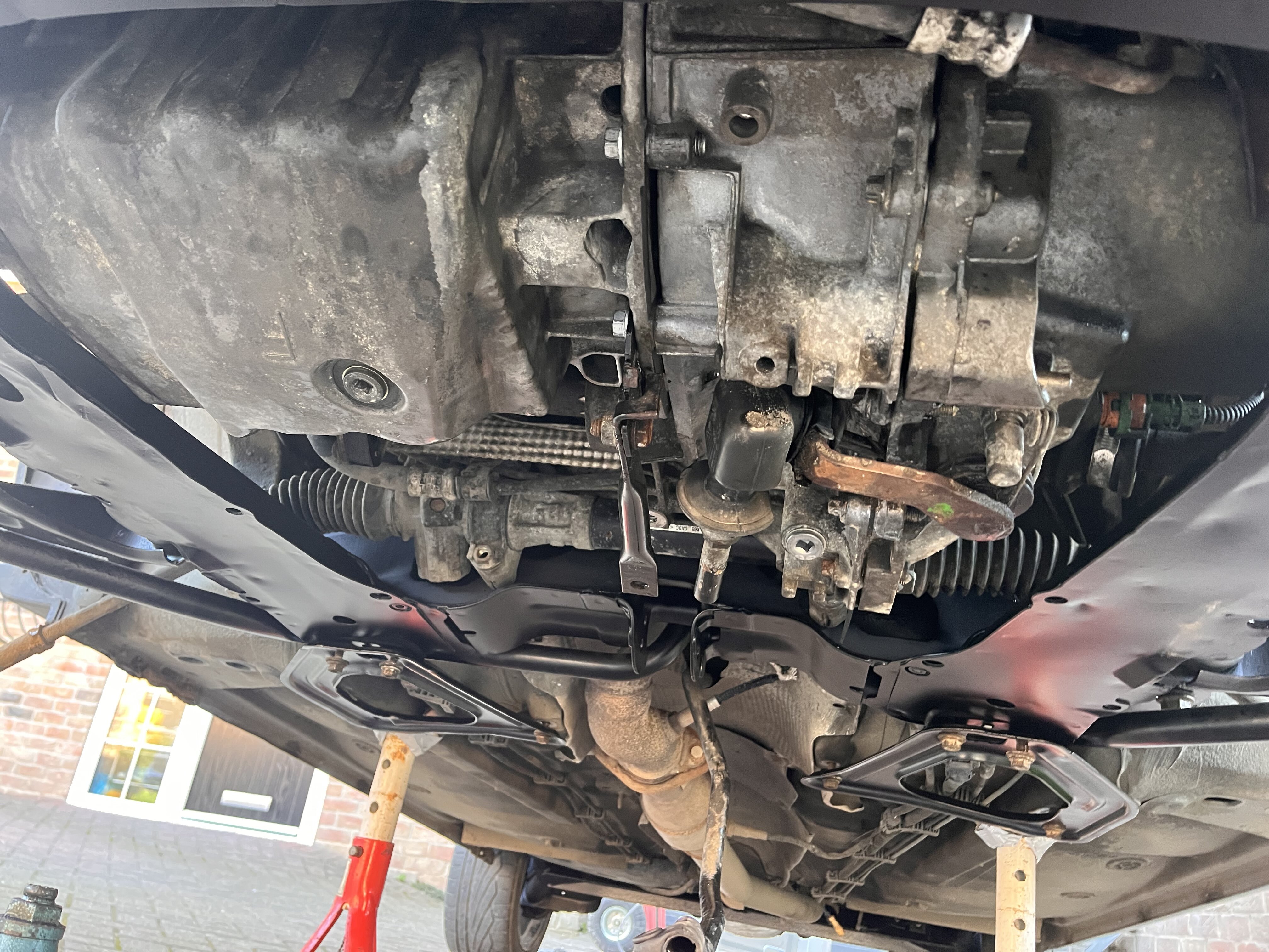

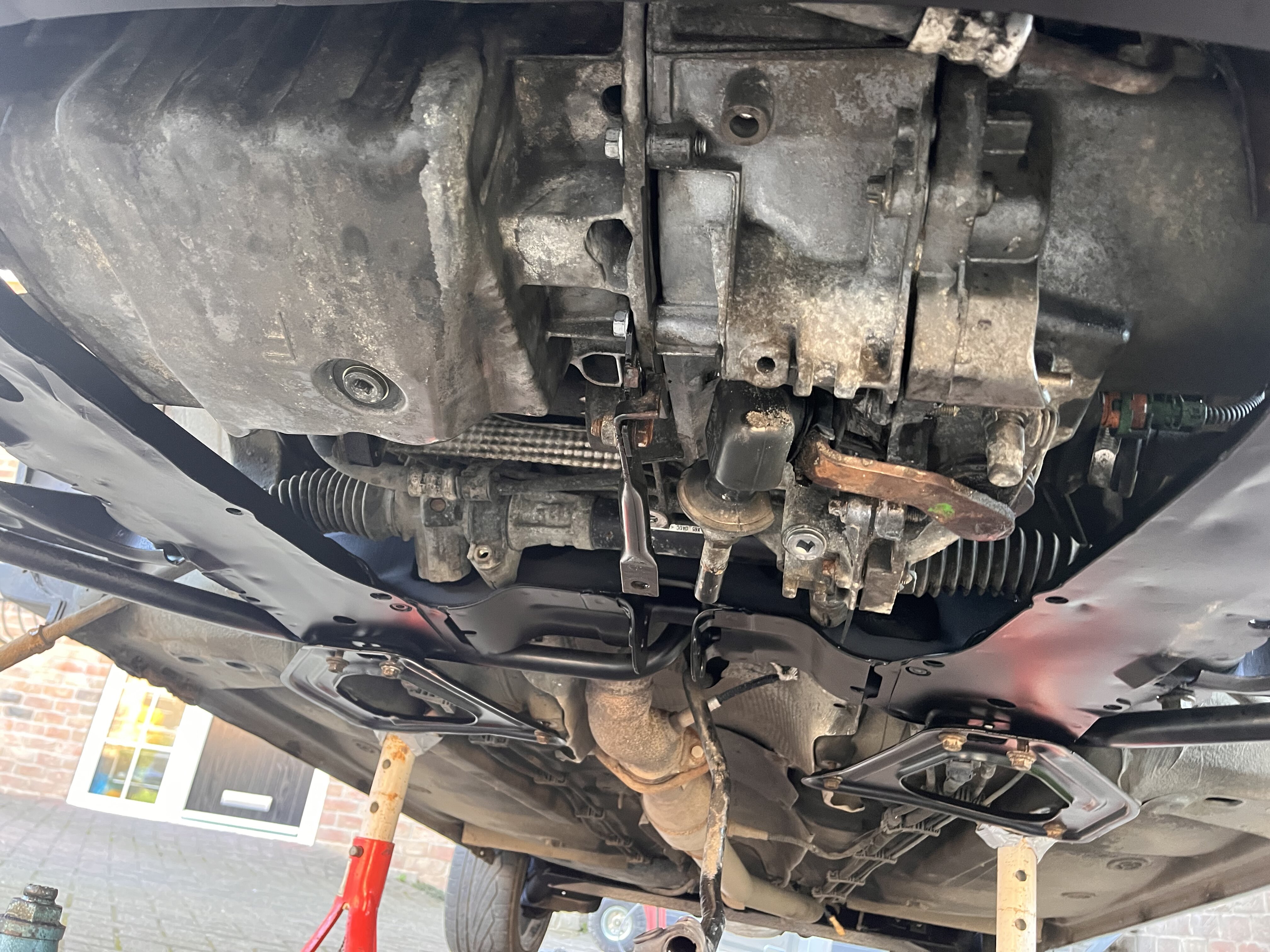

So the old girl has an oil leak, its nothing major and to be fair has been there a little while, although recently is has become a little worse. When the belts were done we couldn't work out if it was the main seal or the sump gasket and I was worried it was the new main seal but I am pretty confident it is the sump gasket now as I cleaned all the oil off and there is a dribble down the side of the pan but its not above it.
Given I am hoping to swap the subframe for a nice powder coated one in the next couple of months I am debating whether to get it done now or just wait until I have the subframe off. I am also wanting to do an oil change but that could result in me doing it twice in short order that seems a bit of waste, so I'm just debating with myself what the best course of action is.
Not a massive job with the subframe off, just a few bolts at the bottom of the gearbox to remove, then the bolts out of the sump.

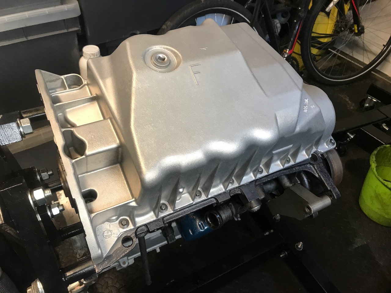

My BG sump was leaking in multiple places, including the crankshaft oil seal, but primarily from the corner near the starter.
Great opportunity to get it aqua blasted and clean the filter on the oil pump.
Thanks Jon, I kinda figured it was pretty easy with the subframe off. Think I will try and bring forward the subframe timeframe and get it done next month. Its not a major leak but it does annoy me.
Do you need to support the engine with the subframe off? I have seen a couple of conflicting messages.
I took the engine out when I did mine as I needed to access other parts, but I've had the subframe off with the engine in. The top engine mount is sitting on the body and the battery support above the gearbox is bolted in, so it won't go anywhere.
Good to know, I wasn't 100% sure.

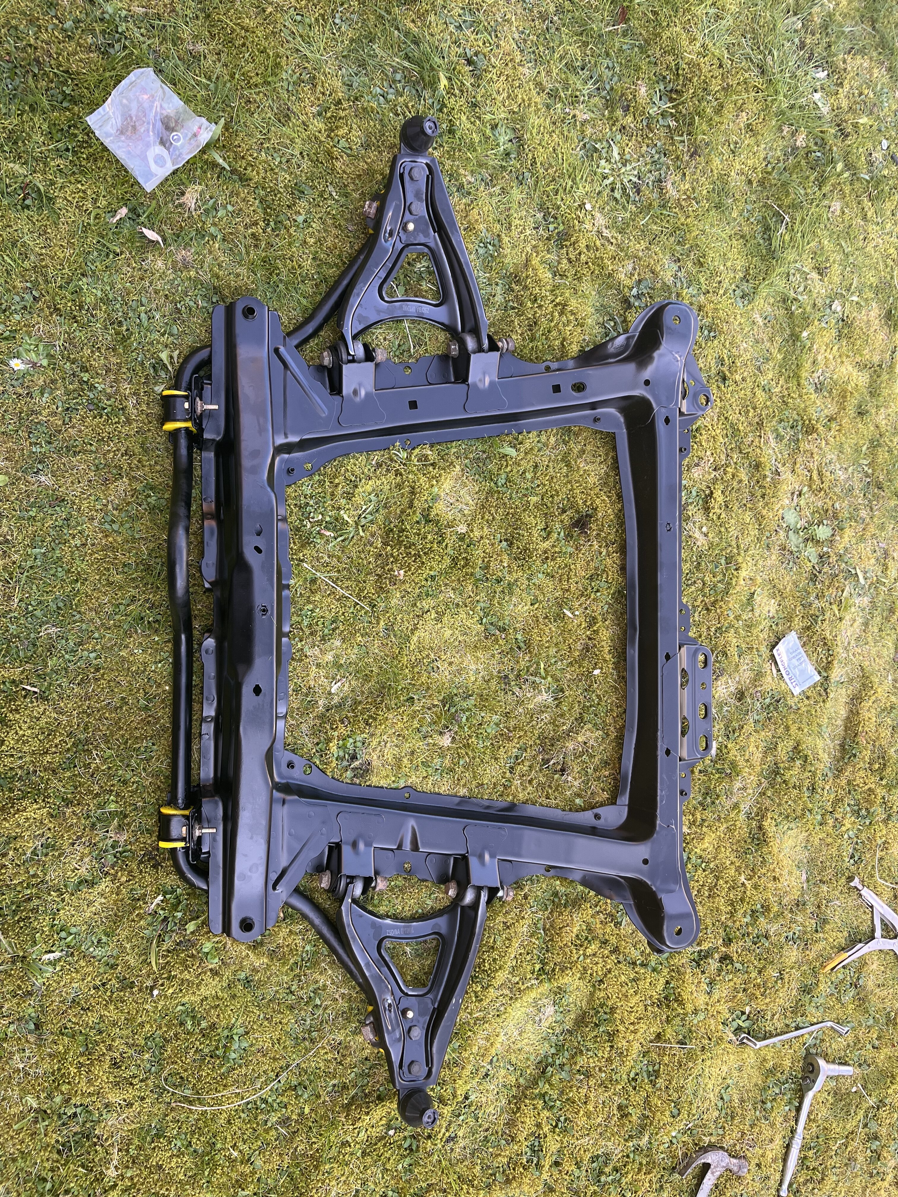

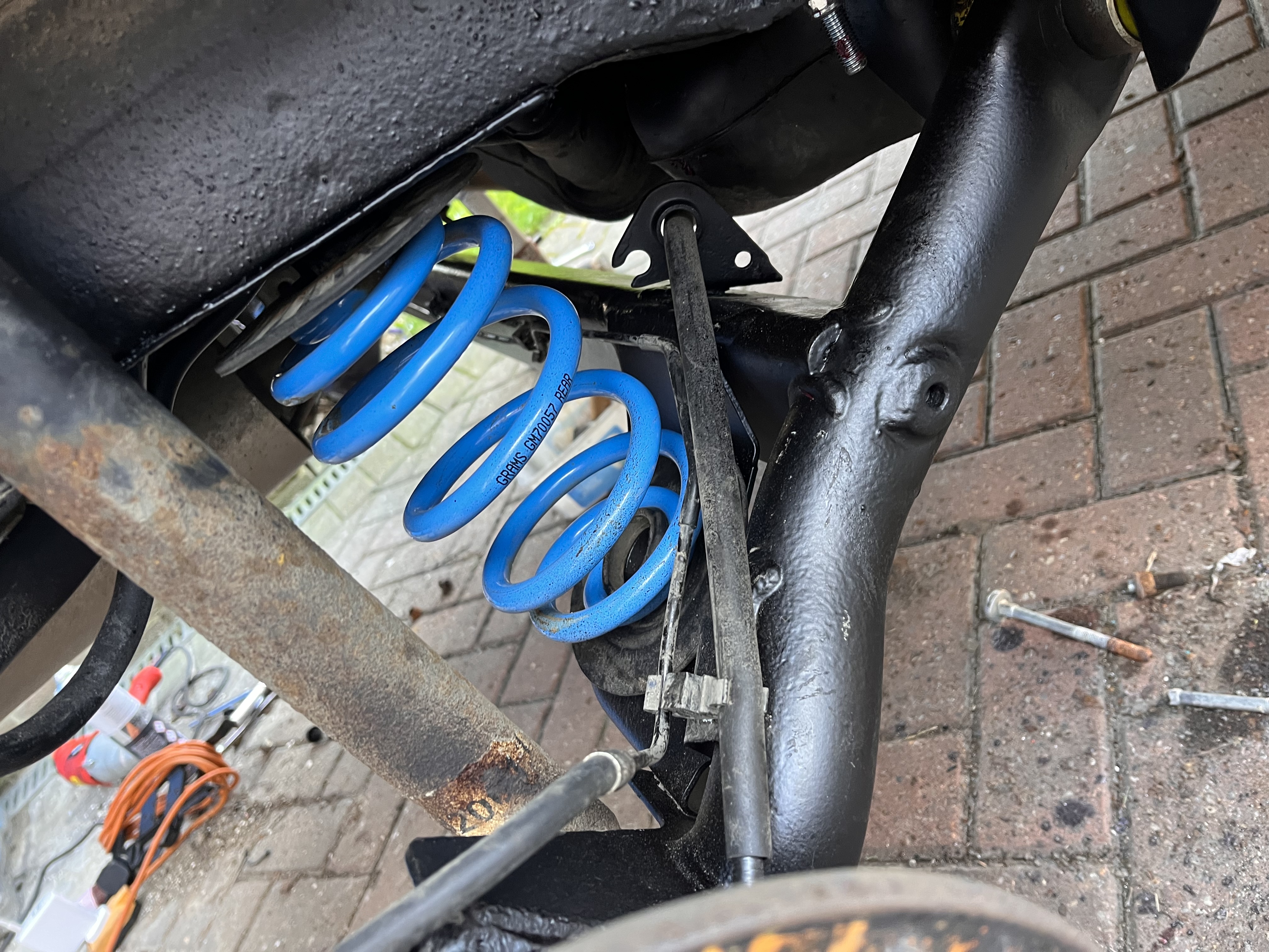

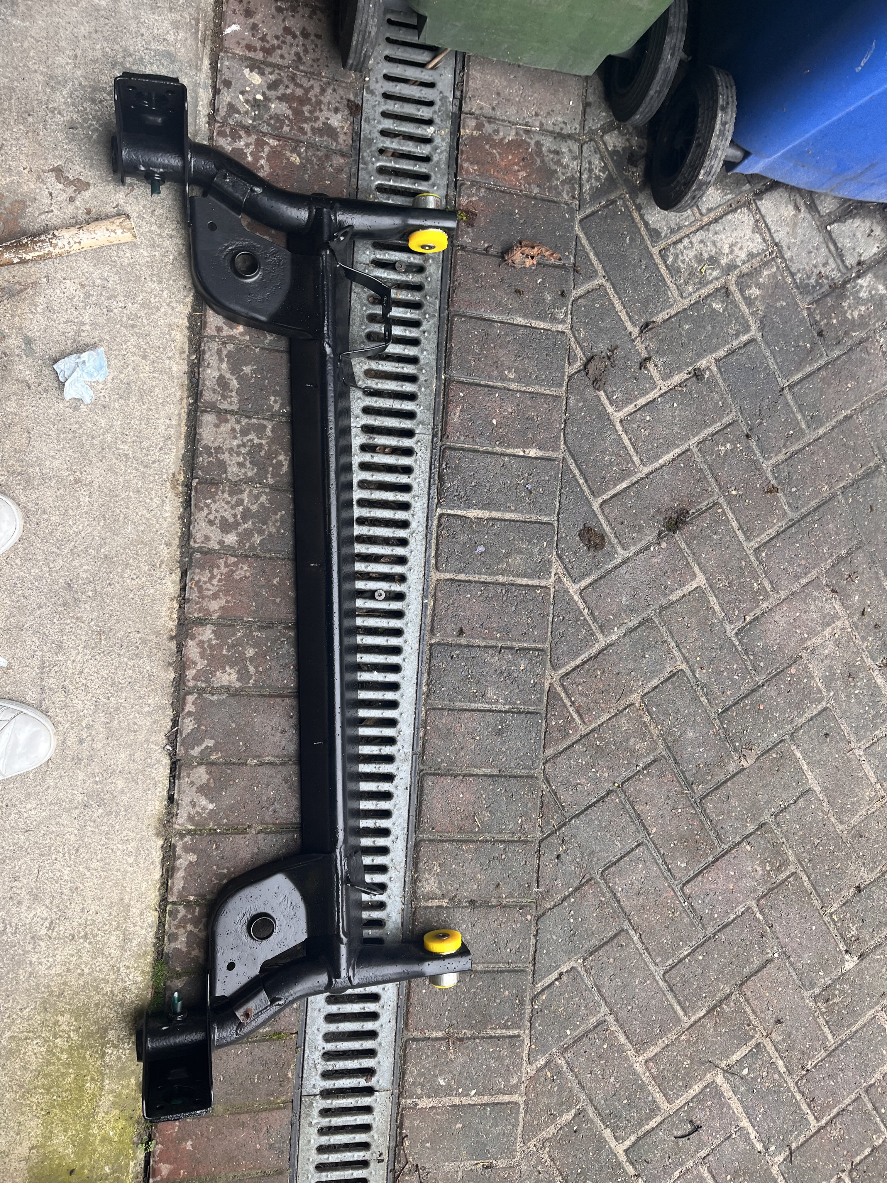

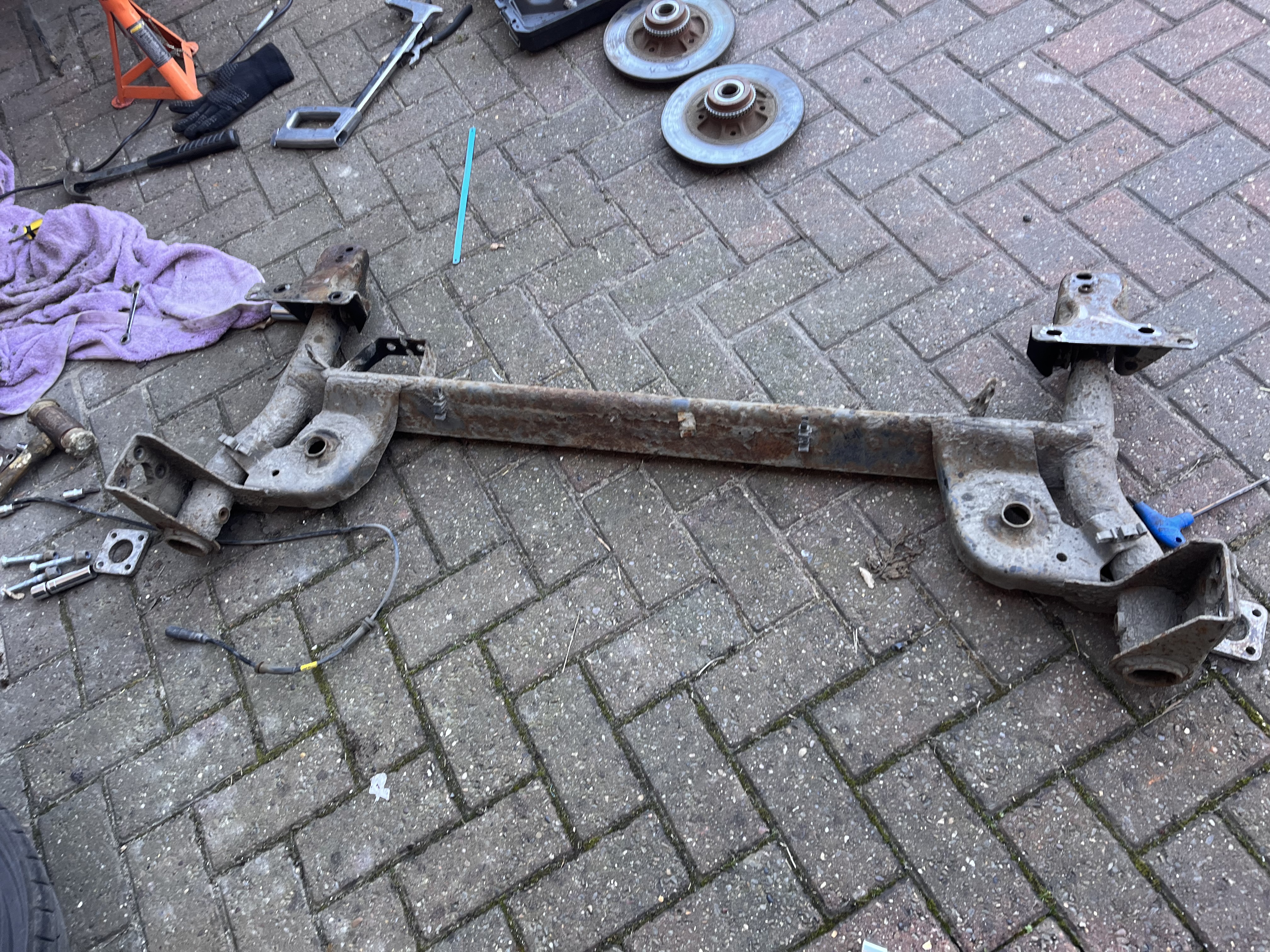

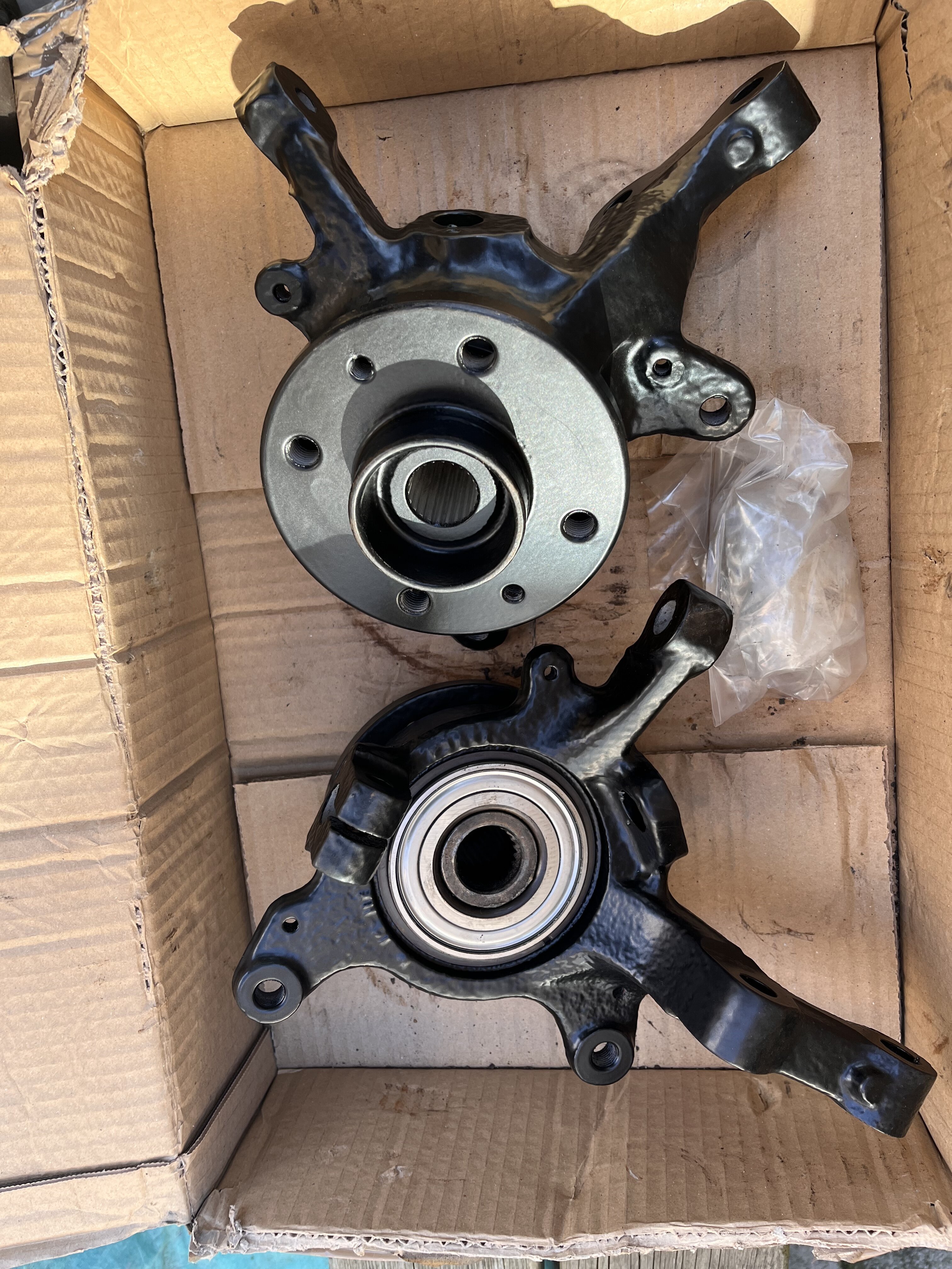

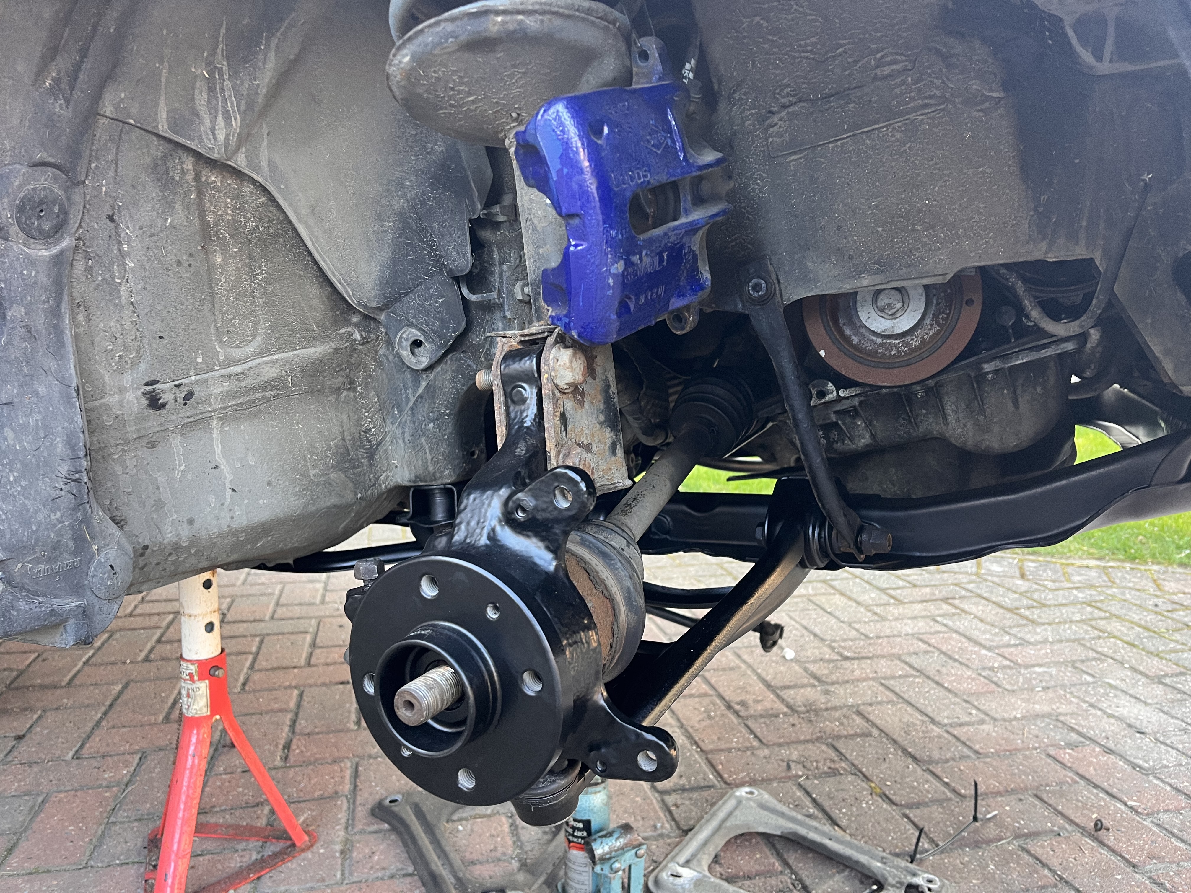

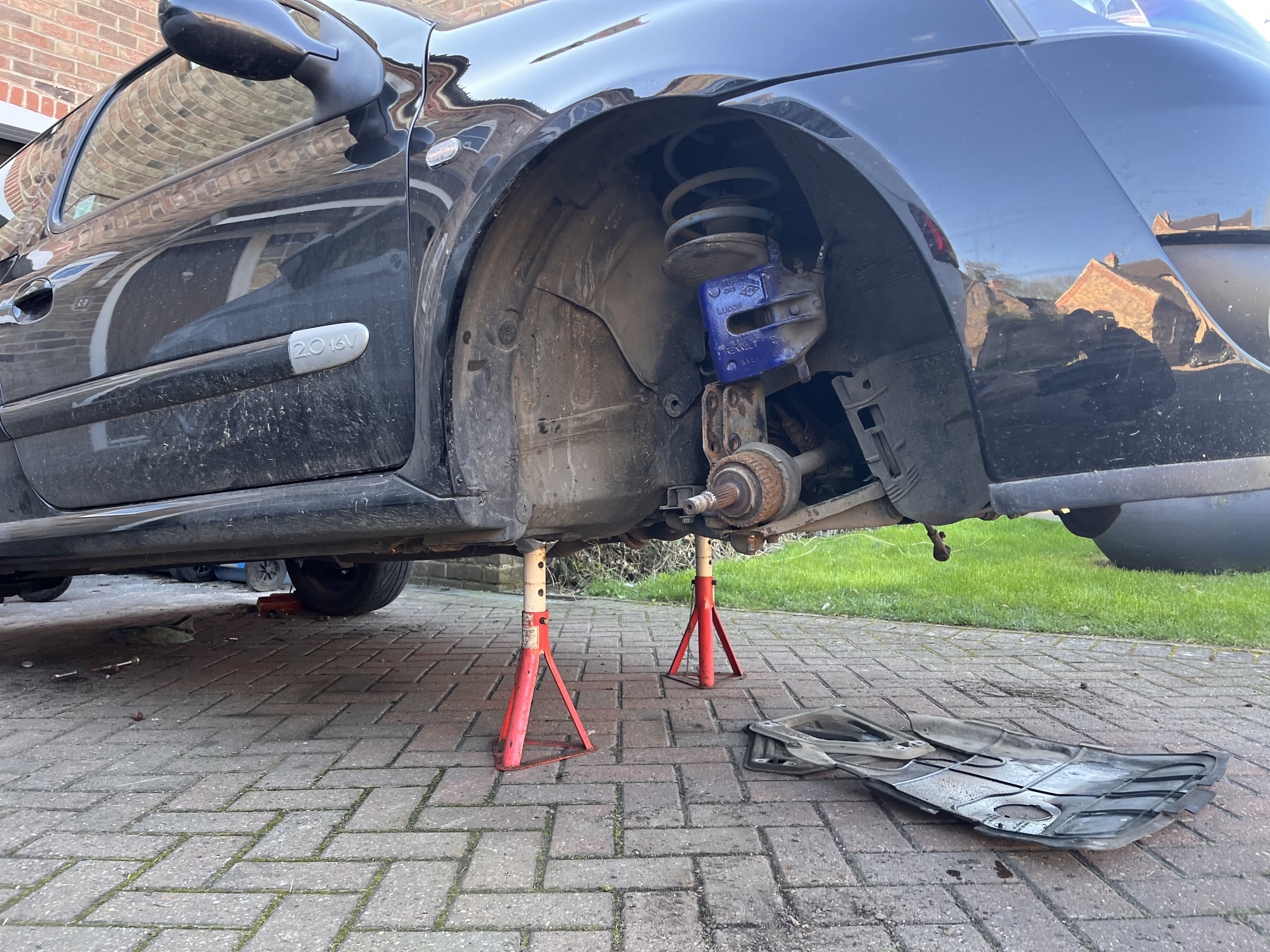

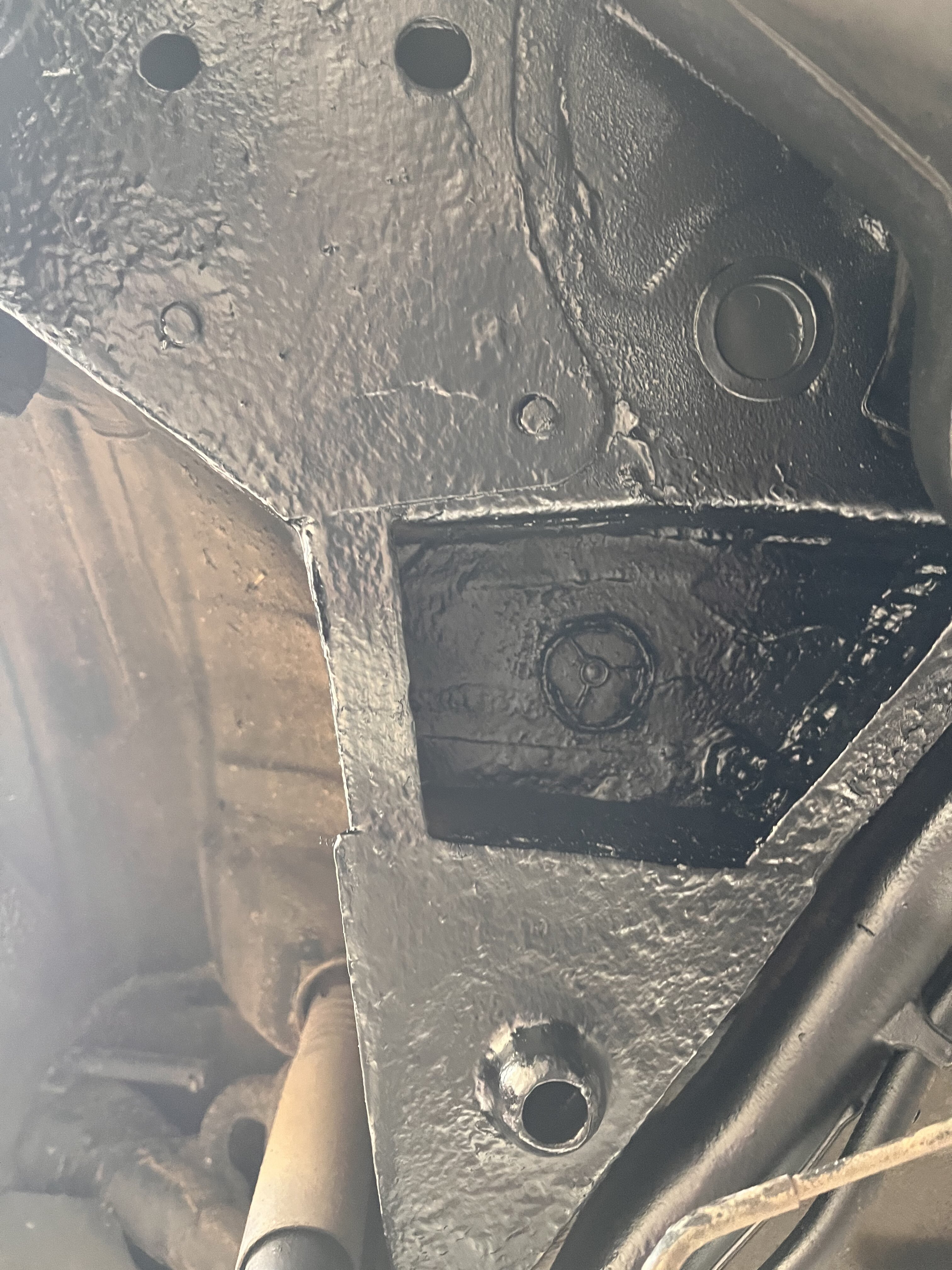

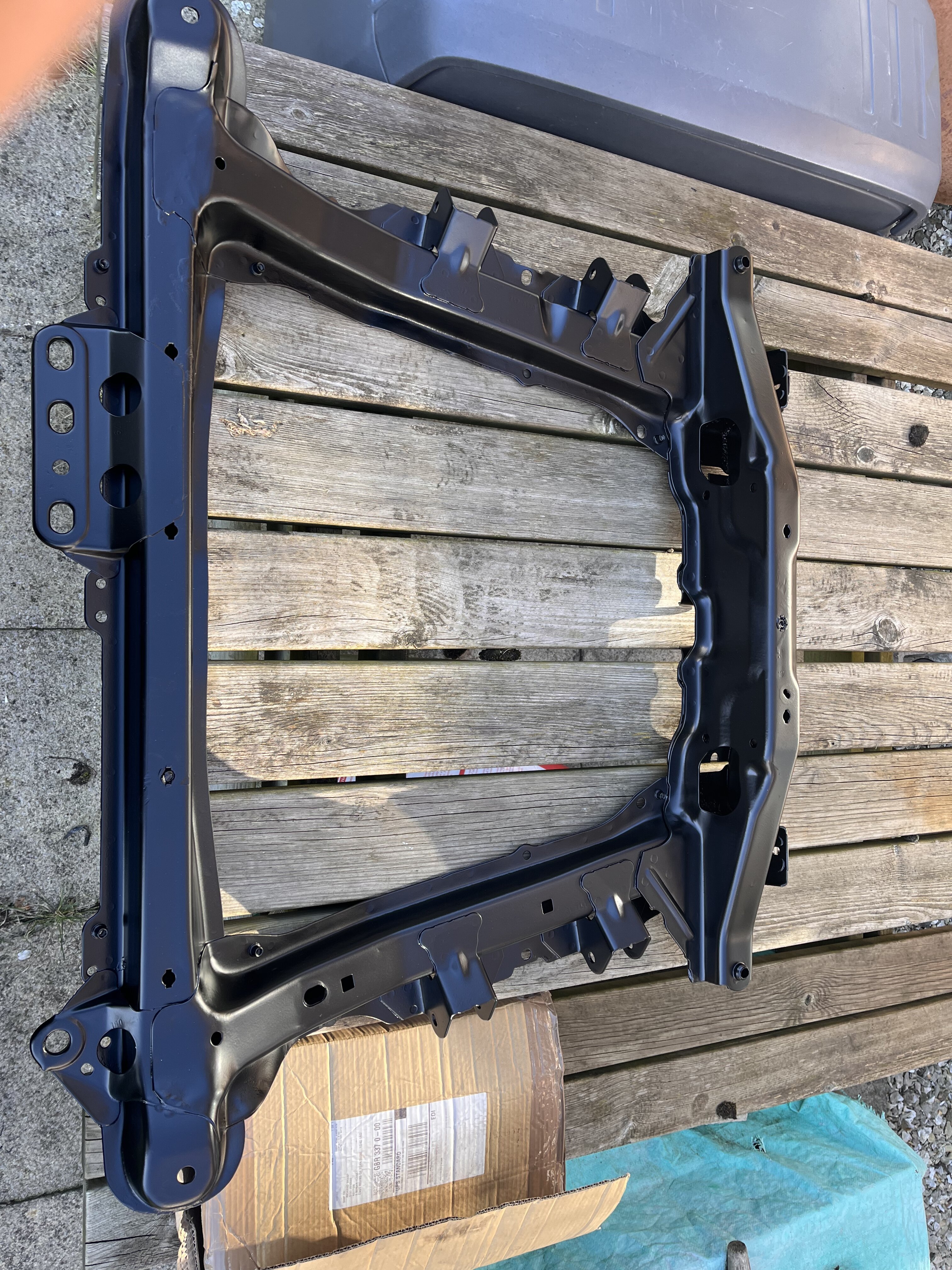

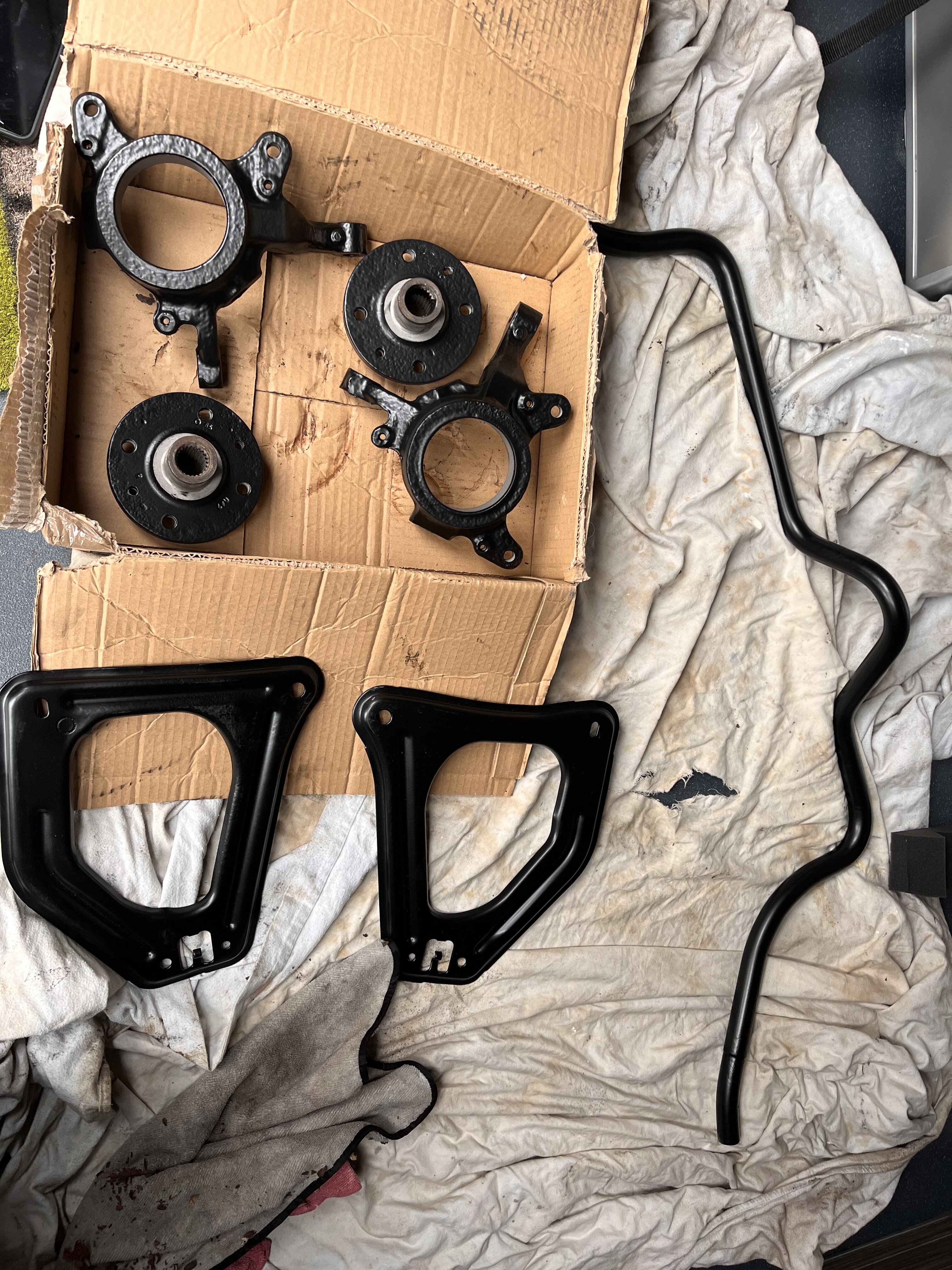

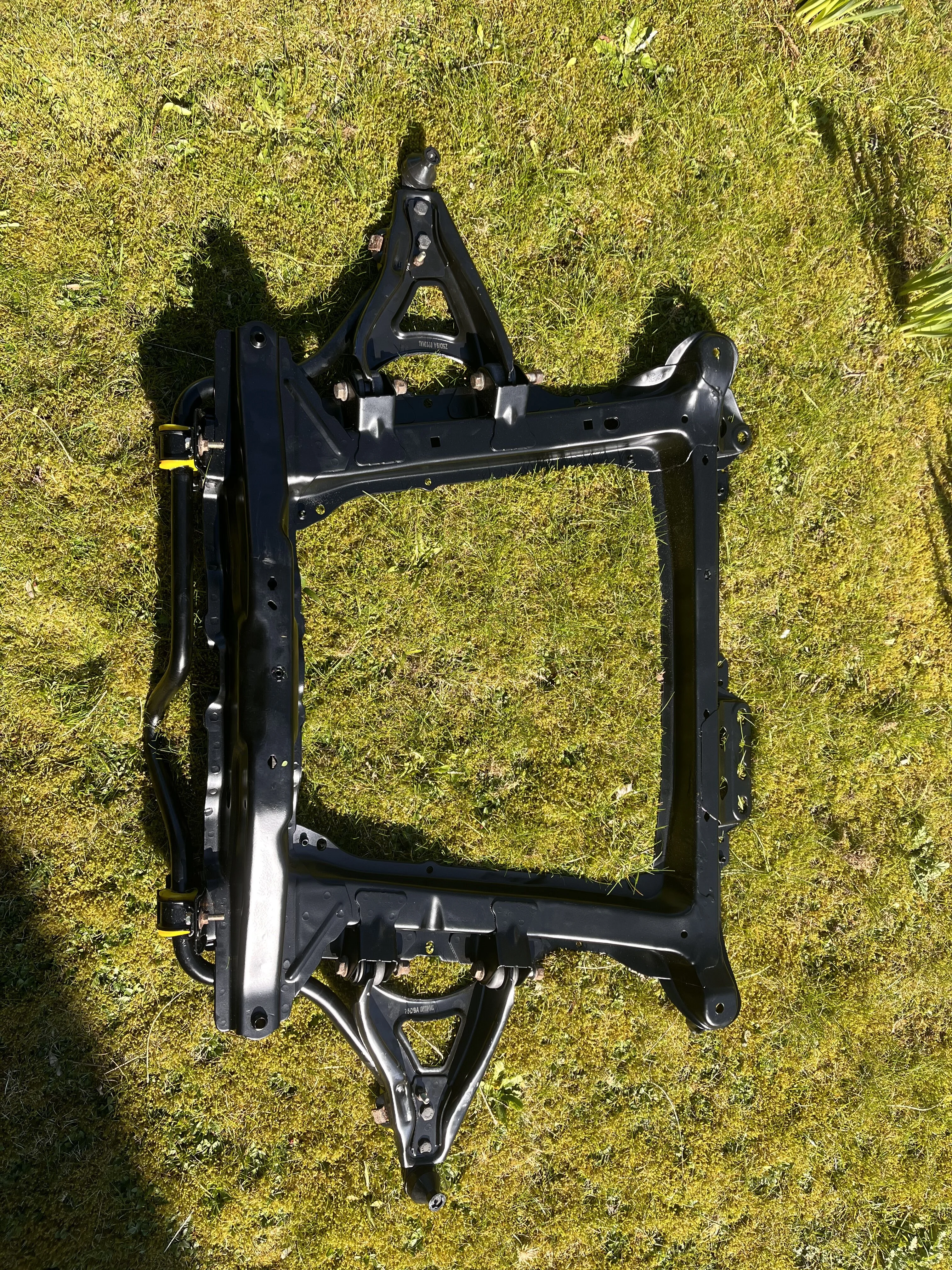

Subframe back from the powder coater and front axles back with bearings,
Also made a star, hadn’t actually meant to do this much but got carried away, as you can tell from the tool explosion…

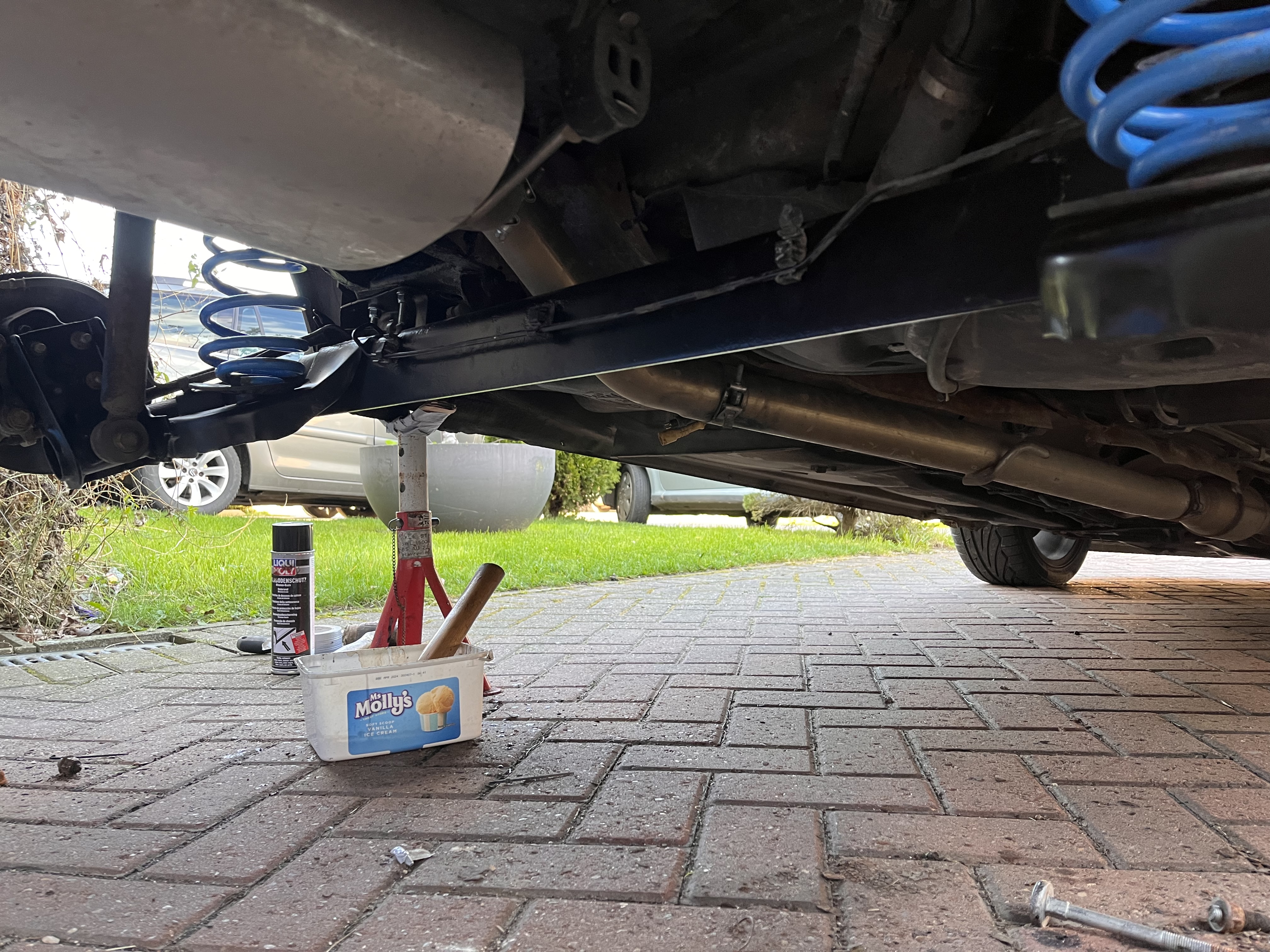

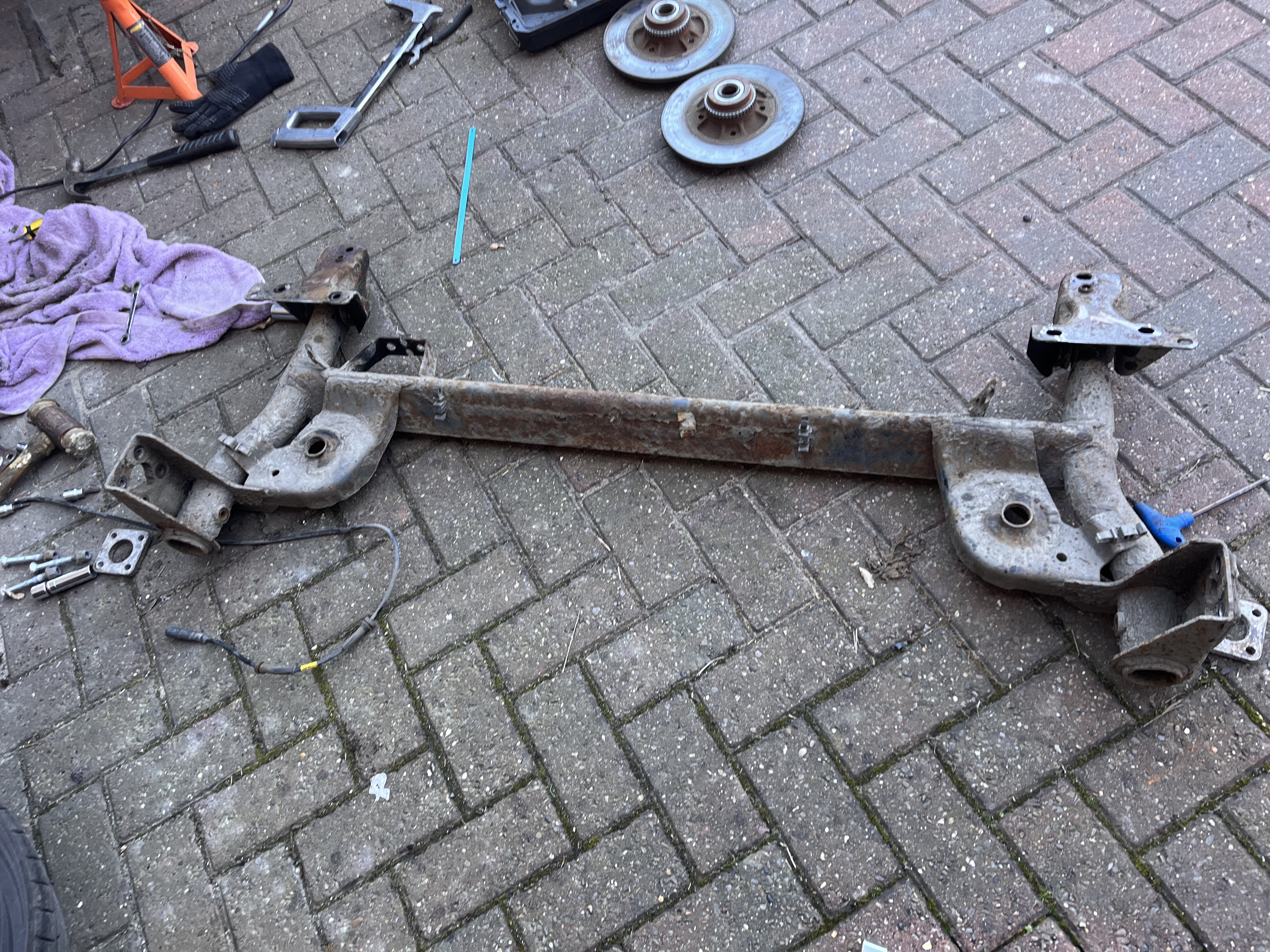

Should be easy enough to drop the rear axle on, some rust to sort out first but nothing major, pretty please with how clean it is really.
Horrible job but it's got to be done! 👏
Looking good. I fancy getting my subframe painted/powdercoated. Might have to break out the hammerite smooth when I pull the gearbox back out... Again🤣
Just make sure you clean up those mating surfaces on the hub flanges. Ask me how hard it is to remove stuff when powdercoat has welded it in place🤣 *Insert video of smacking off brand new powdercoated wheels using a copper hammer because they'd welded themselves on after a trackday*

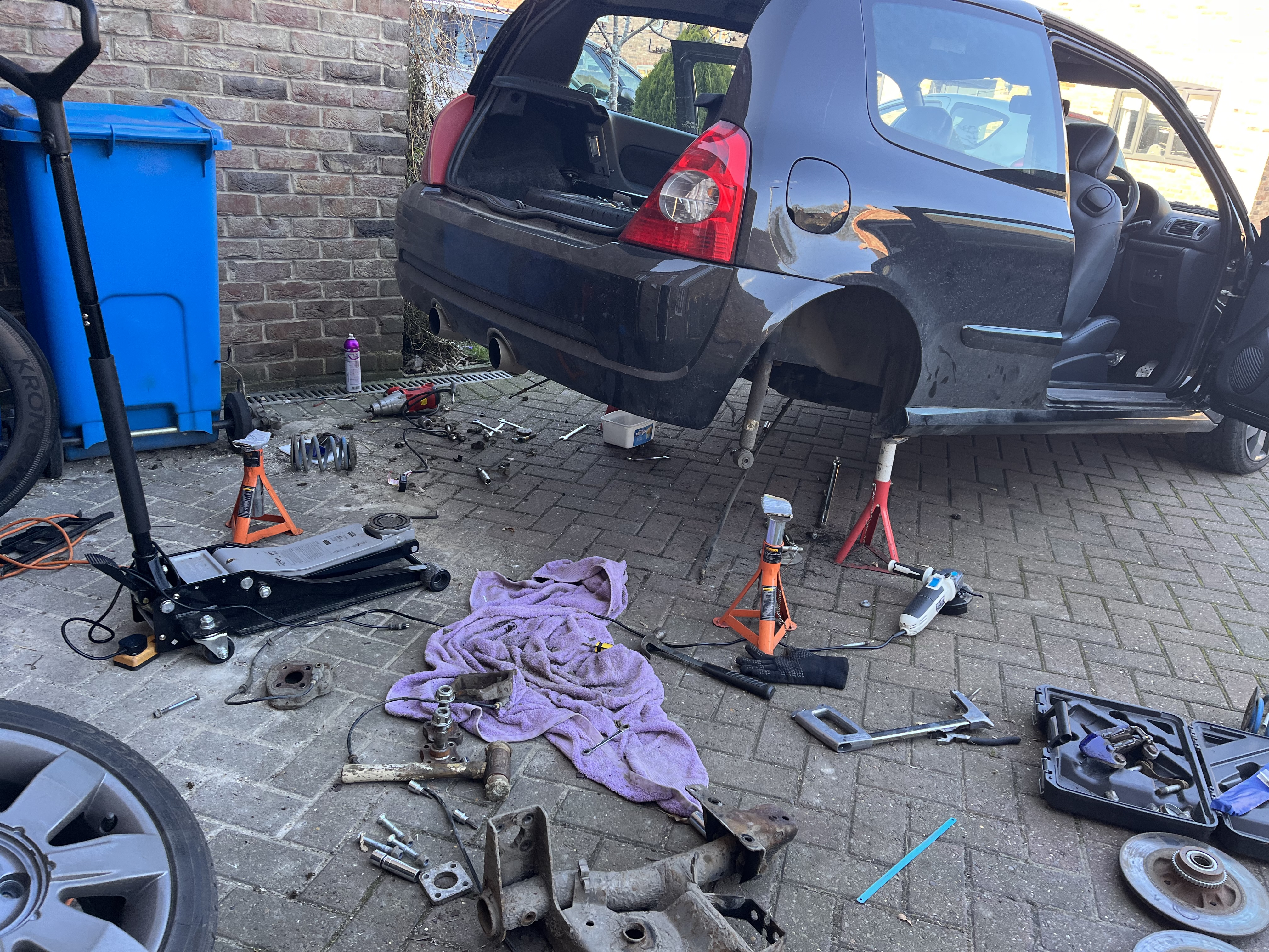

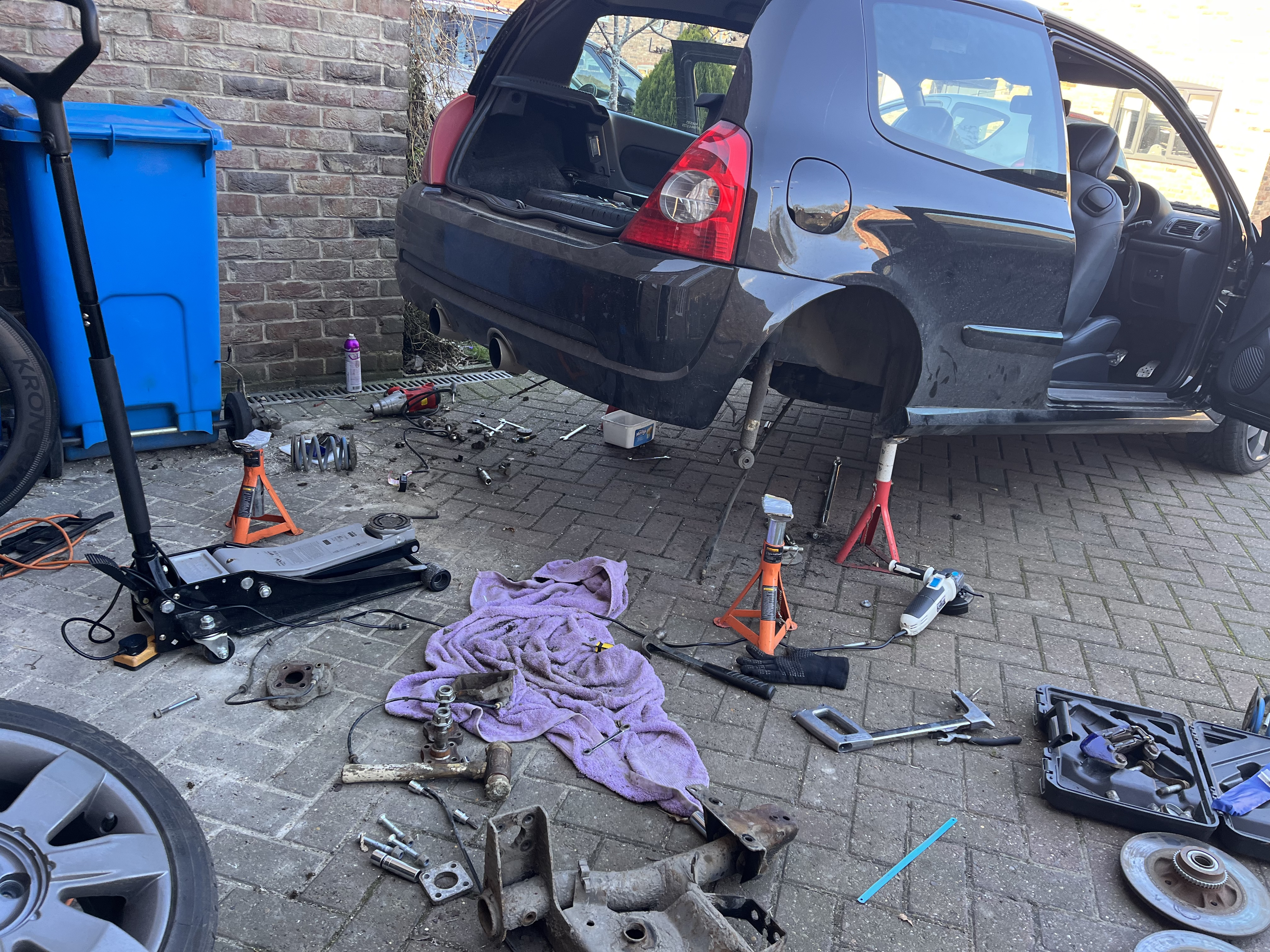

Kinda progress today, got the back end back together, looks really good I’m pleased with it. However the BAS sensors I preemptively bought are not right and I suspect I’ll end up spending £320 on 4 new ones 😫
Also my handbrake outers seem mega tight, almost like they’re too short so might end up replacing those as well.
Still need to bleed the brakes as well but going to wait until I’ve done the front end as I may take the calipers off the front as well not decided yet.

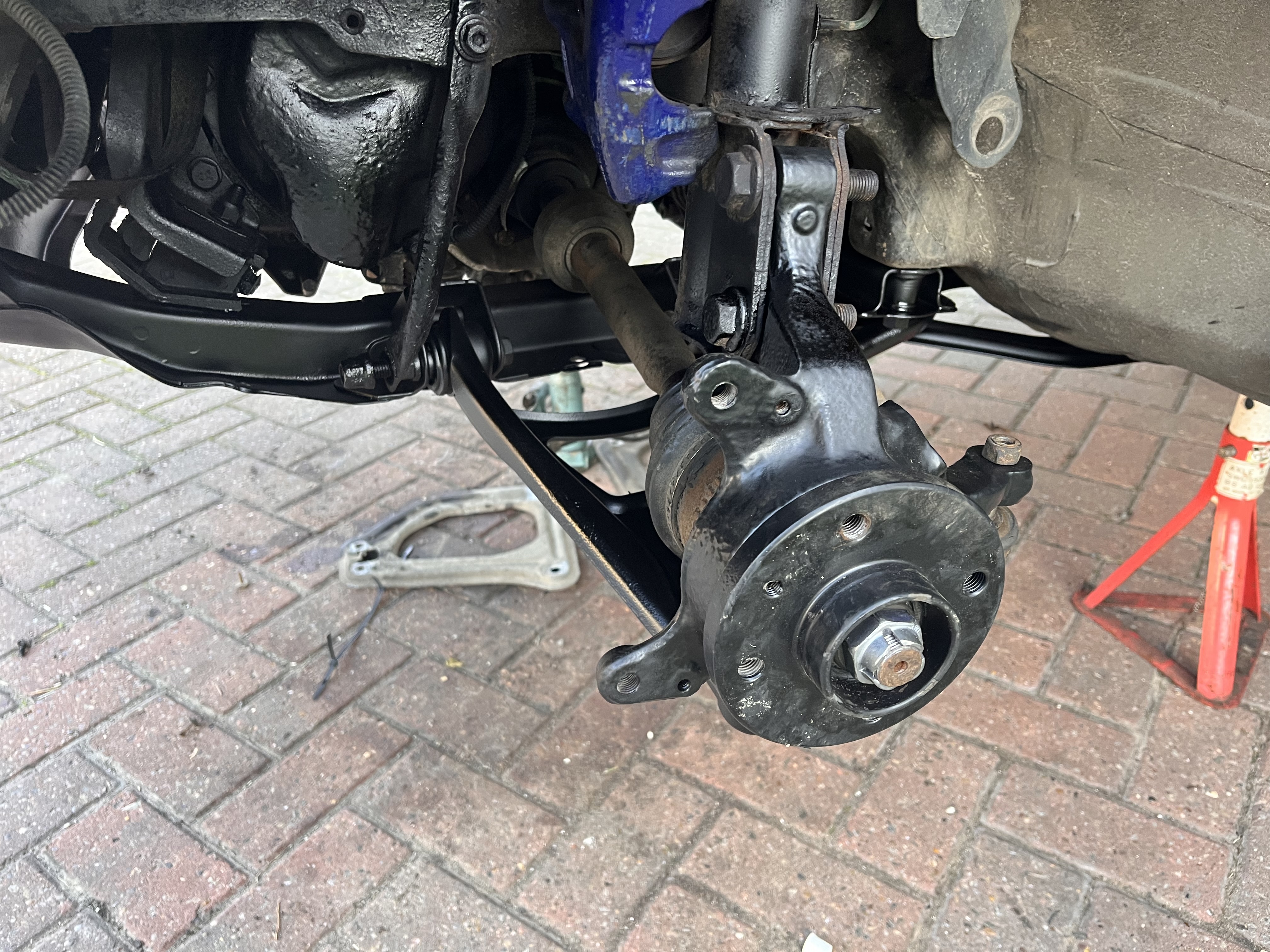

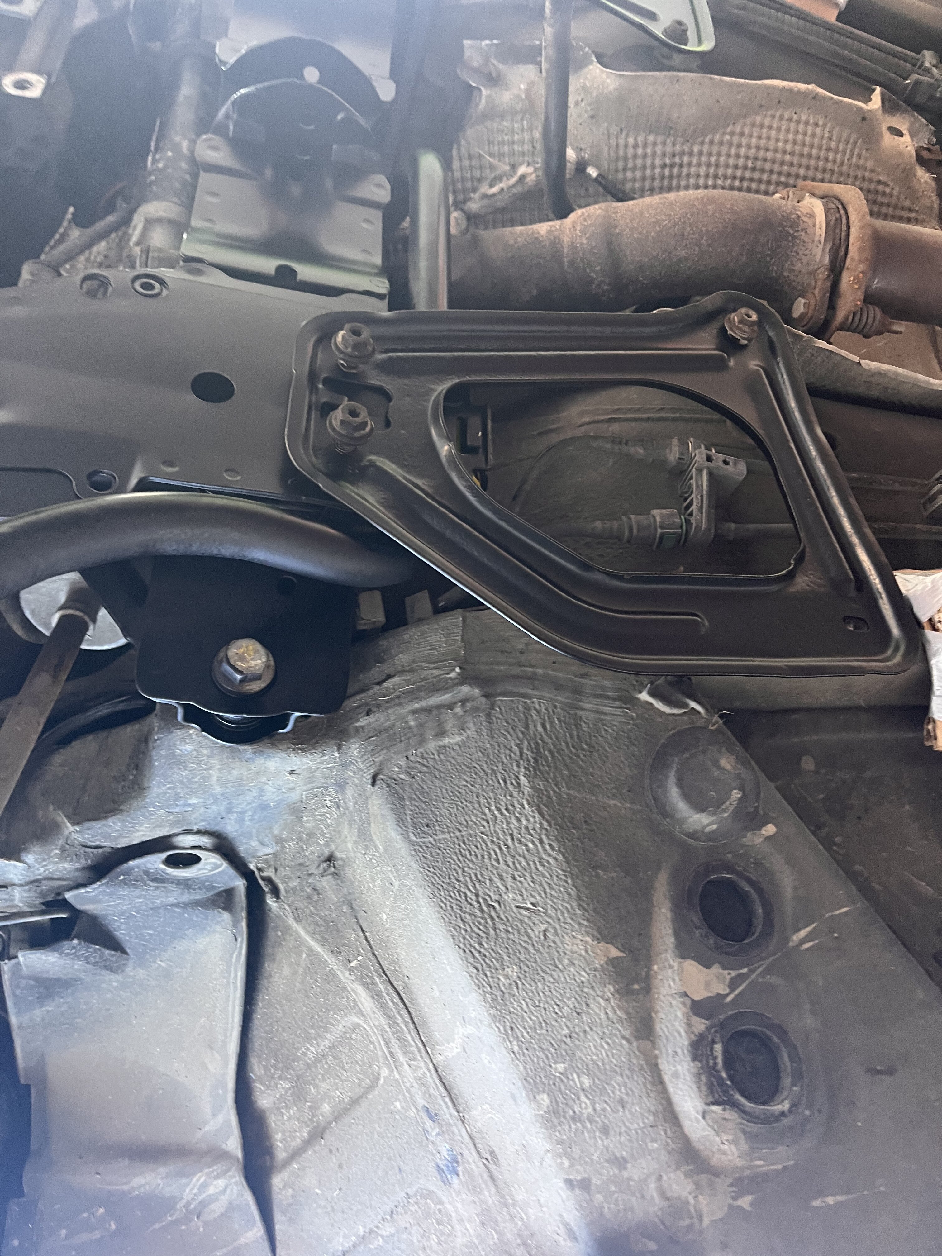

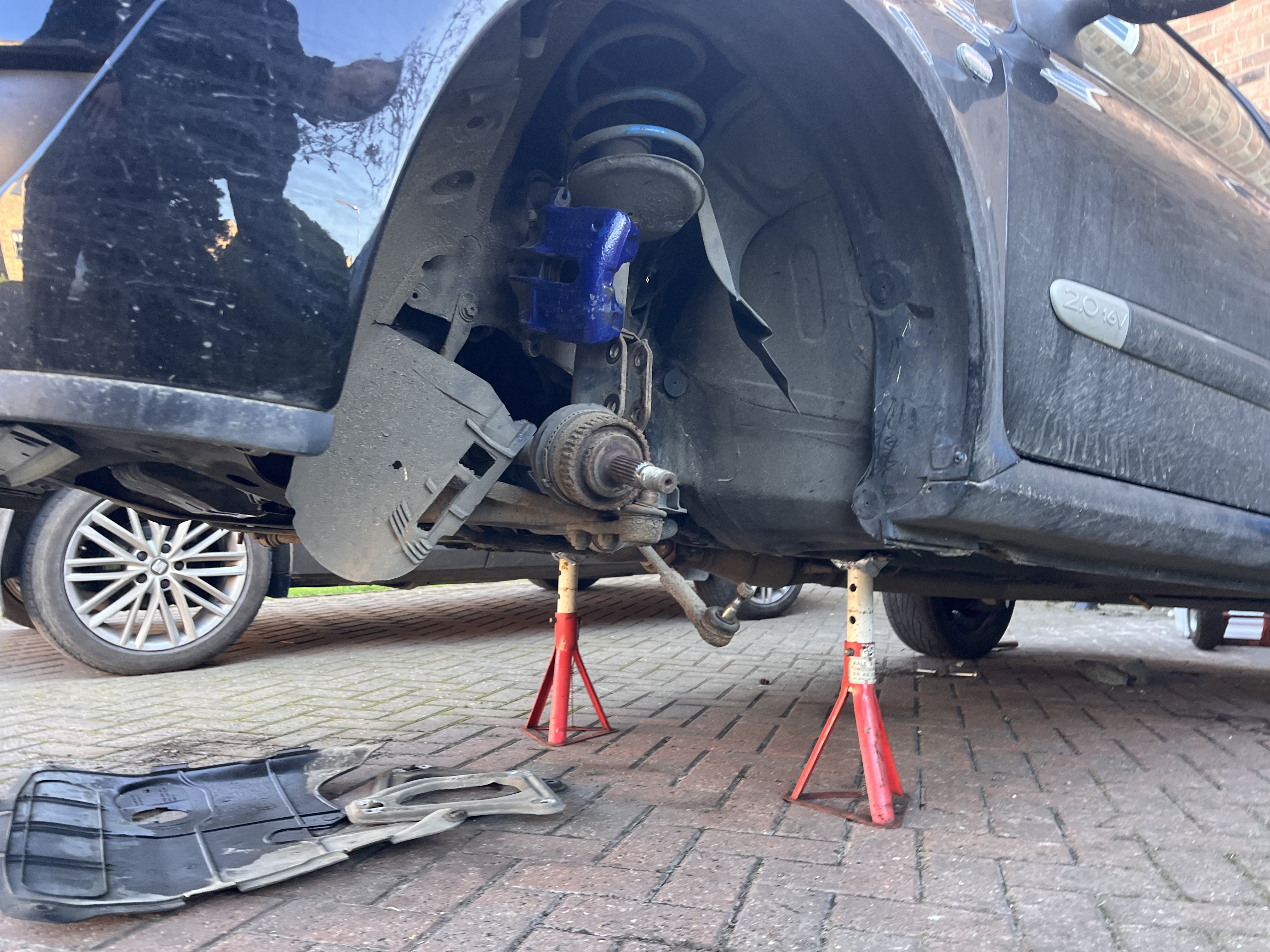

Moving on to the front end, made reasonably positive progress pulling the subframe off. Everything seems compliantish at the moment, couple of the frame bolts are tricky but the swan neck spanner’s working a treat so far.

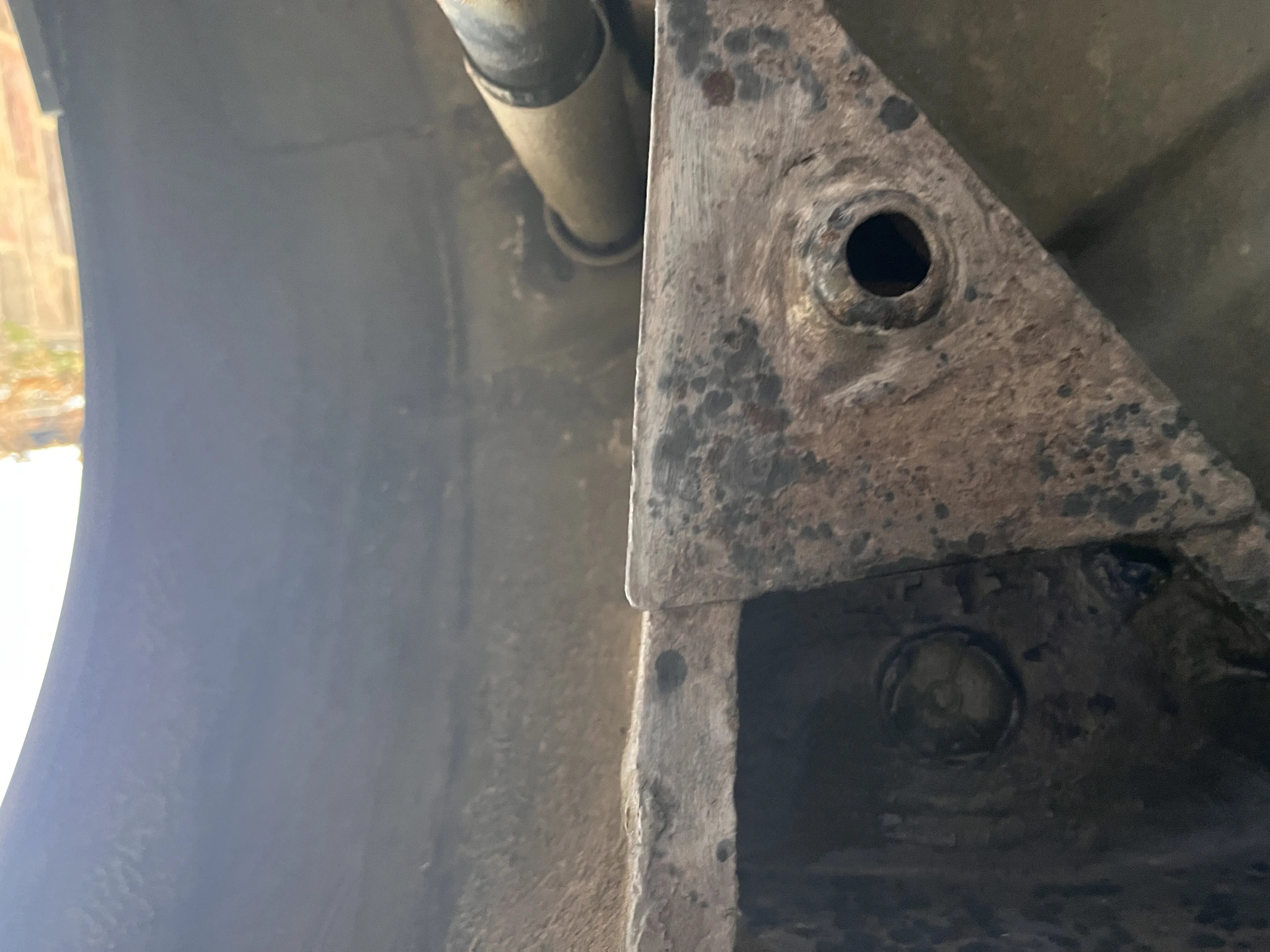

I did manage to snap one of the bolts holding the D supports on which is frustrating.
Hoping to have it dropped off tomorrow or Wednesday.

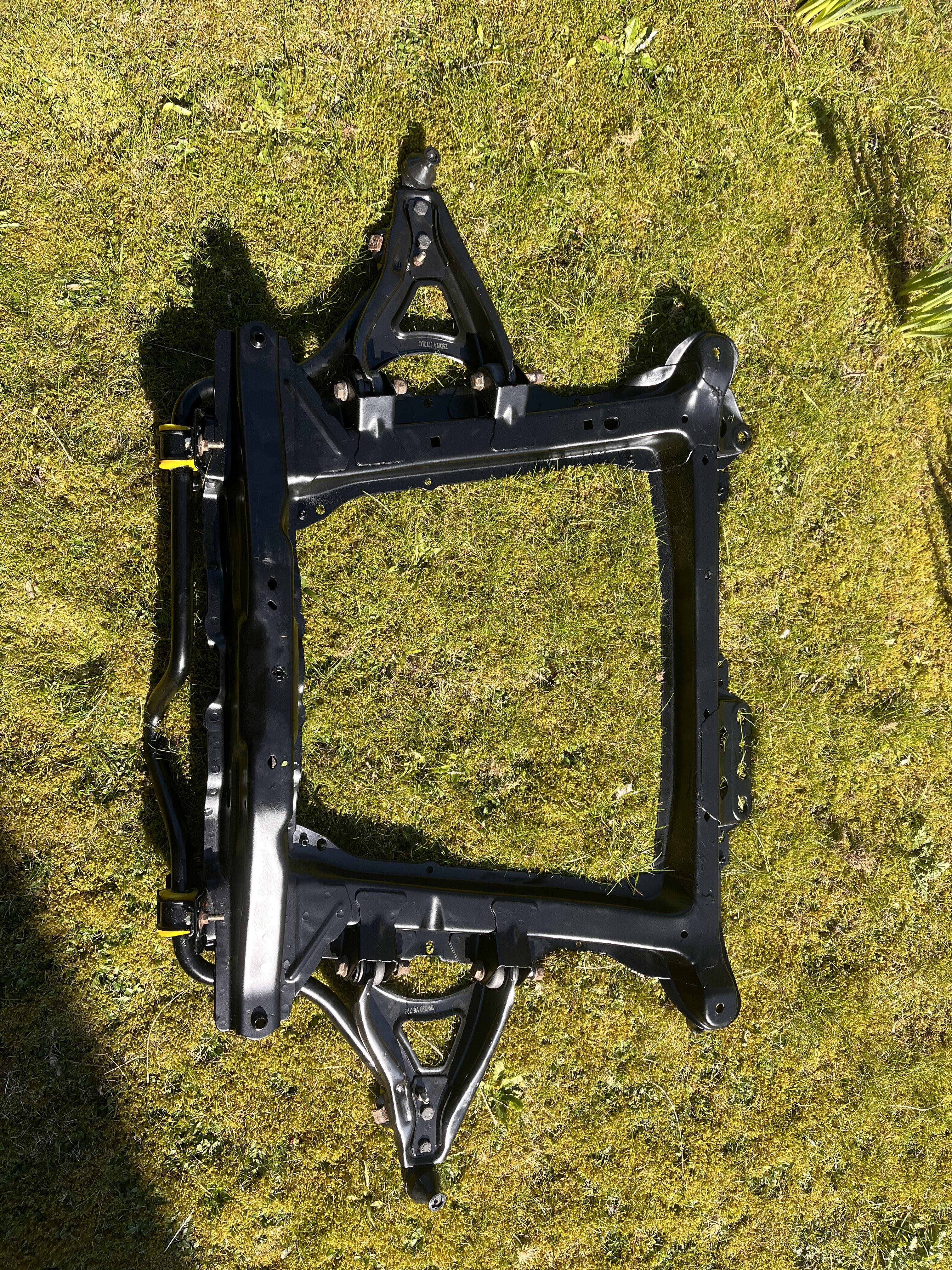

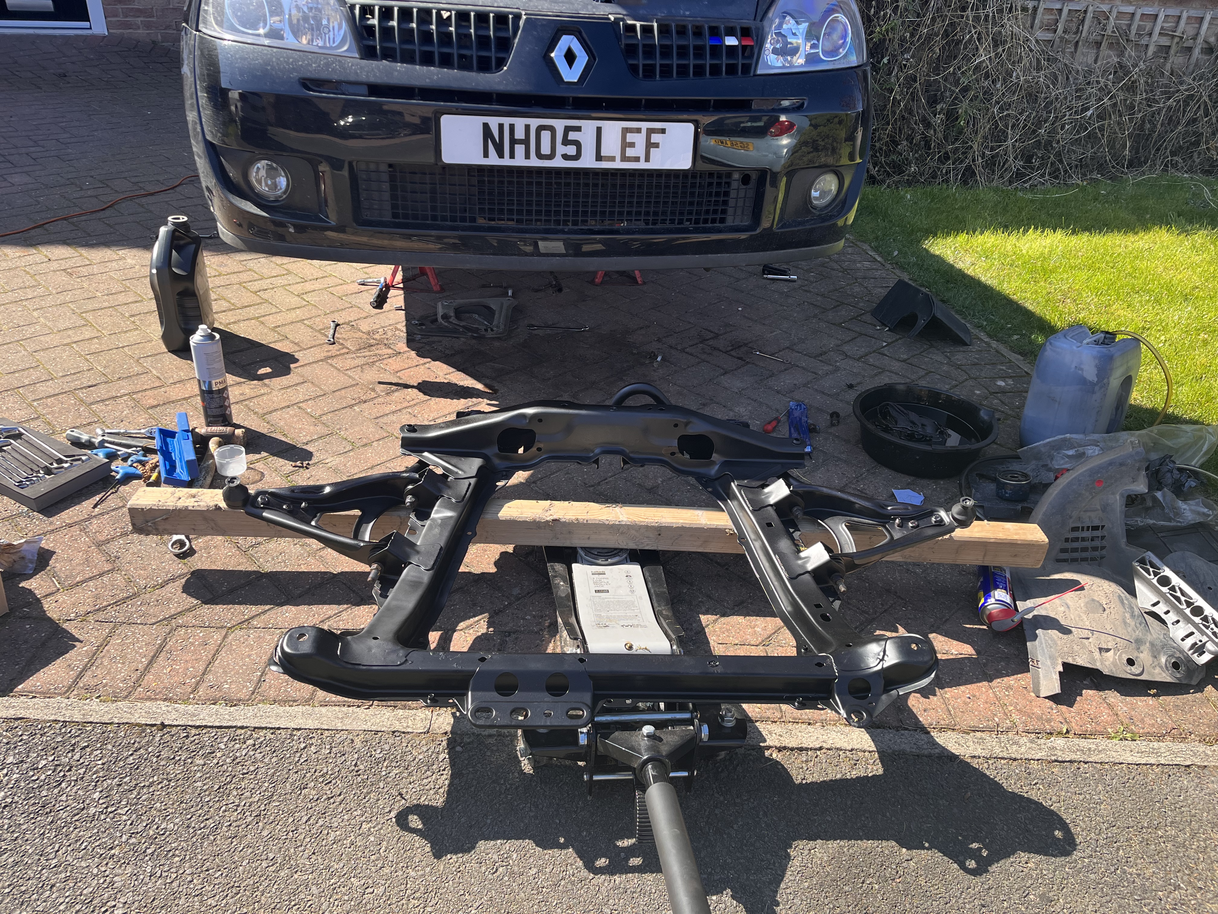

Basically a whole day spent on the car, dropped the subframe, built a up the new subframe…. Twice… fitted the new subframe, cursed the engineer when I forgot the steering rack bolt you have to install before installing the subframe, dropped the subframe, fitted said bolt, knocked it all I to shape and added the hubs. Fitted the new sump gasket as well, looking forward to the leak being worse than before.
Pretty close, although I’m waiting on new abs sensors so it’ll be another week or so before it’s actually finished.
As a slight aside the captive bolts were really easy to get to with swan neck spanners, although one actually held in place which was a small miracle. Not sure why I’ve heard of folks cutting the chassis to get to them, there’s literally a hole already in the chassis.
Worst bolt was the one holding the lower coolant hose on, took for ever and the car ate (later regurgitated) three 10mm sockets.

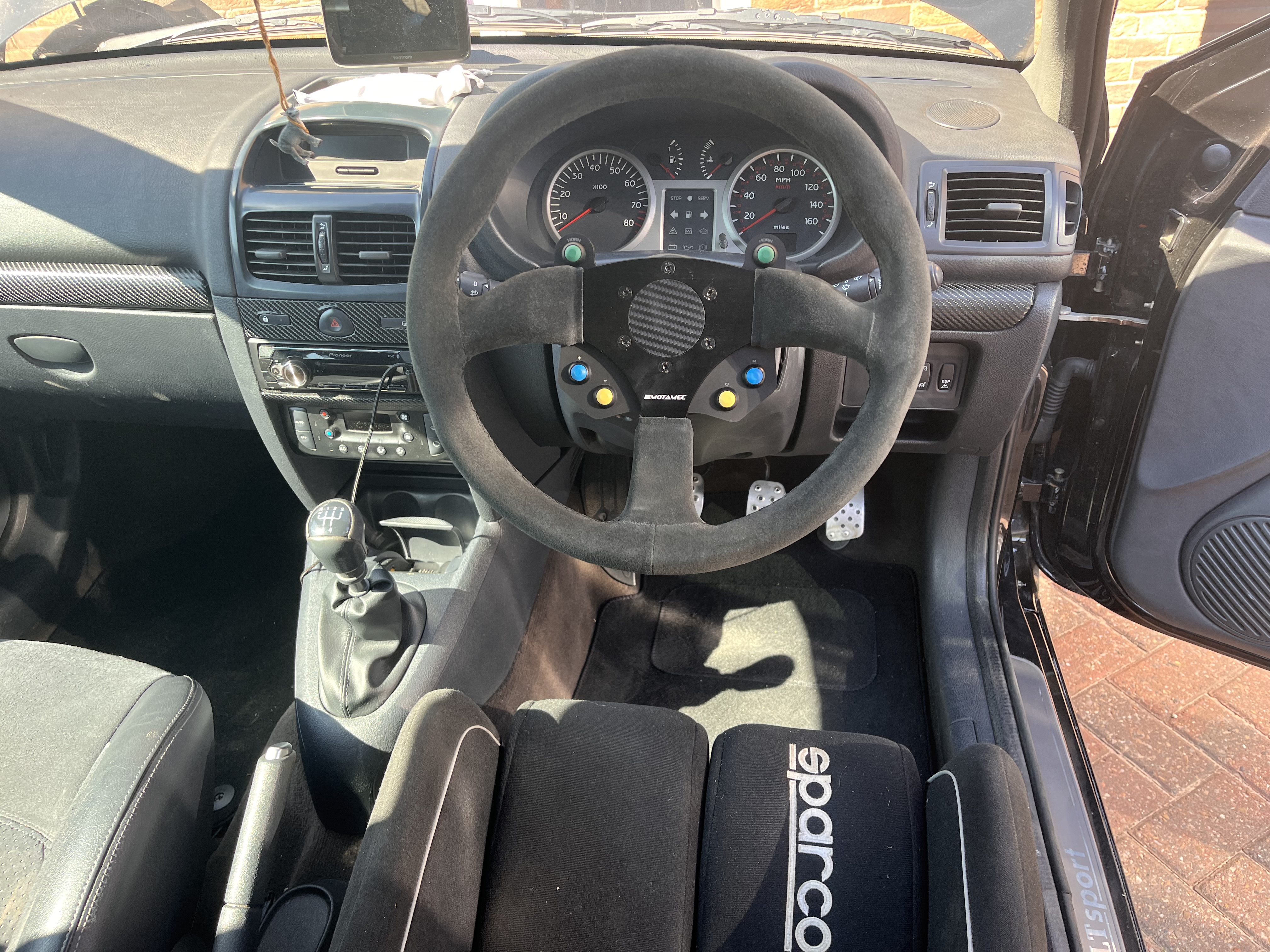

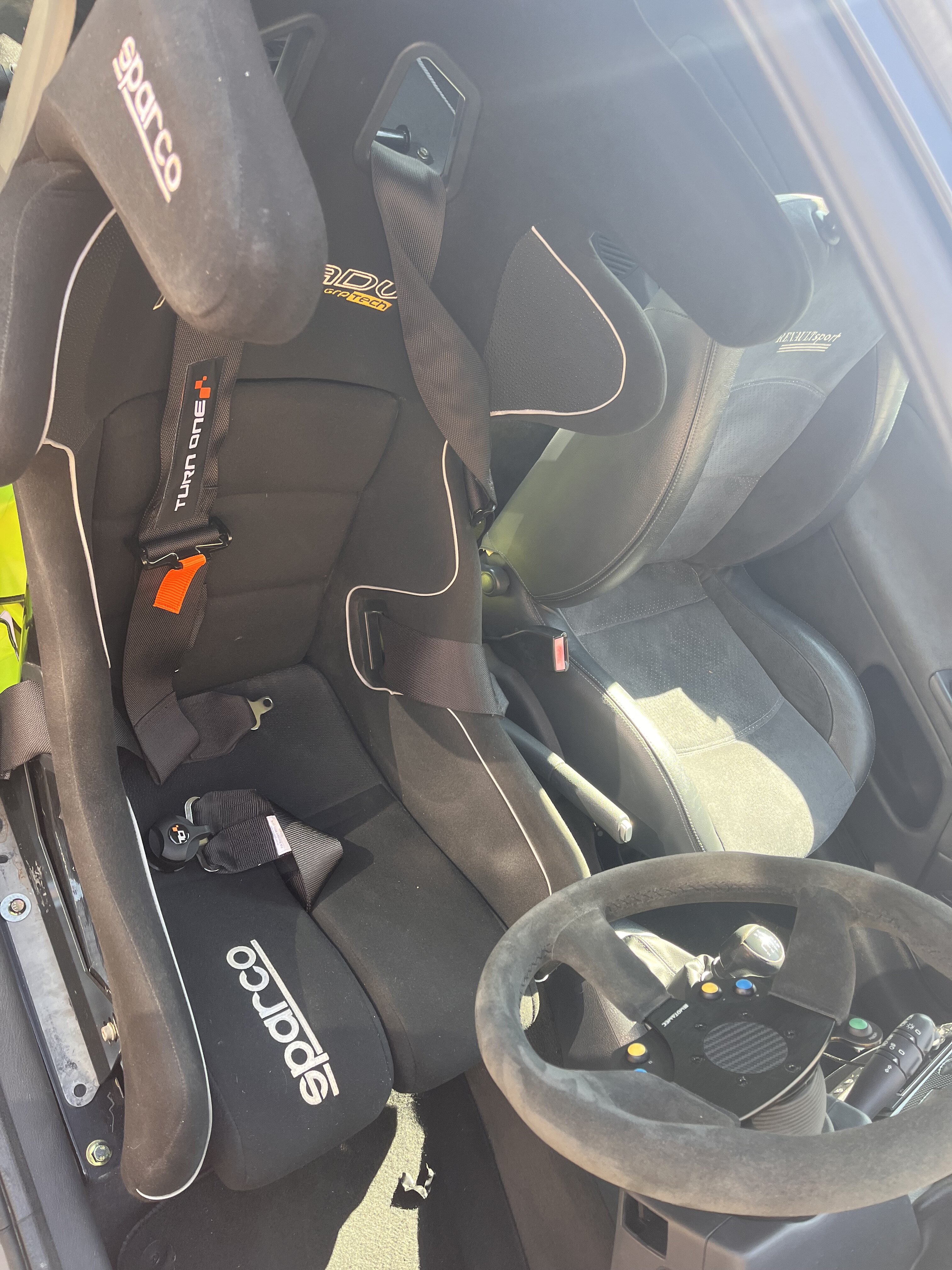

Picked up some bucket seats, got two Sparco adv grp tech seats for £350, would probably have preferred seats without the head wraparound but not a major issue and the price was right.
Fitted one, waiting in a harness and the cage for the other one.
Also got a new steering wheel, went for a monatec semi dished as a flat one would have needed a spacer to get it where I wanted, this is pretty much perfect for me.
Also fitted the button set I got from @idubl.
Waiting on a half cage turning up in the next week or so hopefully.
It’s been a little while since I updating things.

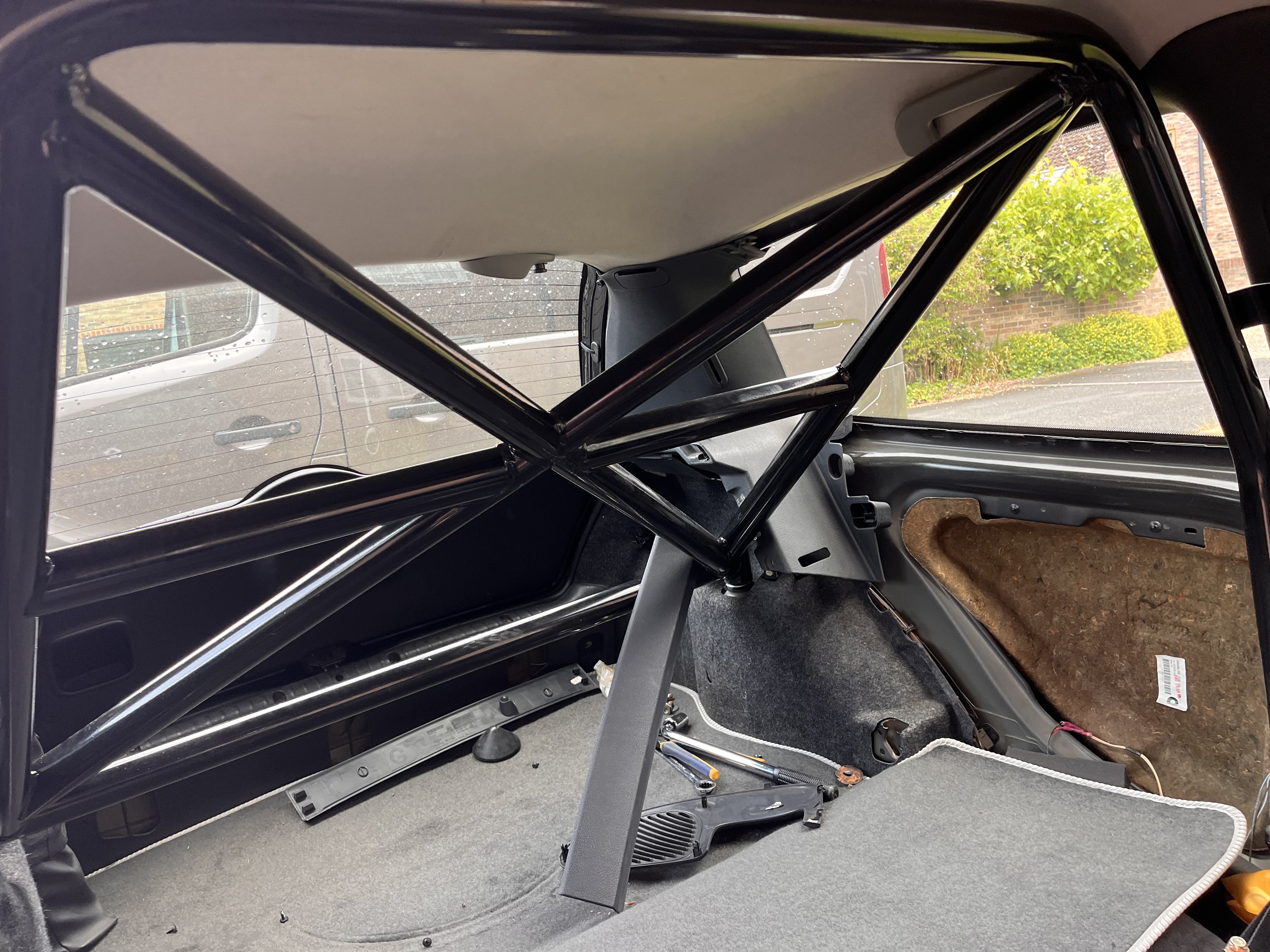

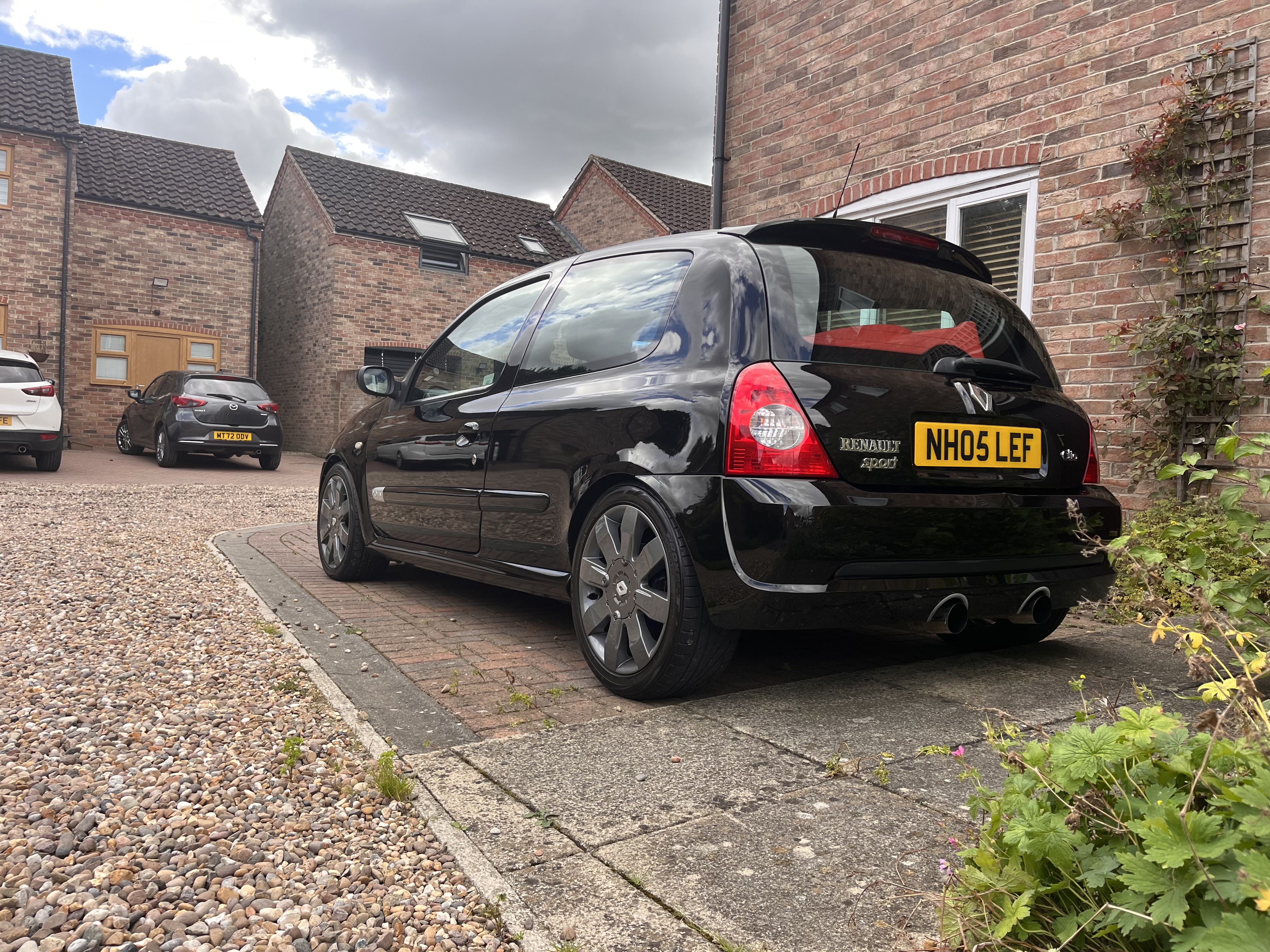

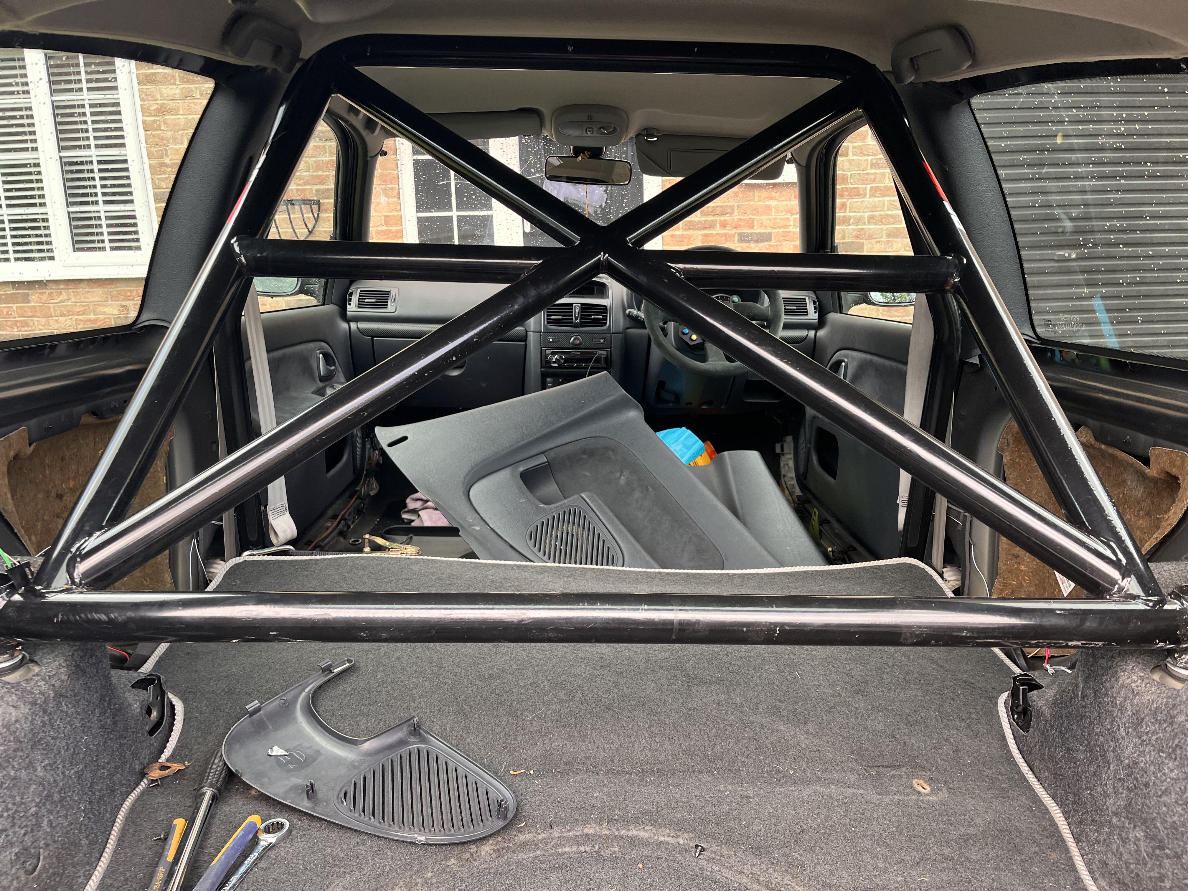

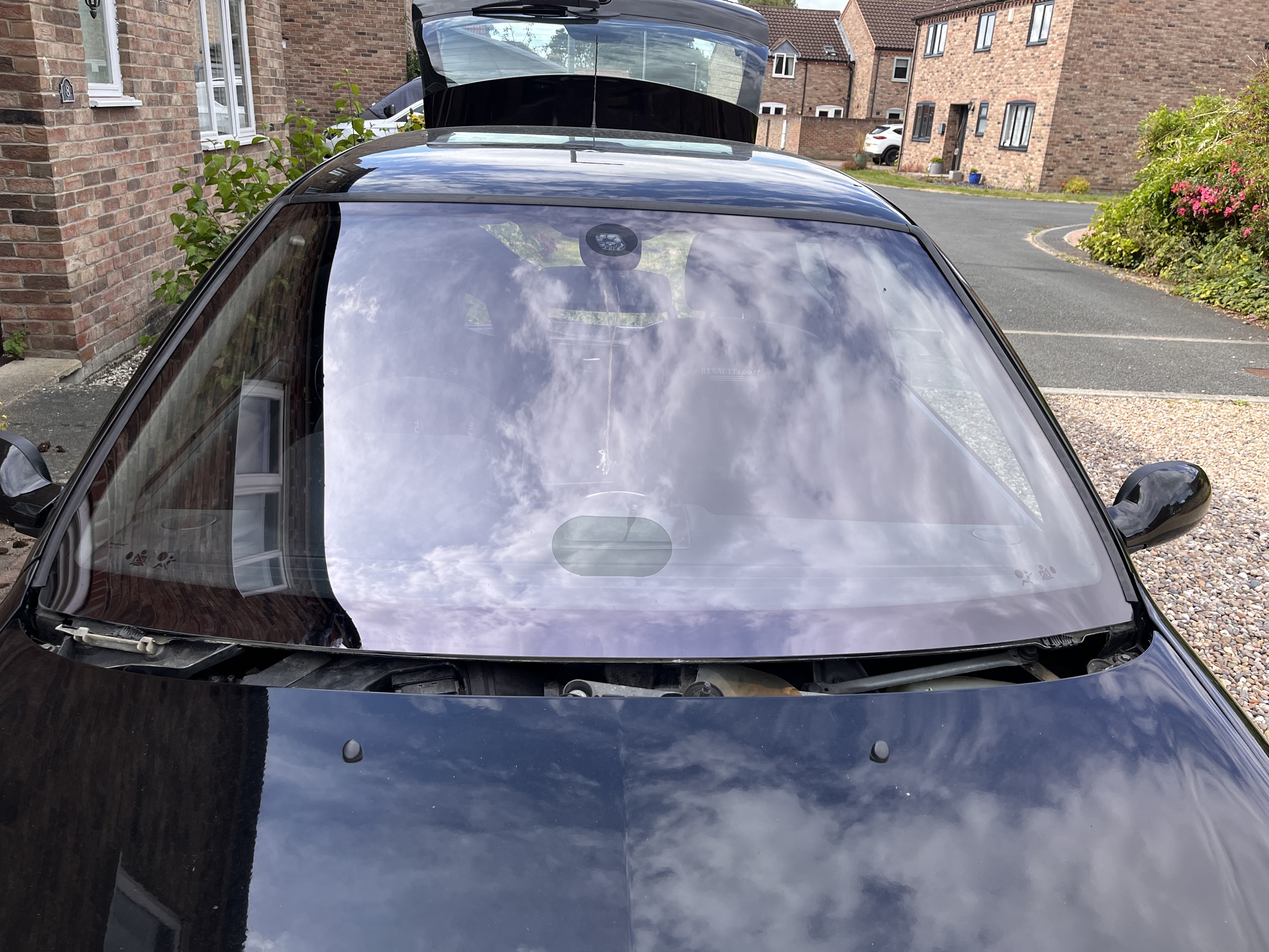

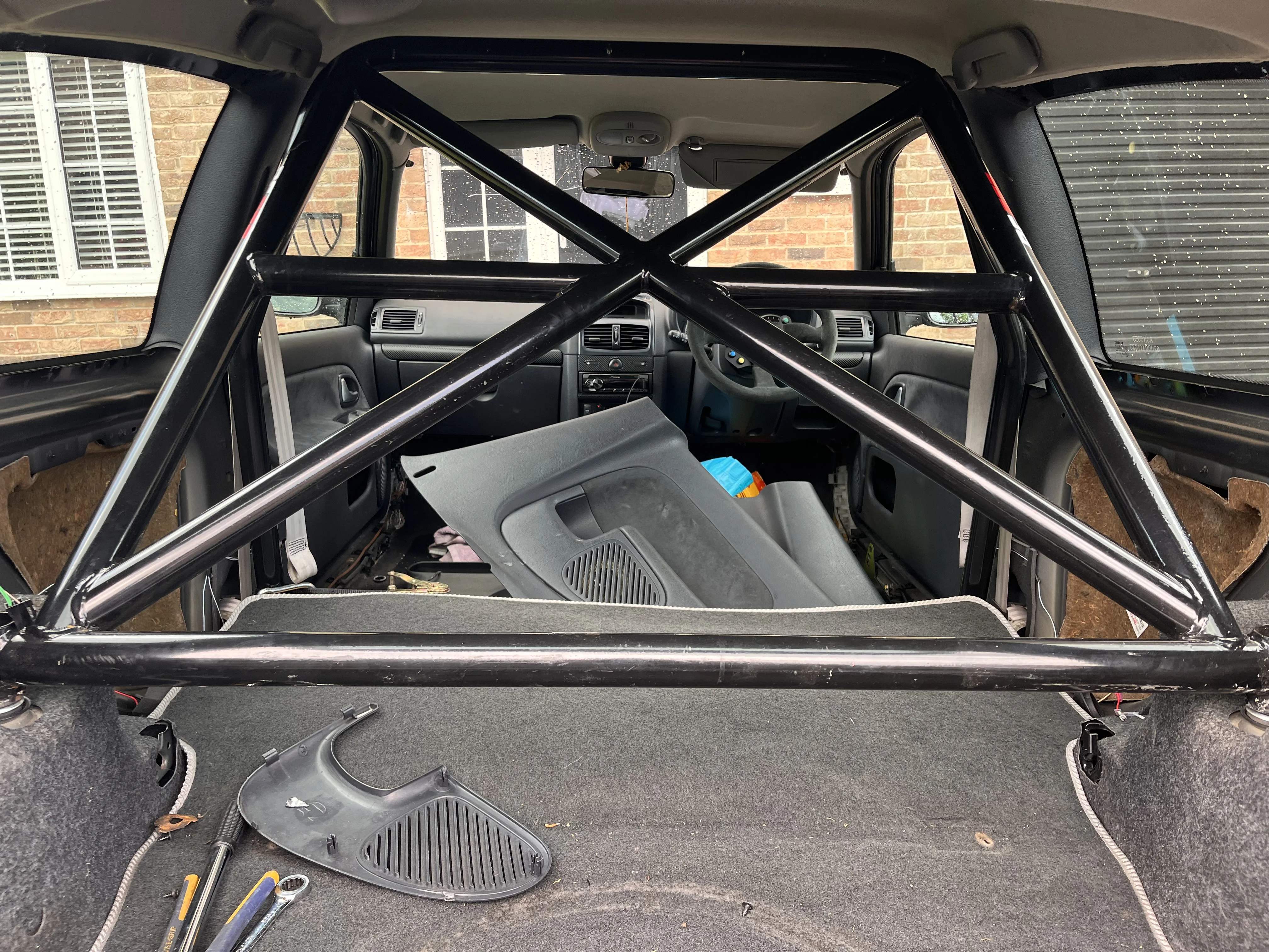

Got my cage and wanted to do a rear fit… why? Because I need the car to get to Luton airport in July and need to still be able to fit my bike box in… I was hopeful…
Cage is great, as recommended by @VenomUK it’s a true bolt in cage, super easy to fit really, took less than an hour to get the whole thing in.
It’ll need to come back out for a little while as the bike box doesn’t quite fit.
Only cost me a windscreen though 🤦‍♂️

Sorry about the windscreen, does it come all in one piece?
Is this one that doesn't require drilling? If so, do you have a link please?
Thanks, yeah it’s true bolt in no drilling at all. It’s all one piece except a bat that goes through the rear footwell to add some more strength but that just bolts in.
