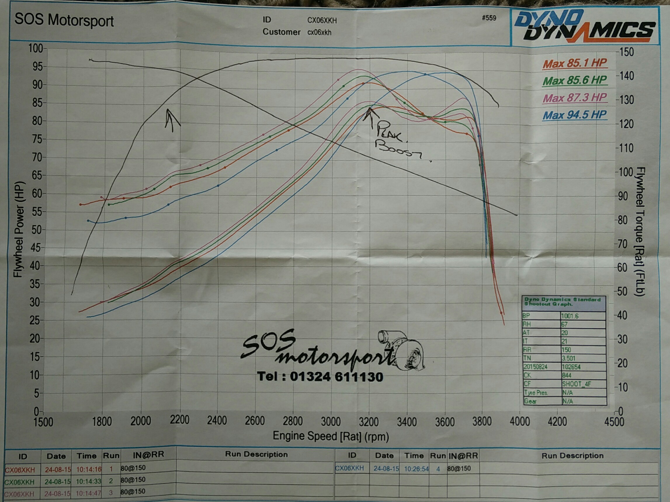

1.9 dci lacking low down torque/power, RR graph included

Basically it has no low down torque at all. It almost drives like a petrol. So far we have tried changing the MAF sensor, checked/cleaned EGR valve and changed the boost solenoid to no avail.
Anyway here's the RR graph
As you can see the curves look nothing like a diesel should. The final blue run was with the boost solenoid disconnected and the two vacuum pipes connected together. Also ignore the lines drawn on to show what a diesel graph should look like.
Does anyone have any ideas what this could be? My only thoughts is that the wastegate actuator isn't set up properly.
R3k1355
Absolute wetter.
It's making shitty boost for a diesel, it's not on full boost till 3.2k - what the f**k is up with that.
Gotta have a big issue with boost/vac somewhere, should be well on song before then.

Smoke test it. Bet there's a vacuum leak.

It was tested to see if it was holding a vacuum when it was getting it's RR runs. Holds a vacuum fine apparently (I wasn't there at the time, but my dad was and it's his van).
And the smoke from it is surprisingly minimal. I thought it seemed short on boost though tbh. Its making 1 bar according to the live data I can get but I can't find any figures on what its supposed to be.

Not that kind of smoke test :smile: you put a machine on the inlet and let it do its thing. Then if there's a leak it'll start pissing smoke out.
May be having a r****d moment here but how would putting something on the inlet reach the vacuum lines? I thought the vacuum setup on a diesel just came from the vac pump?

Try simple things first.
Is the actuator moving freely?
Is the map sensor clogged up?
Egr stuck open?
Silly little things like that could cause it

Actuator moves fine yeah. EGR has also been cleaned out, tried disconnected etc so that's ruled out as well.
Not sure if he's tried a different map sensor in it, but the live data off it doesn't point towards it being dodgy
