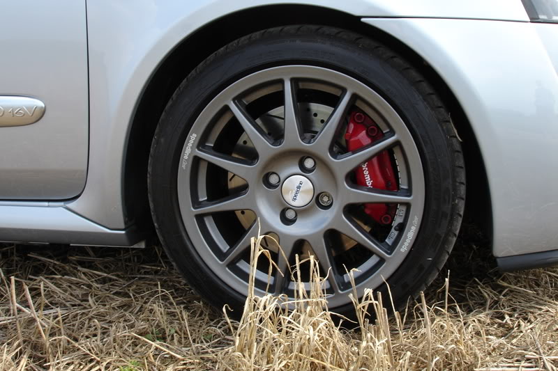

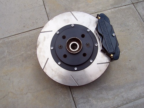

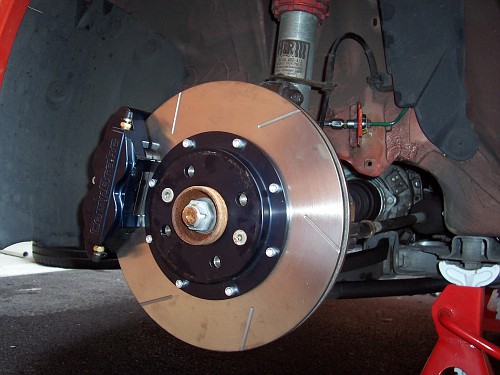

  LY 220 Trophy
Was £950 + Vat and fitting, Have been on the car a long time now so i'm used to them - but i've been told they are alot better..
I think four pots etc are overkill. My standard brakes have enough power to lock the wheels from most speeds - It's more about improving feel and resistance to fade. I've driven a saxo with four pots and the brakes were like an on-off switch lol.
If you doing serious track work get some Brembo HC discs and pagid blues or similar. I think that's the set up the Cup racers use.
Cup racers have a choice of pads they can use.
Personaly for long term use 4 pots although they do cost more are Imo worthwhile.

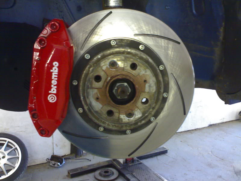

  C63 AMG, F430 & 172
FRONT
Mocal SS lines - £27
Exchange re-furb calipers - £70 per side = (£140)
Bembo max disks - £80
Carbon Loraine Pads - £80
REAR
EBC Groved Disks - £57 + £80 for drivemaster bearings (pair) £10 pressed in
Mintex Extreem Pads -£25
Mocal SS lines - £18
Recon Exchange Calipers £61 per side = £122
FLUID
AP 600 fluid 1ltr £39 + 500ml £23 (full bleed)
TOTAL
£701 all in.. (no fitting as i did it all)
