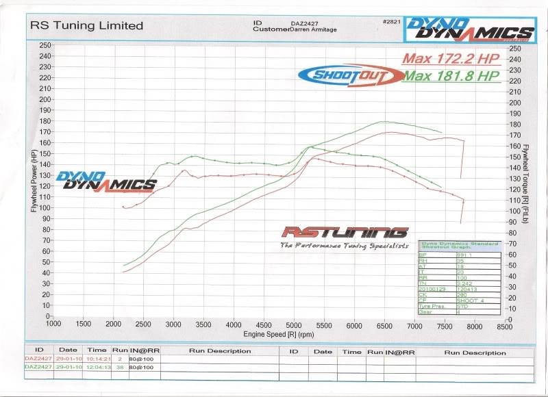

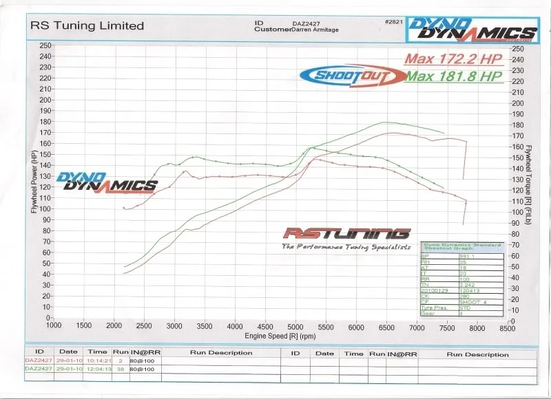

At the fly...

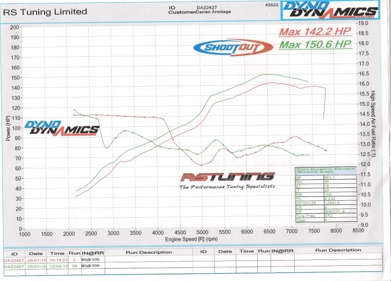

and at the wheels...
Schrick Cams, RS Tuning remap, YozzaSport exhaust and (at the time) an ITG panel filter.
