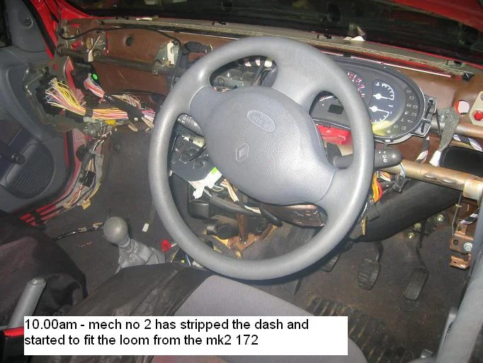

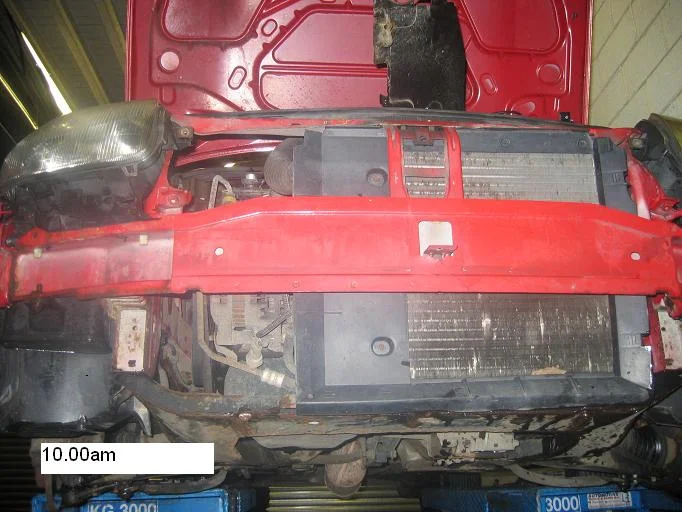

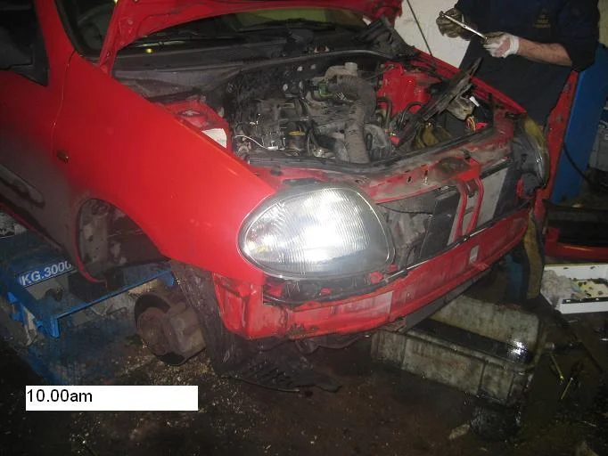

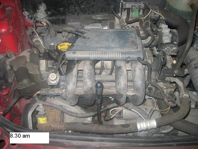

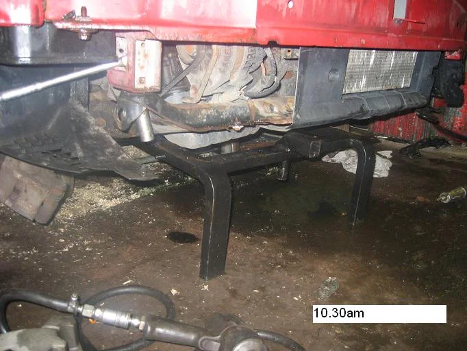

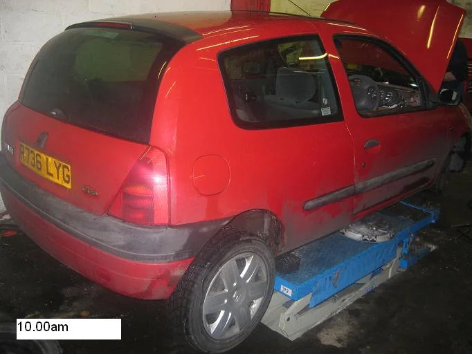

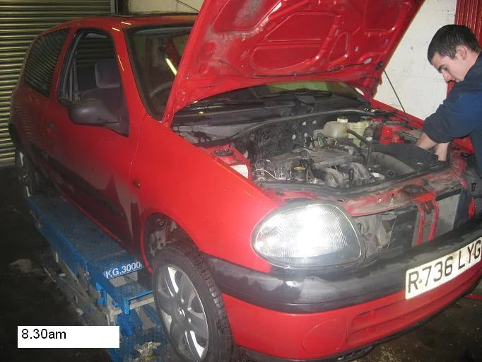

Brought the car in at 9am - stripped the 1.2 diet engine out and dropped in a 2.0 16v 172 engine / loom / box / ecu / susupension / brakes etc etc. Took 8 hrs to do with no problems at all - vehicle is now running and needs minor work to complete conversion ( brakes bleeding etc etc ) Took these pics to show you just how easy it is to do

they share the F4R engine.
Mk1 172 has a cable throttle where as the Mk2 has a crappy fly-by-wire thing.
The engine used here is a mk2 lump FBW - providing you use the ECU and loom and throttle pedal off the donor car its ok
All this work was carried out today - Friday 2 / 12 / 2005

I dont do the conversions no more for the public - trouble is when you do these sort of things you get nobs asking for 12 month warranty's and the service history of the car the engine come out of + lots of more stupid things. So now i just sell the kit for £1500 + vat
Good job!
Will it fit in a valver easily or would it be a mission?! Thinking about it I have never seen one in a valver so I take it it wont.
Yes it will fit in a valver - Forgot to mention this engine has had head work / cams / hillpower inlet manifold / R-sport ECU + other various bits n bobs
