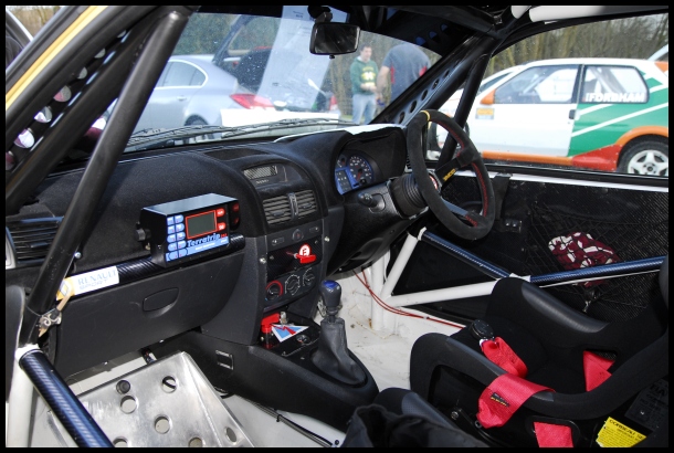

The car started off as a light damaged road car. Car was stripped of all interior parts and then seam welded. A custom cages T45 cage (50 individual pieces!) was permanently welded into the car which took over 40 man hours to fit.
Interior was then painted Diamond white including under bonnet and wheel arches
Engine was completely rebuilt to Group N regs, with new rings, shells bearings etc. ECU is renault sport remapped unit with higher rev limit.
Gearbox is standard ratios with gripper diff and different crown wheel and pinion for increased acceleration. Brakes are standard with Group N discs and Mintex pads. Suspension is AST one way adjustables with different springs for gravel and tarmac.
edit_preview.php
Interior wise there is a Flocked dash with sparco suede steering wheel. Fuel and brake lines are ran inside the car using Goodridge braided hoses and fittings. Corbeau pro series bucket seats are fitted along with and Saebelt 6 point harnesses.
