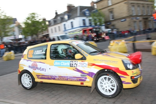

East Boldon rally driver Simon Moore overcame driveshaft failure with his Renault Clio Cup on Jim Clark Challenge Rally to claim 15th overall and ninth in class.
Moore and co-driver Emma Morrison made a great start to their event taking third place on the opening stage which took place around the spectator-packed streets of Duns in Scotland.
Disaster was to strike on the second stage though, the Clio suffered a broken driveshaft four miles into the 15 mile stage. With the rally taking place over two days and the cars being allowed to be fixed overnight a determined Moore and his service crew did not give up hope of being out on day two and several hours of hard work saw the car finally fixed at 2am.
