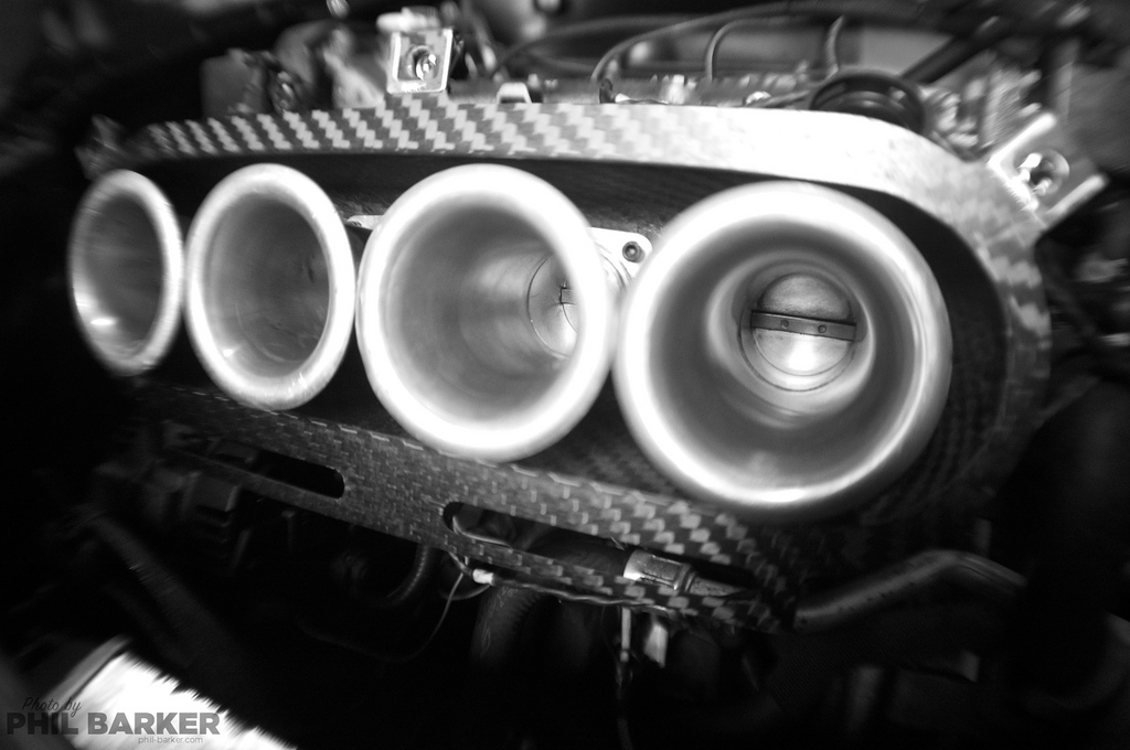

I've been playing around with a semi-fisheye on my X100 today and snapped a quick shot I really like
Thwarrp by Phil_Barker, on Flickr
  Trafic 140dci
Nice picture, looks well smart :) I got a Mini SLR, Panasonic Lumix i think, off my parents for my 21st birthday, haven't a clue how to use it to it's full potential, would love to be able to get pictures like that :(

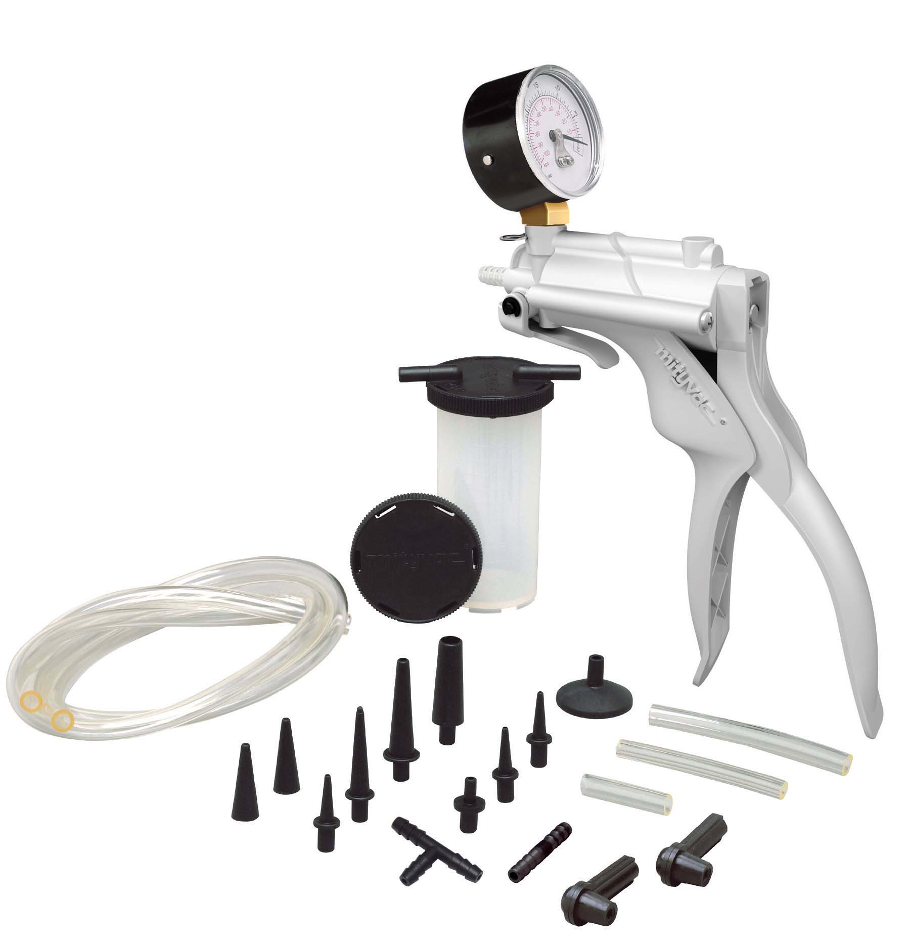

Mityvac MV8000
Got it for £48 I think off eBay
I used to use those that you connect to the bottle and a spare tyre - but had 2 and they kept blowing seals or cracking
Also when you're doing a full flush of the system it's a pain in the ass having to keep disconnecting it to put more fluid in and then re-pressurising etc...
Borrowed one of these off a mate years ago and it was awesome for bleeding brakes
Using this do you connect to bleed nipple and pump until the clear tank is full or you've pulled enough through?
You pump it up to get a vacuum - then undo the bleed nipple and let the fluid run through until there are no more bubbles
Exactly the same as pumping the brakes or using a pressure bleeder - except it pulls the fluid using a vacuum rather than pushing it using pressure

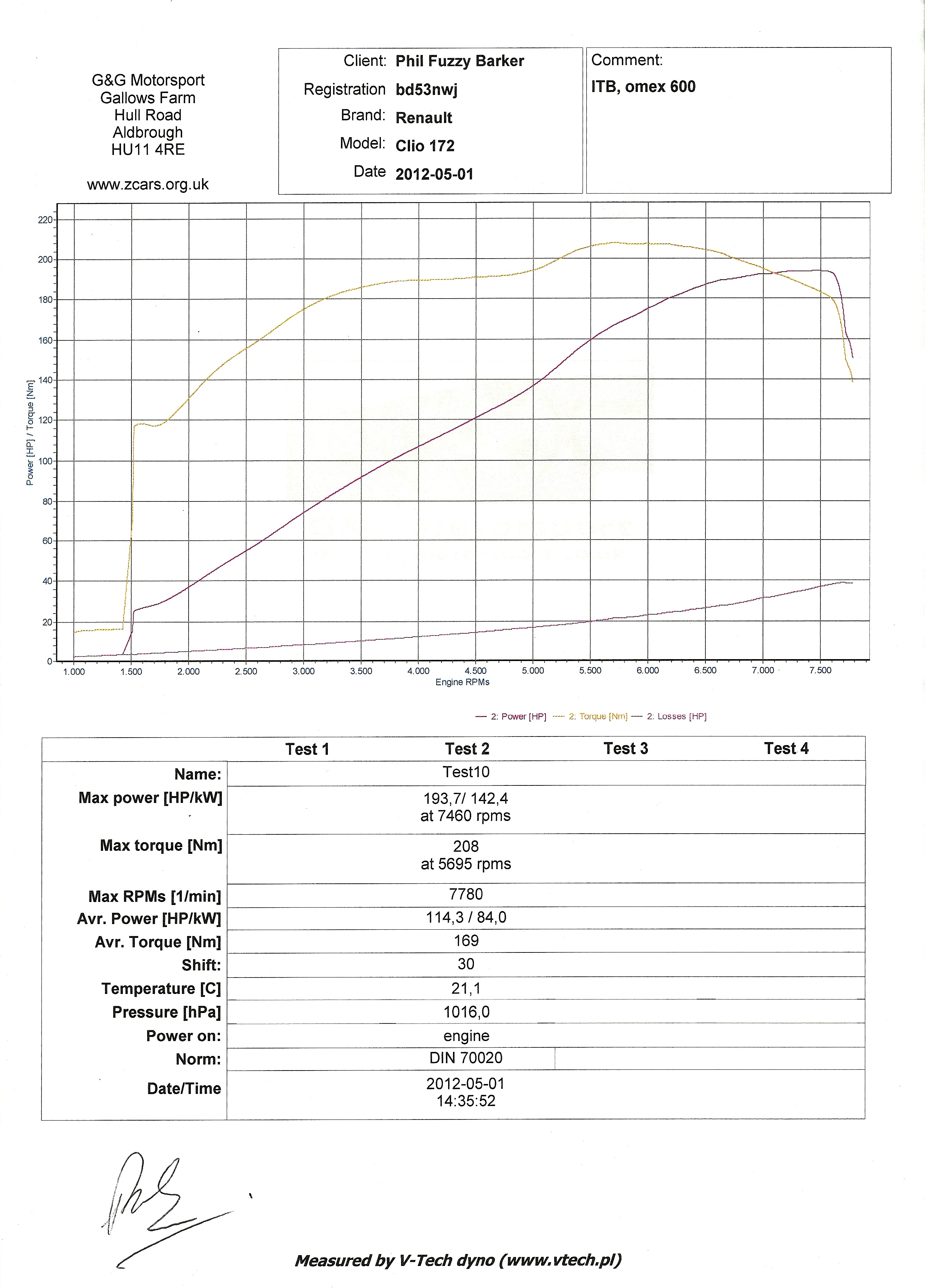

Mapping done :D
The end result was 194bhp and 154lb/ft torque - that was with a red hot engine as we'd been mapping all afternoon
It made the same power on it's first run after tweaking the map when it was cold - so we reckon if we let it cool down and ran it - it'd be around 200bhp
I didn't really have time to let it cool down just to do a power run though as moving house on wednesday morning and i've still not boxed everything up EEK
We went for a play and then drove it home - mind is blown how much better it is
Pulls like a steam train from 2000rpm, smooth as silk - you can cruise through 30 villages in 4th now - it's so well behaved
And then you hit the loud pedal and everything goes backwards haha
LOVE the torque curve :D
I think I might at some point fit ARP rod bolts and raise the limiter because it also makes peak power near enough on the limit

Seems very reasonable figures :) Peak power is a bit later than I'd expect without cams, but the rpm sync could be out by a couple of hundred I guess (unimportant)
