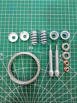

Nice one! I did have the official Renault fitting kit in basket as read some threads suggesting third party ones could be a bit iffy? This one do the job? Tbh I only need the springs, gasket and end pieces as I’ll replace the other bits with stainless as suggested by mrbillyuk.

[mention]MRBILLYUK [/mention] - just checking, will the cups that come with the standard kit fit the stainless M8 bolt from the kit you posted up or will they need drilling? If so what size drill bit would be required? Cheers

The standard cups will definitely need drilling to make the holes a bit bigger. I'm not sure off the top of my head what size.
If you have any small engineering firm locally it might be worth asking if they could make you a couple out of stainless.
I'm sure they wouldn't charge you much.

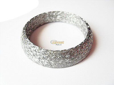

Don't recommend the 65mm one as the pipe diameter measured 65.75mm when I measured. 66mm is the safer bet. @Andyl20
I’ve gone for the kit you referenced:
Assuming the gasket from the is the right size.
I will (attempt) to retrofit the better stainless nuts, bolts and washers along with opening up the standard cups with a drill (will practise on my old ones first!).
So plan is to use the gasket and springs from the kit, modify the cups and replace everything else for stainless items.

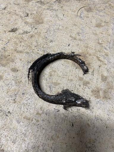

I got it’s on both sides off tonight which was a good start but now having an issue getting the existing fibre gasket off. It’s really wedges onto the down pipe from the manifold. Starting pulling at it with pliers and it’s slowly breaking down, but had to abandon works tonight to go have dinner [emoji4] another observation I made though was that there isn’t much wiggle room between the cat and the down pipe, so not sure how tricky it will be fitting the new gasket. Would I need to unbolt the cat from the midpipe in the worst case? How have others got on with this bit? Am I missing a trick? Cheers all.

Can't help with the fibre washer other than just keep chipping away at it, I never had that issue, maybe a drip of wd40 might help free it.
The entire exhaust is hung on rubber so there should be plenty of movement to get the new dohnut in, but if you really do struggle then the cat to centre section joint is only 2 bolts, easy enough to undoo.

Got the old cr4p off after a lot of messing about and swearing. Had to unbolt the cat from the midpipe to get the gasket back on then fitted the new kit. Blow is completely gone so fixed a treat. Didn’t get after photos as I forgot. Not nearly as fiddly as the steering rack bushes but still not fun [emoji4] now onto more (hopefully) more enjoyable tasks of stripping the interior to further ready for a maiden track day outing if we ever get back to normality! Thanks again to all for the advice with this one[emoji1303]

Perhaps I was doing something wrong but trying to fit my decat and new fitting kit I found I couldn’t get the pipe on enough over the fire ring. Once the bolt was through with gasket / spring it was at the end of the bolt. There was no way I was getting any compression to then fit the washer / end cap & nut.
If I’m missing a trick here the. Please someone advise me??
