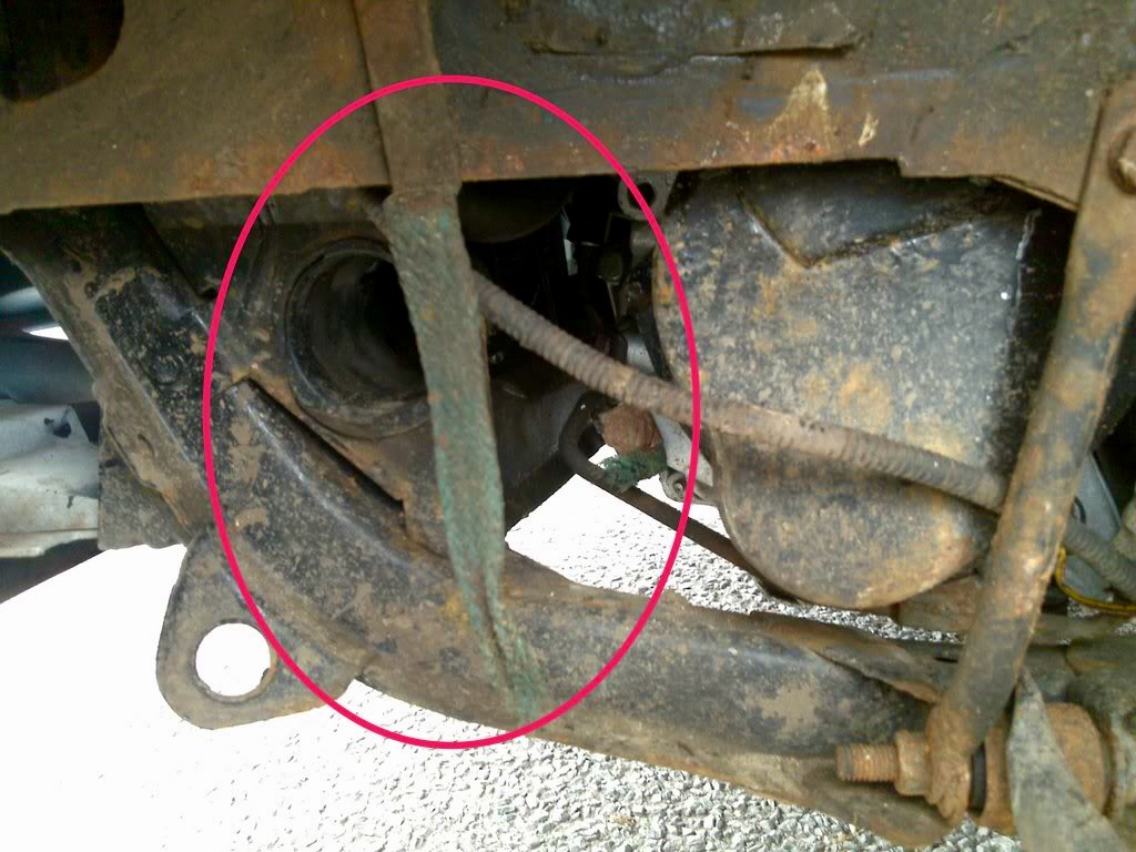

Ive removed gearbox from my track 182 had a rebuild and gripper diff fitted.put it all.back together and it wont fire.turns for 2/3 seconds than stops.solid red light when cranking.tryed holding button on key and turning,sinking the centrel lockong button,lockong unlocking etc to no avil.car has locks removed as fibre glass doirs,bonnet and tailgate etc.my ethos wont read the engine through odb.do i require a clip? im in berkshire juntion 12 m4.i. ready to burn the thing lol
The immobiliser red light on the dash needs to go out after 3 seconds for the car to start. Check the earth strap which I guess you removed when you took the box off.
