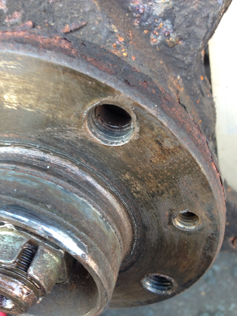

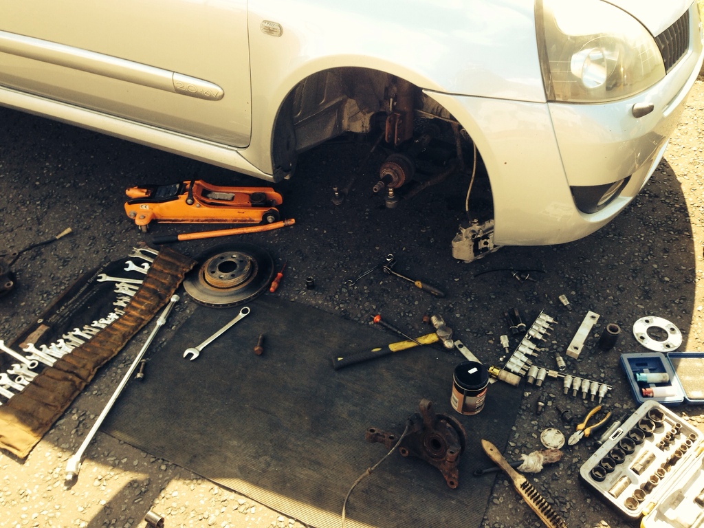

First off is my driverside hub has stripped threads out two of the holes, bu sorted that yesterday
Second of is when I'm doing 70+ and let off the throttle there's a loud grinding sort of noise coming from front right and the steering wheel vibrates quite abit not clue what's causing it

Loose wheel nuts? Mine came loose and it was as you described. Sounds stupid but took me ages to work it out as I was miles from home with no tools.
It could be because of the extra torque you are applying on a more regular basis or increased braking torque. Most cars with the sort of power a turbo clio has will have larger PCD's and 5 wheel bolts per wheel.

There's no extra torque as the boost isn't connected at the moment
Nah every conversion sticks with 4x100 so I must have another issue somewhere

Sounds like a driveshaft issue. Are they original or have they been changed? Have you checked the wheel bearing as well?
Number of wheel bolts is to do with the wheel size not the torque going through the wheel. Look at an escort cosworth, delta integrale, etc that all used 15" wheels from the 80's. They all used 4 stud patterns.
I thought it was drive shaft too
Standard 172's one mate...plus had new hub yesterday due to threads been stripped

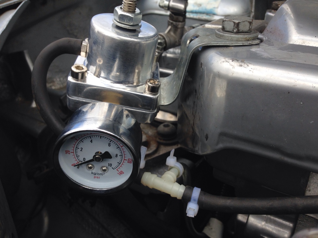

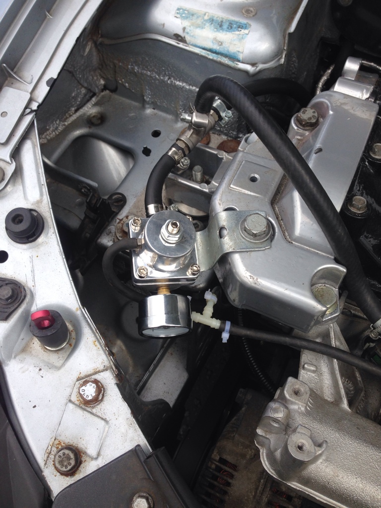

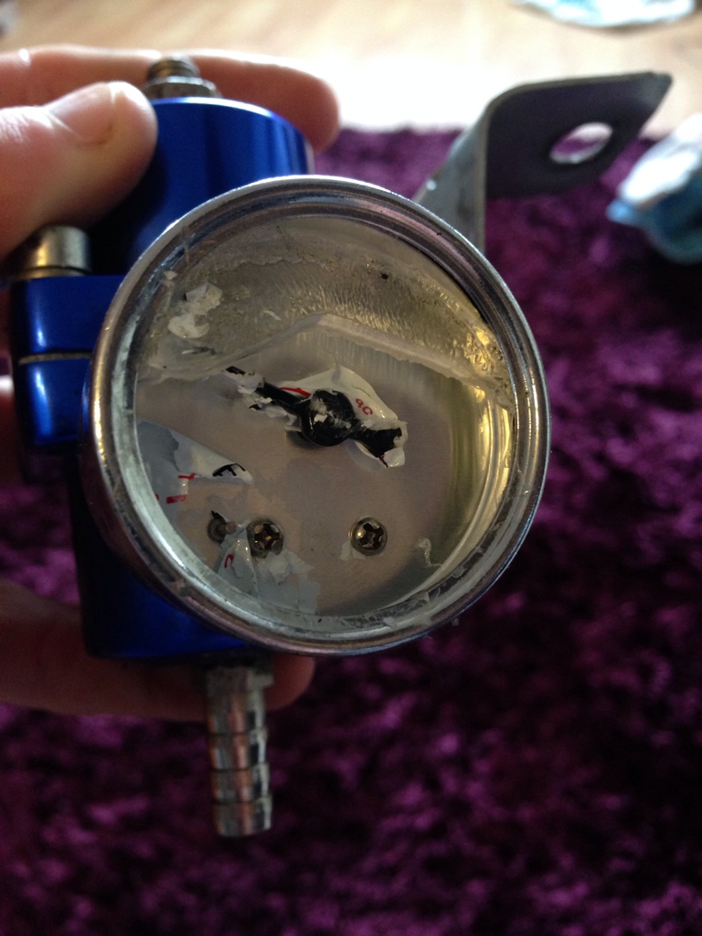

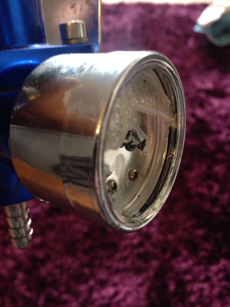

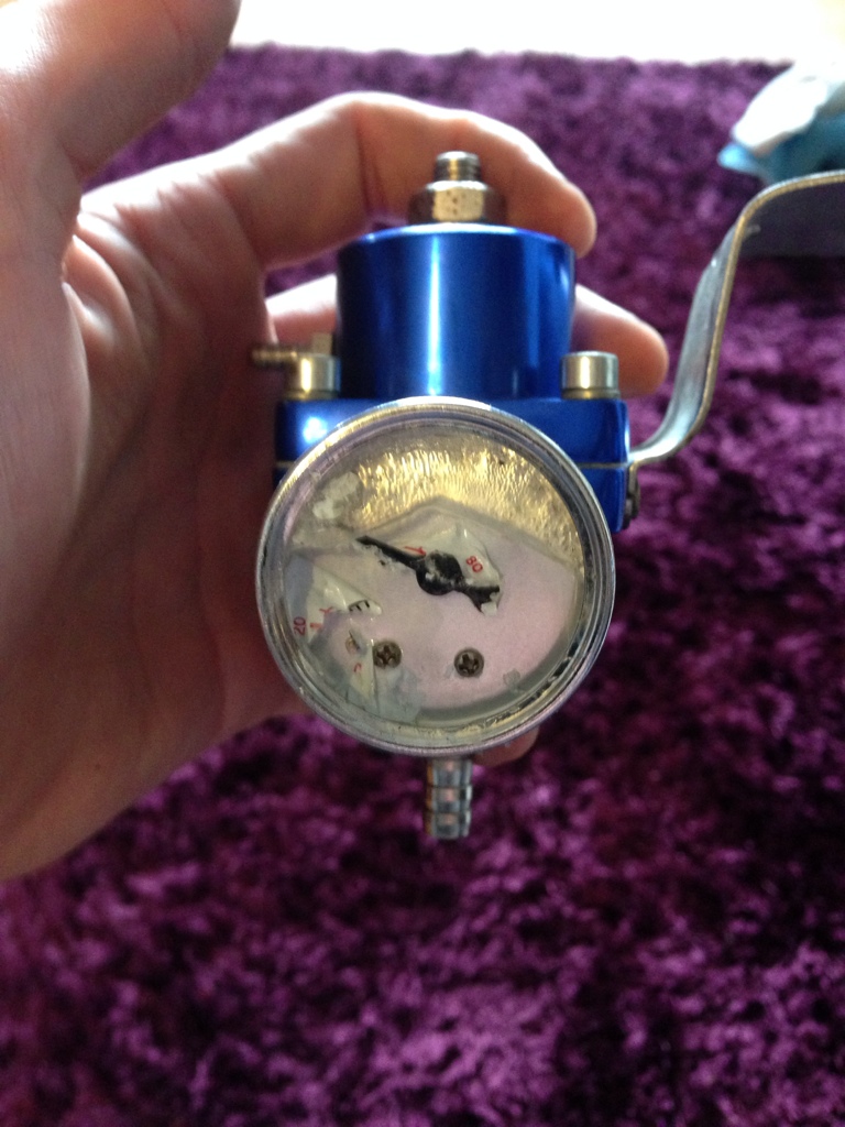

Well had another issue yesterday while picking up my new 630cc injectors
Fuel leak from fpr
Save to say I was very annoyed but got a new one day and fitted just to set it to 3 bar after speaking to scoff
Then off for mapping tomorrow morning
