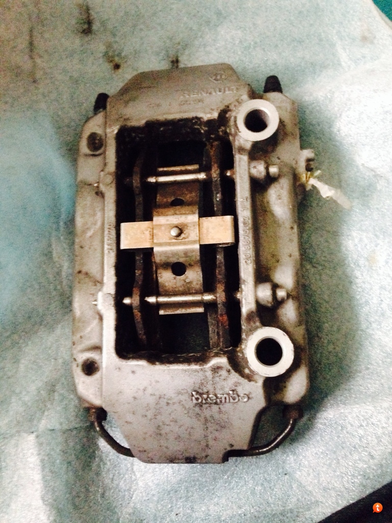

Brackets to fit brembo brake calipers from www.spead.co.uk
300mm scenic discs HC brembos
Mintex 1144 pads
Brembo rear pads
Ate super blue brake fluid
R26 injectors as been let down on 630's

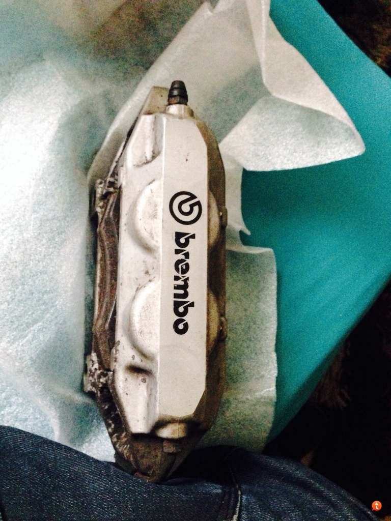

Also picking my brembo calipers up on Wednesday so hopefully that'll keep my busy until I get the turbo back

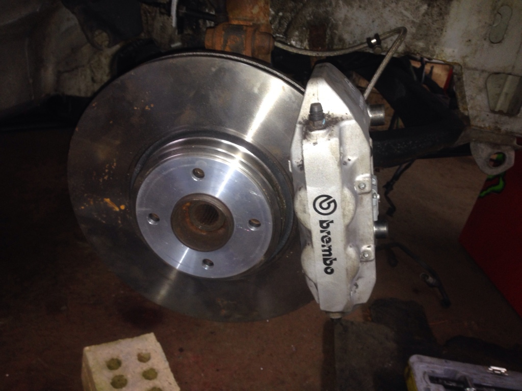

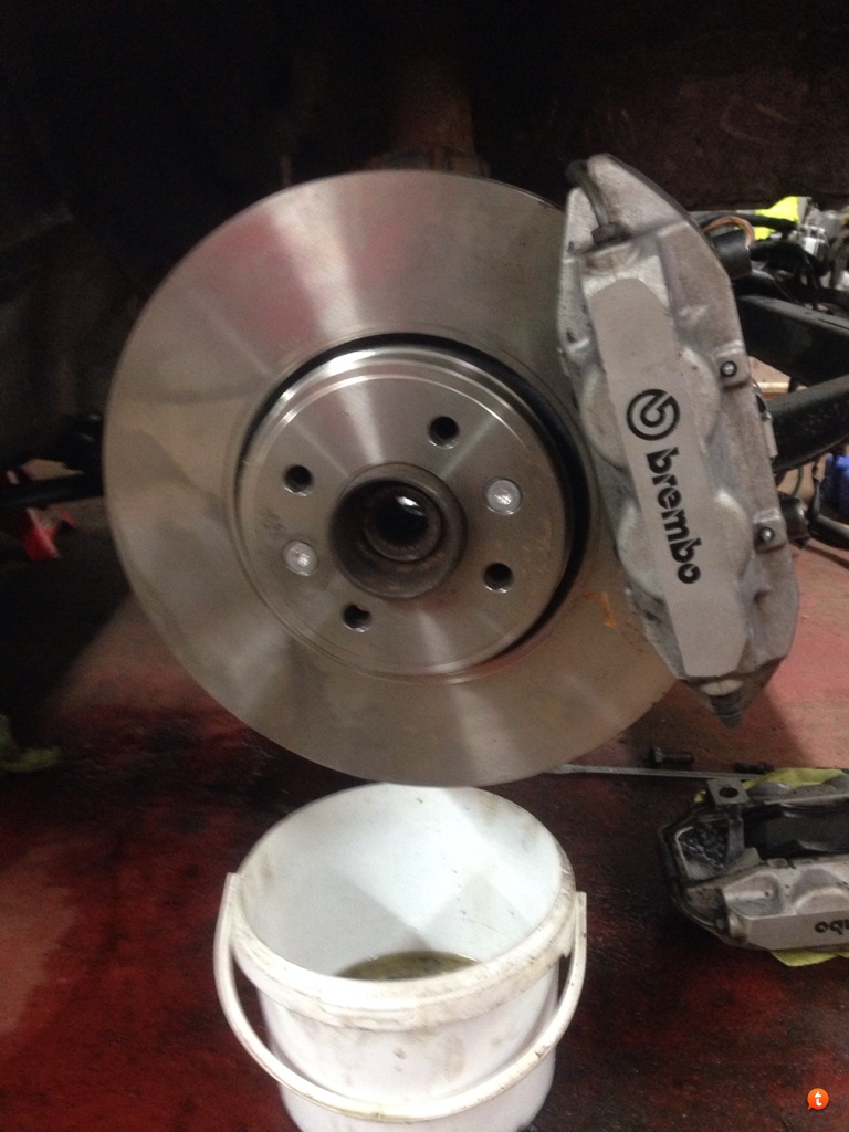

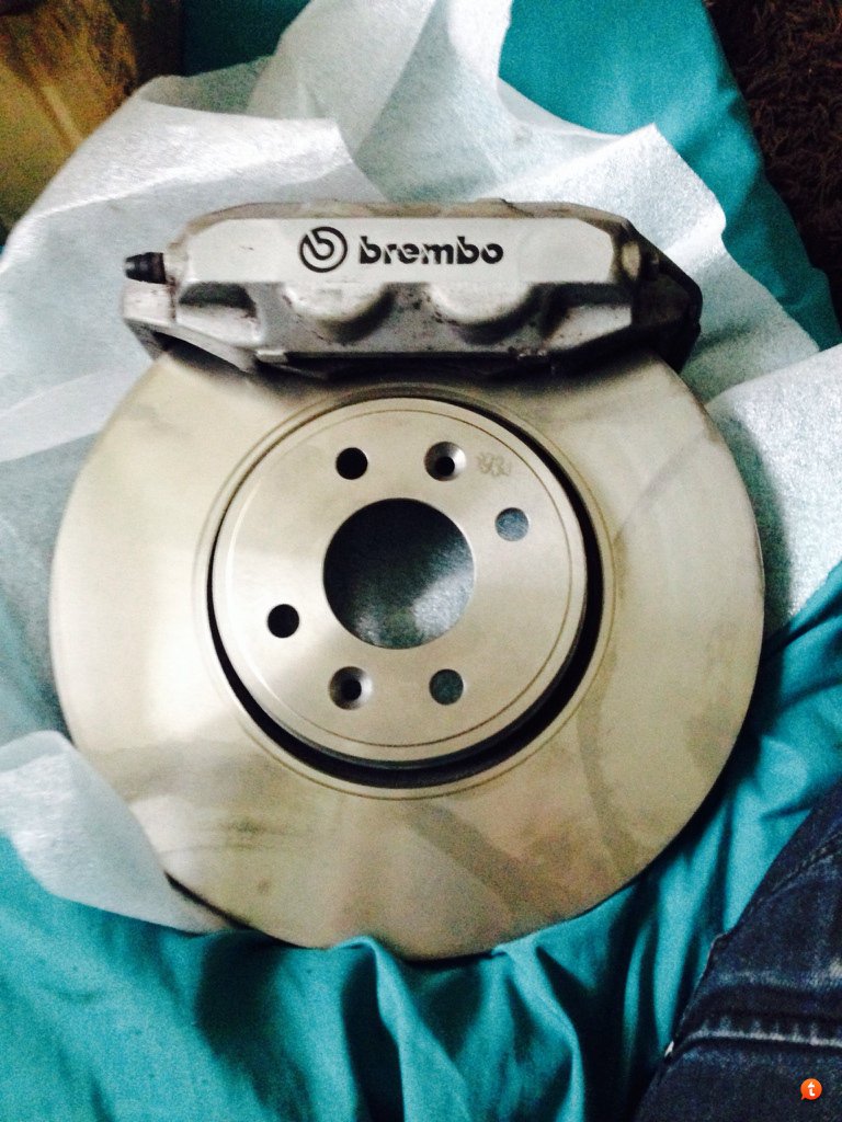

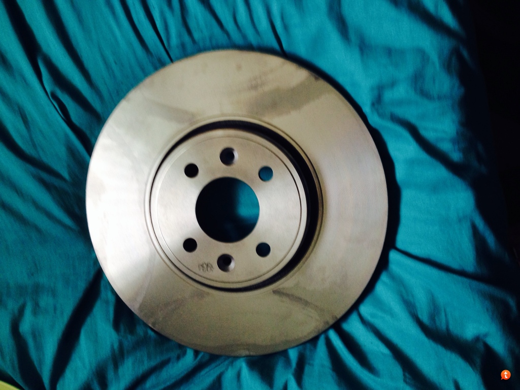

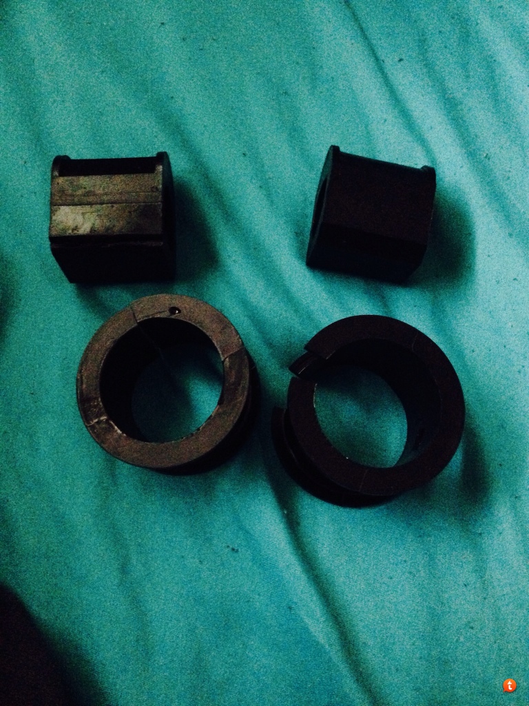

Finally got some work done tonight since the ph1 it's behaving for now..... Inner and outer arb bushes changed to powerflex ones steering rack bushes changed and brakes build up all and all a productive evening even if I drop a socket into the subframe

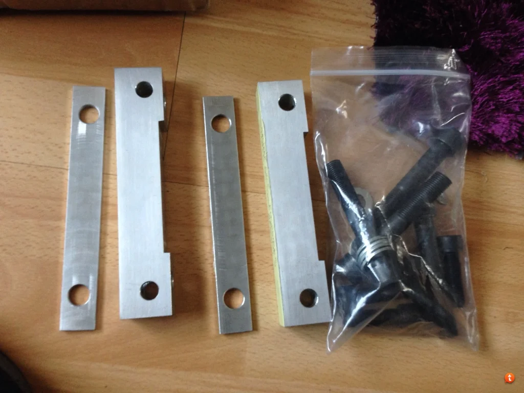

I assume your brackets have shims because the callipers have been machined to fit 280mm discs?
Where did you get them from? I am seriously considering going up to 300mm too.
Mines haven't been machined mate
The brackets came like that with the shim, SPEAD get the main bracket made for the 280mm conversion then give you the 5mm shim
Got them off jack Kemps dads company SPEAD.co.uk
Magic - I had a suspicion they would be from jack!
Cheers mate :D

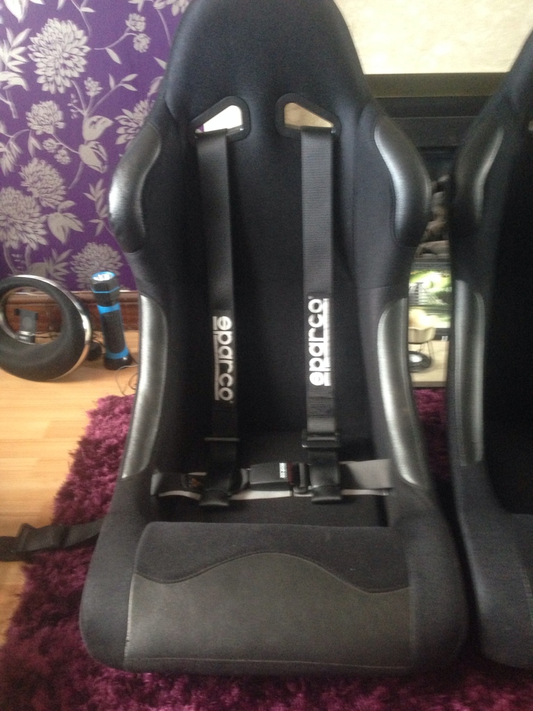

Also been and picked these up today there nothin special but it's a start for track and at £100 couldn't really say no
Picking mounts up next week and I'll get a second harness from somewhere

I was looking at your brakes a couple of nights ago when I was up the unit with Stu, I wish you had the smaller disc set up so I could of tried some of my 15's over them.
What was the problem with the hybrid ? Ive only ever used TT and CR turbos and been a week at the most even for a custom hybrid.
Yeah I didn't want the hassle of having the calipers machined

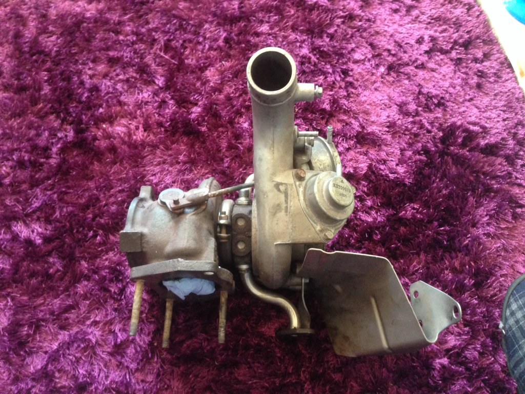

Well finally it has appeared pity it's only the standard one tho
Just waiting on the return fitting which Andy forgot to put in the box the I can start to rebuild the car

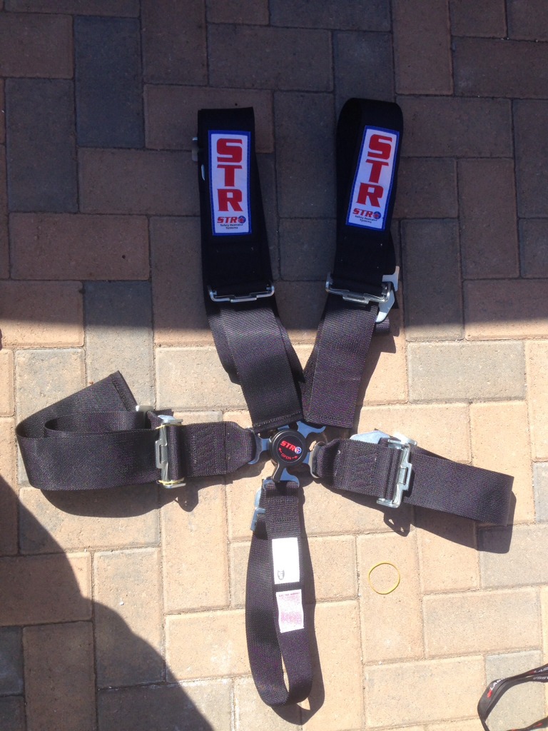

Also could wait to find another harness soon when and bought myself 2 brand new 5 points
Well had a change of heart today while phoning for prices getting turbo hybrid
I ordered a megane 250 turbo oops shall have it tomorrow

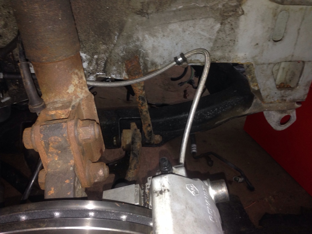

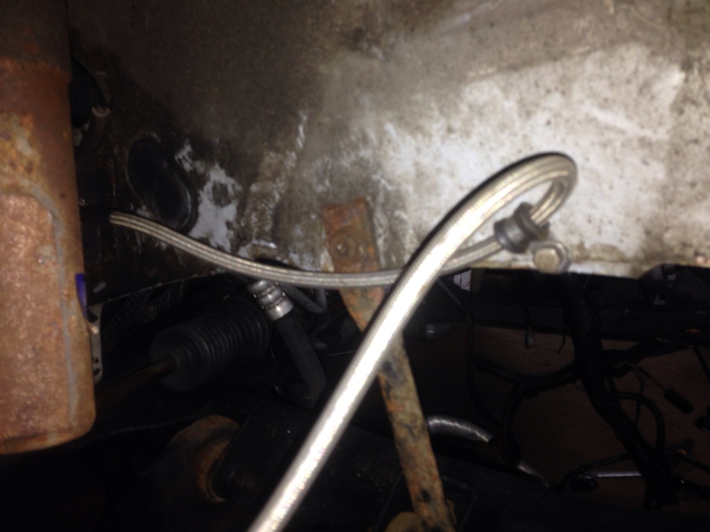

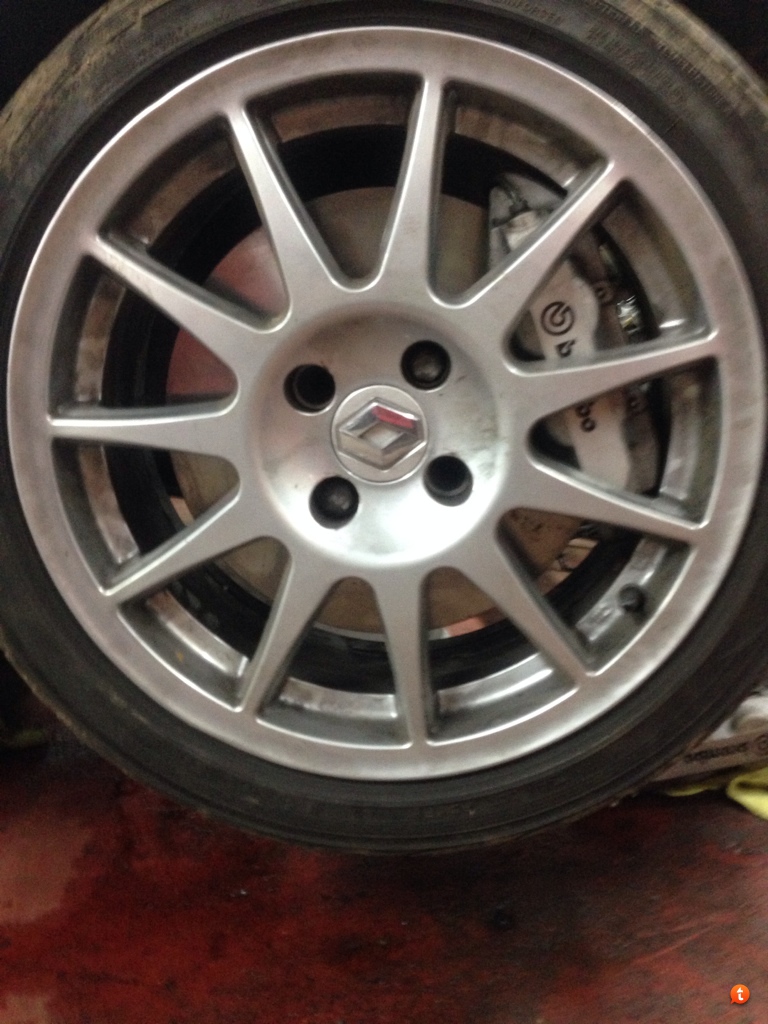

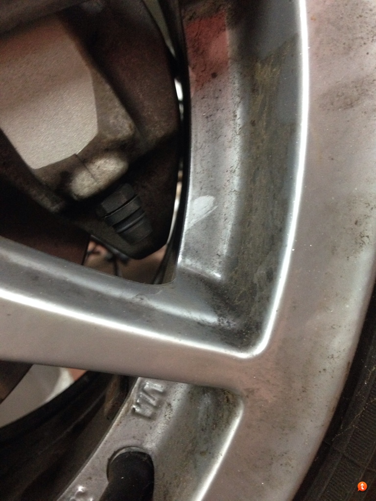

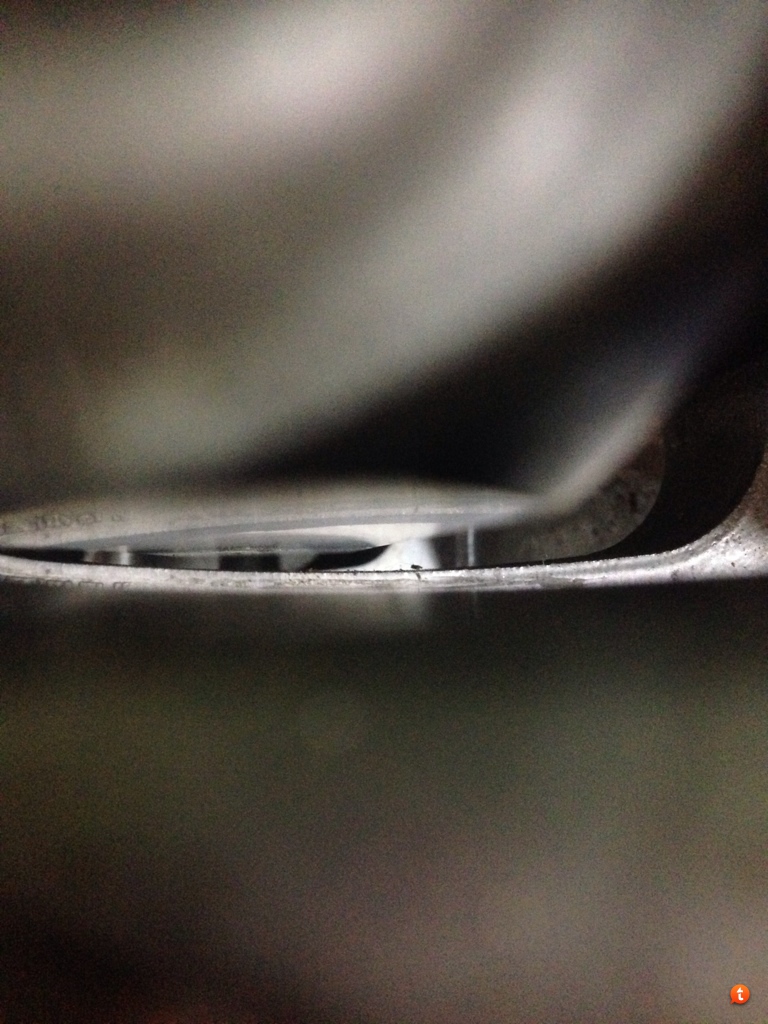

Also fitted 197 HEL brake lines to my brembo calipers along with 5 mm spacers which has helped my clearance issue
  172 cup, Impreza P1
Good choice on the turbo. Is it a straight fit? Did you speak to Braveheart Developments about a hybrid?
Is there enough length on the brake lines when on full lock?
