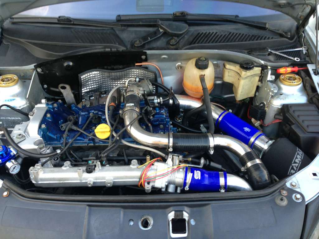

Also got my front bumper back on tonight after having to cut my intercooler spacers down as the was a inch or so gap between intercooler and slam panel
Also ecu mounted and and the rest of the wiring done

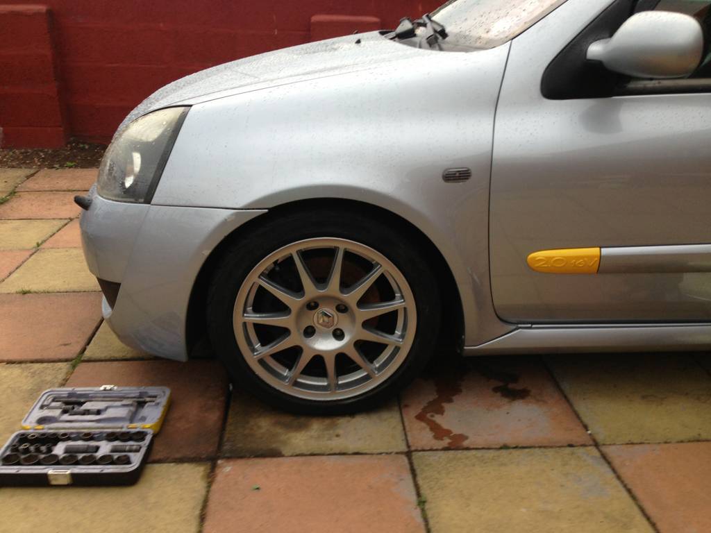

Well after a week of trying to source a brake line and 6 attempts that failed finally got it done slight issue tho when pumping the pedal doesn't go hard anyone any ideas?
But either way its going to Efi Monday morning if new be ill get them to fix it

Nice intake!
Sounds like there is still air in the system. Keep bleeding it would be my suggestion.

Yeah Dave Joyce said the same so going to buy a some tomorrow at the garage after work if not will have to get Efi to do it as I'm working all weekend

I think you need need to bleed the brakes through again and somebody with Clip to bleed the ABS pump through.. That should sort the soft pedal.

Well Scoff been on the Phone today,
cars been giving him hassle its had a couple of fuel leaks due to that braided line being a tad to big, then the car decided to spill 4 litre of oil of his work shop floor
then the throttle cable has been laying on the exhaust and melt when he goes for a high pass
Save to say im a tad annoyed with myself
  172 cup, Impreza P1
Well Scoff been on the Phone today, cars been giving him hassle its had a couple of fuel leaks due to that braided line being a tad to big, then the car decided to spill 4 litre of oil of his work shop floor then the throttle cable has been laying on the exhaust and melt when he goes for a high pass Save to say im a tad annoyed with myself
Where is it leaking oil from??
What oil breather setup did you go with?
