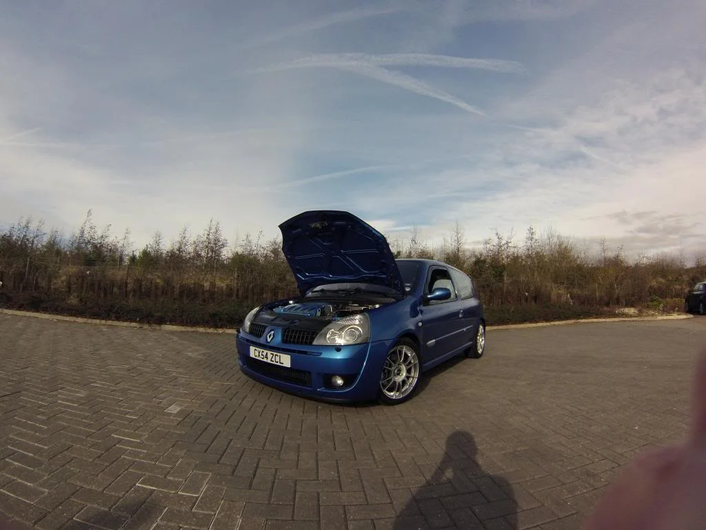

Just thought id put a couple of pics of my recently aquired 172 cup. Its done 82k with full history plus the belts were done 3k ago :)
Its got a ktec induction and apex springs I think? (yellow)
Not much plans at the min as ive got an mr-2 I drive too but I will probably get some AD08's and CL/DS2500 pads in it when I get the time

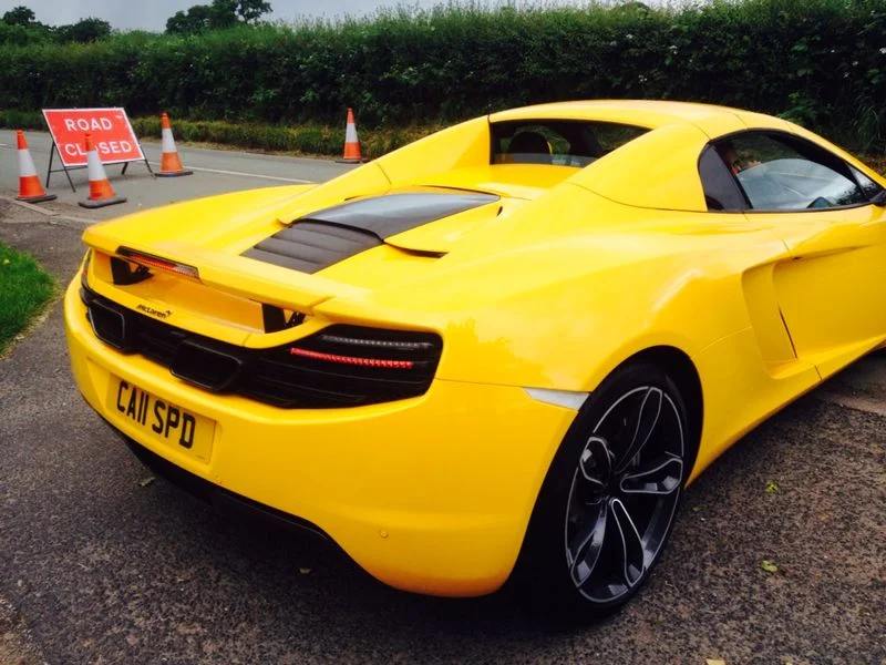

And a pic of a guy in a Mclaren who thought he could enter my road closure lol

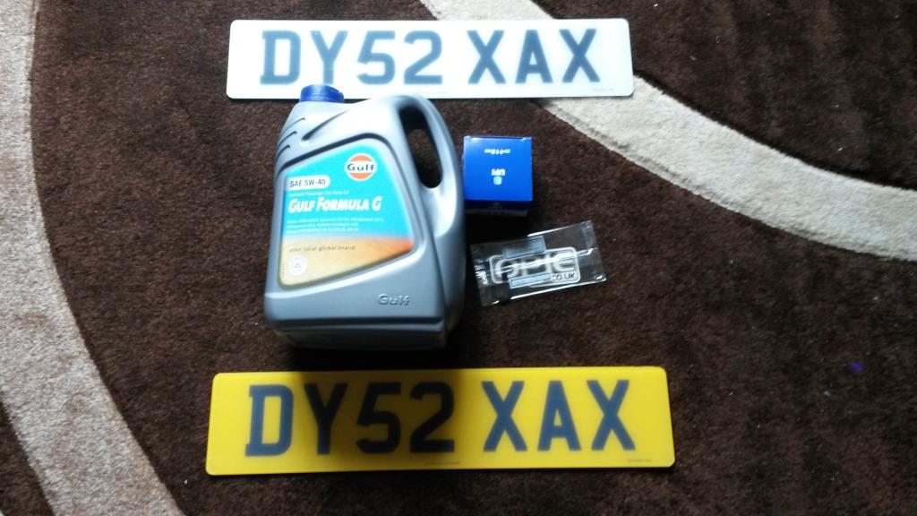

little update since last time i was on, nothing much happening yet as ive been really busy at work, got some new plates, engine and gearbox oil and some new plugs from G172... also bought an omp subframe to fit a bride bucket to the drivers side, will get pics when i finally get round to fitting.

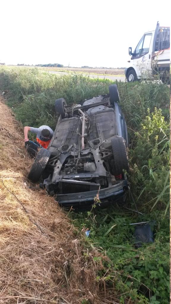

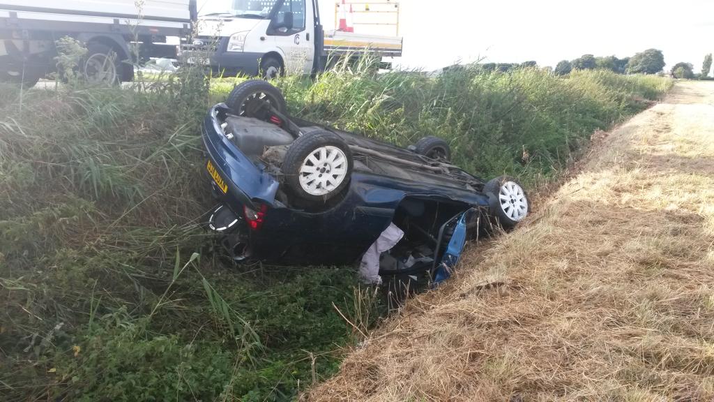

Also saw this on barrier bank between peterborough and spalding, the road that runs along side the a16
Clio 1.5 DCI
God knows how it happened as the road there is as straight as an arrow for a good mile, looked really bad though, blood on the roof lining etc.

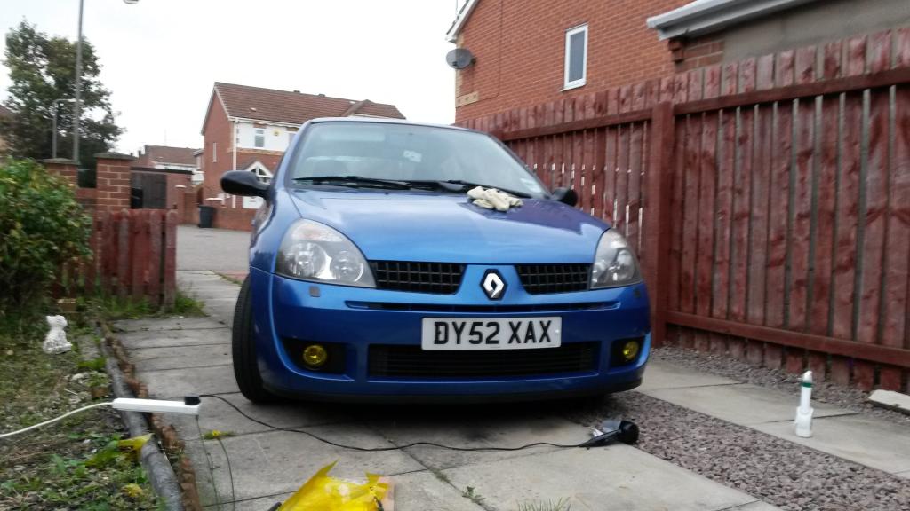

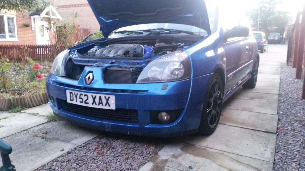

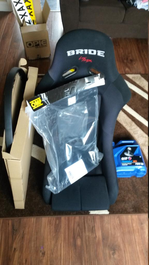

Finally got a bit of spare time today to get gearbox oil changed and fitted a skoda splitter... also bought a meguiers headlight restore kit and took off the front upper grille, wing mirror covers and trim off the rear bumper to spray gloss black.
pic of one headlight restored, its not perfect but alot better, will go over it again tomorrow and do the other
still got the seat to fit when i get chance, going to use the original seat belt so need to figure out a safe place to bolt the buckle

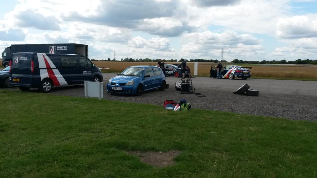

Went to an autocar private test day at Blyton Park last month, was good to watch them comparing a new KTM 450SX? and an old Datsun 240z rally car, only got 1 pic on the day due to my phone running out pretty much 5 mins after we got there

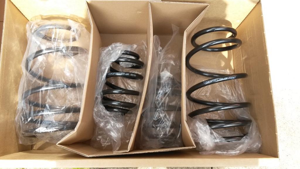

Ordered some Cooksport springs last week and fitted them on wed, really fast delivery from them and the quality seems good, abit higher ride height than my previous apex but they haven't settled yet, the ride is slightly better on poor quality roads and this was the main reason why I got them as the apex made the car bounce too much on country lanes, I will give them a proper test tomorrow night on the snake pass..

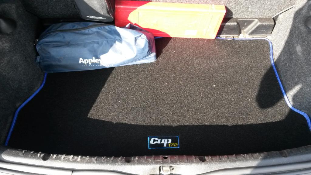

Also got some 172 cup mats from ebay, not genuine but look well, also got the boot mat too :)

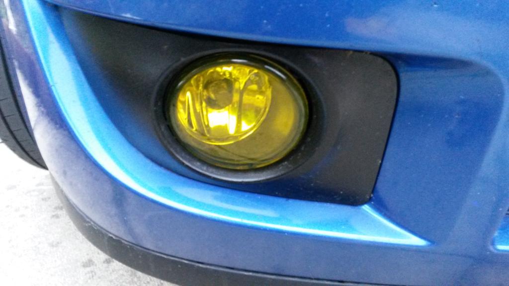

and today I yellow tinted the front fogs

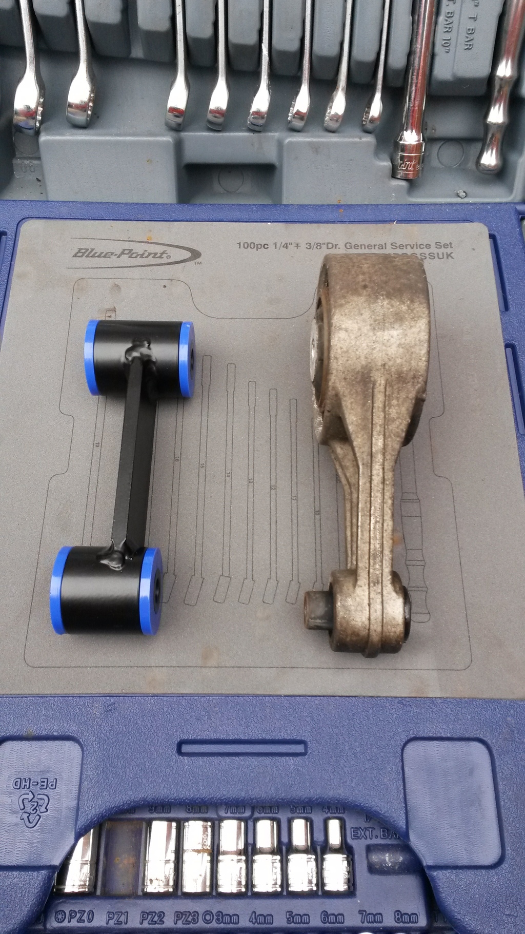

Firstly I fitted an Evol Engineering gearbox mount to try and prevent the manifold banging on the firewall when changing gear at higher revs, bought a second hand offset mount made for the ph2 cars but it didn't fit the cup. For some reason i had to buy a ph1 mount, unsure whether its had the gearbox changed at some point or Renault were using up leftovers from the ph1 cars...

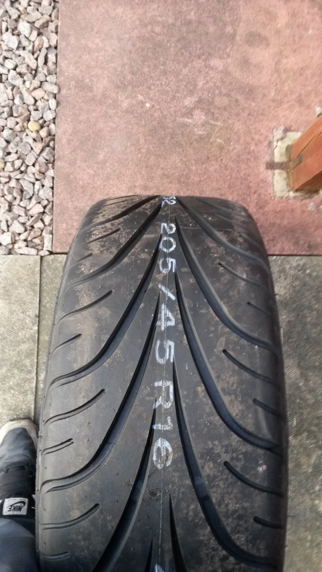

Bought a set of Federal 595 RS-R's in 205 45/16, went for the slightly wider size than the normal 195 as it will provide better grip and help protect the rim of the turinis better..

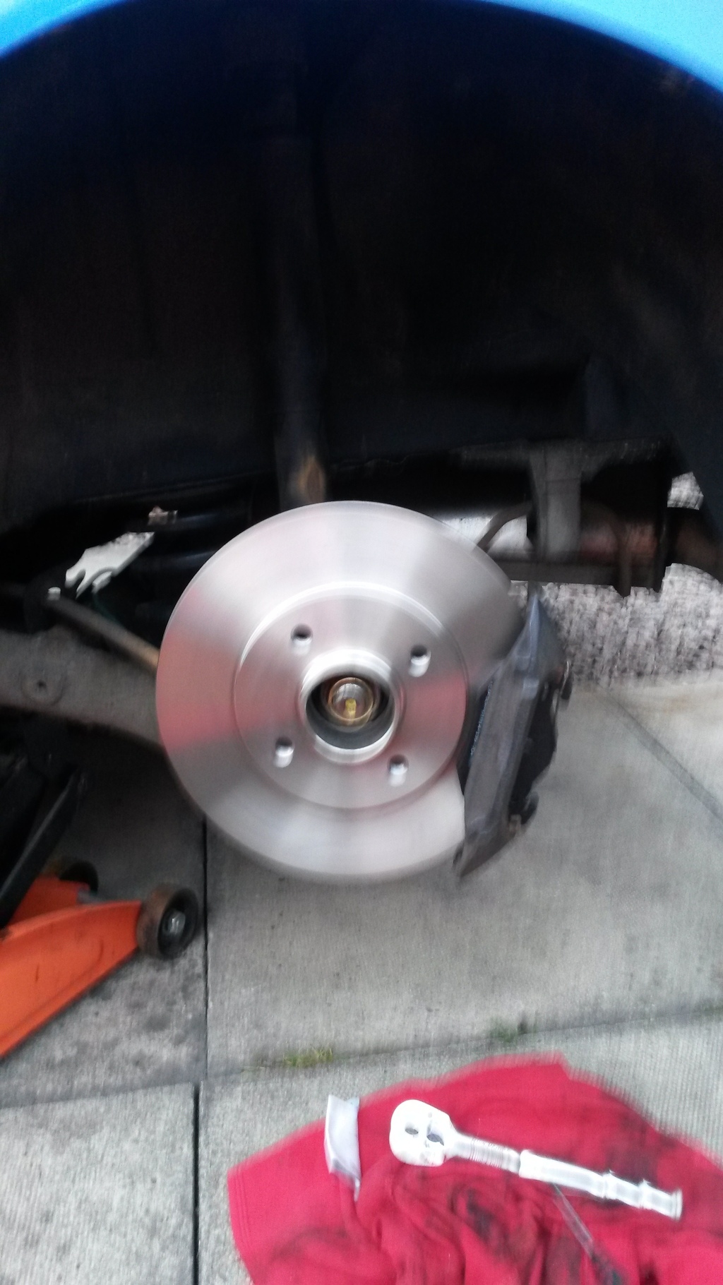

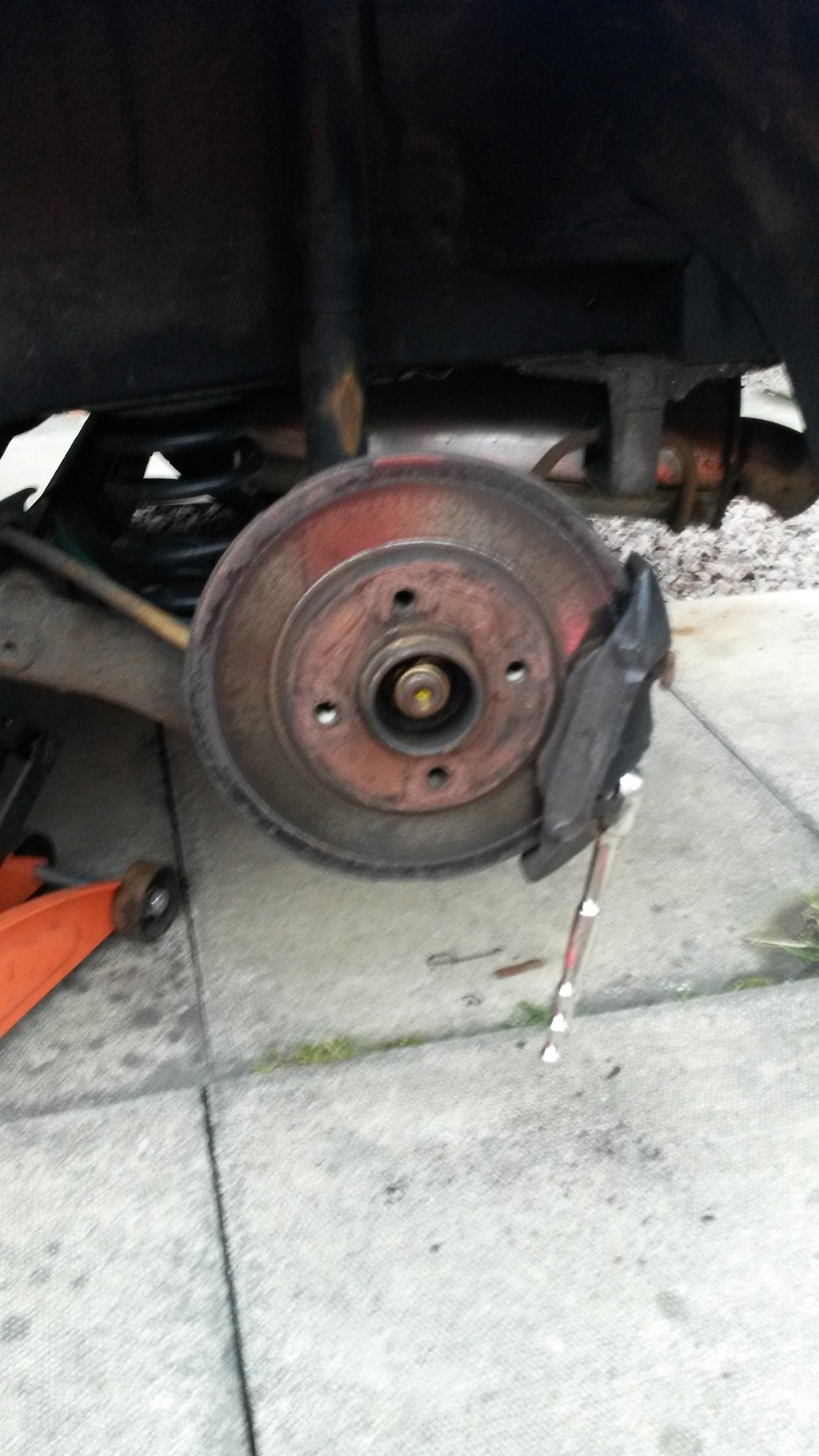

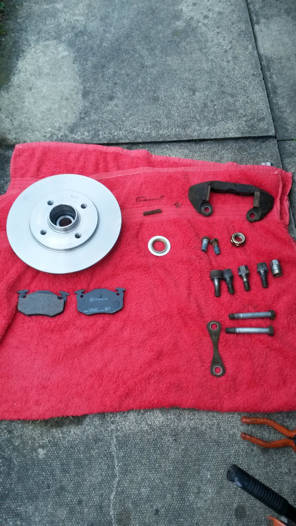

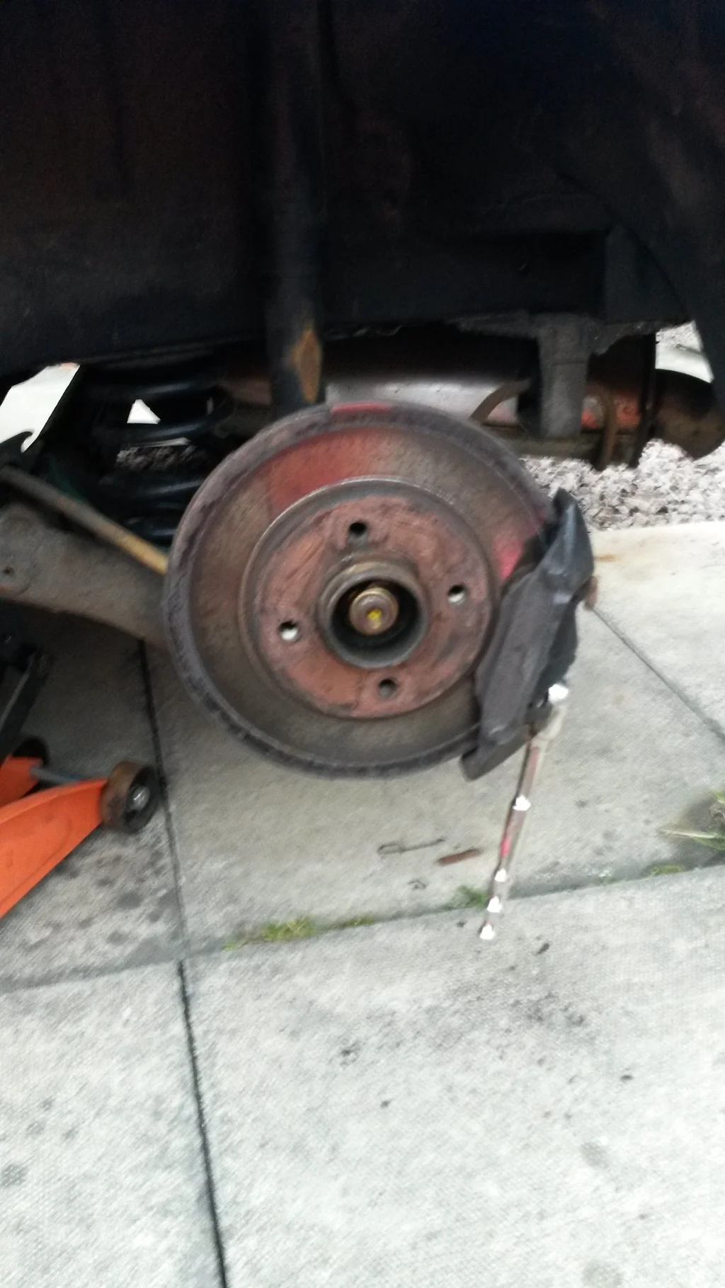

Also renewed the front and rear discs and pads, went for CL RC6 front pads from the group buy arranged on here by @imprezaworks with Brembo HC discs. On the rear i went for Brembo OE discs and pads, also changed the spacer that sits behind the bearing just for peace of mind and removed, cleaned and reassembled with red brake grease all the sliders, got all this from @George@RTR_Parts http://www.roadtrackraceparts.com/
Before:
Fresh parts:
After:
Still got the brake fluid to change, fit camber bolts/shims and get the alignment set up, will update soon, Ive booked on Blyton Park on the 18th April to see how the car feels so should have it ready by then.

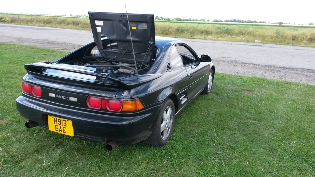

Old pic of my MR-2, 92' jap import 2.0 N/A was a brilliant car to own and i would recommend one to anybody, handled excellent and surprised 99% of more expensive cars on track:

Love the mr2, I used to own a h Reg one in black. Do you really think a 205 would be better than 195. Also where did you get the tyres from?
  Renault Clio 172
the red one above is my old one that i had for a while, ive got a black H reg now that im sharing with my dad
The tyres i got from mytyres for £61 each, im sure the 205's will have more grip as its more contact patch, i'll find out how good they are soon i guess

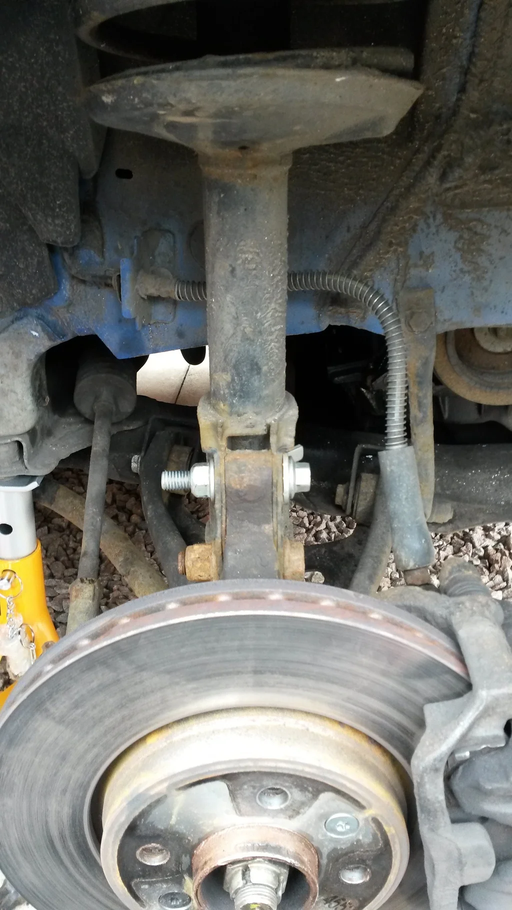

Fitted 2 new lemforder track rod ends and renewed the brake fluid for some ATE supergold dot 4 supplied by http://www.roadtrackraceparts.com/ , also fitted the Eibach camber bolts i bought from @STEVE.M on here (trusted seller, top guy).. I set the camber to as close as i could get 1.5 degrees with the camber gauge app on my phone, suppose it will do until i get it properly set up...

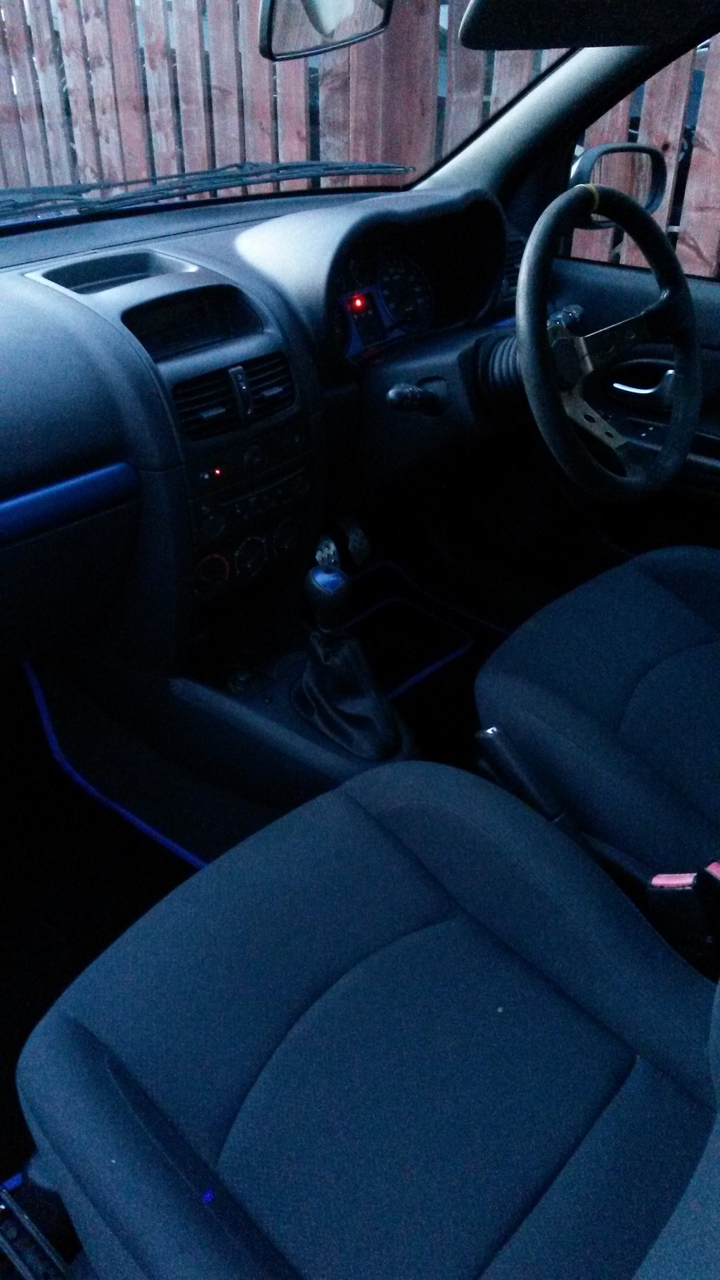

Bought an OMP steering boss a while ago but kept forgetting to take a pic so here it is, the boss is good quality as you'd expect, and despite what people say the indicators do self cancel still, fitting was easy enough although the airbag connectors are abit of a squeeze. The wheel is from McGill motorsport and has been fitted to 3 of my previous cars so the suede is pretty worn but it does the job and allows me to get a better driving position due to the 3" dish..

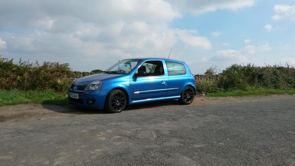

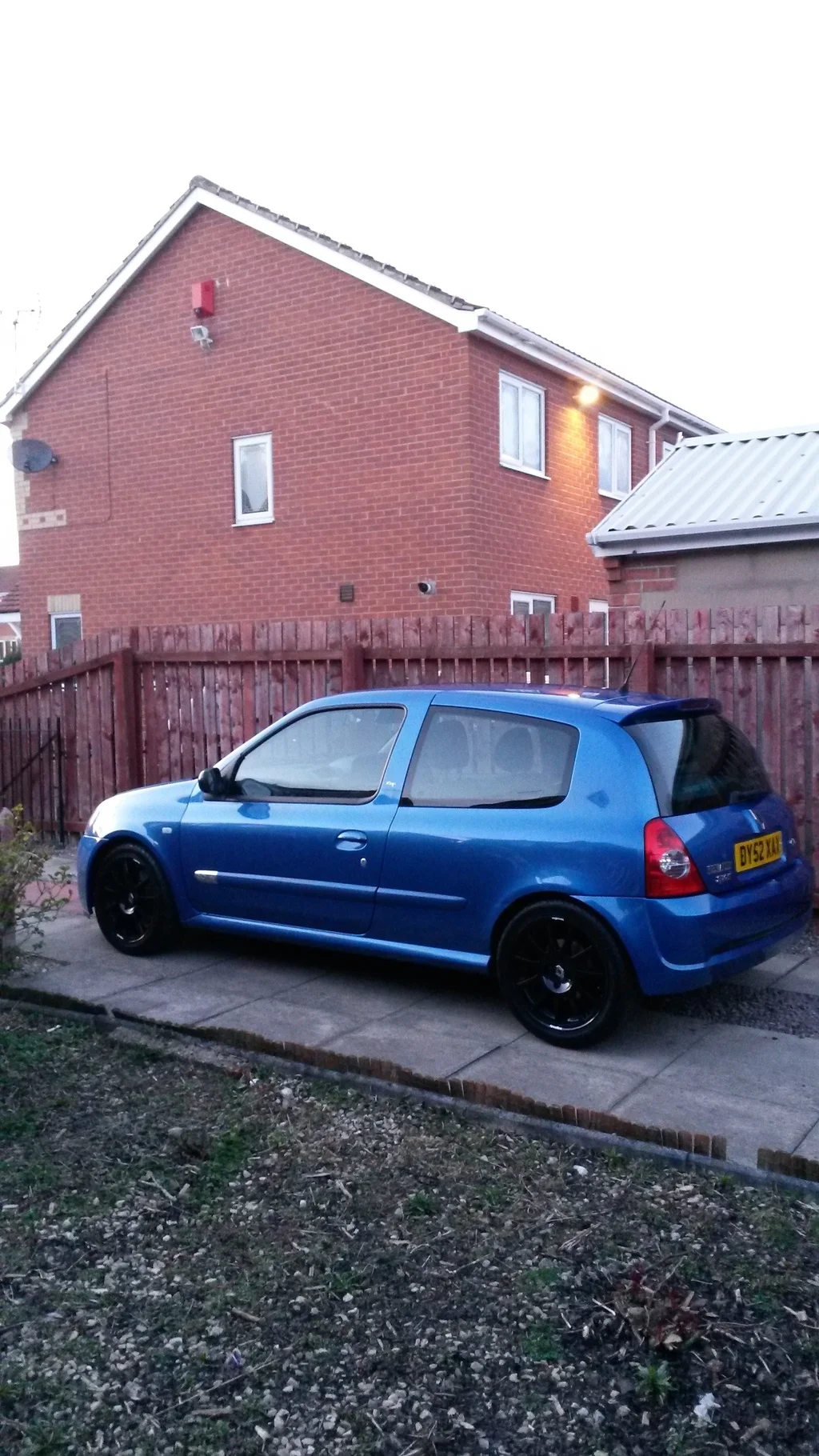

Random pic of how its standing at the min..

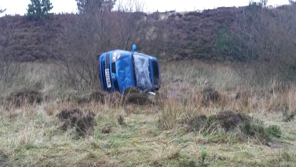

And another crashed clio

yeah really easy just the setting that was a pain due to not having a ramp, i would have left them set at max negative but im not sure when i can get the geometry set up so i wanted to get them as close to 1.5 as i could

Thanks for the mention Andy.
The bolts were surplus to requirements as I bought some coilovers with slotted camber adjustment.
In order to avoid constantly paying out for a set up every time I disturb the front end for whatever reason,I bought a Gunson camber guage (£33) and a mini spirit level.
With OE shocks & bolts fitted,I put an axle stand under one front jacking point,and with the spirit level positioned centrally on the roof(I found just behind the radio aerial was the best position,and put 2 small dots on the roof with an indelible marker for future reference in order to maintain consistant readings) levelled the bubble in the spirit level with a jack on the other side.
With the camber guage adjusted to zero,and after fitting the coilovers,I set them up with neg 1.75 with car in its double checked original stance.
Too many beers into this,I have realised that I do not have a clue what the factory settings were,so this is is only a guide to deviate from those,not an absolute figure

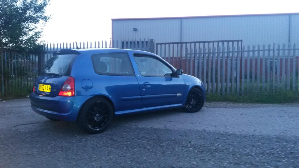

Had the wheel alignment and geometry checked/adjusted today. The suspension is standard cup apart from cooksport springs.
The front is set to -2 degrees camber and 15 minutes toe out.
The rear was measured at -2 degrees camber and parallel toe.

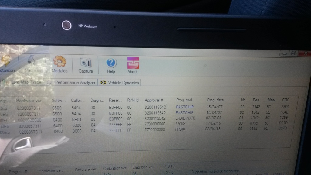

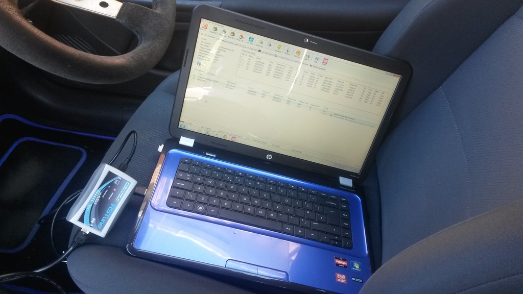

Done a few more things with the car since I last updated this, first off i bought an rs tuner module from @Marcos999 , top guy was delivered very fast and really well packaged. After reading up on these i thought it would be worth a go seen as its quite cheap, I sorted the unlock code from fastchip which took about 3 days but it was bank holiday weekend and bought the 98 RON map.. the results were brilliant and i'm really impressed with the map to say its only a generic one and on an N/A engine, it really is like everyone says, pulls much better and smoother through the rev range all the way up to 7.5k, the 5k "kick" is still there but is less noticeable.. It was also very easy and straightforward to backup the original files and upload the new fastchip ones.

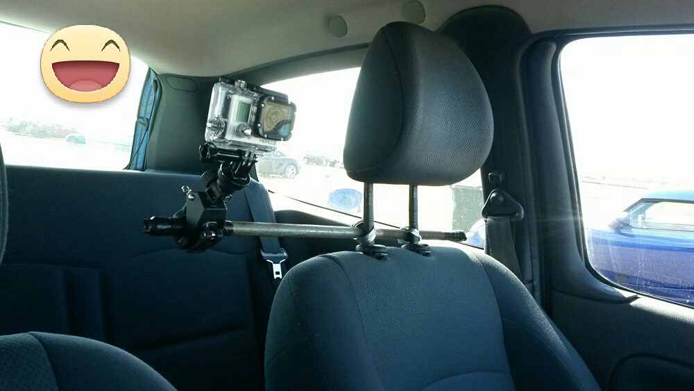

I booked Blyton Park on the 18th to see what the car was like so at the last minute i forgot i needed somewhere to mount the gopro, 1 old washing line pole and some jubilee clips later and had the mk2 camera mount made up (mk1 was made of mdf in my old fiesta).. I have got a patent pending in case anyone is thinking of copying this by the way...
