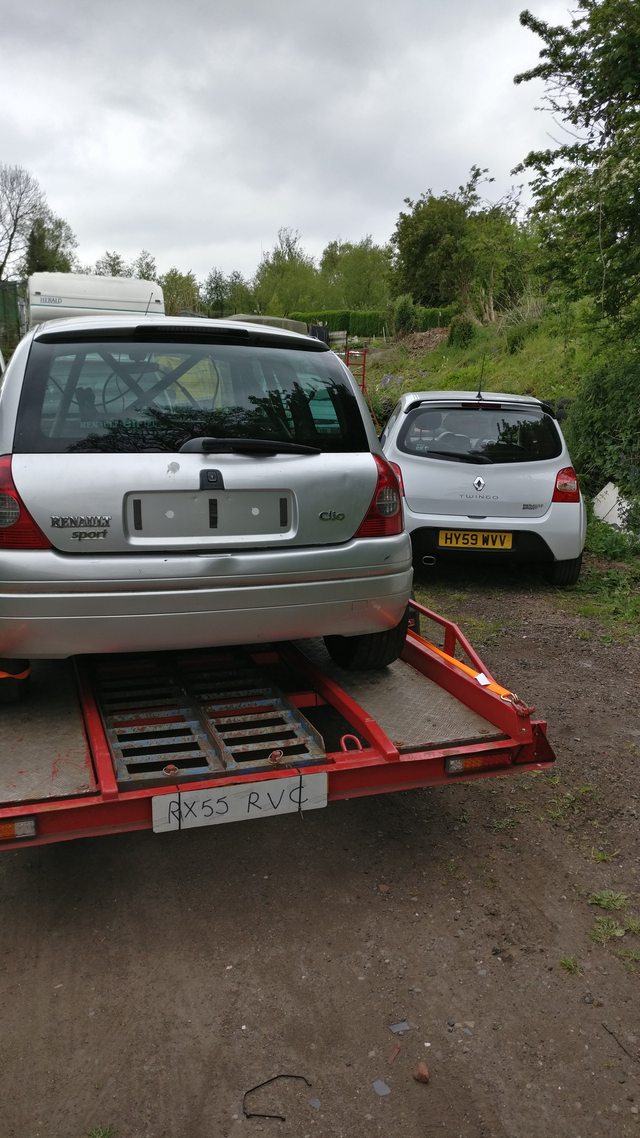

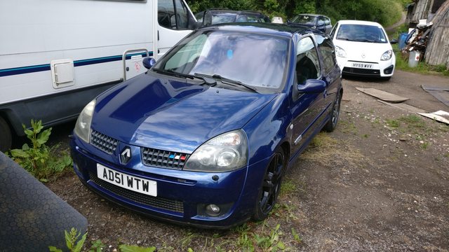

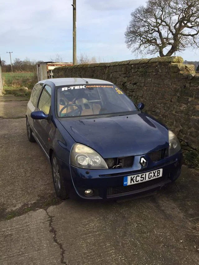

So two weeks ago me and my girlfriend (Alex) bought a ph1 172 car with a full weld in roll cage by Custom Cages. We wanted it as a project to do over the summer break whilst off University and our intention is to have it as a track only car and maybe compete in it one day .
The pics below show the car in the condition we brought it, needing a lot of TLC and some work doing to it.
One of the previous owners facelifted the car putting a ph2 front end on it and ph2 rear lights. But a full ph1 front end and rear lights have been bought and I will be collecting and fitting them in the next couple of months!

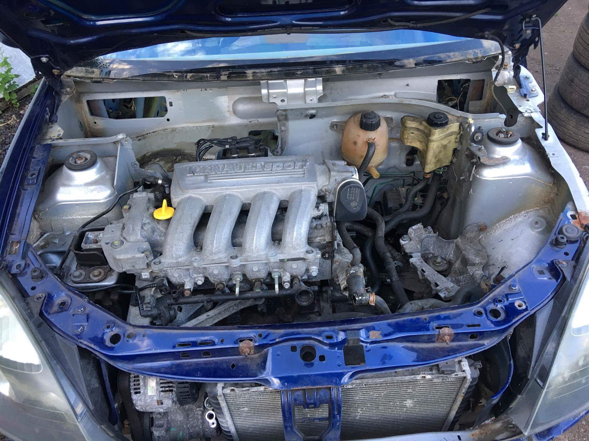

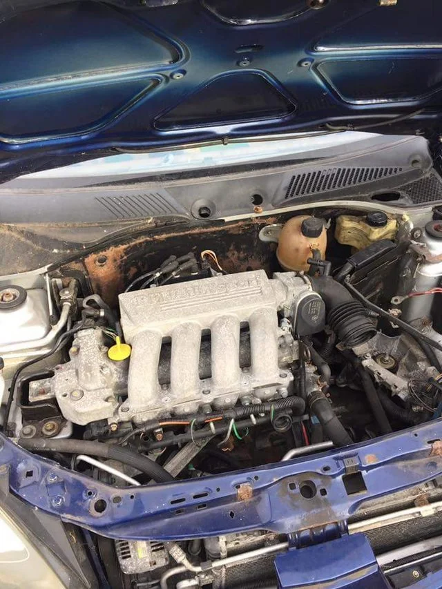

We knew the car had been sitting for many years when we bought it and so knew there was a possibility of the engine being seized. Once we got it back at the lockup we tried cranking it by hand - it was seized solid .
At least the dogs were happy about it.
Anyway... We took the inlet manifold off and filled the bores with Paraffin; left it a couple days and voila! The engine was now free! Now we needed just need to connect all the looms back up and get it starting by the key.. which is proving very timely and difficult.

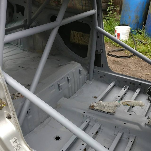

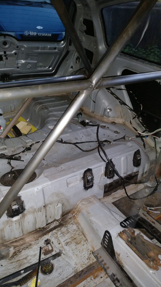

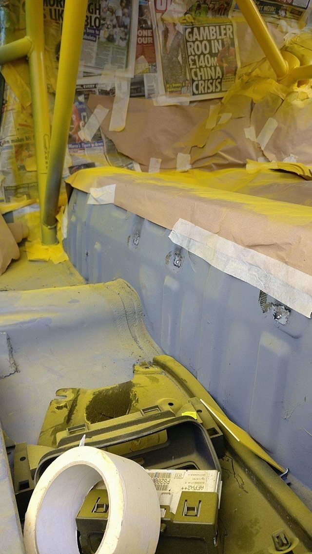

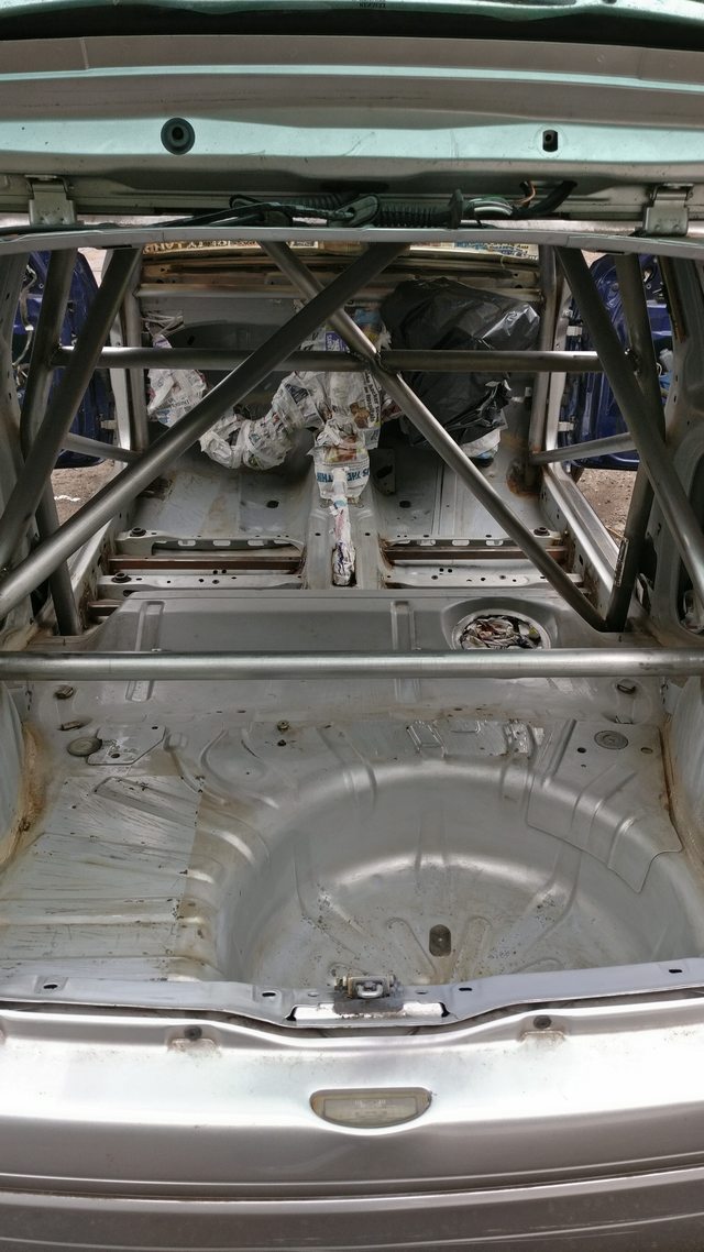

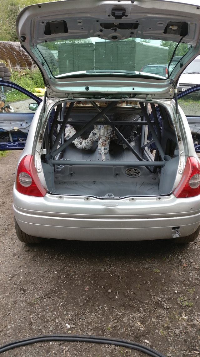

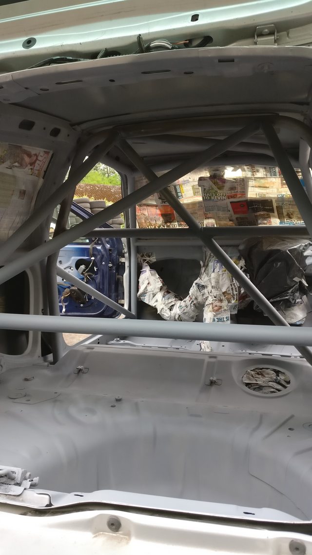

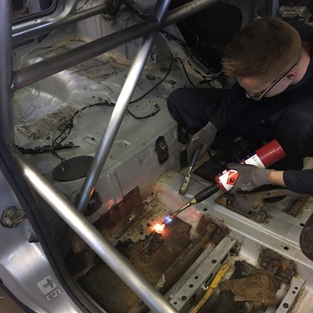

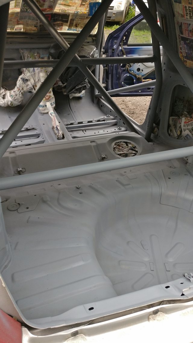

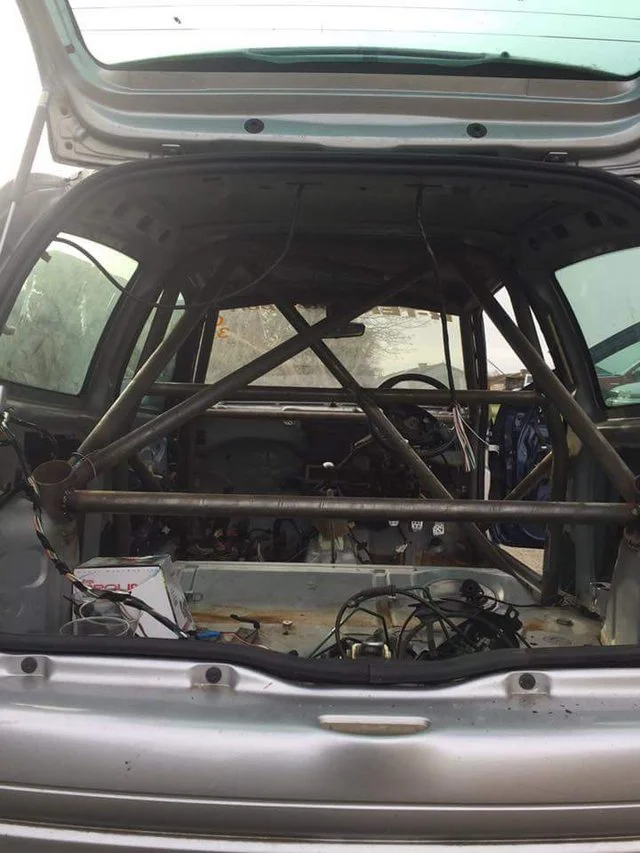

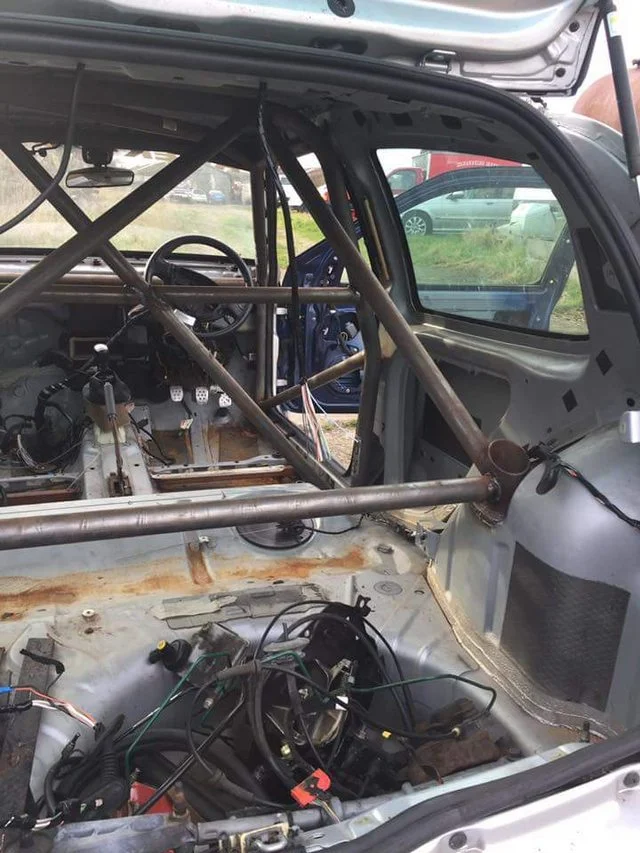

The surface rust plaguing the car interior needed sorting. So earlier this week we dug out the sandpaper and spent two whole days sanding all the inside down. Exhausting work - but the results were worth it. It now looks a completely different car!

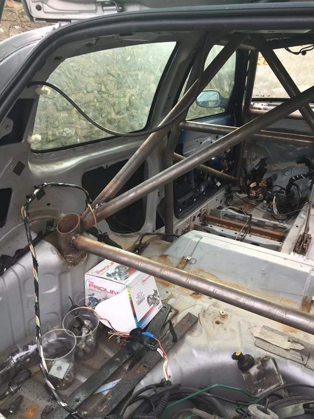

After sanding the cage down we begun removing all the sound deadening. All of it bar the roof is out now and will tackle that in the near future.
Interior all masked up, sanded and ready for priming to prevent surface rust coming back!
And what a difference it has made!! All done with rattle cans and a lot of elbow grease, but we are over the moon with the results and really happy with the progress we are making in our spare time.

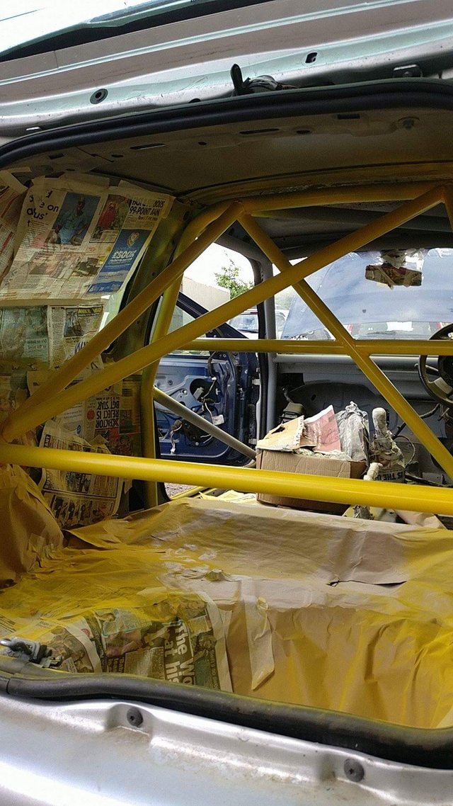

• Sanding the cage down ready for painting - and paint the cage.

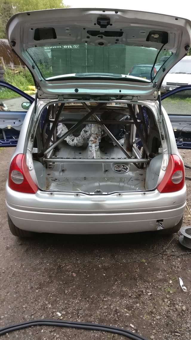

Took out the last of the sound deadening located on the roof and removed the horrid fabric material heat shield thing today from the engine bay, makes it look so much better and will eventually replace it with a Nimbus one once the cars running and actually being used. Ground off the rear seat brackets too and some other bits and pieces to make it look tidier, quite happy with the results .
Also took out the heater box and everything associated with it, should save a fair chunk of weight!
Found some more pesky sound deadening tar... I will remove it tomorrow if I get chance.

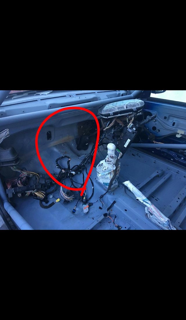

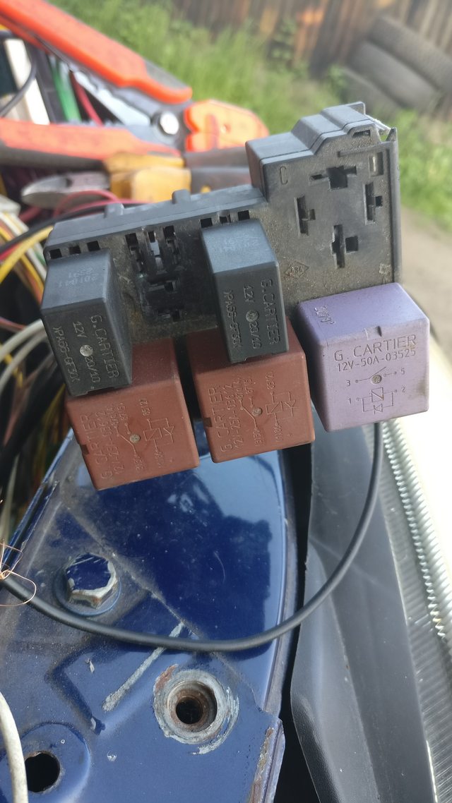

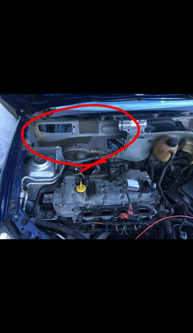

Made some more progress yesterday with the help of a friend whos good with electrics. After I connected everything inside the car and earthed it all back up after the priming, we tried starting the car by the key. Unfortunately no power is getting to the starter motor. We investigated, following the voltage on the ignition wire from the key barrel up to the fuse relay box where the voltage was fine going in, but nothing coming out.
We traced the wires to the centre relay (missing in picture) and figured this is connected to the starter. We swapped the 3 small relays round and bridged them and concluded that they were all broken Very strange indeed. Anyway I've been to the scrapyard today and picked 3 up so hopefully this resolves the issue.
On another note... Don't think the car will start anyway after fixing this wiring issue as the engine is still too tight to be turned by the starter Looks like it might be time to strip it down and rebuild.

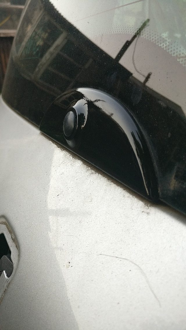

Alex has been busy making the car look prettier in places with cheap little touches.
Homemade wiper blank sprayed satin black with a 13mm rubber grommet.

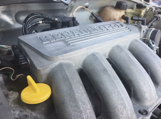

Fresh paint on the oil cap in the yellow we will be spraying the cage with on Sunday
Think she wants to sand and spray the inlet manifold black with yellow 'Renaultsport' writing as her next job. Also shes in the process of spraying the boot lock surround satin black to match the wiper delete.

Is that not a phase 2 fly by wire throttle body it has on?
Nice progress.
Will look much better when its back to phase 1.
Thankyou! Yeah it will look mint cannot wait :smile:
Yes it is the fly by... Well spotted, it has an engine out of a ph2 and ph2 throttle pedal, but its dead anyway so will be swapping the engine in the near future.:confused:

It's gunna need a loom then , as it's got a Ph2 FBW loom and pedal in it .
I'm assuming it's been swapped , or the shell is in fact a Ph2 with Ph1 bits on it

I only know because mine has the standard sticky throttle body issue if not cleaned regular. Hopefully you can find a good lump to stick in

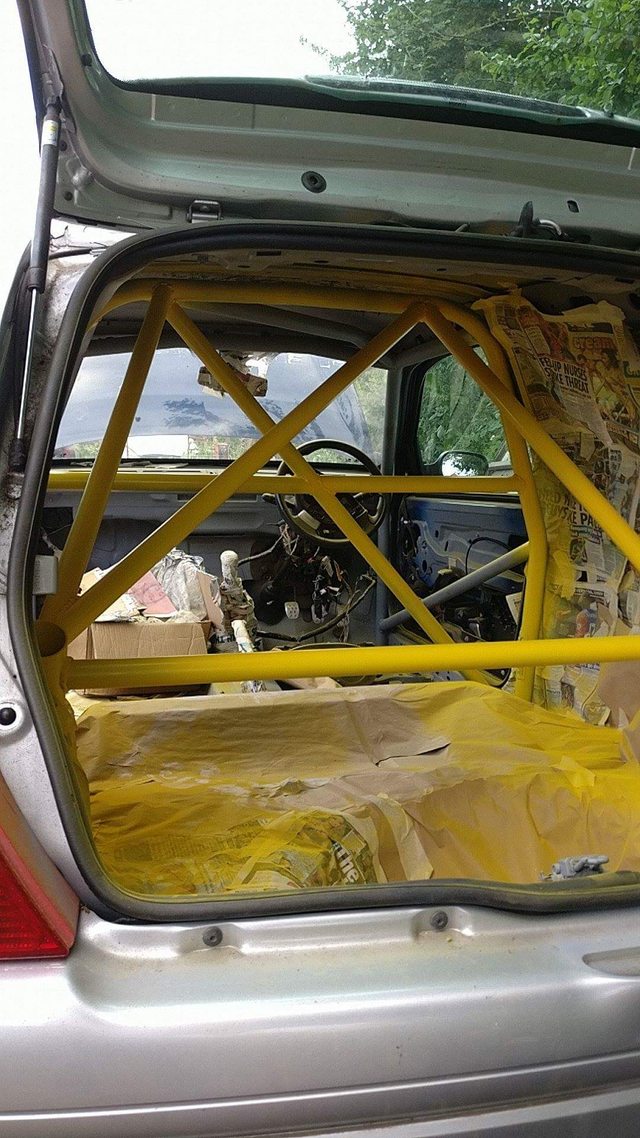

Drilled out the spot welds of the rear seat brackets and chiseled them off. Just needs sanding smooth and re-priming. Much neater than before.
Painted the back of the cage in our chosen yellow:hearteyes:. Really want the ph1 front end now but its finding the time to collect it from Norfolk when we live in Stoke-on-Trent :sweat:.

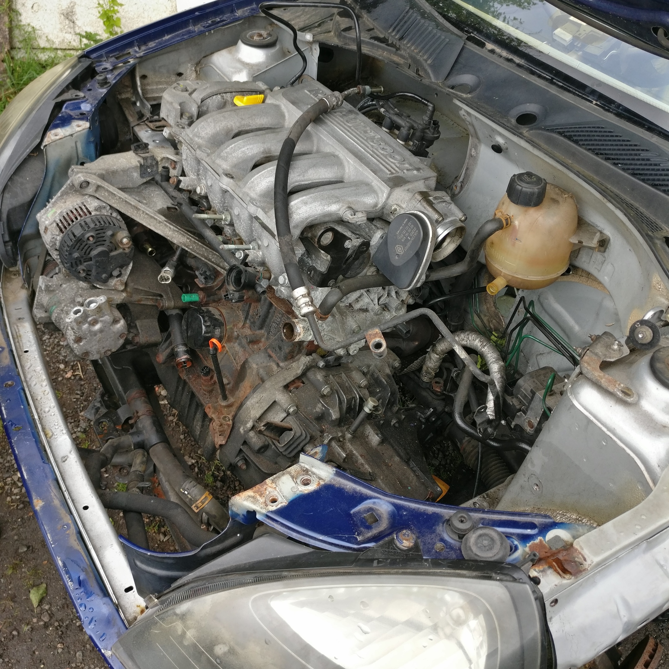

Whilst I was at work Sunday, Alex and her dad were hard at work prepping the car for the engine transplant. They pulled out all the looms and wires both inside and out; ECU everything!

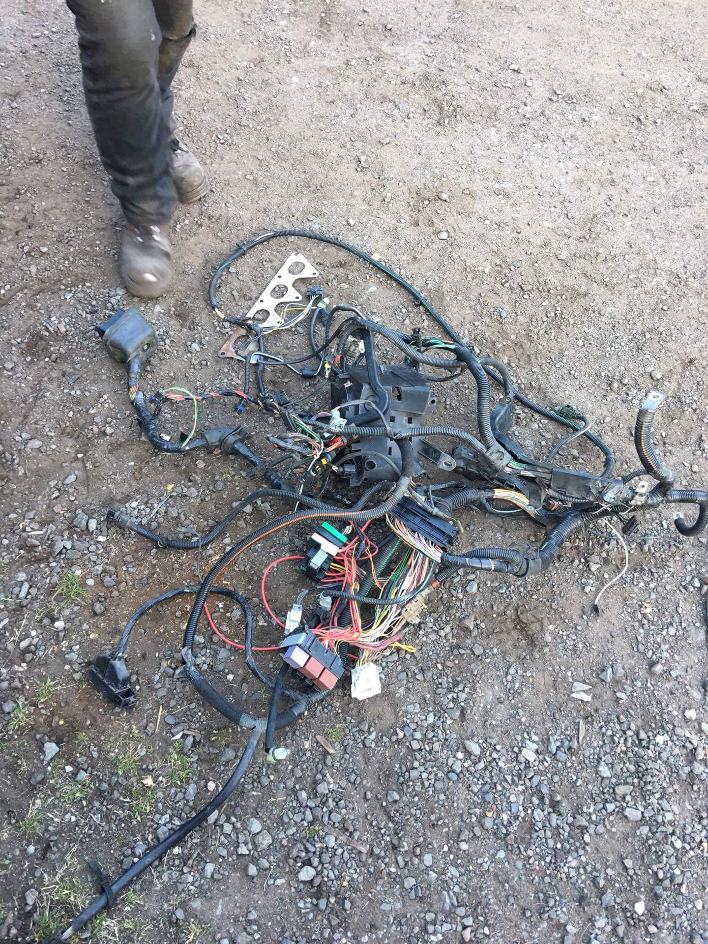

Shall be swapping over this loom for the loom in the donor car as we know everything with that is working as it should - and everything is intact, unlike the one that has been removed.
They also took out all the Aircon Pipework and Aircon Radiator, leaving just the pump left, which we're leaving in place until we get our hands on either a AC Delete Kit or Cup Alternator Setup. Looking into purchasing an EPAS conversion as we might as well do it while everything is going to be out of the car.
Bay looks empty now with all the wiring and lots of pipework gone :smile:. Should make it a lot easier to take out the engine. Need to make some plates to be welded into the holes in the bulkhead to stop water getting in now all the heater box is removed.

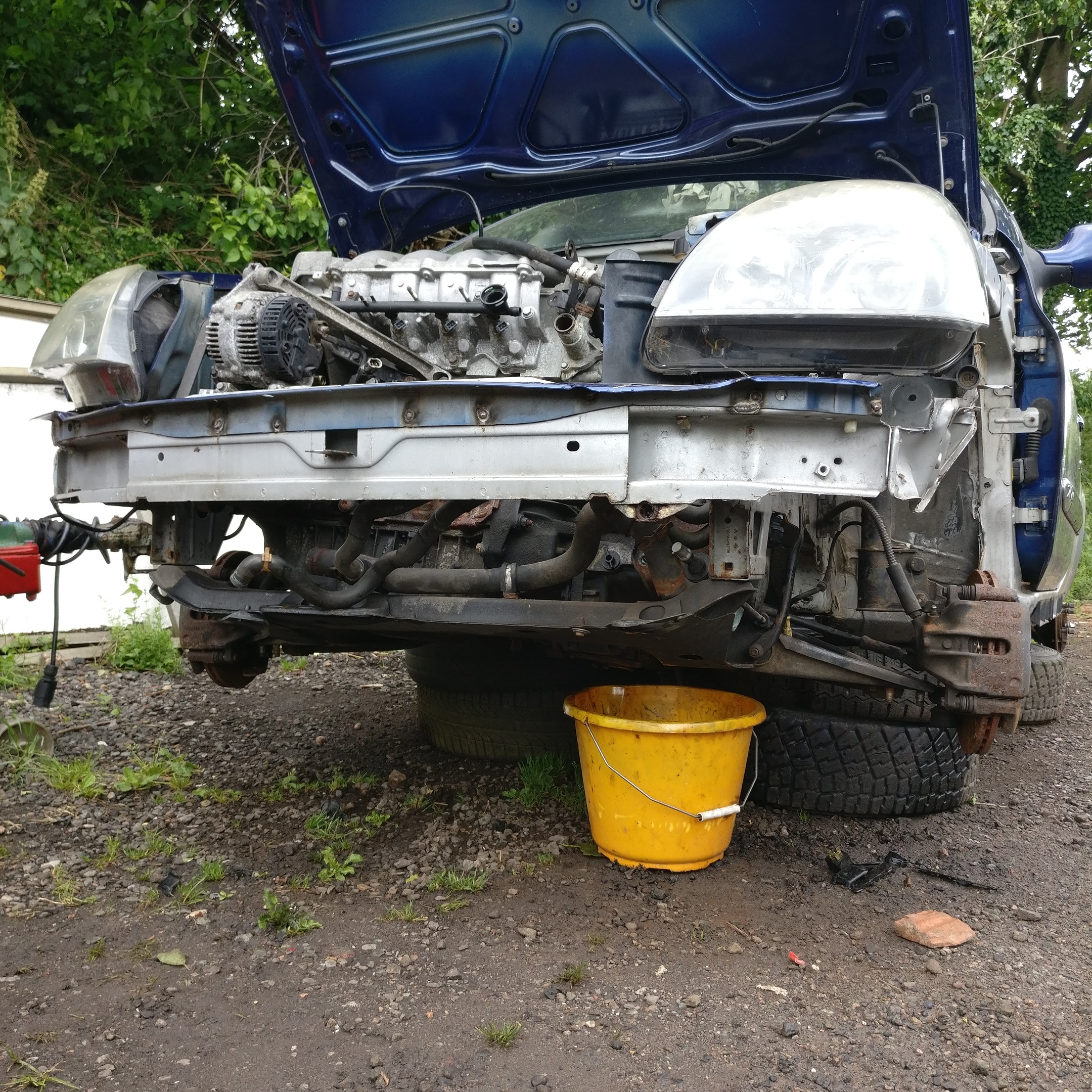

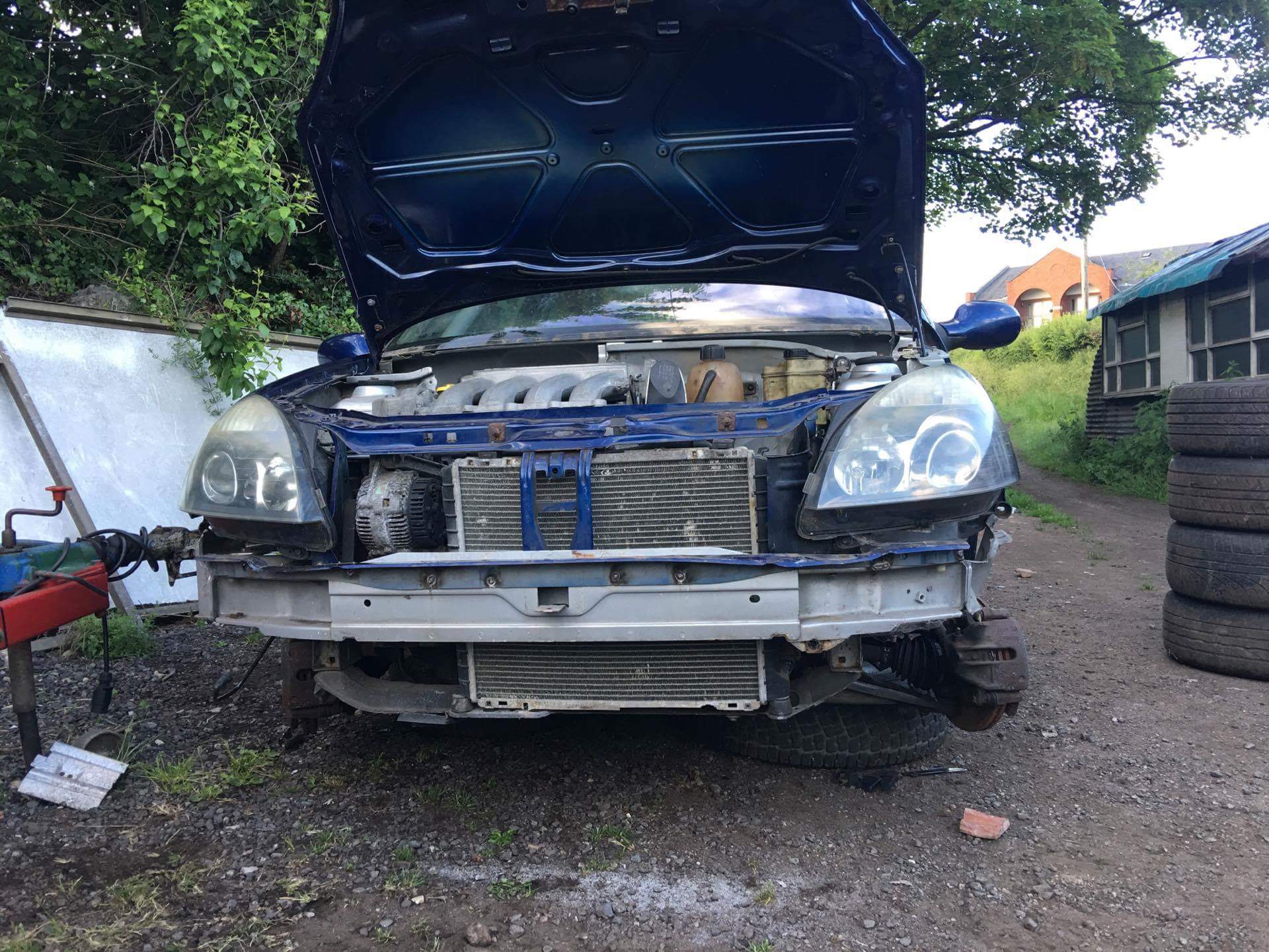

Driveshafts are now out, radiator is out and all coolant pipes are disconnected in prep for the engine being removed.
Engine is being removed by Alex's dad while we are both at work tonight! :smile:
Everything ready for the engine transplant now :tongueout:

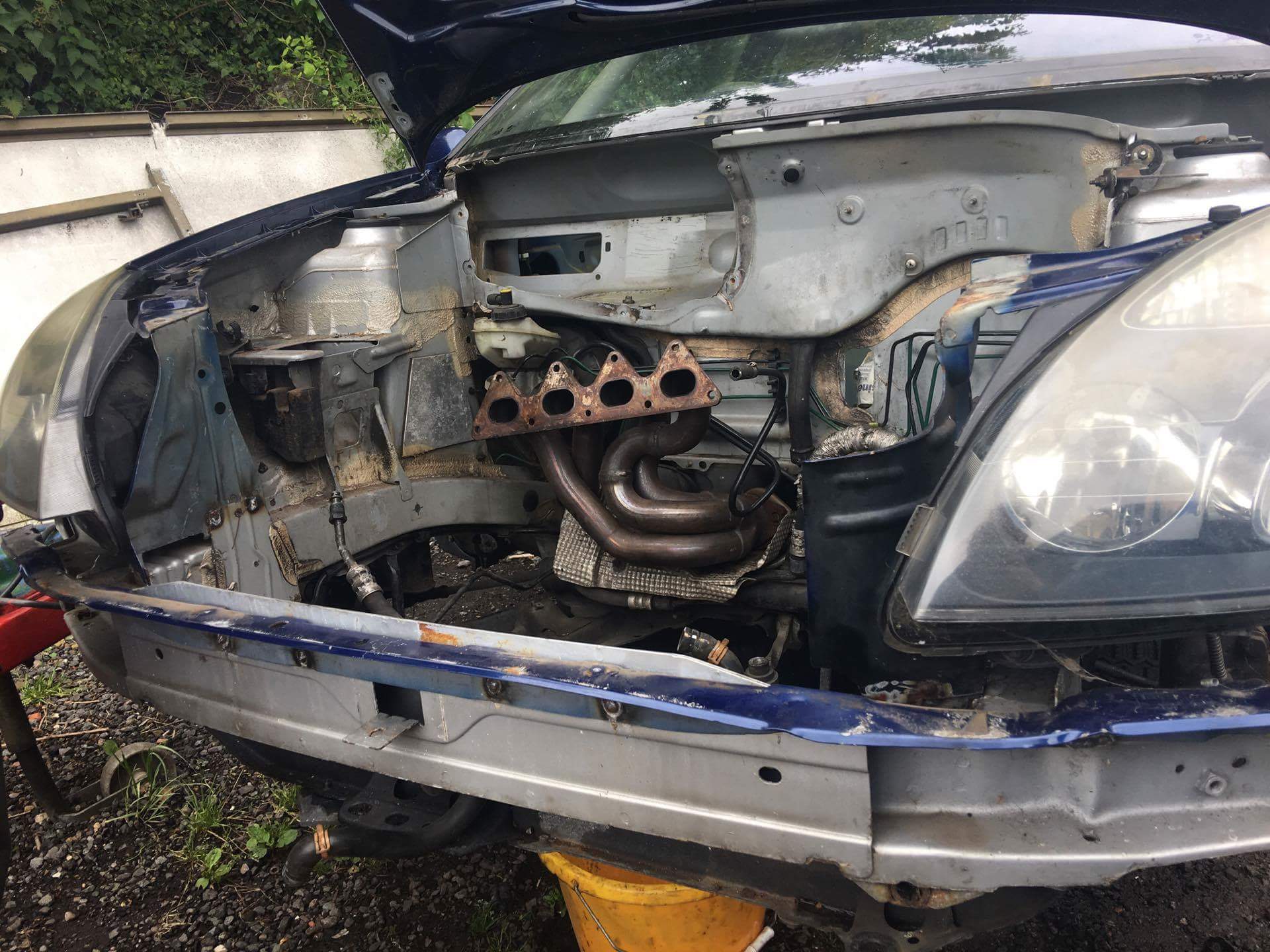

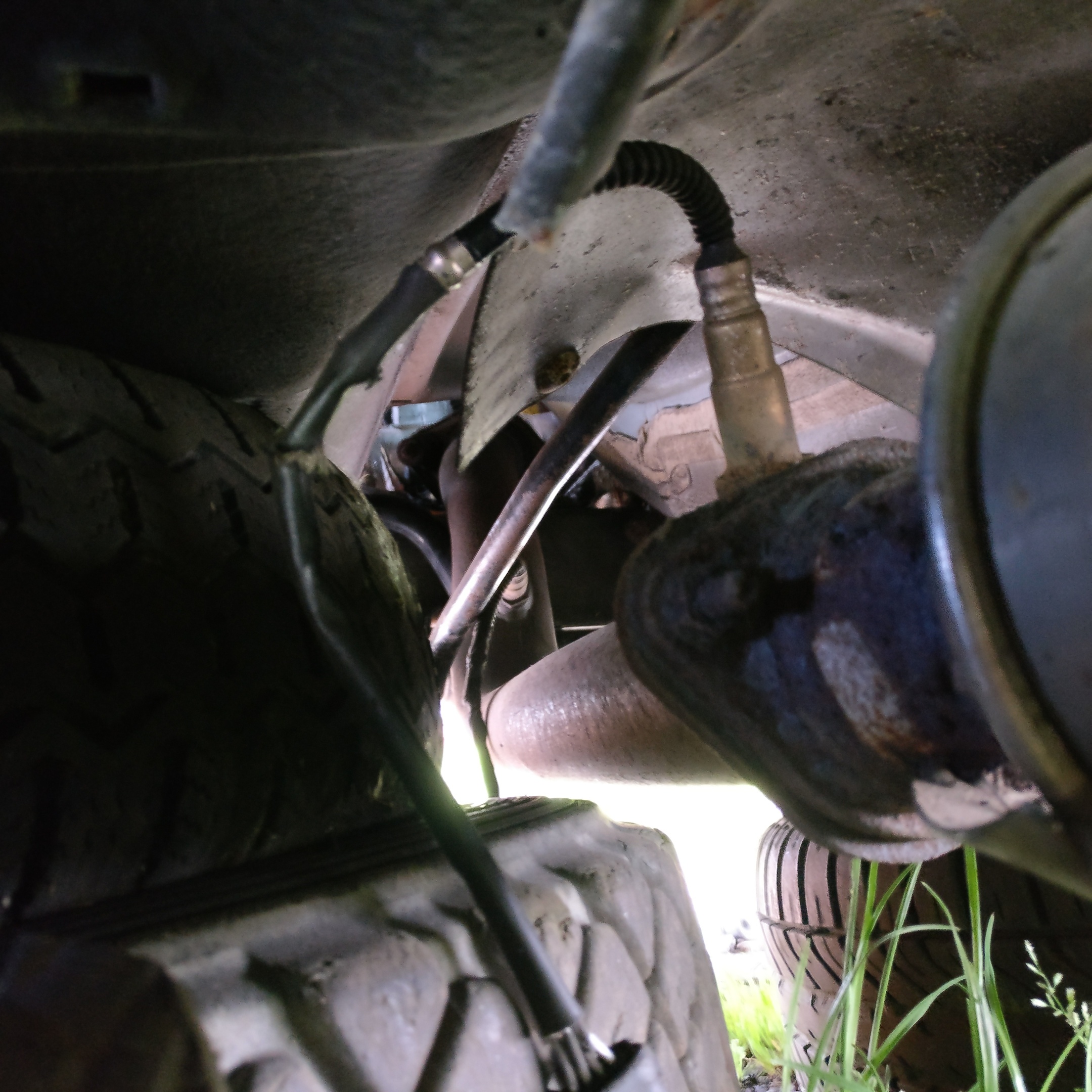

Whilst crawling under the car yesterday noticed it had a dirty decat :smirk: Obviously as sensible owners we will not be using this on the road at all...:wink:

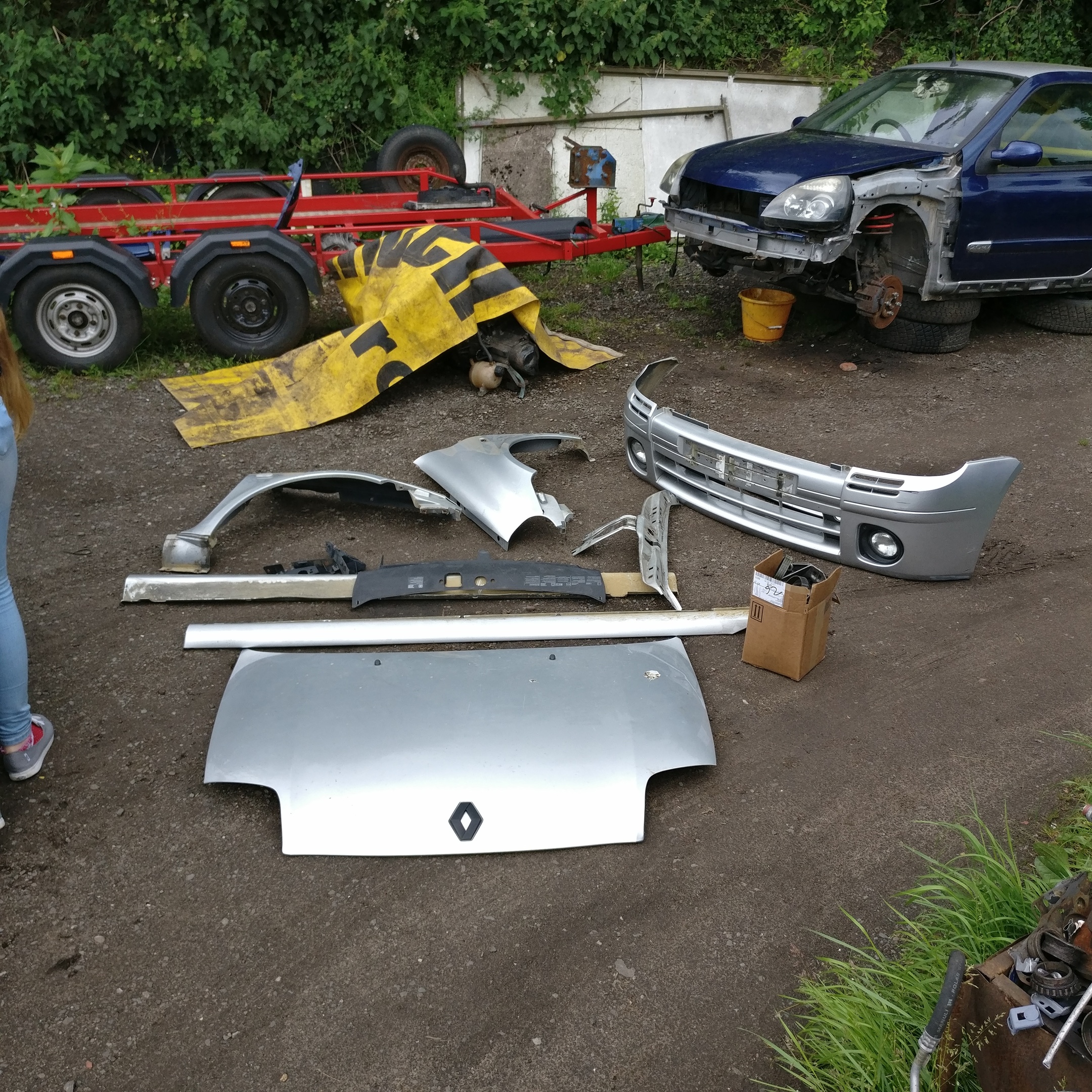

This Sunday we will be travelling from Stoke on Trent to near Norwich to collect some important parts for the PH1, sold to us by a really nice lad named Jordan! We are collecting:
  • PH1 Bonnet
  • PH1 Wings
  • PH1 Front Bumper & Grill
  • PH1 Sideskirts
  • Cup Alternator Setup
  • And hes letting us grind some metal off his PH1 very kindly due so that we can get rid of the PH2 bits that have been welded on.
So next week we should be putting the PH1 front end back on thankfully and it shall be restored! :hearteyes: Can't wait to get it running and then painted.

Engine and Box were removed Friday night, so the new lump is ready to drop into it which is mint! Will swap over the 182 Cup sub-frame off the donor car and driveshafts while everything is out.

Will get down there tomorrow and finish stripping the wiring loom out of the donor car - need to take the seats out to get to the last bit. Then it needs removing and obviously the engine needs removing and putting in the other car. After that we can put the PH1 front end back on and finally have a proper PH1 again... not a 50/50 car 😂.
Forgot to add to the post earlier.. turns out the engine that was in the car originally isn't seized after all 😂
It turned out to be the alternator being seized and now that the engines out and disconnected from it it turns so easily by hand its completely free.
Oh well... At least we now have a spare working engine to rebuild to a mint spec one day. Still glad we got the donor car though, resolved our previous electrical issues and we can stop guessing at what previous people had cut off the loom and do it ourselves :grinning:
