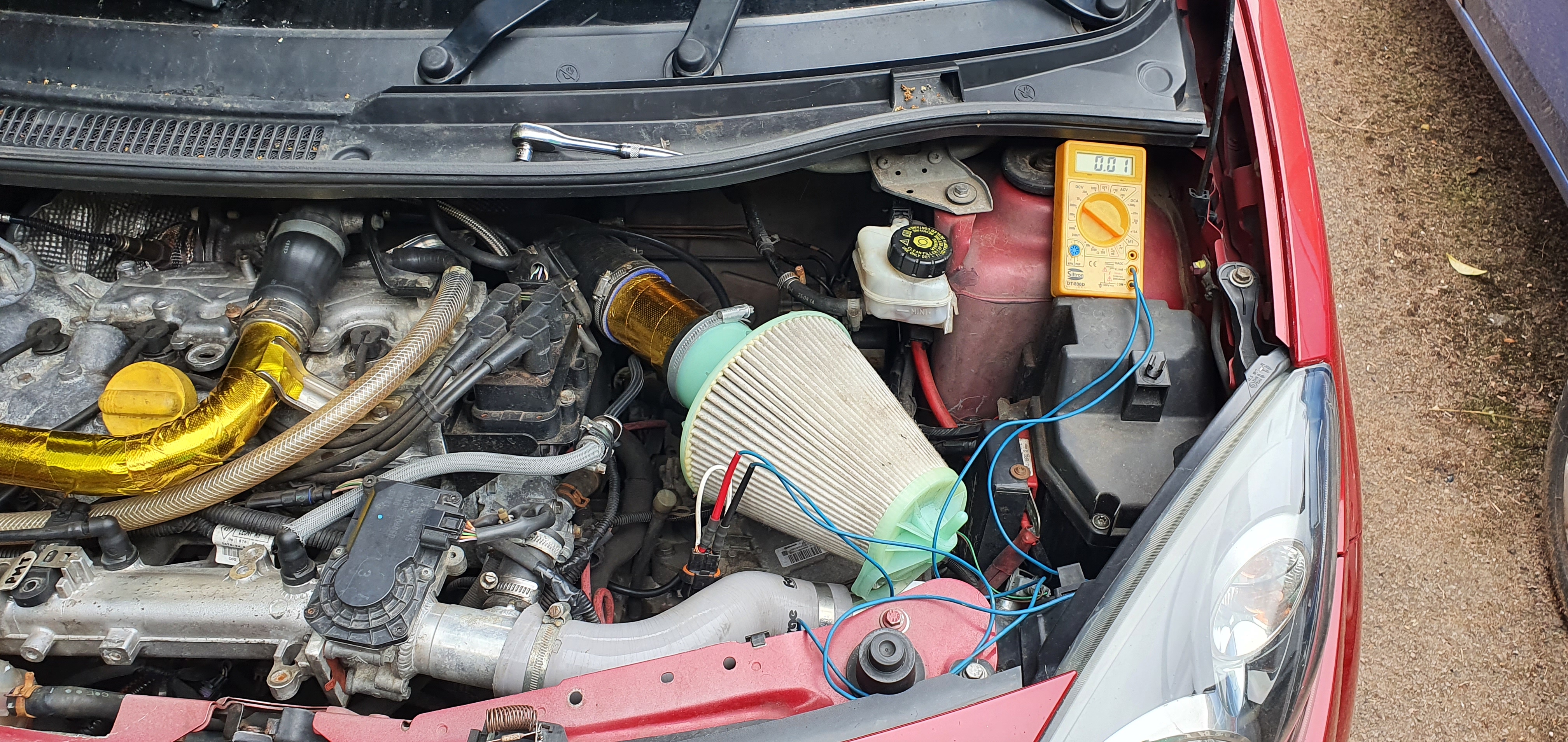

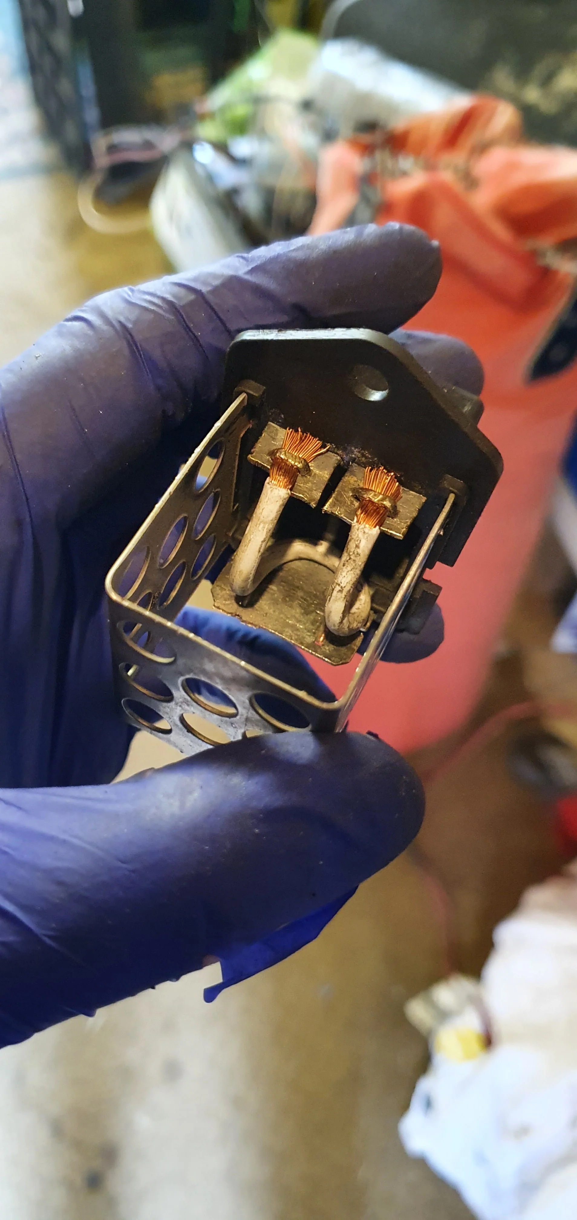

I was running the car up on the drive and noticed the rad fan wasn't cutting in... checked the dash and we were at 103 degrees. Quick check showed the resistor pack had failed again.... very strange. Fan is totally free to spin so hopefully just an age thing. From what I understand is it runs the fan at 2 speeds but with it bypassed it will just run flat out. Quickly tested and it worked fine so I gutted the resistor and bridged the connectors so it's all still oem looking.

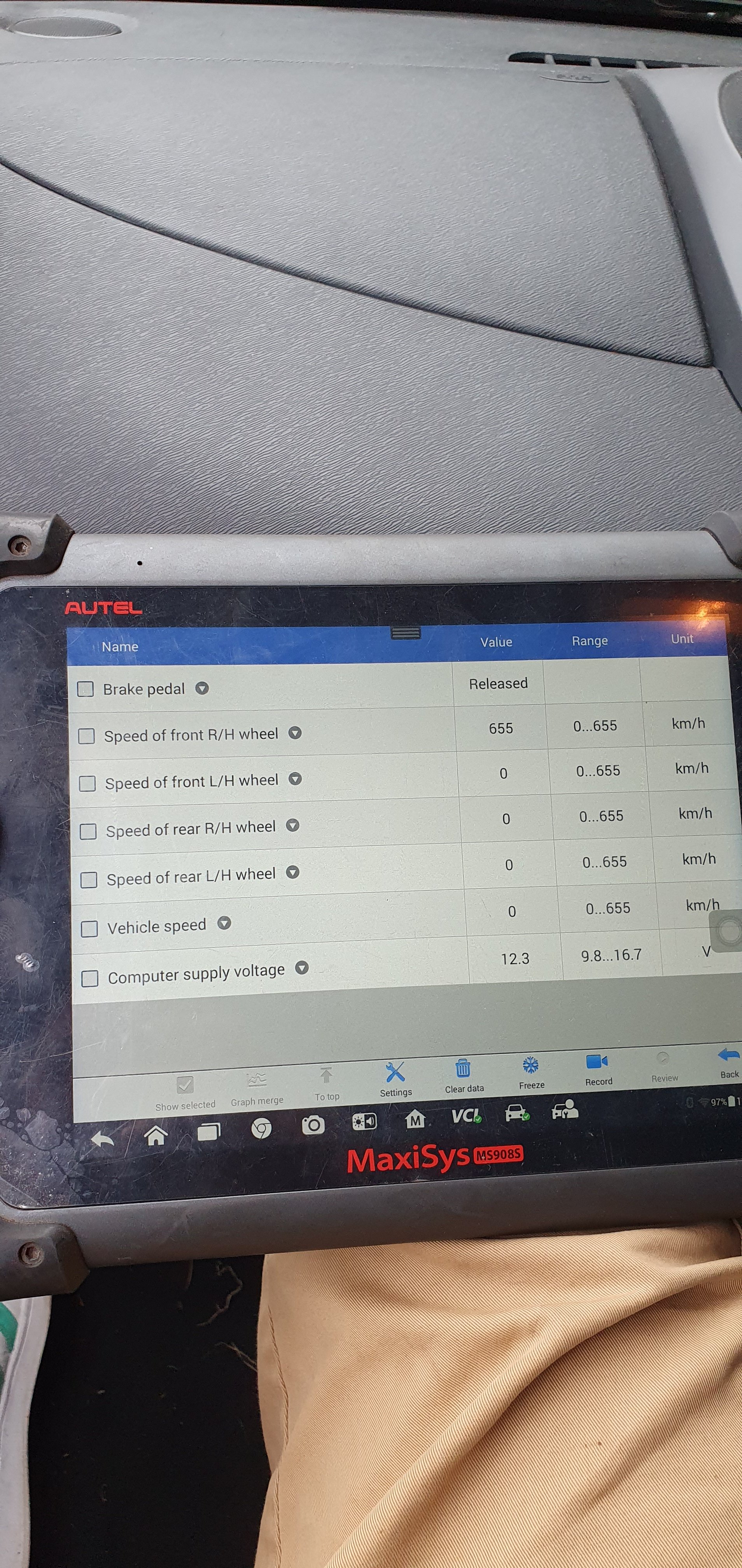

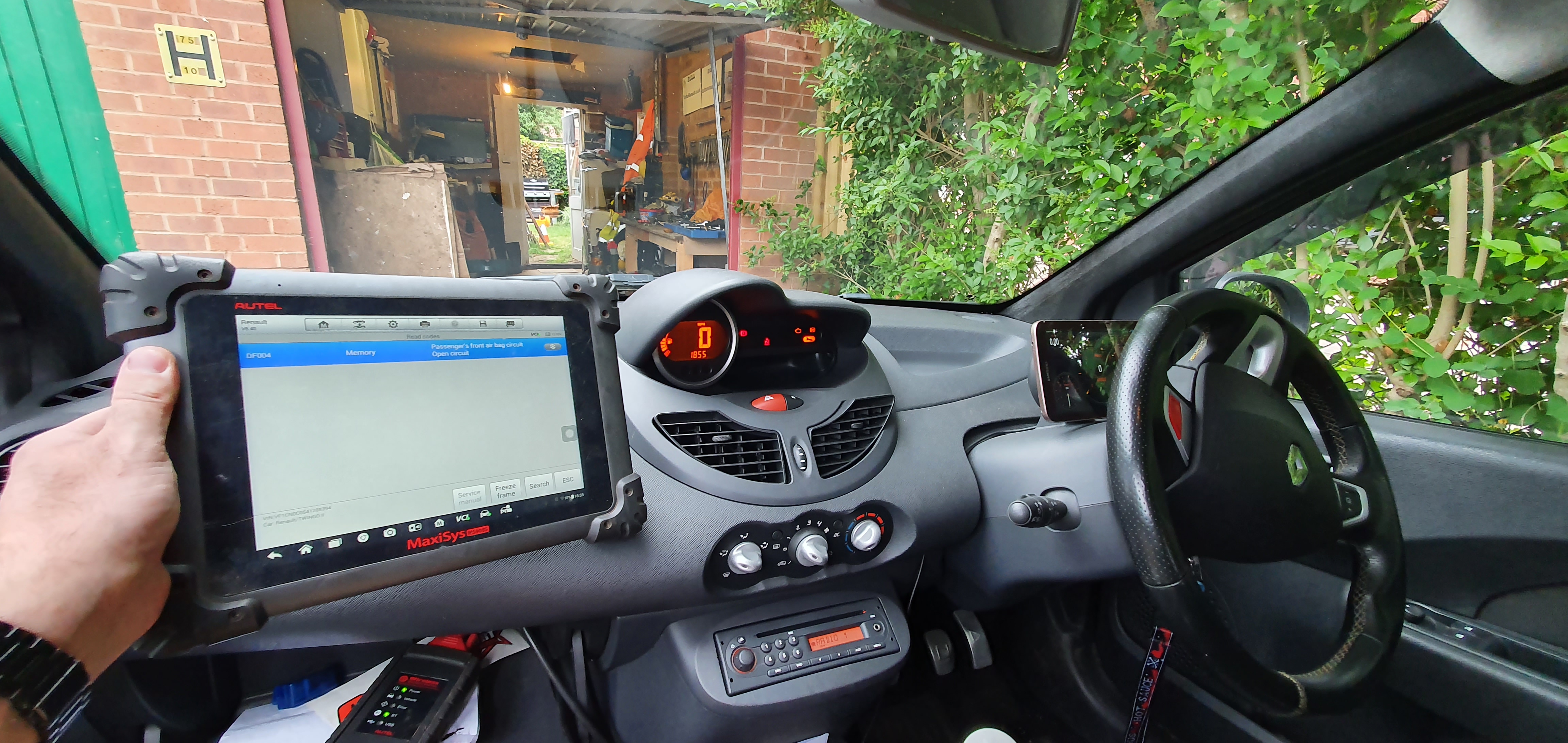

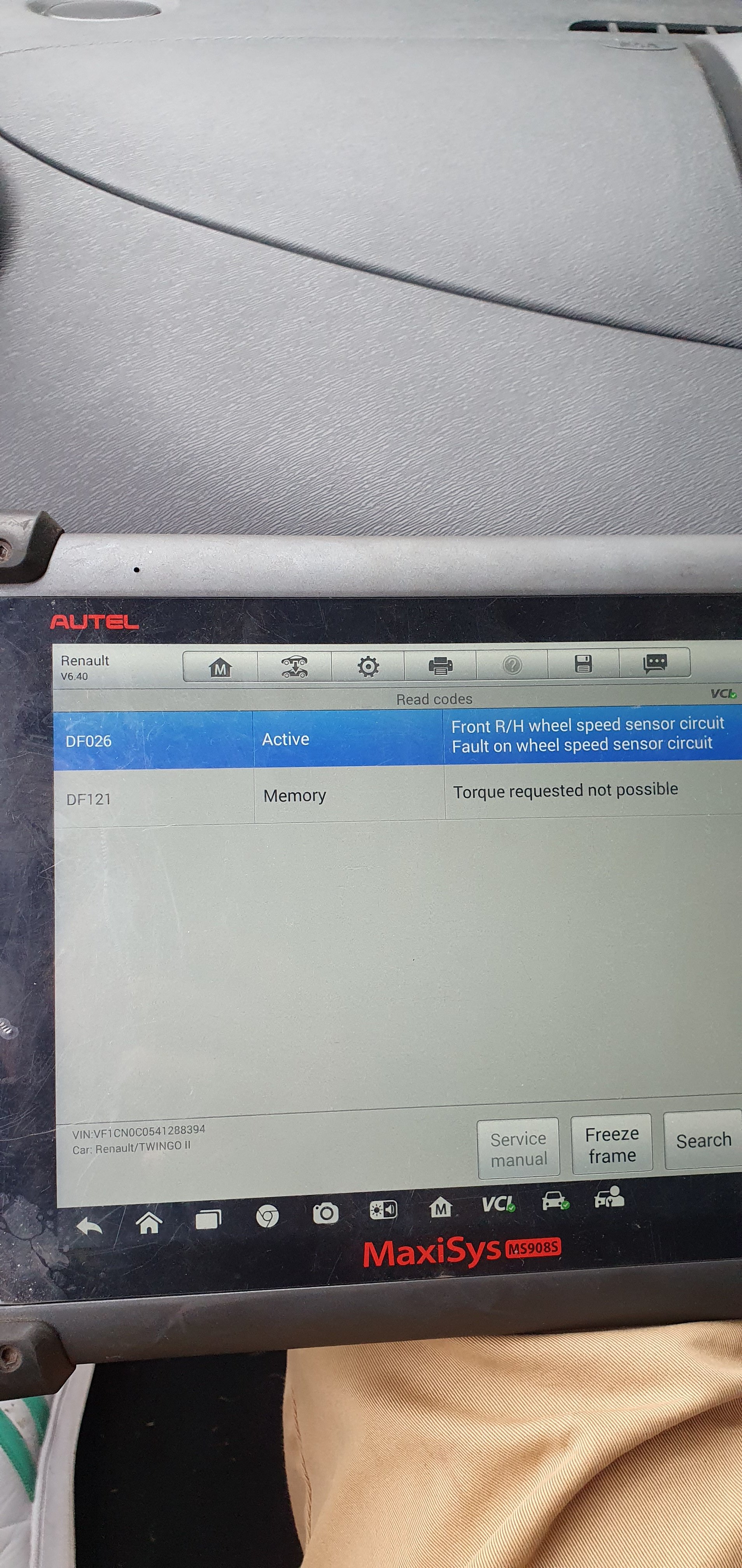

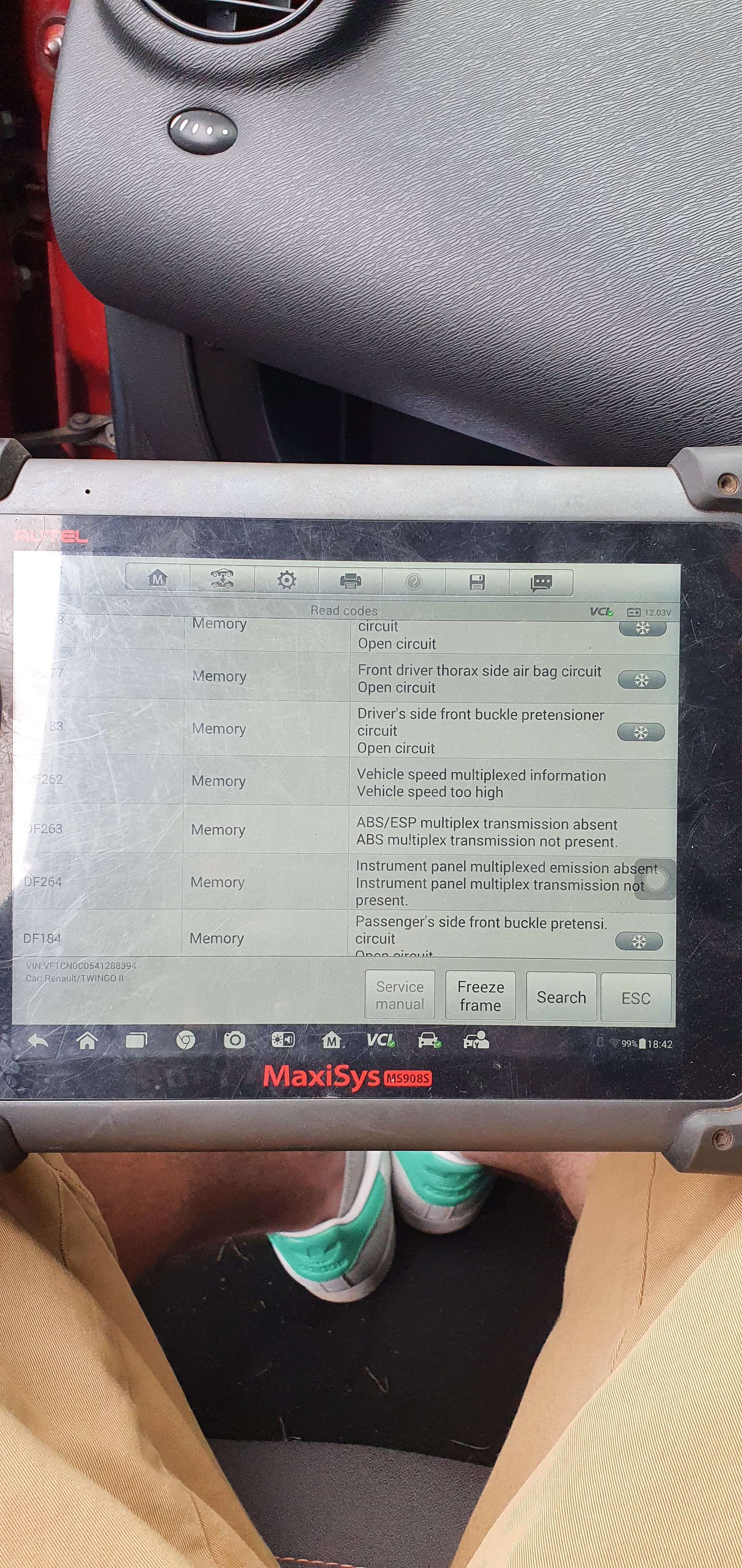

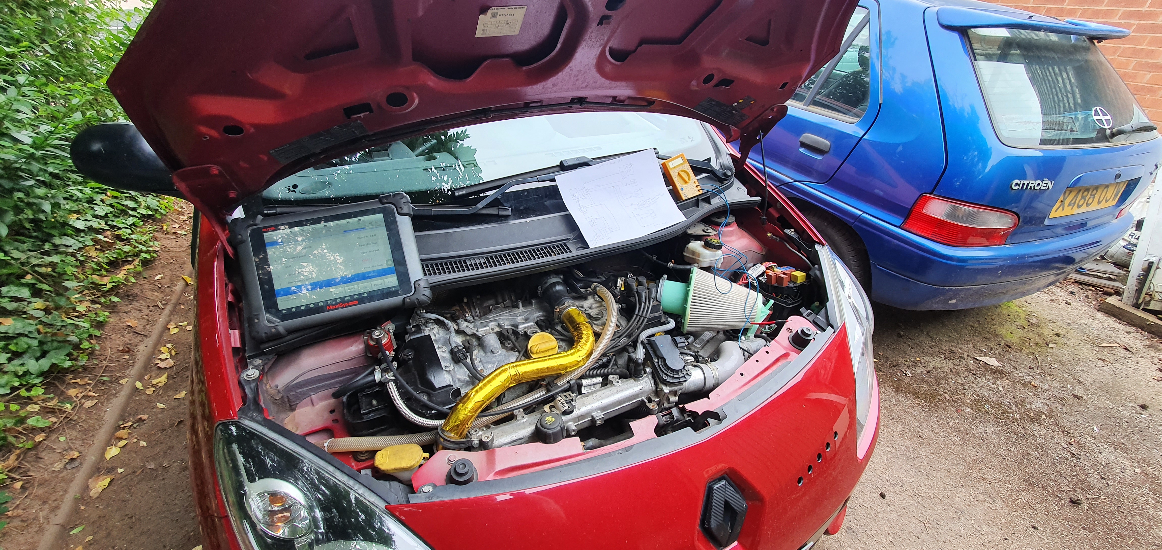

Turns out my fan wiring issue maybe a little deeper routed, another thread posted up for that as I could do with some input. My good neighbour lent me some real sweet diagnostic kit as i have a few little issue with the Twingo. An abs fault was my first to look into, after clearing all the legacy items I was able to see the current issues. DF026 front R/H wheel speed sensor. the live readout also shows its doing 655kph so hopefully it just needs a new sensor. I was able to correctly code out the front airbags, one from the dash that's been missing for years and the one for the Meg 2 steering wheel (wooo that lights now off)
Whilst I had the kit I was playing with the actuation of the fan and found it would pop the fuse when requesting the high speed fan, also causing the stop sign to illuminate and warning beep to go off, I have the same thing happen when I start the car and intermittently when I use my over boost switch which is a completely independent system making me think I have an earth fault on the high speed side of the fan wiring. The light that comes up is actually there for the brake fluid level as far as I can tell.
Great bit of kit to use though, wireless and easy. With a price tag of 2k plus I'm told, it should be! Also spotted a stored code for going too fast 😂 from the spec it looks like it will ping it for going faster than 134mph...

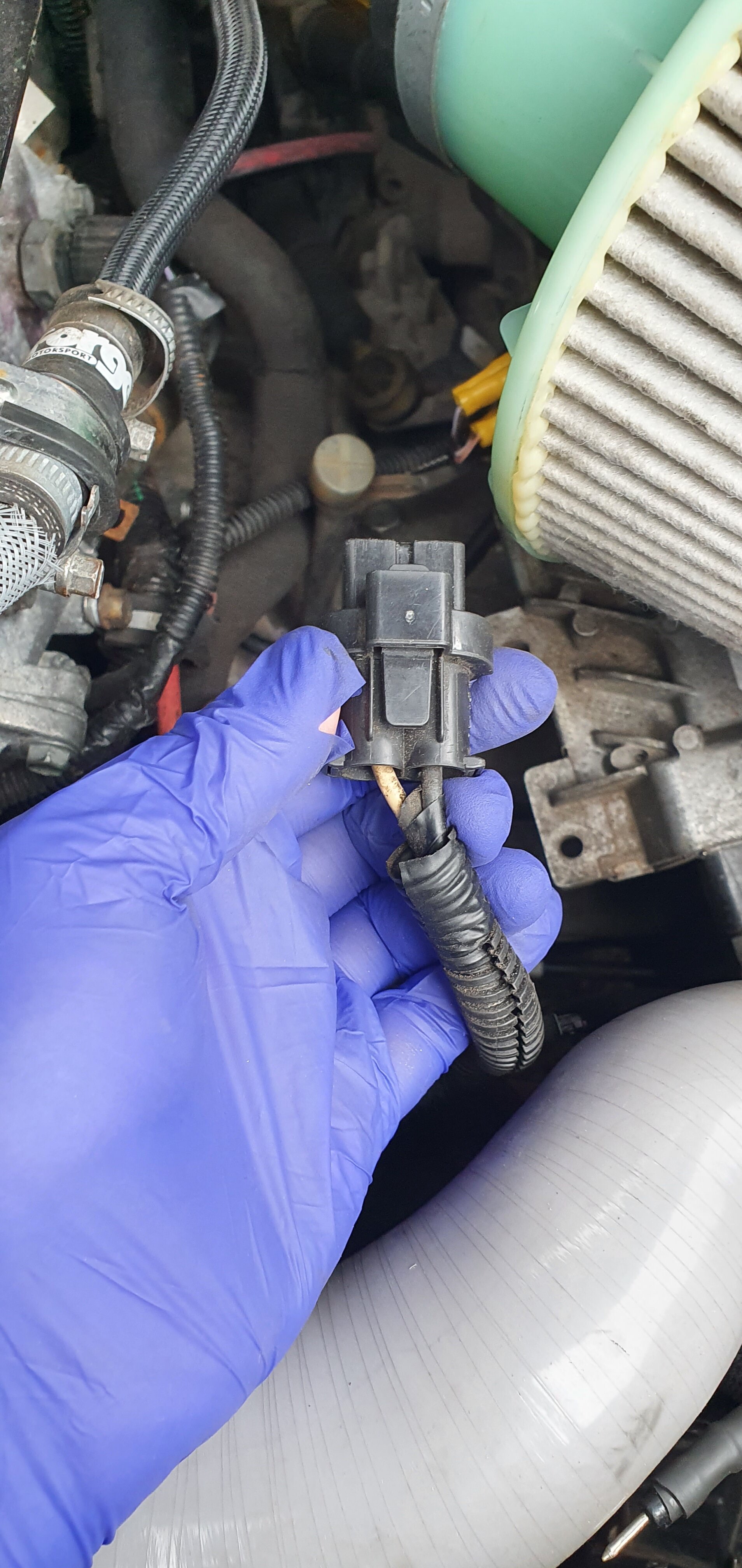

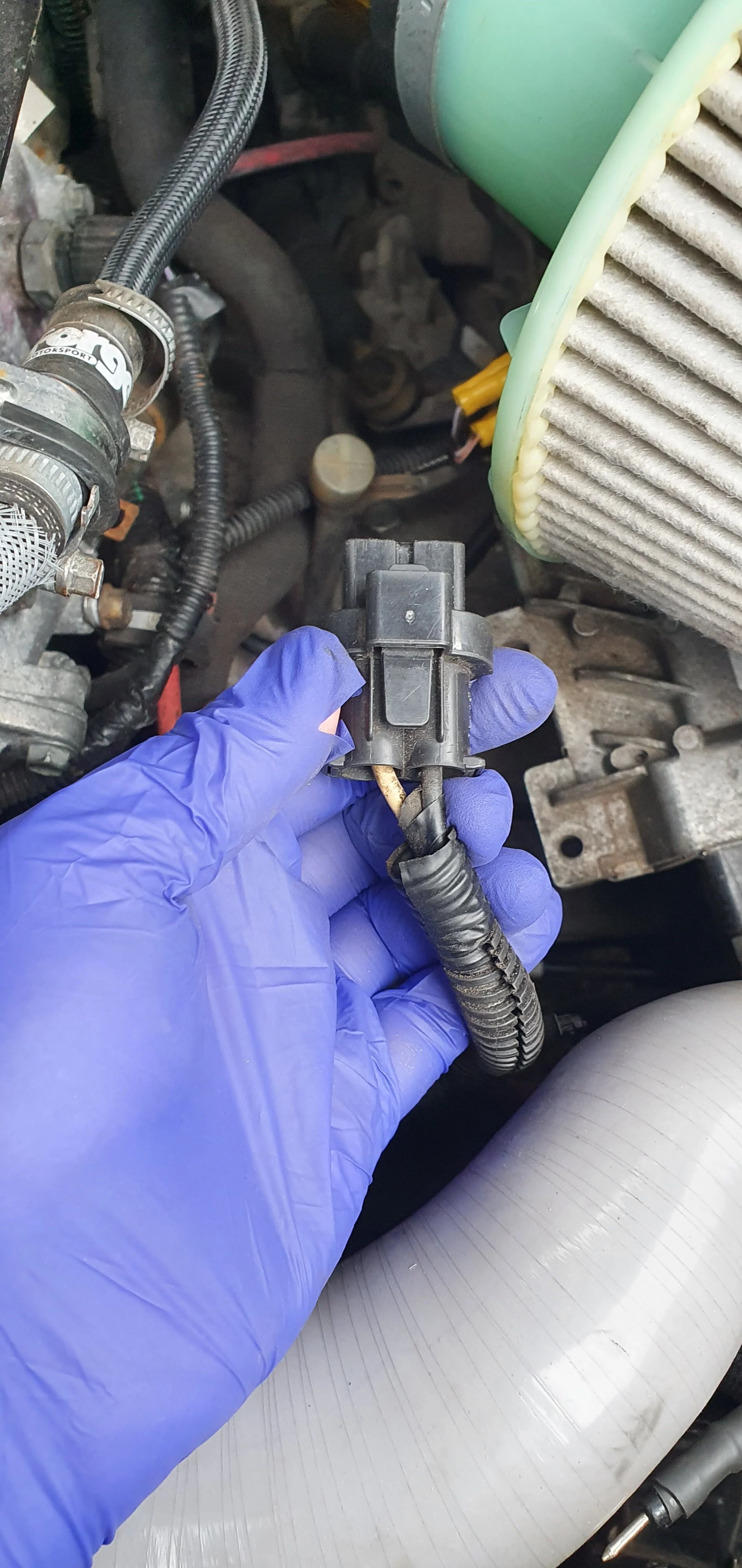

I woke at around 6.30 this morning with a thought that I may have wired something backwards. If the resistor and fan were plugged in the wrong way round it would be easy to check with the wiring diagram and wirings colours labelled......
Yep id plugged the fan wiring to the resistor pack, and the resistor pack wiring to the fan 🤦‍♂️
Anyway after diagnosing that I swapped them to find the fan was now running backwards, that was a super easy fix though, just de pin and re pin the connector and the fan was back to running the correct way. Funny how it ran in the correct orientation with the incorrect wiring lol. Checked with the diag kit on both both low and high speed request (all one speed as I have bypassed the resistor) with no more blown fuses (y)

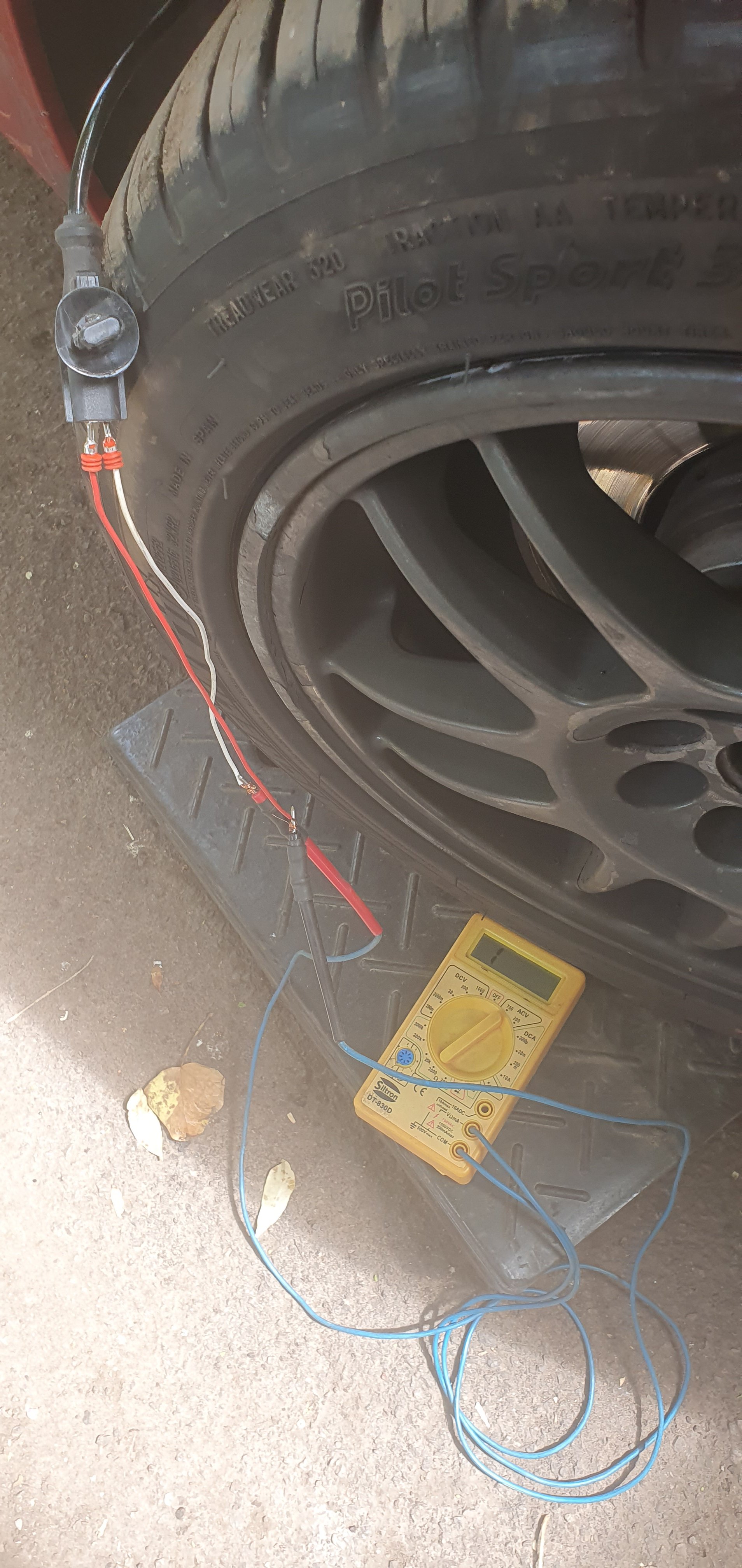

One more fault to fix with the abs sensor, which I'm assuming is all that is required but I will investigate and make sure this afternoon. Thanks for reading 😁

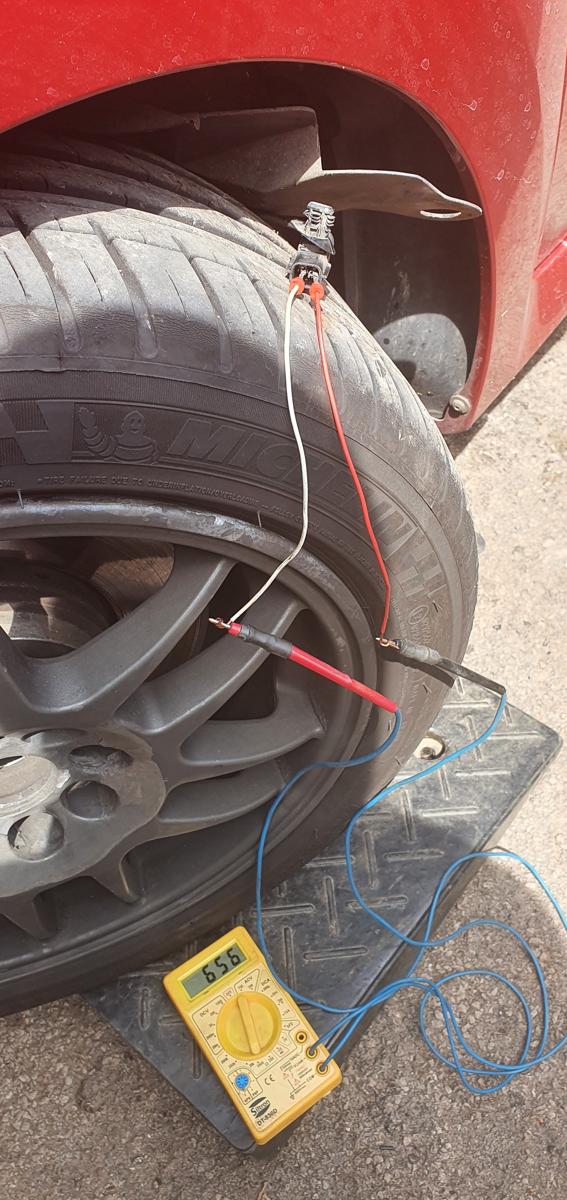

So final for this weekend I think. Abs sensors checked, I get a reading off the known good one but nothing at all from the dodgy one confirming I need a new sensor, so will get that ordered up 👍🏻

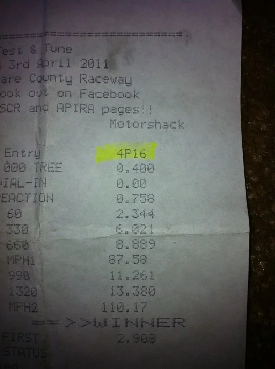

I also dug out a picture of my old SC Clio's quarter mile time slip from just over 10 years ago! Took a lot of Facebook digging to find it. This is my personal target to beat in the Twingo, both have roughly the same horsepower, the Twingo has loads more torque but the SC 172 delivered it a lot better and with more revs...

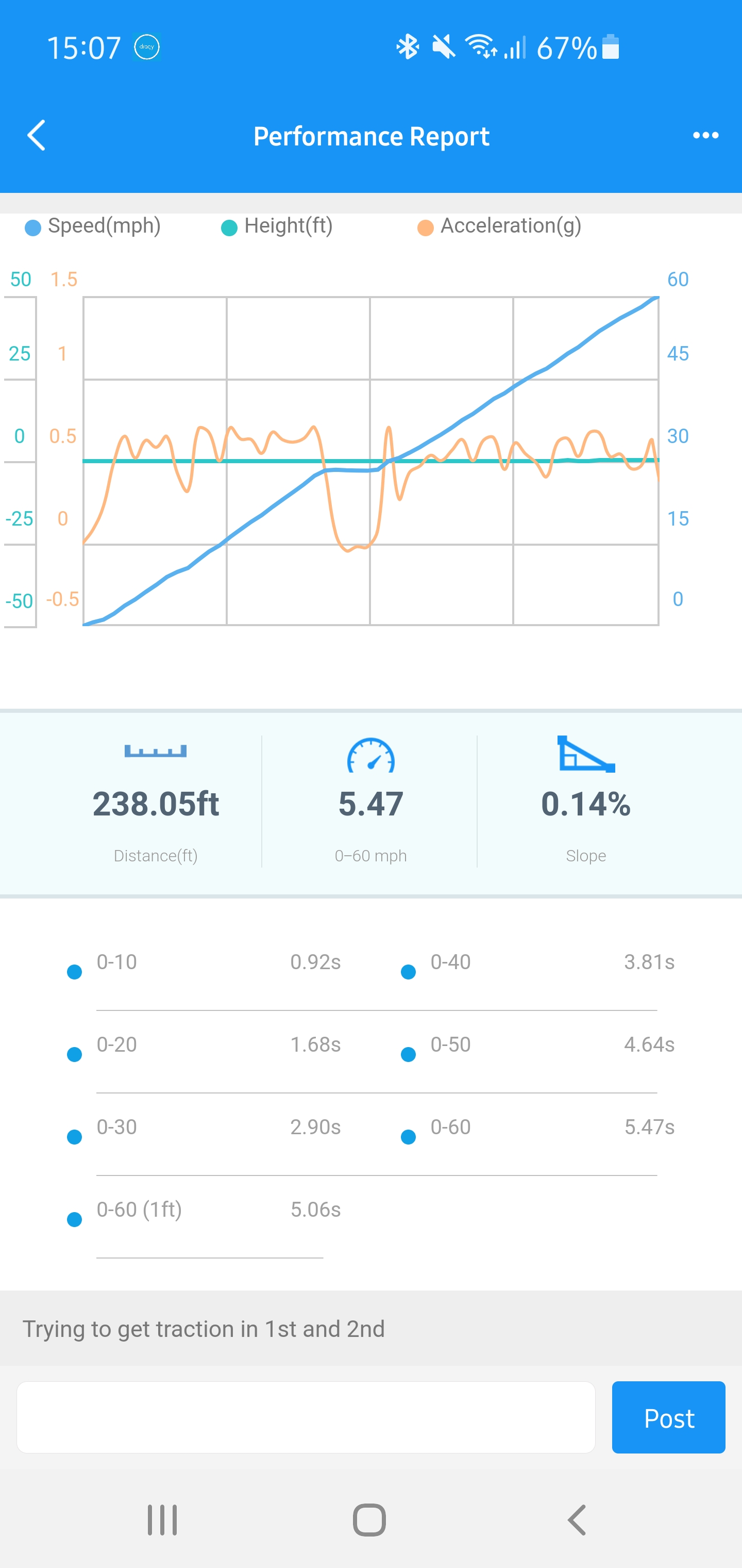

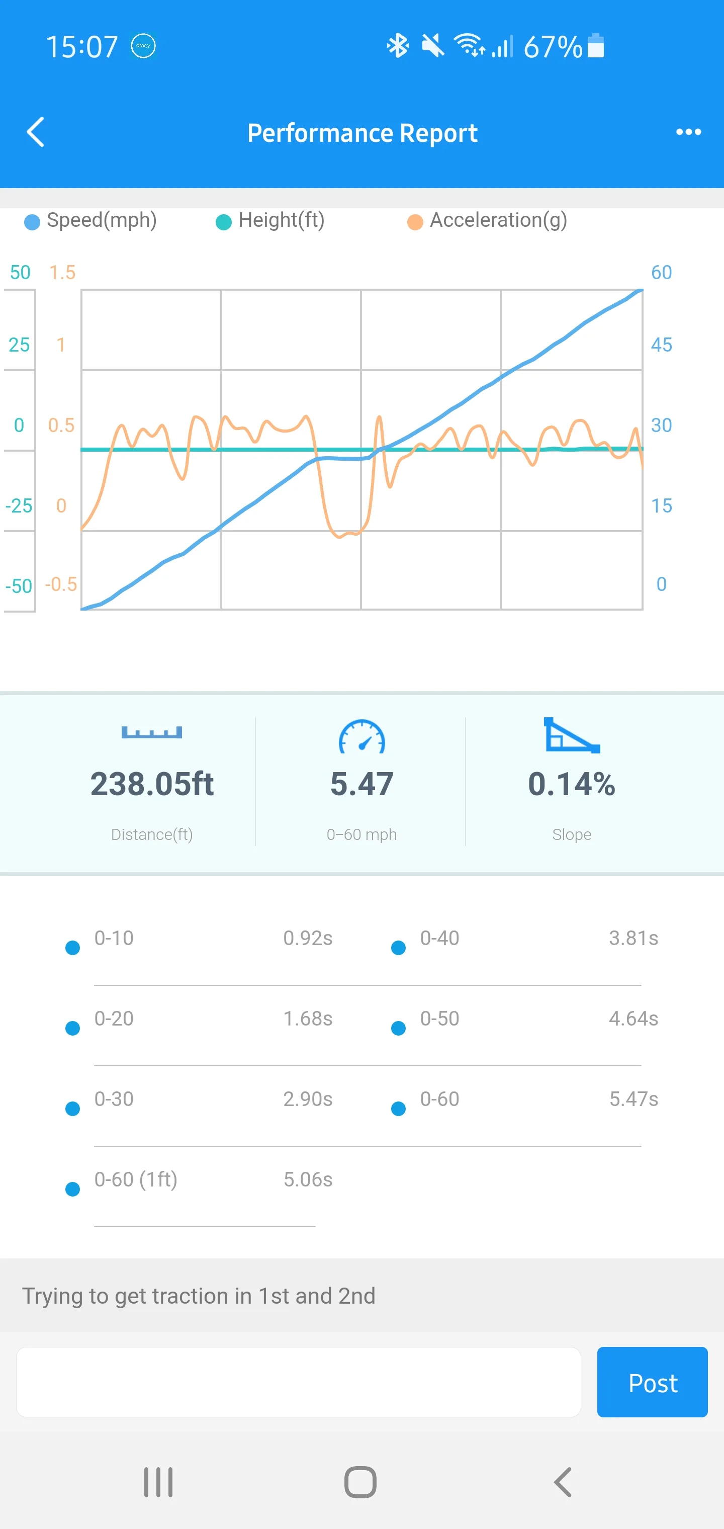

So had a little play in it today, nothing too mad as obviously stopping and sprinting to 60 on the road isn't all that fun. Wheelspin central 😂 that said Dragy clocked a 5.47 0-60mph and I can just clip it in 2nd gear. For comparison a new 4wd Yaris GR does it in a very similar time👍🏻
