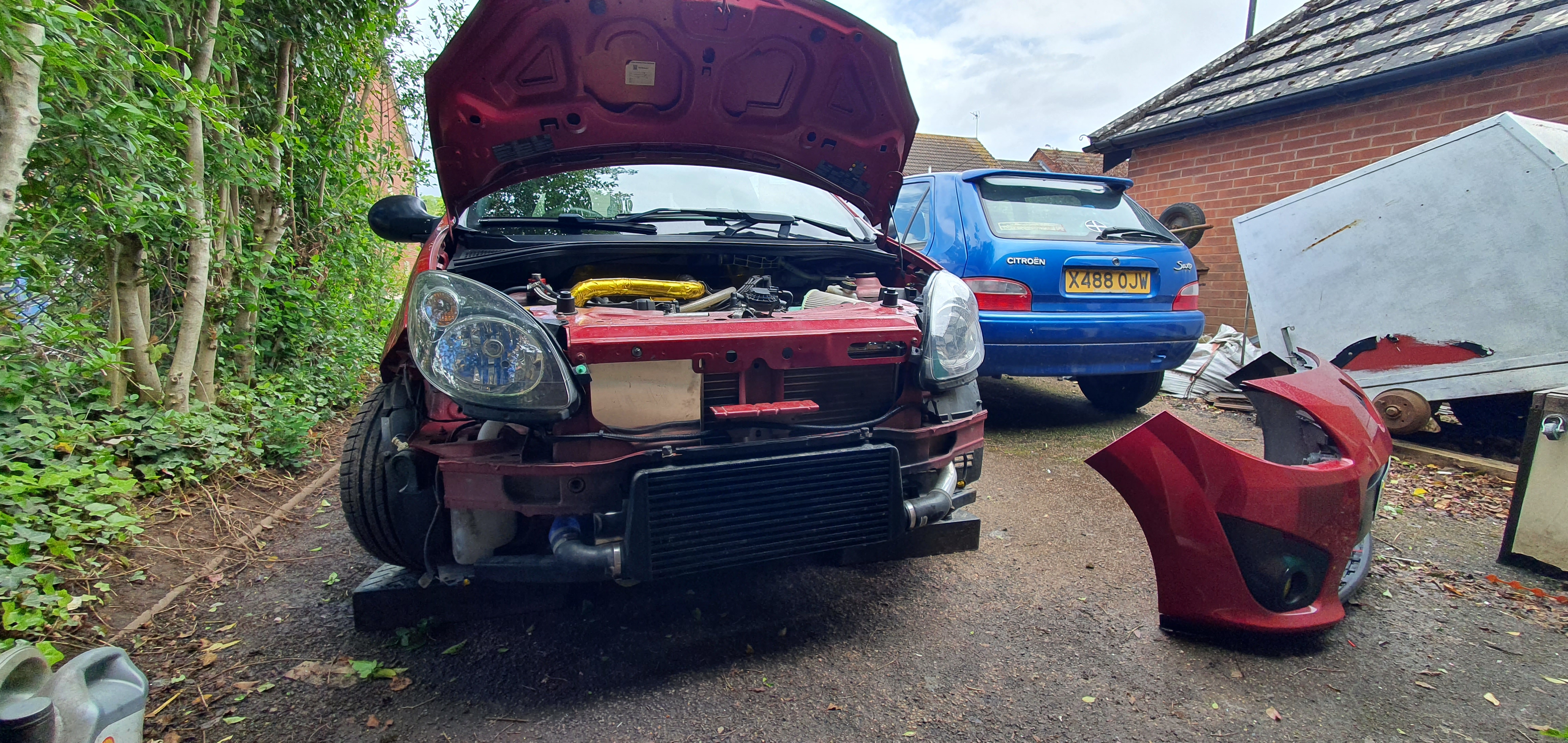

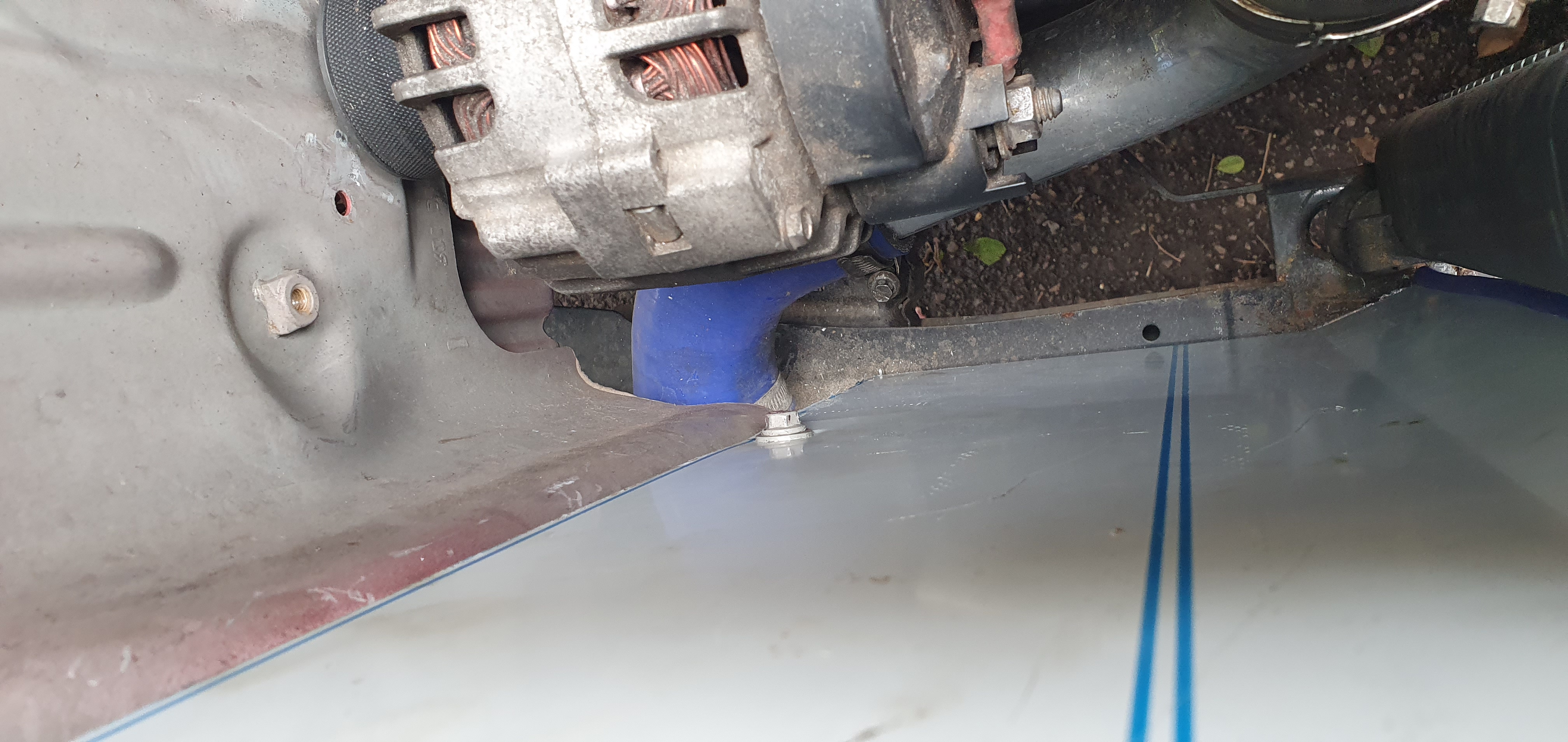

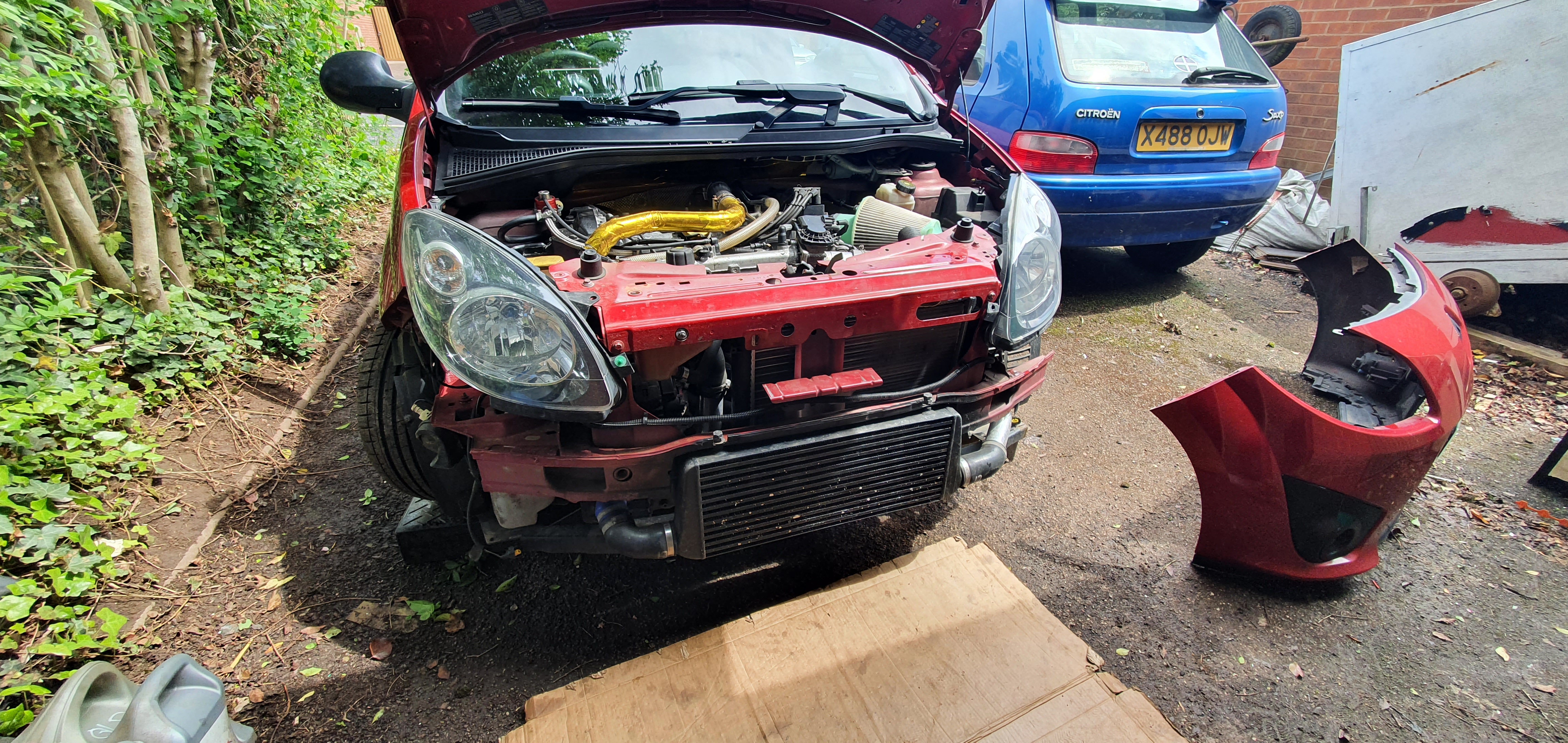

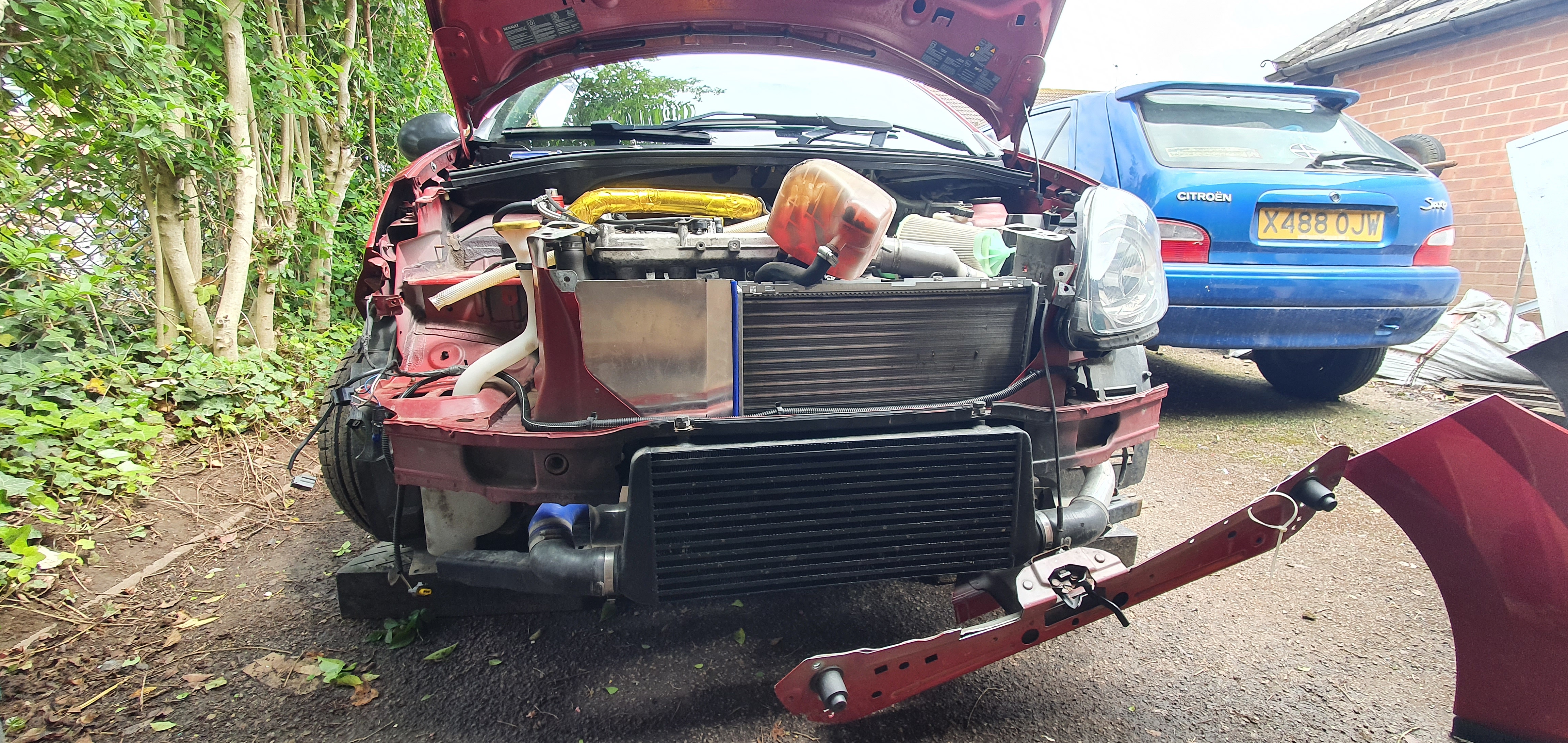

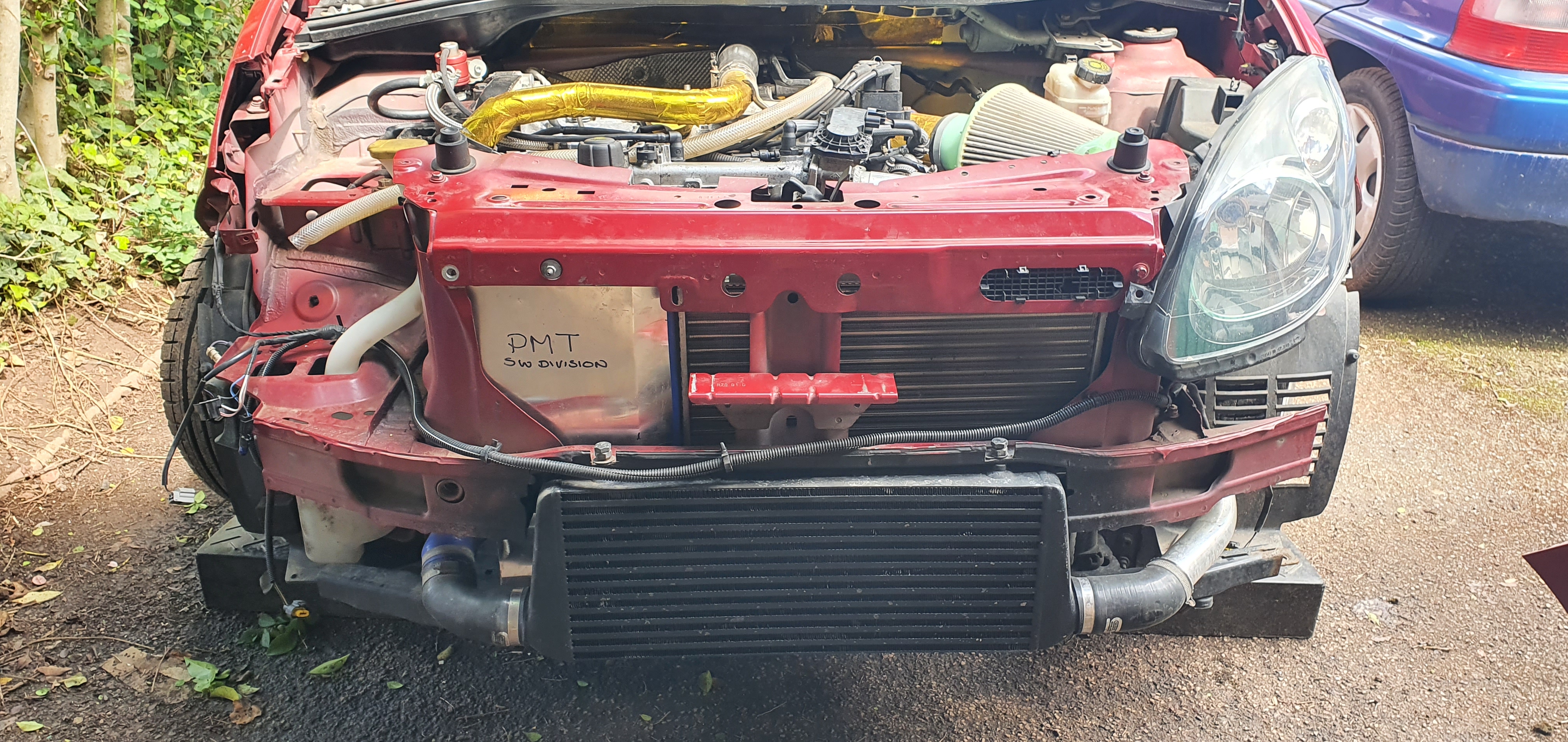

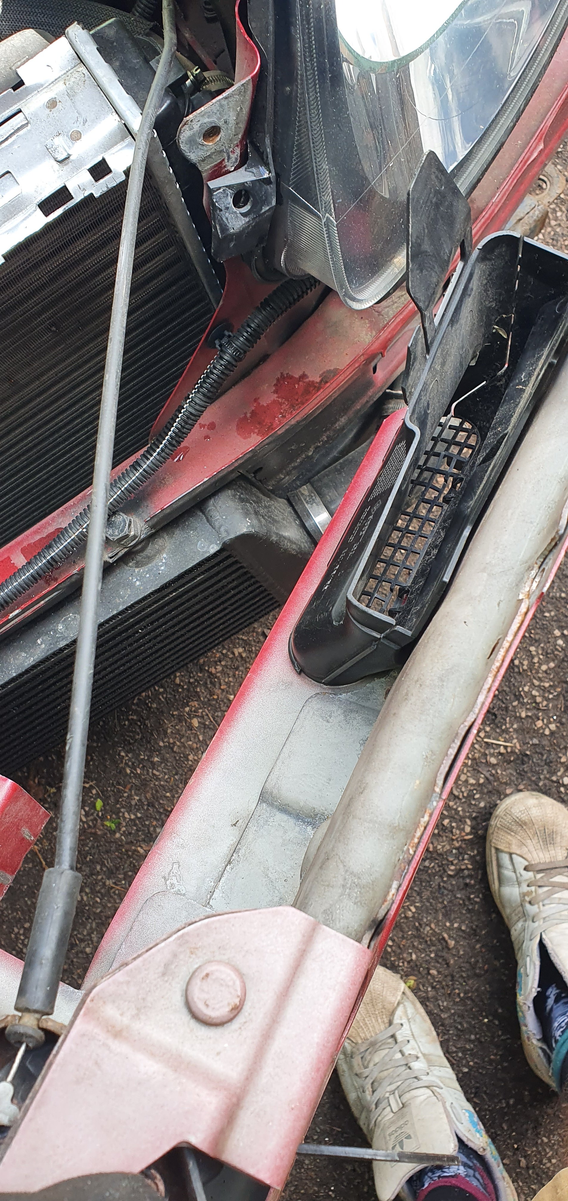

I think I'd already mentioned previously that I wanted to panel in the radiator just to maximise airflow through it and not around it. Quick bit of CAD then cut out of aluminium. Renault left a nice fixing I was able to use to hold it. Whilst the front was off I refitted the air scoop to the slam panel which grabs cold air and throws it over the radiator towards the air filter. Probably does diddly squat but every little helps 👍🏻

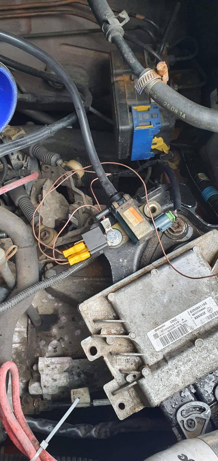

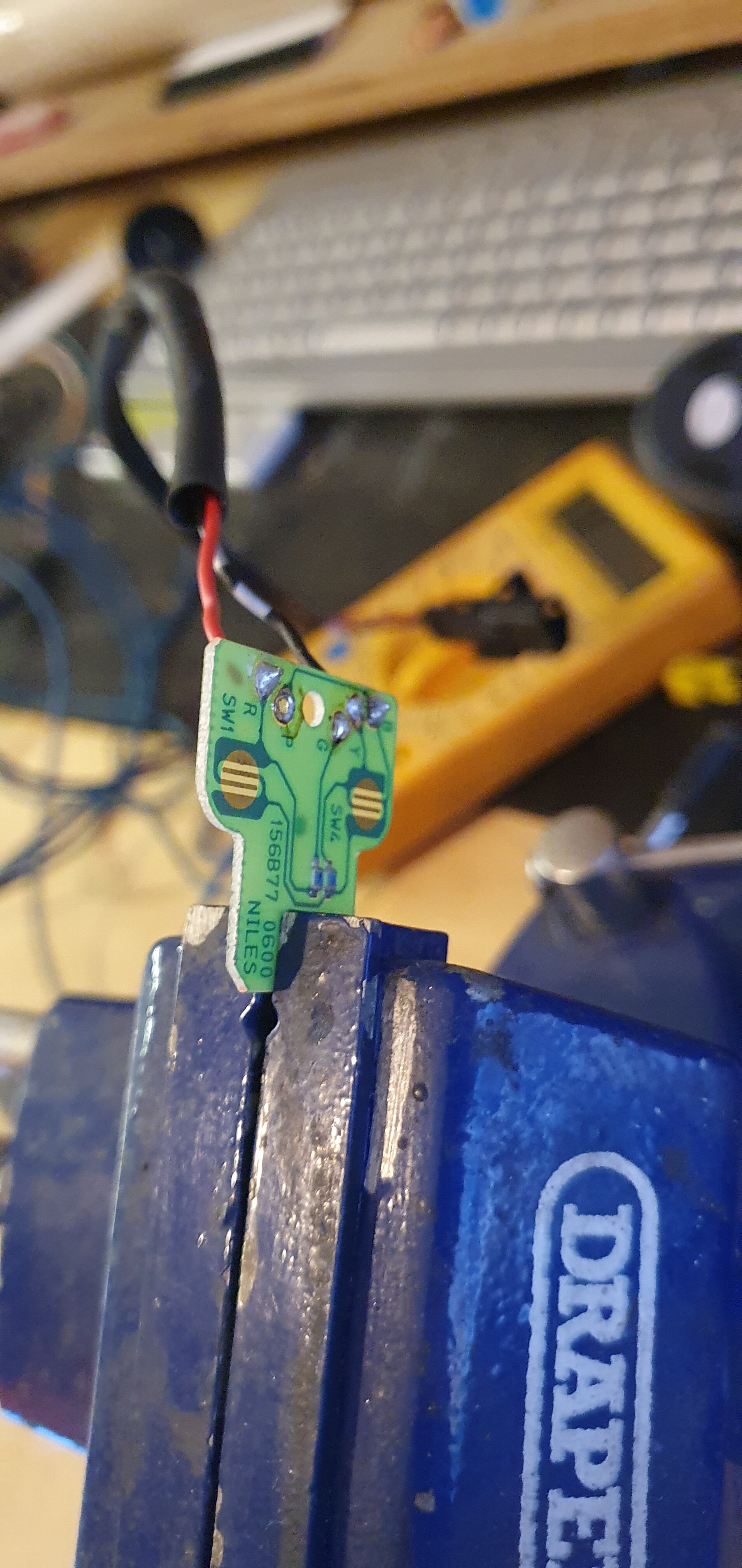

So I've been looking at ways I can limit power in lower gears. 300lbft of torque by 2500rpm, a light car and 15s is pretty savage even at light throttle. My car was mapped with open loop boost control meaning (haven't tested it yet) I should be able to close off/block the standard electronic bleed valves air bleed and run actuator pressure. Which in this car is around 200bhp. I wanted this to be switchable, so I could have high power on demand.

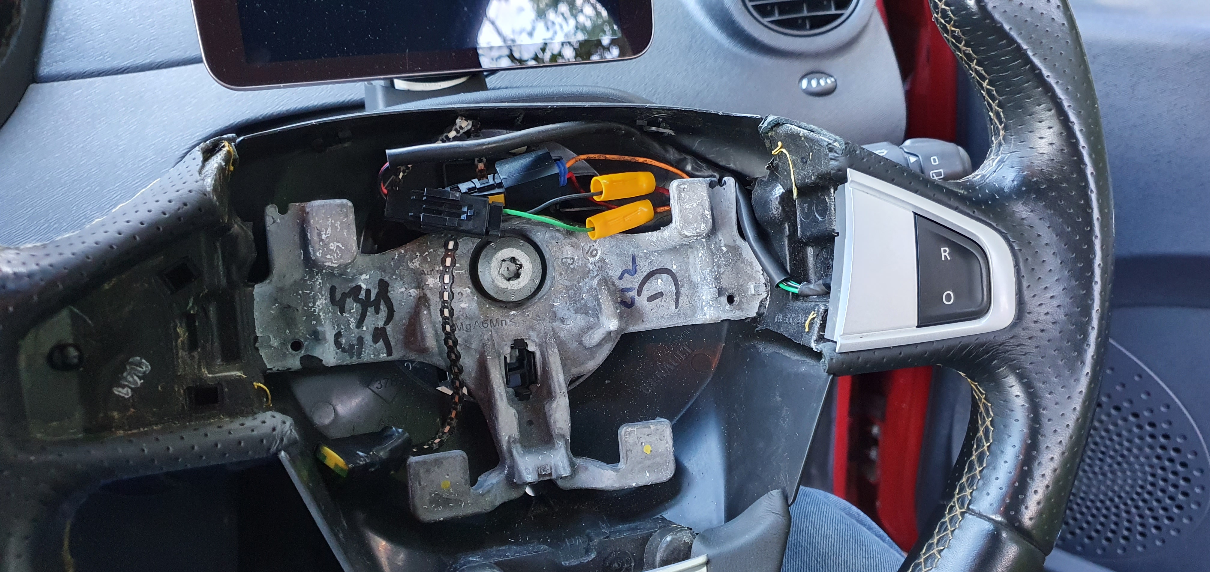

A quick rummage through my spares and scraps found an old Denso electronic bleed valve from my old Impreza and a spare relay. I found a nice spot in the bay to throw it in and set about wiring it up. The only part I needed to figure was the switching. As I wasn't using the cruise control switches I opted to rewire them for this so that it was easy to use whilst driving, no need to remove my hand from the wheel. Out came the soldering iron to do some reworking of the pcb's and I ended up with the buttons working as a normal open/closed switch.
I've not driven on it yet but it all seems to work electronically. In this setup I should now be running low boost all the time unless the steering wheel switch is held. I will add a further switch that will bypass this so that I can have full power all the time. This should aid me at the traffic light gran prix, and in wet weather (y)
If this all works as planned ill get back in and tidy up all the wiring, free control of the power, I could of probably just bought a boost controller off eBay and ran it on the vent of the electronic bleed valve but where's the fun in that.

Clever!
What about connecting it to the cruise control and speed limiter switch too so you can have it on high boost without holding the button?
Adey.
Clever!
My car doesn't have one..... but it will do soon. That's the other switch I mentioned that ill add in the future (when I get down the scrap yard :D) my car wasn't pre wired for cruise control, I only have the buttons spare as I fitted the meg 250 steering wheel. There's a blank in the side panel so it will fit nicely and once flipped will give full power in all gears without the steering wheel buttons pressed (y)
Adey.
WOW, works so well on the road. Boost comes in at about 5psi increasing with revs to 8psi then when you want some more press the button and 17psi fires in giving you all the powerz...... :D gets off the line so much better. Need to try some dragy times now.
