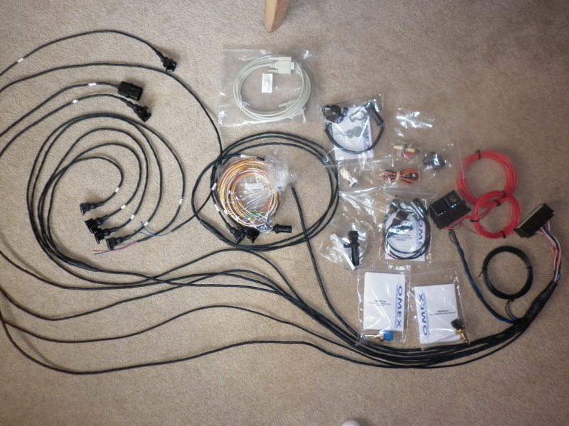

Just need to finalise which sensors I am going to use and get Omex to build a loom, then get Aeroquip hose and fittings for the fuel lines.

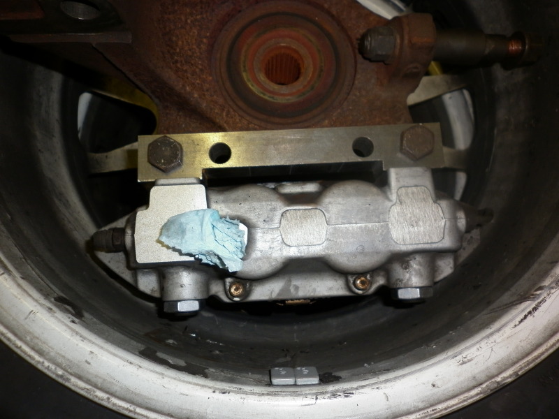

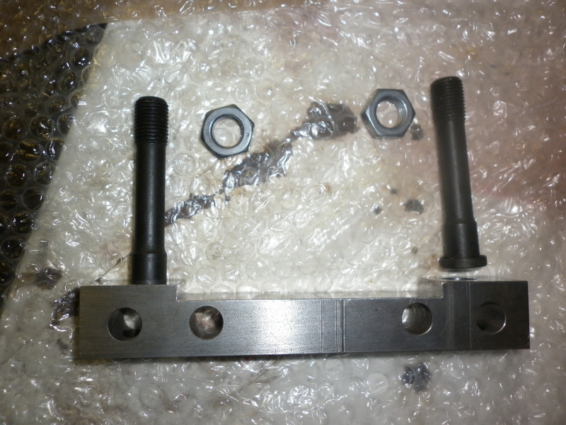

I also decided to just go ahead and get some 197 Brembo caliper's & custom mounting brackets.
I will test fit these under my 2118's (hopefully they work) if its not possible there will be a complete 197 Brembo set up or front pads and reconditioned/painted front calipers for sale.

Test fitted the brembo calipers, need some maching done to the caliper's and possibly some spacers to fit under 2118's.
Omex race loom with fan control, Omex sensors & zetec crank sensor & bracket. Crank signal splitter. Launch control button and full throttle gearshift switch & associated wiring.

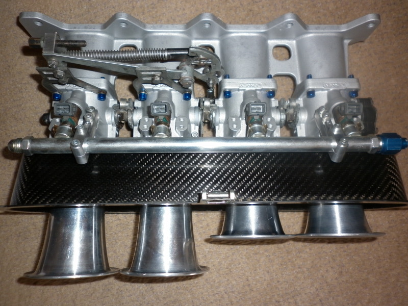

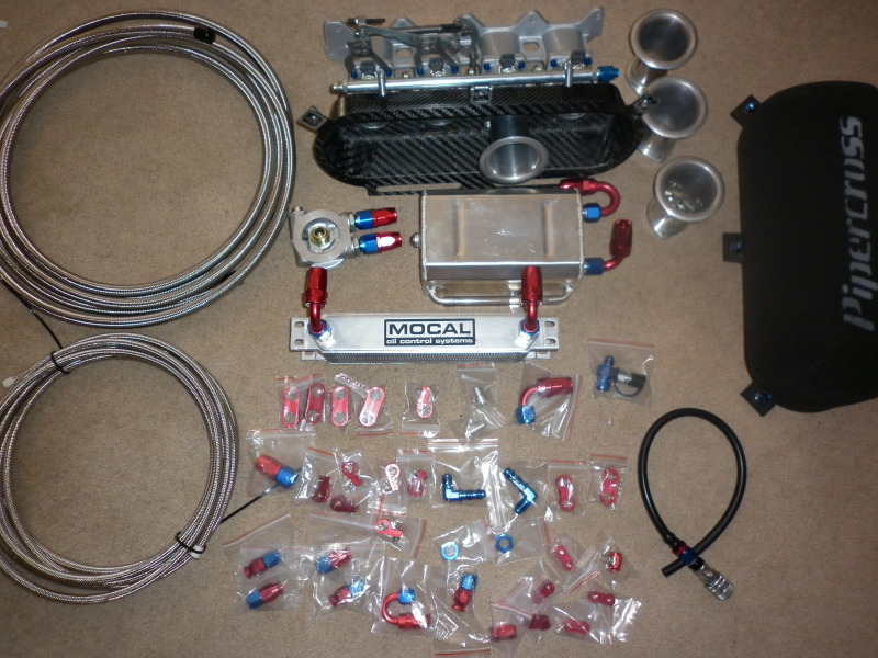

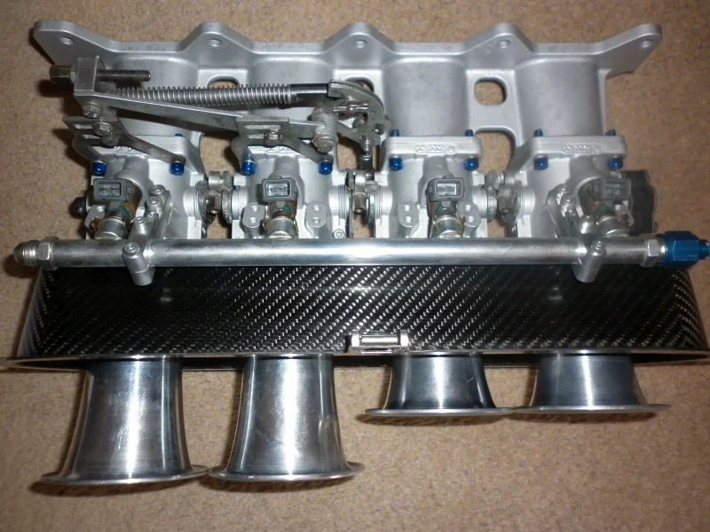

Decided to just go ahead and get 120's for my ITB's as the current airbox allows this.

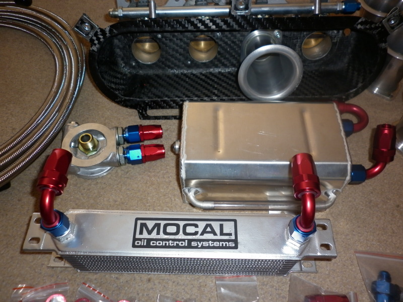

Some p**n in the form of aeroquip hoses and fittings for fuel, oil & breather lines.
Breather tank, oil cooler, filter take off.

Hope you don't have the same issue I had that some fittings and hoses are not compatible with each other. Very annoying!
  Cup In bits
Some nice goodies there! :cool:
Hope not, got an-6 teflon hose and fittings for all the fuel hoses and standard an-8 hose with a mix of fast flow and standard for oil cooler and breather system. Had to get x-over for Mocal stuff 1/2bsp to an-8
What was your issue, this is the first time I have used aeroquip parts??
  172 cup, Impreza P1
It was the 1/2" bsp to an10 fitting for the sandwich plate. It was too tight to push the hose in with the insert inside the hose if you know what I mean.
The an10 to an10 fittings for the cooler were fine.

And this lot from Jenvey FOC, cant recommend them enough, top customer service.

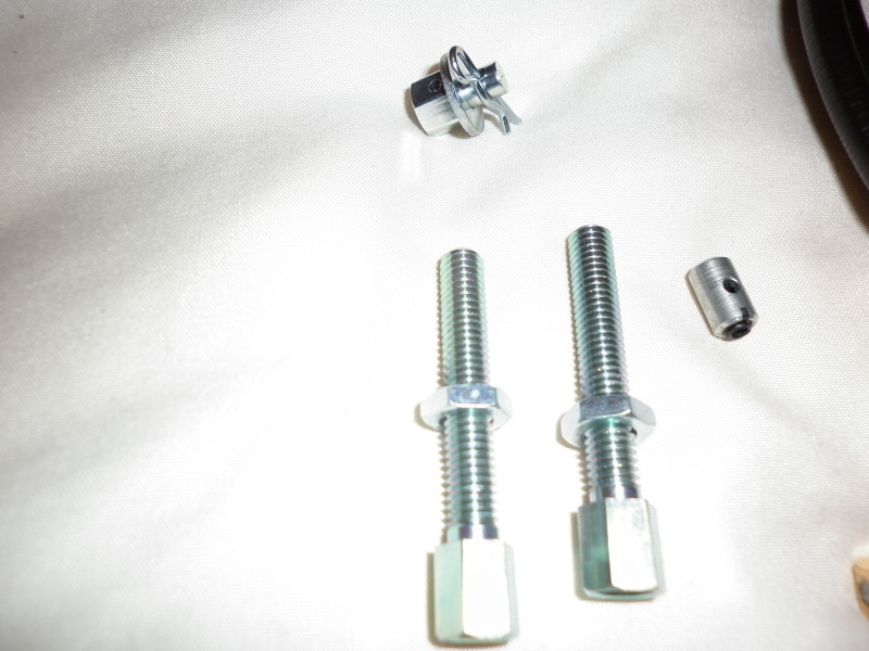

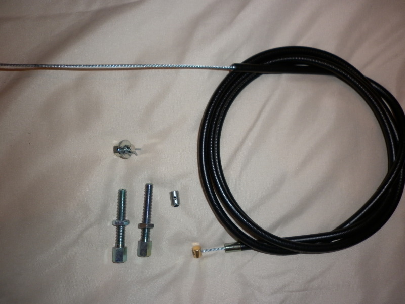

Good solution for retro fitting cable throttle for phase 2's. I had a search around and couldn't find any info on fitting cable and a few people just said chop phase 1 cable and fit a grub screwed nipple to the end, hopefully this will be better, cheaper to replace cable aswell if need be.
  Trafic 140dci
Don't fit the grub screwed nipple! If you are heavy footed you'll more than likely pull the cable strait out of it!
After a few PM's i found the best method was cut the throttle cable at the end that goes to the throttle pedal, get an electrical chop block, feed the cable through it before it goes through the throttle pedal, then through the pedal, then back through the other side of the chop block then do screws up if that makes sense? So much stronger, looks bodged, but it's brilliant.

Yeah I get you, alright idea that.
The pedal already has a nipple pressed on the cable at the bodys, they supplied a truneon that has a r-clip and grub screw to attach to the pedal and sent a spare grubbed nipple as well in case it comes of at the body side. Should be better but I will put a chop block after it for good measure.

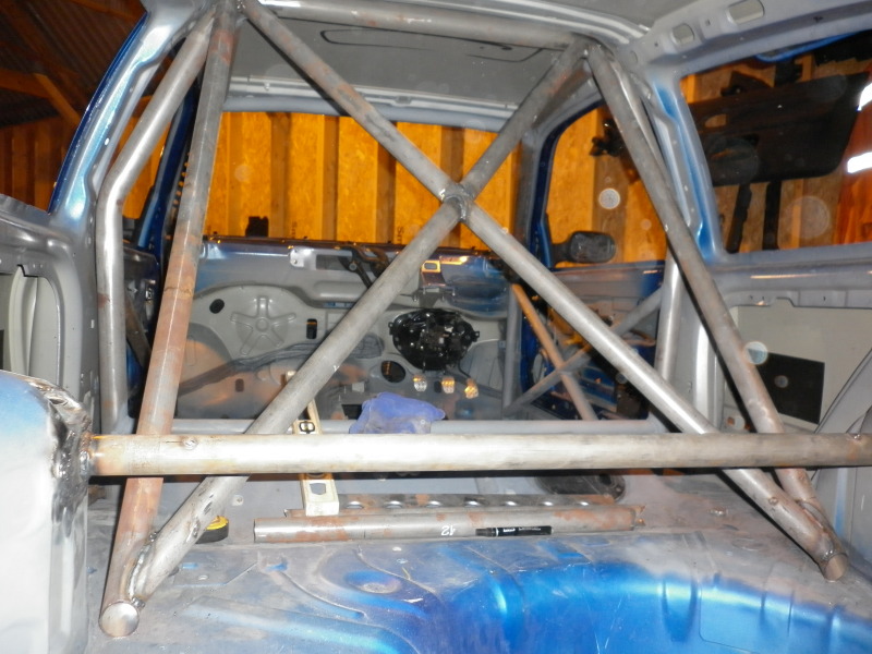

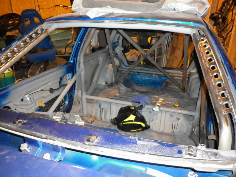

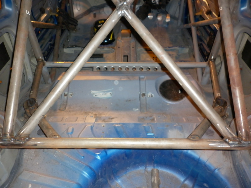

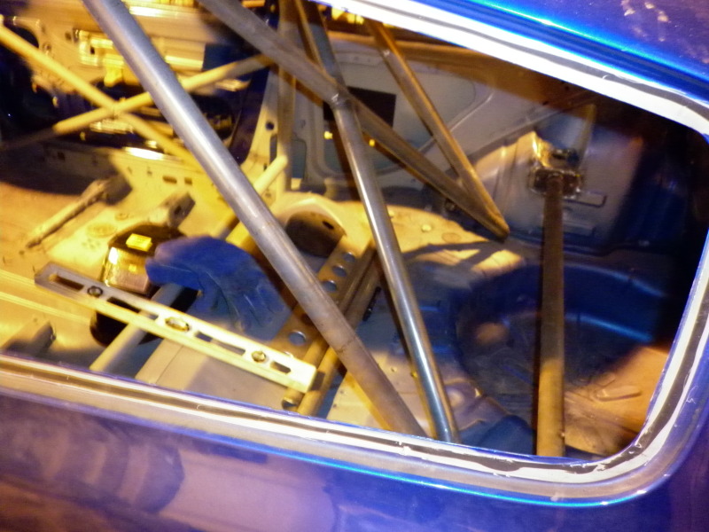

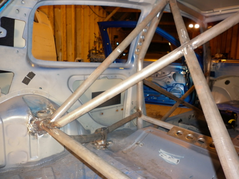

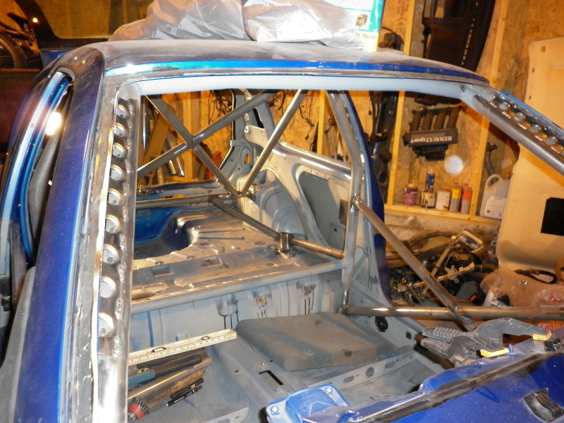

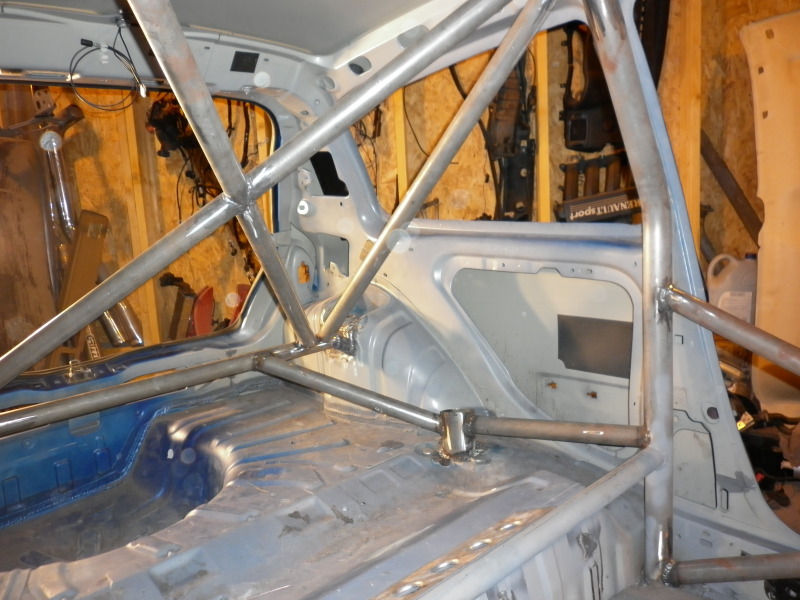

A few update pictures of the work I done yesterday on the cage. Still need to raise the rear cross onto the strut brace, fit door cross strengtheners, pick up the rear axle points, fit gussets to B pillars and front dash bar for A pillars.
More pictures to follow tonight.

Cage is looking good cant wait to see this once it's painted, have you decided what colour the inside is going yet?
  Cup In bits
Aye me too, Id like the same sort of colour as yours, always liked cars with gun metal interior. Only thing that puts me off is cost, sprayers up here are shocking.
Do you find your interior alright, white can be a bit blinding!
neil a
I don't find mind bad at all for glare and it doesn't seem to show up marks easily, I might paint my cage blue at some point.

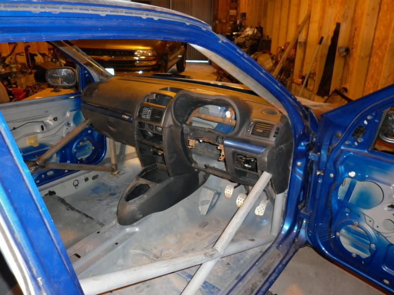

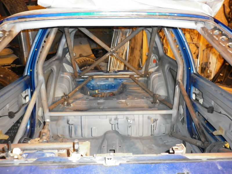

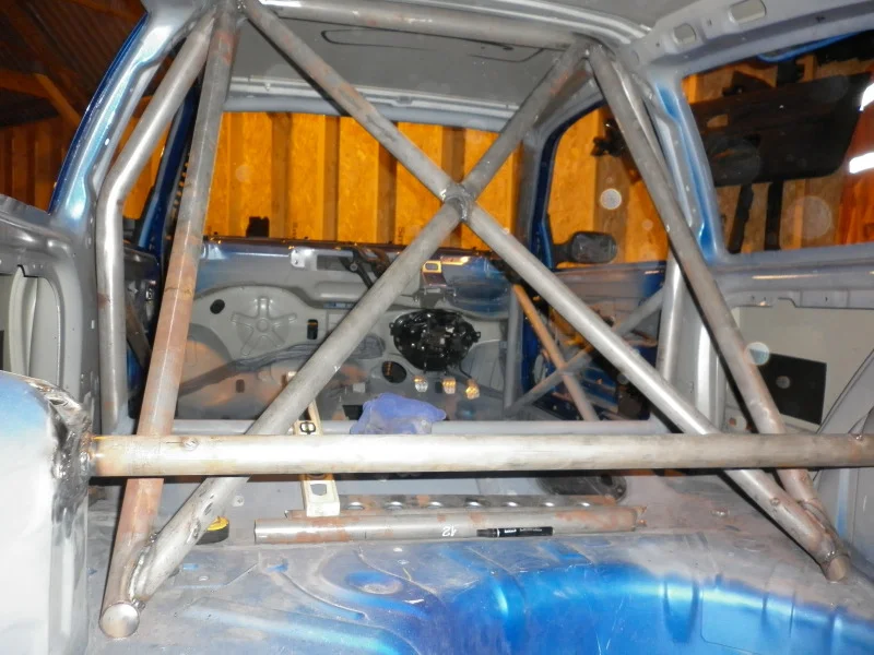

A few more of today's work, trimmed and test fitted dash.
Almost finished cage, no more fabrication, just some door 'x' gussets and seat rails to weld in then clean and prime everything.

Looking very nice mate, would be good to see it this year! :D
Cheers, I will see how this month goes, hoping to have it running and moving and then it will be painting and tidying up....Knockhill in winter tyres!!! :p
