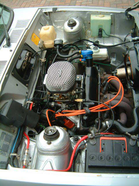

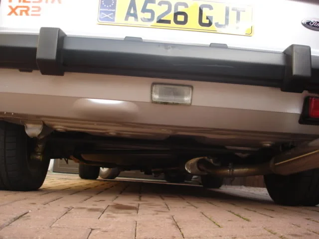

Just found an old pics of my mk1 Xr2 I thought I would share, biggest regret I have selling this.
All original panels 54,00 miles from new.

Gotta love the old fords Ash, Escort mk2 mexico is next on my retro ride list or any of the special editions, harrier etc.

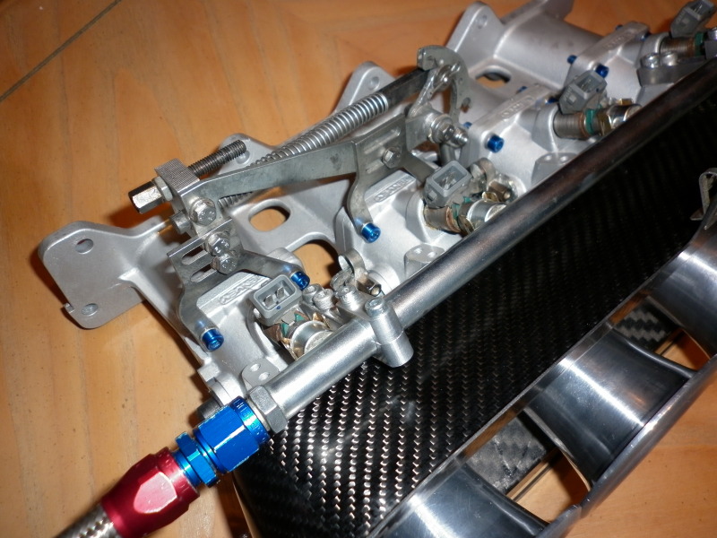

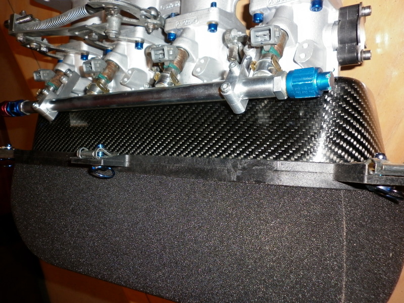

Nice work on the inlet .
The xr2 looks stunning , did you end up selling it o a guy in Aberdeen with a CSL.
No I bought it from Paul who now has a CSL amongst other things, did you know the car? It got sold to a guy using it daily from Peterhead to Abz, will be fu**ed now.

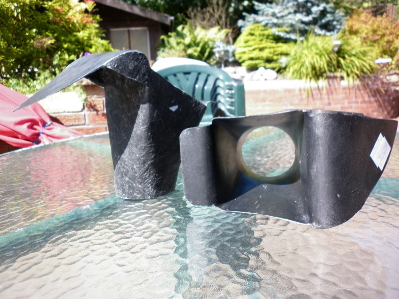

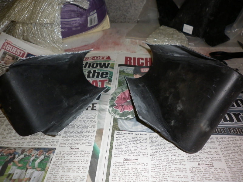

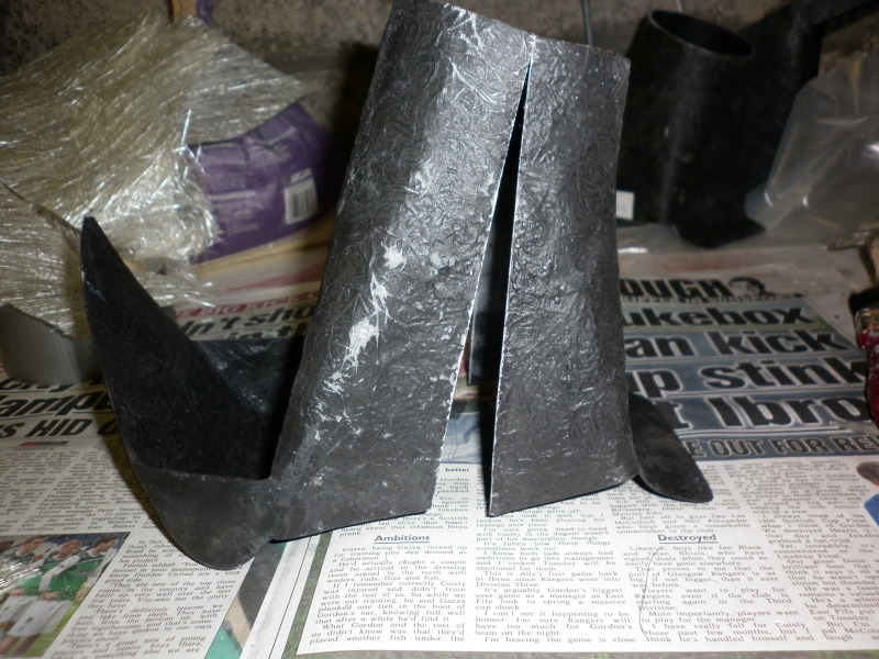

On the plus side my 2nd set of brake ducts have arrived, the quality is worse than my 1st, I have seen new born's that could do a better job than Renault Sport with fiberglass, you would think they are modelled on a written off car. Anyway a half decent fit should be found from the 2 sets.

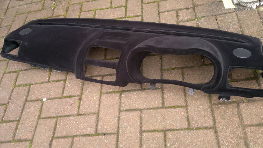

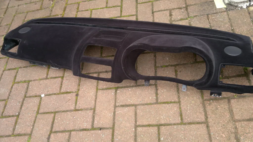

Quick pic of my flocked dash, few marks , not ideal but a professional flock job. I will use the original to cut up as a marker for this one. Im not looking forward to that.

Tony, I know I know, the fit is just so different from one side to another surprising a large manufacturer such as Renault would send out such poor quality gear
  182cup & 172 racecar
Made by some hairy arsed onion sniffer up a dusty mountain road. Did they come with goat poo and chicken sh1t.
They are shaped like that, so as to collect the air that runs across the bumper, be surprised how little air goes directly in from the front.

Yeah I understand why they have a bulge on outer edge as the air would just wash by with the likes of the standard surrounds with fogs removed. when you seee pics of the Rsport promo cars there immaculate.

Another little update, couldn't be ar**d with the car today so decided to rebuild the trumpets, looking brand new again with some new bolts, paint and elbow grease.

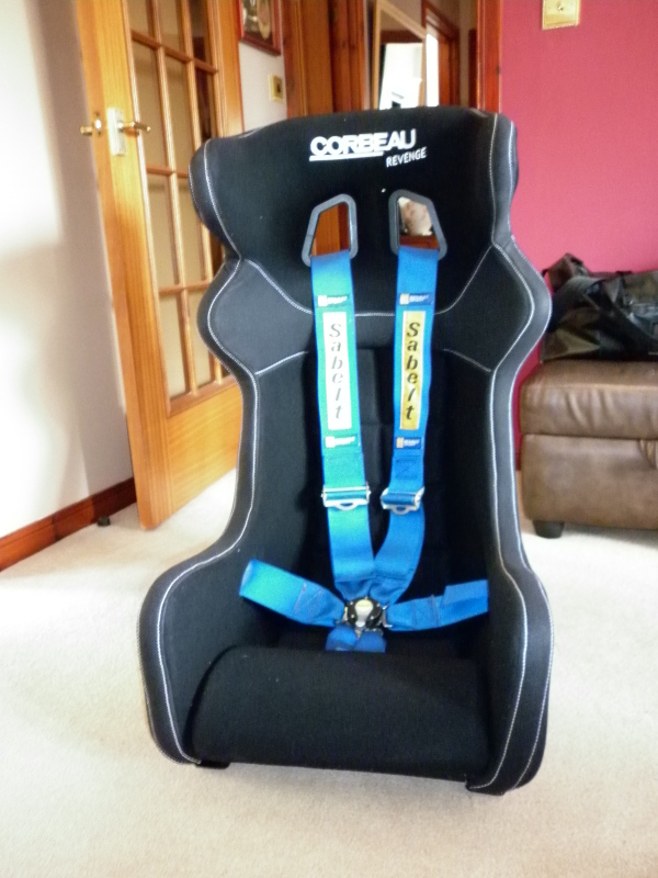

Sent back my Circuit II's today and will be getting the 2012 Corbeau Revenge XL's hopefully there a better fit this time.

Not had much time to get anything done on the car but received a few more parts, namely seats that I am now happy with.
2012 Corbeau Revenge XL along with some renault sport sabelt 6 points.

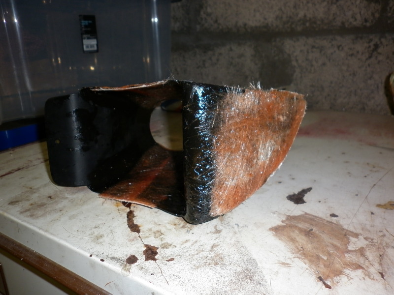

After getting another set of brake ducts to find a better fit, where as I can actually attach them as designed, they were the same rubbish fit on the n/s so I decided to get busy with a hack saw and fiber glass.
Split it in two and fiber glassed 20mm wider at the front and added to the side piece,sanded,body filler, sanded and test fitted tonight. Some adjustments and it will be areet. pics to follow
When people say the cup racer brake ducts may need some adjustment, there not kidding, basically rebuilt the n/s one

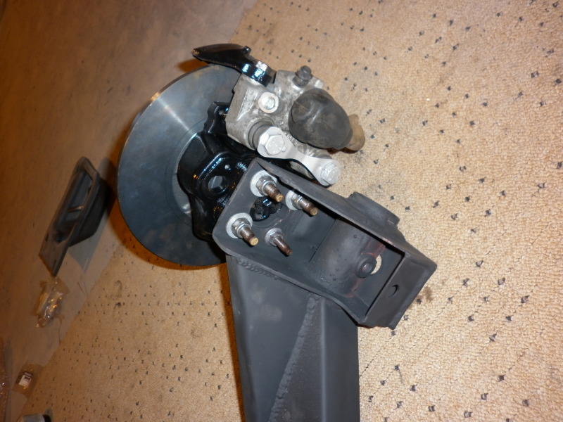

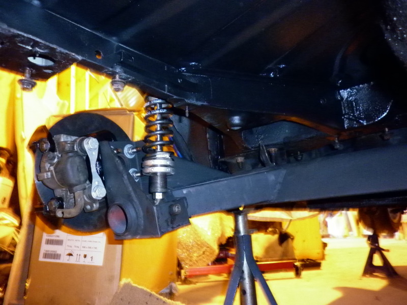

I have been struggling for motivation recently to get on with things on the car but after my trip to Knockhill at the weekend to watch my mates in the scottish minis & saloon cars, I see what Im missing. So with my oncoming trip to Jordan only days away I thought I better get something done.

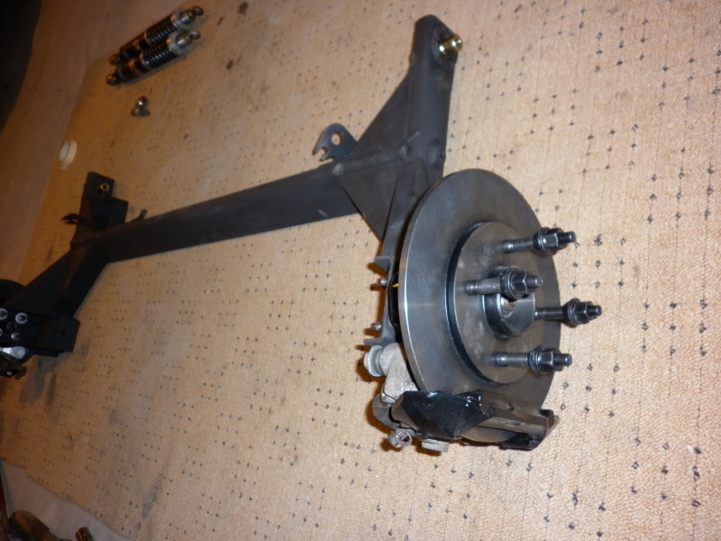

I wanted the car as a roller before I left so I set about finishing the axle, mounting h/brake cable holder and brake flexi mount.
I then painted the axle in red oxide and some black VHT, before anyone says I know its meant to be cured but is pretty tough without it and I ran out of stonechip.
Built up the axle with my painted stub axles I done a while back new disks and bearings/hubnuts, stub axle nuts, pure motorsport bearings and stud conversion and cleaned any bolt that looked tatty.
Turned out quite well, I was going to get it powder coated but decided against it so I could carry on.
I then stripped my rear coilovers, cleaned all threads and rebuilt with loctite in crucial places and greasing sperical and ball joint mounts
I then had my mate come round to help, these are really fiddly especially on the drivers side where the bolt is far to long to fit with tank in place so I shortened bolt enough to where I can remove the axle with tank In place.

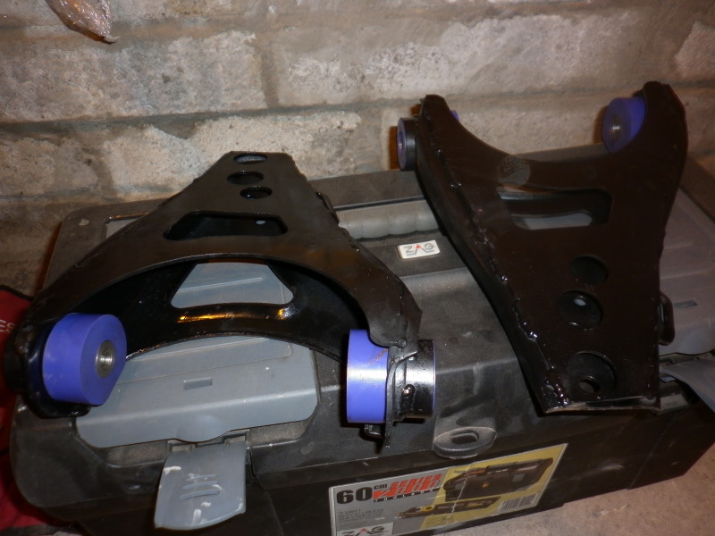

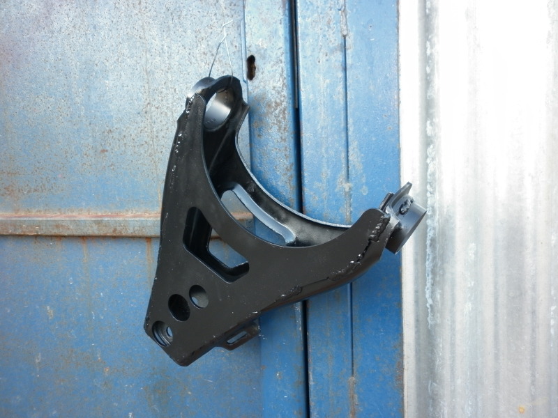

I decided not do anything with the cage and then made up my spare set of lower arms until pure motorsport release there adjustable arms.

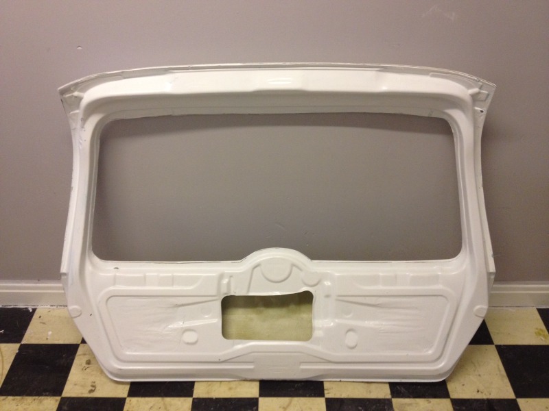

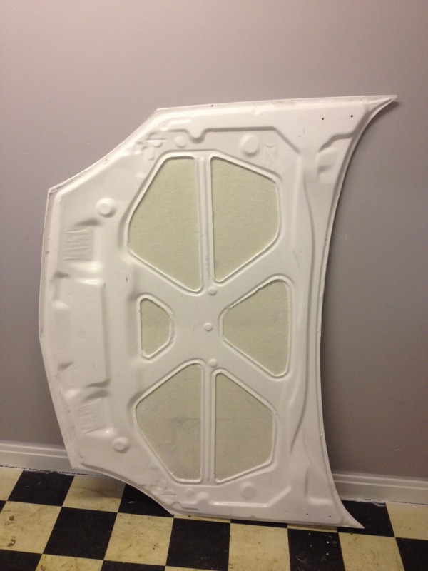

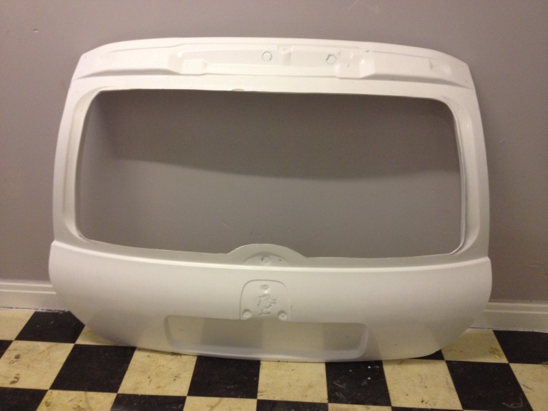

I had been thinking about lighter doors, bonnet and boot but decided doors were most likely to get a whack when racing so decided on these for justnow, will arrive next.
Look to be really good copy and I have been assured no adjustment needed to fit.

Does the kit for the rear beam include the parts to put the lower shock mount into double shear or did you make that your self?
I'm still in two minds what to do with the rear beam on mine, tempted to leave it apart from doing the shock mount and then see how I get on. I've got a spare beam so if I decided to I could fit the kit to the spare and then swap, that way I would be able to tell first hand what difference it made.

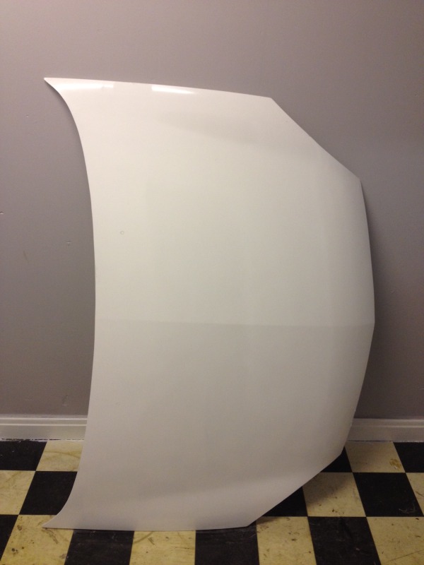

Where are you getting the fibreglass panels? Do they quote what weight they are?
  Cup In bits
Yeah the PM kit comes with plates to beef up shock mount, decent kit, needs minimal fettling to fit. I just went for it as I have heard that cup racers have been known to have loose rear ends with slicks fitted so should stiffen things up nicely. Setups are also known to need reset after a race so these axles are really like cheese as standard. Also custom brake lines have to made but that ain't no biggy and it gets rid of the flexi before it goes into calliper.
I got the bonnet and boot from a guy on here that does rally cross, no ideas on the weight saving but at the price I had them for anything will be good, will weigh them a post findings when I get them. seller said they are a good bit lighter.
