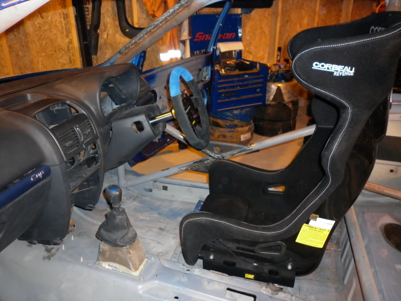

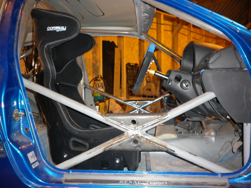

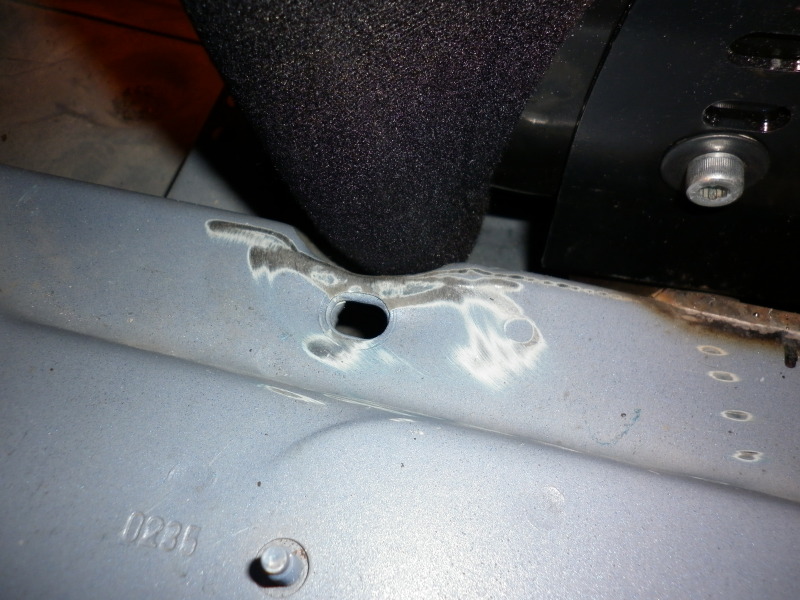

Not much to update today, got some tabs welded to cage to secure dash and finalised and fitted seat.
Seats are so tight I spent all night pi**ing about, had to make an indent in the exhaust tunnel.
Corbeau XL revenge's are not meant to be fitted in a clio, total nightmare. I had to compromise on the final seating position.
Anyone who has done the gear selector mod, how much distance can you get the stick to come back??? I need a good bit otherwise it's cut out the selector and shift the whole lot back.
  Cup In bits

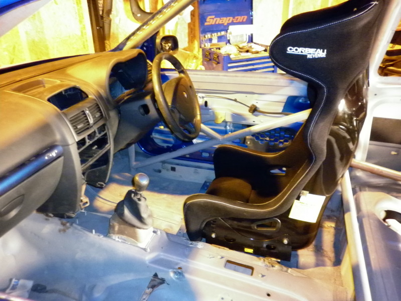

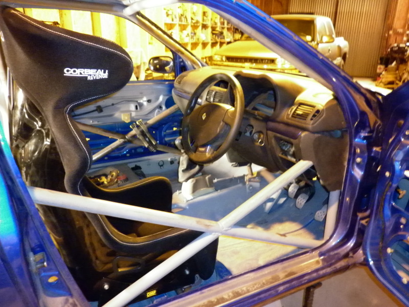

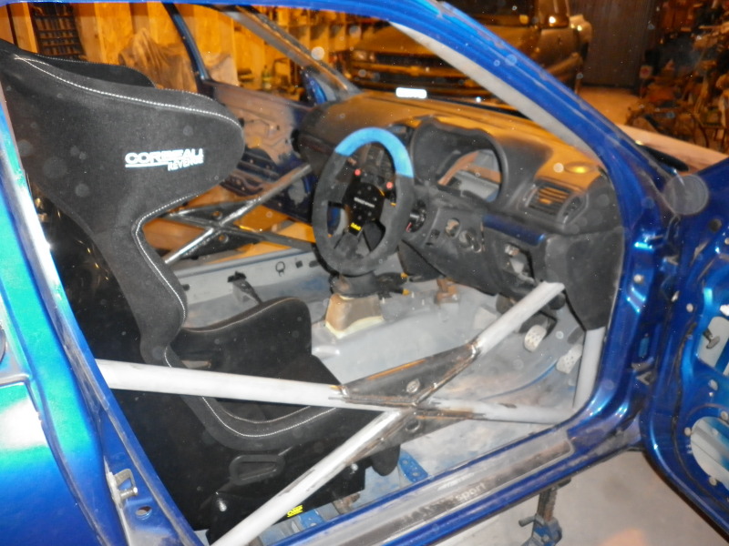

Few more from today, got some harness bars in which I totally forgot about.

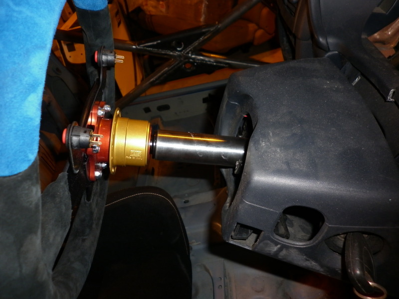

Had my mate make up a steering extension at work today so I could finalise seating position.
Seating position all set, loving it (A la touring car...steering wheel up in your face)
Also drilled and swaged my door gussets trimmed and welded and that's a days work lol.
I dont pity cage installers, hoor of a work.

Looking really good! Love the seating position.
Do you feel the gearstick will be too far from the wheel?
  Cup In bits
It's hard to tell just now untill I get the linkage attached to the box, I have a yanoo fast road shifter that's about 40mm longer than standard and shortens the throw plus I can shorten the linkage to bring the stick towards me. Hoping that's enough, will know when the engine is in.
I was hoping for a seating position similar to big ash's car but its just not possible with my cage/seat design, it's big enough for my lanky 6'2" frame but not ideal.

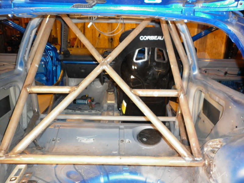

Coming along nicely mate.
I have a similar shaped dent in the side of the tunnel on my car ;)
On the cage tie ins for the rear beam, i'm sure you've realised the angle those tubes are at is relying almost solely on the strength of the tubes? ie you cant really get any triangulation on them.
I thought about trying to do something similar on my car but decided the extra weight vs benefit wasn't worth it, be difficult to measure or otherwise know if it's helping to stiffen the back of the car up but I guess it cant do any harm.
Yeah my seats are far too big for a little Clio, I should have really brought the main hoop on the cage back in heindsight, not the designed way of the cage but then I have went and totaly re-built the rear setup so wouldn't have been too much a problem.
Yeah I do realise is not the best possible design to secure the axle pickups but without having a spiders web in the back of the car, my solution was the best for weight and strength I came up with to tie in the axle while also tying in the main hoop to the rear 'X'. I got a decent angle on the pieces coming from axle pick up to rear cross so it will also provide a good amount of protection for a side knock which is why I done it to start with. The strengthened axle was a worry it would tweak the shell if it took a hit but I think it will just bend axle mounts or slightly more inboard on the axle, the pice that holds the torsion bar, seems the weak link with PMS axle kit.

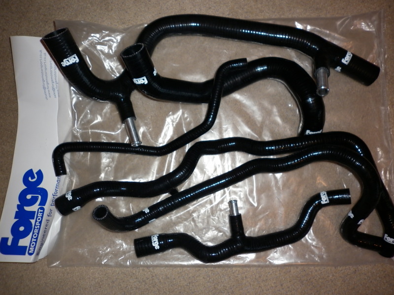

These also turned up along with more aerocatches for the fiberglass boot and another set for the bumper, brake pipe to plumb up my back axle and loads of other sundries to complete everything. My list of needed bits gets bigger the closer I get to completion, the amount of small pieces you overlook or I did anyway while doing a build is crazy. Just waiting on mikalor clamps for hoses now for the engine.
So that's everything I can think of that I need to get the engine freshened up fitted an vitals plumbed in.Ordered some inner track rods as well, as their showing sign's of wear and I cant be as**d doing them with the engine in.

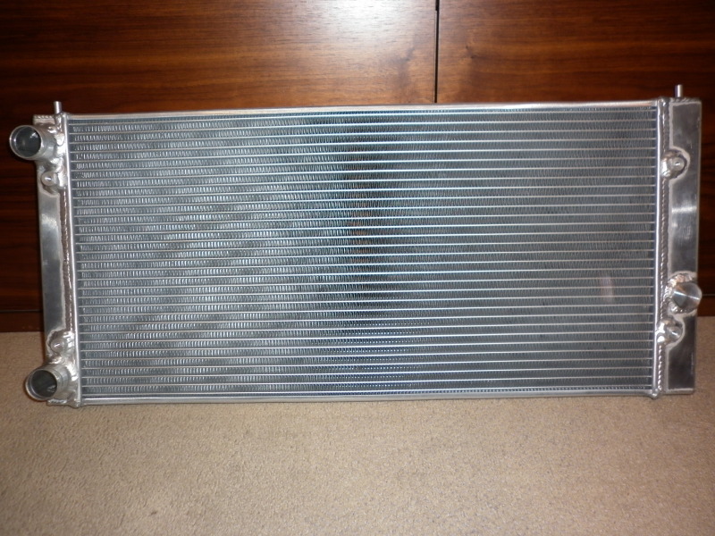

No worries, its a golf mk3 8v/16v rad from eBay. Comes in a direnza.co.uk box but it didn't bring up anything on google, I searched to see if you could get for cheaper. It was £174.99 delivered, quite reasonable I thought considering the price from renault.
  Cup In bits
Haha it is expensive against the polo rad that's sure but against o.e.m its reasonable, if its gets buckled, im going the polo route.
What fan do you use, any good or bad to stay away from that you have used/experienced?
  182cup & 172 racecar
Can't remember now, it was 3yrs ago. ebay I think, the biggest one that would fit onto the rad. Jay might remember.

Ive put a 14" fan on my radiator,I got away with tilting the standard rad forward at the top but will probably upgrade to an alloy one at somepoint.

It's a 14" fan I've got too. Just fitted it and never used it in anger so can't say if it's upmto the job or not yet.

I got a polo rad with my ITB's, it ain't in the best condition but your welcome to it?
