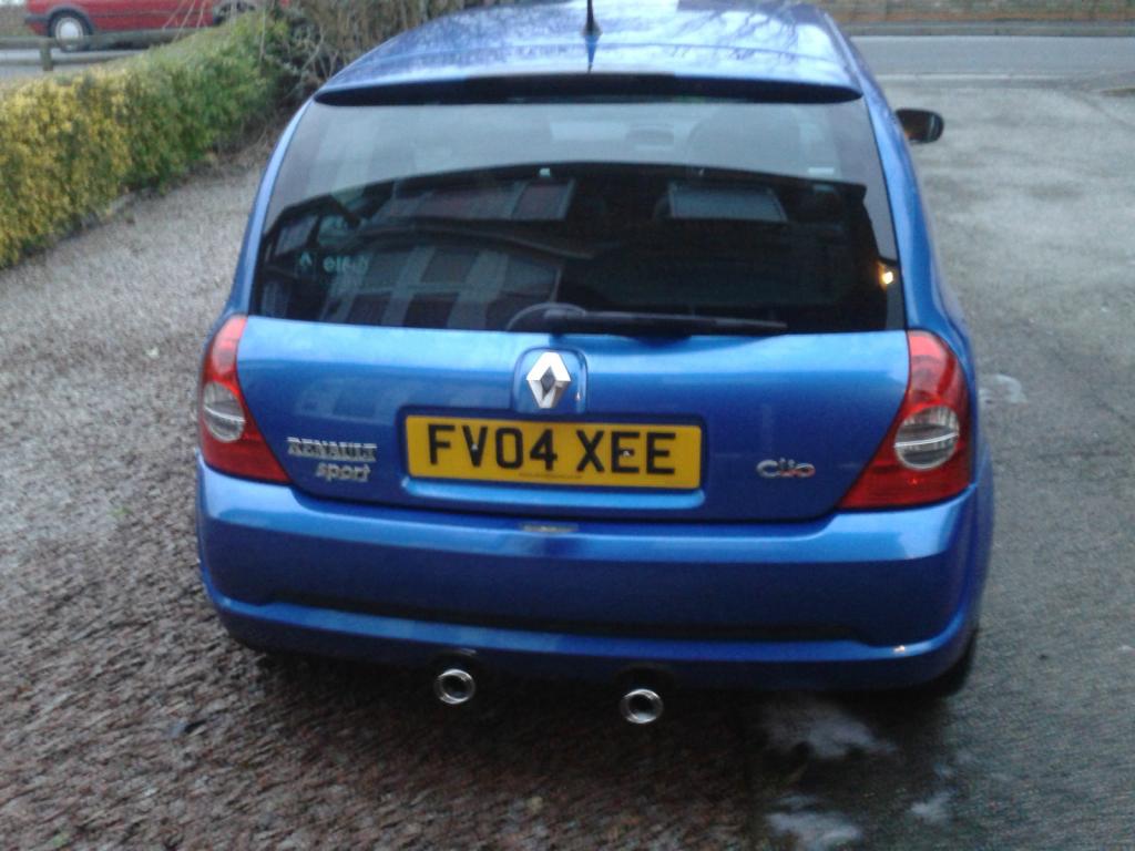

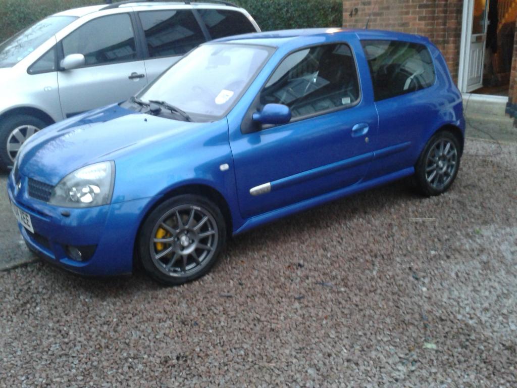

which I liked but it was an absolute pig to work on so after not very long and being a hot hatch man at heart I fancied a change so swapped the impreza for an artic blue 182 (pictures from advert):

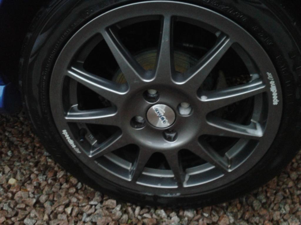

as far as I can tell it is FF 182 with virtually brand new aftermarket speedline turini's otherwise it is completely standard in everyway. it has done just over 100k and has a few little problems:

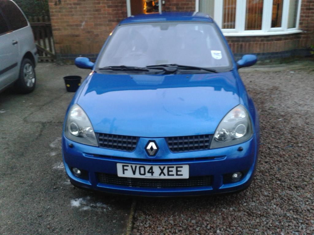

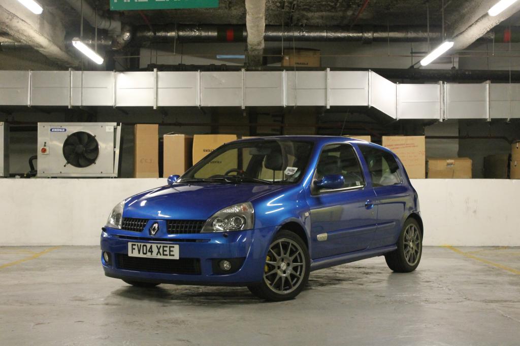

Well finally managed to give it a decent clean and polish but it was p**sing it down so no outdoor pictures but here's one post clean in my works carpark:

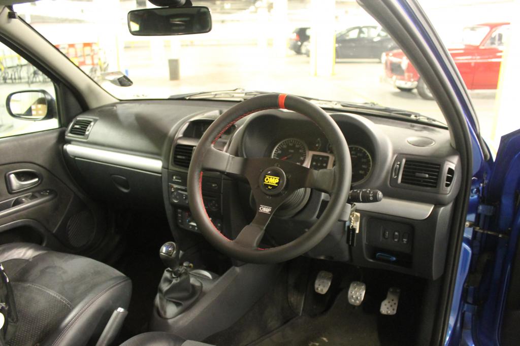

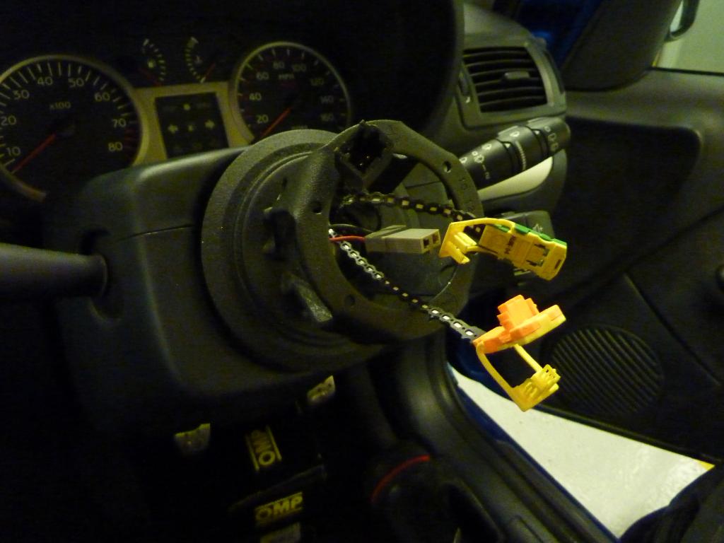

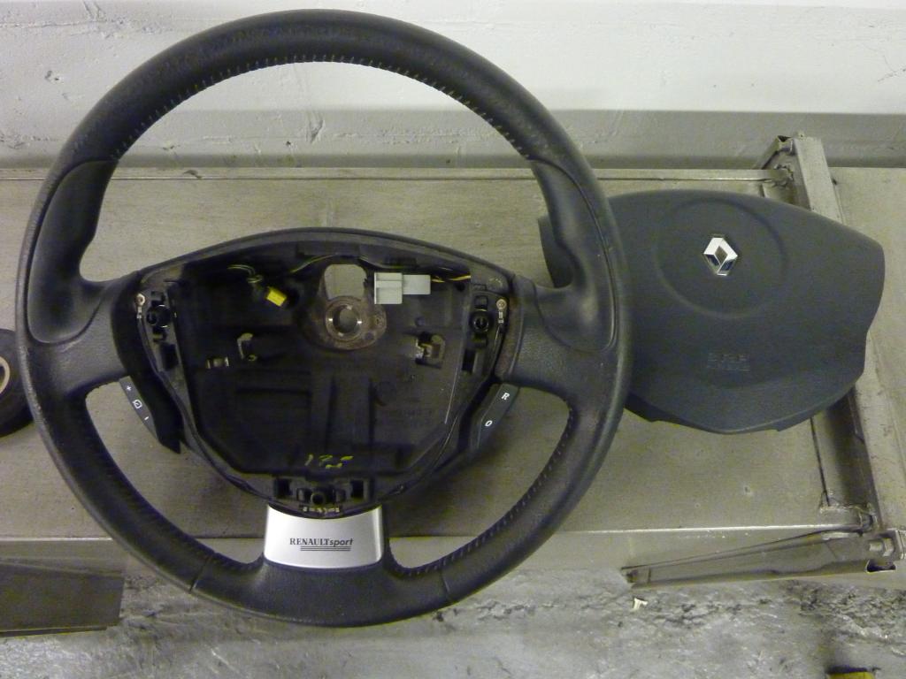

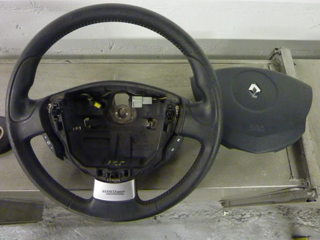

I have also fitted a new steering wheel so removed this:
Fitted the boss (as a side note to this the OMP boss doesnt fit the CC plug through it without a fair bit of filing!!!)

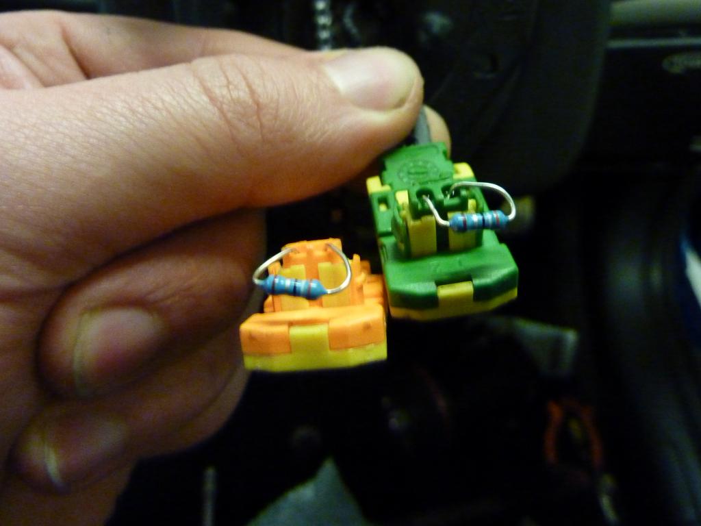

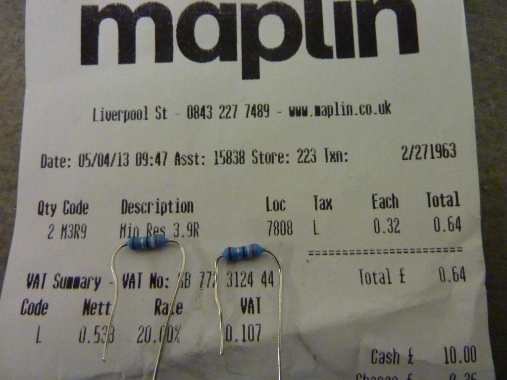

fitted these 3.9ohm resistors to remove the airbag light:

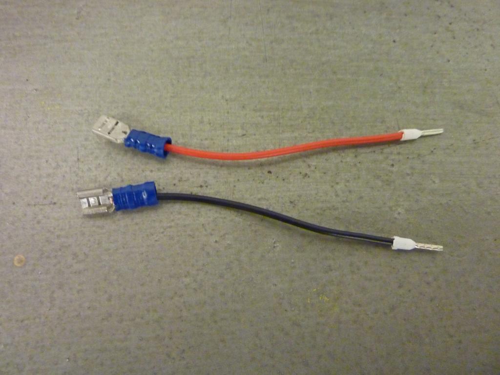

I also made these so that I could use the OMP horn button:
and the finished result:

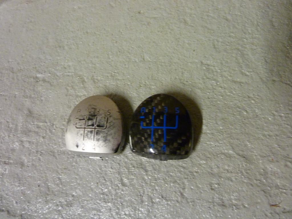

and and you can just about see from the pic above I have also bought a carbon gearknob cover with blue decals:

Looks lovely mate. But it doesn't have a cup spoiler so it's not a FF. It may have cup packed suspension though.
Cup spoilers come up for sale quite often and it is probably the best modification you can do imo.

I thought FF was the term for the standard car with all the toys then you could have FF plus cup suspension, FF plus both cup packs (FF cup) or am I mistaken??
The cup spoiler is something I am looking out for as I agree with you they look much better than the standard jobbie.
Anyone have any idea if the cup spoiler is still available from Renault and if so how much?
A full fat is a non cup 182 with both cup packs ie suspension and cup spoiler.

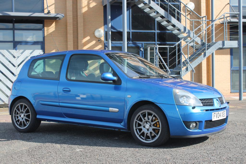

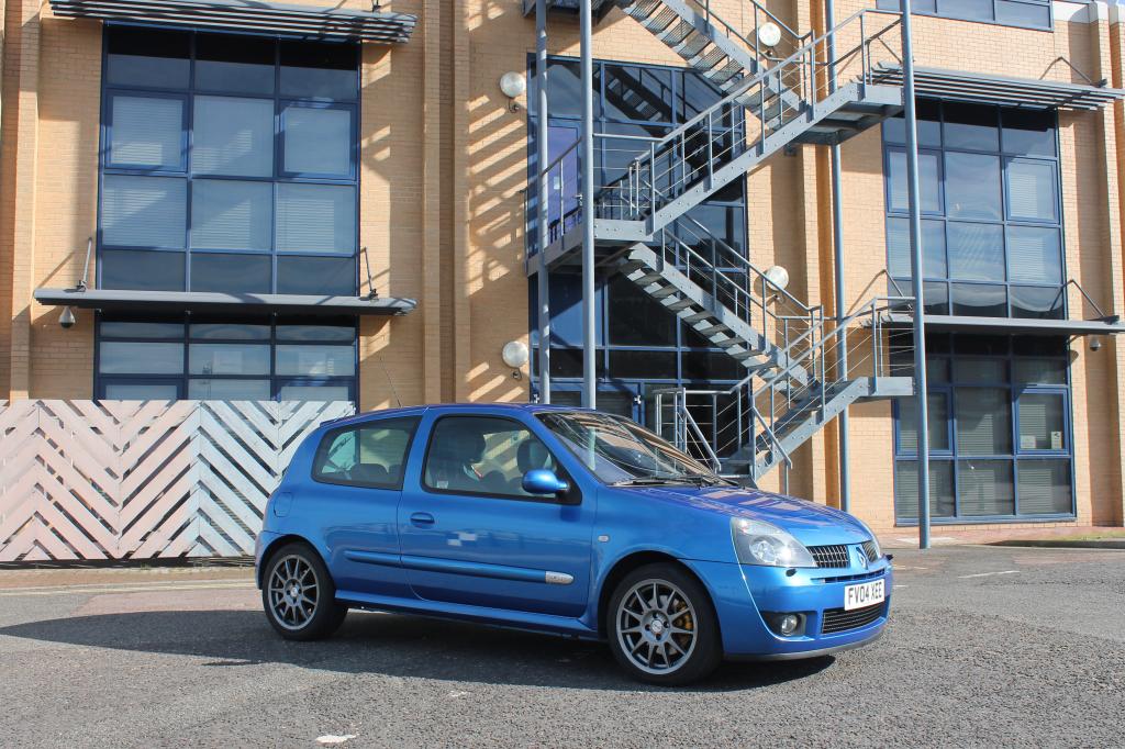

Well as can be seen below I finally managed to get some pictures outside in sunlight which I am happy about but whilst giving the car a good clean and also clearing some items off my to do list I have a few more to add so:

Steering wheel is worn: Now replaced with OMP WRC however service and ESP lights are now up (think this is something to do with the clock spring/squib that tells the car the steering angle being in the wrong position but cant get it to work even after realigning the sight glass and dot)

wear to gear knob now replaced with a carbon piece as above

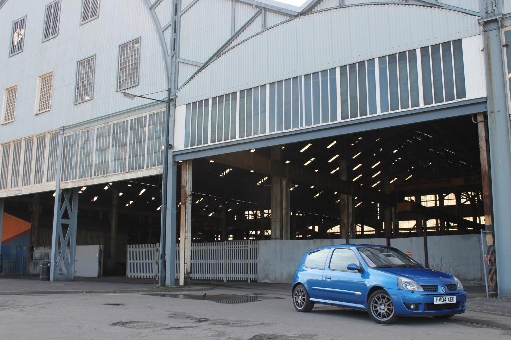

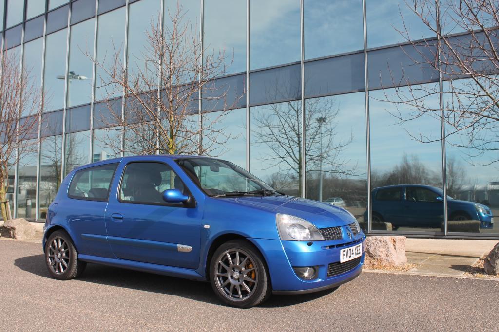

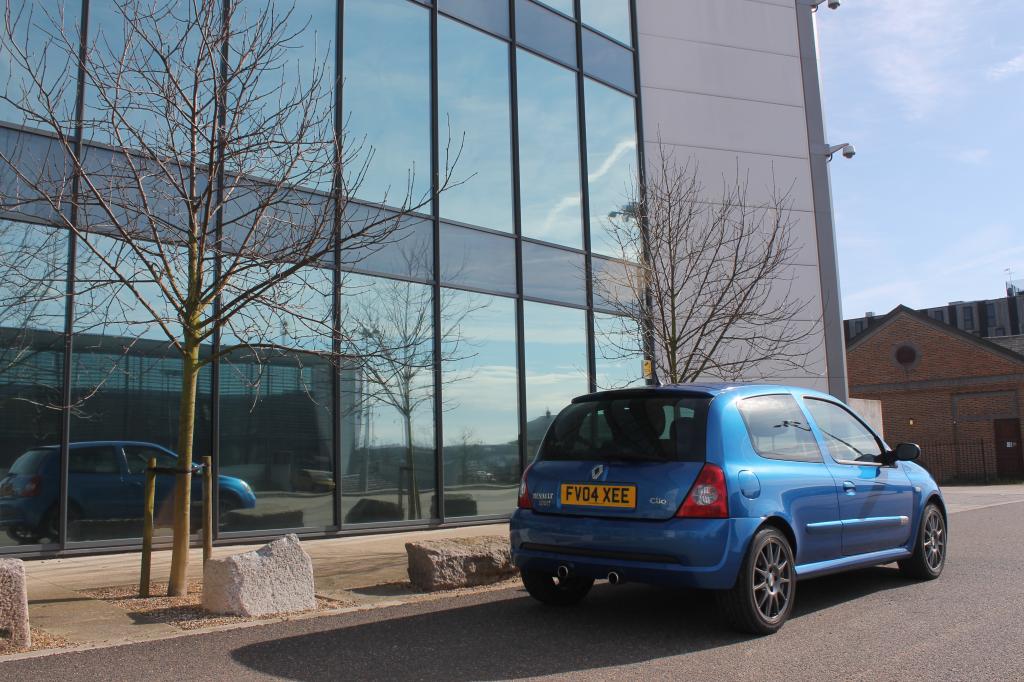

Anyways enough of the bad news here's some pictures outside as promised:
