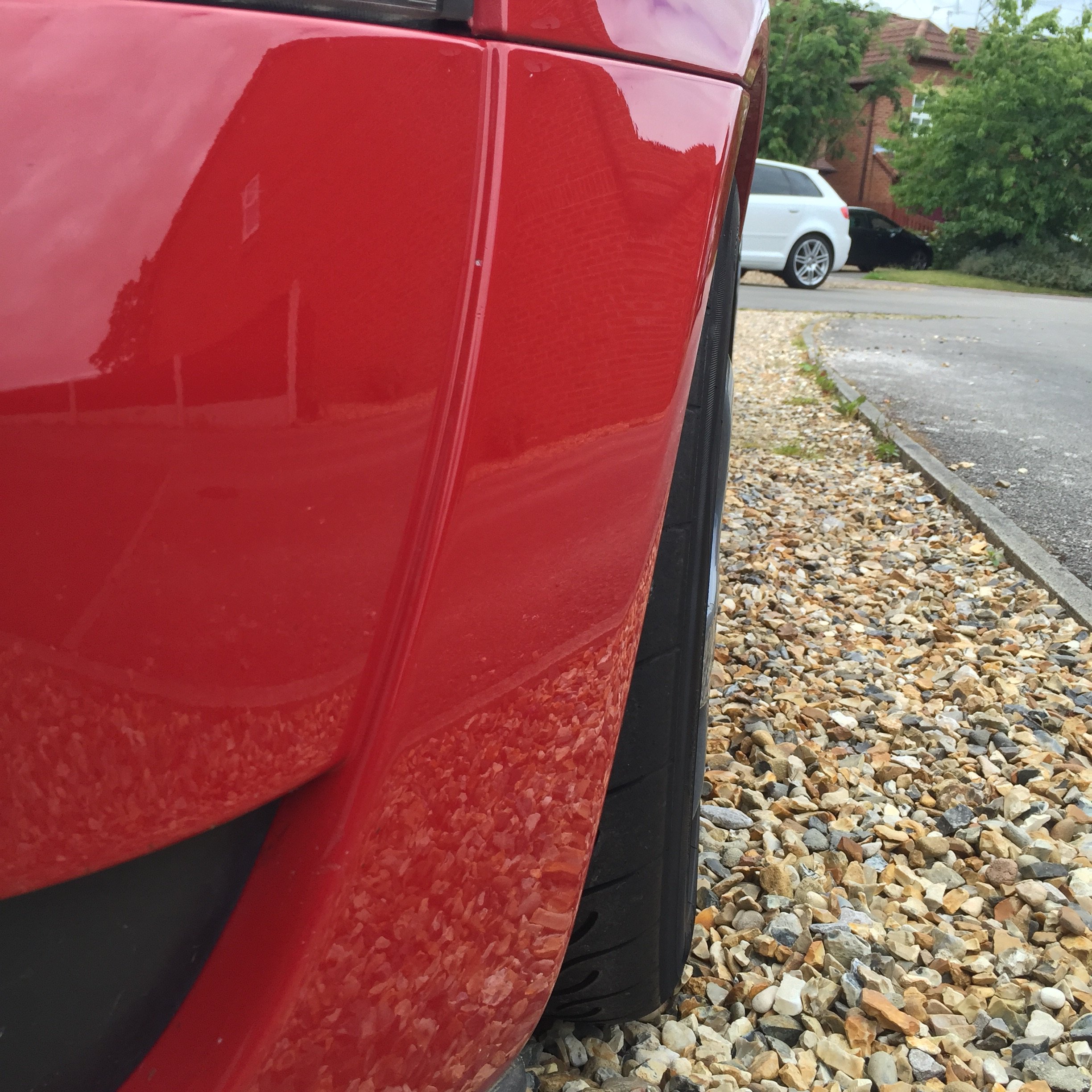

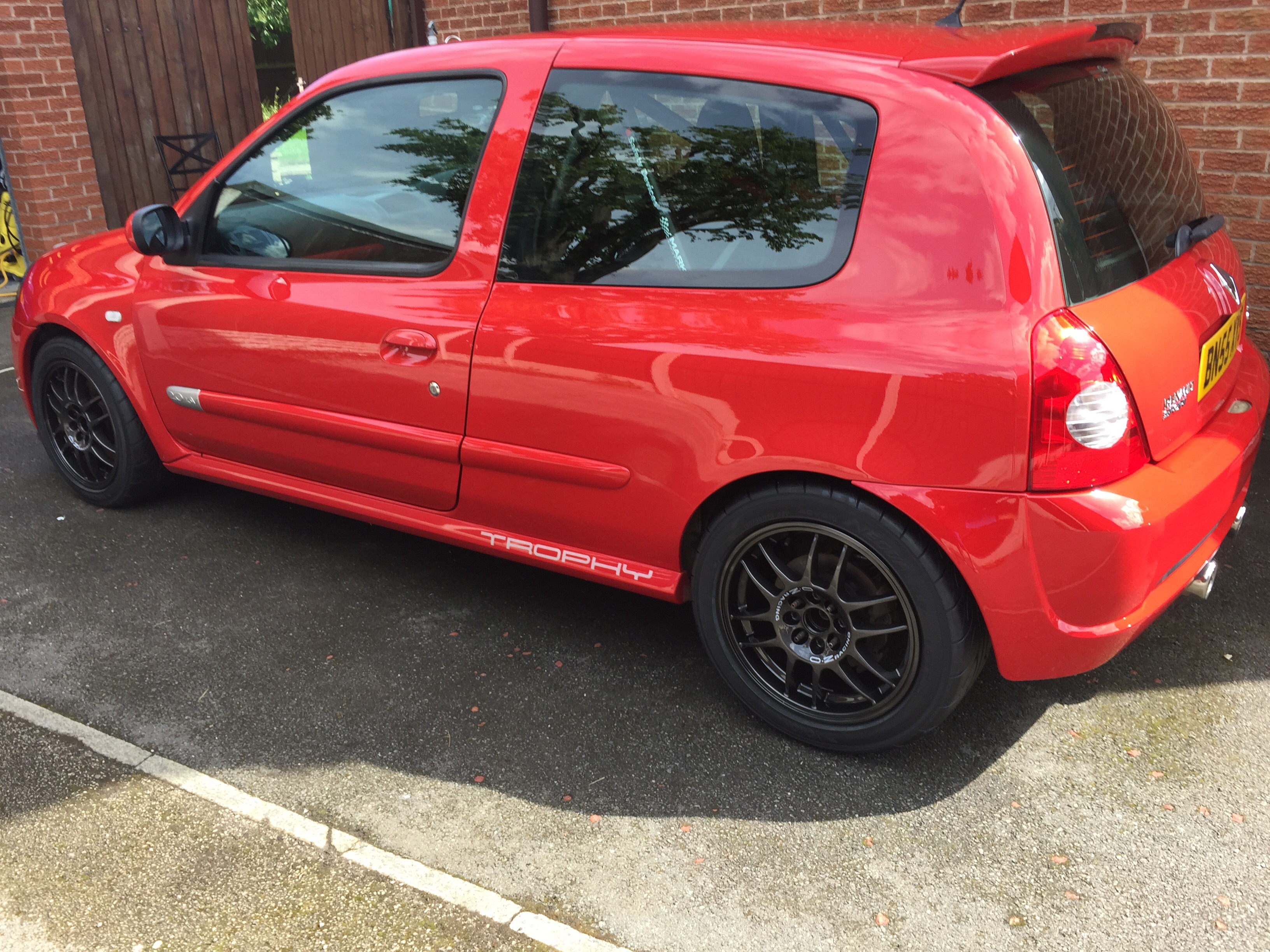

On Trophy Sachs and Mark Fish springs I managed to run 16mm and 10mm spacers (front & rear respectively) with ET35 wheels.
However with a lower ride height and brand new tyres I have my doubts about clearance.
^poke.
So my Renault/Oz F1s are going for refurb. The lower offset should fit.

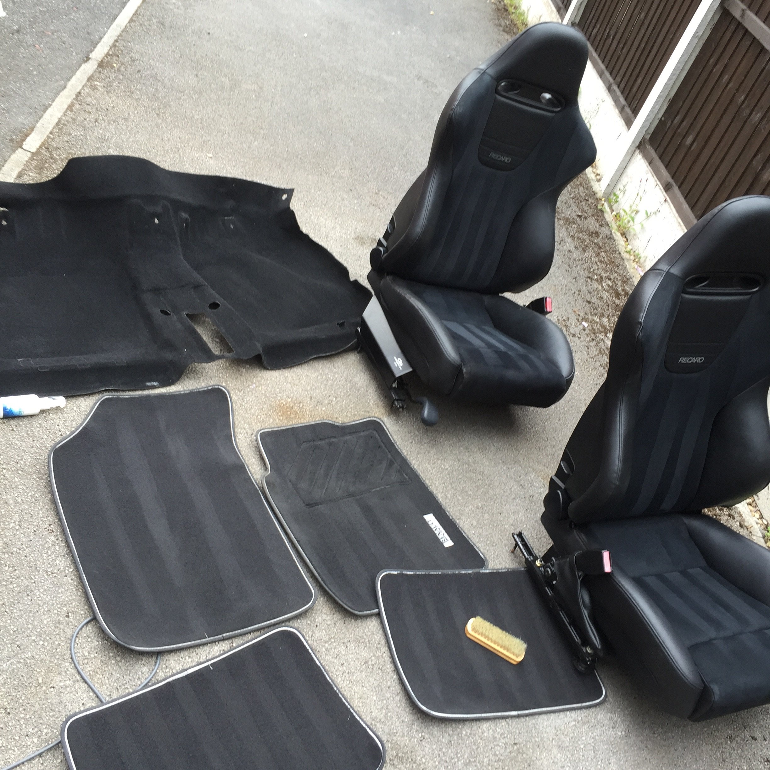

Interior is 90% back in with the cage. Looks like I'll have to modify the rear door cards to fit around the cage.
Whilst it was out I gave everything a good Hoover and wet-vac.

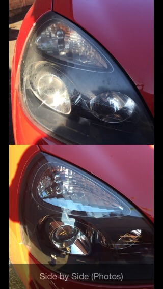

Quick headlight refurb this morning.
Not 100% perfect but good enough for now.
- 2500 grit by hand, lots of water until the grit was very degraded
- 4000 grit sanding disc with lime prime plus
- Menzerna PG1000 worked until fully diminished (lots of water top ups) on a green 3M pad and finished with lime prime plus
- Eraser wipe downs and 2 x coats of CQUK14
That'll do pig.

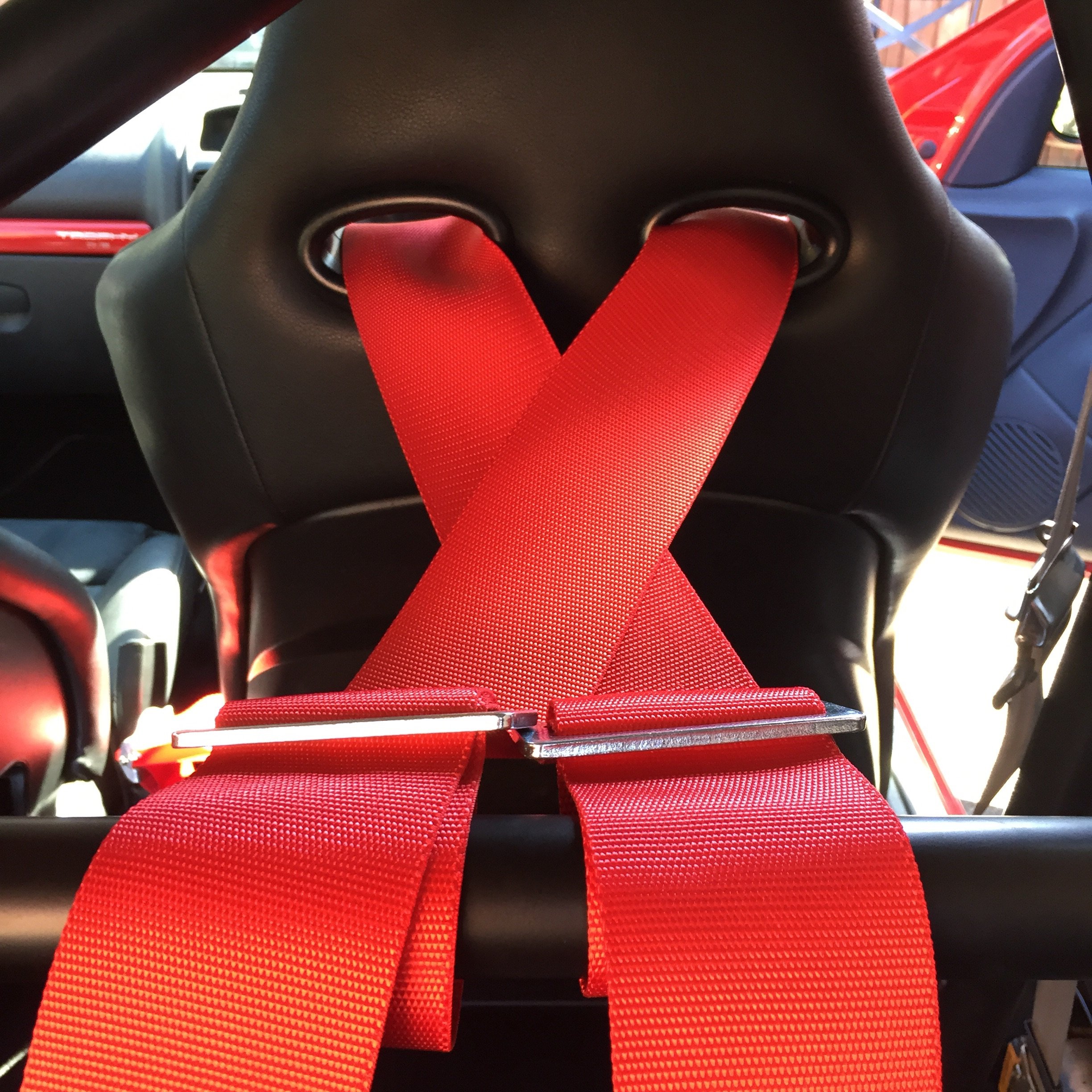

aucky

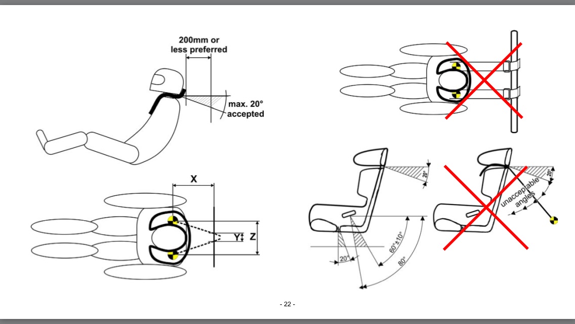

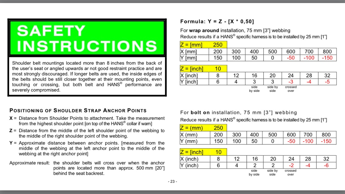

Based on this:
With 600mm from bar to collar bone, the harnesses should cross over with a 50mm spacer between them?
Thought I better ask because most Clios I've seen tend to run them in parallel.
@NorthloopCup
NorthloopCup
Based on this:
@NorthloopCup
Measure the distance from the back of the seat mate not from the collar bone. You may well find that its 500mm or less, so in this case you don't need them to x over. I've never seen them crossed when a harness bar has been used in that position tbh.
