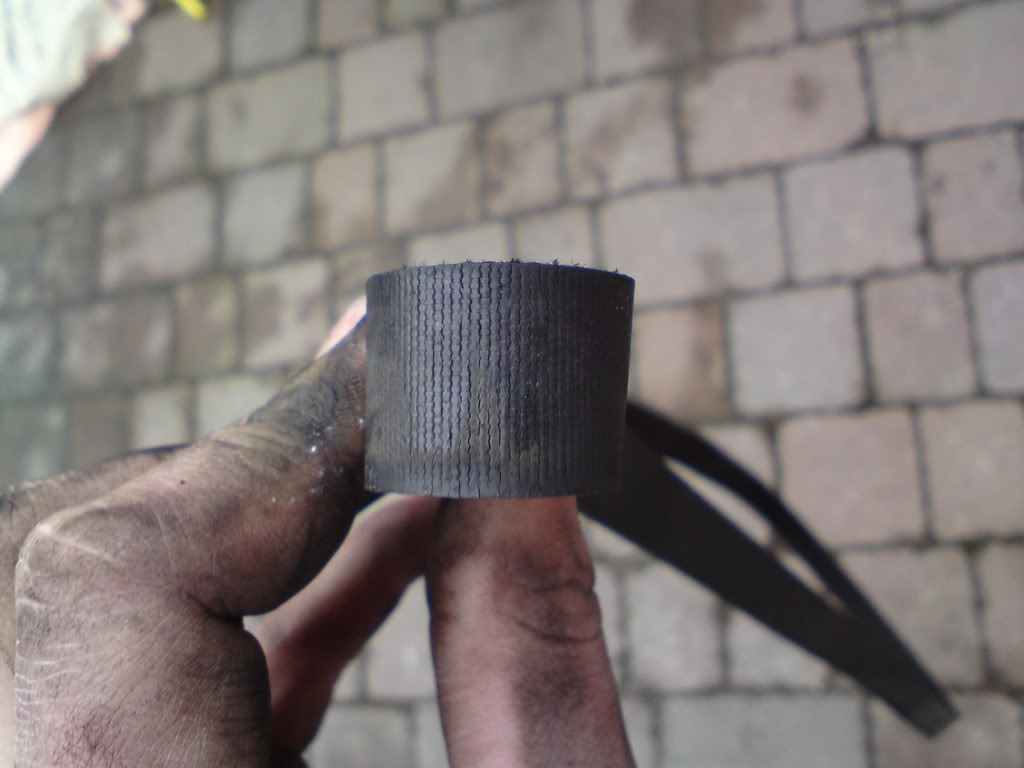

:( Had it on the ramp at work teh other day and noticed theres a few cracks starting to appear, Its f**k all TBH but better to be safe than sorry

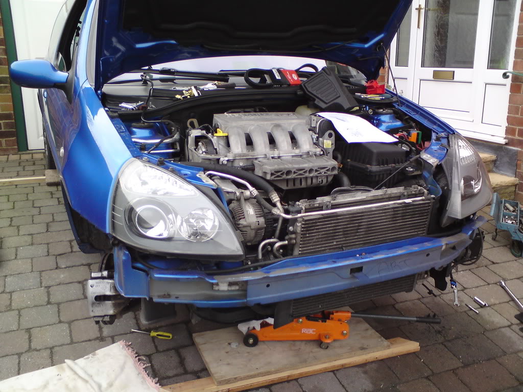

Well i did it but what a b*****d lol

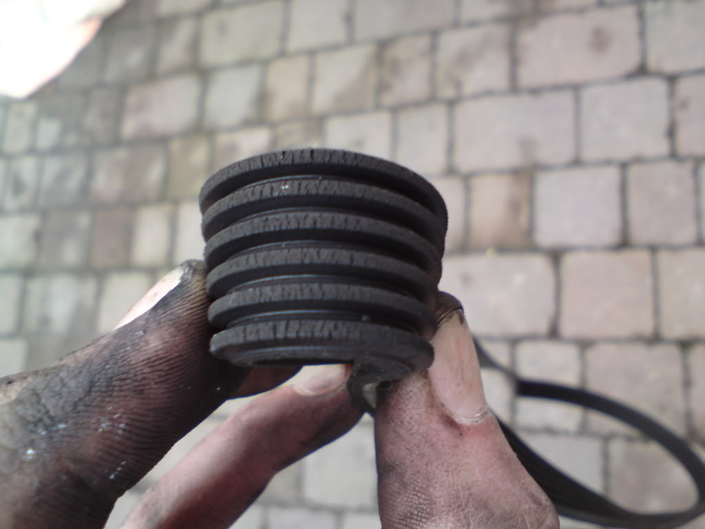

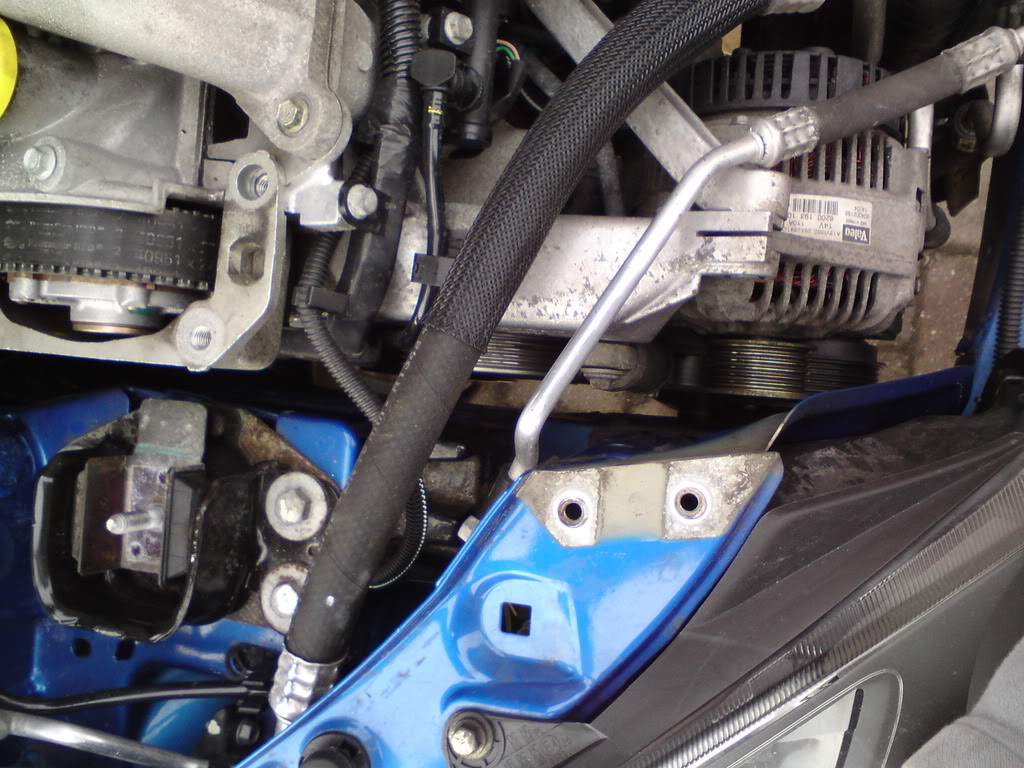

I think the pics will speak for themselves but just incase, this is what you have to do to change the Aux belt on a 182 with aircon, You dont have to take the bumper and Slam panel off like Mike says but it makes it a whole load easier on your back

I noticed it was worn when i had it on the ramps at work and wasnt particularly looking forward to the job
a £20 belt took about 3 hours to fit, Nearly cried halfway through when the tensioner casting broke on me, Nan babbling on in my ear = me not concentrating 100% and bang broke the cast on the tensioner making it very difficult to release the tension to slip the belt on
Quick call to my mate comes round grab a few bits of wood lever, poke, prod back on it goes
Ended up using bits of wood to release the tension on the spring once the belt was on because after the cast broke i had to take the top nut out off the tensioner to slide the belt on first. Proper monkey style (must not do jobs when parts dep is shut

I've heard a 1/4" to 3/8" adapter with a 1/4" ratchet fits in. You can't get a ratchet straight on as there isn't room next to the hole. I filed the side off a 1/2" to 3/8" adapter but I had a little "bit" that came with my ratchet spanners that basically has a 19mm bolt on one end and 1/2" square on the other. Got that on the modified adapter and then a 19mm spanner on that. If you release the top bolt of the alternator that will pivot down and make it easier to get the belt on.
You have to be careful with that Mark because theres the Aircon pipes right under the alternator so you cant put much stress on them :boring:
Thats the way i ended up slipping my belt on because of the nackered tensioner then i had to compress the spring after the alternator was all bolted back into place. Problem with these cars is everythings just shoved in where theres a space :mad:
Yeah I know. I only found out because that bolt came out when I was driving, alternator resting on the air con pipes for a good few miles before I realised. Small dent but they look OK. As long as you know though it is fine when doing the belt.
