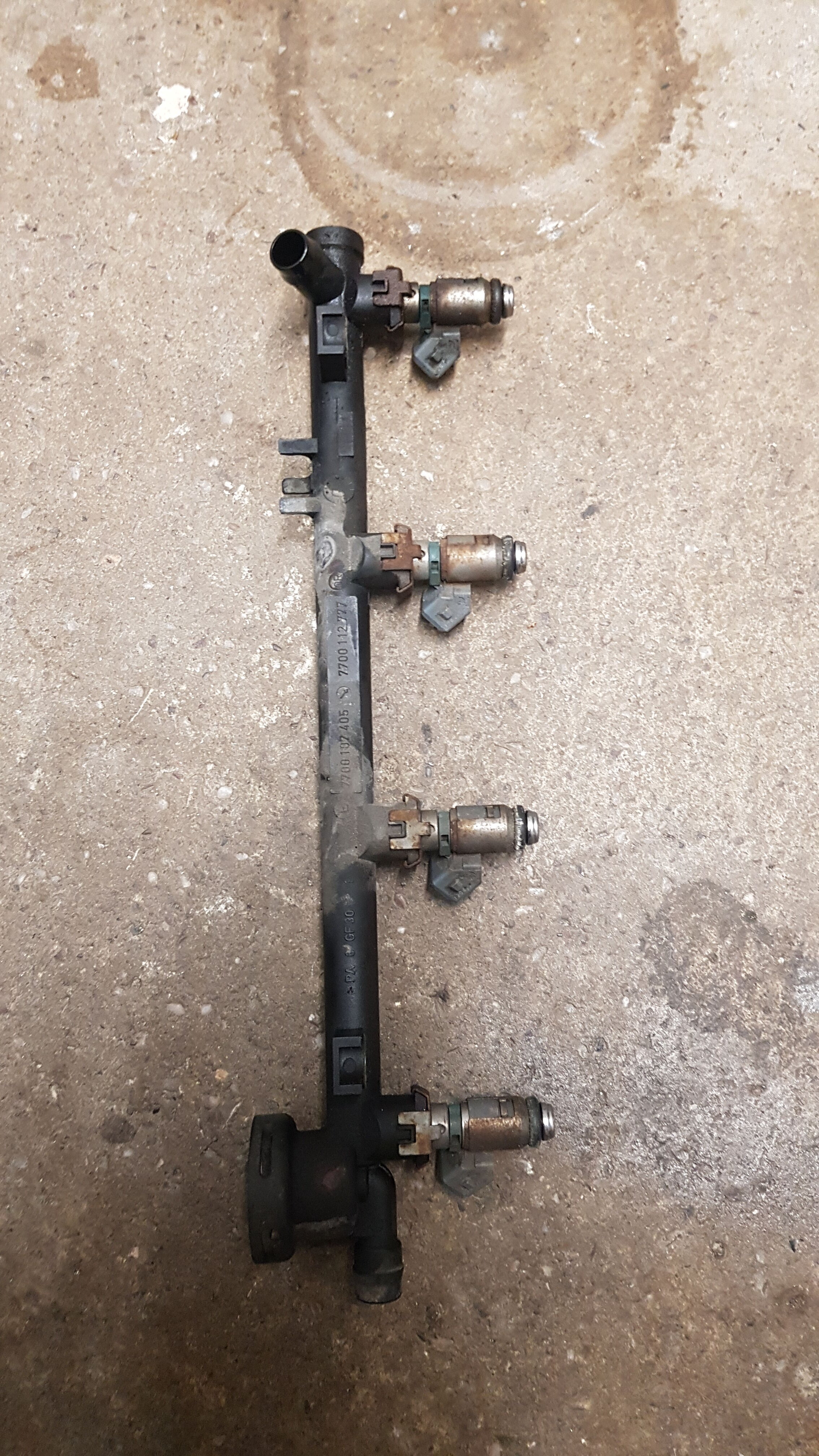

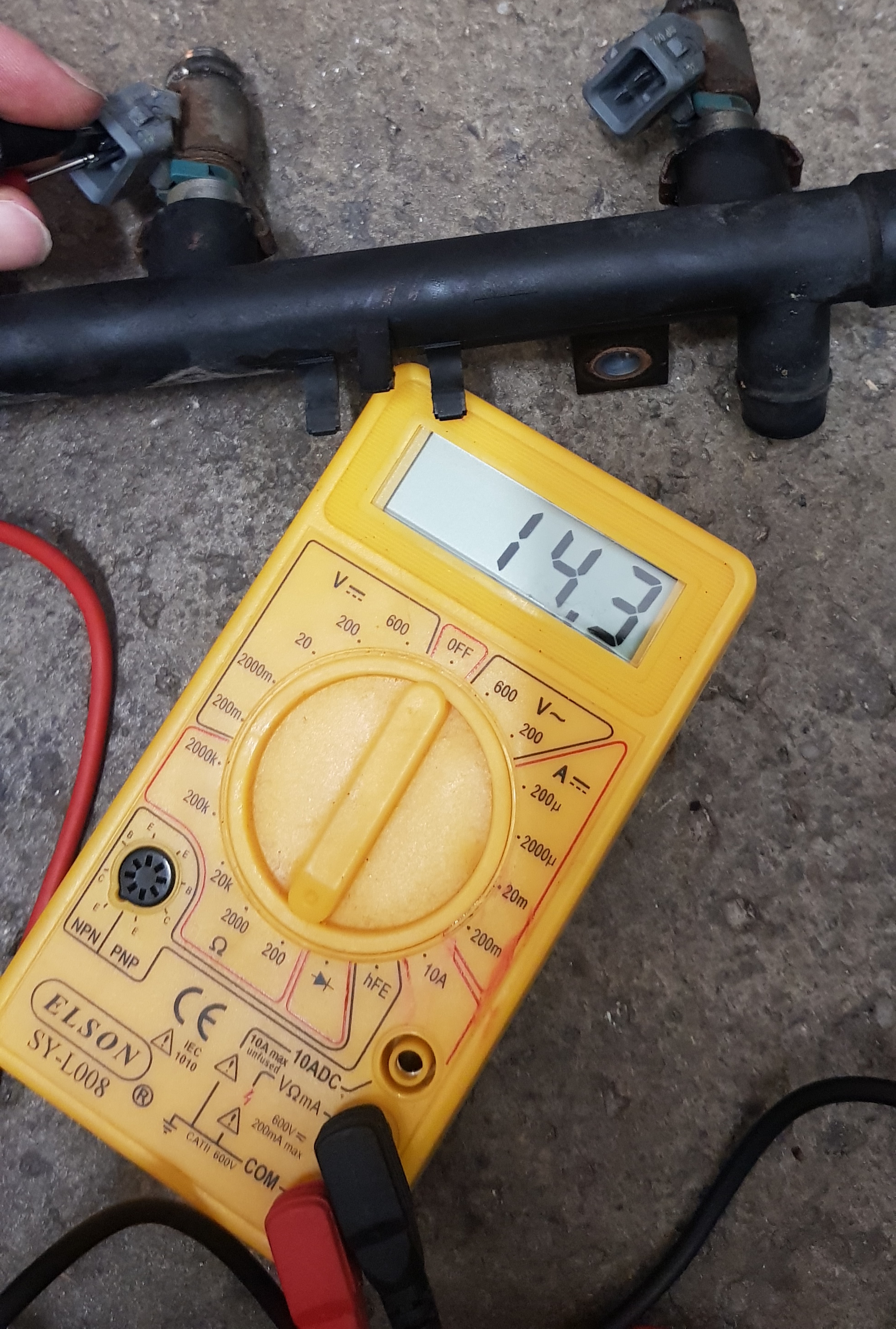

Driving to work today I noticed a slightly stutter when waiting at a set of traffic lights. Kept driving and then when stuck in traffic the idle began to hunt and the EML started to flash. Thankfully it got me there and I had a spare set of old injectors in my drawer.
Ended up worrying all day about driving back but managed to ease it home and gave it a bit of a blast down the carriageway to try clear it up.
Seemed to run a lot better but @Pudding of Yorkshire persuaded me to replace the injector just incase. Good job I did, as moving it closer to the garage got the EML flashing again.
Unfortunately I dont have enough room to get into the garage!
Close enough 😬
So being careful on all connections I removed the fuel rail, probably safe to say they're the originals 😂

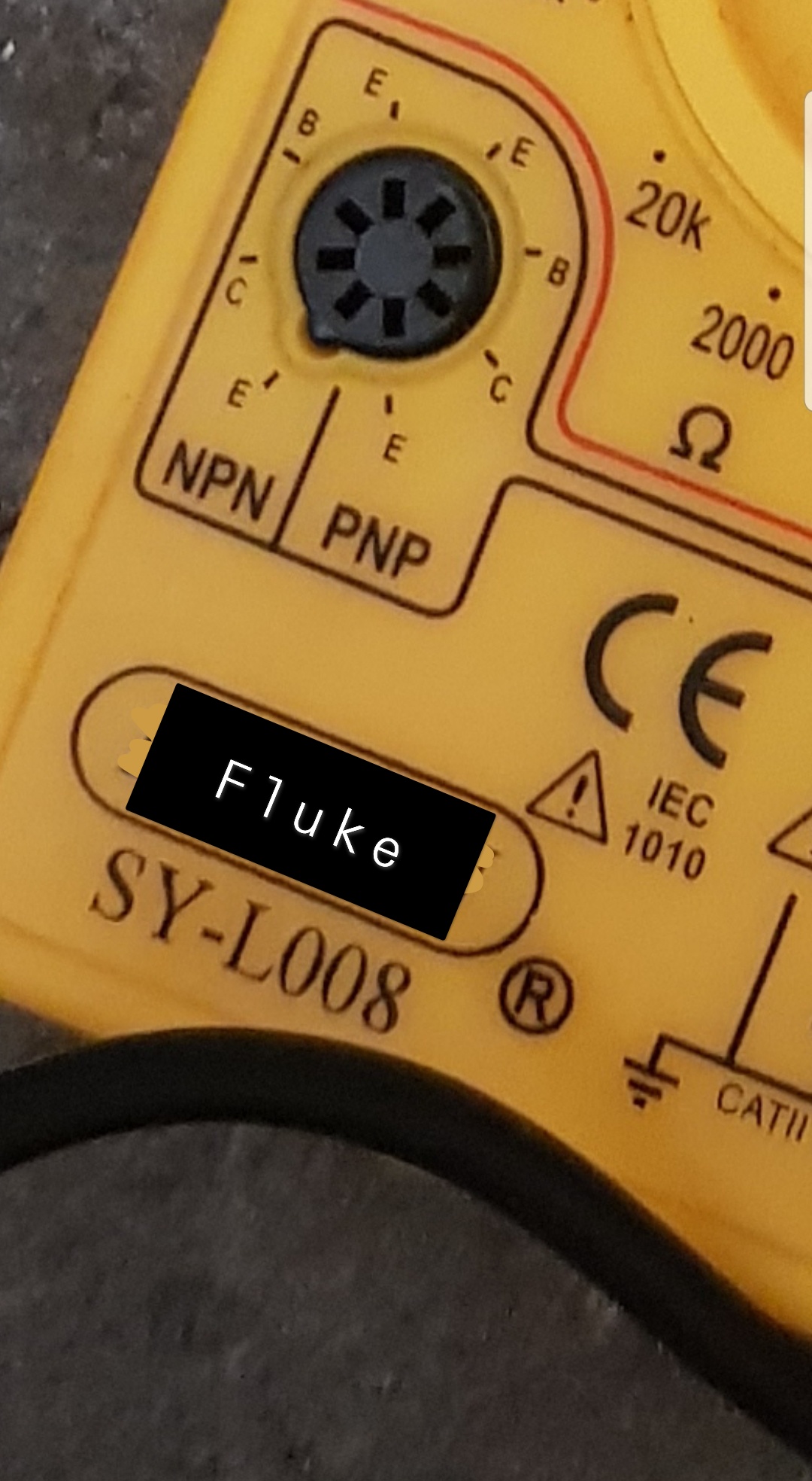

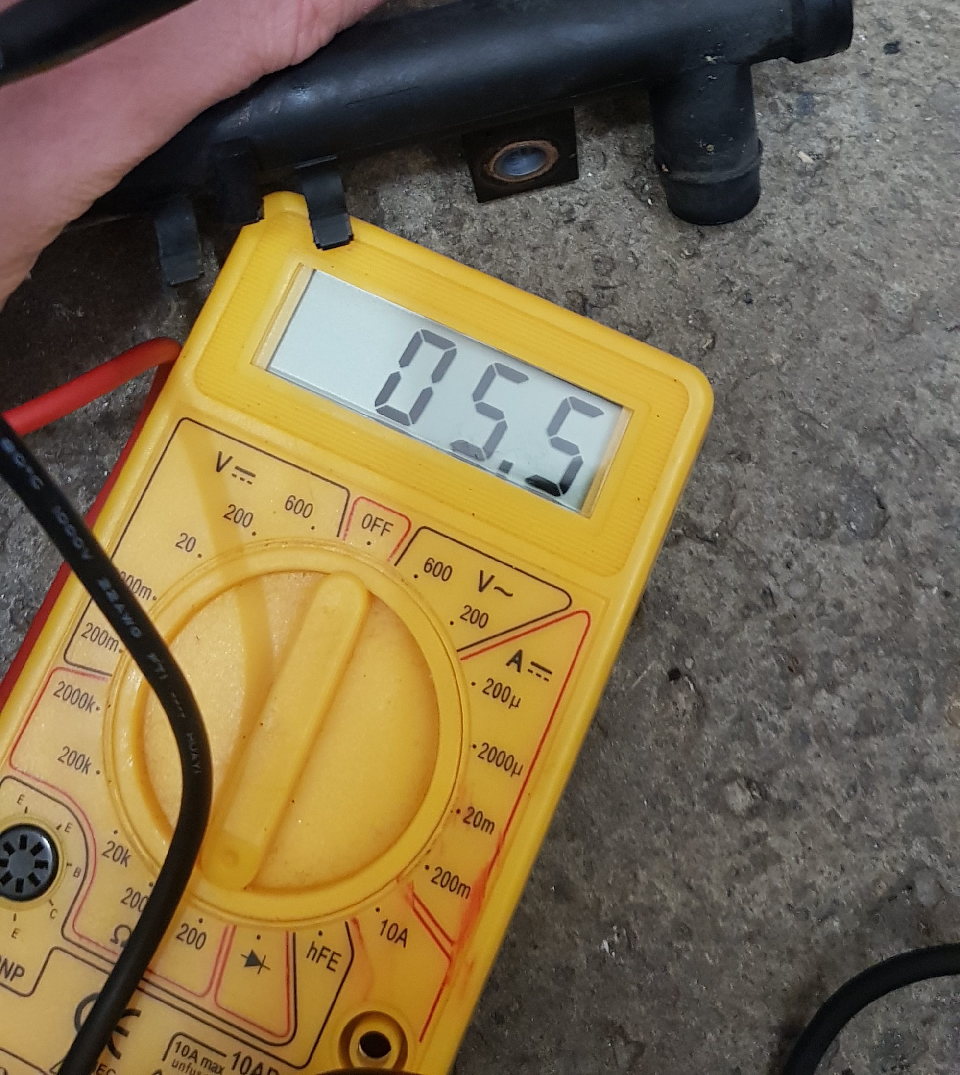

Measured the resistance on my Fisher price multimeter and I found the problem.
Injector #4 is knackered then! All the other 3 seemed okay.

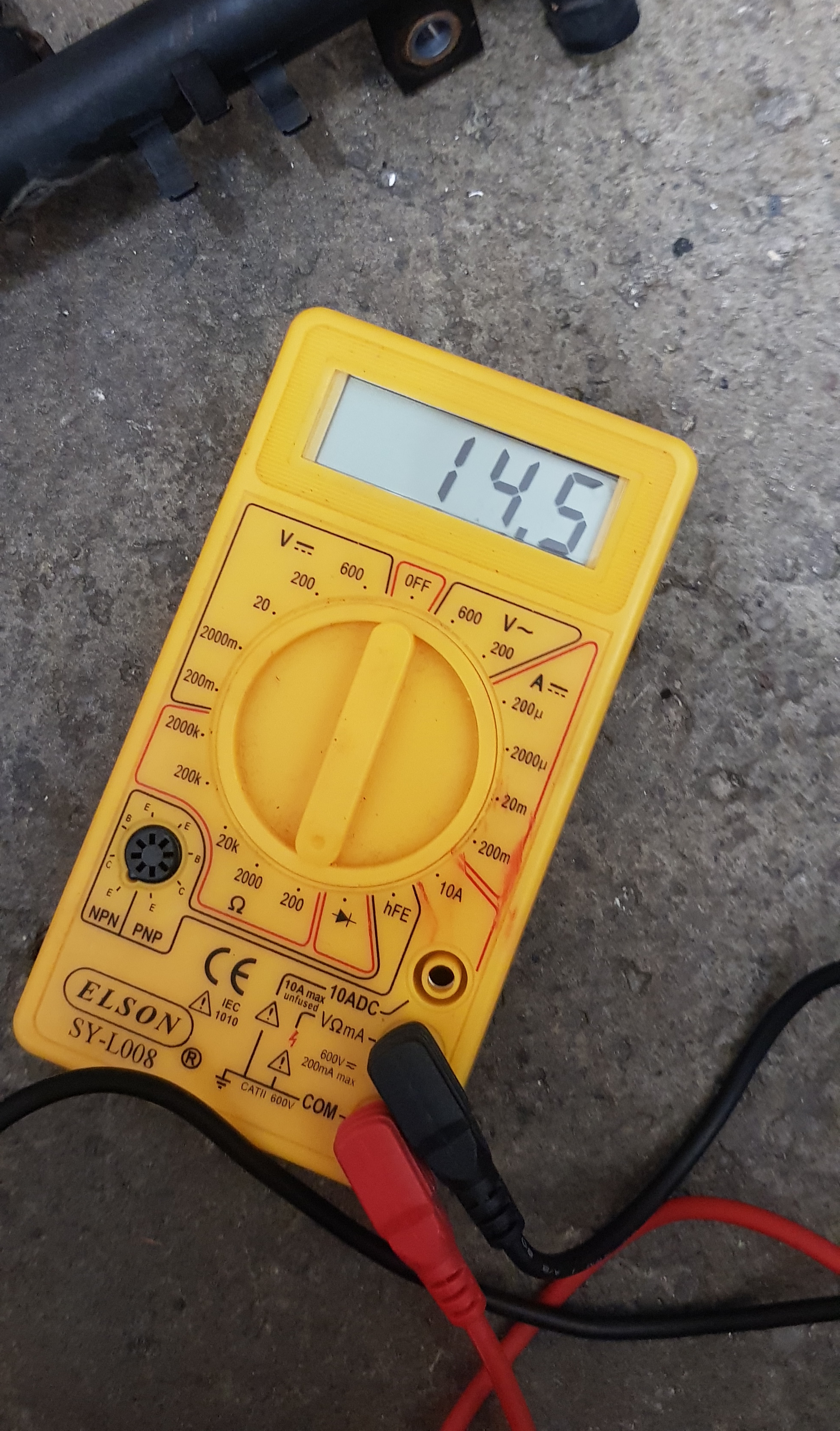

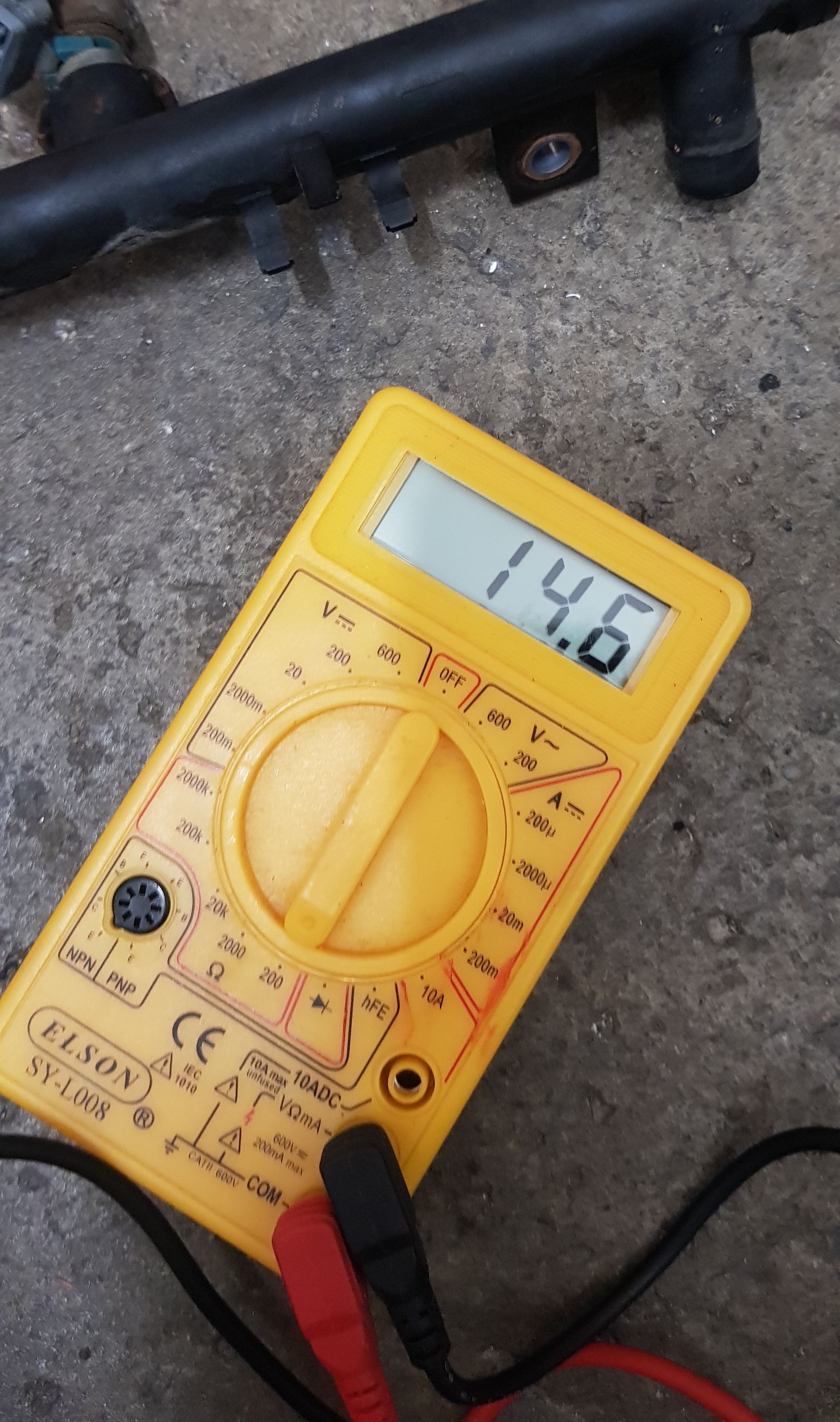

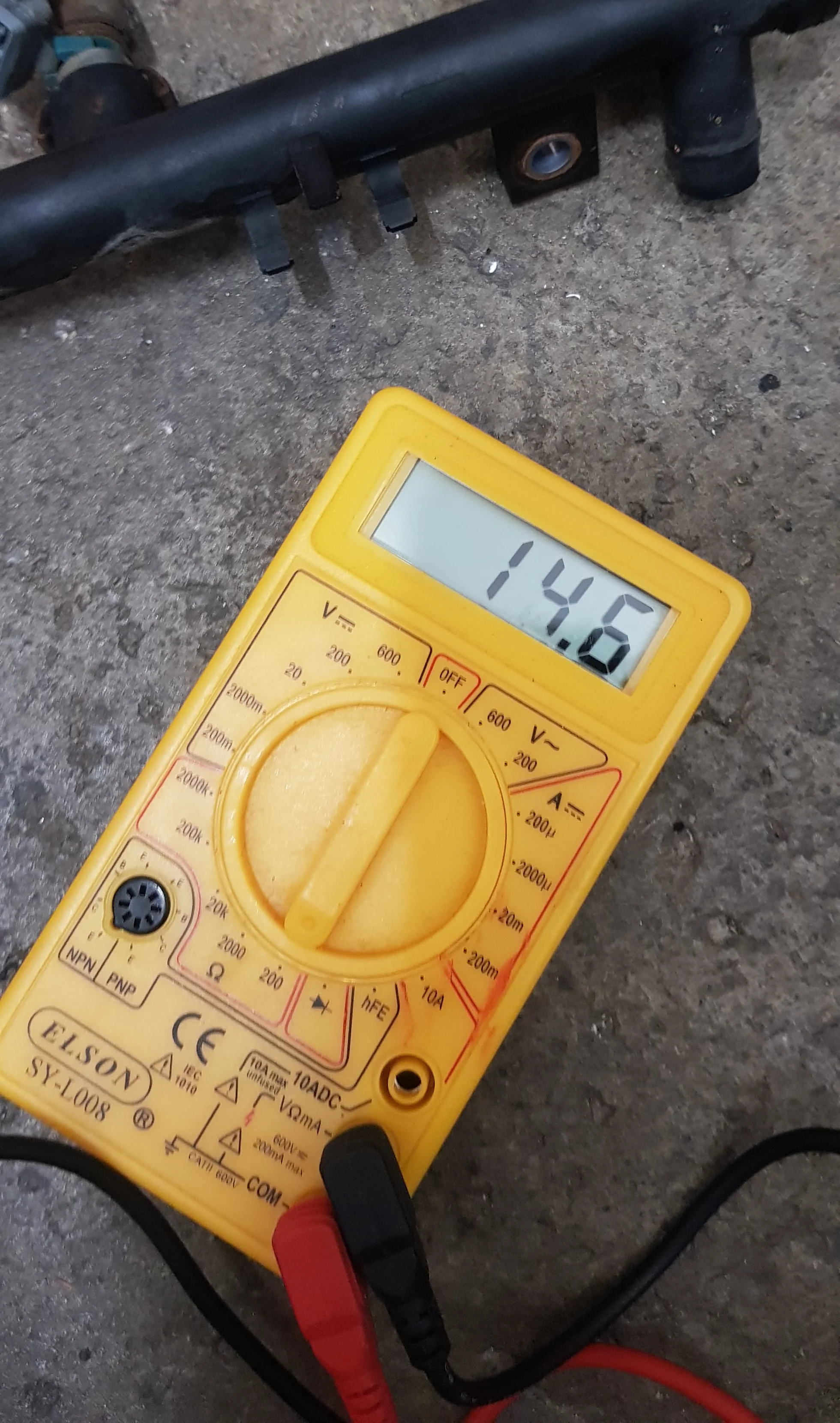

So removed the injector, cleaned up the old ones and found the best used injector I had. Measured 14.5 ohms so got that fitted with some engine oil on the orings and then pushed the rail back onto the engine.
Fired it up and no more misfire, true test will be the drive to work tomorrow!
Not what I had planned for the evening but theres nothing much else to do anyway at the moment 😂

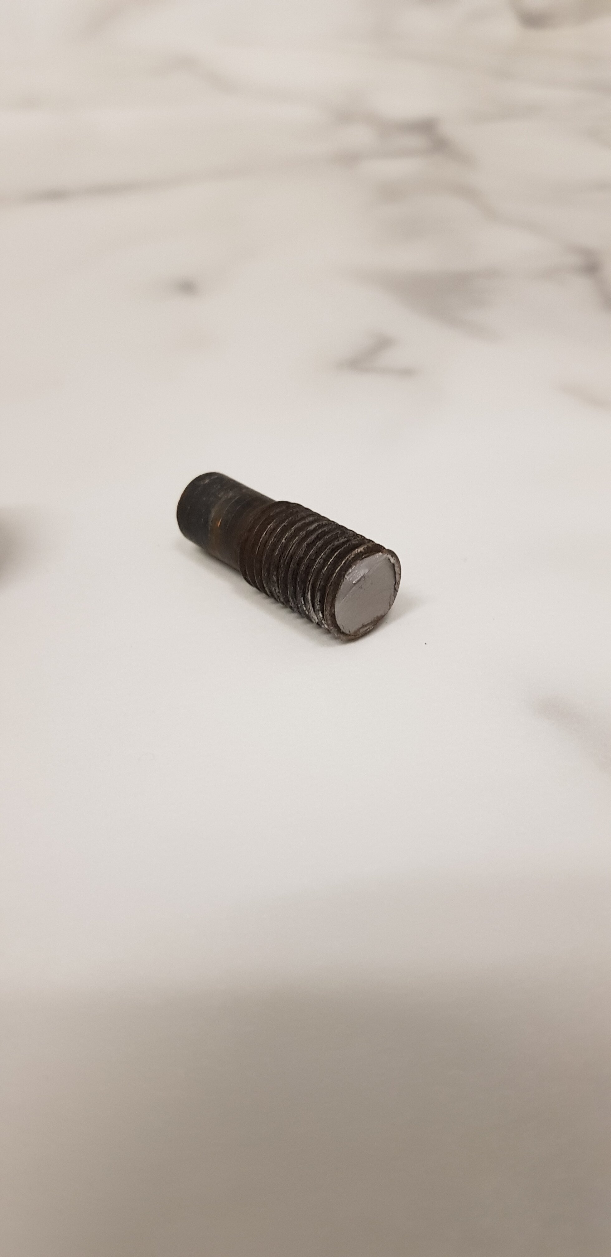

Checked over my car today before setting off down the motorway to see family. Got the torque wrench out to click the wheel nuts and instead one stud decided it didnt want to be fastened to the car anymore 😂
Nipped round to see @Pudding of Yorkshire who gave me a spare one. That's a job for boxing day then 🙄
Suprised it snapped so cleanly. Any recommendations for decent ones that dont corrode in 5 minutes?
David Stuart
Same thing happened to me mate a few months ago,bought a whole new set after that & also making sure myself and anyone else who works on the car to not use a impact gun & do by hand.
Got to question. If the impact gun isn’t set to 200nm and operated correctly it shouldn’t be a problem.
If a gun is used up to torque correctly and they snap then it’s just crap quality wheel bolts.
