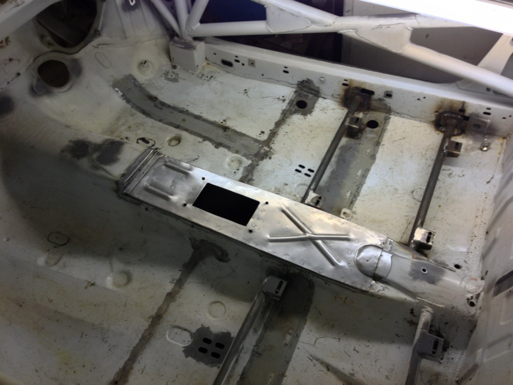

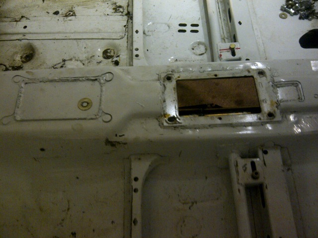

Took longer than planned to do the gear mount plate but I think it was worth it and it's much lighter than what was fitted before and is now really strong too. I love the look of it and nice to get rid of the previous s**t
Before:
After:
It's double skinned to retain the same thickness of the orignal shell and been seam welded and spot welded along with welded nuts to hold the gearlinkage so no longer a two man job to remove the linkage :) Can't wait to see it painted

Looks good that, I spent a day removing 1 standard seat rail/ floor stiffener and positioning and welding in another 2 seat rails by myself.
I feel your pain!!!
