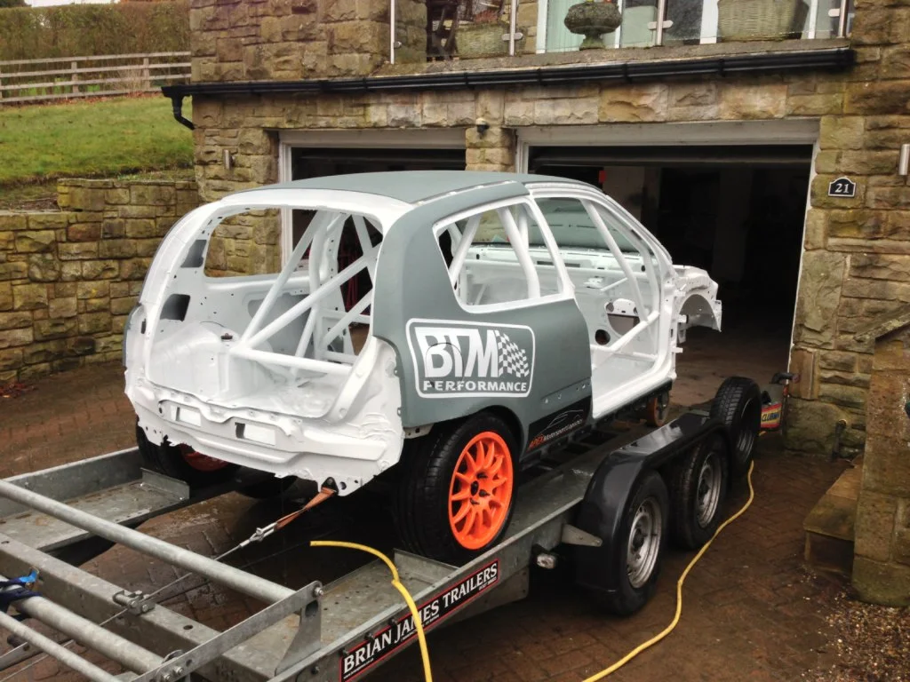

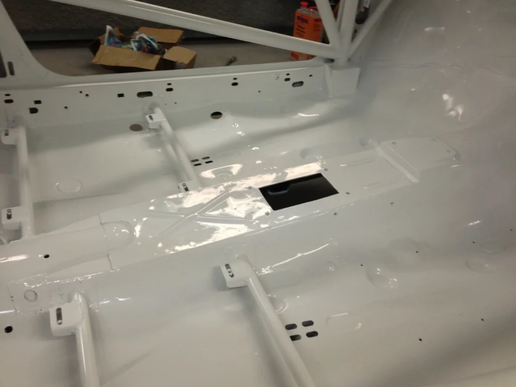

Just collected the car and its all done and looking nice :) I'm over the moon with the stuff we have done with it.
Will start to put it back together this evening!

Looking good pal.
On the window thing, could you not accost a Autoglass guy to see if he would do you a foreigner? Their glue is brilliant stuff.
With how much you've had painted were you not tempted to pull the roof and rear quarter vinyls off and have the whole thing done white?
Or is it just me that has a serious lust for white Clios lol
