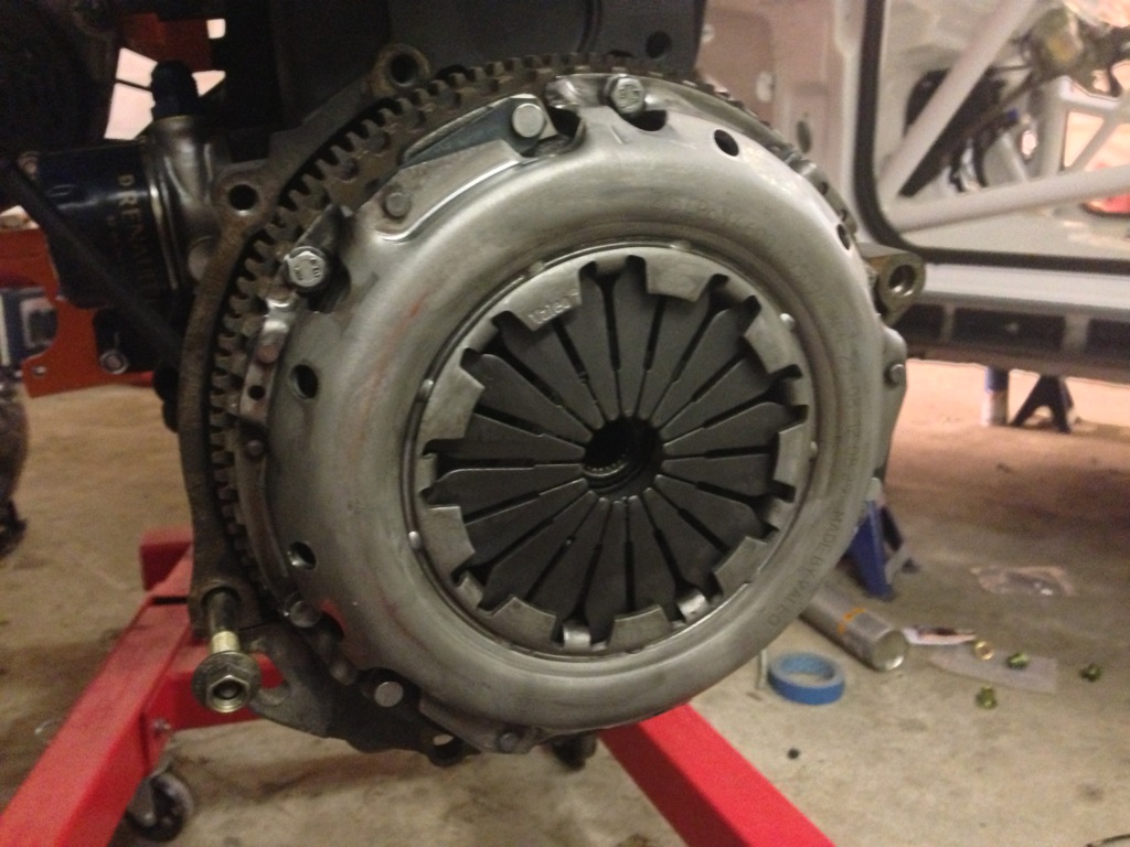

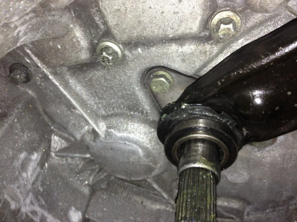

Have I put the clutch release bearing back in the correct way? It looks the correct way but would rather check than have to pull the engine and box back out :)

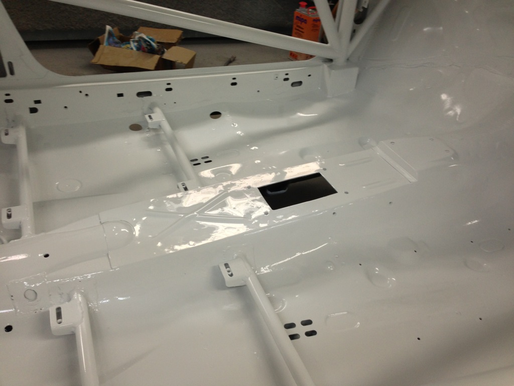

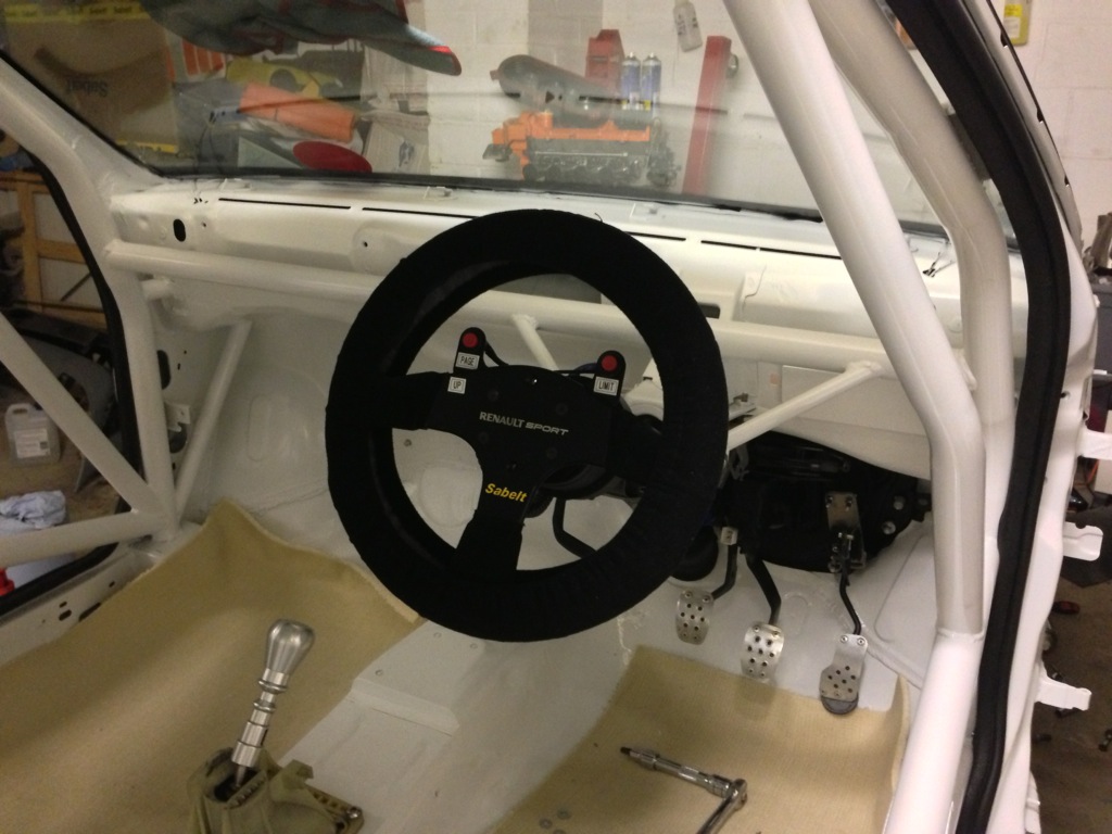

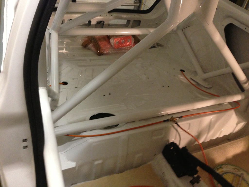

Right so as I showed a few days ago I collected the shell on Monday after it had spent the weekend drying after painting. While there it had the new seat rails fitted at the correct spacing apart which now gives much more flexibility, a few areas of missing welds on the cage were sorted, the central tunnel was modified to relocate the linkage further forwards. This involved cutting the strengthening bar from under the car but this has been replaced with 2 bars laterally one in front and one behind the gearstick. The plate was then double skinned with a Genny used to create extra strength in the top panel.

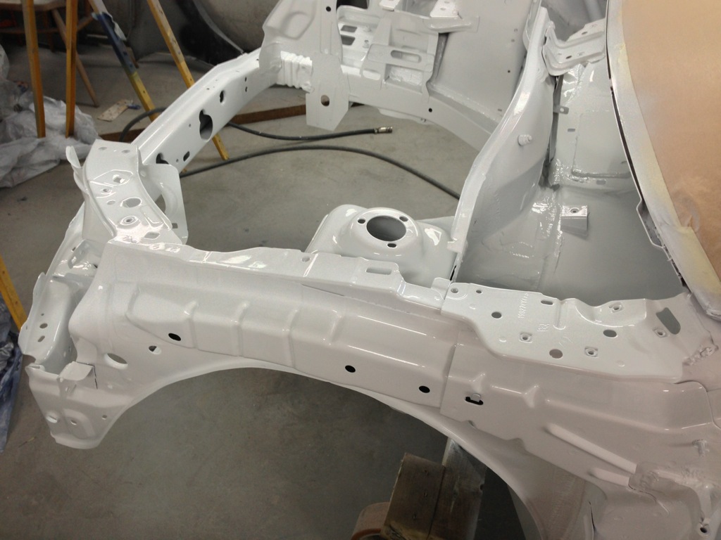

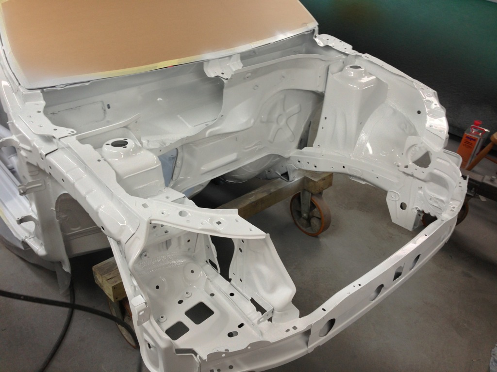

I then spent a long time prepping the shell for painting which RG engineering did an awesome job of painting!

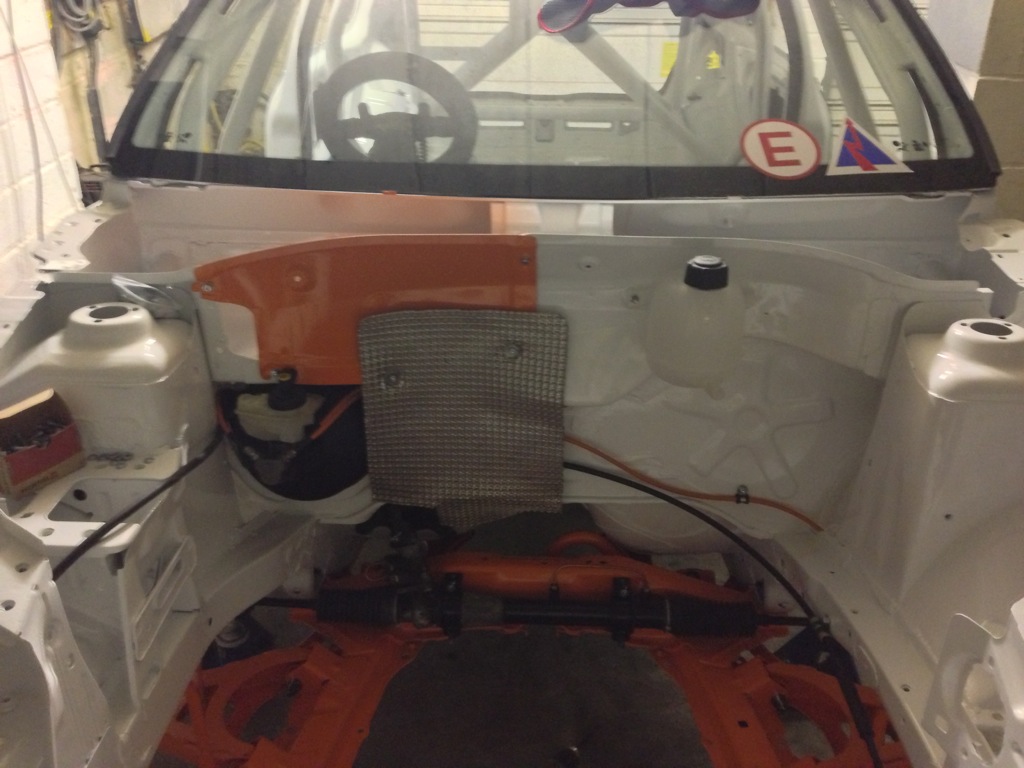

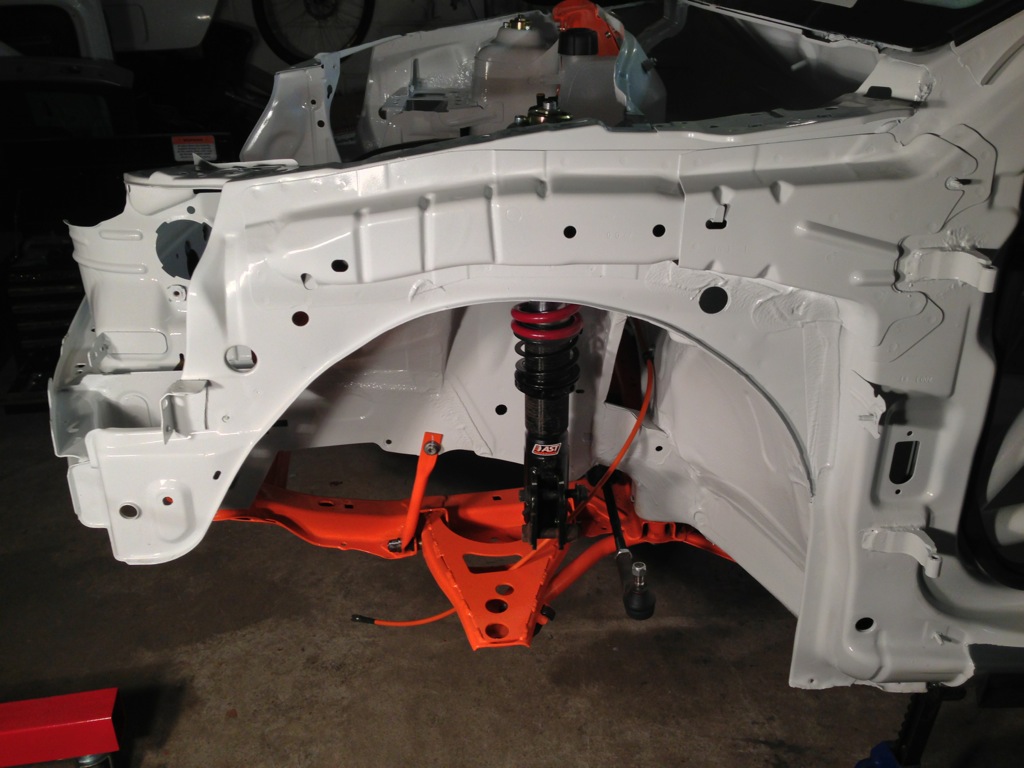

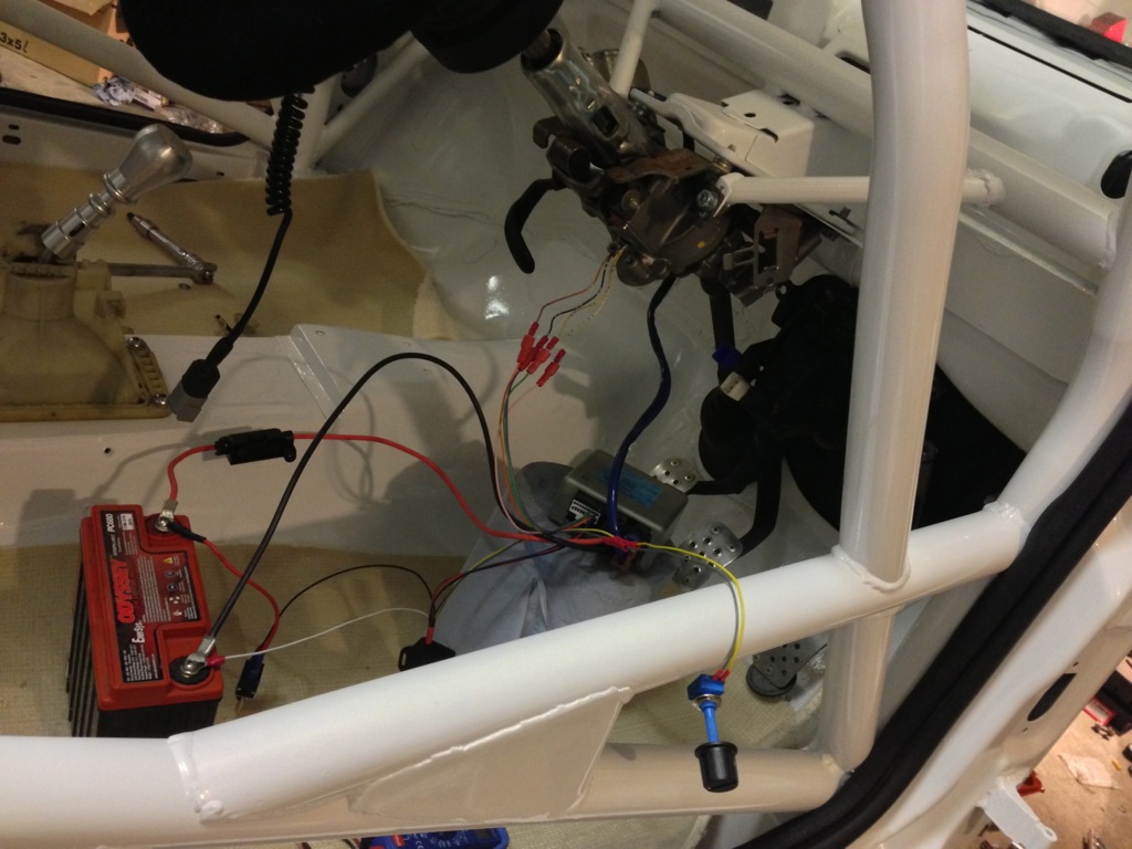

Once the shell was home it was time to start the rebuild, firstly fitting the subframe and then moving onto the EPAS. I wanted to rig it up to ensure it worked before fitting the engine and it didn’t after nearly a day wasted and a lot of help from Mick@Diamond, Chip and Mark I then found out that the EPAS wouldn’t work unless it see’s a required load to turn (Wheels on ground etc) so hopefully that is all fine and I carried on with the rebuild.

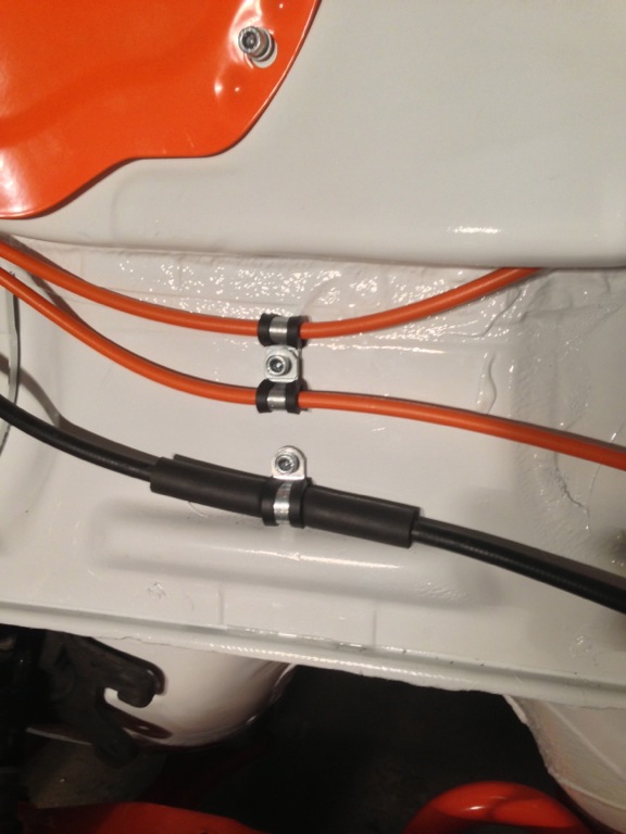

The next job was the brake lines, clutch cable etc. Then fitting some of the shiny parts back on

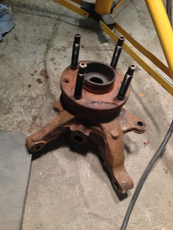

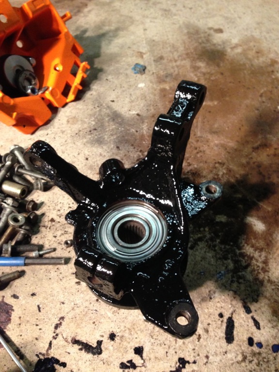

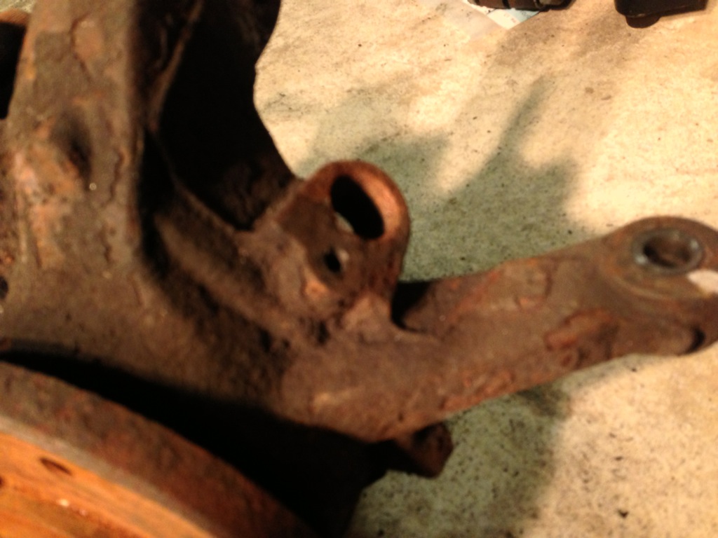

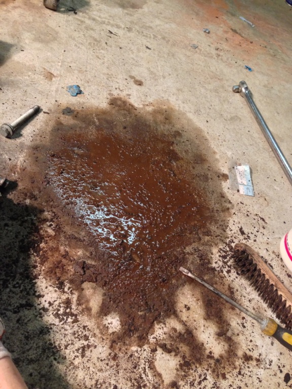

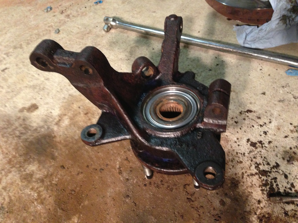

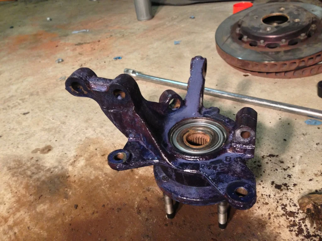

The hub’s were awful and had a lot of rust on them so I spent most of one day cleaning them up then giving them a dose of Karust and then painting them up which has massively improved them. I wanted to get them powder coated but didn’t want to waste money having to change bearings etc so just painted them by hand.

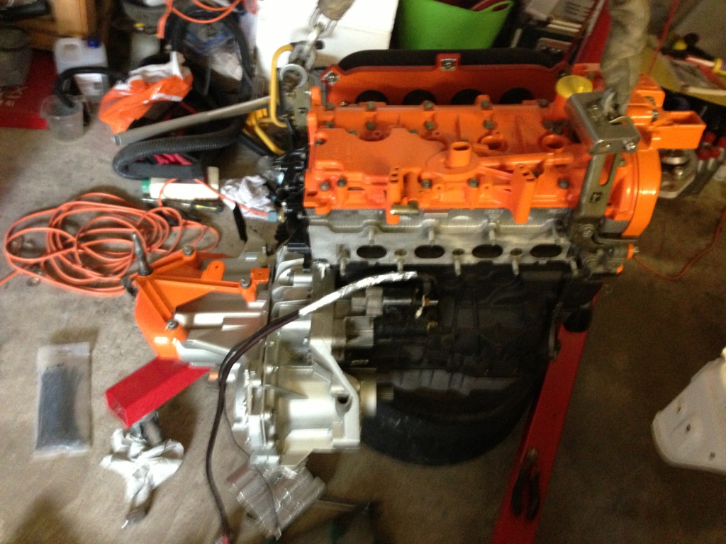

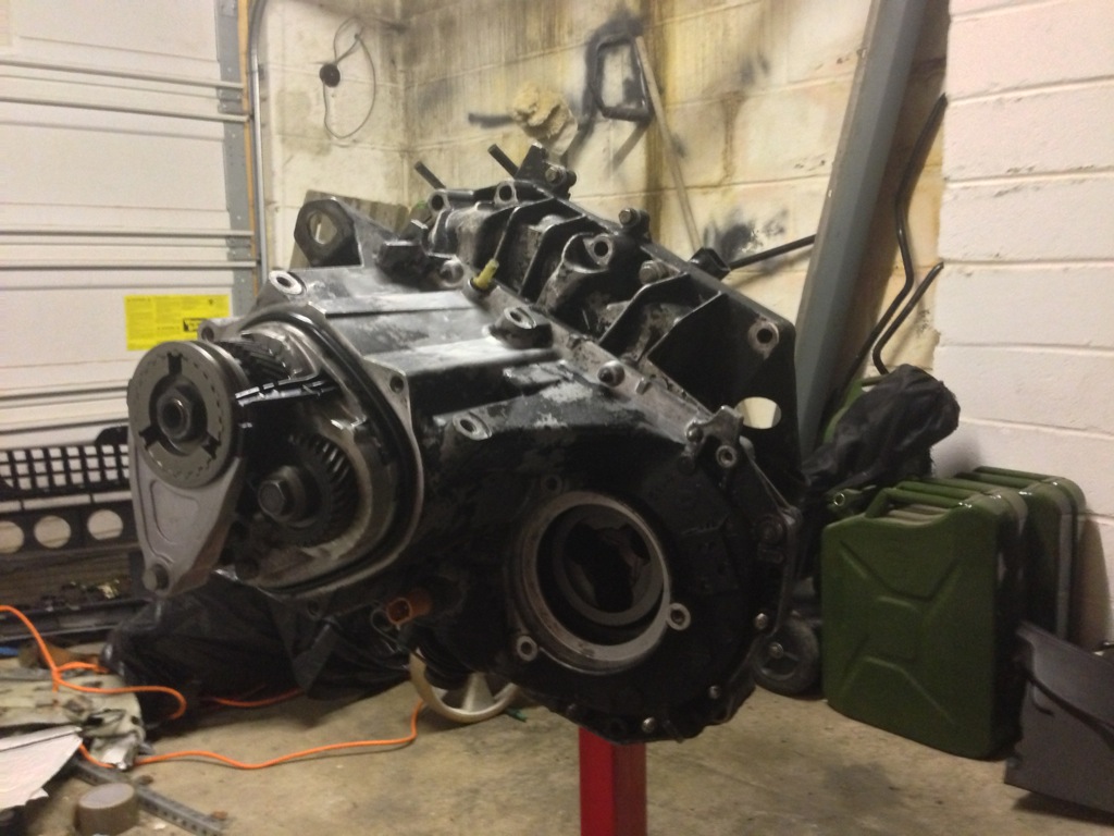

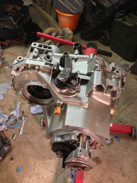

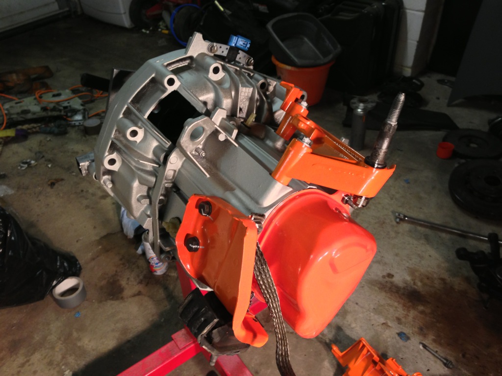

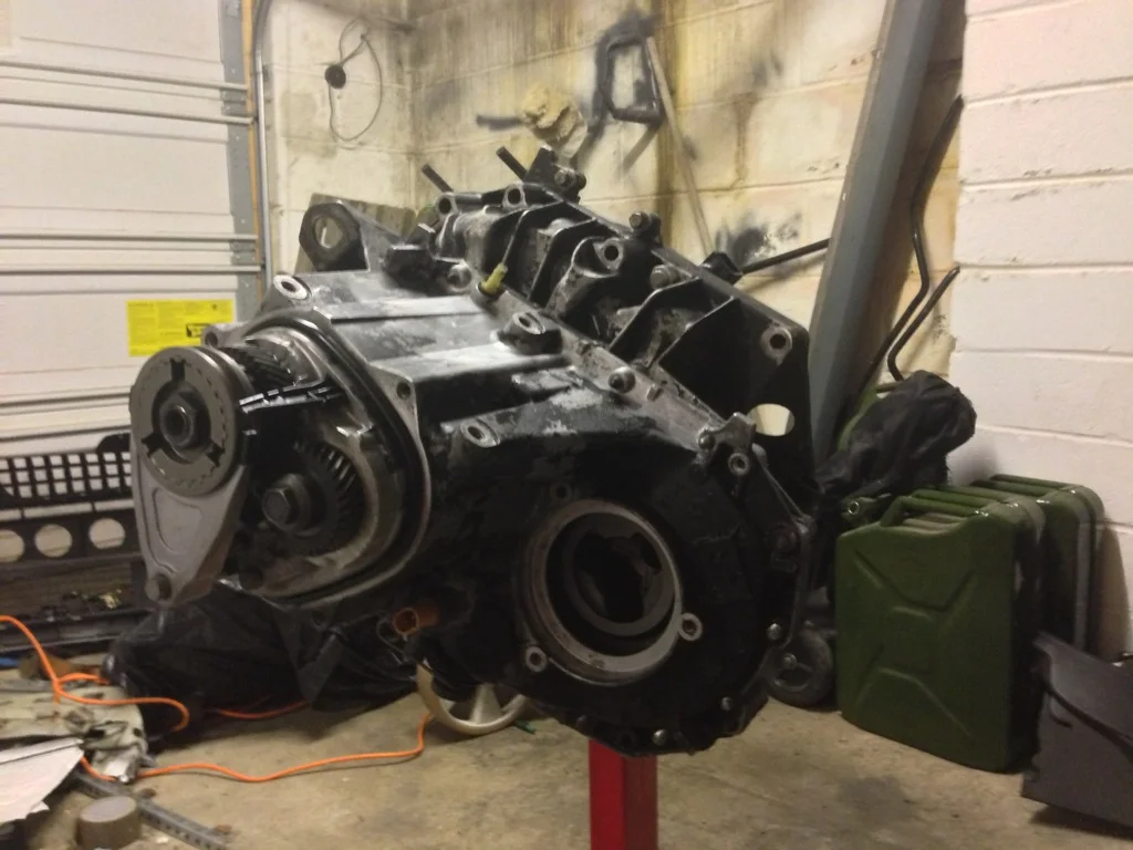

It was then time to assemble the flywheel and clutch to the engine and also build the gearbox back up after a lick of Alumna blast
I was working my week around getting the car into a state where I could fit the engine on Saturday as very kindly Russ (Sprintcup) had offered to come round and help.

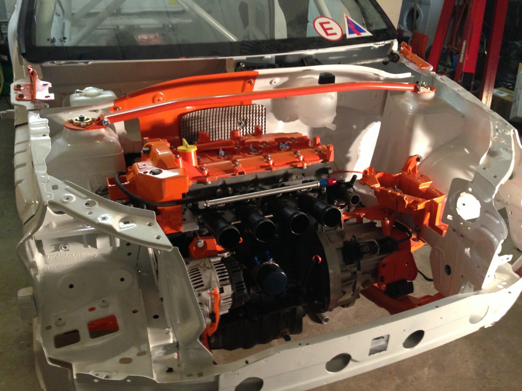

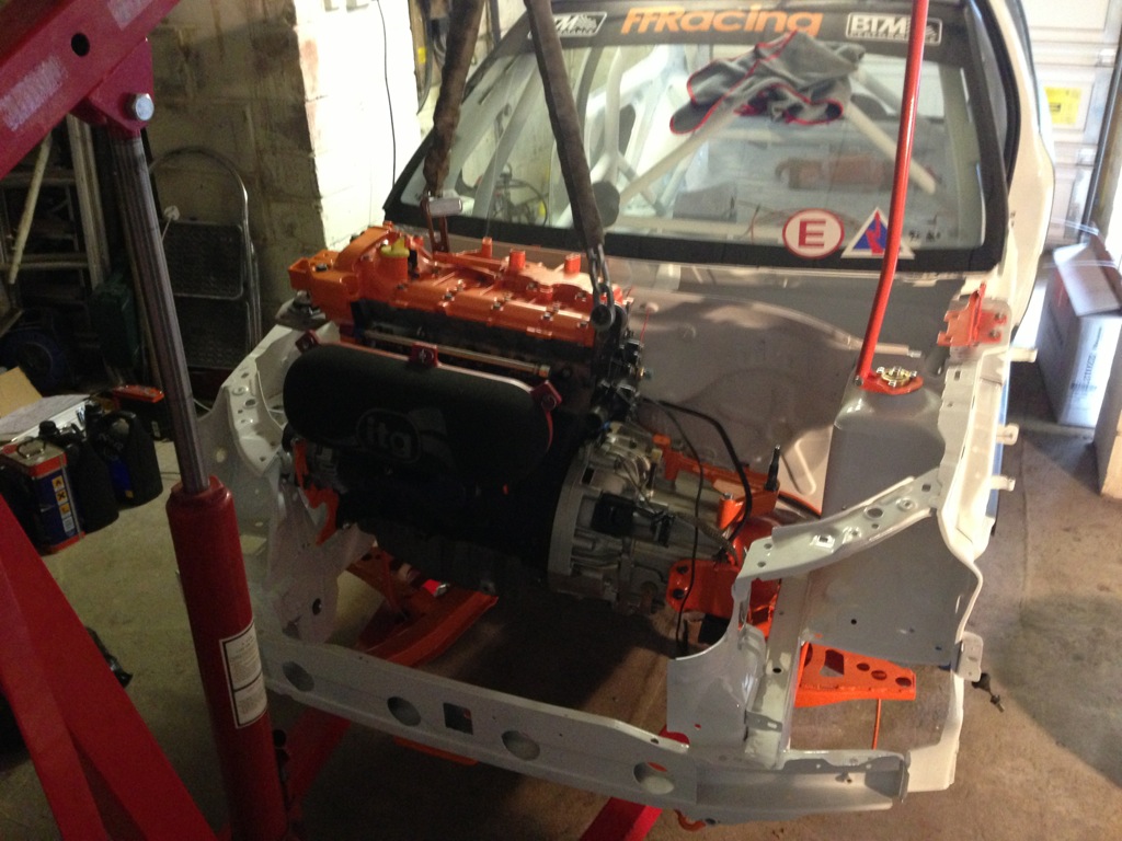

So this morning after a rather delayed start as I had a house viewing and didn’t think they would appreciate me shuffling an engine in myself and Russ got started on getting the engine back in.
We started off by mounting the box to the engine that I was worried about as I didn’t have a clutch alignment tool but all was okay and it sailed on. Then we started to line it up to the engine bay. As you can see in the photos all the car is fresh paint or powdercoat so it was a rather delicate mission and after one hour of swearing it was in the hole and then Russ and I got cracking with plumbing it in and doing engine mount’s, clutch and throttle cables etc.
While having Russ to help out it seemed wise to get some more of the bulkier jobs done so we got the fuel tank and line in along with also a couple of other bits that required more skills than I have :)
I really owe Russ big time so thanks mate! True legend driving all the way over to help out

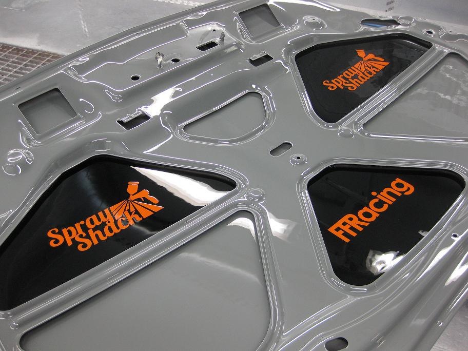

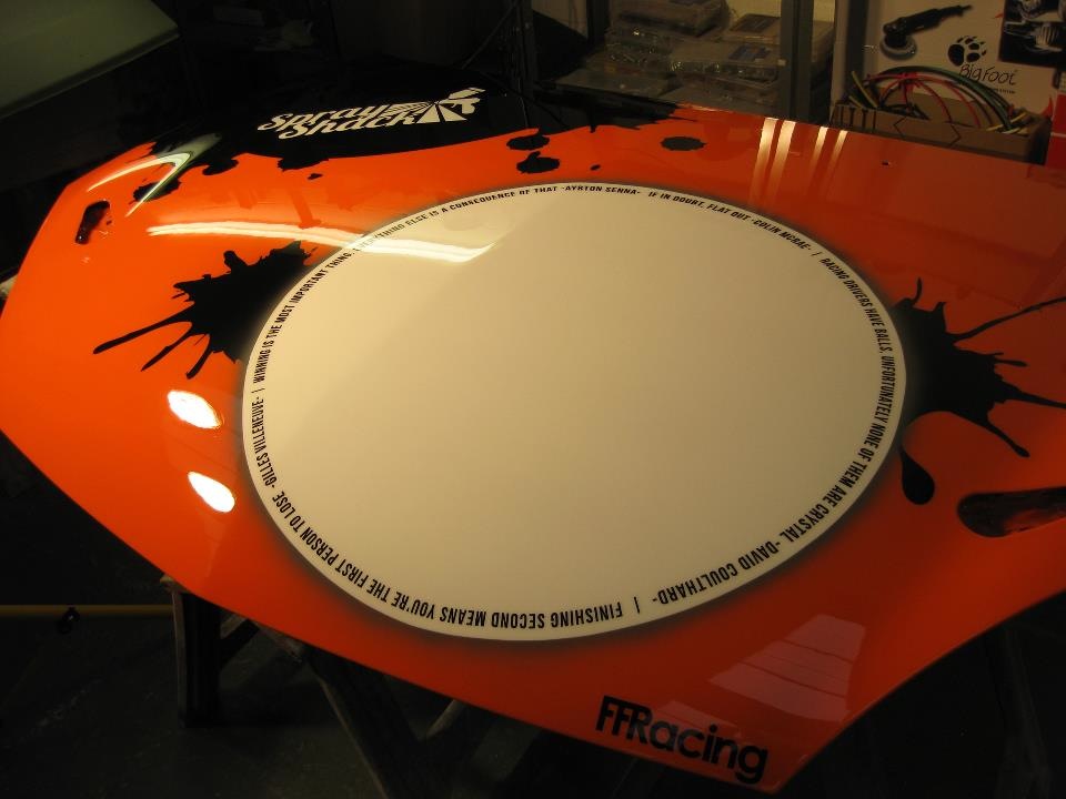

That bonnet is wicked. Sponsor going in the space?
Thanks mate, the sponsor is already on the bonnet ;) It's for the race number

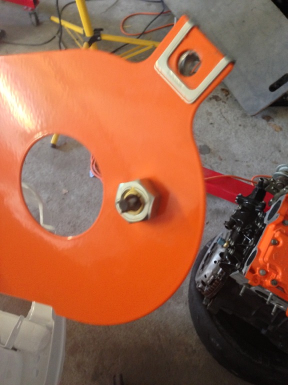

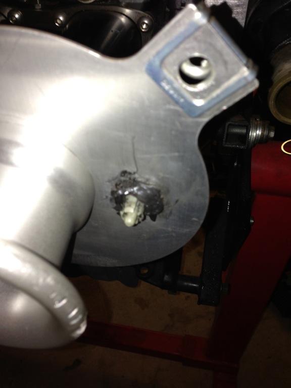

Not trying to tell you how to suck eggs mate, but id be making sure this nut doesn't come off and get sucked into your engine, maybe a spot of Loctite on the nut?? ;)
Scott
  A special one.
^ Good stuff, we had an Aston racer that sucked up a bolt made a right old mess...:(
And a Austin Healey 3000 that sucked in part of its weber carb and jammed the thottle open.
