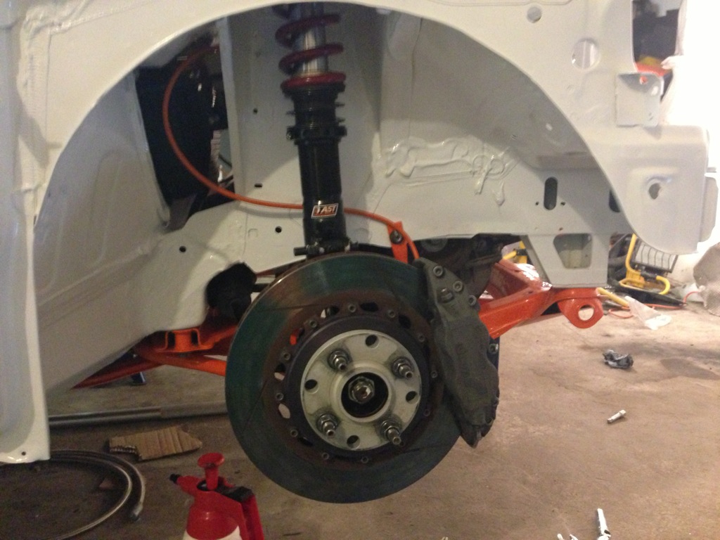

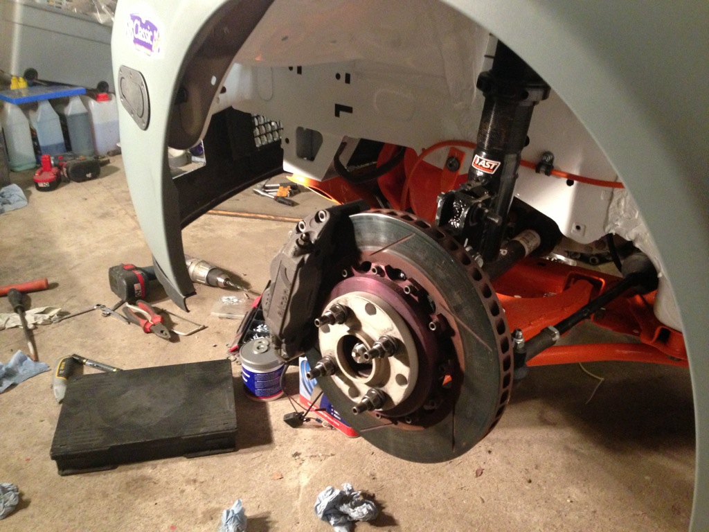

Managed to convince a friend to come over today to help me bleed the brakes and all went well and finished! Just checked the system now for leaks and all is okay except the two front Alcon callipers are weeping from the thread area on the bleed nipple. Looks like i'm going to have to get the callipers off and see whats wrong with them but after a quick look on the internet it sounds like more of a problem with the calliper than the bleed nipple itself which i'm dreading as I don't fancy shelling out for new callipers. Has anyone got any experience of this and how can it be sorted? Obviously the issue is with the sealing seat as that is what creates the seal rather than the thread.
Thanks
Thanks

I dont know specifically about the Alcons or the the issues they may have but all you can do is get a good look at the seat area and see if it looks galled up, there may also be witness marks on the bleed nipple to give you some clues as to what's going on. If the seat is damaged I should imagine it'll be repairable though.
Thanks Kenny just when I'd finally got the car on the ground and pretty much finished :( I've spoken to Alcon and Ear's. Alcon say it must be the seat damage and would need new casings to the calipers so then I spoke with Ears motorsport who manage the repair service and they said cheaper for new callipers at £1080 I nearly fell off my seat! Seems like this car is still hating me lol. I've got one other possibility at the moment so i'm keeping my fingers crossed!

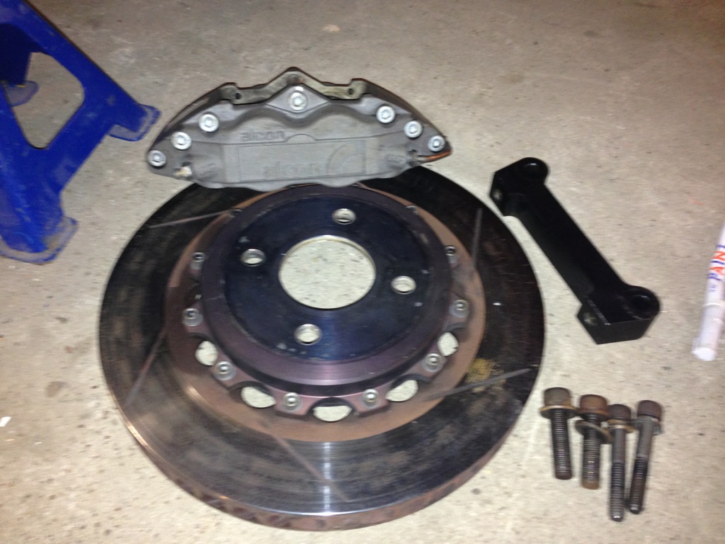

That seems a bit extreme, surely you can't just write off a pair of calipers because the seats for the bleed nipples are a bit damaged!? Did they not even mention the possibility of refacing the seats?
Have you got any pictures of the calipers handy?
That's what I said Kenny lol! Nope just needs new casings on the calipers if it was just one that was the issue then it wouldn't have been too bad but its all the nipples so cheapest option was new (Which isn't an option for me)
Do you mean the actual setup or of the leaking/seat. I'm going down to the garage now to remove them so will get some more pics but these are the ones I have of the setup
How the FK can the calipers be damaged, this is what I want to know!!
Someone suggested the casting to blame or as Mark says hopefully my other possibility will work out and can get them sorted if not I have another back up plan if not that then standard callipers. Fred did notice it back in September but it was only very very slight like a haze but now its properly leaking.
Yes Mike could just use the standard setup but would mean new brakes lines, needing to buy new pads, disc's and get the knakered std callipers I have refreshed :( Plus would be a shame to waste the decent brakes, I'm sure i'll get them sorted :)
What do people think to me machining the threads off a bleed nipple so it fits in the calliper without needing to be screwed in and then use valve cutting paste on the face of the seat to lap a new seat?
Might work, but I'm sure if it was that easy, you would have thought that they would have suggested doing it.
It probably is that easy, but it's a lot easier to just say fit new and charge the customer, all industries are going this way unfortunatly as it seems the skill required gets lost.
