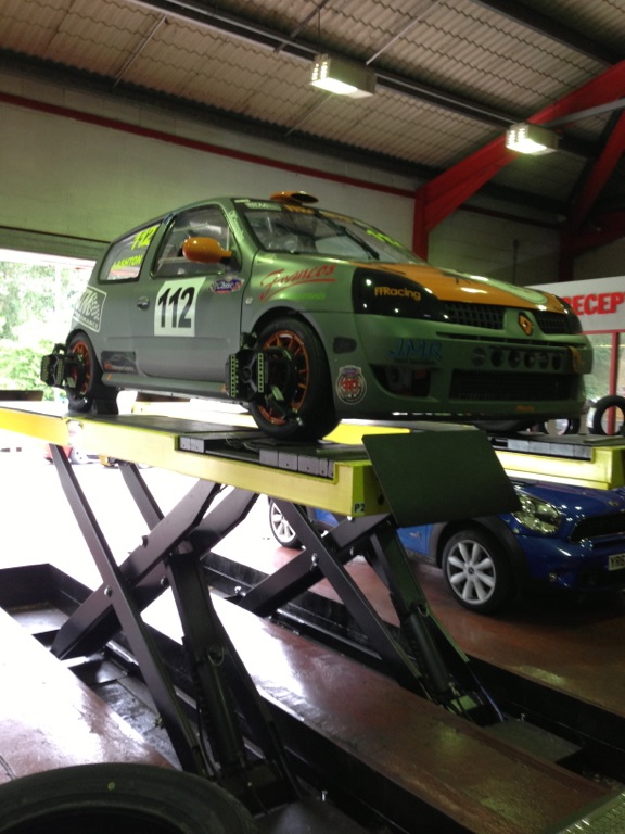

When I got home in the afternoon I got the car on the ramp for a quick check over and only a couple of little issues to fix, the passenger side gaiter where it goes into the gearbox is weeping oil but it was brand new so not too sure why it's leaking. The other thing is the oil cooler still weeping ever so slightly, I have checked the connector again but it's not that so I think it must be the actual cooler that is leaking.

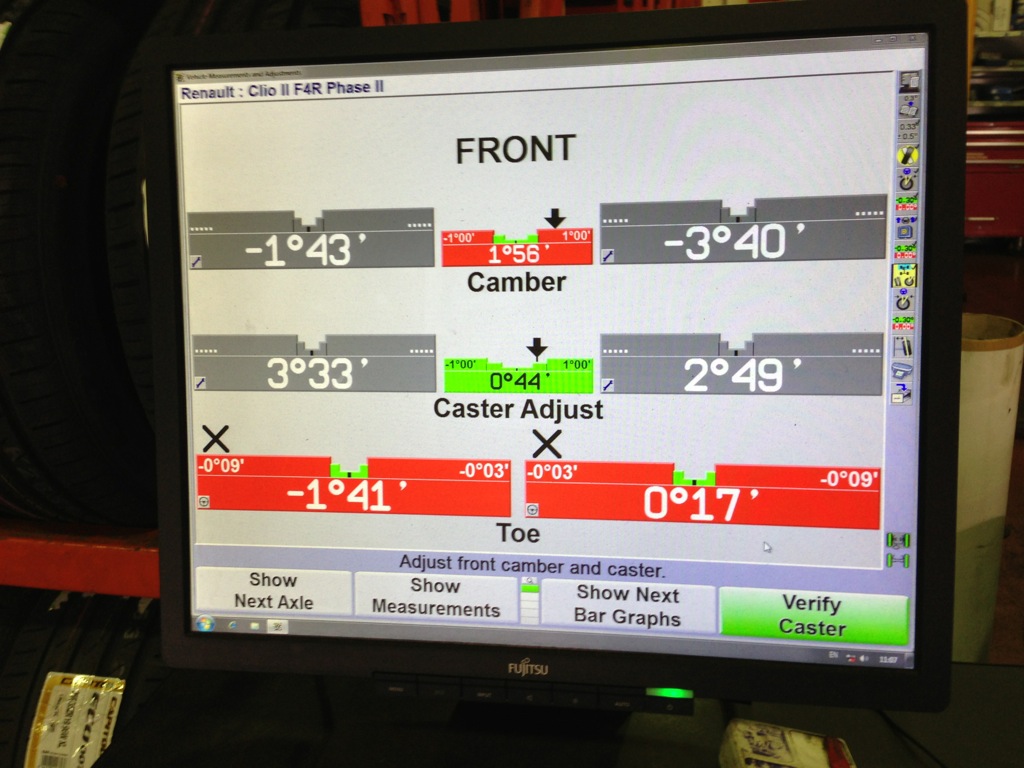

I went to get the alignment checked as it was only done on the Tuesday and it really didn't feel right. Sure enough it had slipped and had lost 2 degree's of camber on the passenger front and also that had induced nearly 2 degree's of toe out. It certainly explains why the handling was a bit odd. This has been corrected again and I helped out this time and checked over all the bolts so i'm confident it will be fine this time. The car now needs a proper check over to try and work out the vibration and also just to finish off a few finishing touches that have arisen and then some more testing time to optimise the setup and get it feeling good so I'm hoping to do another Mallory morning test before the race on the 3rd August
