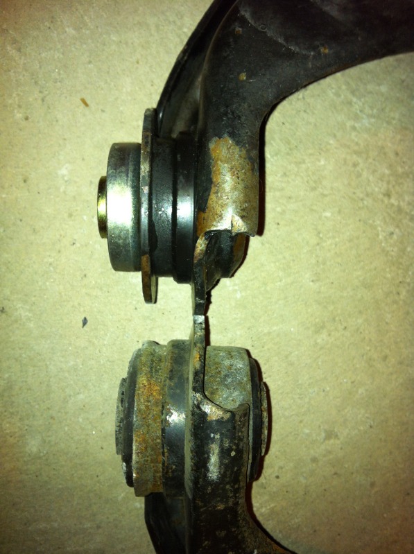

Extra caster is easily achievable on a Clio by adjusting the lower arm bush offset like so
There's an easy 11mm of adjustment available by just off setting the bushes before you even have to modify the shape of the arm, no need to re-drill ball joint mount.
All that's needed is 2 large washers welded in the right place and one of the bushes to be pushed in from the inside. It would be ideal for people running AST mounts as the 2 combined would give a good amount of caster.
For people running the pure motorsport kit and powerflex bushes on there lower arms, these need modified anyway to work. I keep meaning to speak to Pure as there kit seems to be fitted equally on each side of lower arms and with a small adjustment in design they could be selling kits that alter the caster by varying degree's.

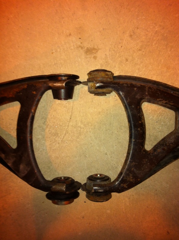

I'd need a picture taken further away to see that properly.
This is the only pictures I took before fitting them, exactly the same as cup arms. If there is any variations throughout the 1*2 range with lower arms then the cup arms must be the best base to start with they have fitted offset bushes.
Arnt the cup racers bottom arms fitted with offset bushes for increased castor ?
Yeah these are a set of cup racer arms I have managed to get.

That picture is better, can see it better now.
Apologies Ash for cluttering your thread.
Is the cup racer wishbone same a standard one is the profile different? are the ball joint hols in the same place ?
  Cup In bits
Re: James/BigAsh 182 Race Car by TDF... It doesn't get much better than this! *Pic He
They are exactly the same in every way to the ones I removed from my 172 cup, just offset bushes fitted. The cup racer ball joint/uni ball makes all the difference in there setup pushing out each side 20mm. I have been told that there are different arms fitted to 172 phase 1's, phase 2's and 182's including the cup versions. The sets I have compared to are the same as my arms removed but I don't know if they have been the correct arms fitted to the cars I checked against.
