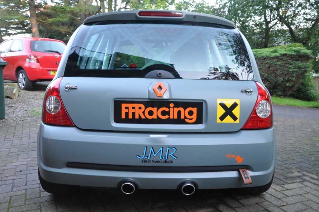

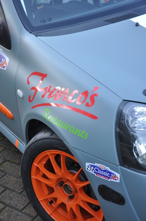

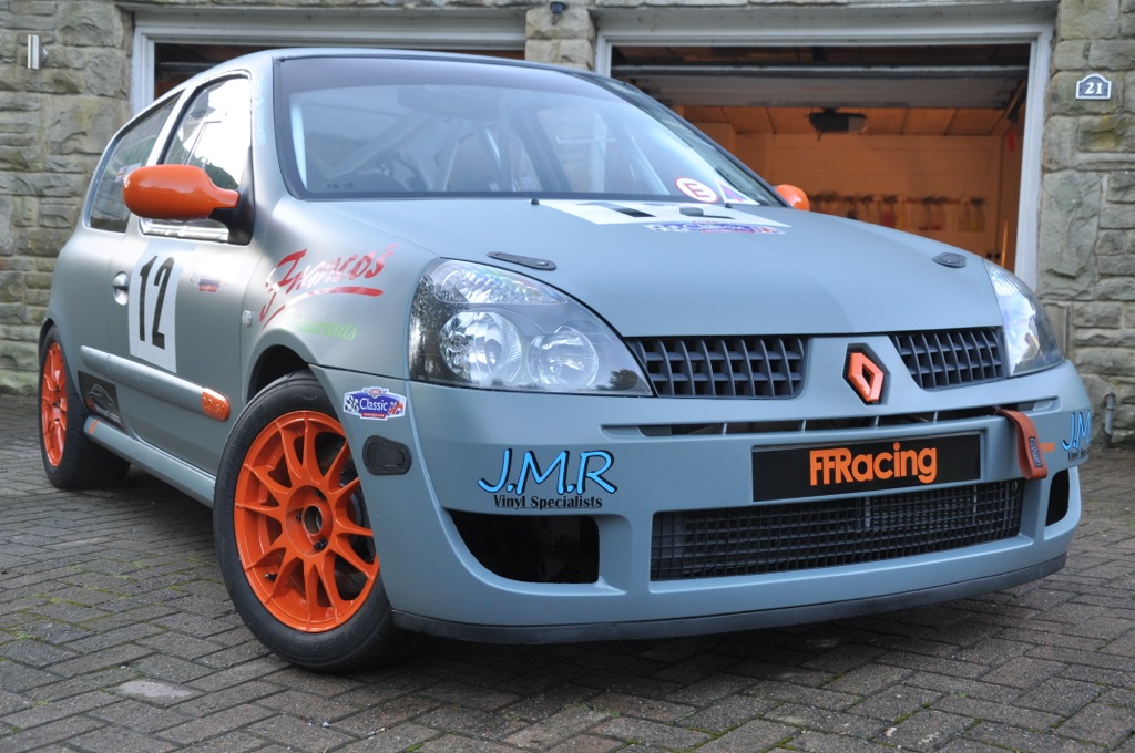

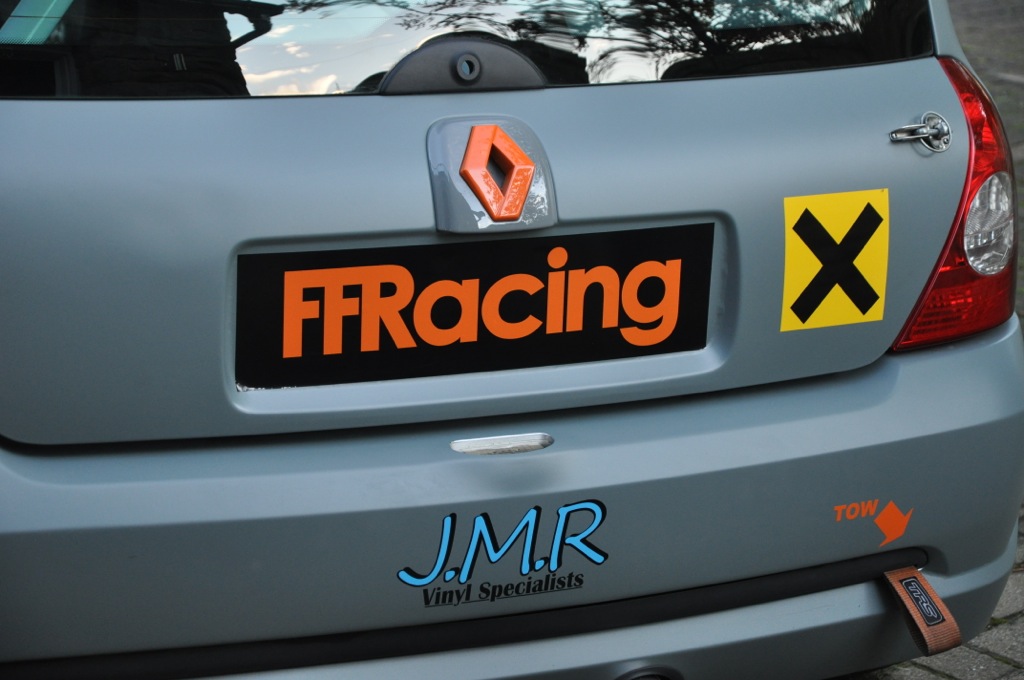

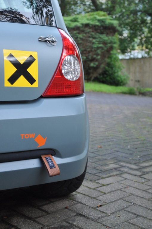

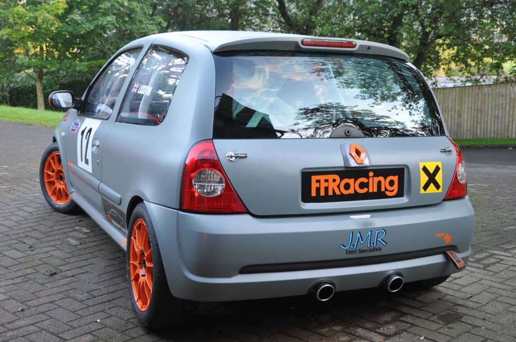

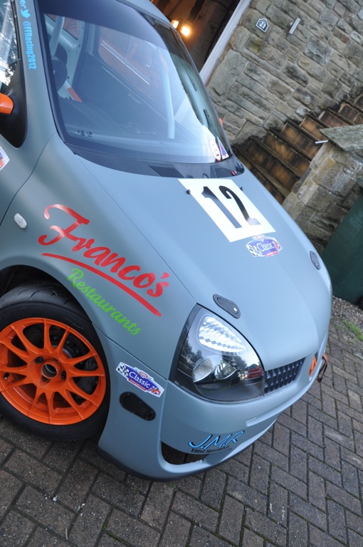

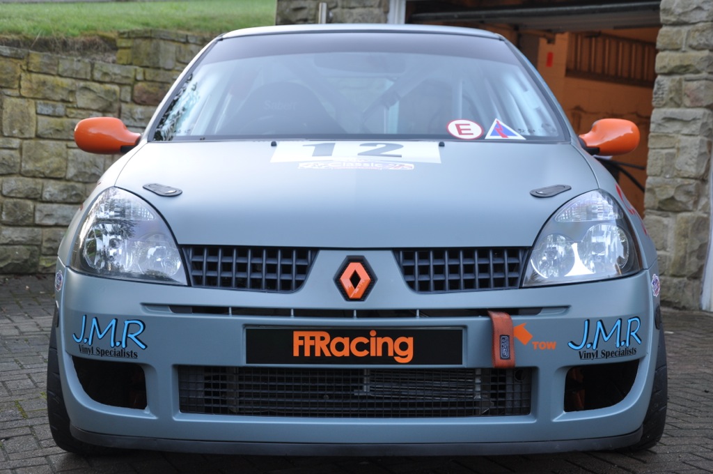

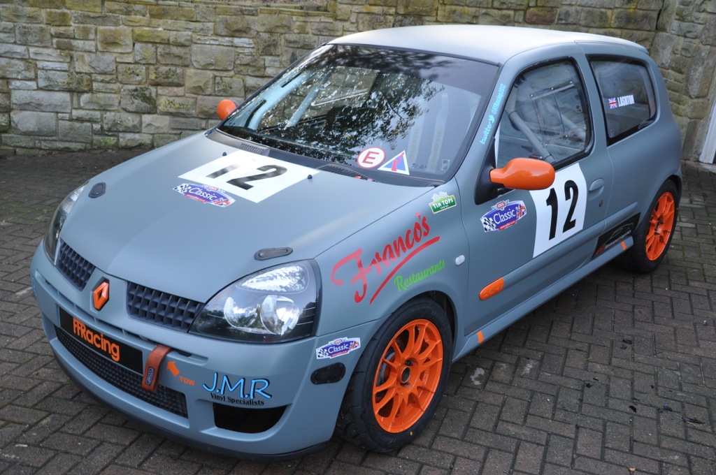

For those who aren't on Facebook then below are some pictures from today :) The car is now fully ready for Donington apart from I just need to refit the top mounts when they get the new bearings and will take it for geo setup en-route to Donington!
