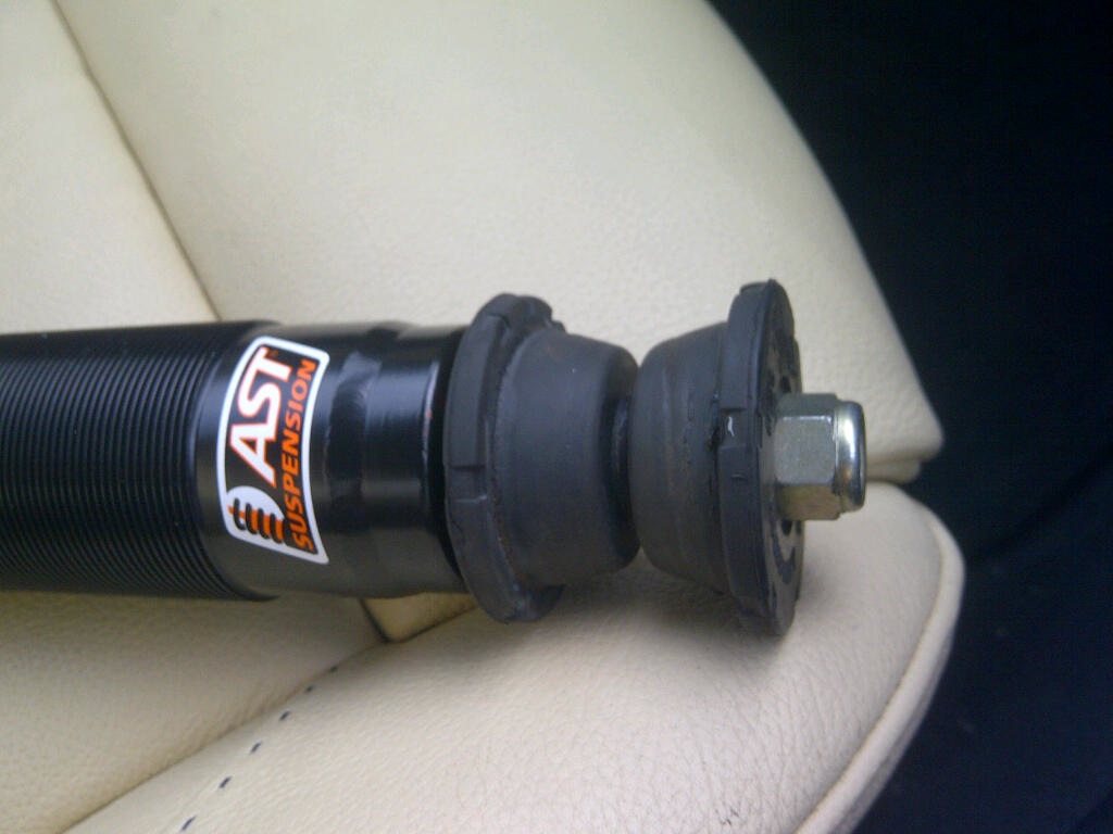

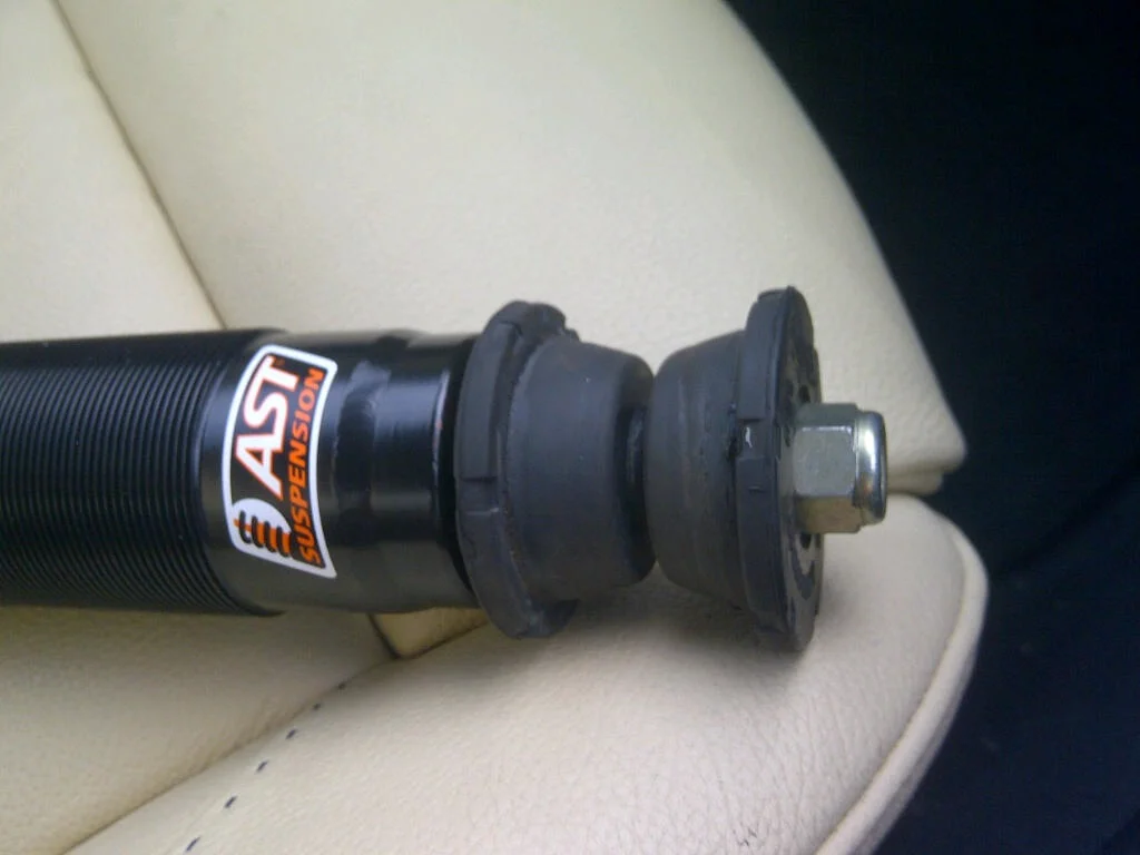

So Since Anglesey a lot had been going on behind the scenes and I was trying to sort out new suspension. I made the decision about 2 weeks ago to go with the AST sportline 2’s and Josh from Cooksport got these delivered to me direct from AST to save time as he knew I was wanting them urgently and he was really helpful. Unfortunately a few bits didn’t arrive with the coilovers so took a few days to end up with all the right bits but have to give it to Josh he pulled out all the stops to ensure I got sorted ASAP and I wouldn’t hesitate to recommend him.

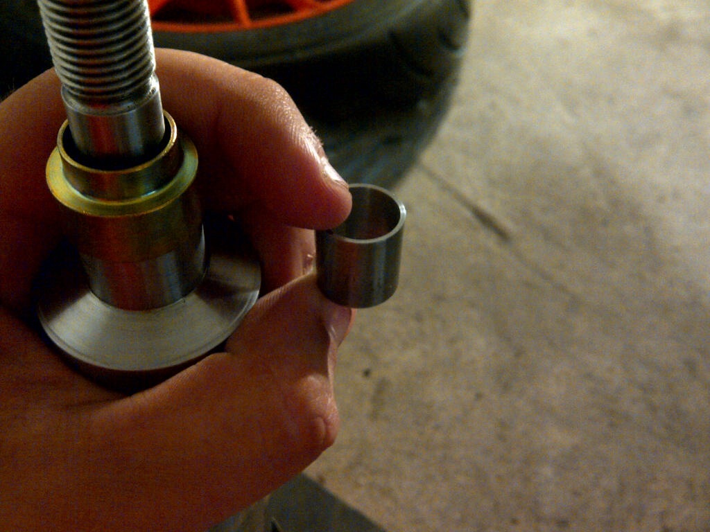

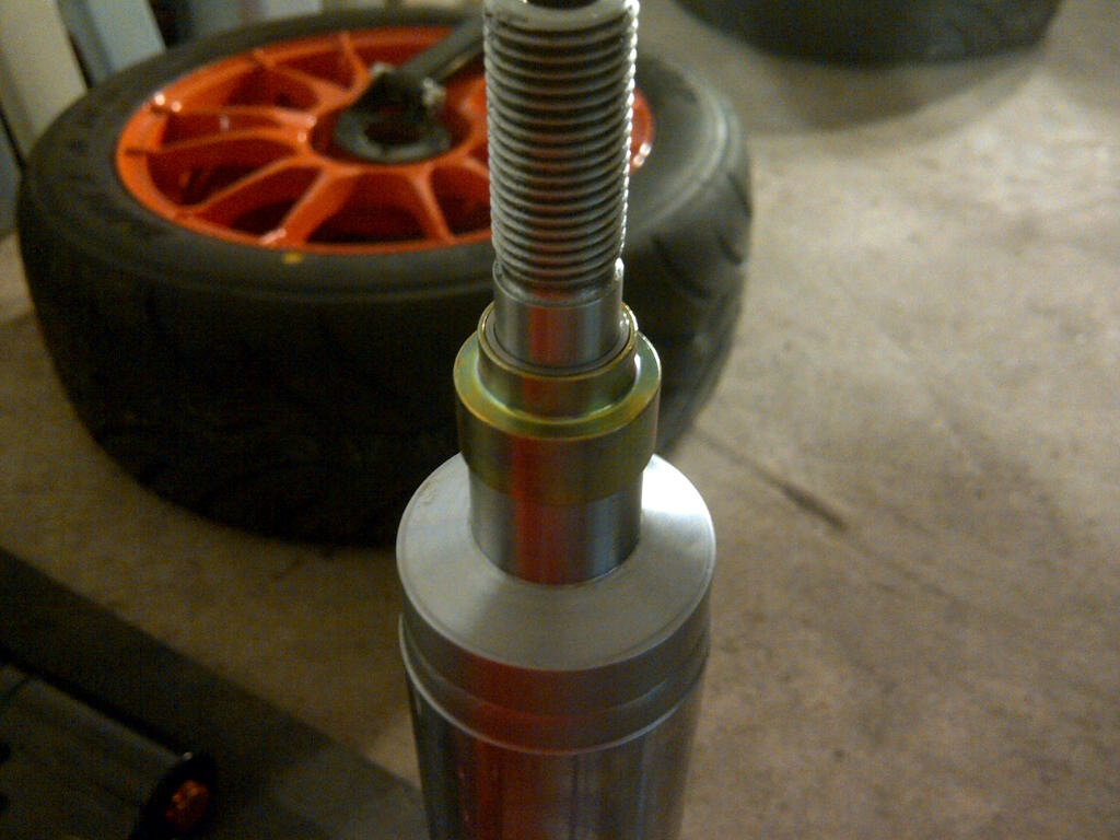

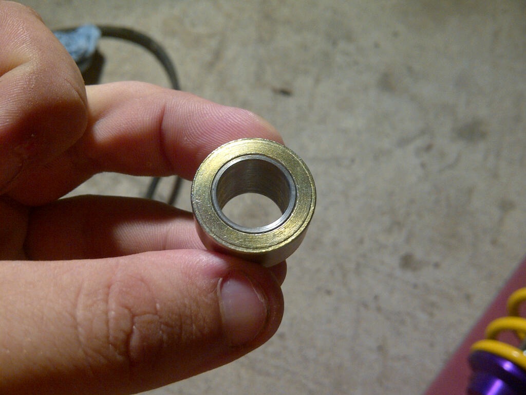

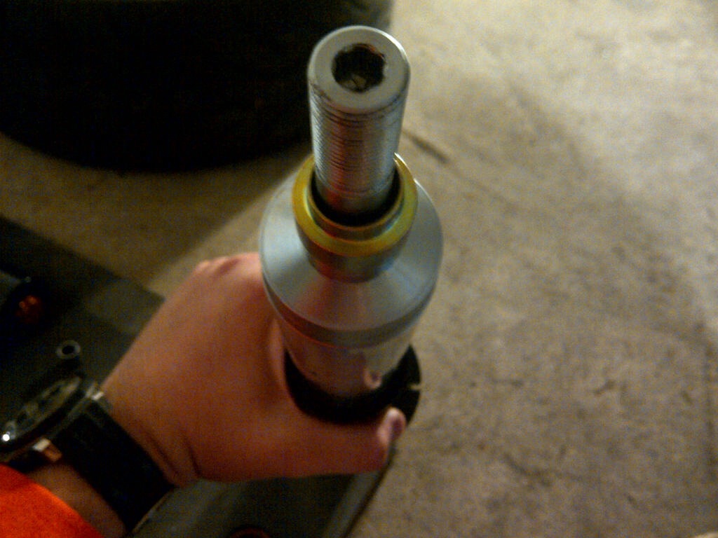

Once everything arrived I got on with fitting the kit which is where I came across my first issue, the KW’s that were coming off had a different diameter thread so the bushes and nut’s wouldn’t transfer over and I didn’t have a set of standard items to fit. (Thanks to Jay for making me realise what the issue was)It was late on a Friday afternoon and with the car booked in for setup on the Monday morning I was just trying to get them to fit. Trying to work out what nut they needed was a mission in itself and turns out the are metric fine thread with a very fine (0.75mm pitch I think it was) I couldn’t find one for love nor money but then luckily Kat at Renparts returned my call and said they had a set of the bushes and nuts but had missed the post for Saturday. I had 1hr 30 until they shut and it is a 1hr 30 journey so it was time once again for me to get my toe down. Luckily got there just in time complete with AST coilover to test they were correct.
Then upon returning home I proceeded to fit the suspension but when I had fit the fronts there was play in the wheels. I swapped the TRE’s, knackered the ball joint while trying to check it but then realised it was the bearing in the top mount that had been vibrated to death from the knackered H+R’s at Anglesey. This was an issue as the car was booked in for geo on Monday morning and then I was busy until the trackday so would have had no time to get sorted. I left Pure a message and they kindly retuned my call first thing Monday to say they could ship some out to me special delivery. Kindly one of my friends offered to get them delivered there then he would fit them into the top mounts and drop them off for me at home ready for me to get home Tuesday night, fit them and take it for geo en-route to Donny. All went to plan thankfully and went about fitting them when I realised that the I.D of the Pure top mount spacer is different to the diameter of the AST strut. It was 5 to 5 on the Tuesday so I went to my local precision engineer and pleaded with him to machine me up some metal bushes to correct the I.D issue. Thankfully a crate of beer was a good persuader and I got sorted and went back home and fit the front suspension.
I gave the wheels a wobble in the 12-6 position and no play so was relieved then just casually checked 3-9 position and still had play! I was gutted, by this point I had replaced the TRE’s, Ball joints, top bearings so all it could have been was either the rack or the inner tie rod’s sure enough when I stripped back the gaiter it was the tie rod’s. Nothing could describe how I felt after all the time I had put in to get the car ready. I called Fred at nearly 10pm and woke him up :( sorry mate! He was frankly awesome and offered to squeeze me in on Wednesday and then if we had time to spare then we would go and get the alignment done before the trackday and he would also do the corner weighting.

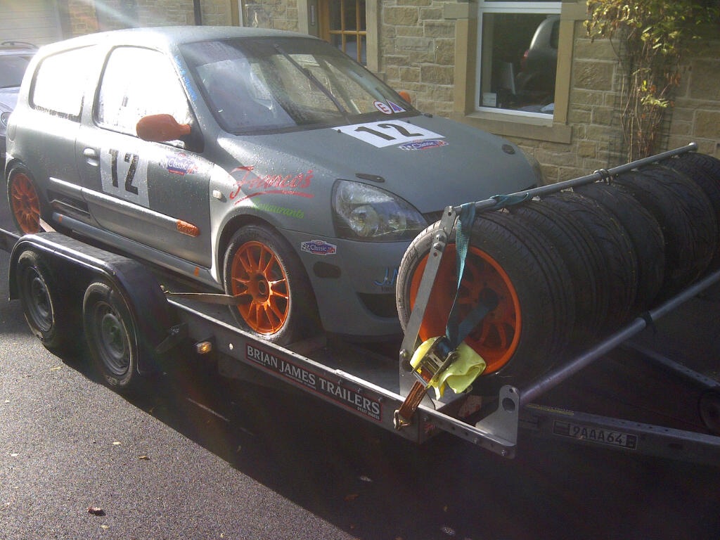

So I got the car all packed up all with associated gear for the trackday. Managed to get about 2 hours sleep before setting off to Birmingham.

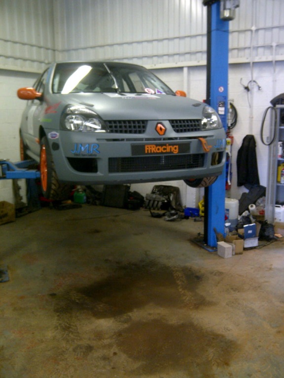

The parts were already waiting when I arrived with the car and Fred got cracking :) It was great to meet Fred, Sam and Zoltan and they really did save the day. By the time I had finished chatting away it was too late to safely get to Warwick and get the alignment done so Fred offered to do what he could just by sight and to say I was not optimistic was an understatement. I said I wanted the front to be fairly parallel and sure enough following a short test drive it was remarkable how good it felt! We quickly put the car on the scales to check cornerweights and it was well within what it needed to be but the total weight including me was 1130kg which is scarily heavy and going to have to work on the car’s and my weight over winter.
Tony had kindly offered to come upto Donington to help out for the evening and when I explained I hadn’t managed to get the alignment done he very kindly managed to blag some alignment gauges (What a legend!) So I got on my way to Donington to get a garage so that we had a level surface to work on setup.
