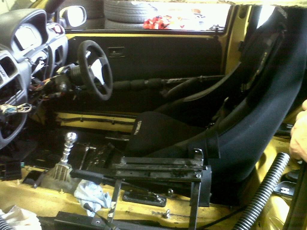

I really want to do something with my gear setup. Think it's time to have a think over winter and see what I can fabricate lol
Have you tried moving it back just on the linkage? I think you can get a couple of inches with that
Yeah done that as far as it will go. Trouble is 1st is still a stretch and to be honest I'd really like the seat to be 3-4" further back. I think easiest thing might be what's been done to yours and move the mechanism futher back and extend the link rod under the car.

On my mk1 I just moved it back a couple inches and extended the rod. Took all of half an hour. Really is no drama, just crack on with it.

Ohh, Yes its a good way of doing it I think and the way Chip has done his looks ideal compared to mine that is in the boot nearly lol!
