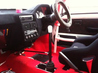

There's a gear linkage system developed for the 106 - by Colin Satchell - satchshift, it's fecking AWESOME
Runs rod's through the car - puts the gear nob high up and near your left hand. I wish someone like BTM/K-Tec would develop a similar system for the Clio. Or a cable system because frankly the gear stick in a Clio is in completely the wrong place unless you're a 5' 2" girl
TDF wanted to do something similar to mine and spent time trying but it's just not possible unless you change the selector on the box :(
Certainly not worth starting again to make those changes!
Yes I agree but starting from fresh I would do things differently and if I can get a good price for my shell so that it wouldn't cost me much to start again then I think I would do it
