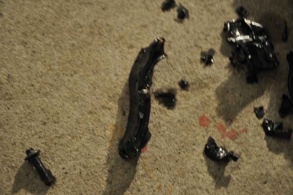

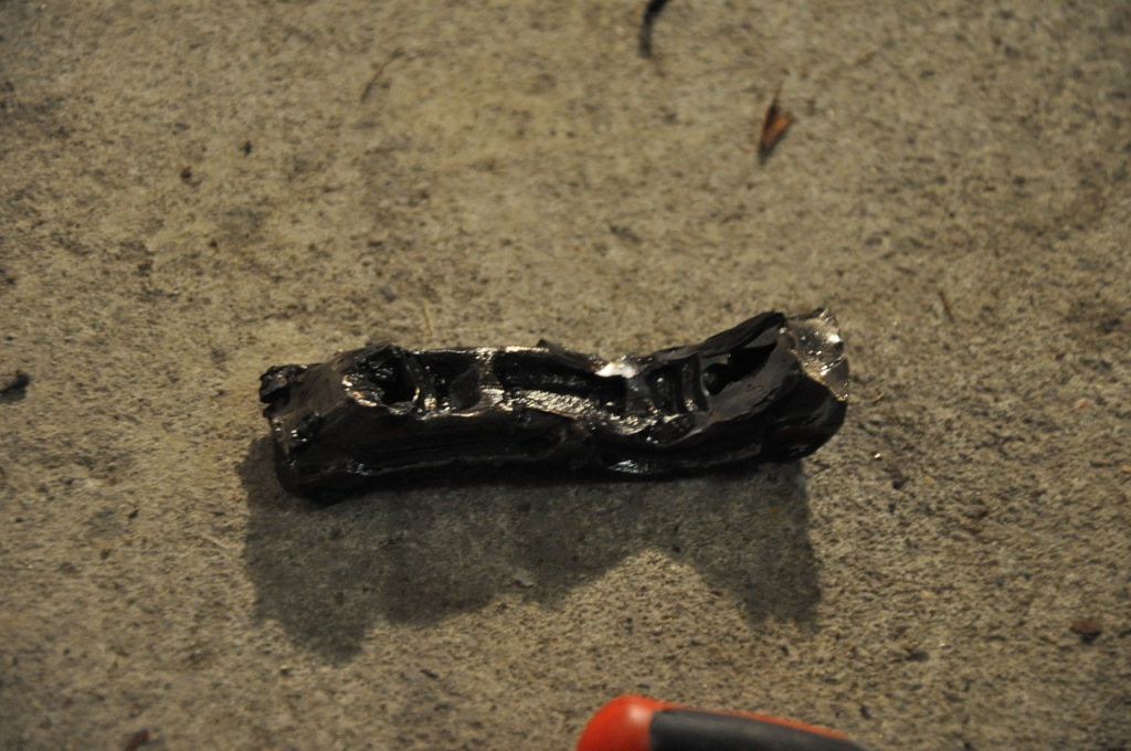

You say the bottom of the rod is missing, that makes it sound a lot like rod bolt failure rather than rod failure, as if the rod had snapped there would still be the bottom half attached to the crank in most cases.
Were the rod bolts ARP (you should be able to read it on the head of the remaining bolts if they are), as I know you had a few issues with TDF (practicing my understatements there...) and I just wondered if they did actually fit the bolts you were under the impression they did?
Its pretty unusual for a set of ARPs to fail at only 7800rpm, but on the other hand of course if the bearing had spun it puts MUCH higher loads on them once the clearance opens up as a result of thinner metal when the bearing wears down.

Yes I was kind of expecting standard rod bolts but they are ARP's :) I can't even find the two from the rod that has gone lol

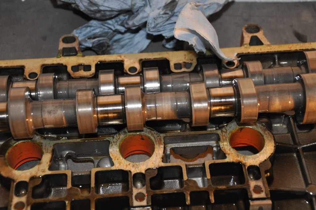

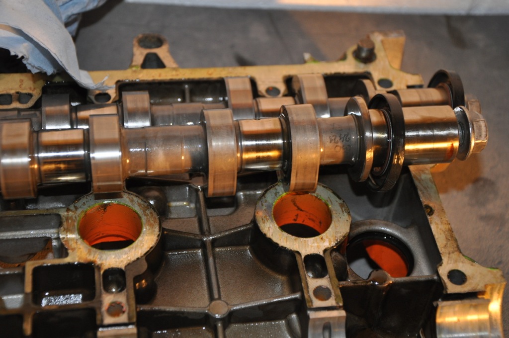

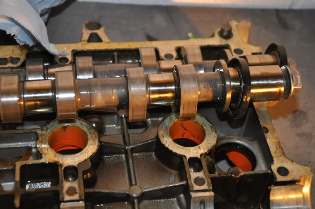

I was surprised Arron bottom end is FULL of swarf but not the slightest bit has got to the head! Cams are out and not a mark on them thankfully :)
enlighten the world oh wise one. No....wait.....shush and let the condition be decided by actually looking.
Haha you are right mate, the cams are mint from my eyes! I took some high res pics earlier so will load up later :)

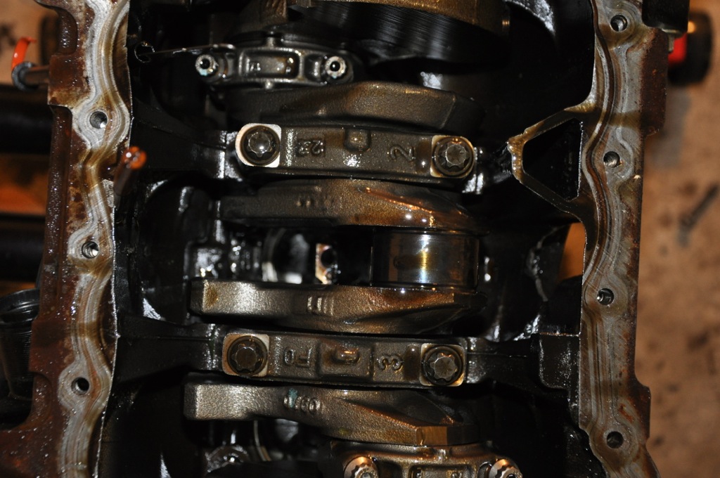

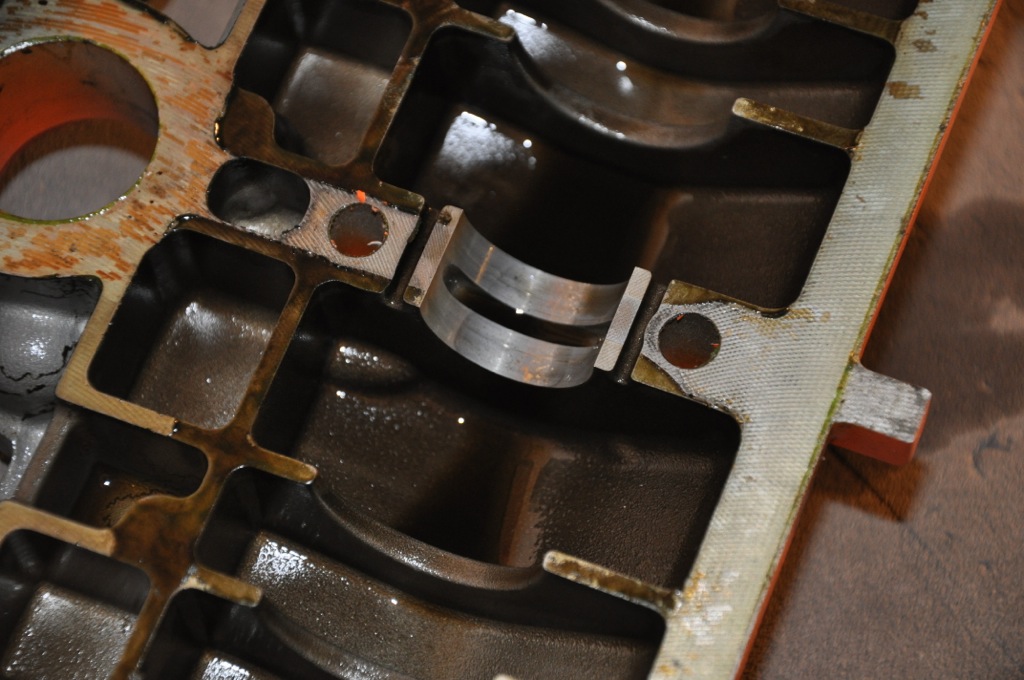

Were your bearings blue/scored etc on the other three journals that were left?
Do you need a cat for tintops and is there a set Db level for all circuits they visit or does it differ from place to place, sorry to keep asking questions but im too lazy to check regs for different championships as im trying to build a car that can go racing all over the uk with minor changes.
What are journals lol? The bits on the crank? If so i'm not sure yet as I dont have the tool to undo the arp's

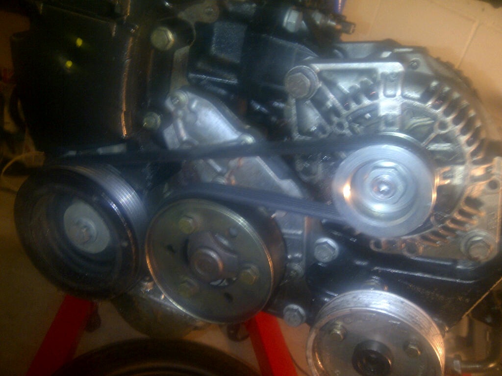

Yes cat is a requirement of the bluebook and 105 static is the noise limit :) No worries mate! I took that picture of the aux belt routing as mentioned do you want me to put it up or did you work out which way it needs to go?

Yeah that's your journals mate.

This is the way I routed it mate :)

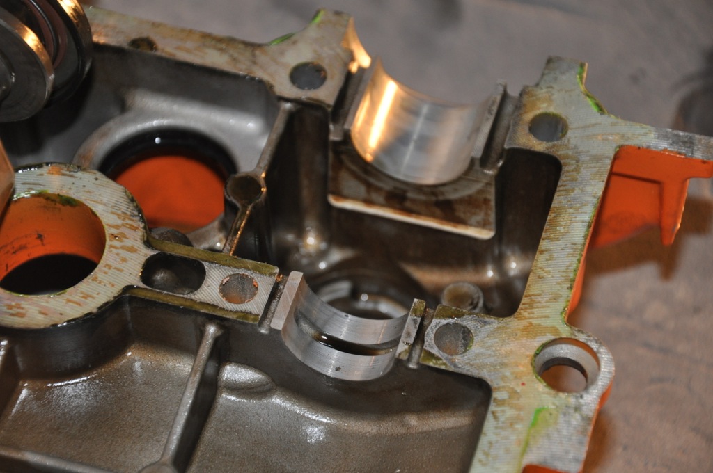

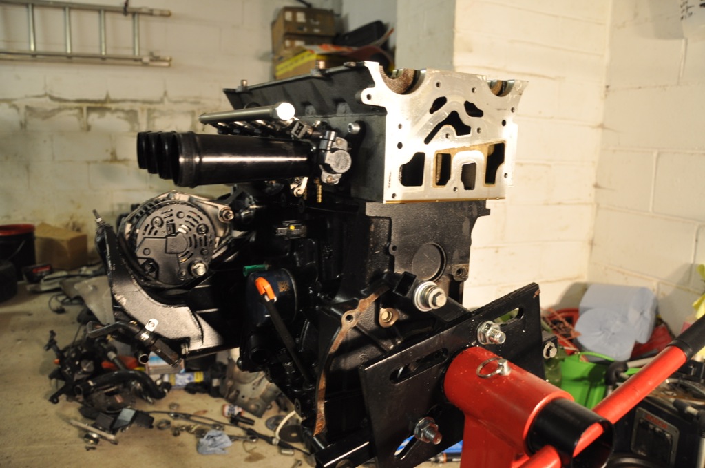

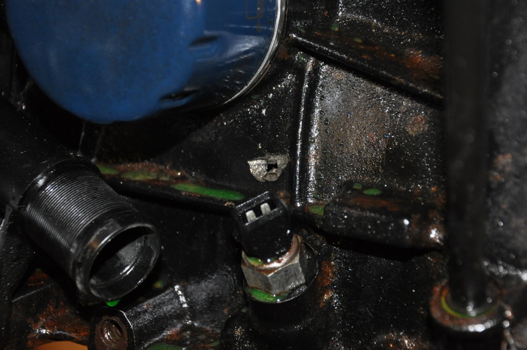

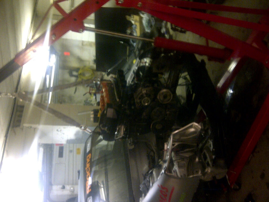

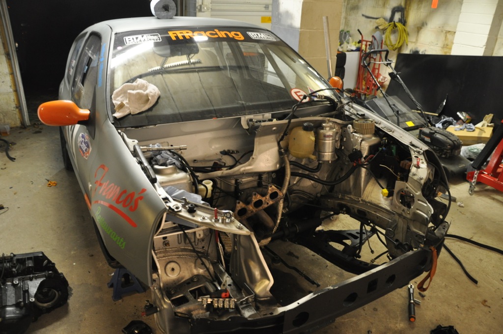

Engine:

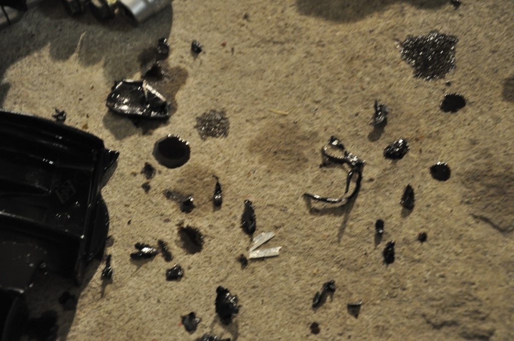

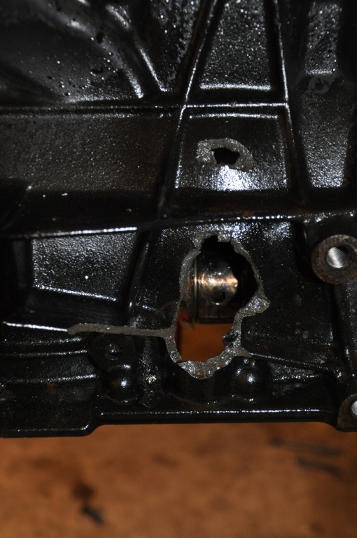

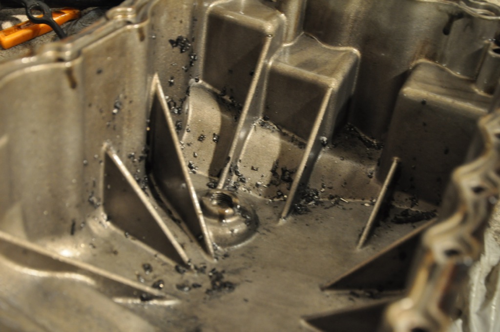

Got the engine out as planned last night and took all that I can apart with the tools I have. The breather plate seems to have been leaking as it was missing 3 bolts from where the Coilpack was mounted so I will relocate this for next year. The *end cap* (I think thats what its called) Looks to have been leaking oil into the bellhousing recently. The block has got 3 holes in 2 small and one hefty one! I think the failure is the Oil has overheated to point it hasn't been working and then bearing has gone on the rod that failed, spat out of the block and job done. I checked the oil at Teeside while testing and the oil was so thin I could hardly see it! After the engine blew it was so thin I thought there was nothing in it but yesterday when draining it was still over half on the dipstick and now jet black so think it had just got silly hot. Unfortunately the oil temperature gauge has never worked and it never had a pressure warning light or sensor fitted so I wouldn't have known until it went bang like it did! Anyway life moves on and I will learn from this and the new engine will have full temp and pressure logging :)

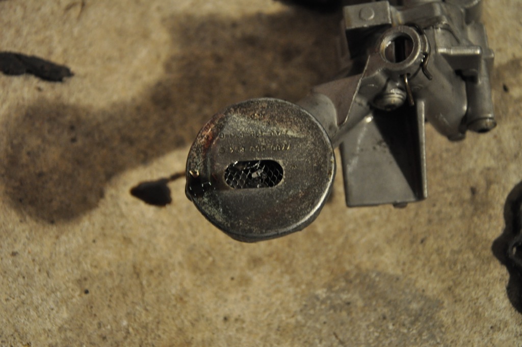

I will let the pics do the talking but the only thing that seems salvageable is the cams! Wouldn't even want to reuse the sump due to the amount of swarf and the fact it had bits of engine in it!

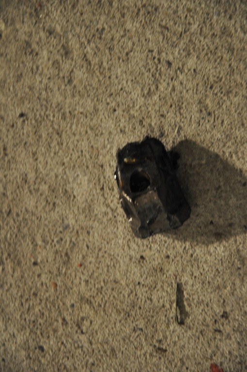

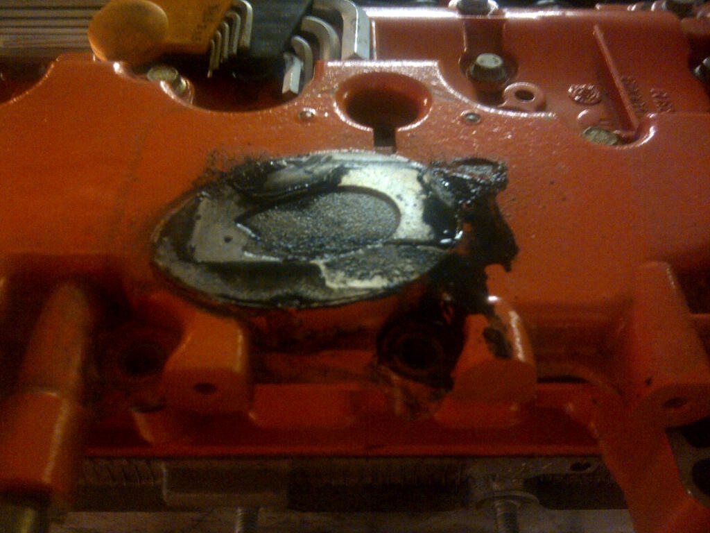

Cheers, looks like the rod cap failed, seems to be in two pieces with one part good nick and the other shagged and bent backwards.
The rod still looks pretty good/still in place and attached to the piston from your picture. Is there a threaded part of the rod bolt still left in the rod, that would say that the arp has broke then.
Rod is pretty bent to be fair but yes still attached to the piston :) Nope no sign of the bolts anywhere :S its asthough they have come loose as there is marking that something has been repeatedly hitting the bottom of the engine

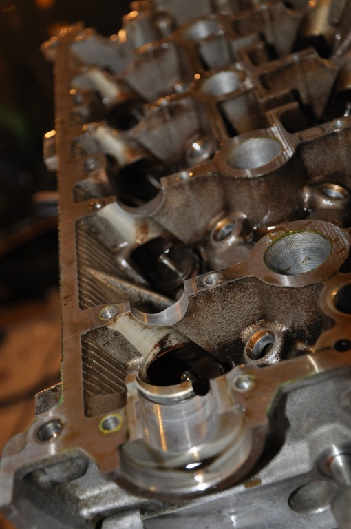

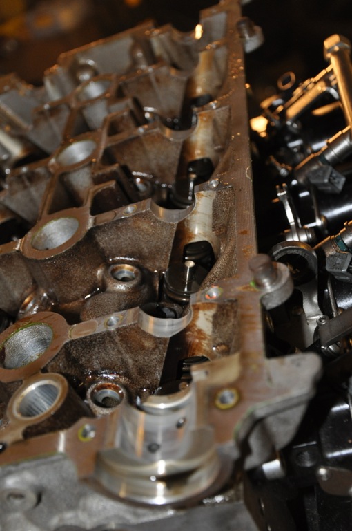

Head , cams and sump look ok from what I can see James. They look like catcams. Have a look on the shaft and there will be a number which is dotted on. This will tell you if you have the correct ones. It's a 6 digit number starting with 5 and ending on 421.

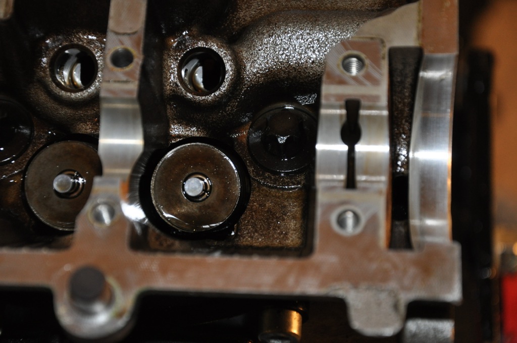

Did the valves not bend (Piccy from underneath of the head ;))? I'd keep the bits for spares as you never know what you might need

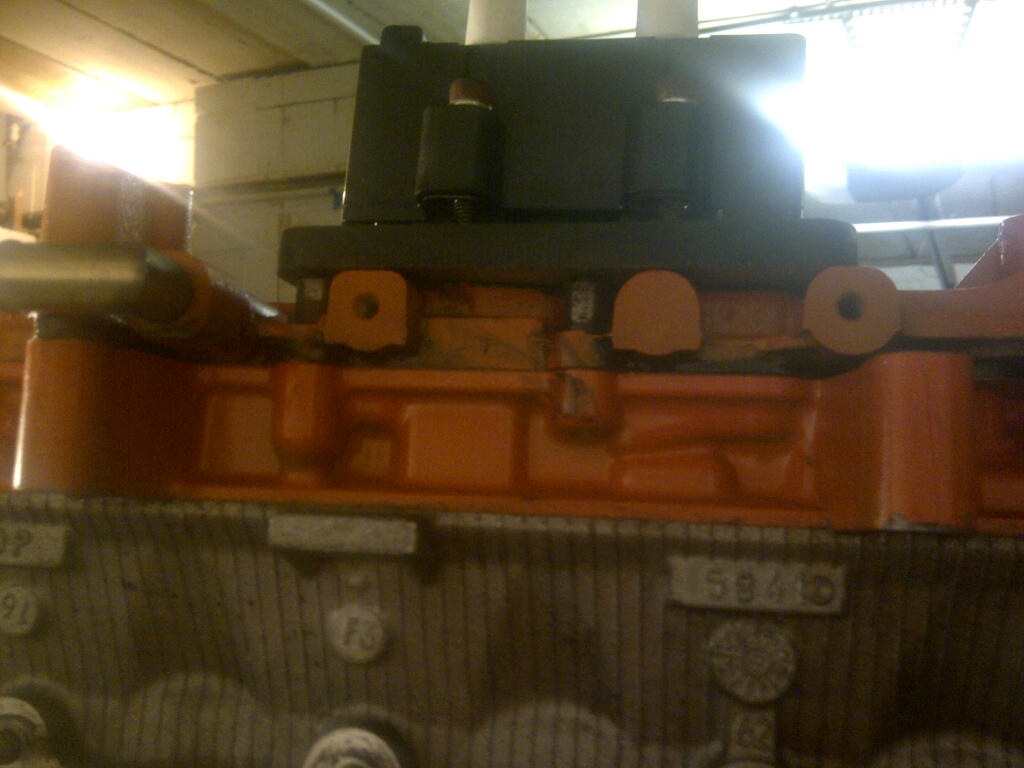

It's in at the moment Dan, sump arrives this morning and if that fails and it still leaks from that bolt hole I will just sit in the car and set the garage of fire :banghead:
