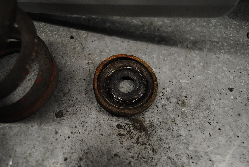

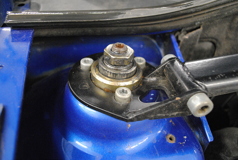

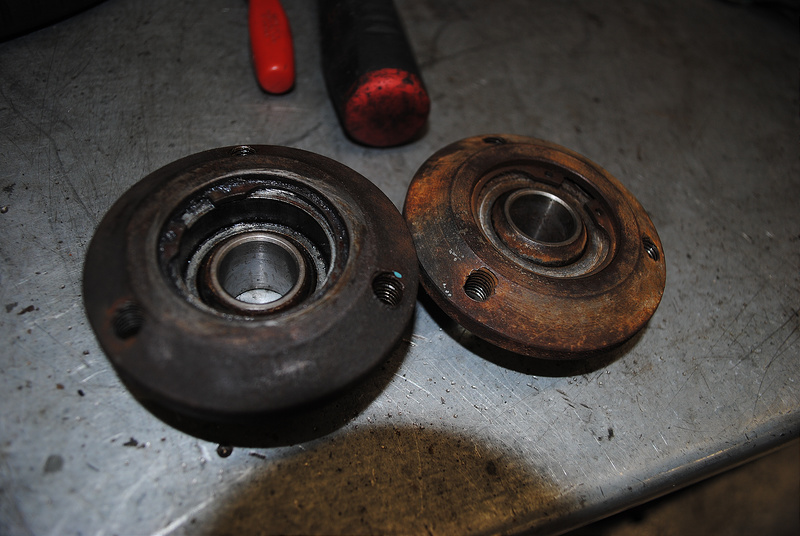

It looks like the circlip is missing from that top mount from the pictures.

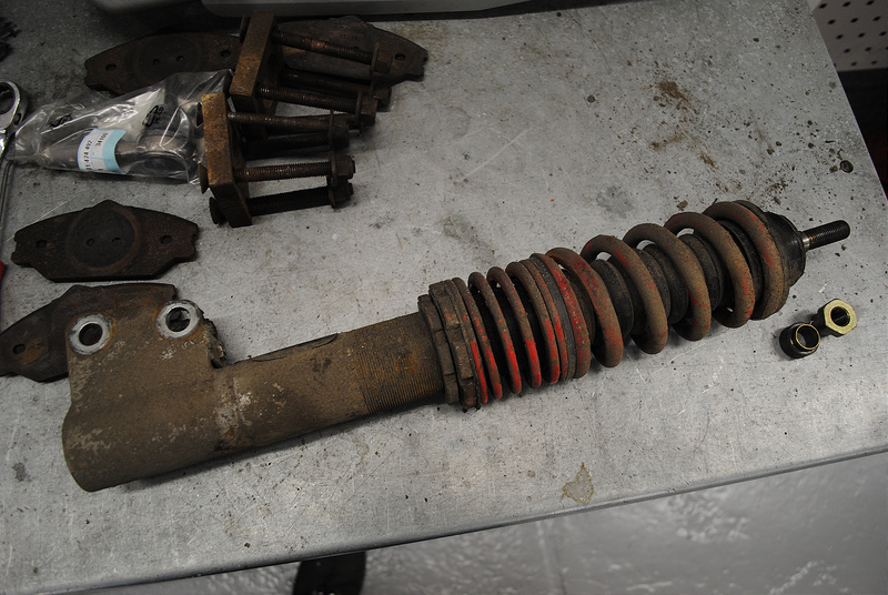

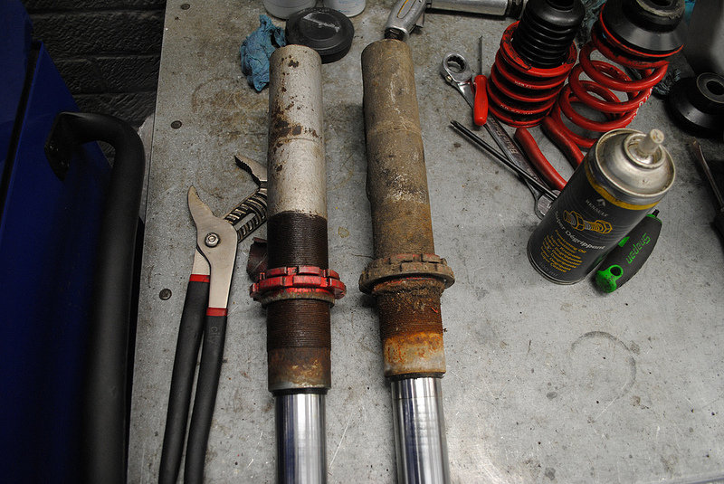

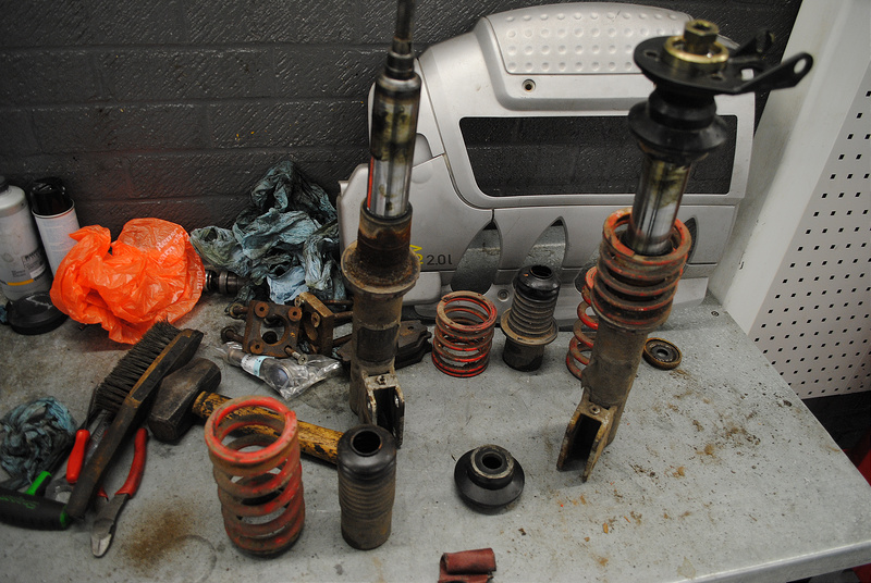

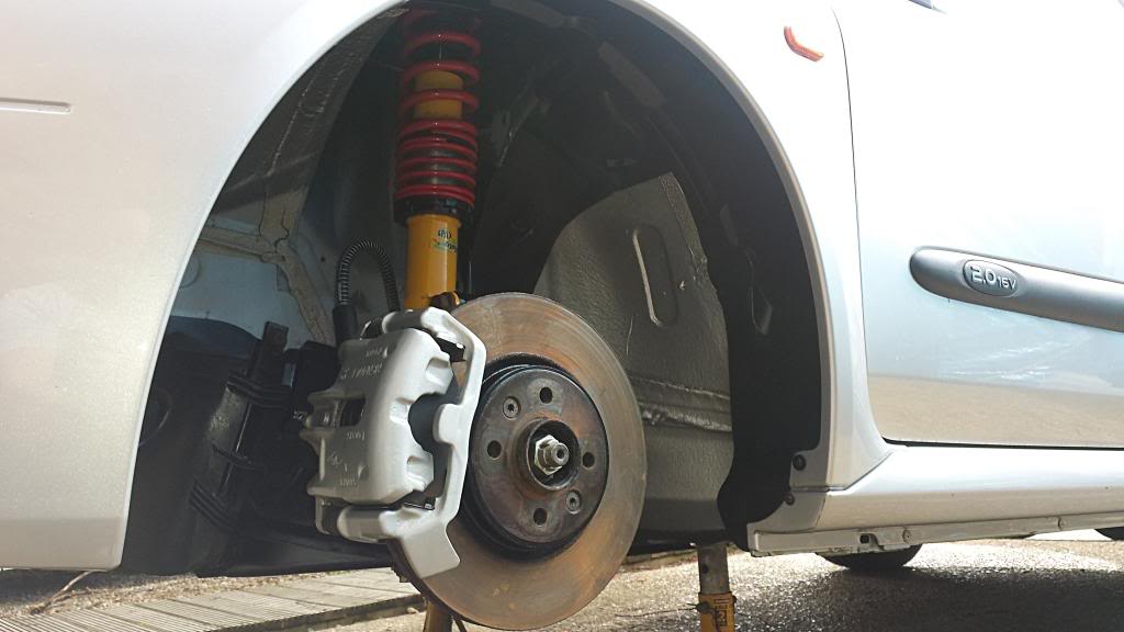

The pistons in them H&R's look rather large compared to my old Spax.
So how has the bearing come out of its holder?
Is it not the clip that holds it in?
Deffo thicker mate, i might go for the BC Racing coilovers when im ready.

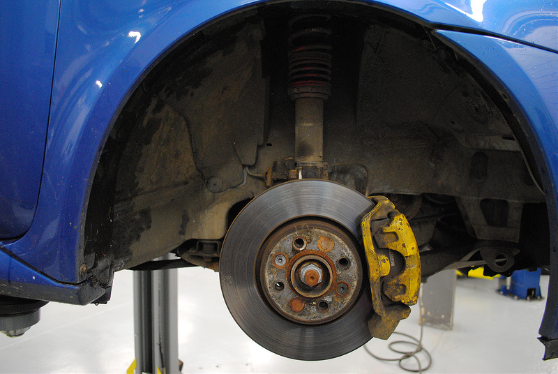

Yellow calipers look good when the paint is fresh.
yeah their held in by the circlip, if you look at the picture where the two mounts are sitting next to each other you can see the circlips and if you removed them the bearing would push out that way, part of the bearing has failed on the one in question and now moves the opposite way to what it presses out.
Yellows a bit 2003 silver for the oem win!

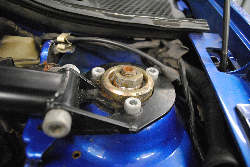

Looking on the pure-Motorsport website I think I can see what you mean by the 'plate' you mean the bit on the left hand side in the picture in this link...
http://www.pure-motorsport.co.uk/details.php?itemid=147
if that's what you talking about that bit sits on top if you don't have the brace, if you have the brace you don't use the 'plate'
Spray on Hammerite smooth, been on my car for 3 years.
Not had a problem.

Think mine used to have a brace but got sold and doesnt have the plate on. Better get mine fitted!

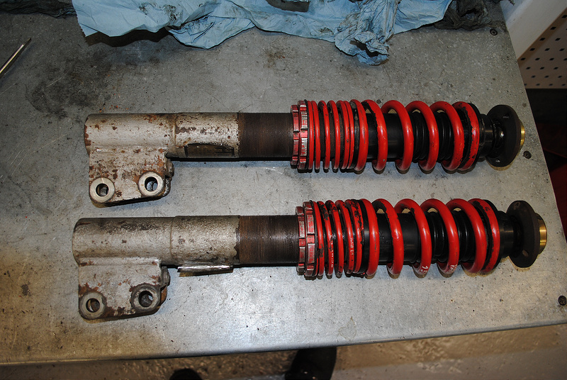

H&R's
Same as on mine. Are these dampening adjustable?
no their fixed unfortunately.
Ah that's s**t. I thought they would being so expensive!
