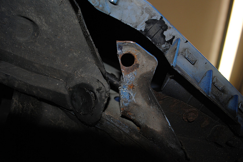

Is it an easy fix?
Well I've thought about getting it alloy welded but as it's so close to gear I don't think its worth risking it, best bet it to just source a second hand box, I'm talking to a couple people atm.
Ouch! that doesnt look good mate! hopefully you'll have it sorted soon without much expense
probably going to set me back £150 and a days work so not the end of the world, just cba to remove and refit, lol.

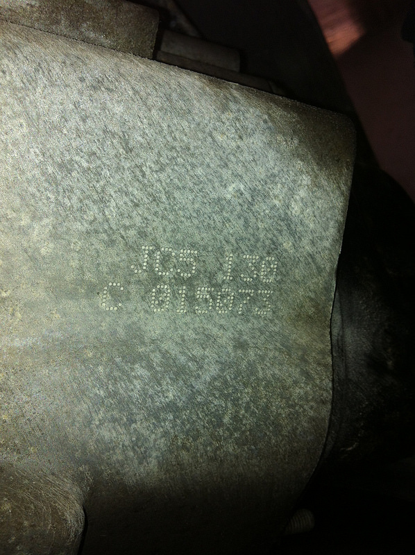

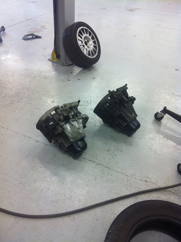

I've been having a bit of a mare with this replacement gearbox, I picked one up from a chap in London on Wednesday just gone, got it home and then decided to check the numbers to find it's the wrong one, what a tit I am for not checking it up their. turns out it was a jc5 130 and for the cup I need a jc5 129! the thing is the bloke is breaking a cup so I just thought it will be coming out of the cup. oh well, I wont make that mistake again, lol.
gearbox by bobby683, on Flickr
IMG_2067 by bobby683, on Flickr
after a few calls with the bloke, it turns out he's broke a 182 before and this box is from that and the cup box is still in the cup. he's said he'll have it removed Monday and brought down to me Tuesday/Wednesday so not too much lost.

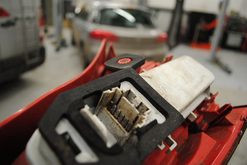

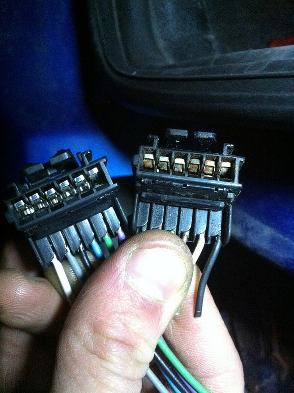

Next I noticed a couple lights flashing on the dash when braking, indicating etc, so thought bad earth somewhere, took the drivers side rear light off and found this
DSC_0159 by bobby683, on Flickr

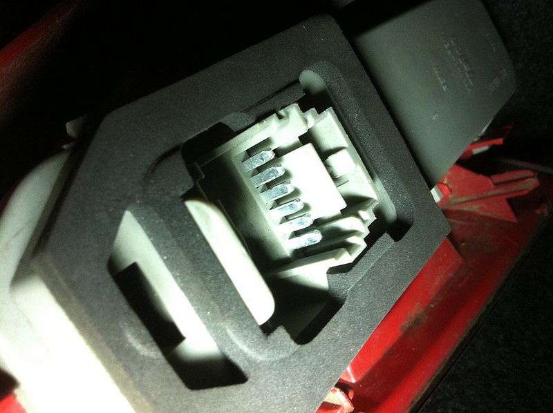

the connector was corroded aswell
old and new
IMG_2070 by bobby683, on Flickr

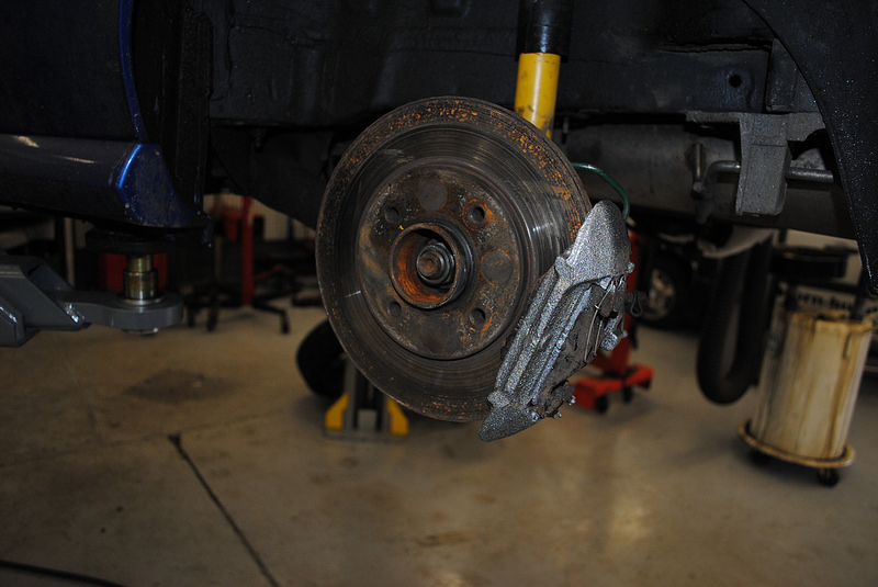

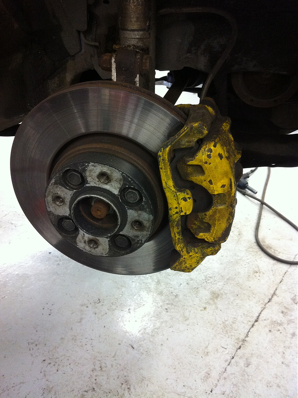

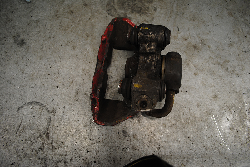

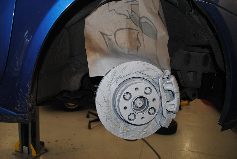

The calliper's, disc's and spacers were looking a bit worse for wear so gave them a quick spruce up
didn't do the rears because one of the callipers needs replacing, so i'll wait till the replacement turns up.
IMG_2076 by bobby683, on Flickr
DSC0145 by bobby683, on Flickr

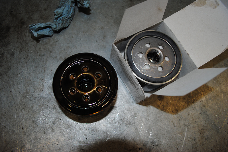

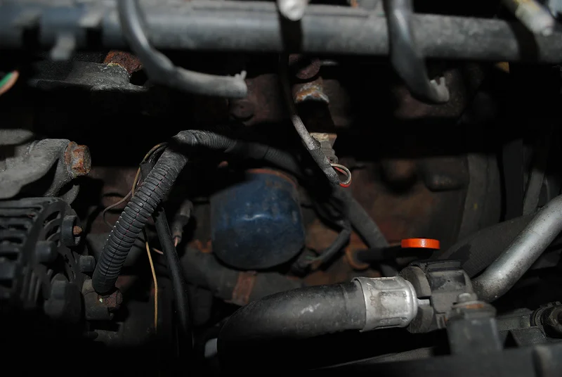

the oil filter was looking a bit rusty so thought I best do an oil an filter change.
DSC0142 by bobby683, on Flickr
DSC0143 by bobby683, on Flickr

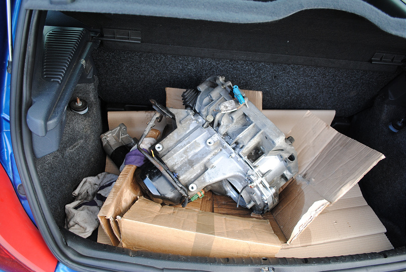

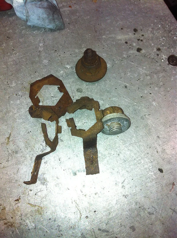

got the new gearbox in now, all went ok but 3 out of the 4 subframe captive nuts were seized in so they were a pain, don't you just love these things lol.
IMG_2136 by bobby683, on Flickr
IMG_2126 by bobby683, on Flickr

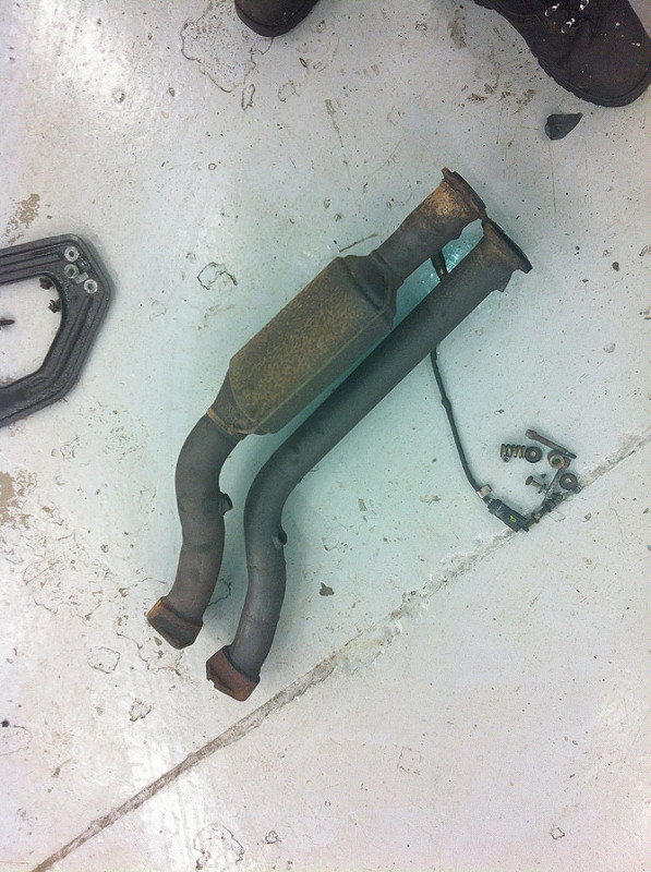

decided to put the cat back on when stripping it all down.
IMG_2134 by bobby683, on Flickr

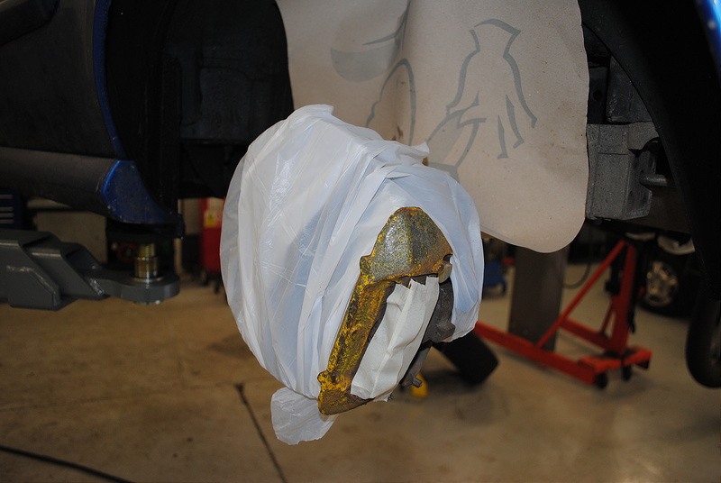

replacement calliper turned up for the o/s/r so got that on
39 by bobby683, on Flickr
and then gave the rear's a quick spray
47 by bobby683, on Flickr

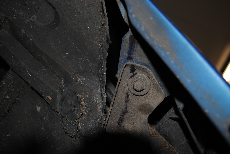

Next i cut the away some of the metal bracket near the wheel arch linner as this is where you get rubbing on track.
Before
After
46 by bobby683, on Flickr

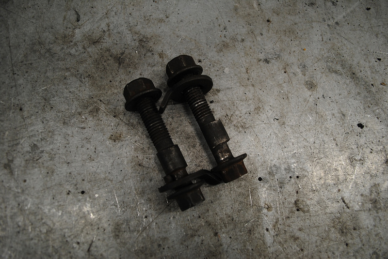

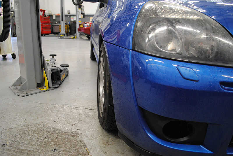

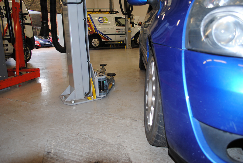

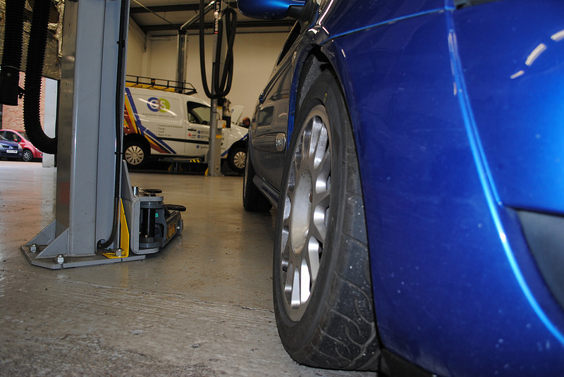

The H&R coilvers were giving about -2 degrees with standard bolts and with the Bedford track day coming up i wanted a bit more camber so put these on and set to maximum, i now have about -3 degree's camber.
Before
28 by bobby683, on Flickr
After
29 by bobby683, on Flickr

Those captive subframe nuts are a stupid idea. Luckily its not too hard to overcome with the right lengh socket for the fronts and a spanner for the rears.

Yeah they were a bit of a prick but got their in the end. I've put some new nuts and bolts on the front so if they ever have to come off again they should just come straight off.

Looked spot on when I saw it yesterday dude :) love that camber on the front. Are those camber bolts hard to set up?

yeah fairly easy to set up, I can do them for if needed. I definitely think your need spacers first though.
