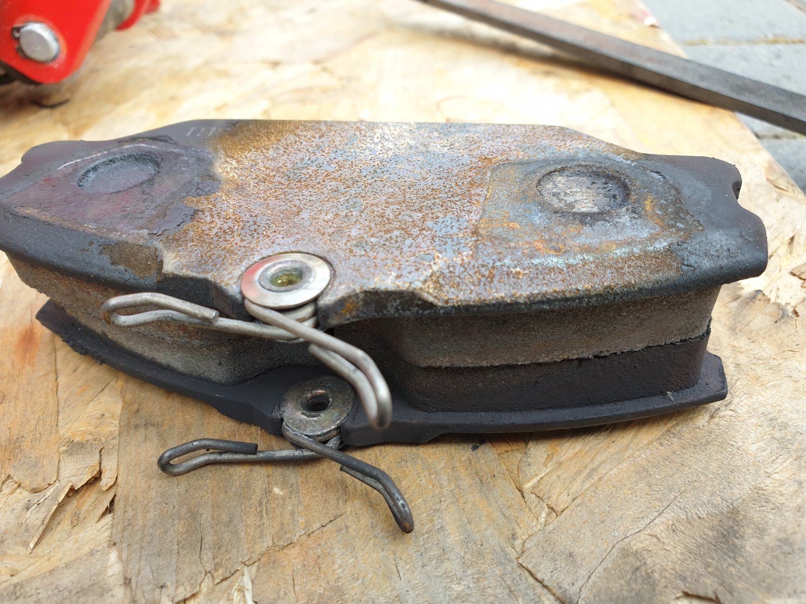

Definitely, cant wait to see what they are like. The pbs pads look quite glazed when removed after quite a bit of road driving, but can prob revive them with some 80grit. Im not expecting these m1177s to be great from cold, it will be a case of boshing stock pads or the pbs back in after Croft, then bosh the m1177s back in at Blyton.

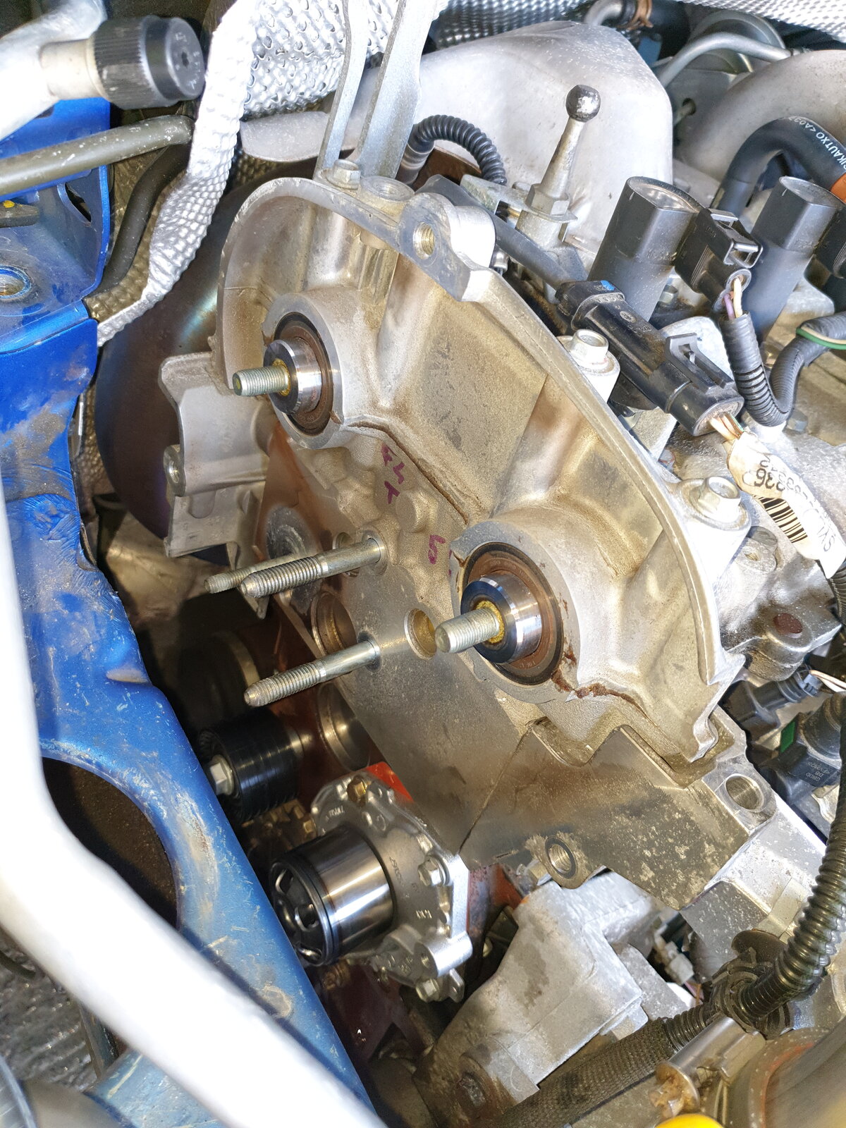

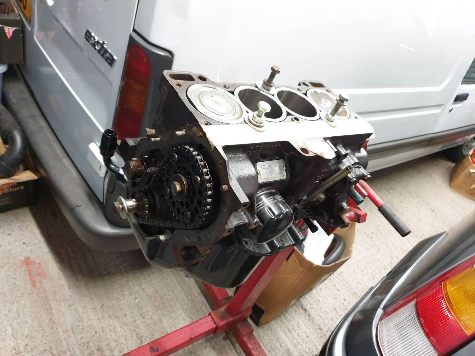

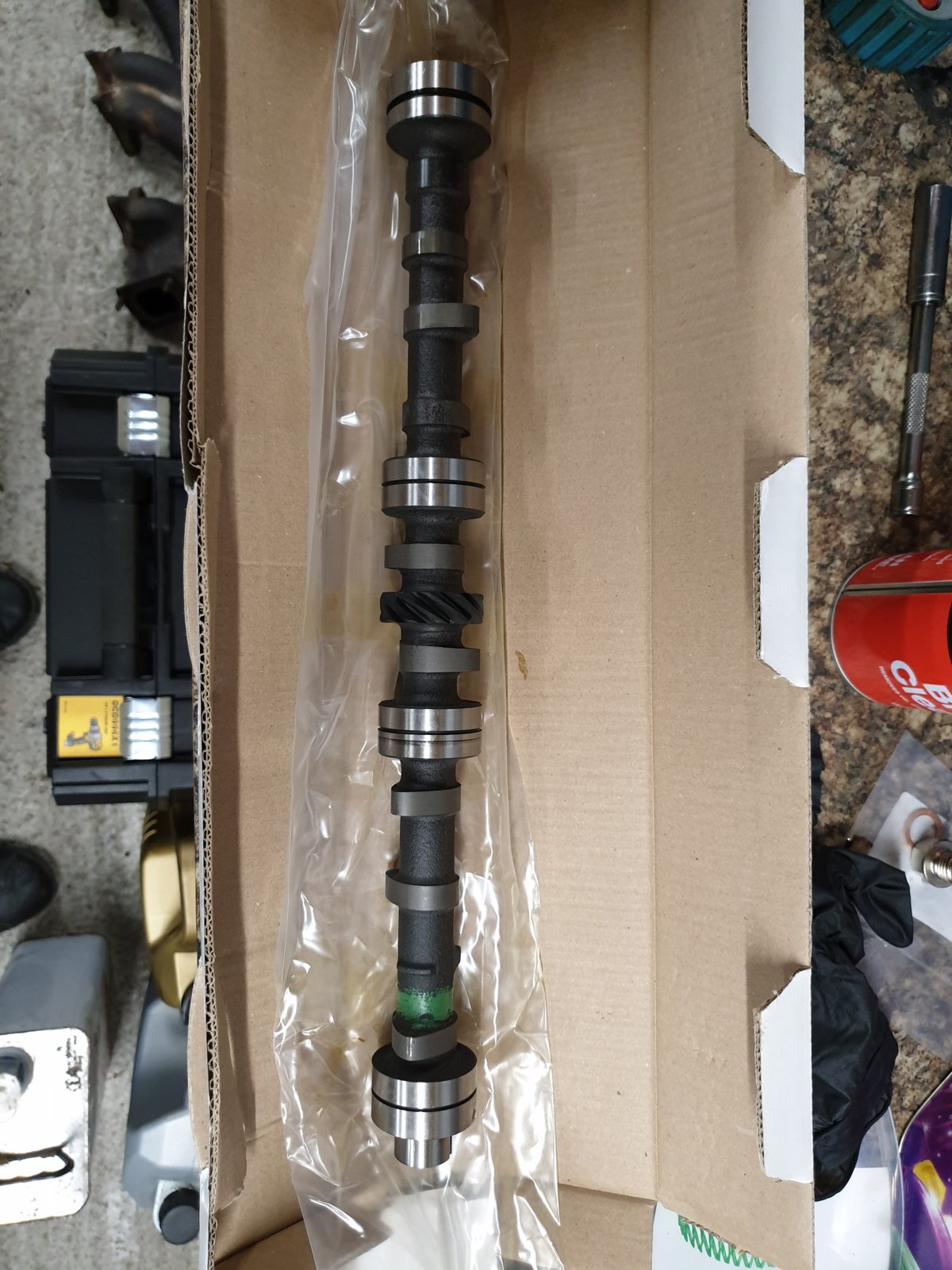

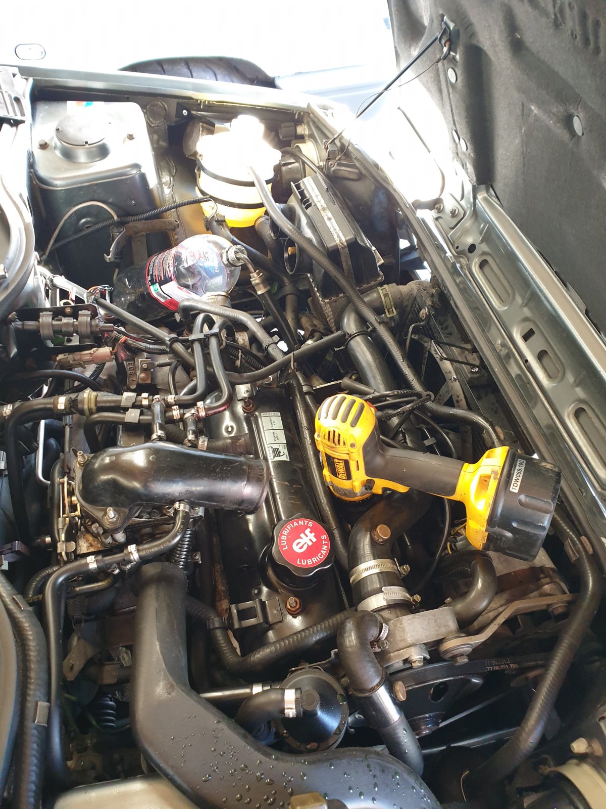

Mega busy day today so brief update. Started early, fitted bilet cam and vernier pulley/timing chain to Extra van engine
Next job was to change turbo on my gtt as leaking oil, absolute ballache as all oem brackets still fitted. Got new turbo on and tried to prime oil system and the fecking oil light would not go out after tons of cranking and oil feed was dry, so had to get the drill out, take dizzy out and manually prime the pump with my special tool. Ill repeat Ballache !!

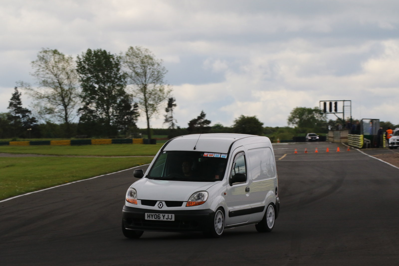

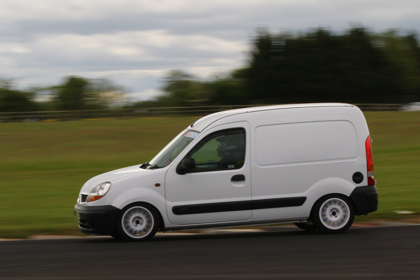

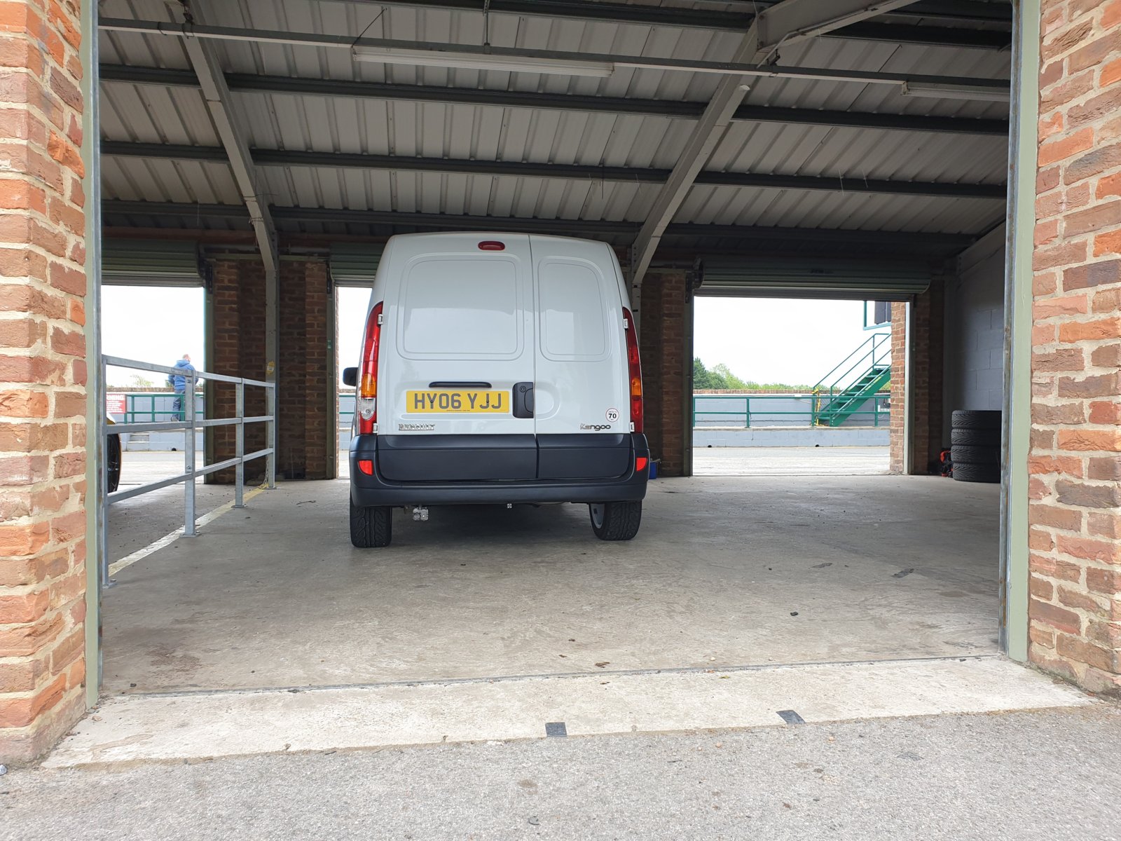

Mega day at Croft on Monday in the Kangoo. In and out all day no issues, driving was a bit rusty in the morning as 8 month since last trackday but got the pedal down in the afternoon.
The Mintex M1177 pads were awesome, no fade and f**k loads of power, locked it up a couple of times late braking towards Clervaux and a bit of poo came out as thought i was going into the gravel. Pad backing has gone white from the heat ?

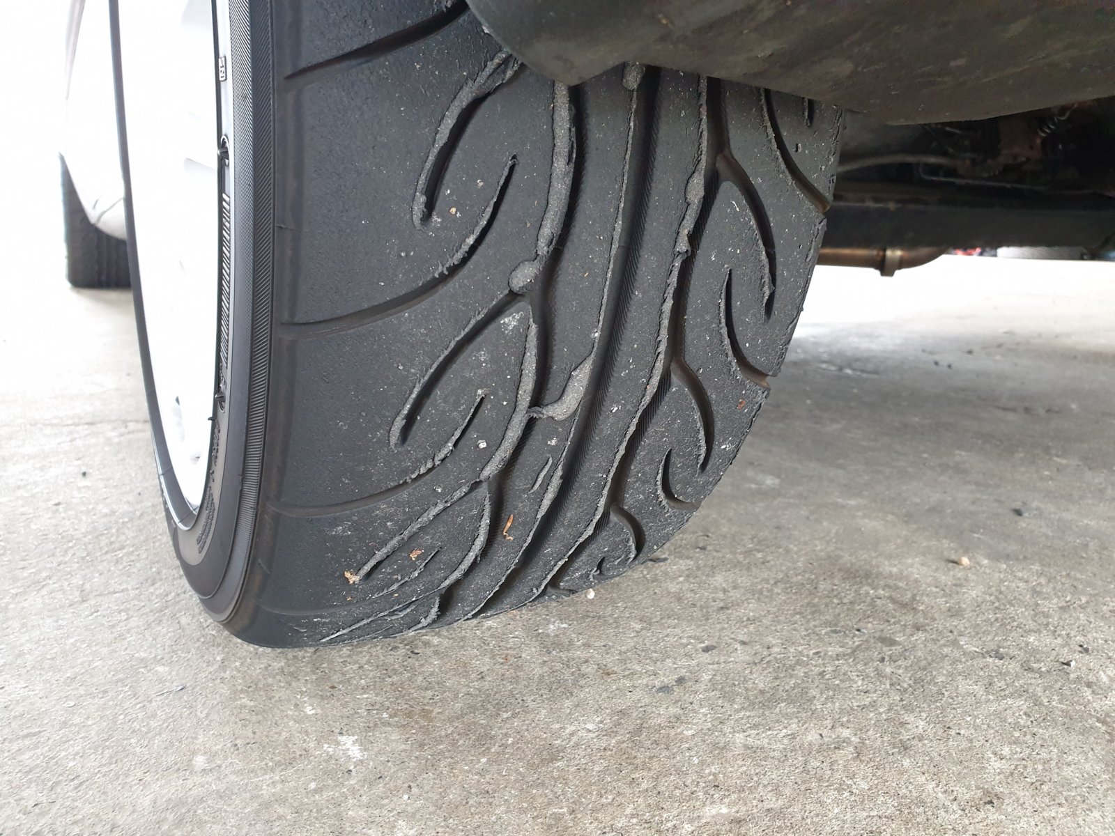

The new tarmac at Croft is great too, it used to be a tyre killer for n/s front, but now not bad at all. Was shocked to come back with legal tyres !

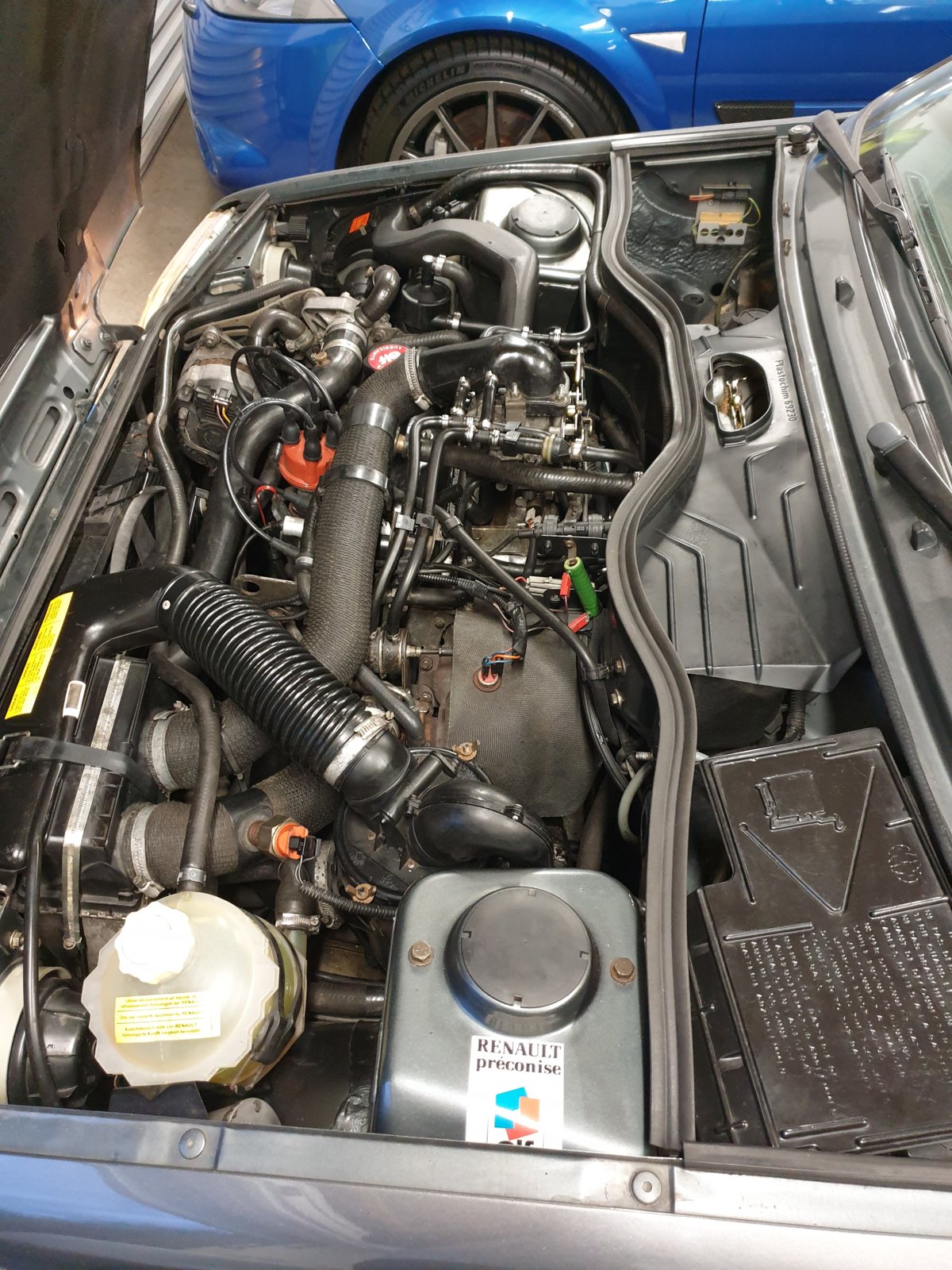

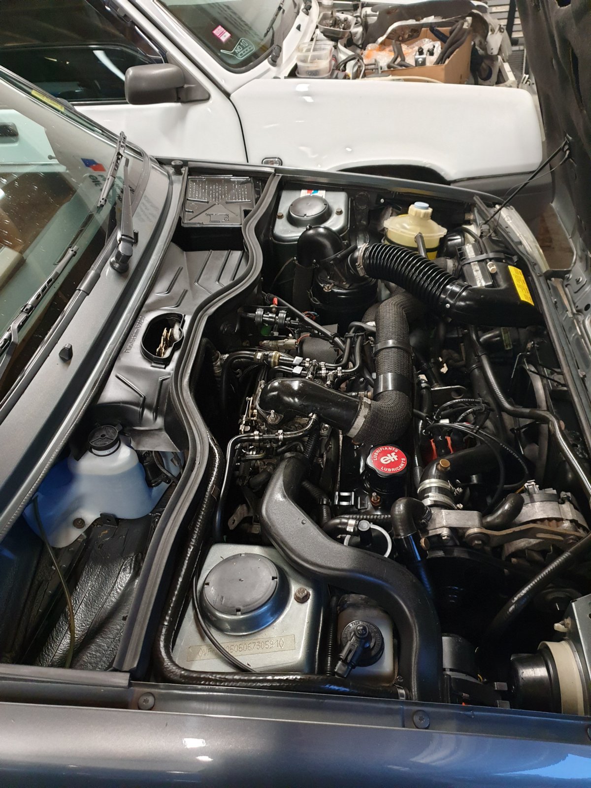

Got up early today and started work on the gtt.

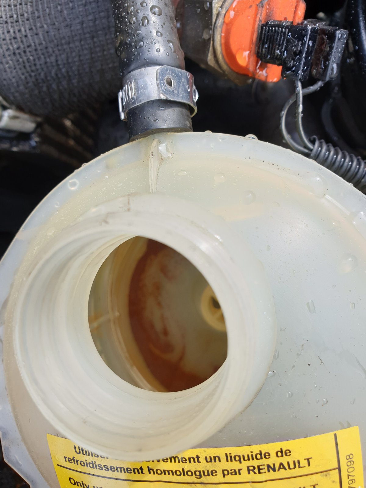

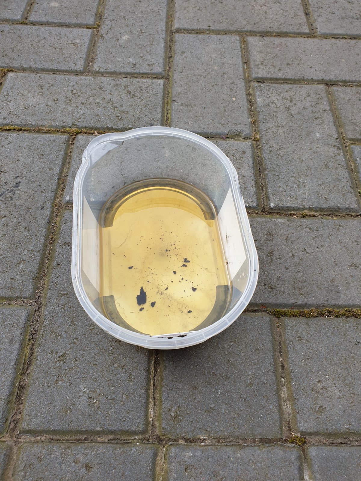

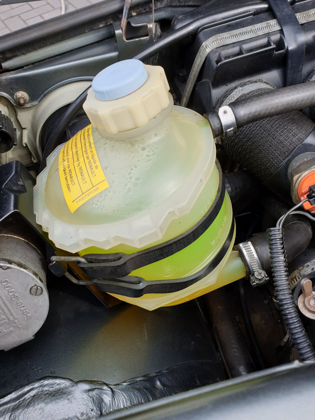

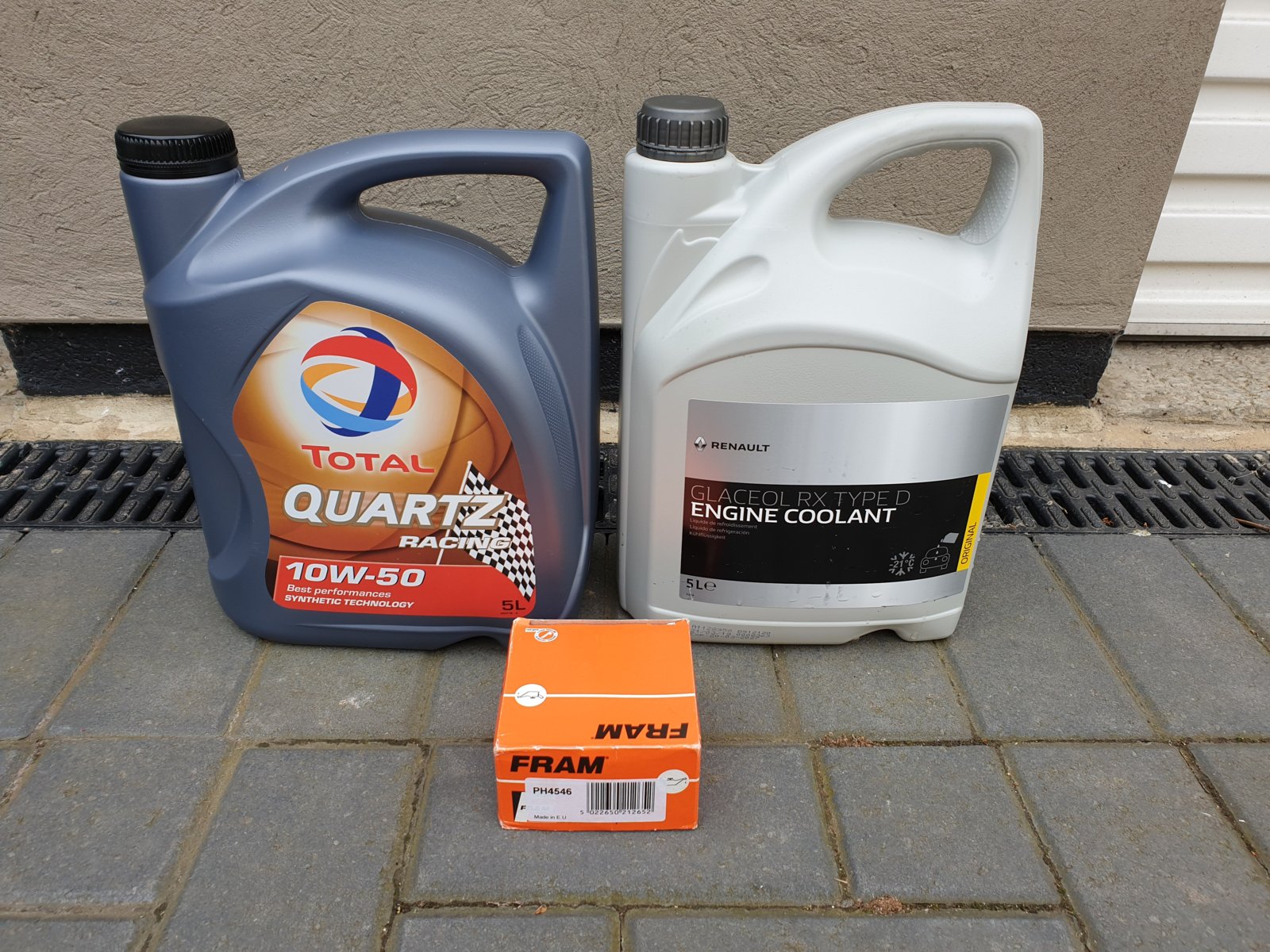

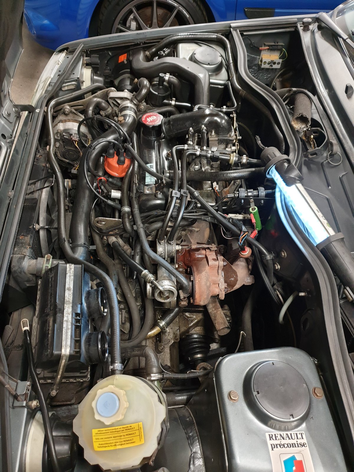

First job was to flush the coolant. It still looked nice and green but noticed a bit of sedament in header tank, flushed full system with hosepipe, rad and heater matrix thoroughly.
s**t that came out when back flushing !
Refilled with fresh type d

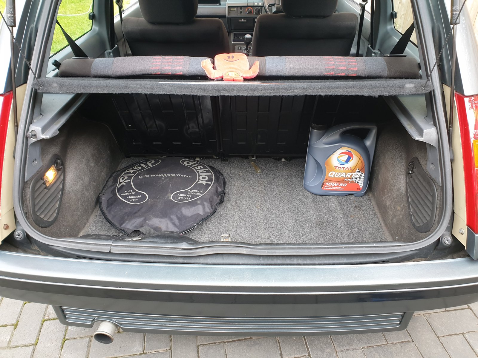

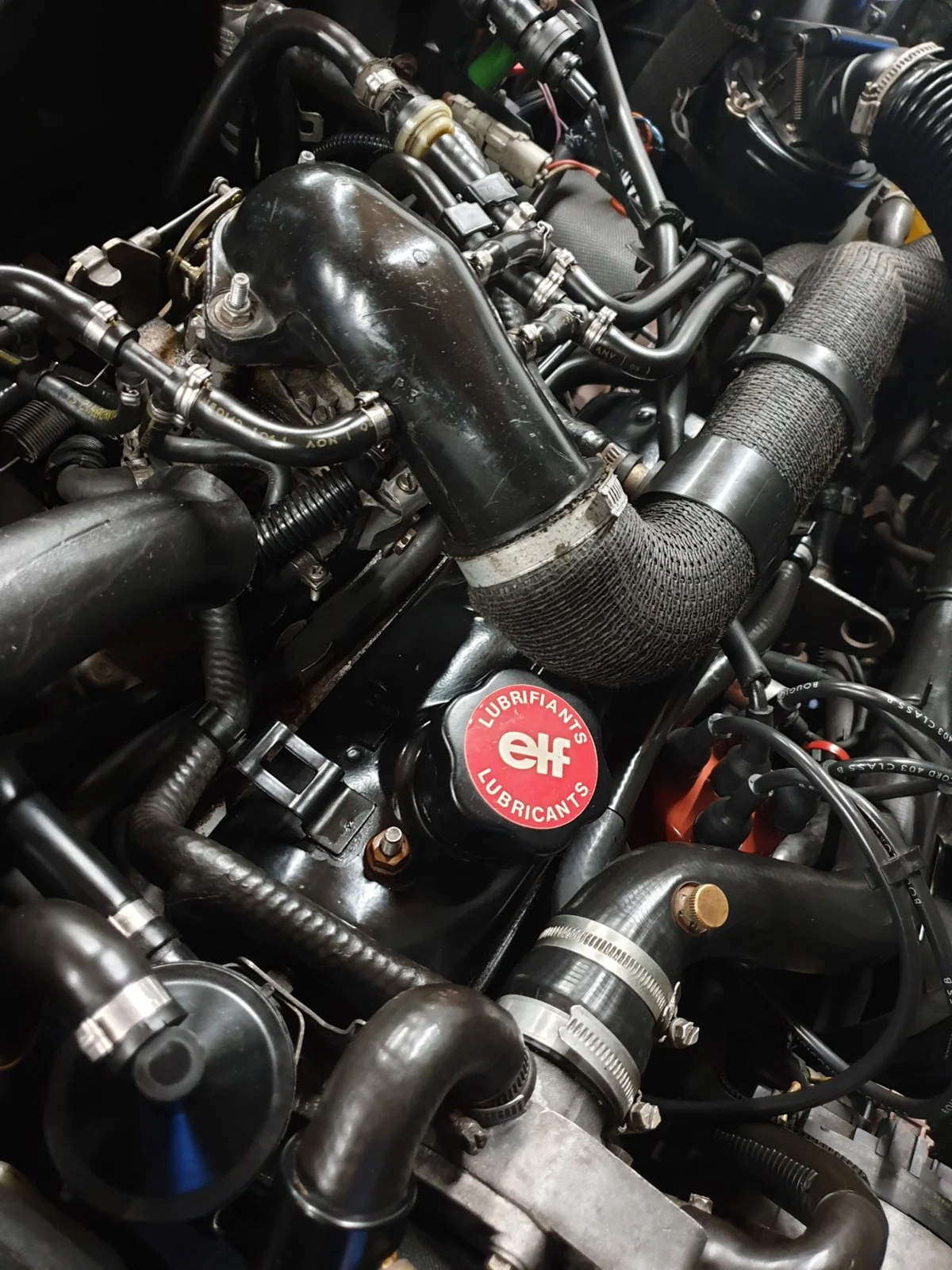

Next step was to change oil, Total quartz racing 10/50 synthetic and new old stock Fram ph4546 oil filter out of my stash. These go for £25-30 a filter now as made of unobtanium, its madness

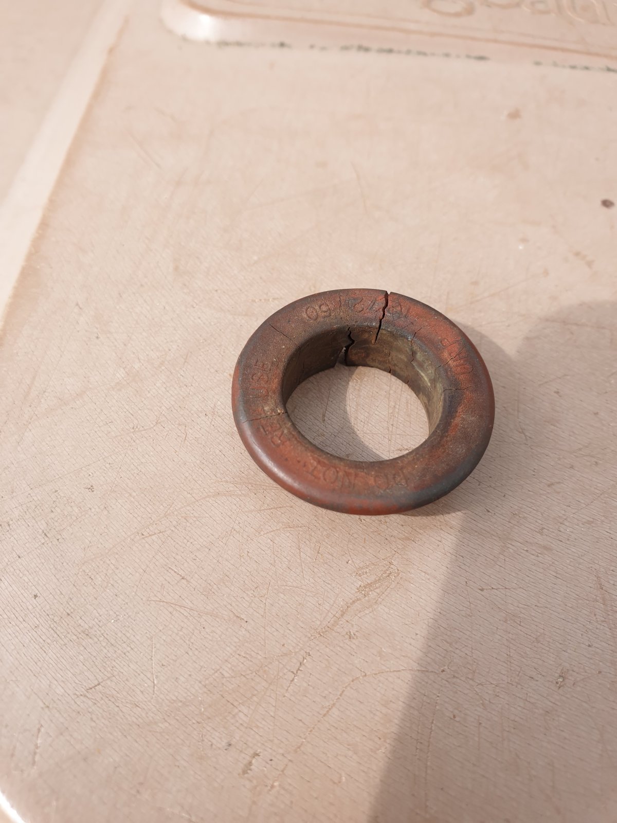

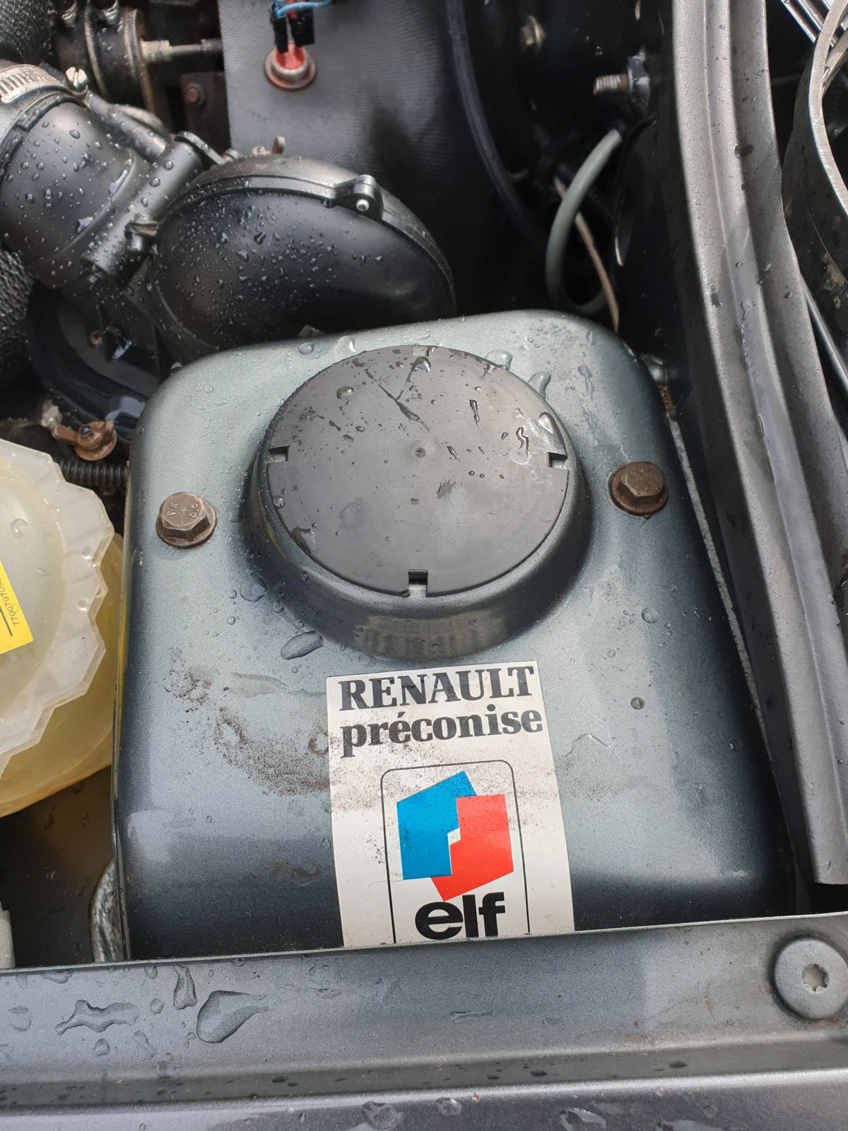

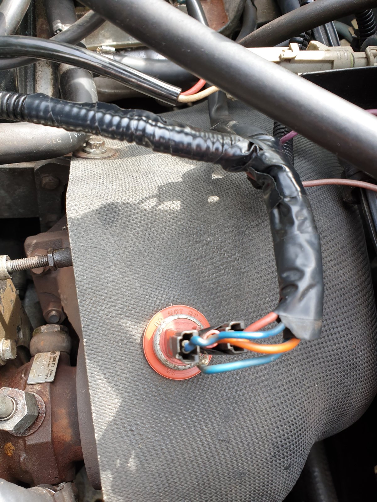

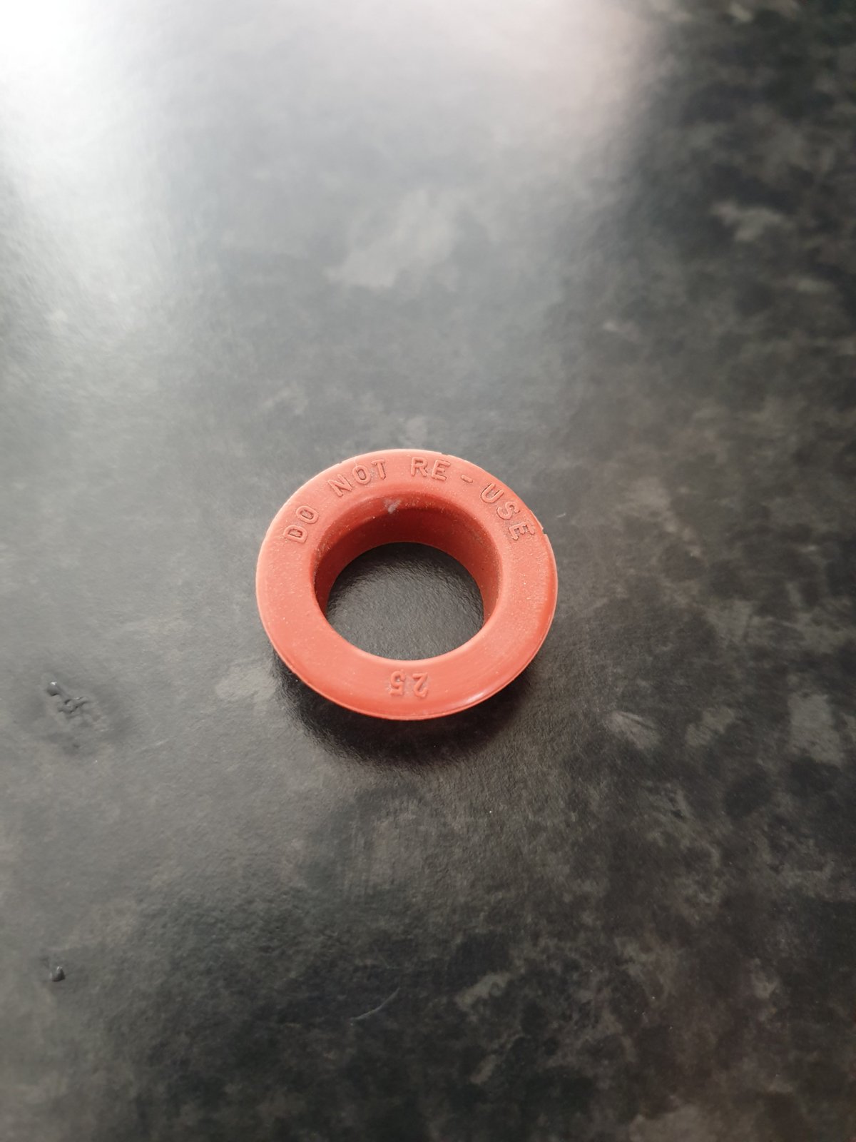

Also changed the bung that holds the anti pwrc sensor into the turbo heatshield. Mine was not pretty
New one, note do not reuse on it, my old one was best part of 30 years old lol
Fitted into Kevlar Bb performance heatshield, fitted this to replace the w**k oem one that smoulders after a top speed run.

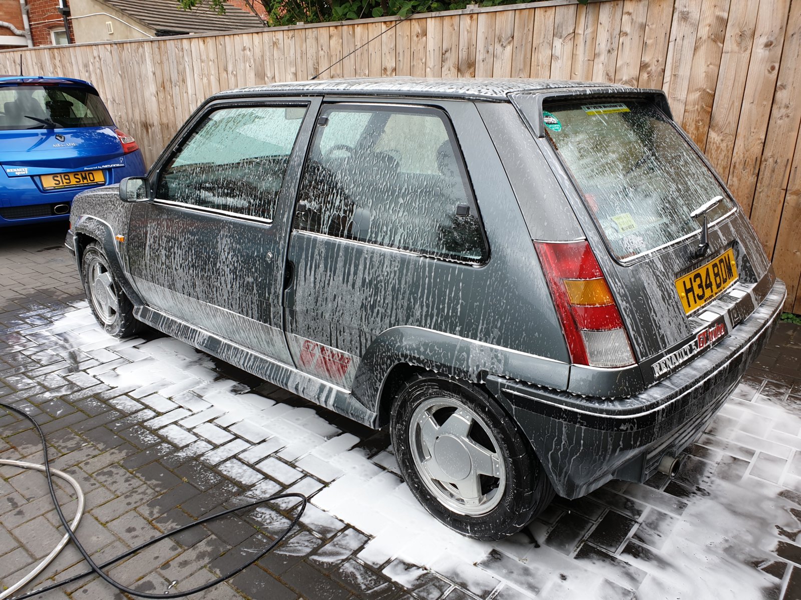

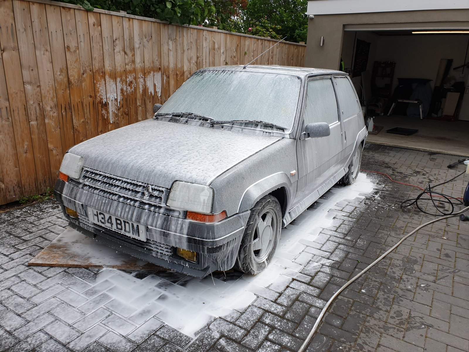

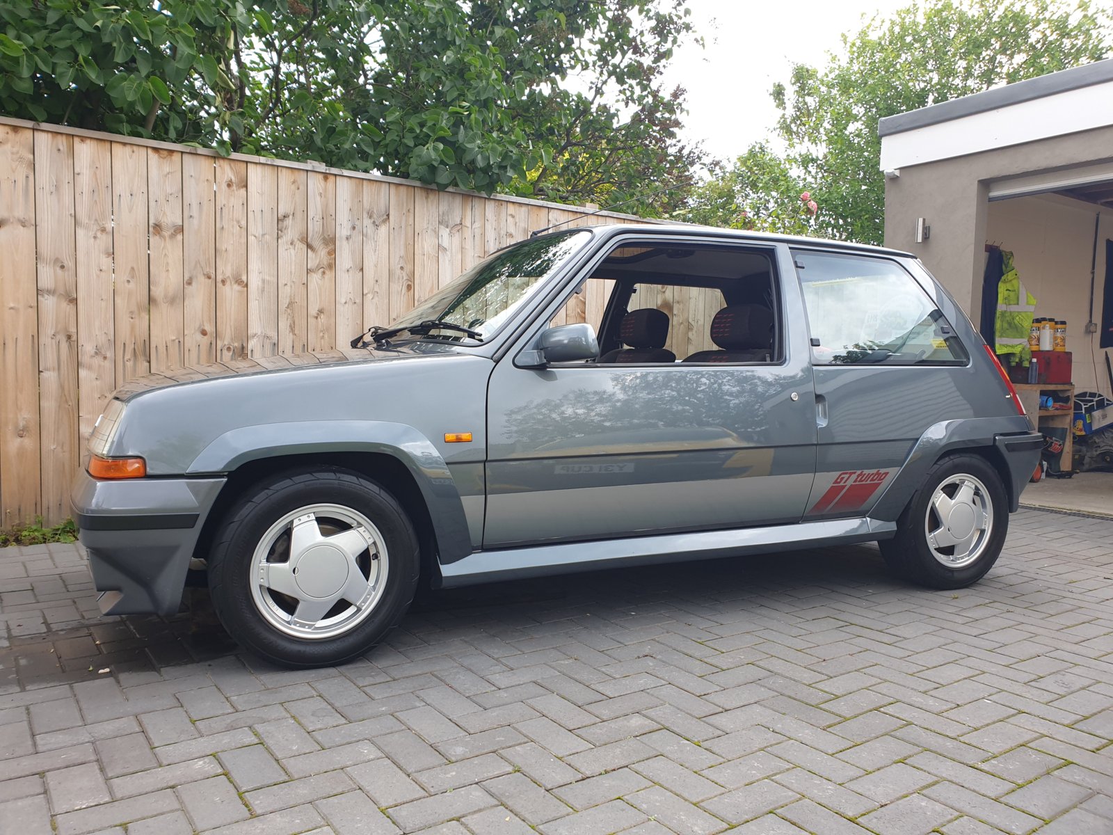

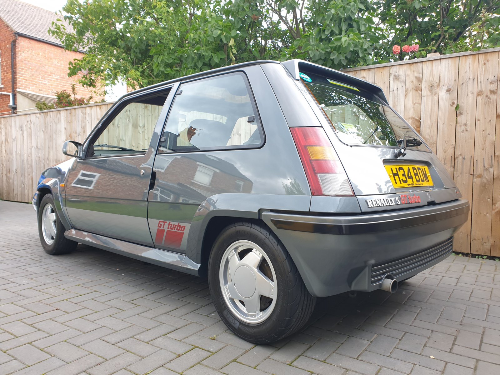

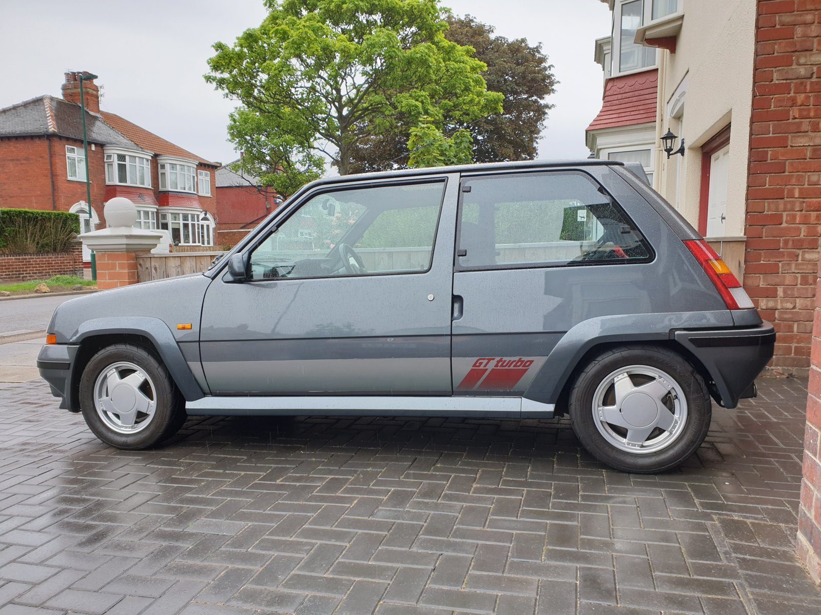

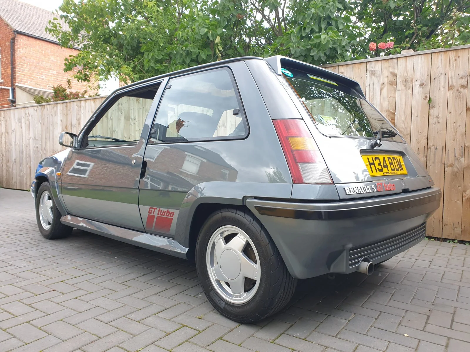

Washed the dust off before mot, BH auto foam, followed by 2 bucket wash, and dried.
Gtt looks so small compared to the rest of the cars !
Typically 5 mins after drying it pissed down, just before i was about to set off. Good beadage though. First time its been out in the rain in years.

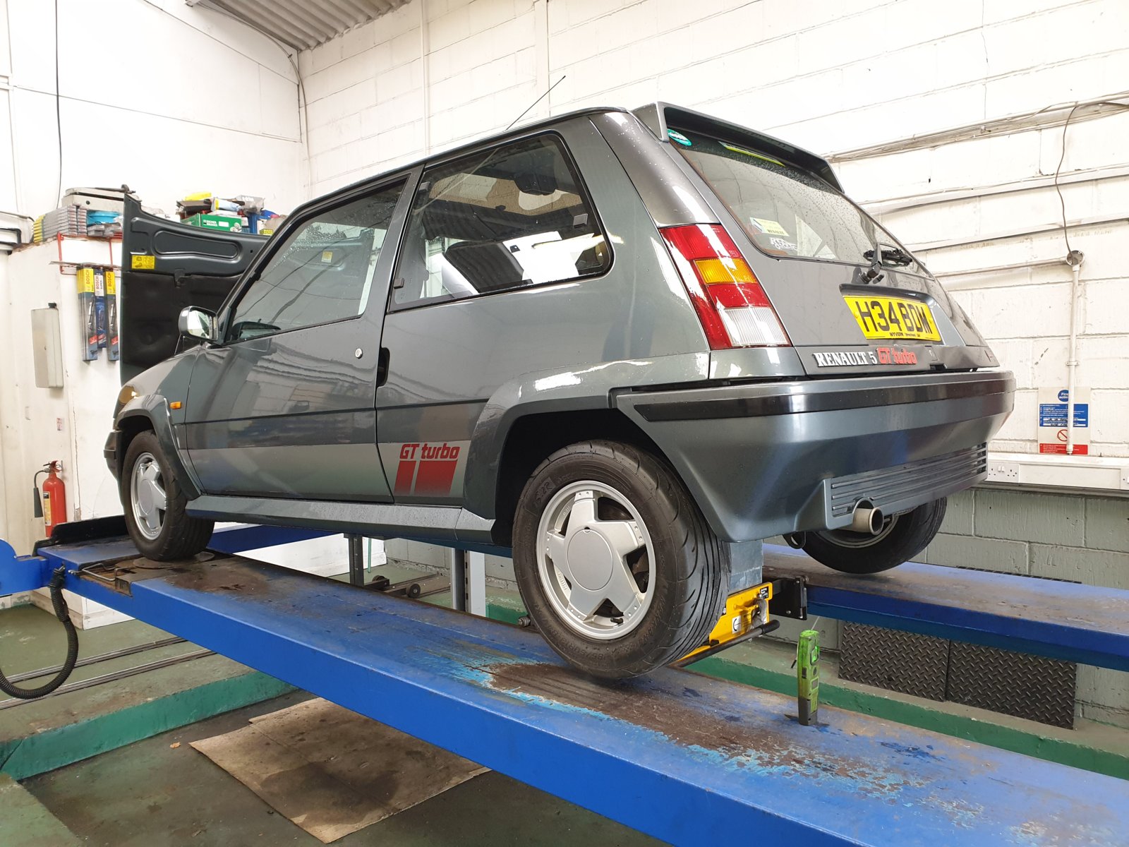

Next stop mot station

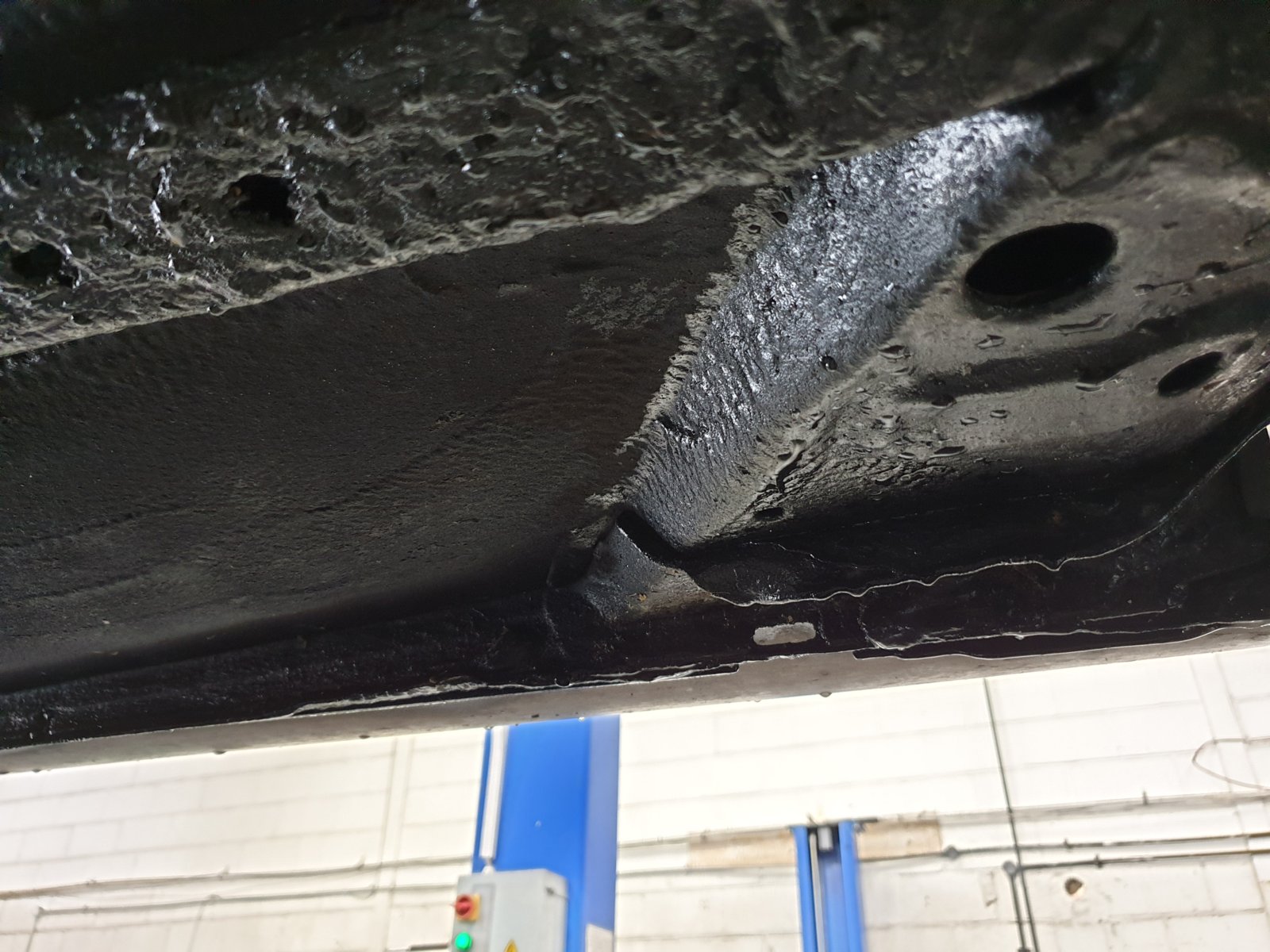

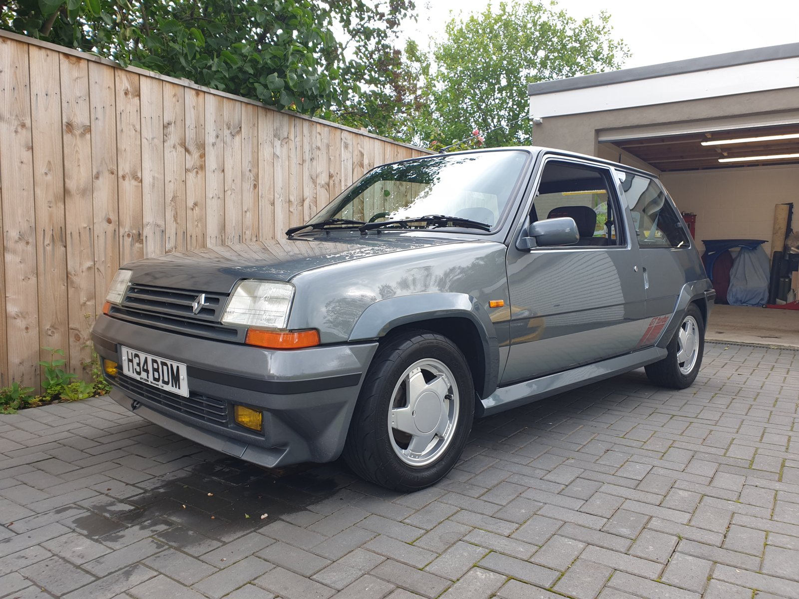

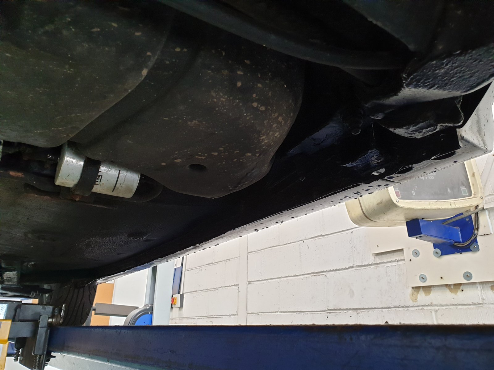

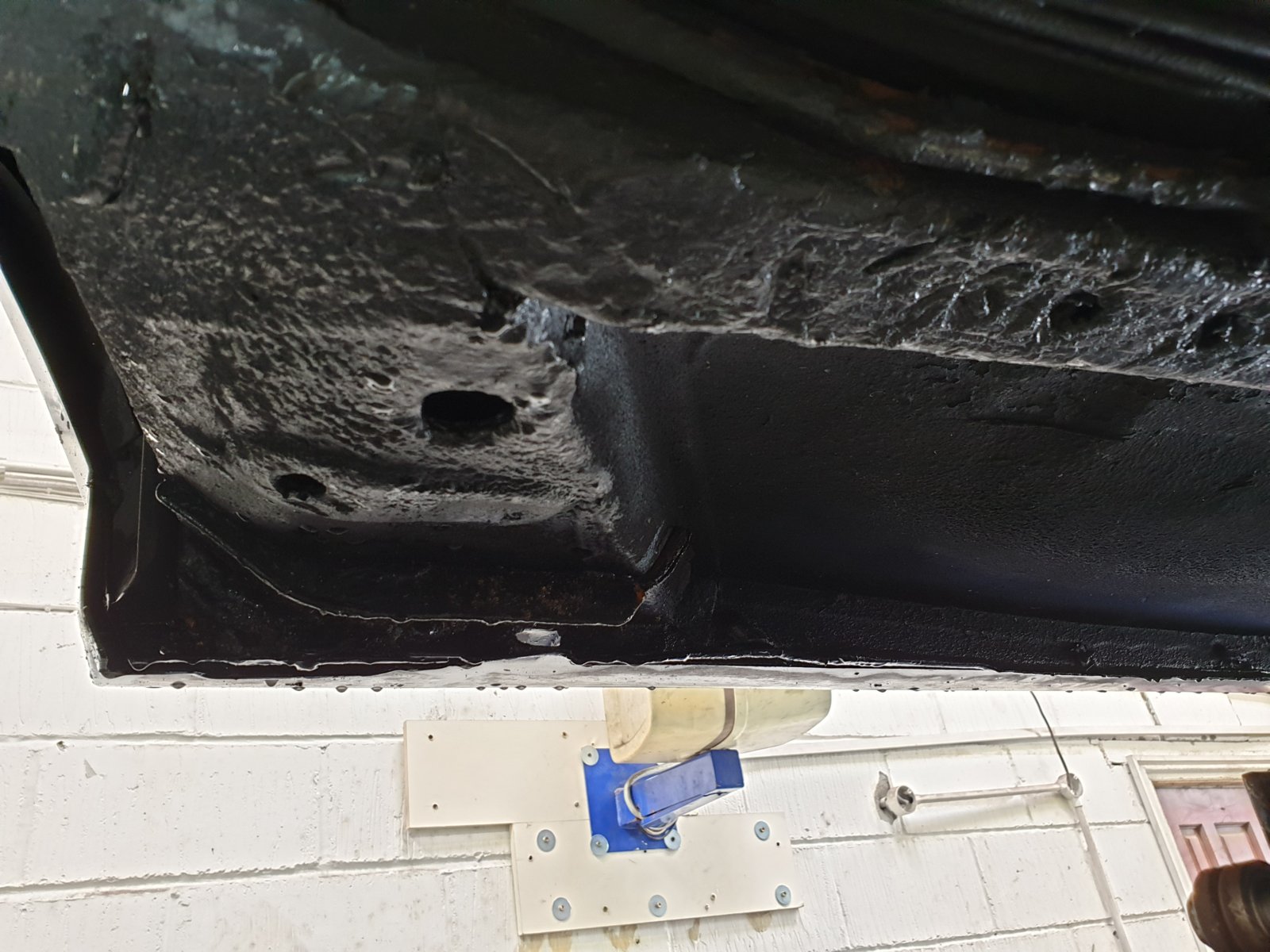

Still looks clean underneath for a 28year old car, need to give the powdercoated bits a wipe down but apart from that no work required
Passed no issues at all, 25 miles since its last mot September 2017 !

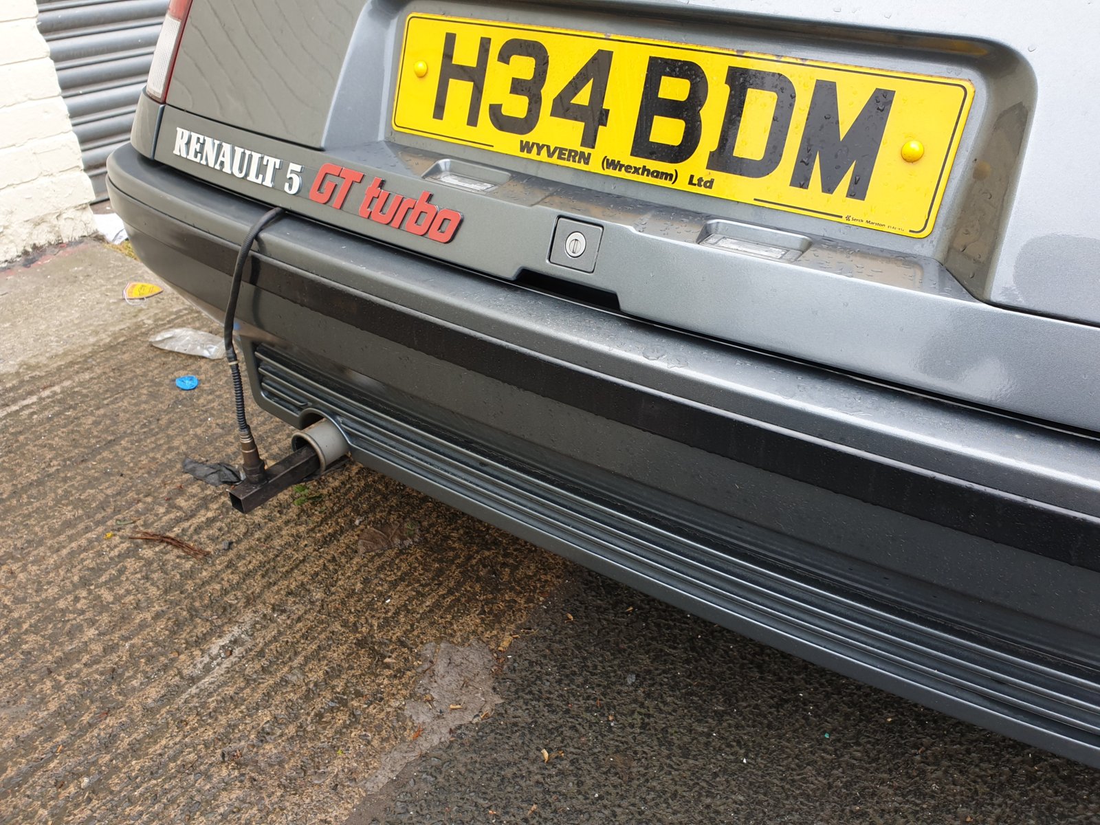

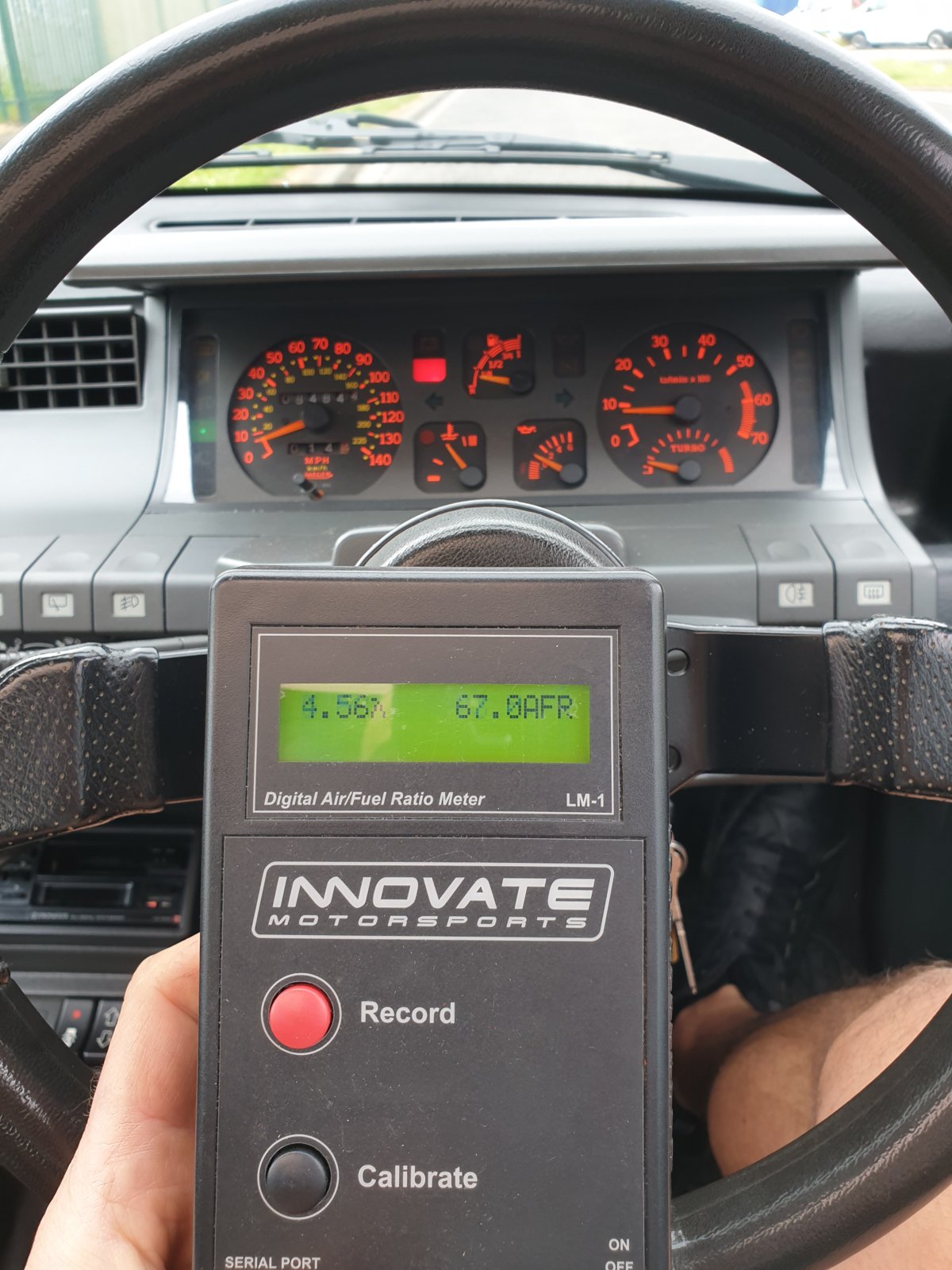

Taxed straight after mot, weather had dried up too. Needed to give the Afr's a check after fitting new turbo, so dug out my old Innovate Lm1 and sniffer clamp, still a superb bit of kit had it over 10 years. Still running great, 11.9 on boost/wot nice and safe.

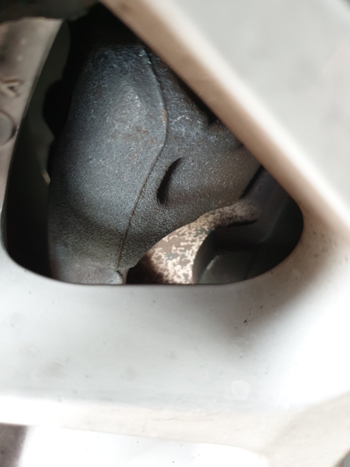

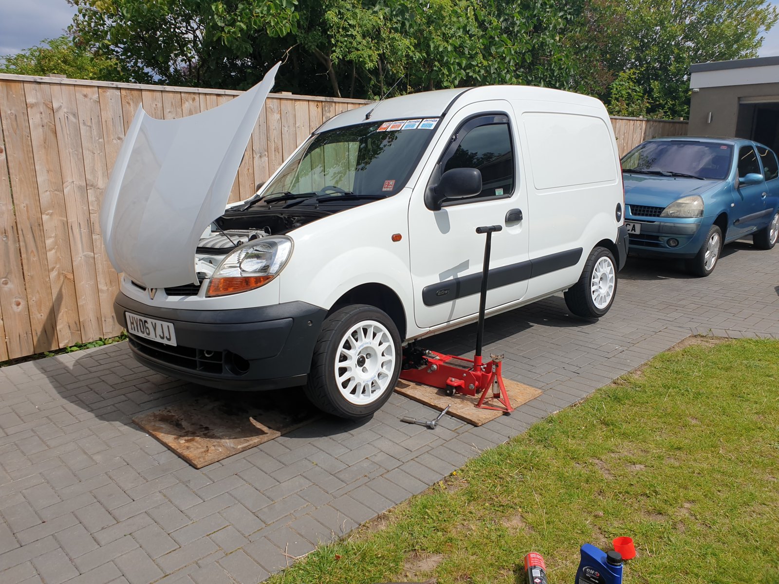

Washed Kangoo after Croft to get the shite off, jacked up and give it a once over, no issues to report. Changed brake pads over to ds2500 for road use, as the mintex are terrible from cold so not suited to road use. Feel like blocks of wood lol.
Mintex m1177 look like they have been mega hot, paint has burnt off !

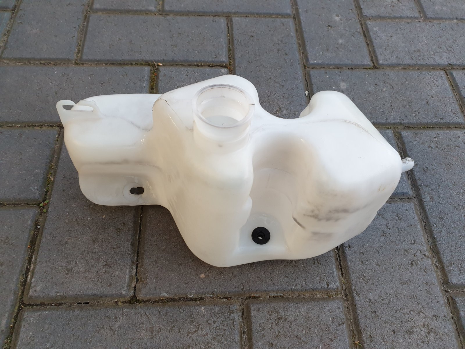

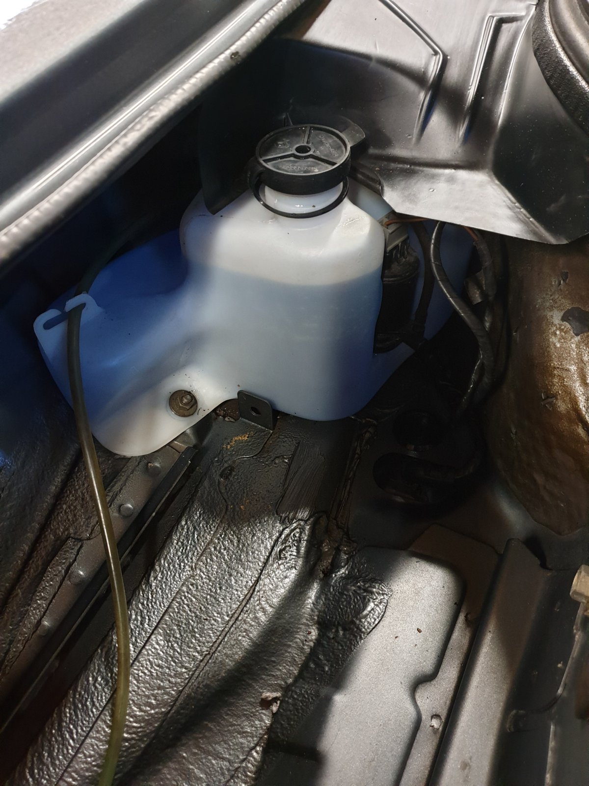

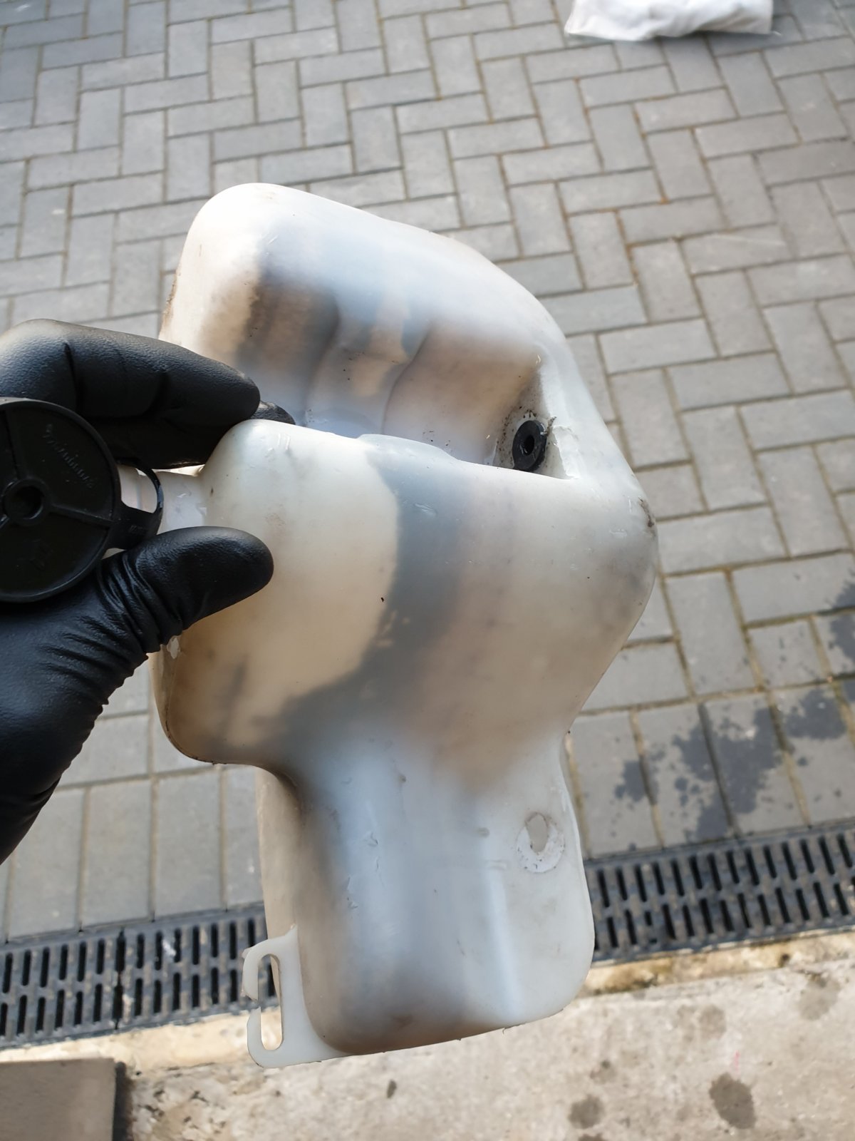

Also give the washer bottle a clean up on the gtt lastnight, i have been meaning to do this for ten years. Checked level yesterday, and ran finger in and realised it was full of scum. Whipped it off and flushed it out, 1/4 filled with Apc and a handful of rice and shook it for about 20 mins, came up great. Also give the engine bay a wipe down, pipes everywhere on oem setup!!

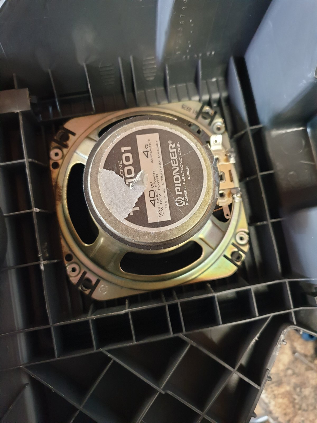

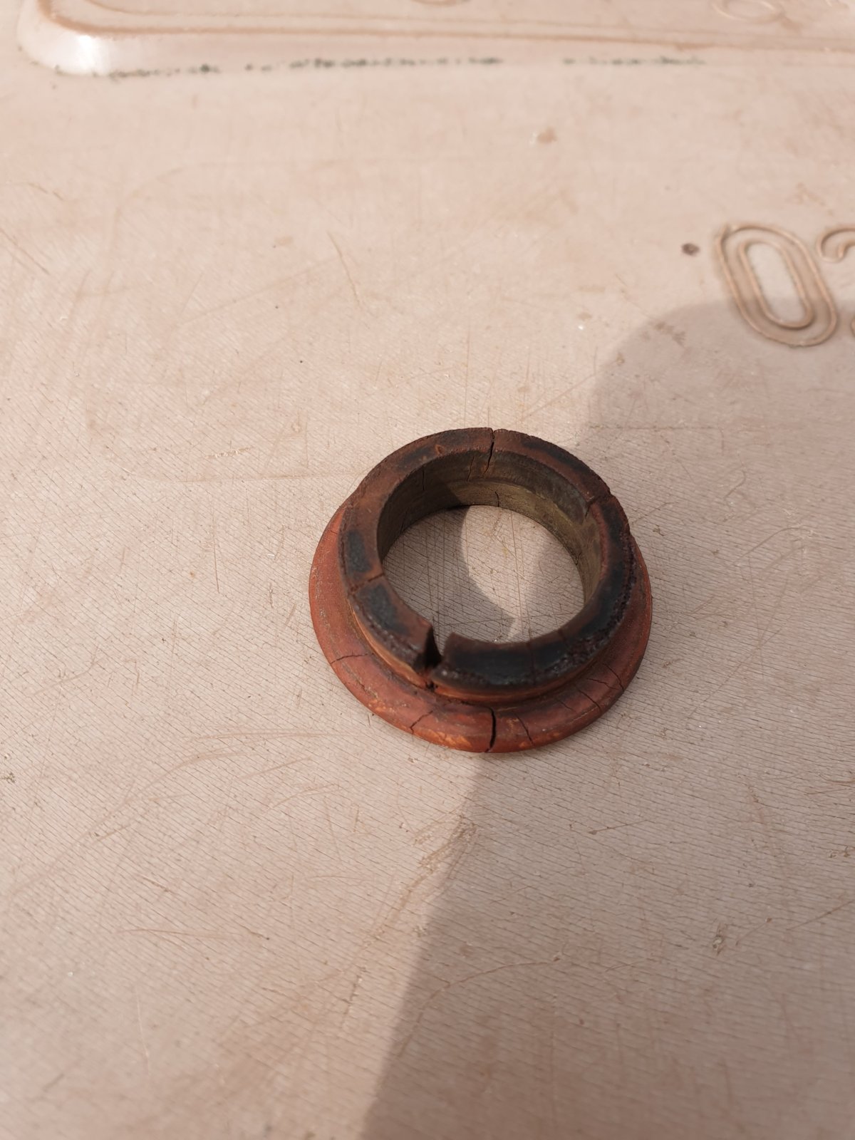

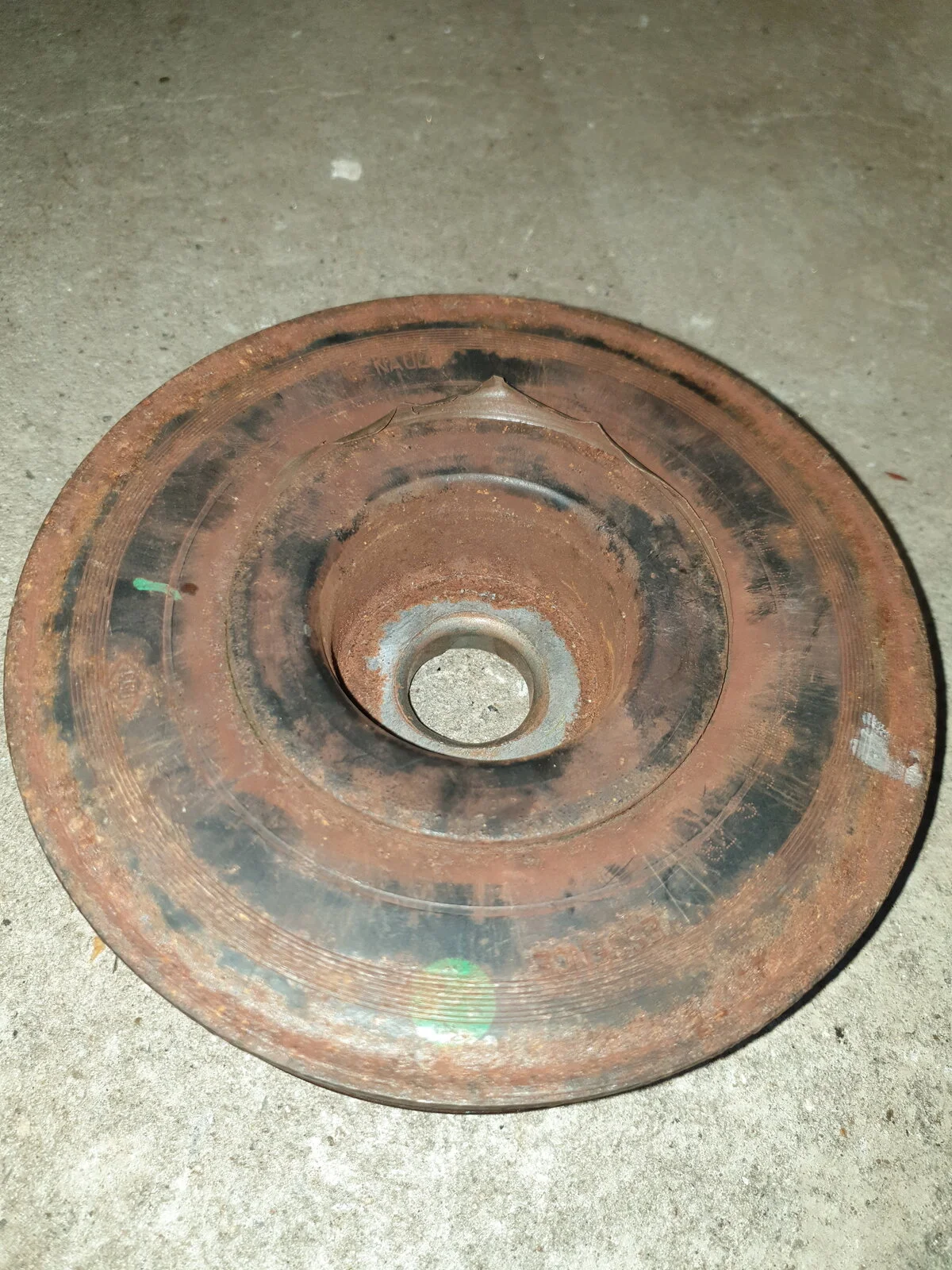

Done a couple of jobs i have been putting off for years too, for no reason apart from being lazy. O.e rear speakers were totally past their best, so stuck in some pioneer replacements that i bought at least 5 years ago ! Ten min job that i never got round to.
O.e cone split

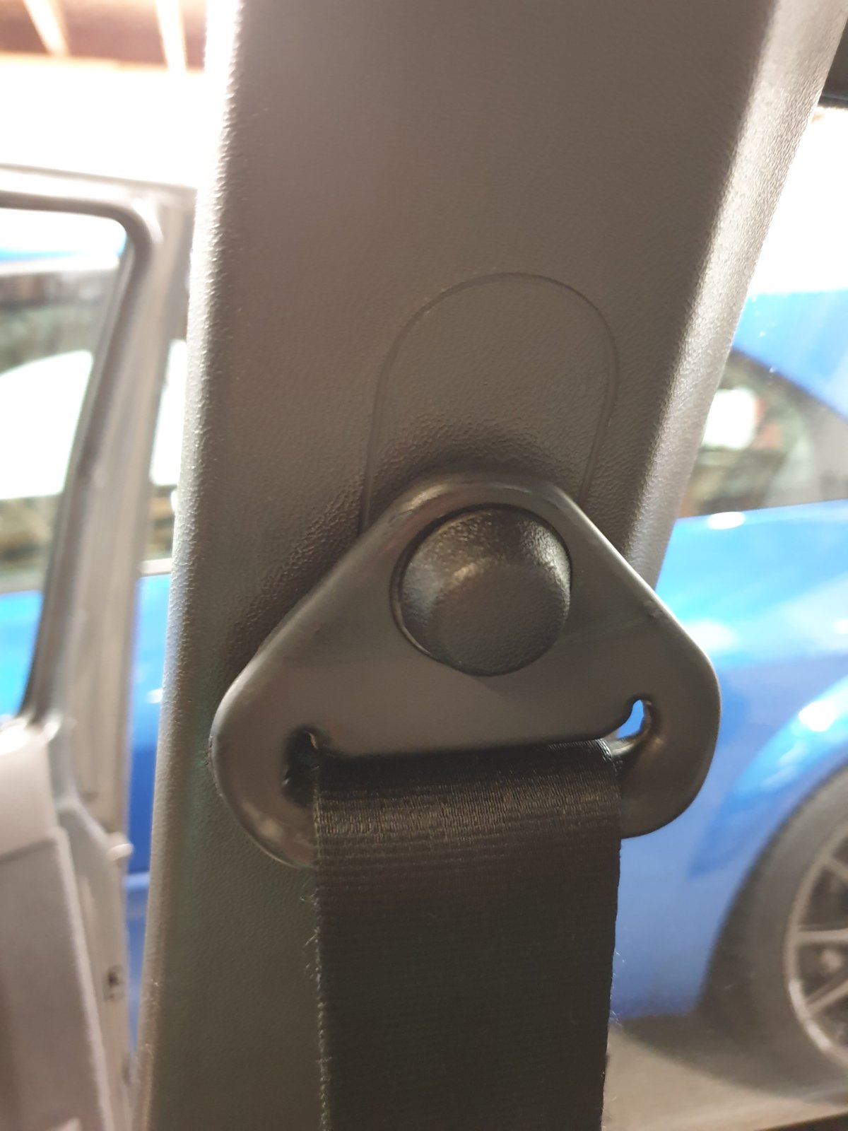

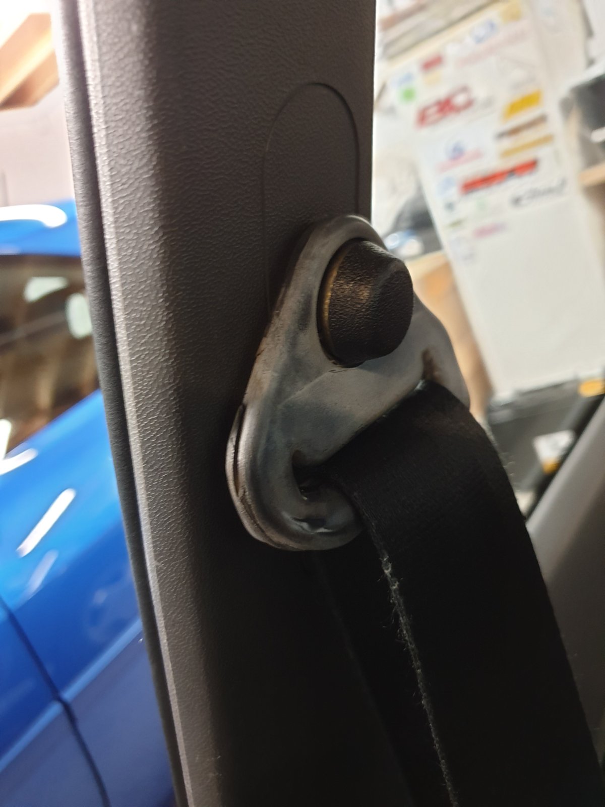

Also the seatbelt buckles were mega faded, which looked awful. Coated in left over Gyeon q2 trim
Before
After

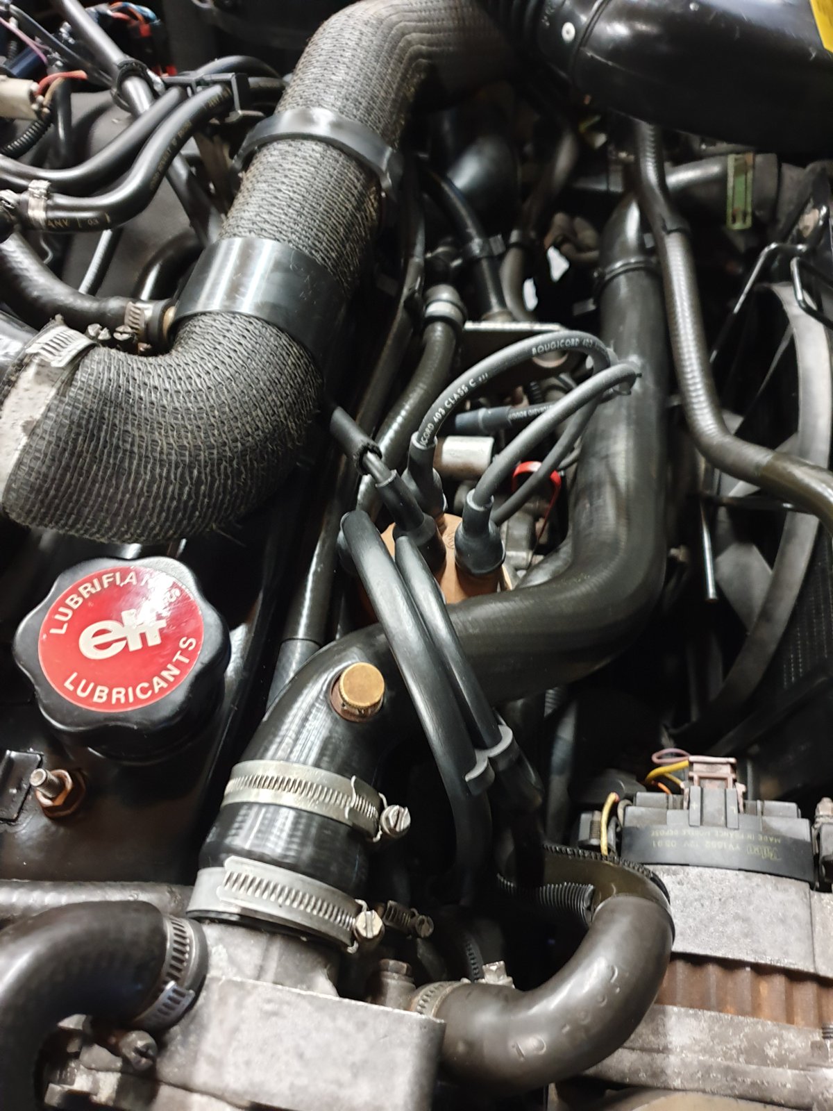

Fitted new o.e Bougicord ht leads and Ducellior distributor cap.

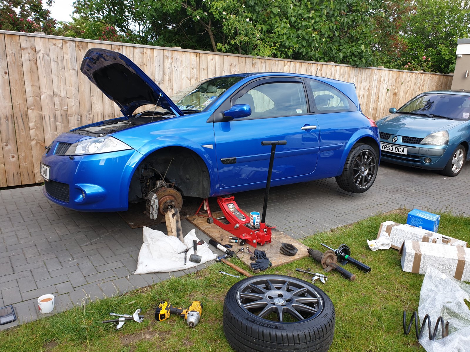

With the new shocks, fresh Pilotsport 4 on each corner, all fresh bushes, balljoints & tie rods up front it drives absolutely awesome and ive fell in love with it again. Its raw enough to have tons of fun in, yet refined enough to go to the shops in. The brakes are absolutely epic with the Ferodo ds1:11's up front and you can put the power down great with the r26 lsd.

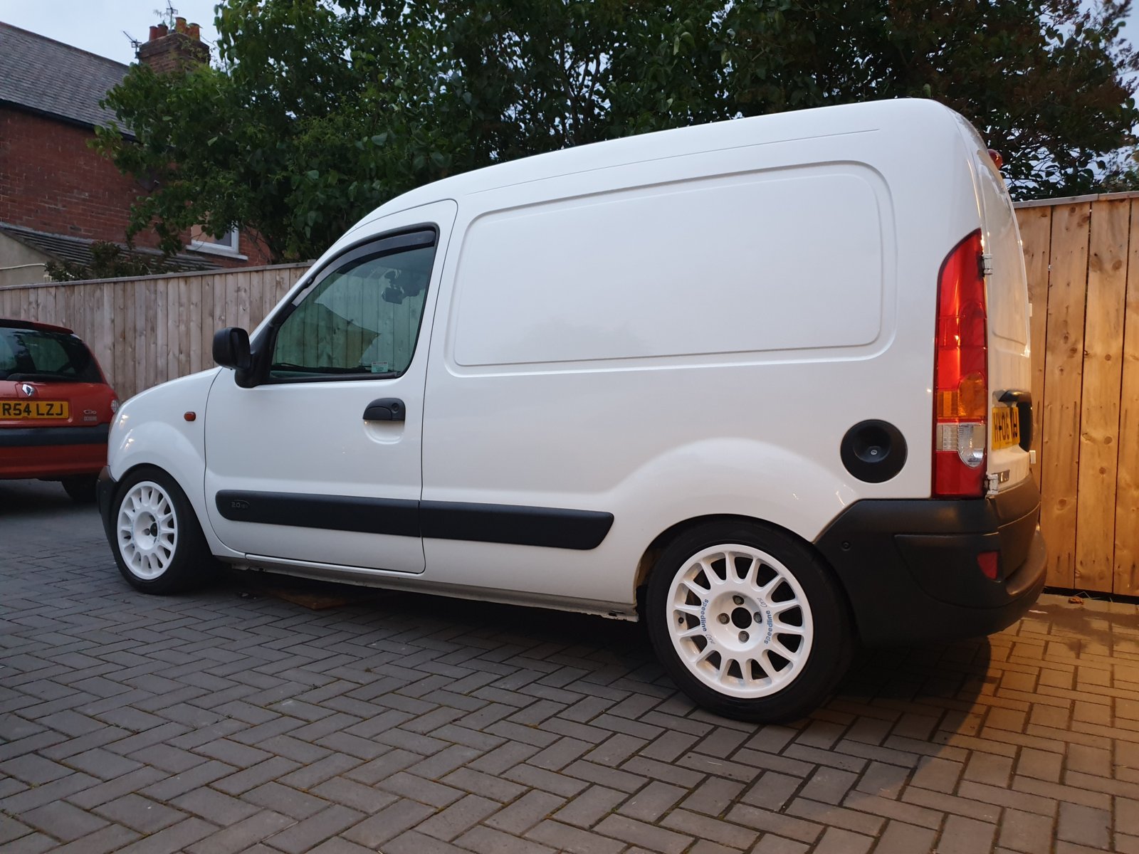

Started off by adjusting the rear shoes, they needed minor adjustment after a full day at Croft. This needs a disc upgrade on the back really, but works OK for now. Adjusting the rear compensator to original settings last year made a massive difference to wear.
Fresh RBF600 fluid, old stuff came out ok and it had done 2 & 1/4 trackdays (1/4 being 15 laps of Croft then the diff circlip s**t itself:rolleyes:)

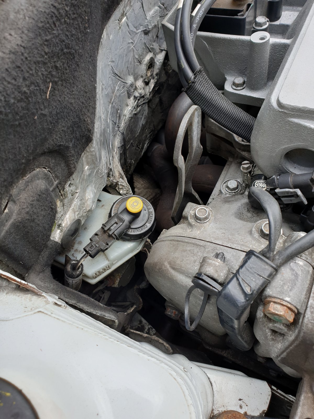

Fitted another brake reservior cap as mine was weeping out of the top/middle at Croft last time. See how this one fairs, i think i bought it new for my Extra van years ago bit same style/thread so boshed it on. Greased pms shifter bearing as had gone a little bit stiff for some reason ? Seems fine now though, will keep an eye on it.
Just needs a wash off and fuel, and refit the M1177 at Blyton and good to go. Mrs is using it as a daily at the moment and it seems to be running superb ! Fingers crossed it will behave on Sat.

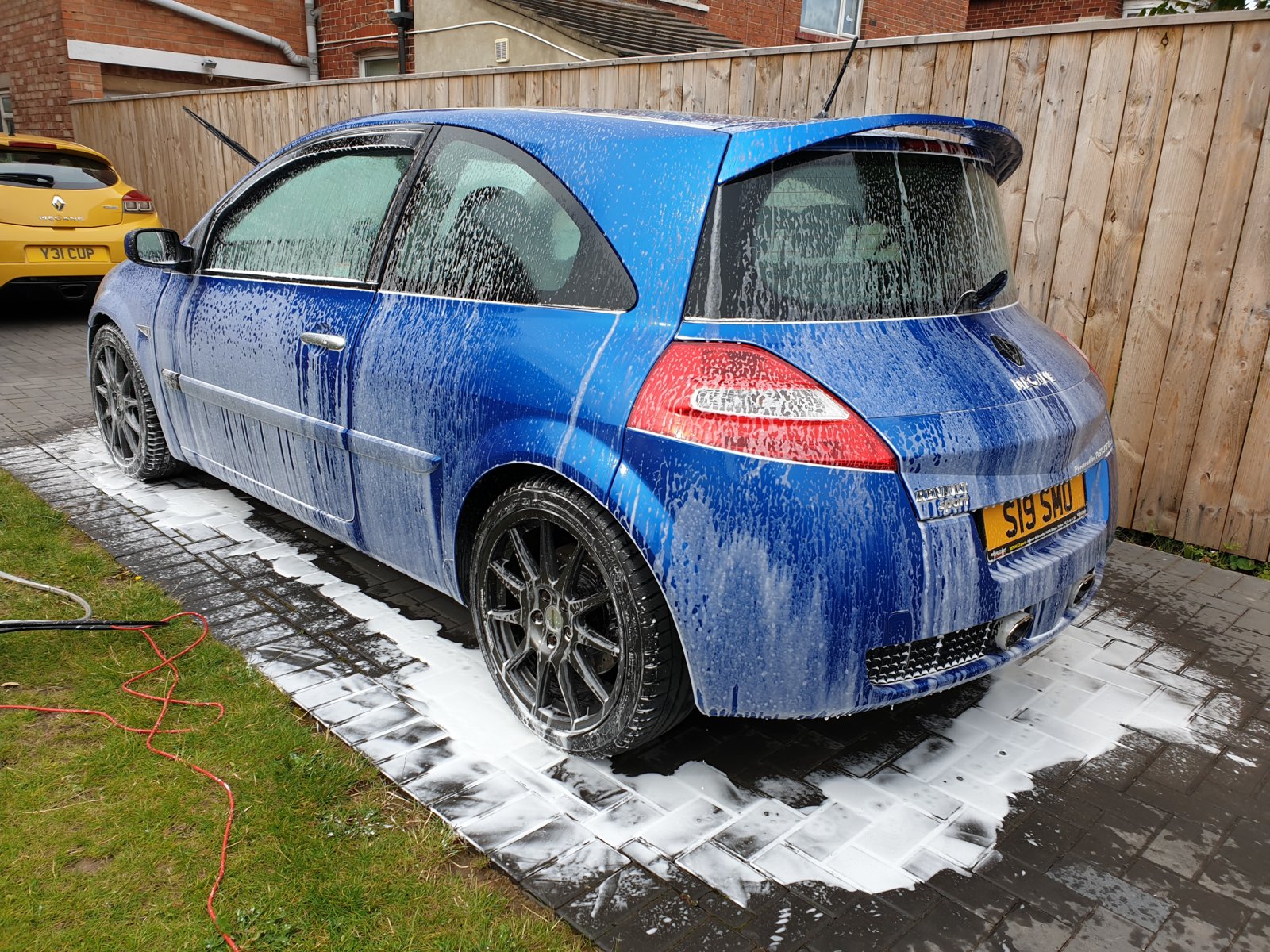

Late one tonight, got in from work/gym and went out to clean Kangoo and Megane up, as not been cleaned for ages maybe 4-6 weeks.
Started raining as soon as i had got the jetwash out, could not fecking believe it. Cleaned the inside and packed instead. Rain eased off 7:45ish so cracked on and got both done by 9:30. Started spitting again straight after, if it rains tonight or tomorrow they will be staying mucky lol.
Fuel them up tomorrow after work and should be good to go ! Thanks for reading!

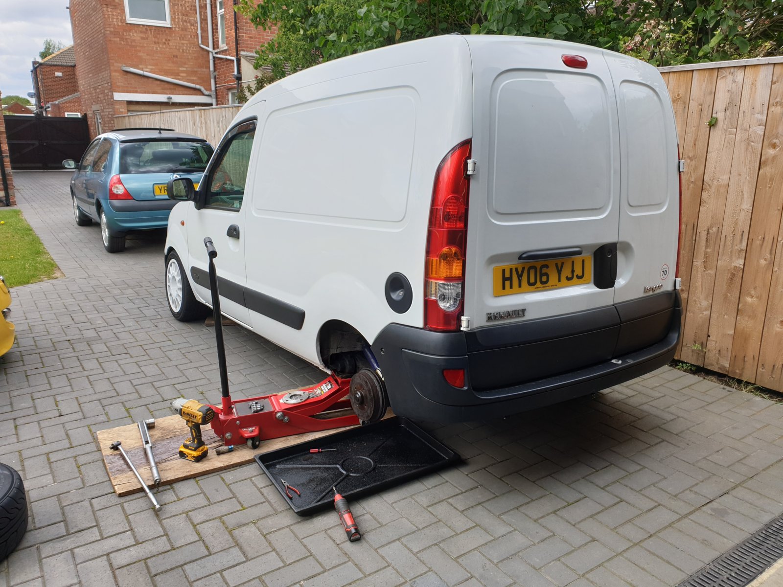

Mrs has been using it for daily driver duties since then. Noticed a couple of oil drips on our block paving, from selector seal as its a typical jc box and pissing out of there. So had a look today to see if it was just the selector or something else going tits up
Assume position

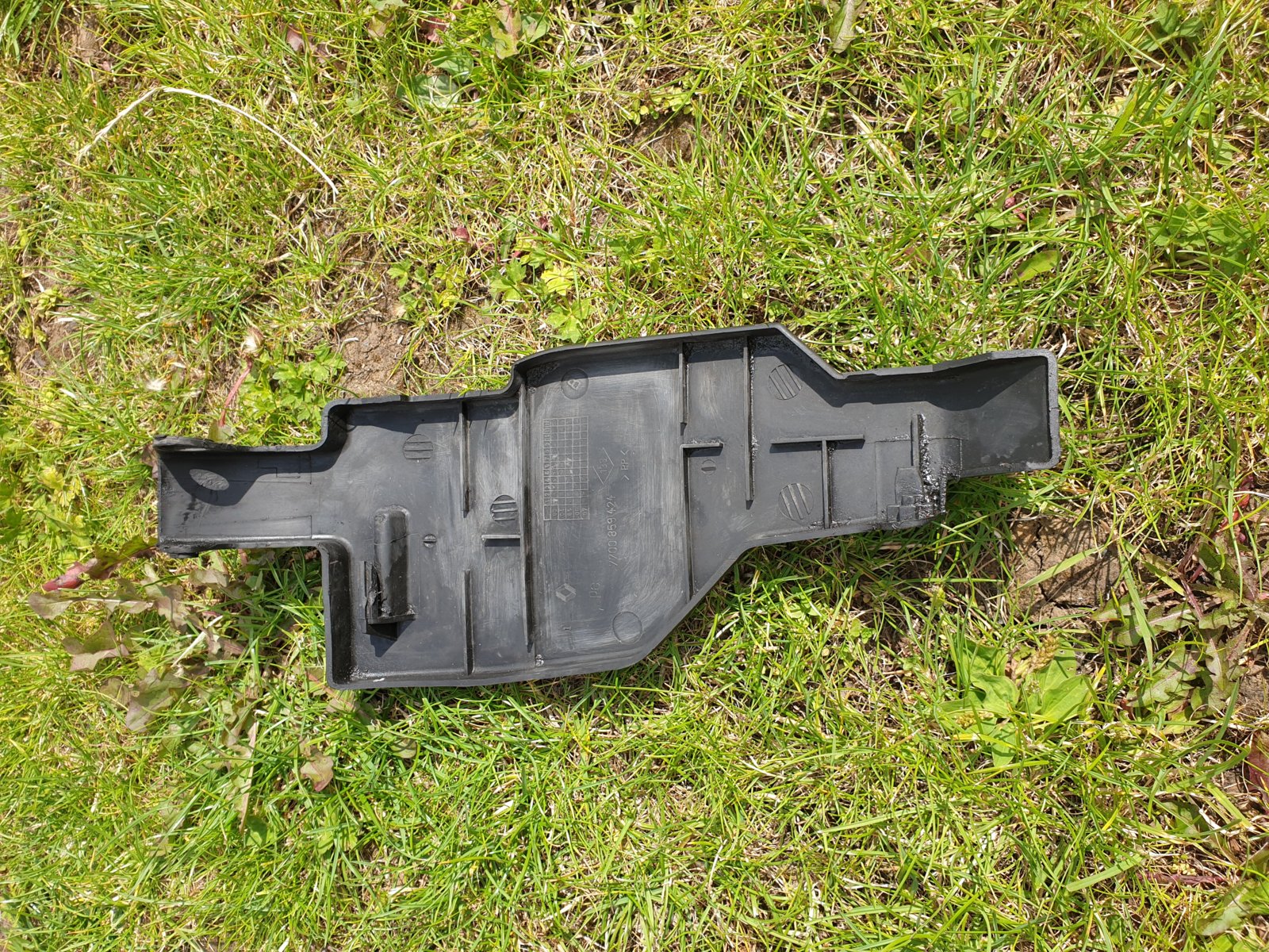

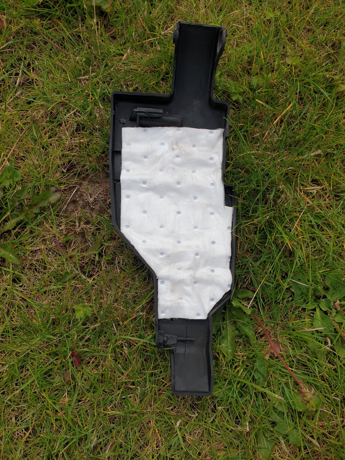

Looked underneath and the Renault drip tray that was fitted underneath as a band aid to stop it marking the block paving has gone walkies, it was defo on before Croft so its either at Croft or Blyton:LOL:
Had another one in stock off the blue dci after fitting a full undertray instead, so cleaned up, and cut/glued a bit of cheap oil spill mat on it to soak up the drips, Its like fitting a nappy to it. I seen somebody using a sanitary towel recently which was even a bit too pikey for me haha.
Topped up the gear oil with elf nfj, to my suprise only needed 100mm or less hardly anything.

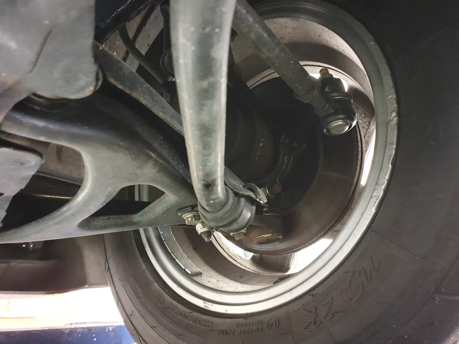

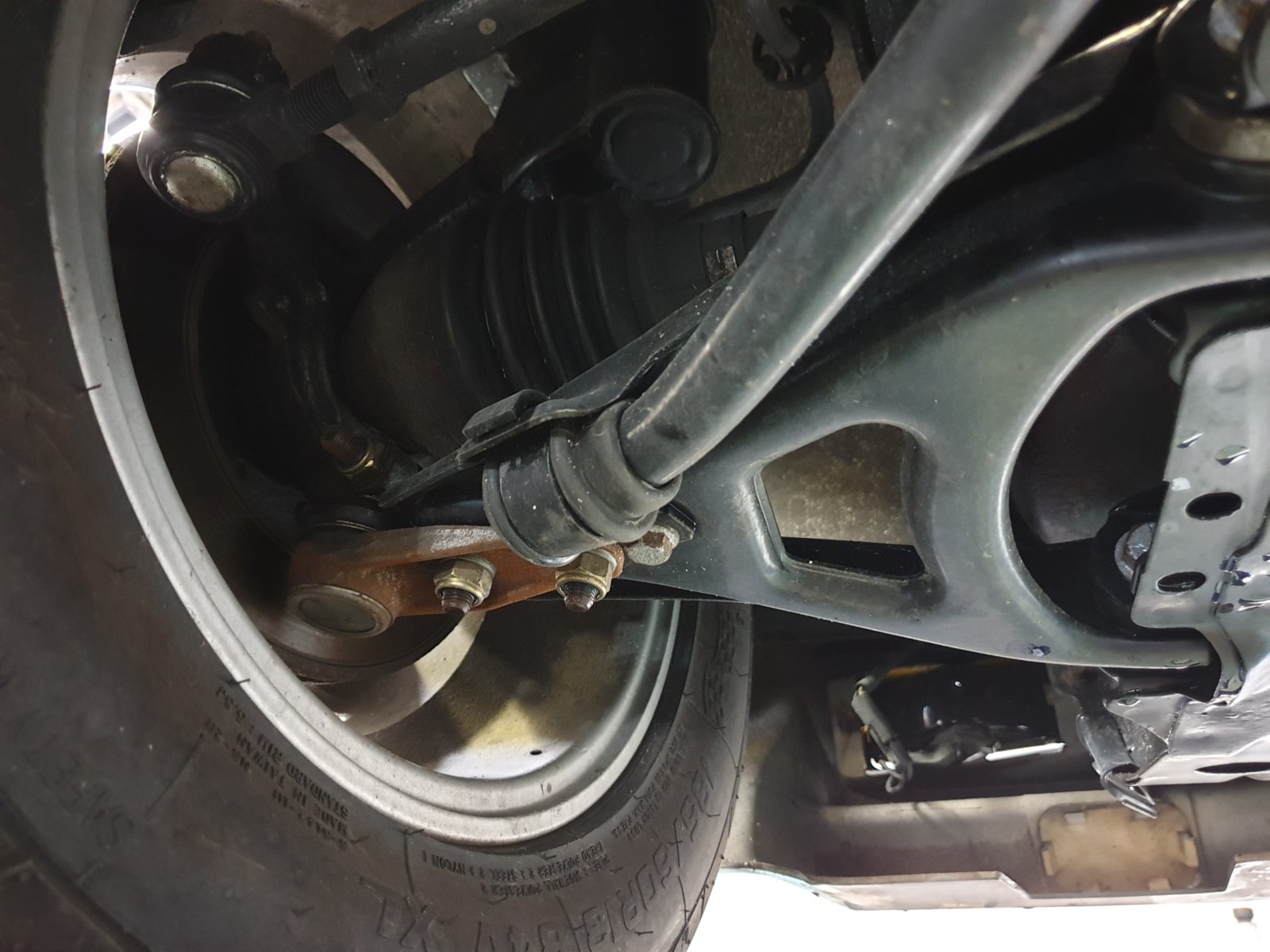

Give it a quick suspension check over whilst on the jack, no issues at all. Checked oil and fluid levels, oil is still on the max and golden, coolant still on the max.

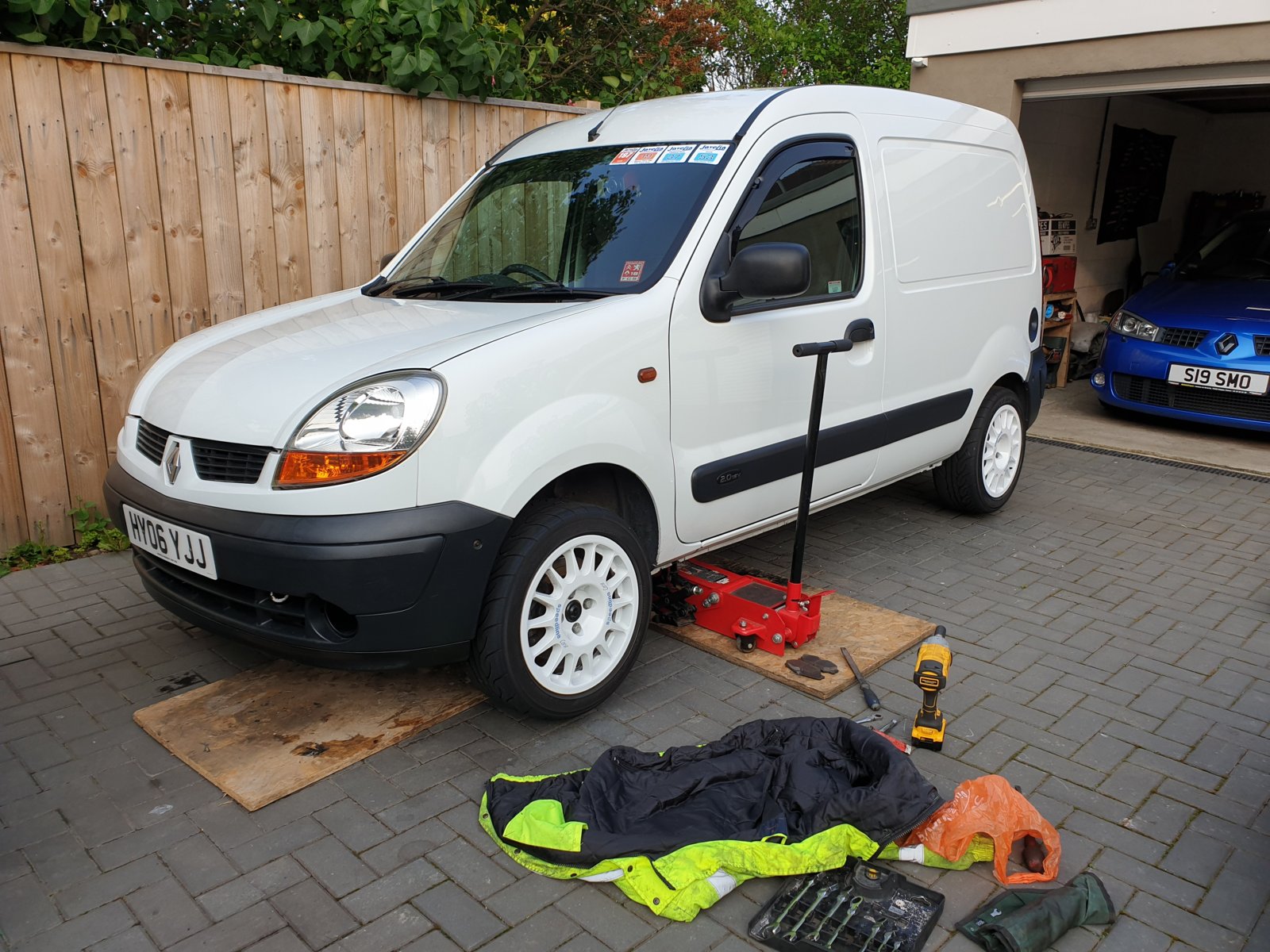

Had a few spare hours yesterday afternoon, so pulled the blue meg out and changed the oil and filter with elf evolution 5/40 & purflux filter.
With the meg out of the garage made the effort and got the gtt out, and give them both a clean. Used Bilt Hamber autofoam, it takes 90% of the muck off with no contact, awesome stuff. Its all go and no show, no ridiculous foam up, just works epic.
After this took the gtt for a run out, nice Sunday evening blast, then just got back home before it pissed down, which it always seems to do when i take it out for a drive!

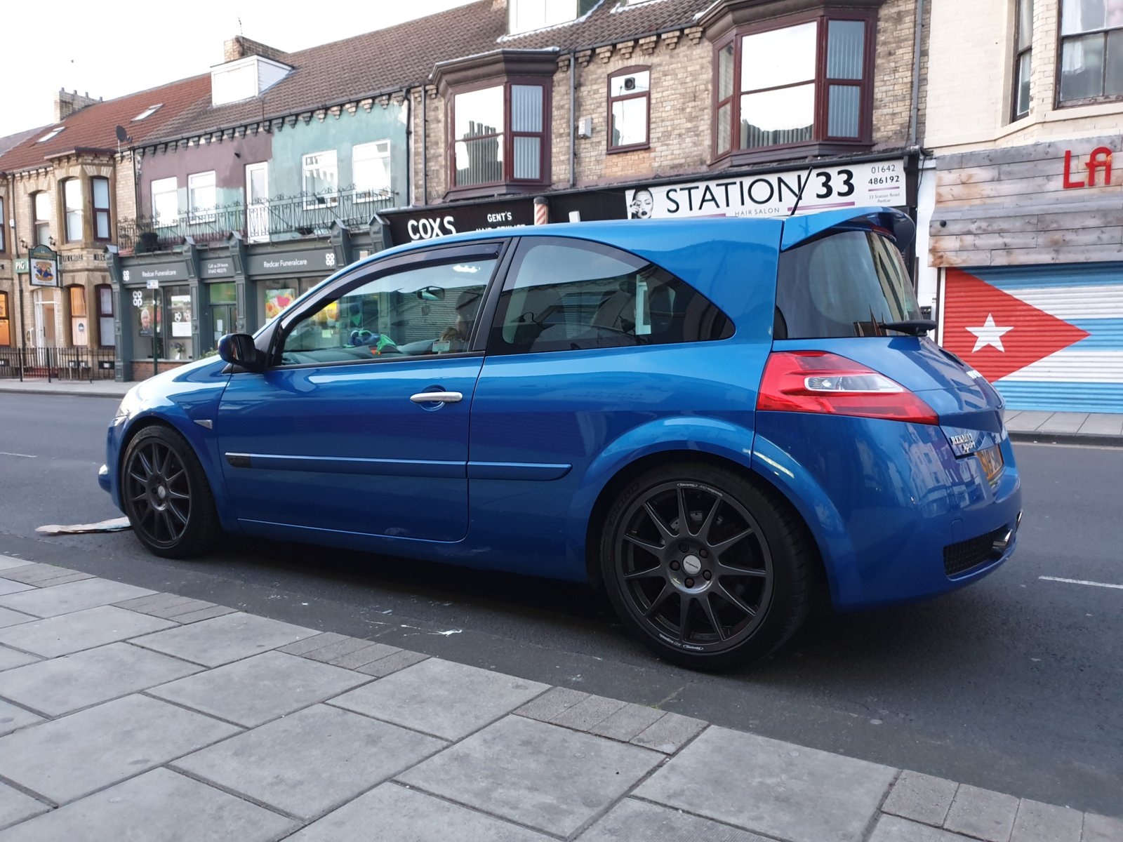

Blue megane has had the timing belt, water pump, aux kit, new fuel pump and 15t fitted. Old cambelt and aux looked mint after 5 years/15k, the crank pulley did not look so good though!!
Mapping booked for next month at Efi, hope the clutch holds out, but should see 300hp hopefully.
