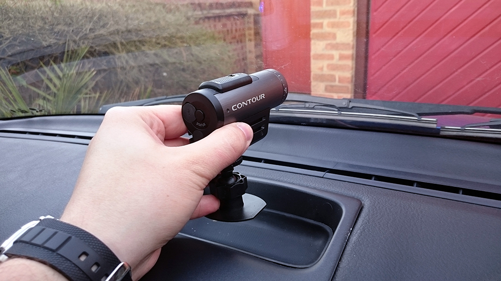

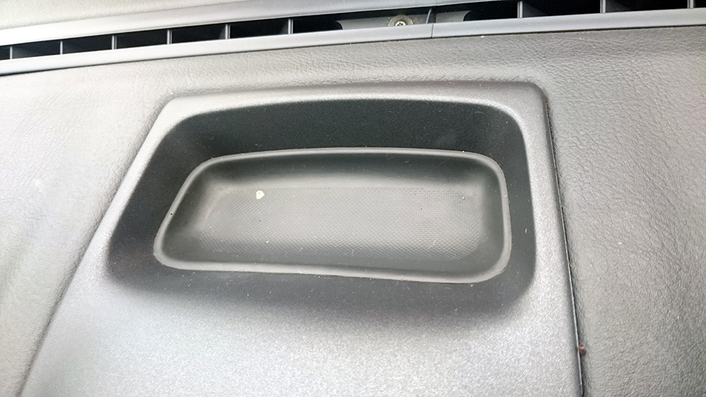

I'm looking at different ways of mounting an 'action' camera in the front of the car ready for track days (in my case a Contour camera) and have seen a thread where a forum member mounted a camera above the clock in the dash.

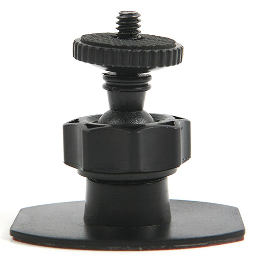

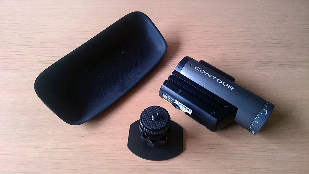

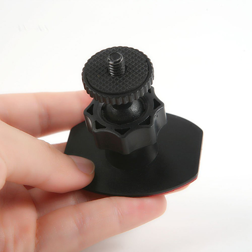

We've bought the following mount for a few quid with the idea of a couple of self tappers running through the base of the mount and into the top of the dash.
We've also got a spare rubber insert for the recess above the clocks ready to cut up and screw into (and keep on perfect for a cover for when not in use).
Do any of you know if there are any cables (or anything else not to be tampered with) directly under this area in the dash. Any ideas on what size fixings would be best to use?
Either that, or are there better permanent fixings to be used?

It's only few bolts whip dash off, I'd then drill couple of holes and bond some nuts to the underside. Then you can use some small bolts through the camera mount and remove when not in use. If you did that with self tappers the holes are going to pull through pretty quick after couple of refits

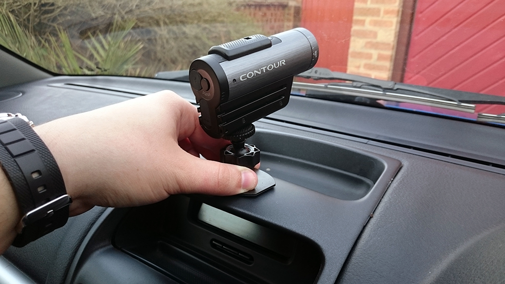

Well the mount has arrived and it's not bad quality for a few £. It should do the trick nicely. I can gut a hole in the replacement rubber mat to poke it straight through and it should look neat.
I just need to check what it looks like before I make it more permanent:
  Clio 182, EvoX FQ360

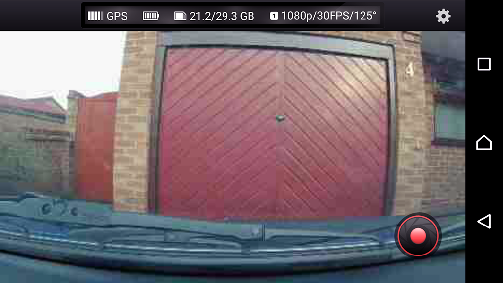

I had a proper look at the camera mount again today to see what everything looked like. If the camera is mounted in the dish thing it does just get a lot of the wipers. It'd have to have something to raise it up which would looks a bit messy really.

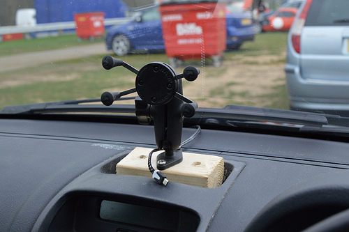

I realised that Cadwell Park didn't allow suction mounts so had the same dilemma at 10pm the night before the track day, it may not be elegant but I came up with this... I use my phone and Harry's Lap Timer to record on track and I was happy with the positioning of it.
The block of wood is currently held on with a couple of screws through the dash but I'm planning to take it out this week to paint it black and attach it more securely so watching this thread with interest. That said, it worked well and survived a full day at Cadwell! Here's the view from it...

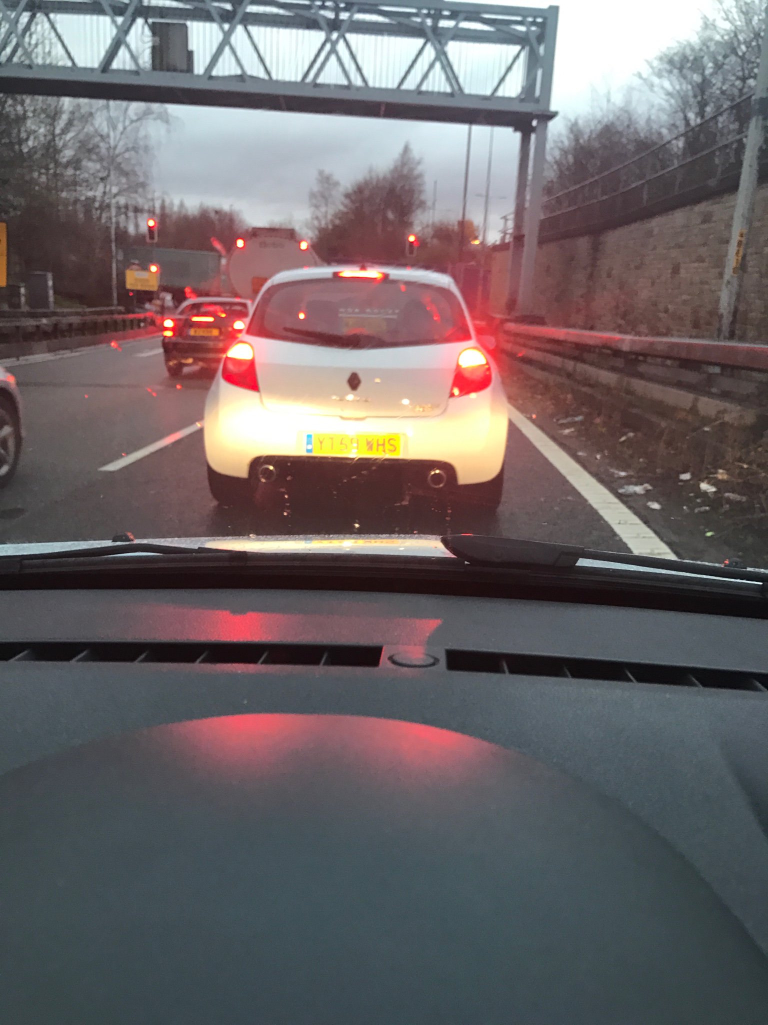

Took this using my iPhone montes in a quad lock case and bracket. Obviously from the passenger seat!

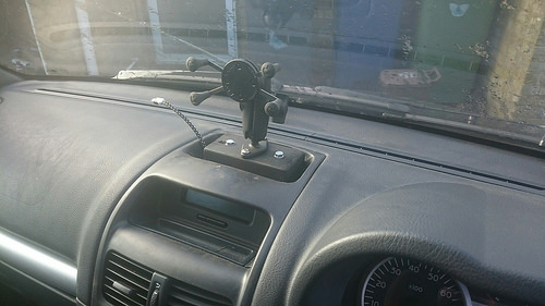

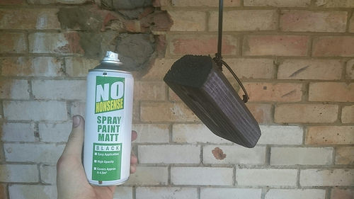

I gave the mount a bit of an update over the weekend... The longest part was waiting for the paint to dry but I think I spent about an hour doing it if you don't include the wait time.
Firsty, I gave it a coat of Matt Black so it blends in with the dash a bit better as I want to leave it in place

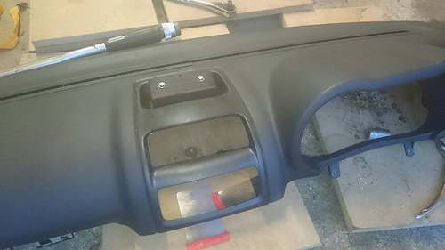

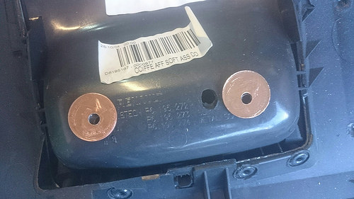

I then followed the guide to remove the dash (sub 15 mins) and wanted to bolt through the wooden mount and dash to keep it firm so needed something to spread the load slightly. I realised I didn't have any penny washers so I made some 2-penny washers...
I'm not sure if that other hole is original or not? But chose to ever so slightly widen the existing 2 holes that the standard rubber mat goes into. I then put some bolts through the lot and bolted the bit of wood to the dash...
I then put the whole lot back together, I haven't got a picture of it but I also made a small hole to put a cable through and ran this up through the dash. The other end sticks out of the back of the cup holders so I can plug it into the 12v socket there. I then attached the parts of my RAM Mount and I'm really impressed with how solid it is and I think it looks ok all things considered...

Used the mount on the way into work this morning and it's very solid, would definitely recommend!

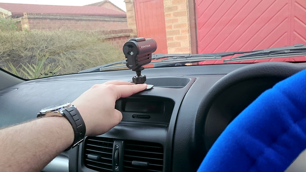

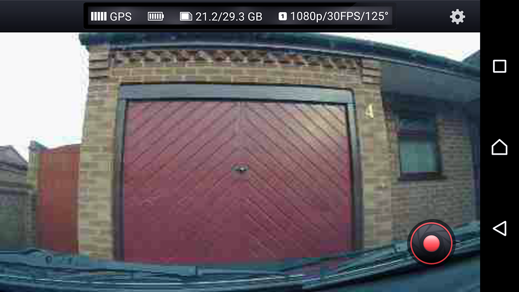

Just tested out my mount which is a 3M go pro above the clock and I'm just getting a frame full of wipers!
My wipers seem to sit abnormally high is this just the way they are?
Mine did get a lot of wiper in the shot from there which is why I'm considering moving it backwards a bit. Bloody wipers...

Yes the dash removal was a lot easier than I thought it would be, honestly less than 15 mins to get out. Slightly longer to put back in as I lost a screw that attaches through one of the top vents and had to find another to replace it so just be careful not to drop any of those 3 on top.

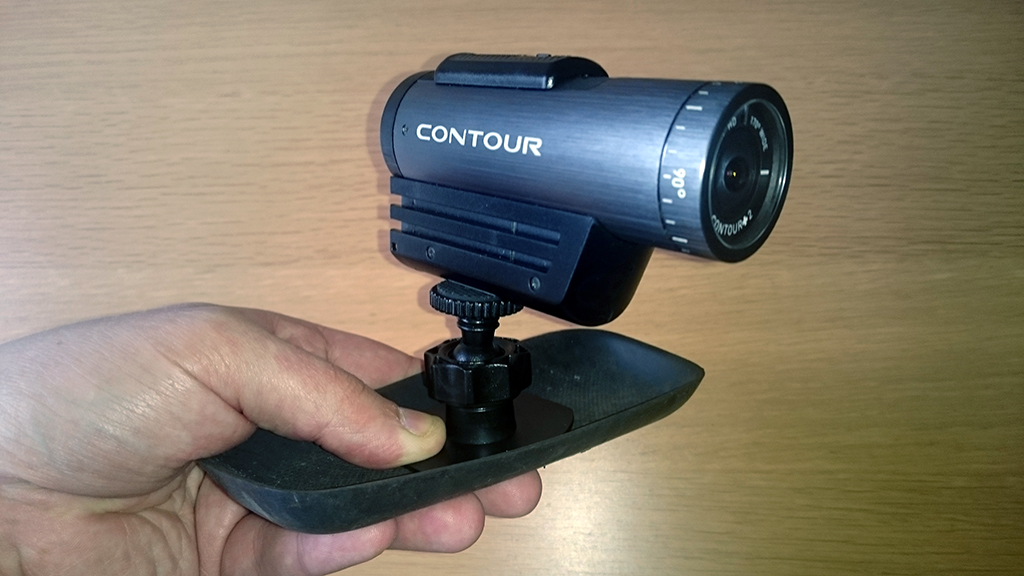

For all those who are getting footage of their wipers in action, this is why I needed to use the wood. I could have mounted it just using the 4 inch extension bar but even that was a bit too low so I used the wood to raise it as well as giving something secure to attach on to.
