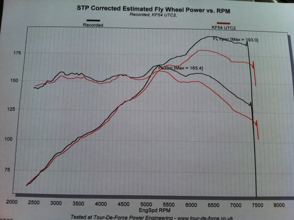

428's aint too bad once Matt (icarus) has mapped it!
Your car is a bit of a Freak though Dave!!!! It's one of the strongest none port throttled cars I've ever seen :)
Generally 188 - 190bhp on 428's with matched inlets and no aircon compressor is about right.
And mine had air-con lol
