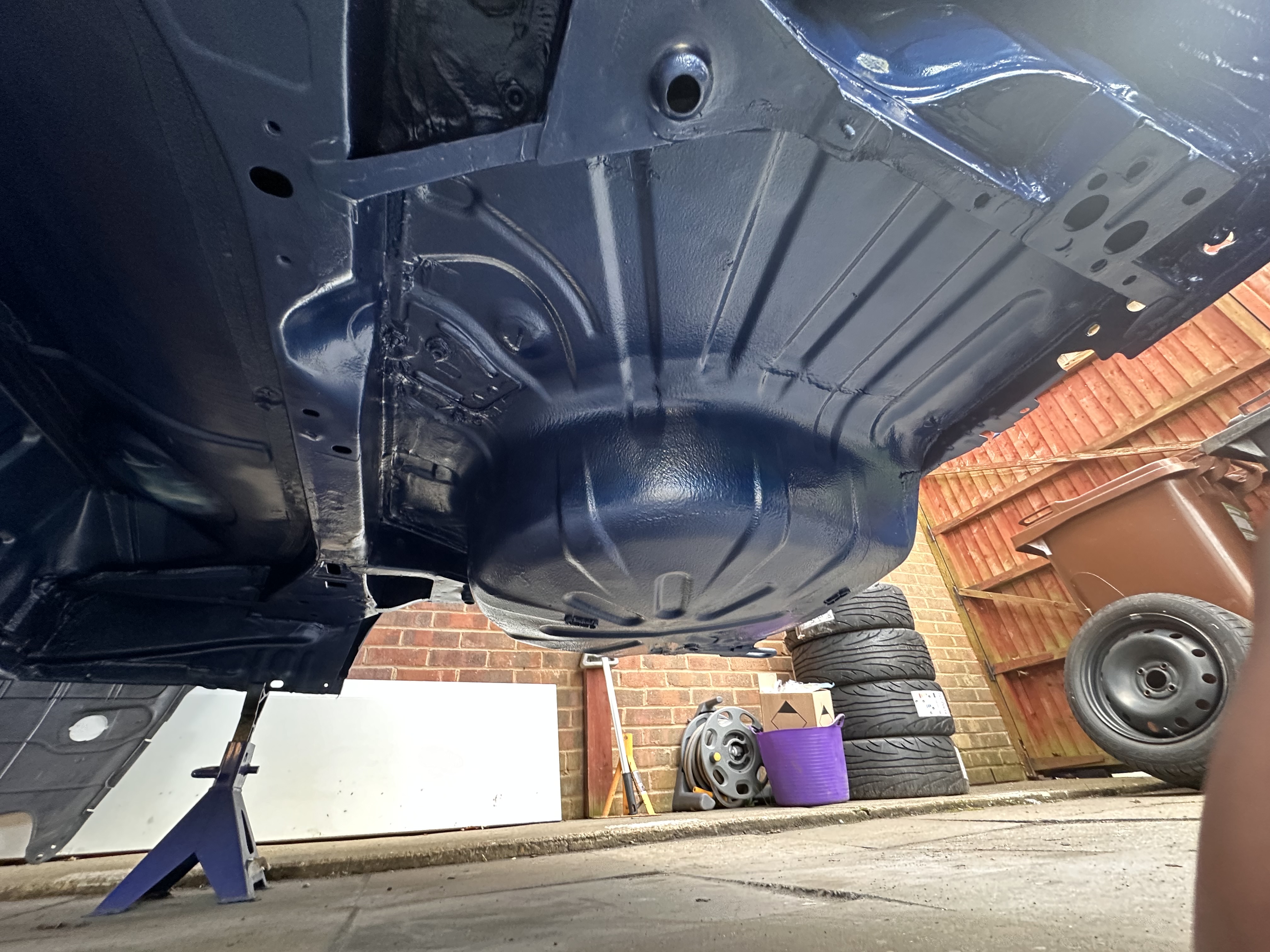

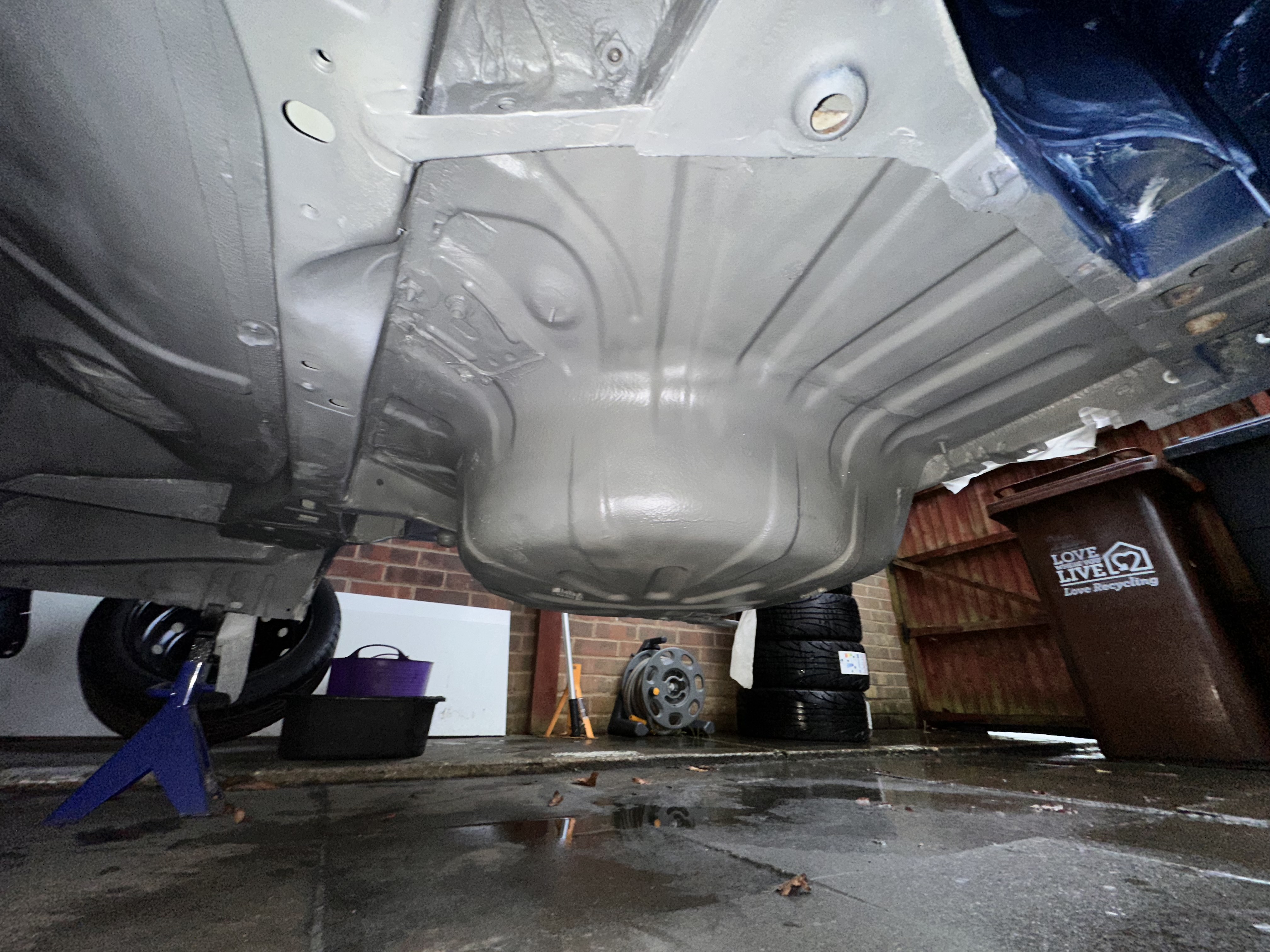

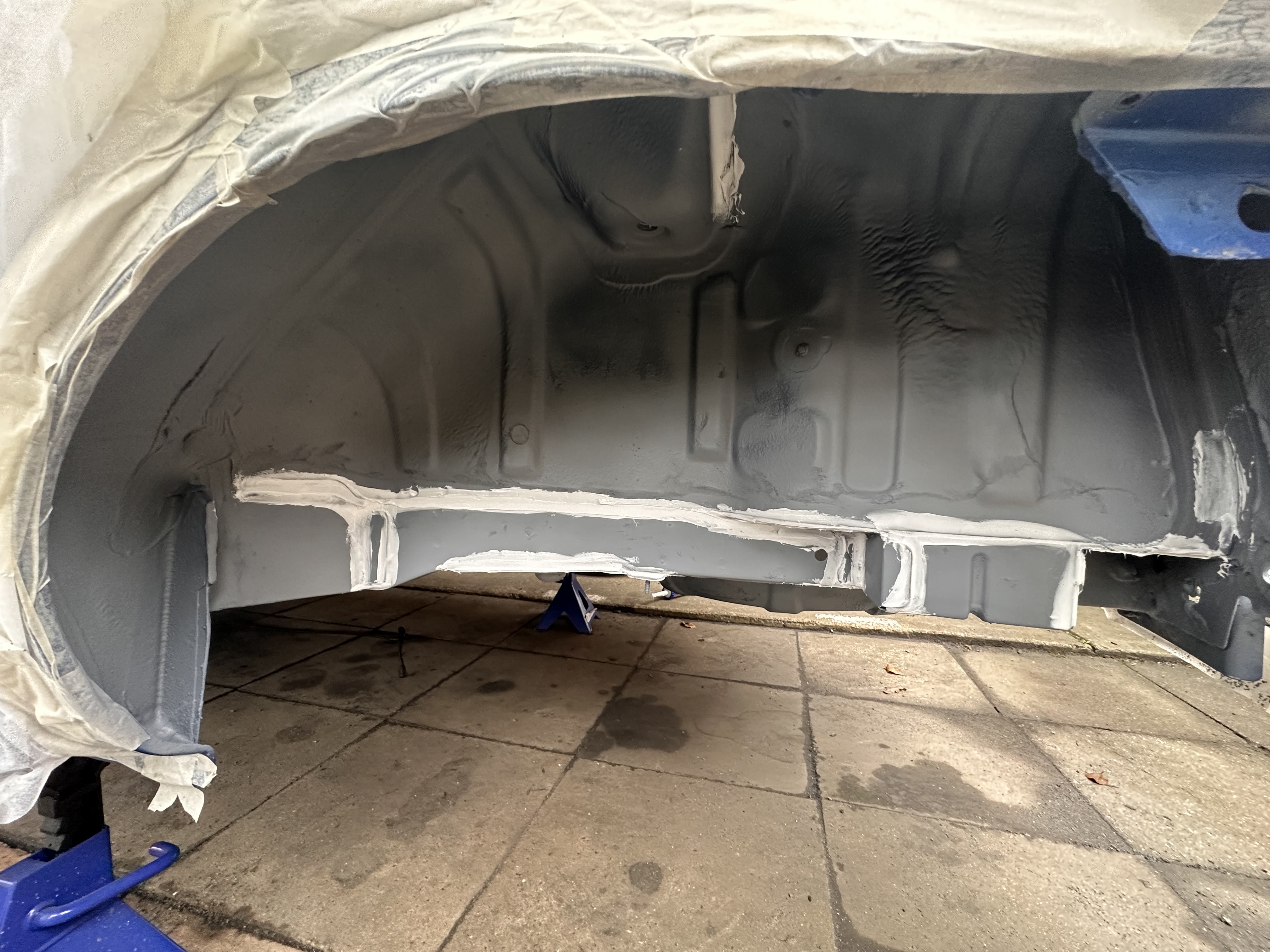

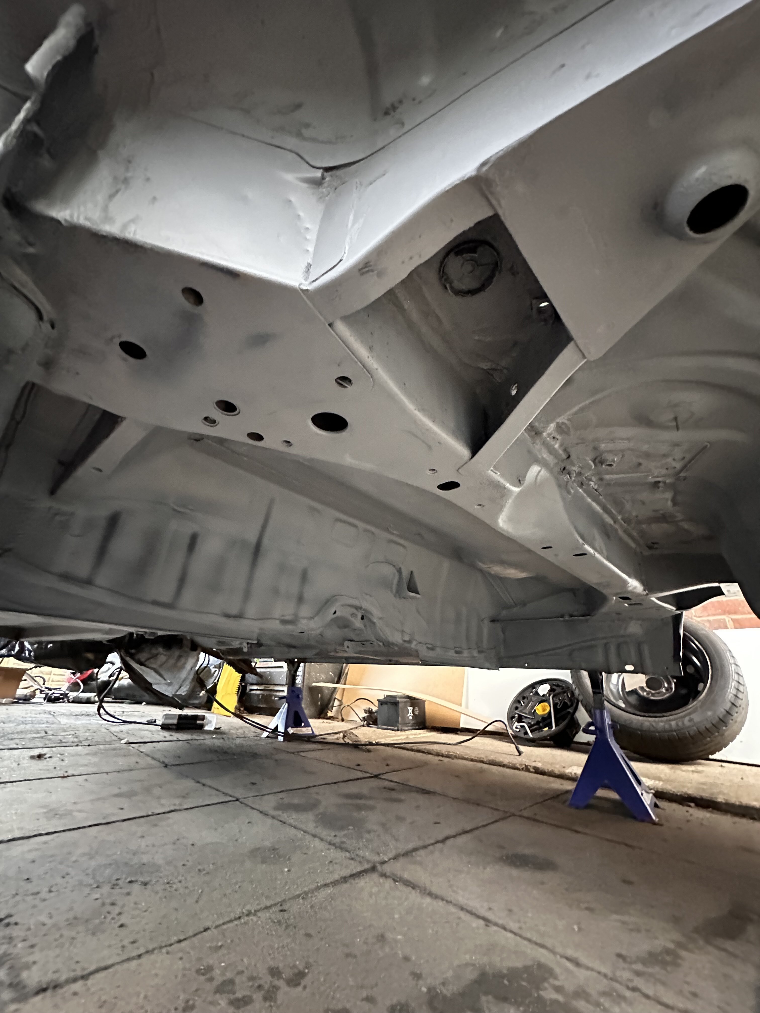

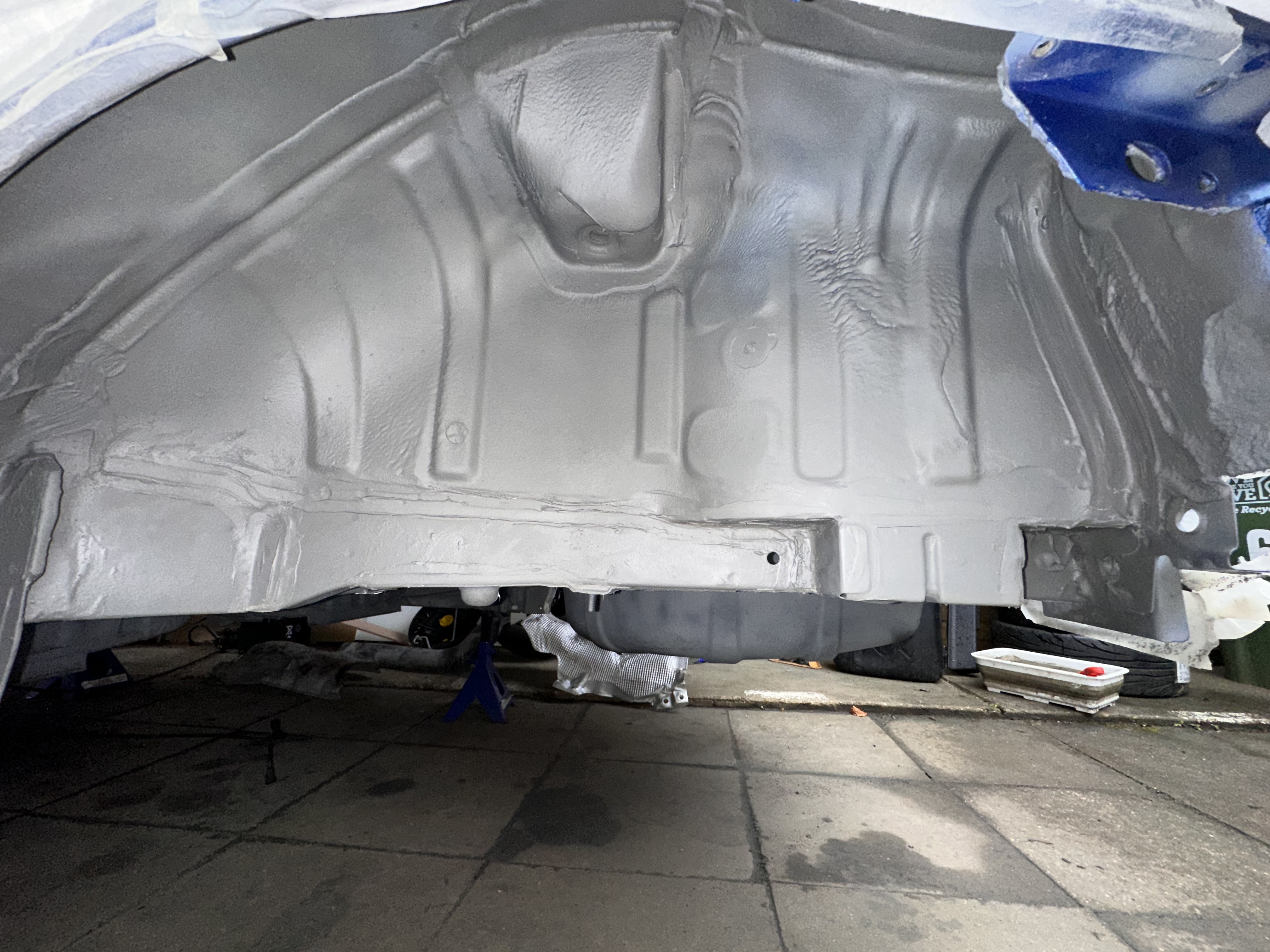

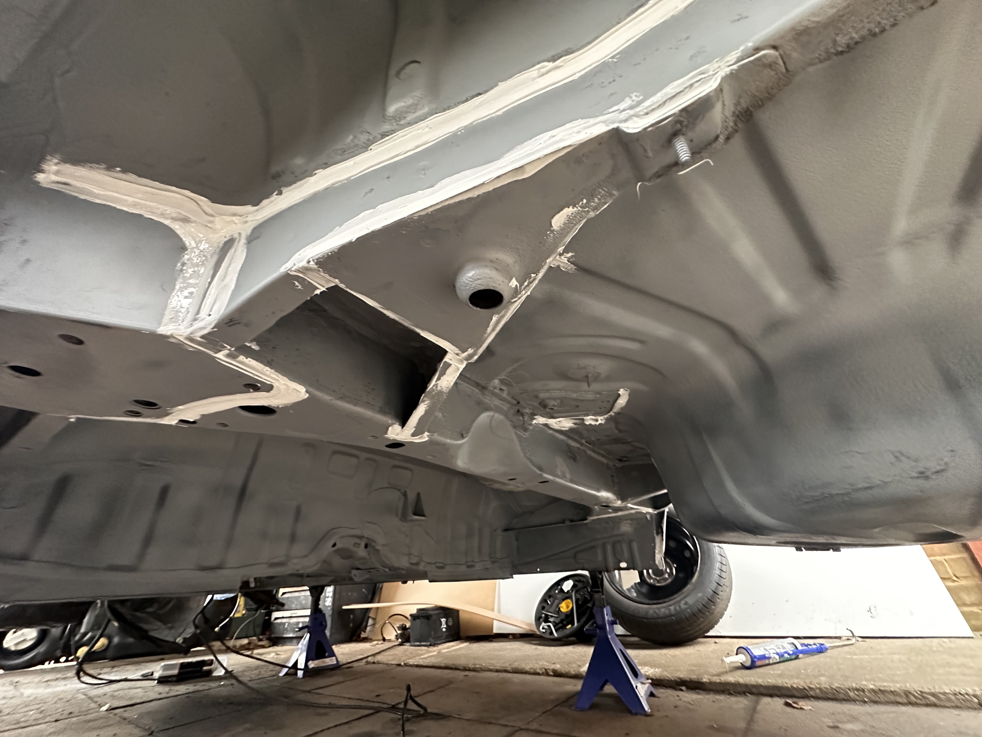

Tried to make some progress yesterday with getting the rust primer sprayed underneath. Massively underestimated the amount of cans I needed and ran out after 4 of them.

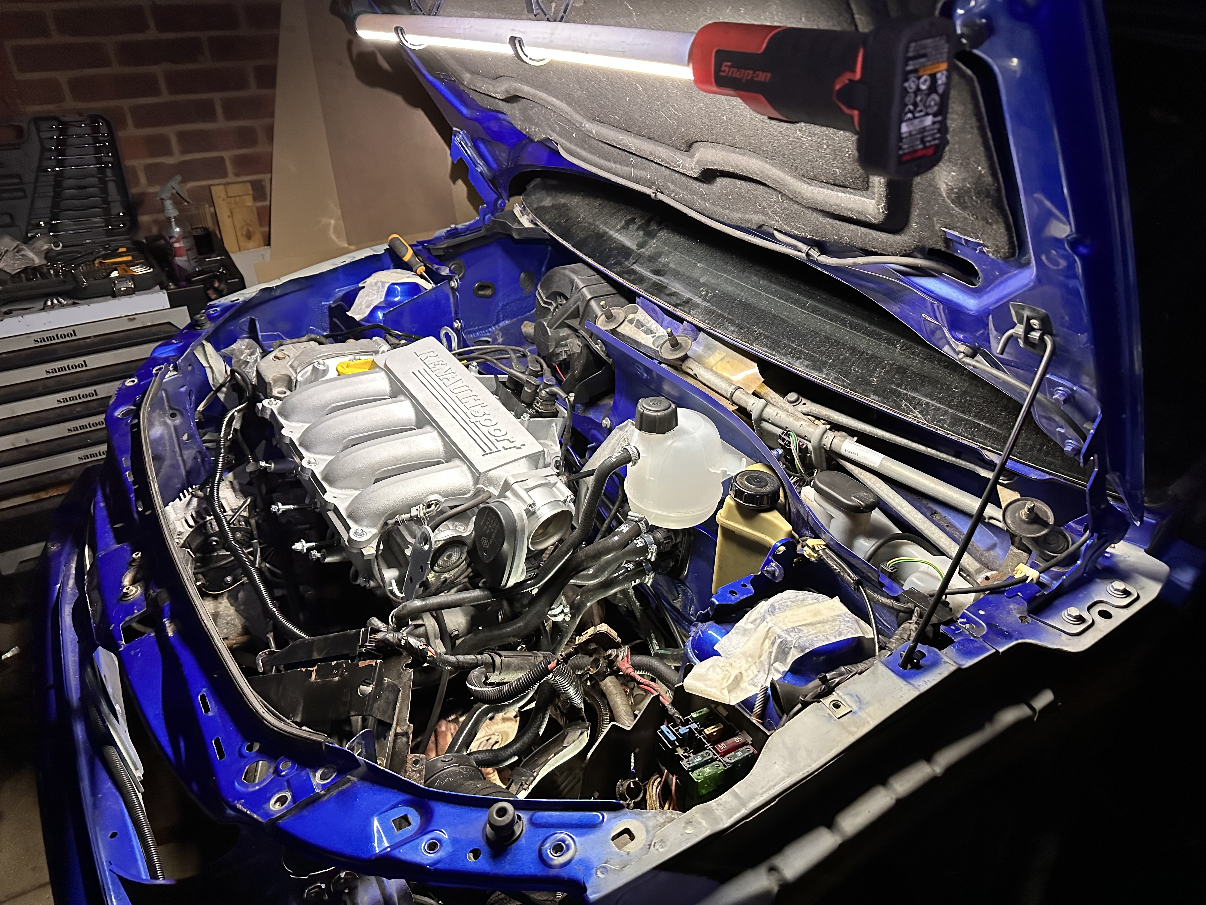

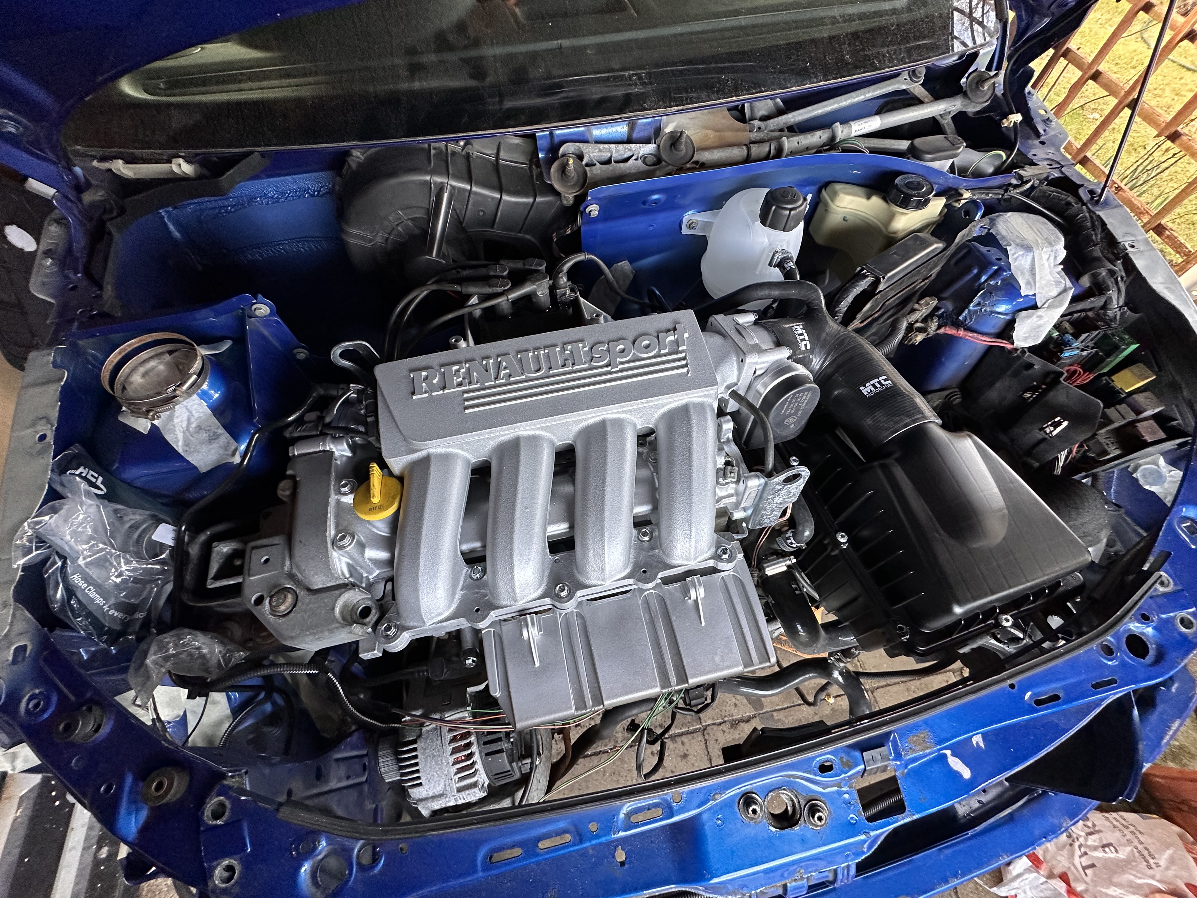

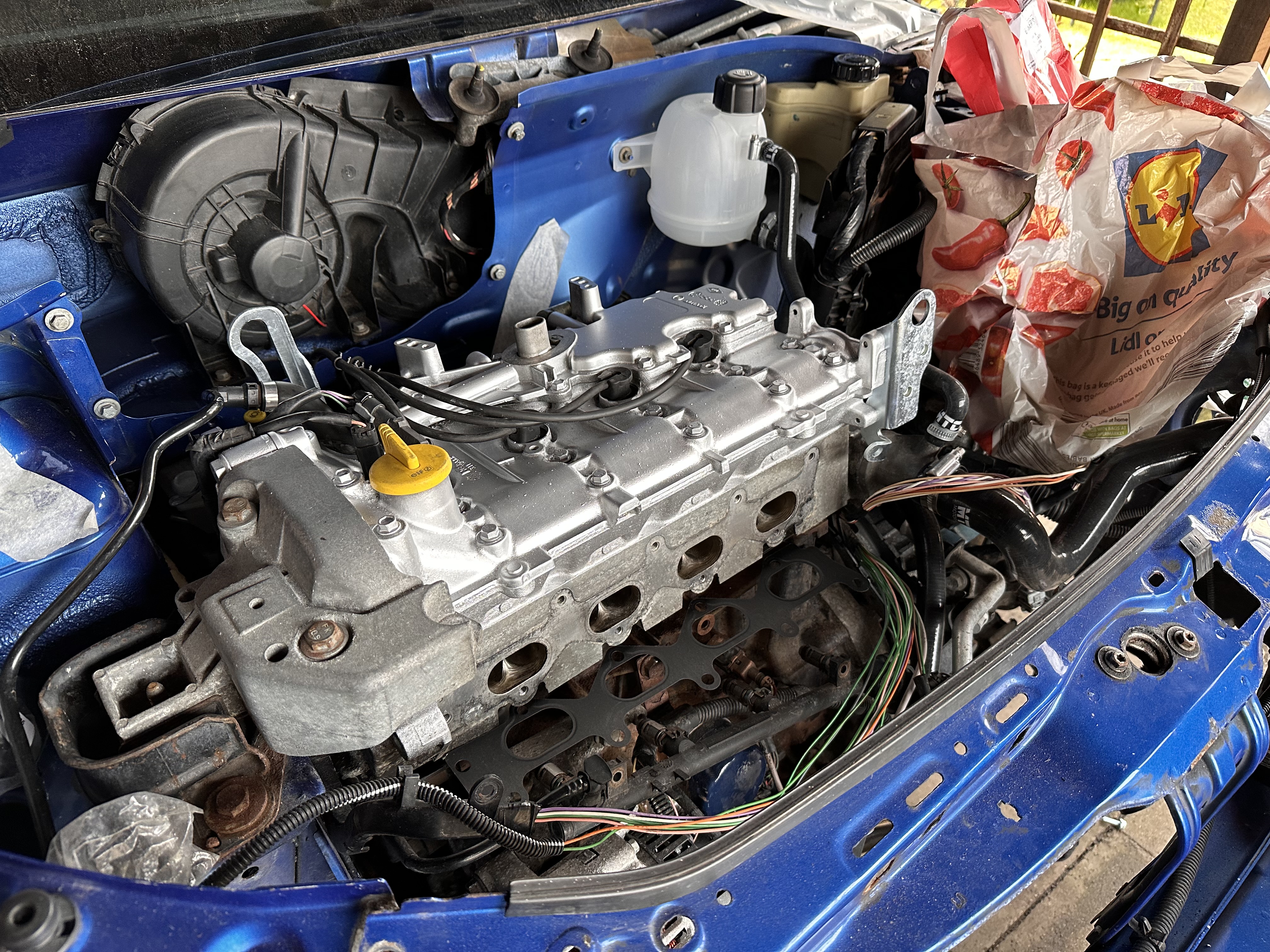

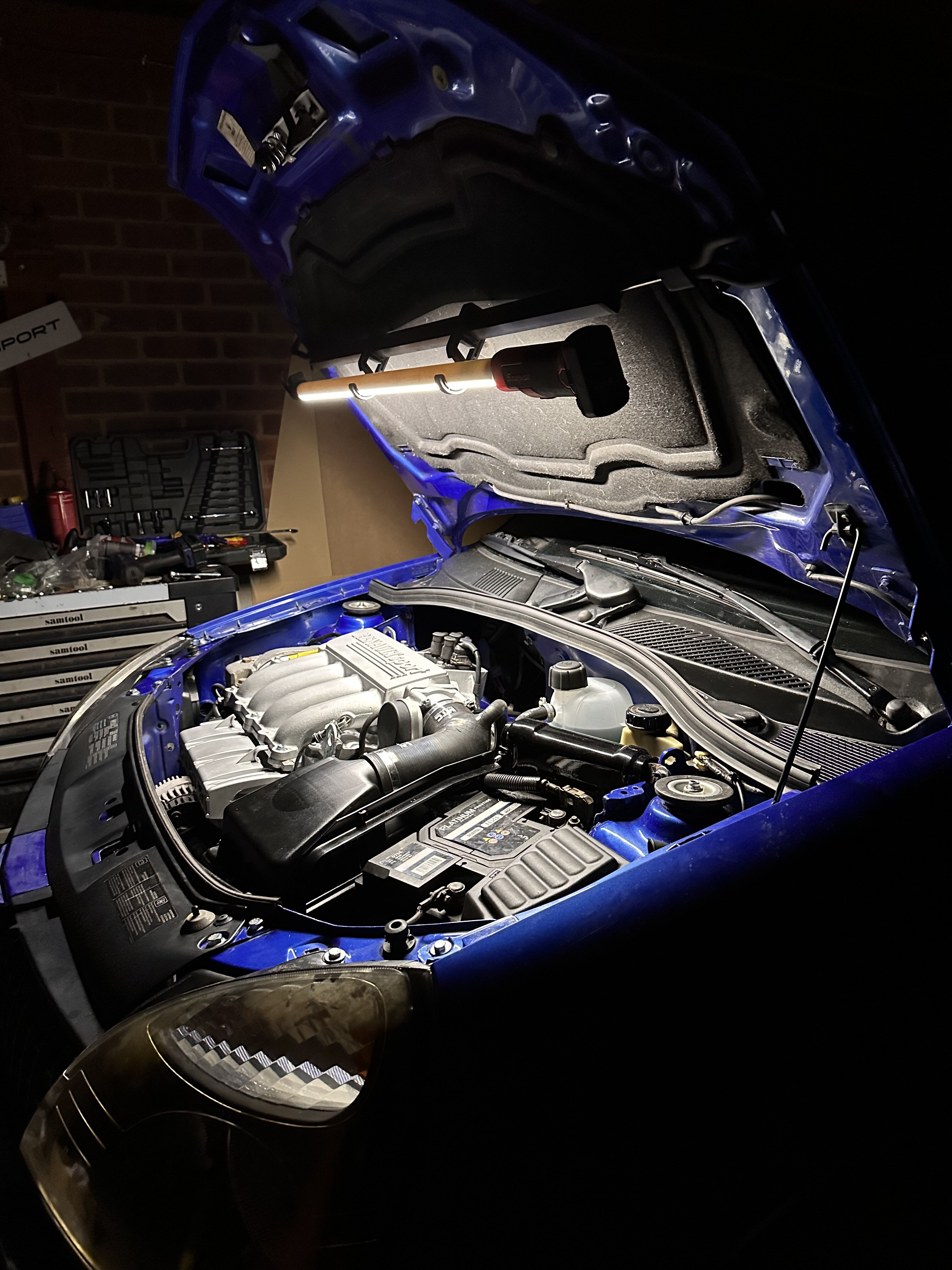

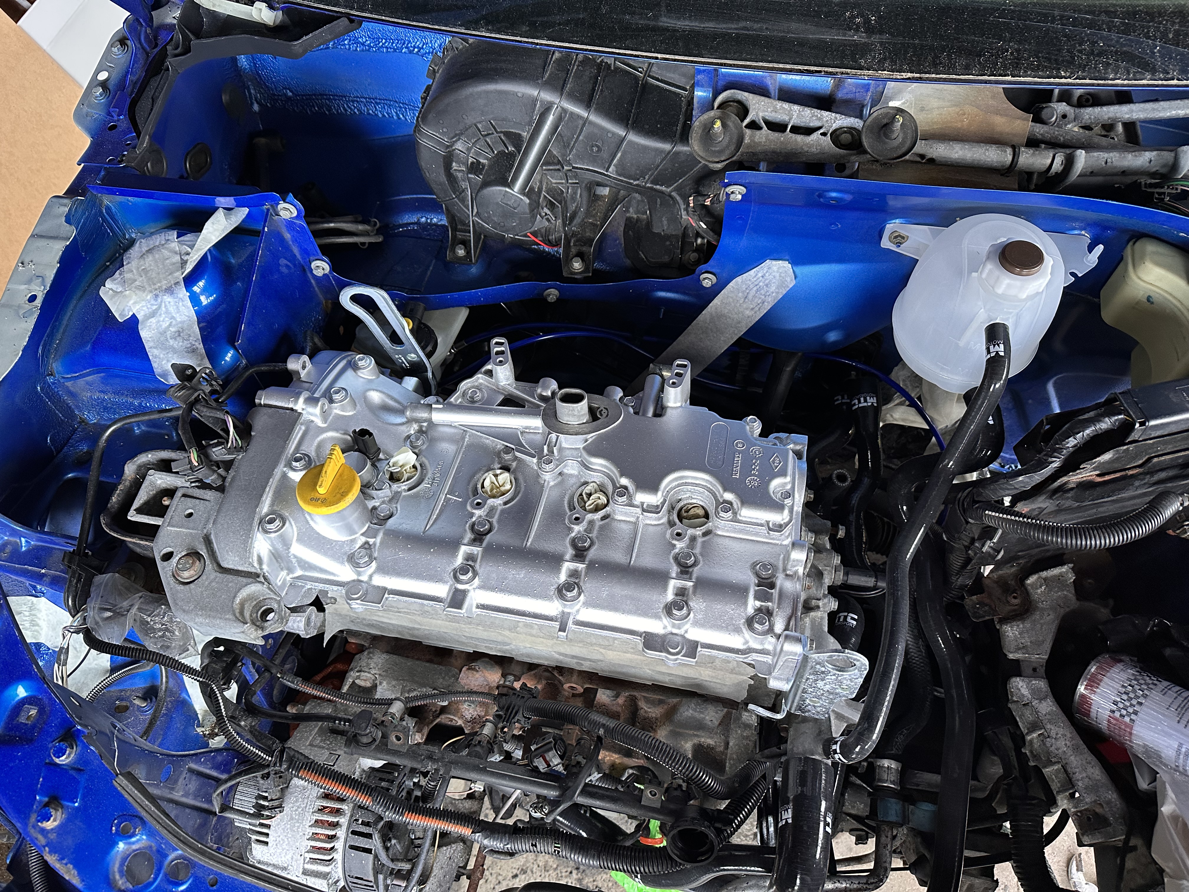

So we turned our attention to the engine bay. I had some VHT silver but didn’t quite realise how shiny it would be. Still, it’s an improvement.
Honda bond was also used on the bolts to try and eliminate any oil. I suspect the mess before we cleaned it had probably leaked from the VVT solenoid.

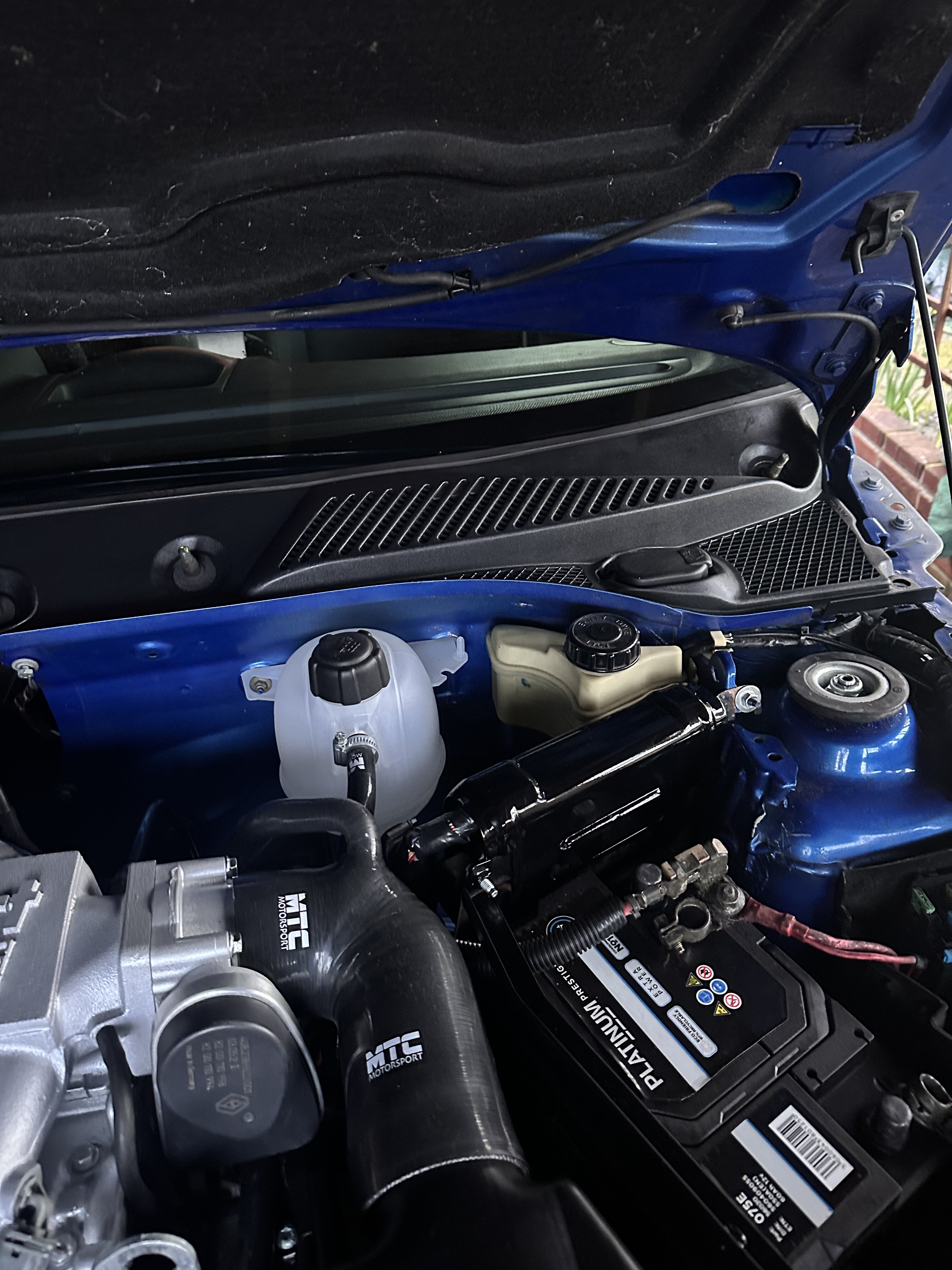

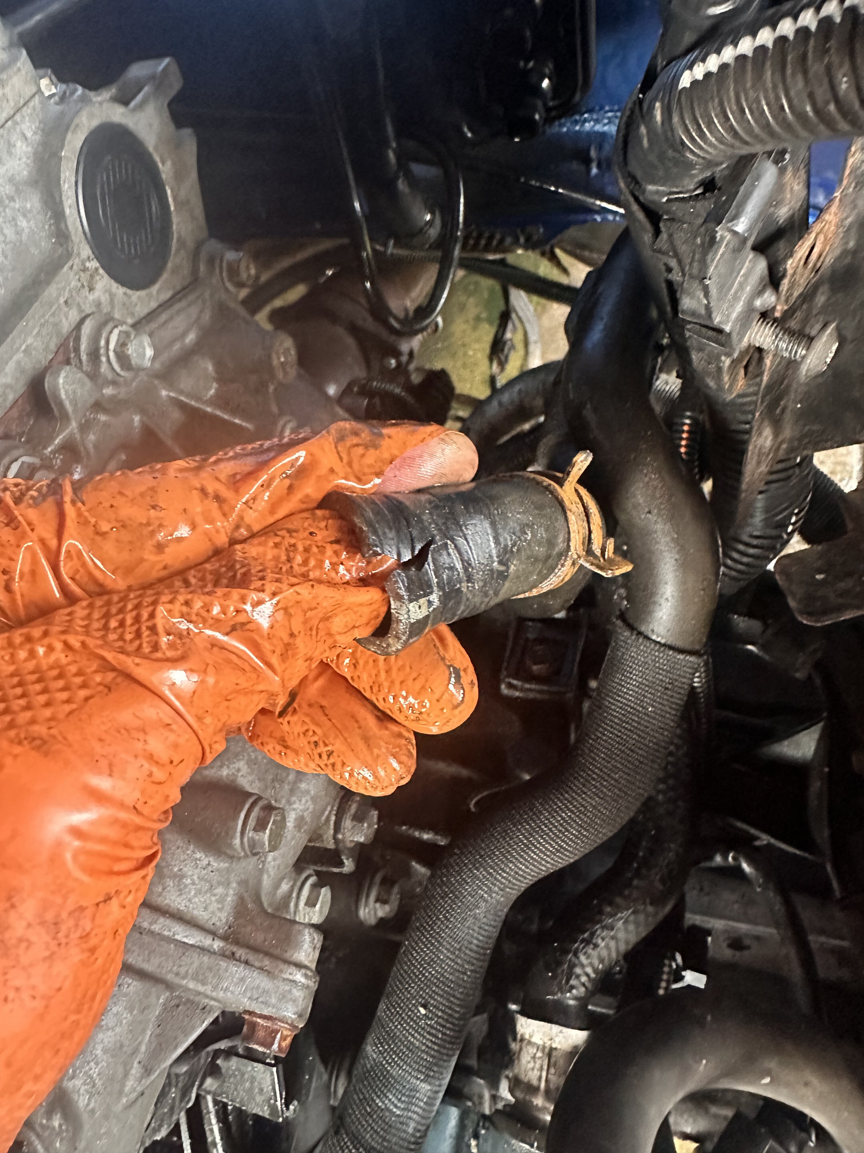

We also mocked up the MTC hoses. They fit nicely. One of the OEM items was starting to split, so it made sense to fit new ones.

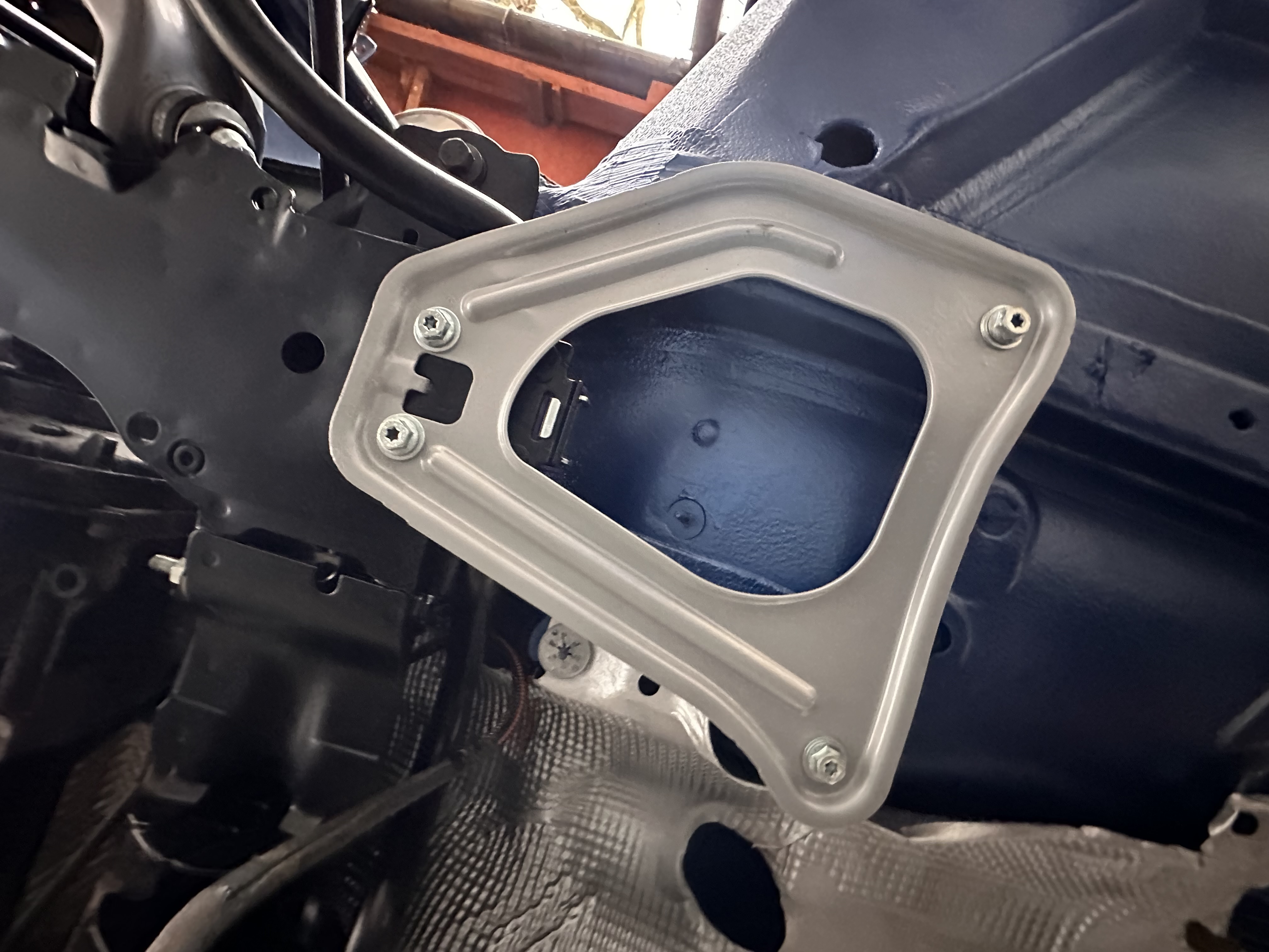

Once the primer had dried, I decided to silicone the sections where there are joins. It’s not pretty, but it’s a preventative measure to stop water ingress.
Underneath needs another go, but after that was touch dry i stone chipped on top of the silicone inside both arches.

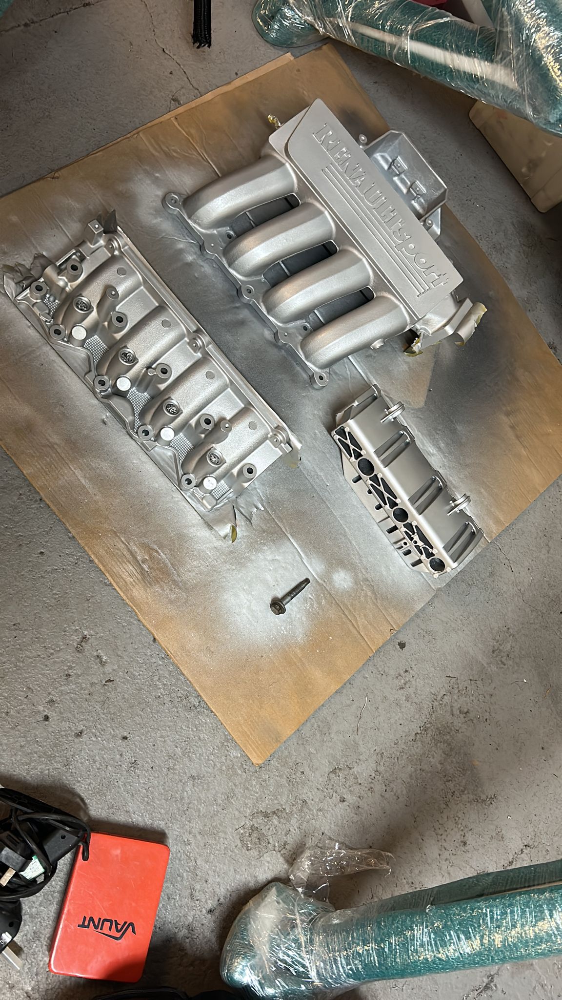

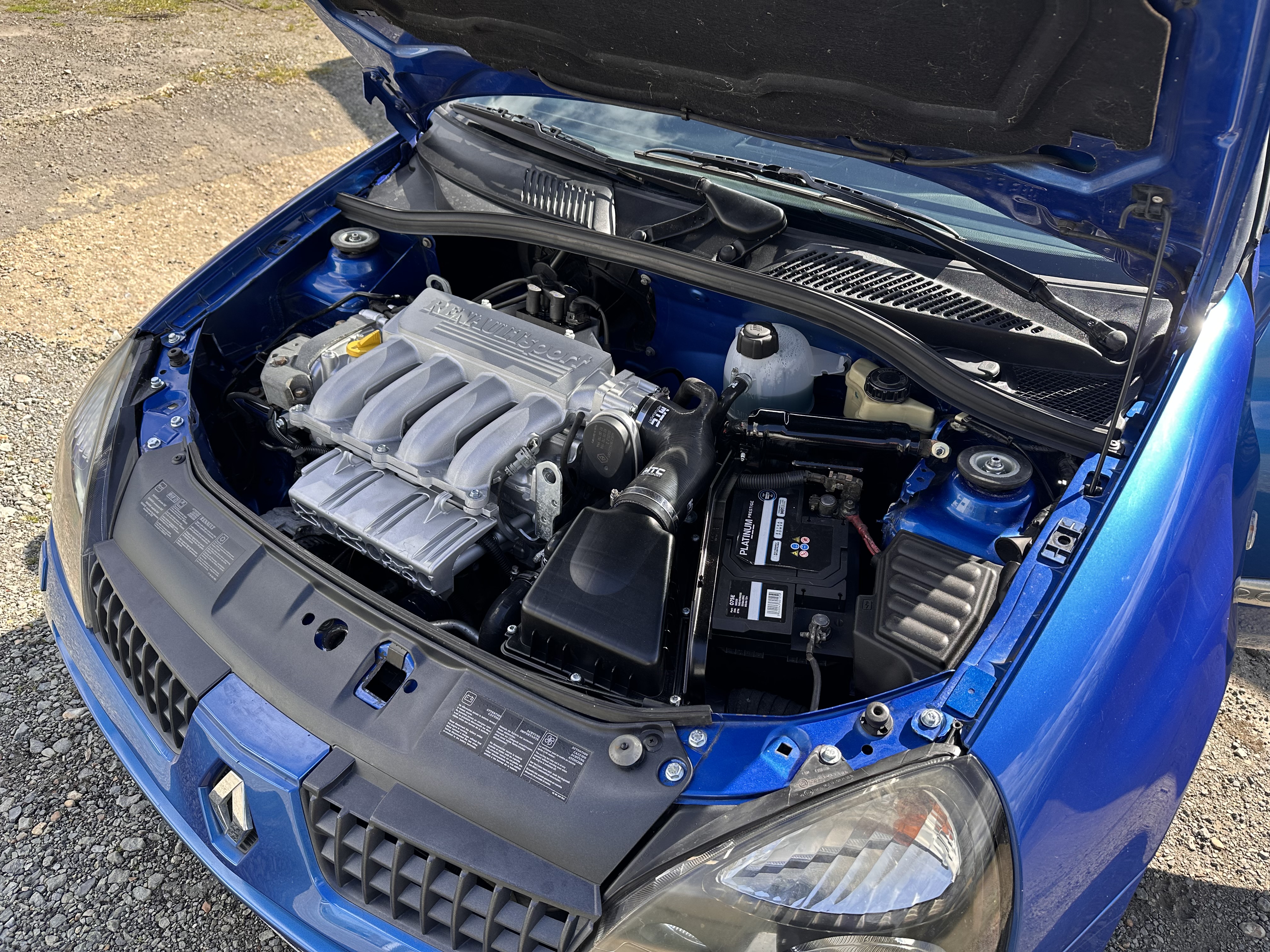

I’ll continue to add to this over the next few days. In the meantime, I’ve been trying to refurb the heat shields with some VHT silver. One done so far. Sadly the rain put a stop to spraying.

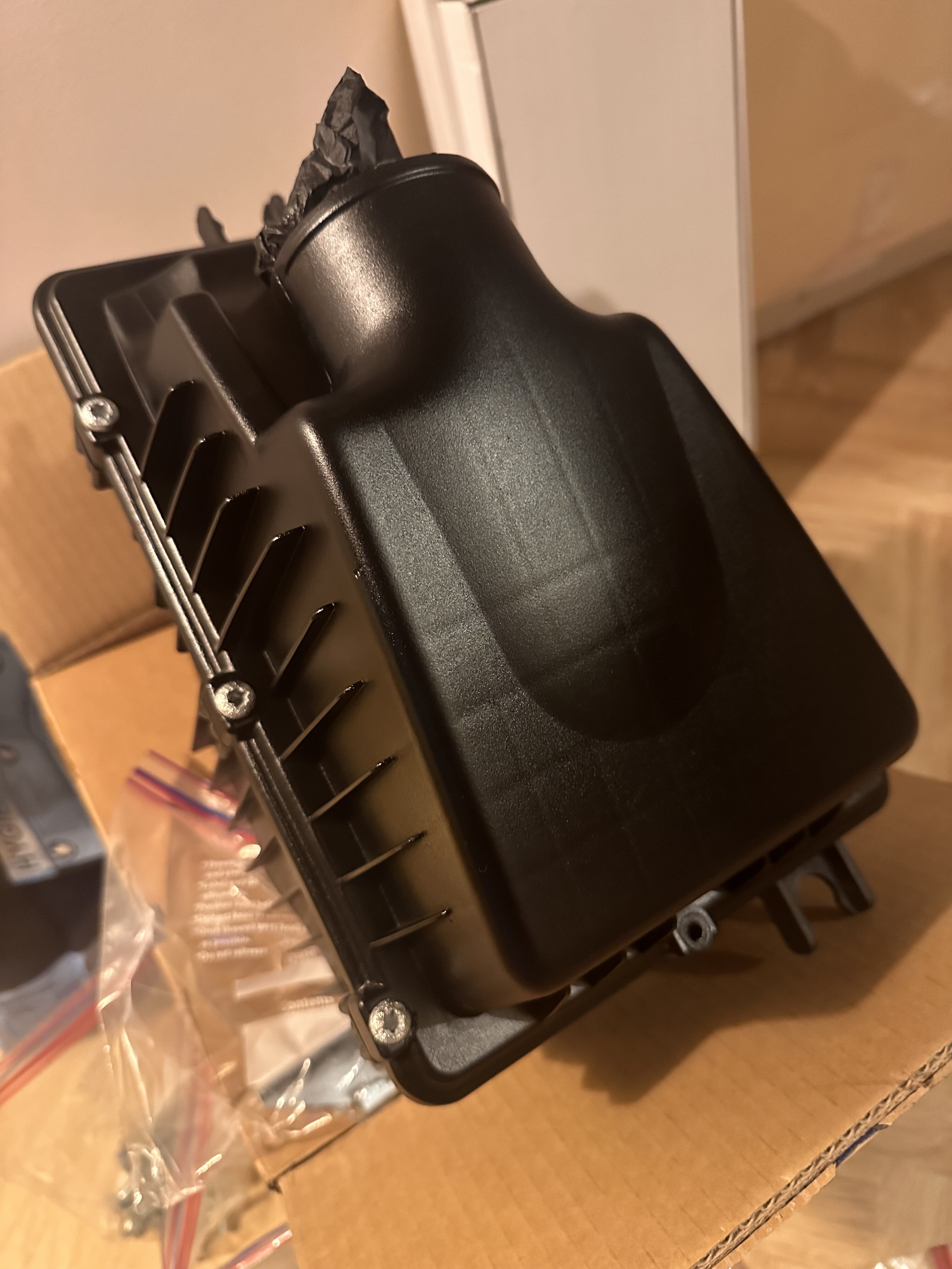

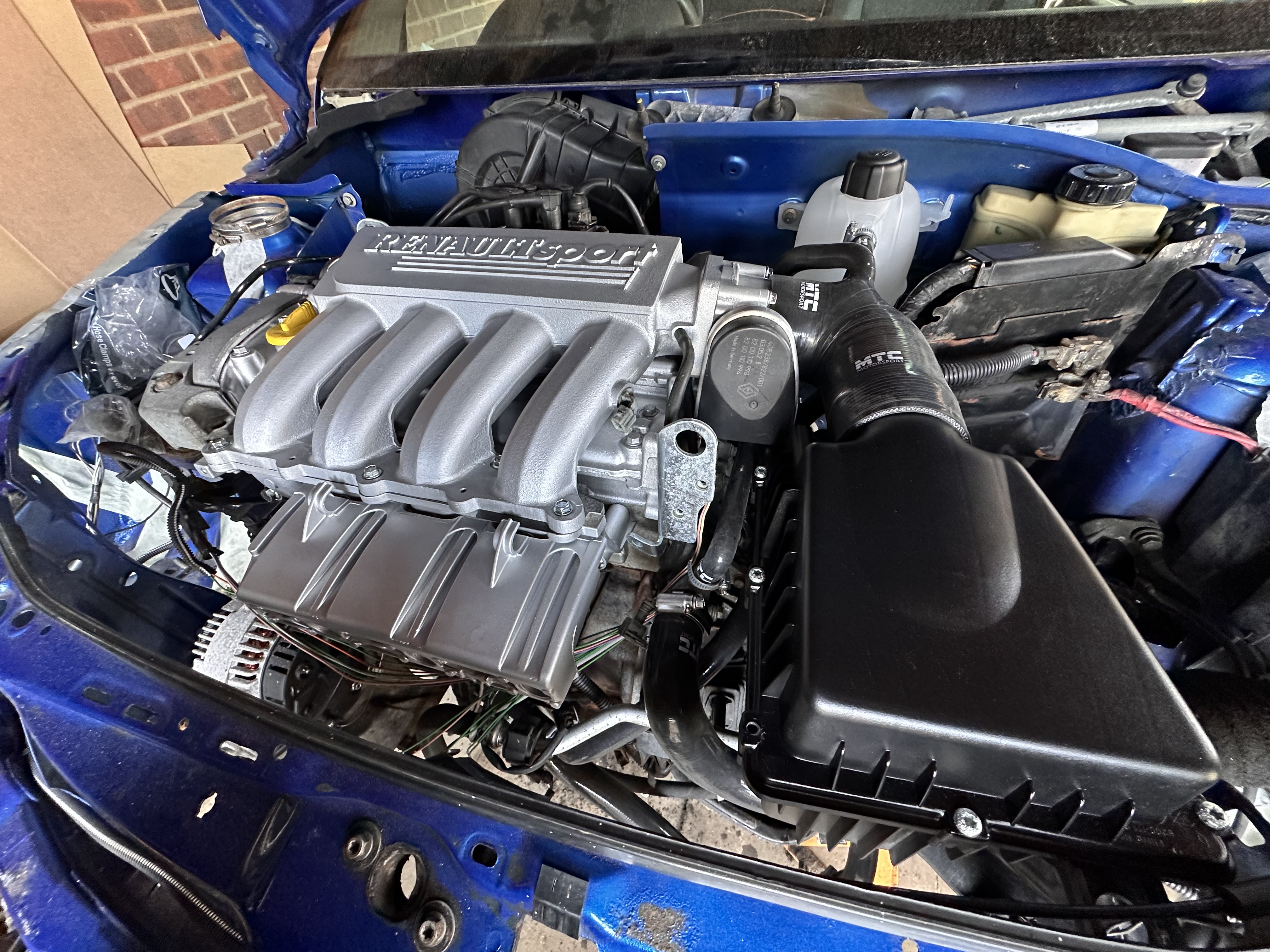

Manifolds, inlets and airbox looking decent too. Have had them sprayed by a friend who is helping me with the build. I was tempted by an induction kit, but would rather have exhaust noise over the rather loud induction noise an open cone filter creates.

Incredible work Chris! this is going to be a minter.
The heat shield, inlets, fuel guard and airbox look superb. Did you get the throttle body sprayed the same as the inlets?
cjgower
Thanks Colin, I really hope so. It's starting to get pretty expensive :ROFLMAO:.
Yes, we've done the throttle body too, just on the main housing. Probably the most fiddly of the bunch with all the masking

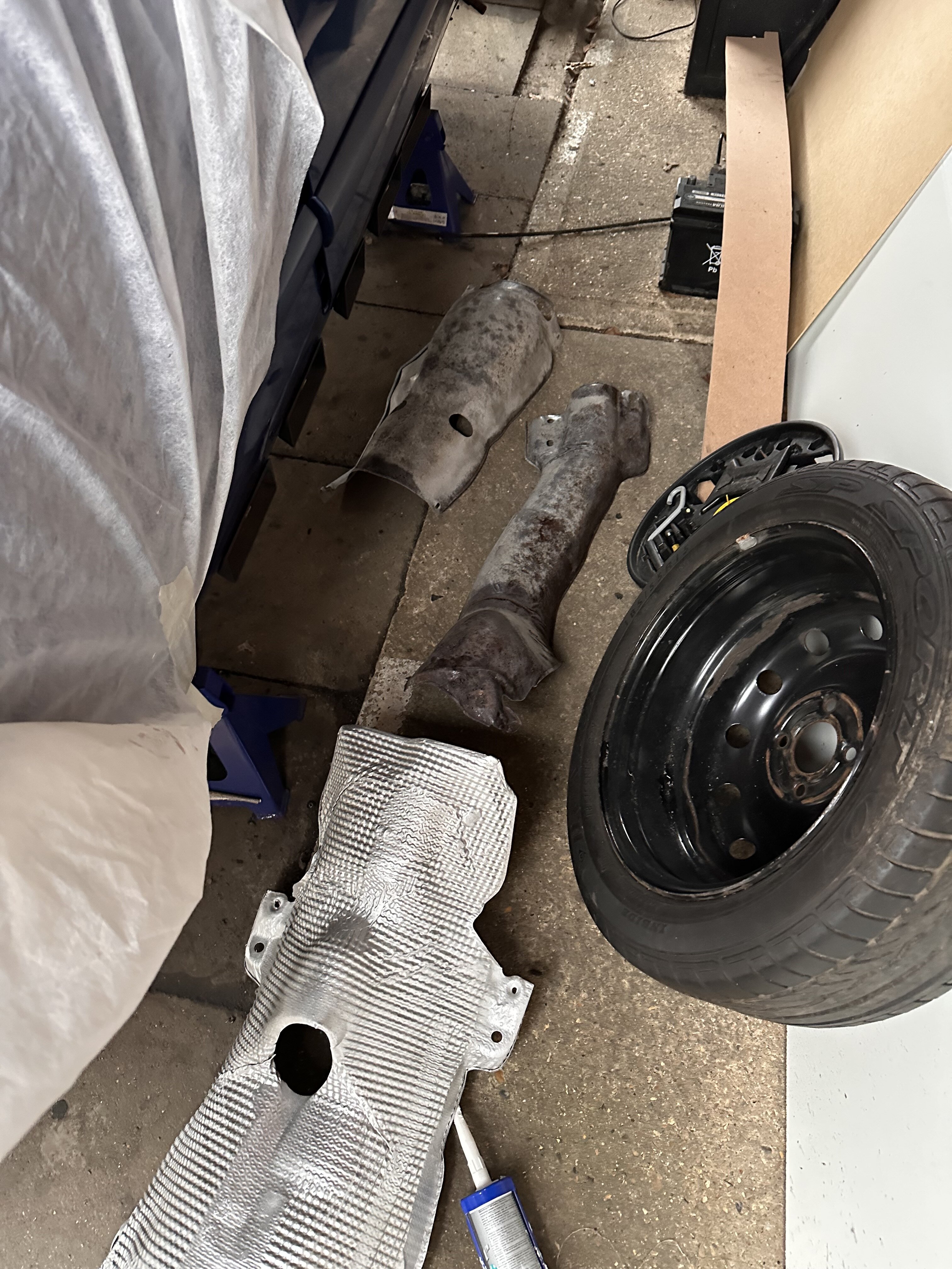

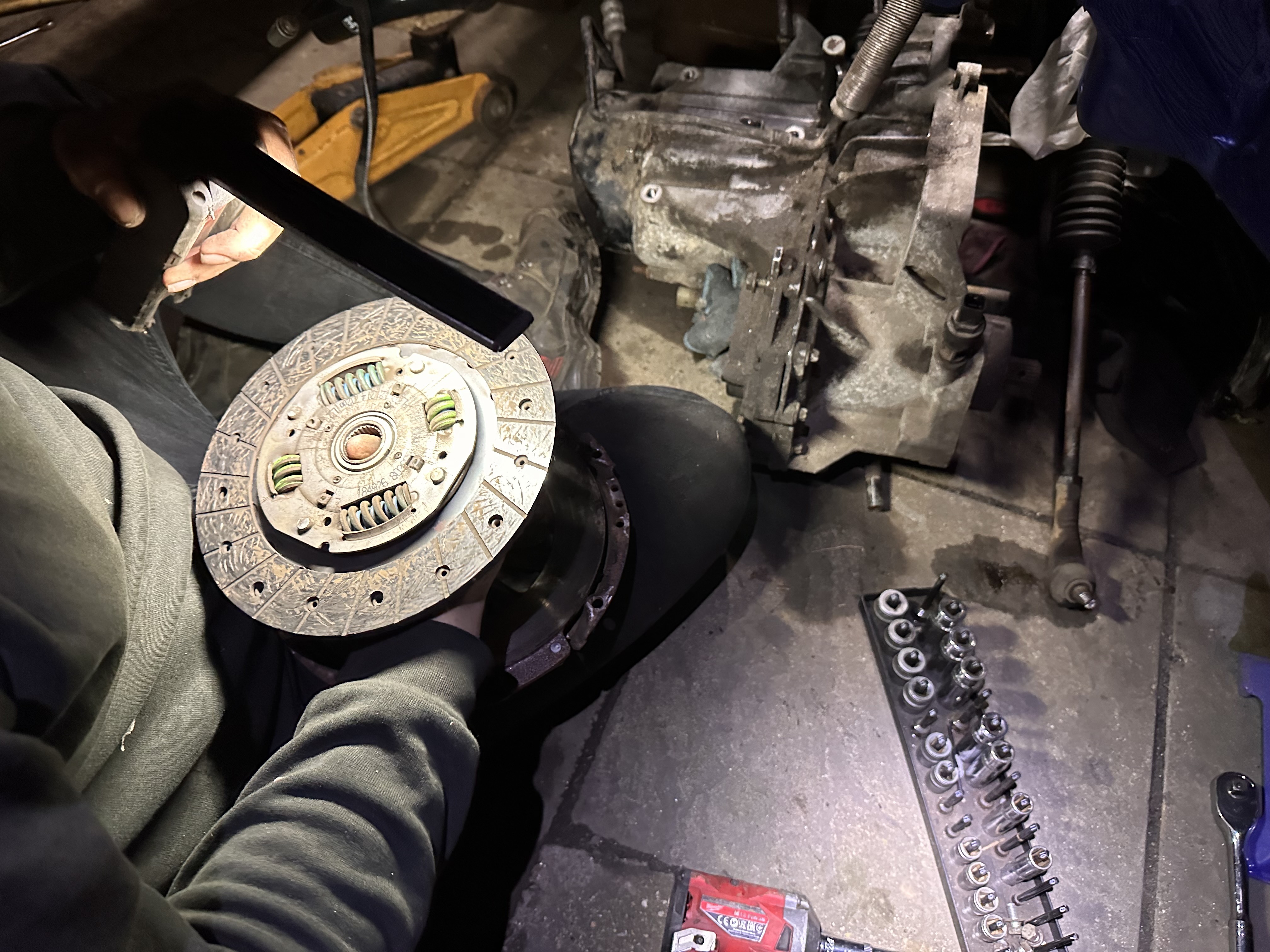

Slow progress with the poor weather at the moment. Took the box out last night in order to fit a new clutch, just because it’s easier to do now than later.
Turns out it was ok. Never mind. It can be a spare 🤣.

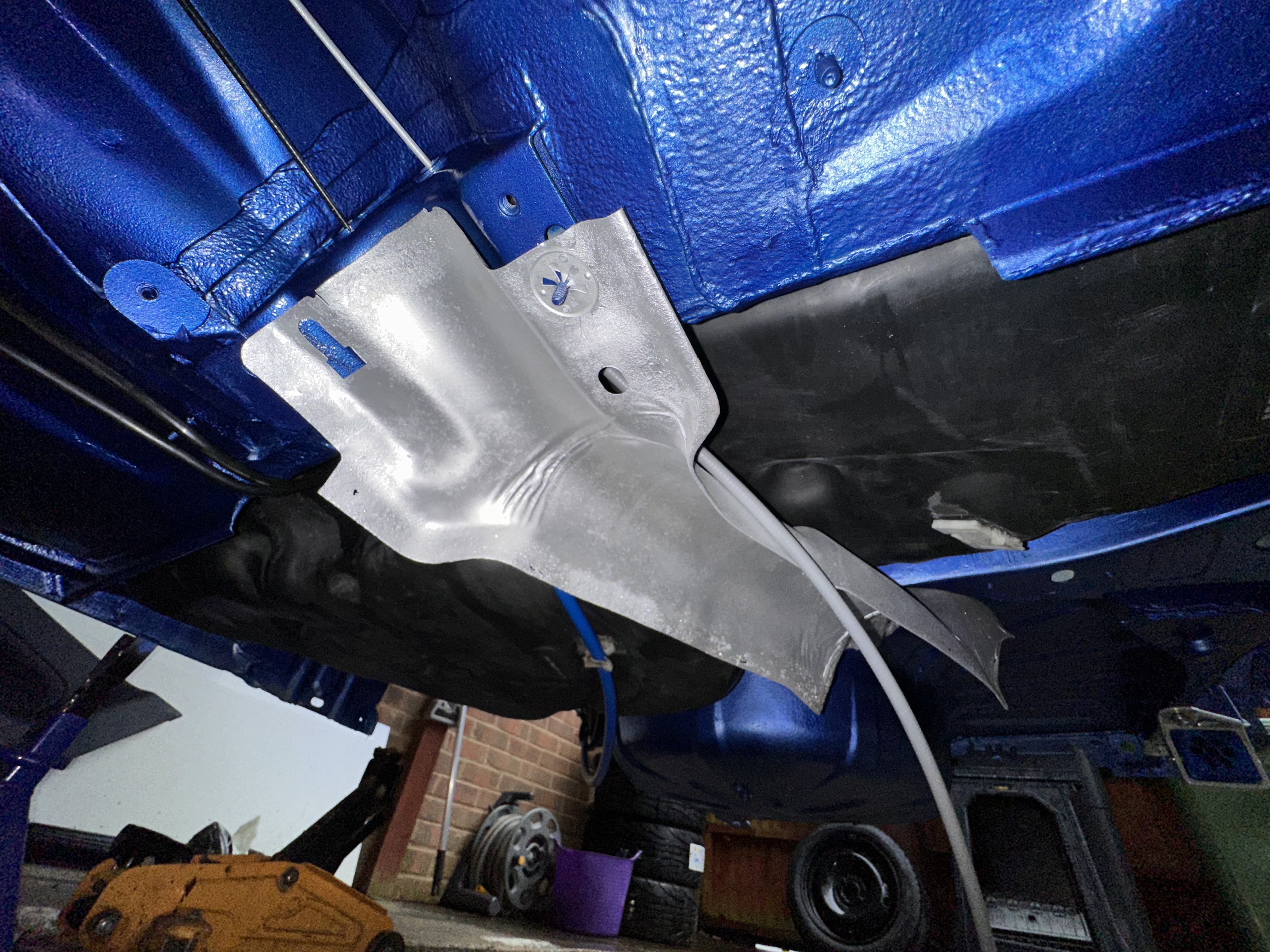

Also sprayed up the underside with stonechip. Pretty even coverage at this point so it will be on to Mondial Blue next!

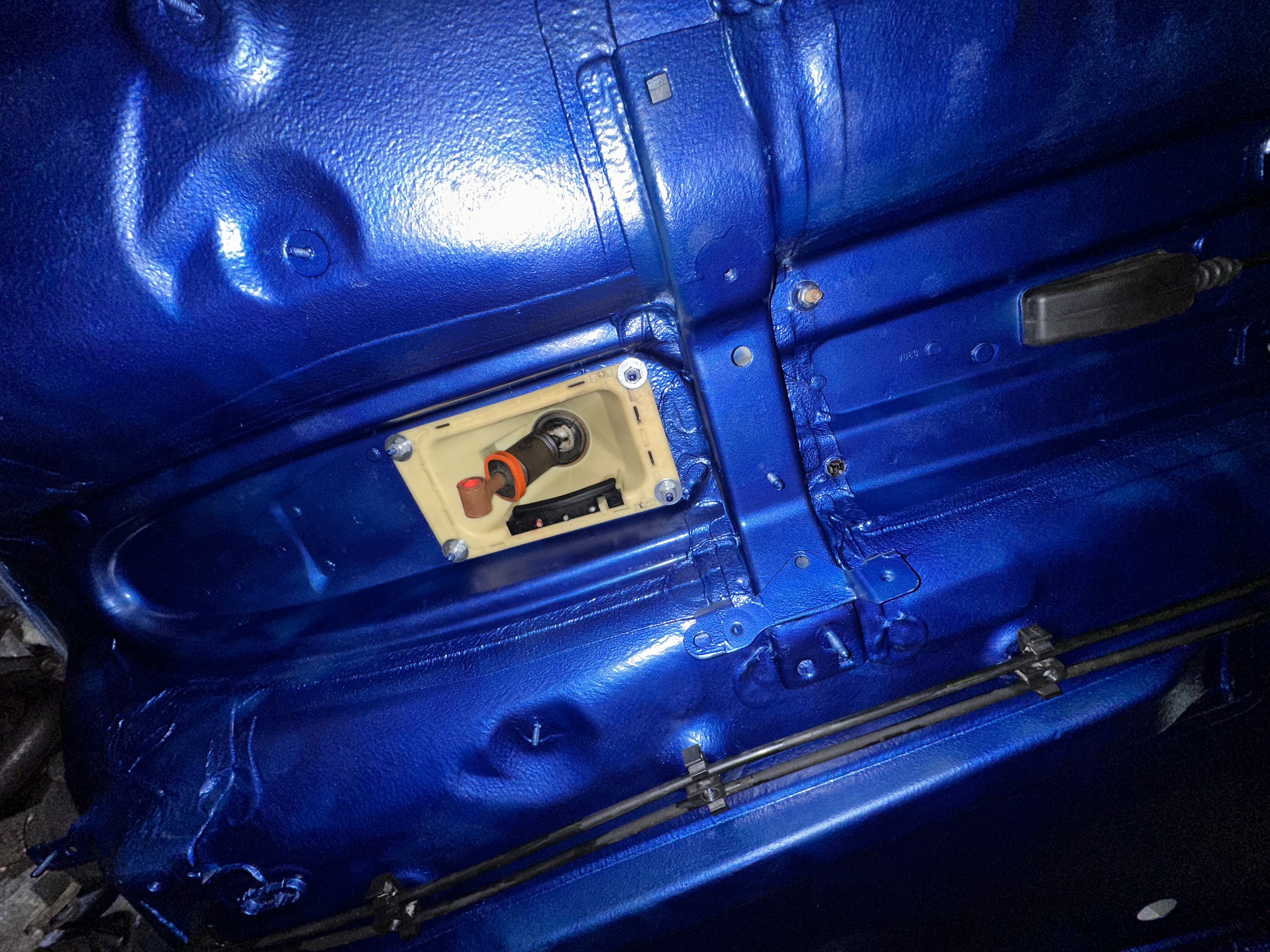

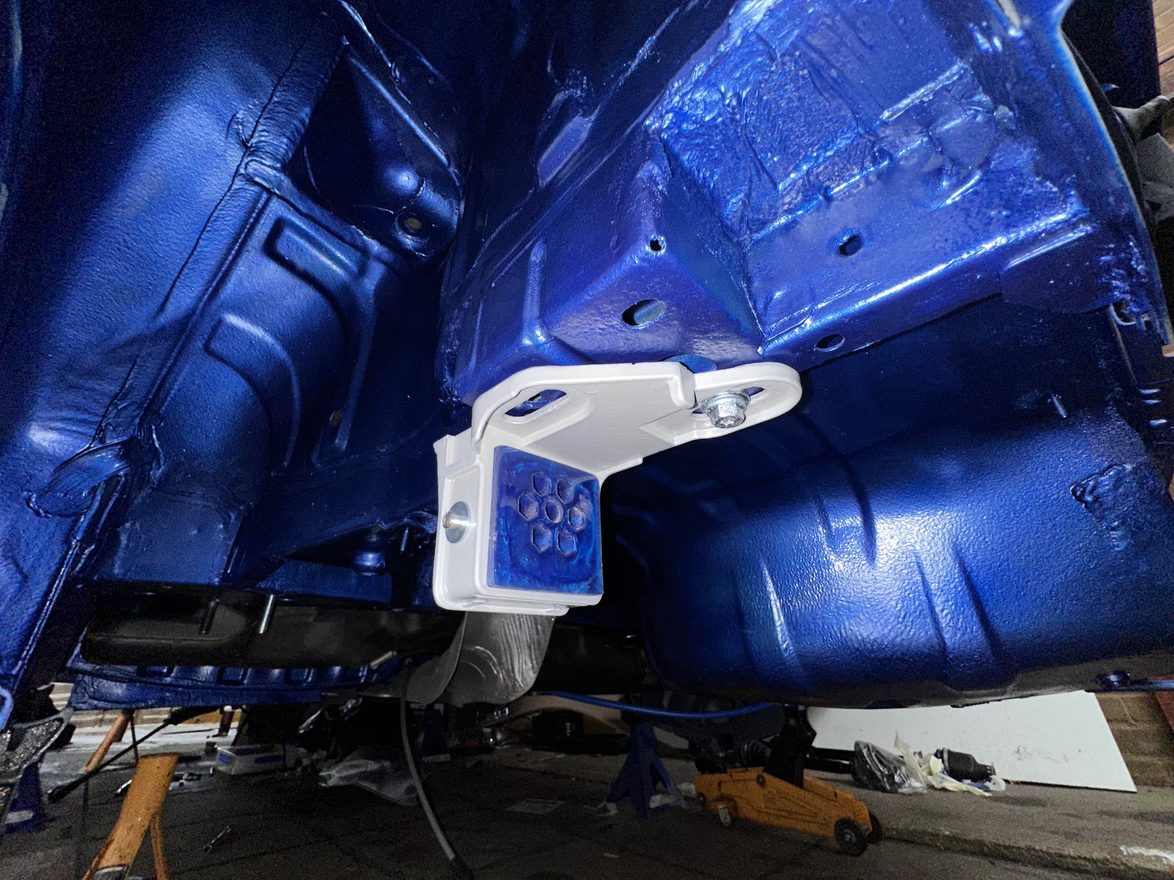

More progress on the car, but nowhere near as much as I’d have hoped at this stage. I wanted to get the rear beam back on, but don’t have a press for the bearings.

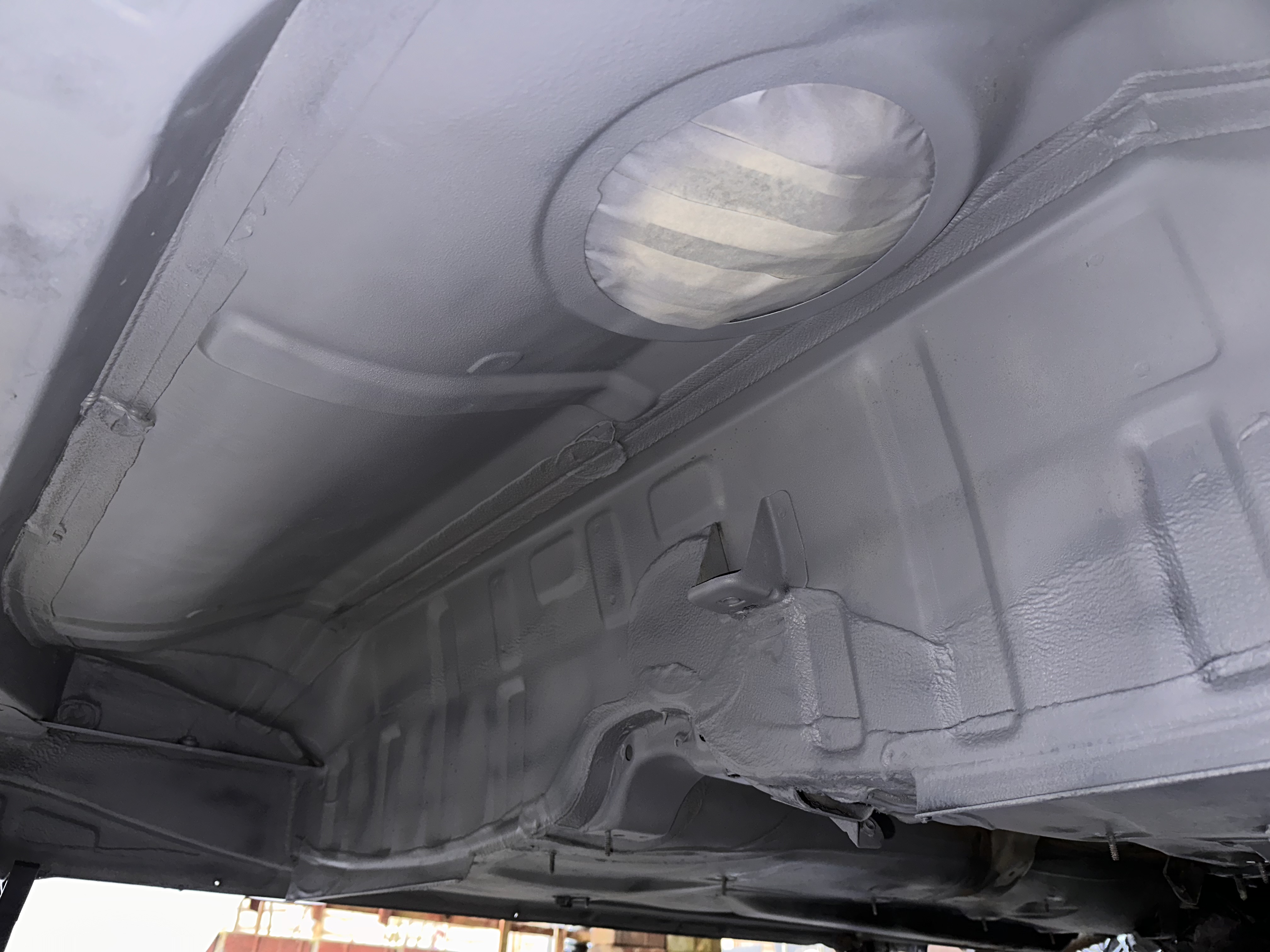

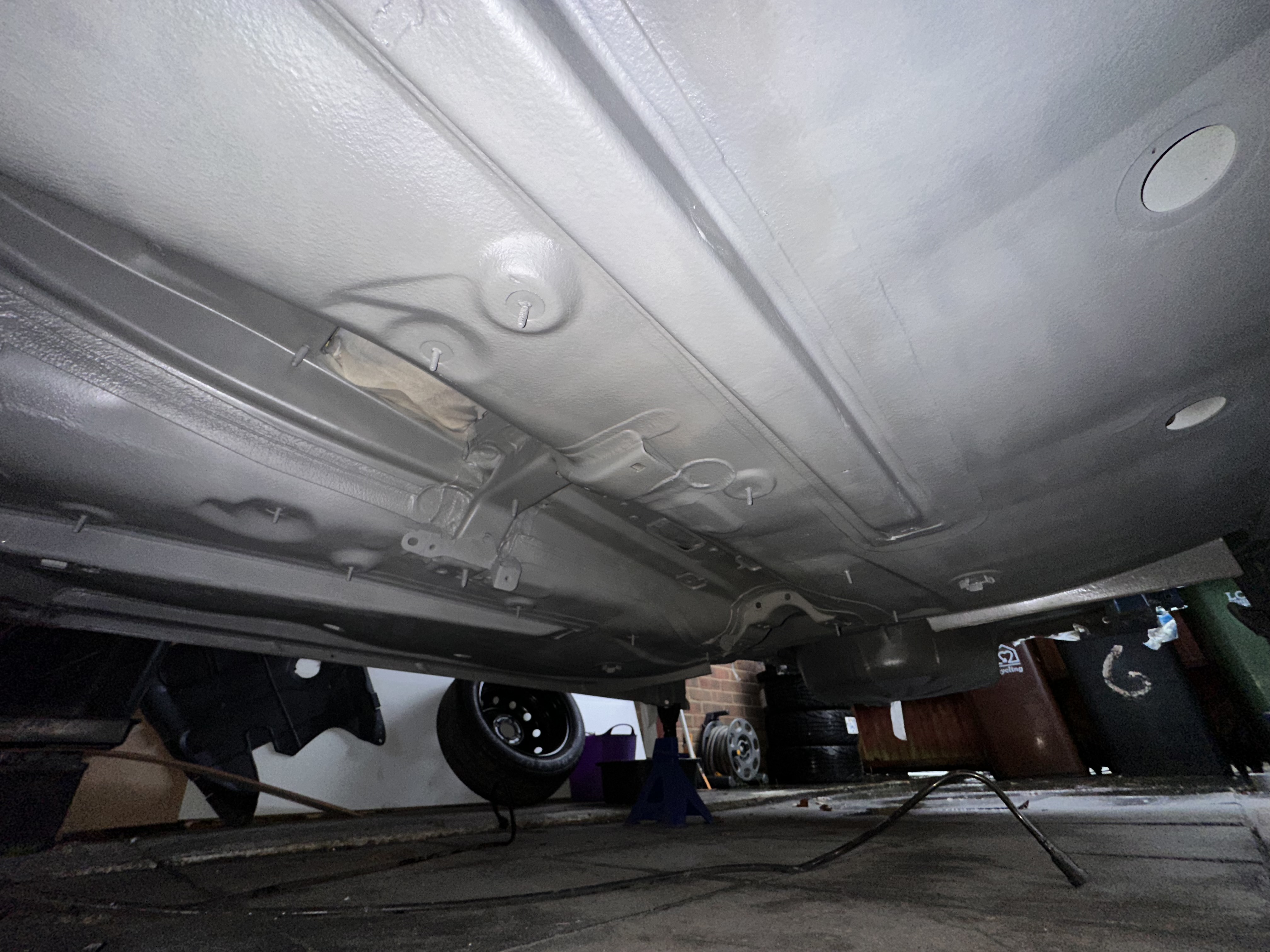

I’ve sprayed underneath and used a 2K lacquer to finish. FYI traditional 2K lacquer with a hardener that you release into the can before spraying is pretty nasty stuff. I didn’t realise. So ordered another batch of the Air Dry Converter type that doesn’t contain isocyanates.
Anyway, pics below.
Before lacquer and hardware being added.
After lacquer and adding fuel tank back

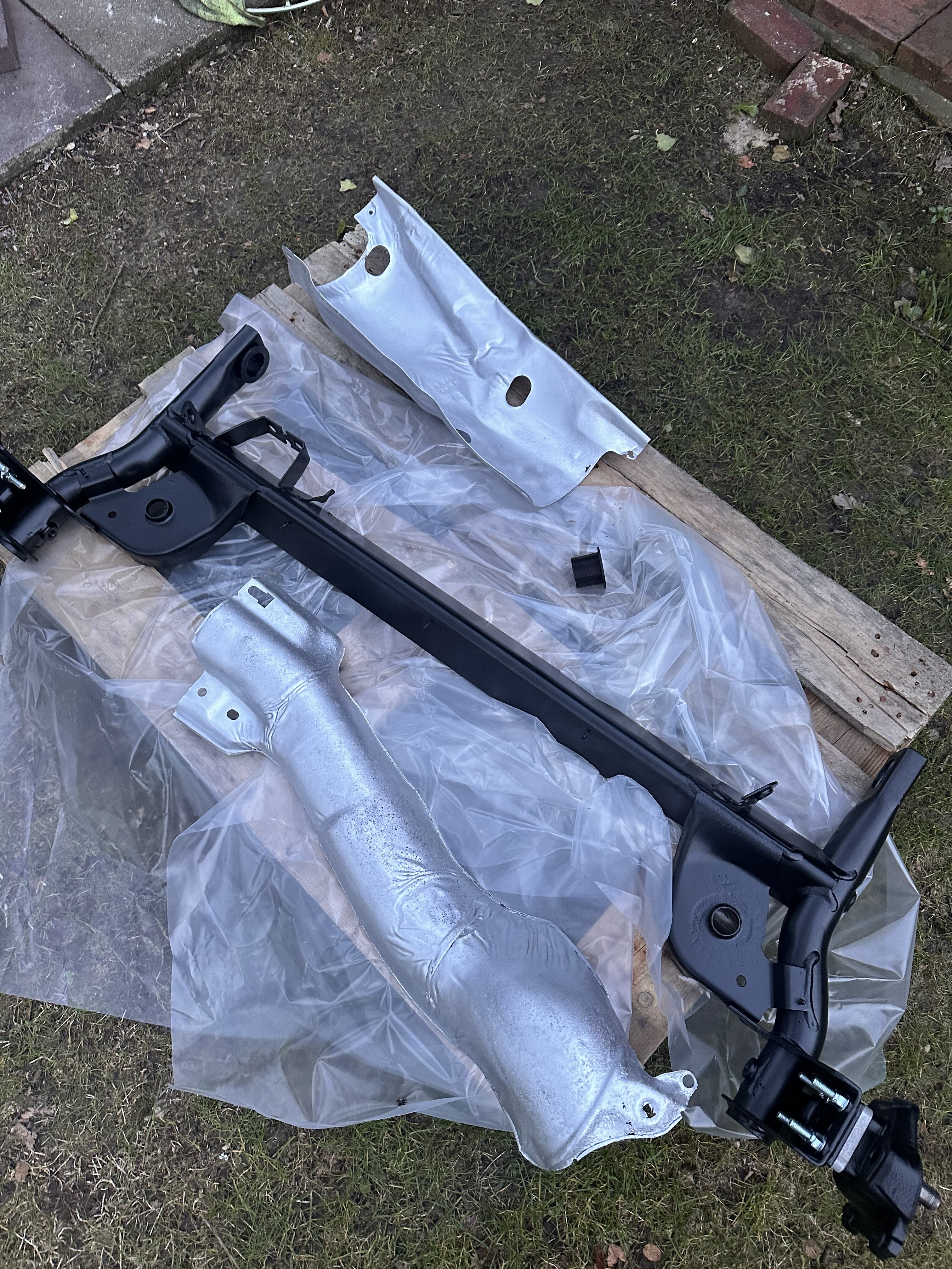

Powdercoated bits plus heatshields

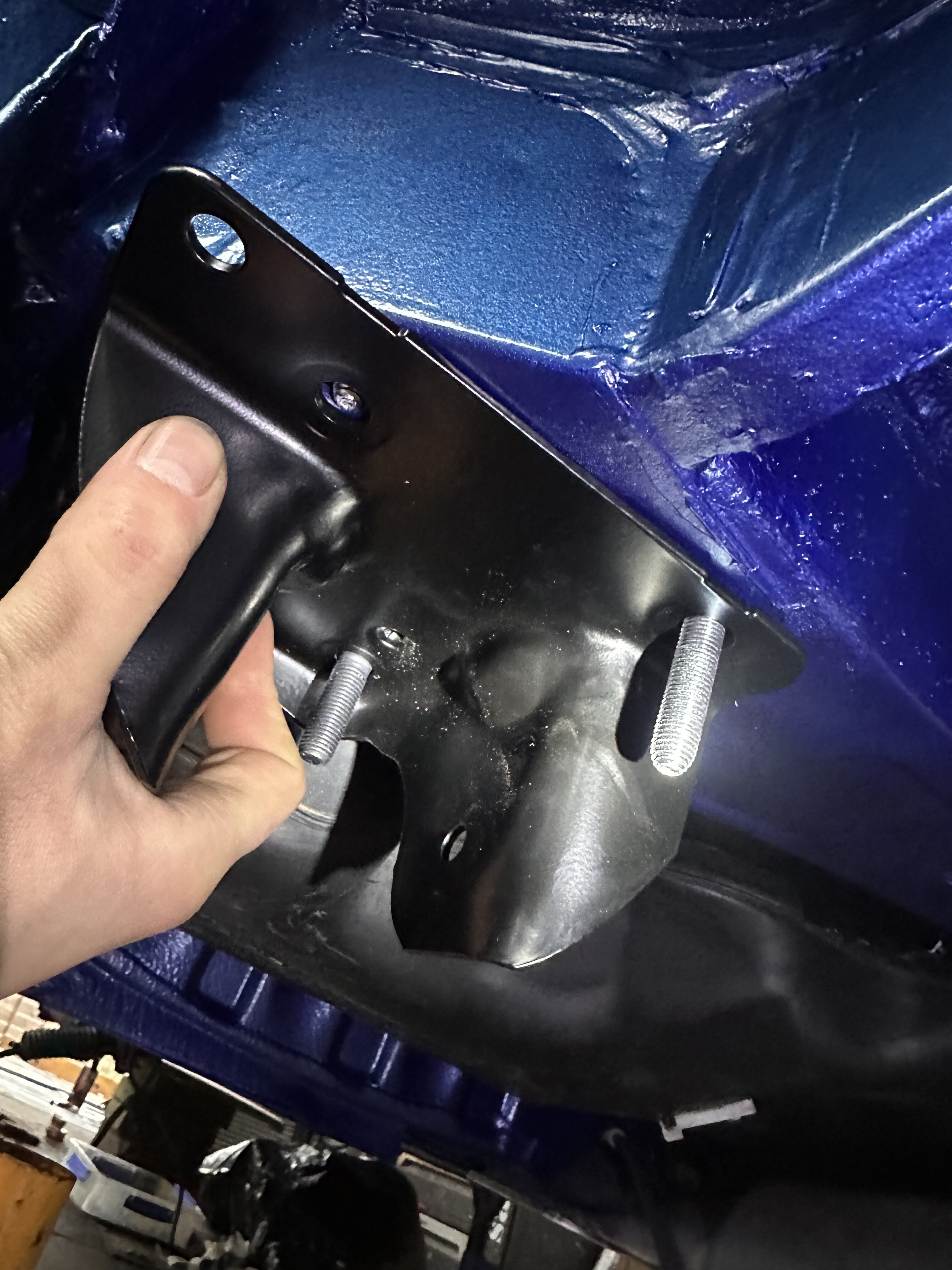

Finally, I’ve opted for some M12 10.9 high tensile bolts to hold the rear beam brackets on. Trial fitted and fortunately, they fit ok, as they are partially threaded. Looks like they will do up tight. Black are the new ones, shiny ones are the OEM.

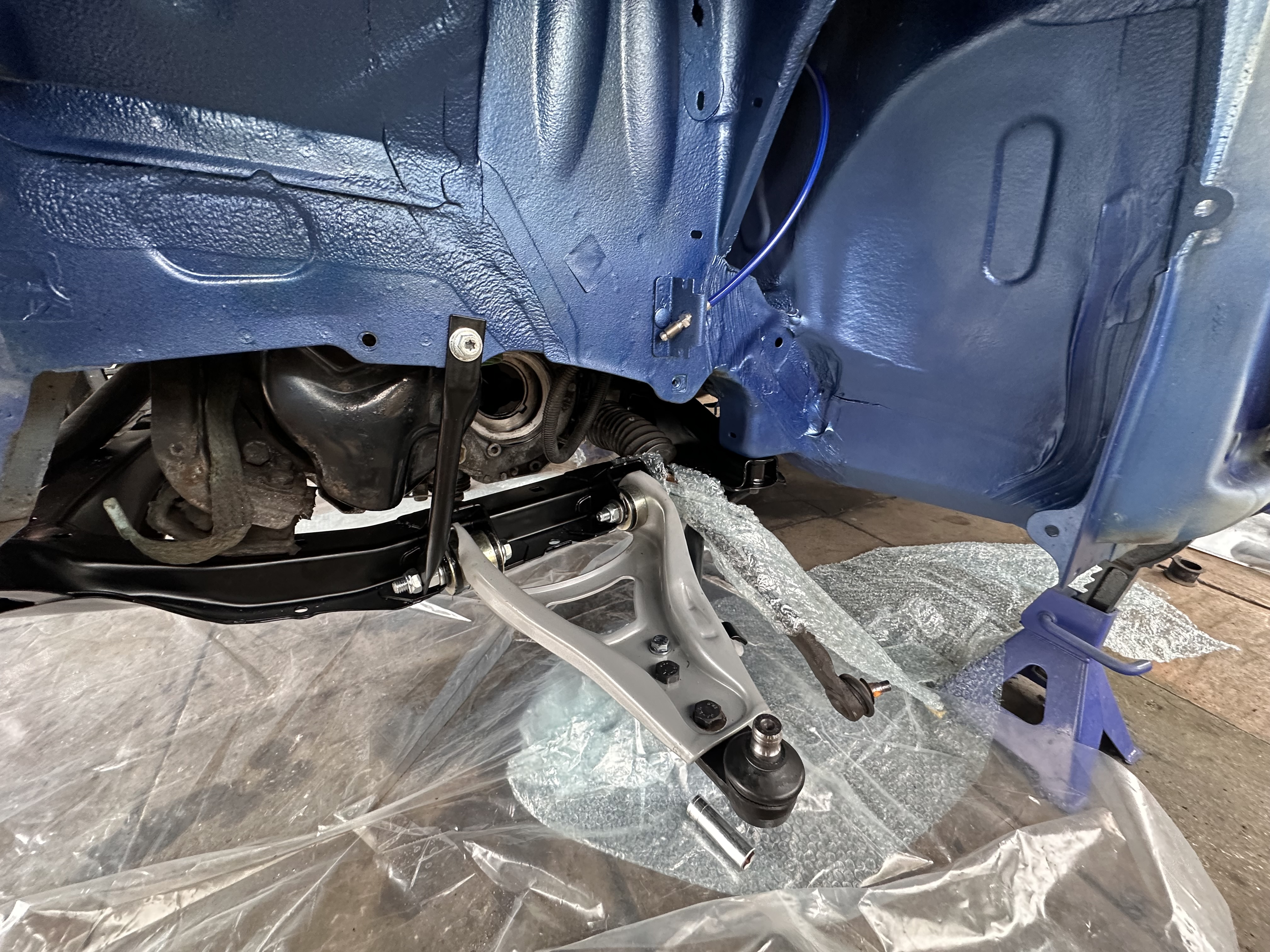

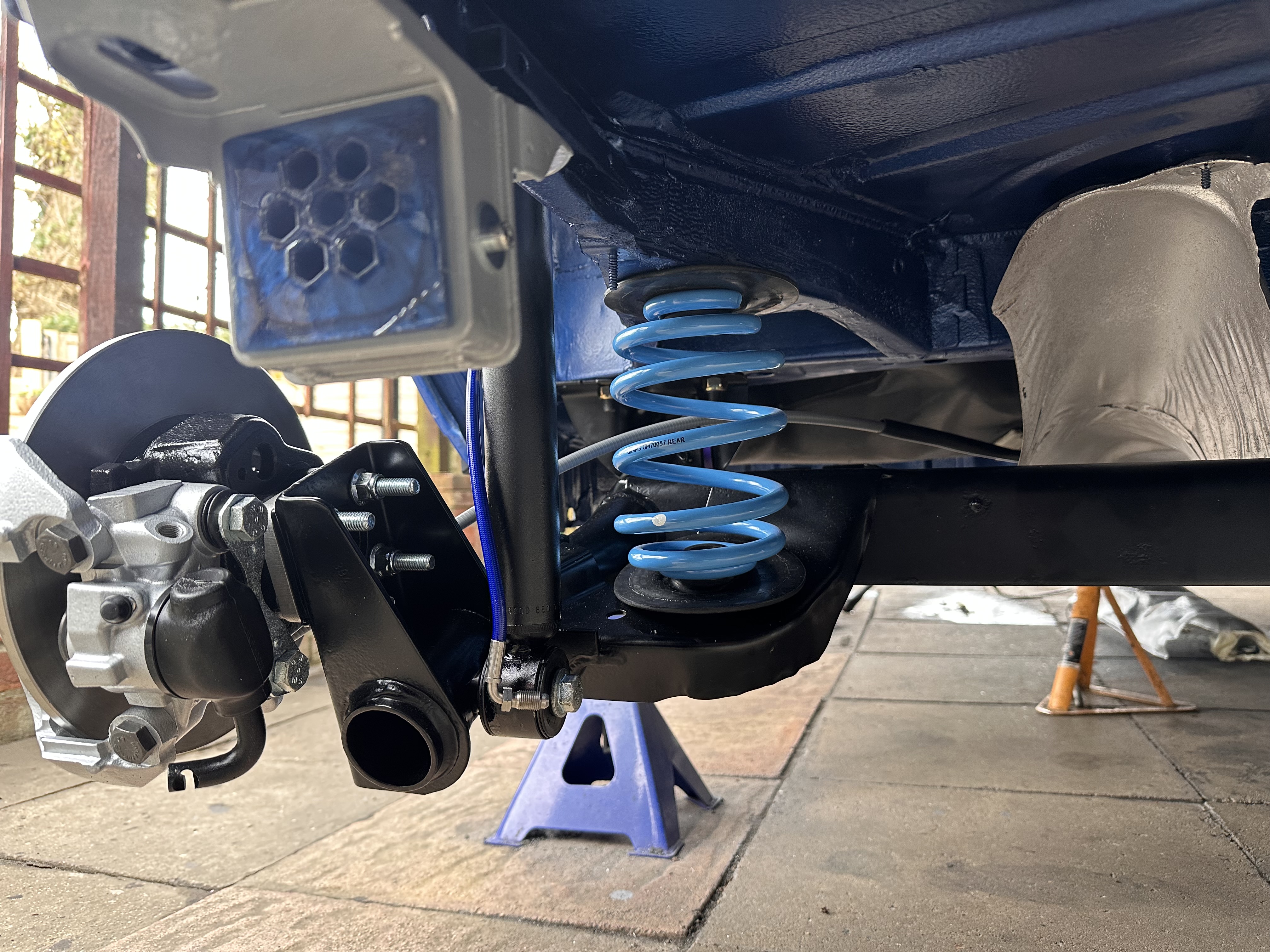

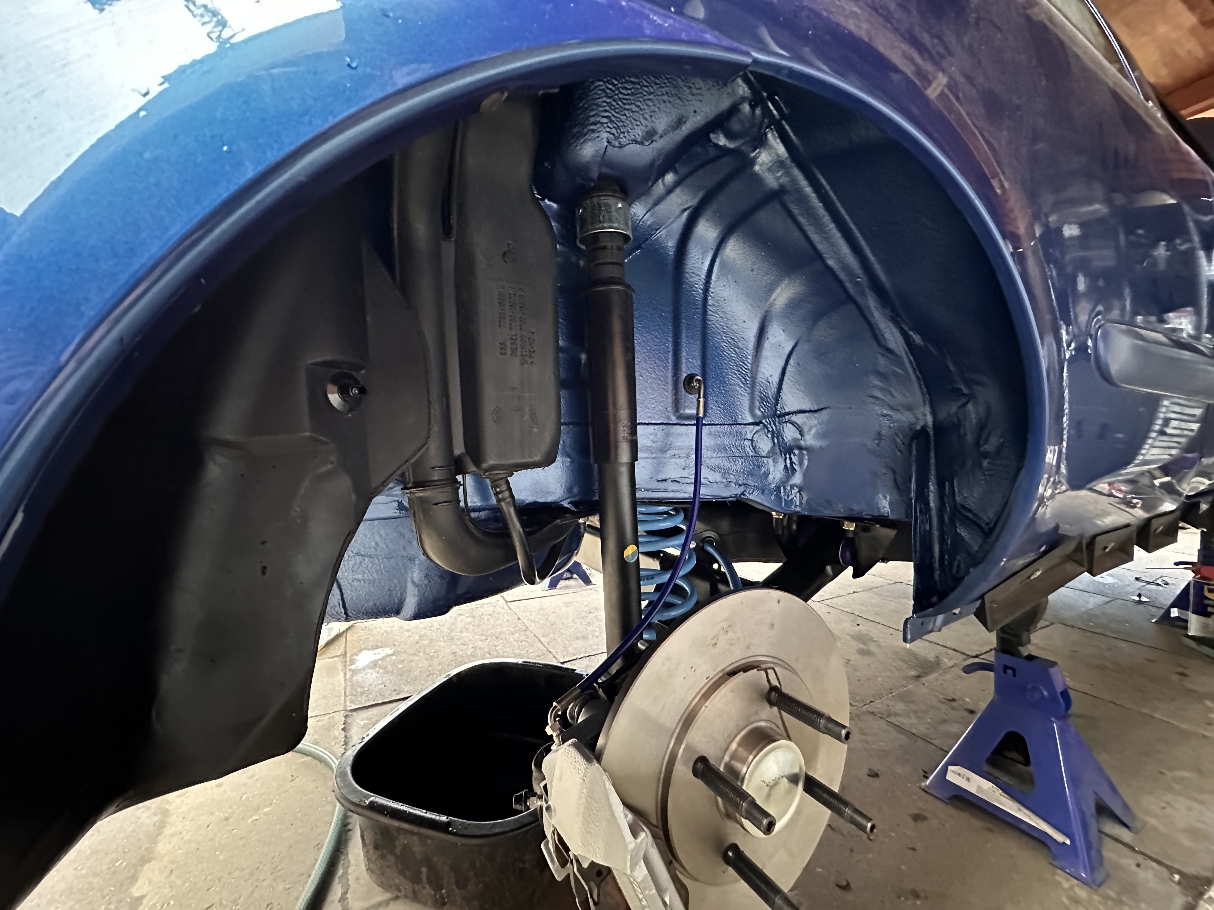

Had a late one on Thursday. With the help of a friend we managed to lift the rear beam onto the car. Had to drop the tank, then slide the bolts through the brackets. Bit of a faff.

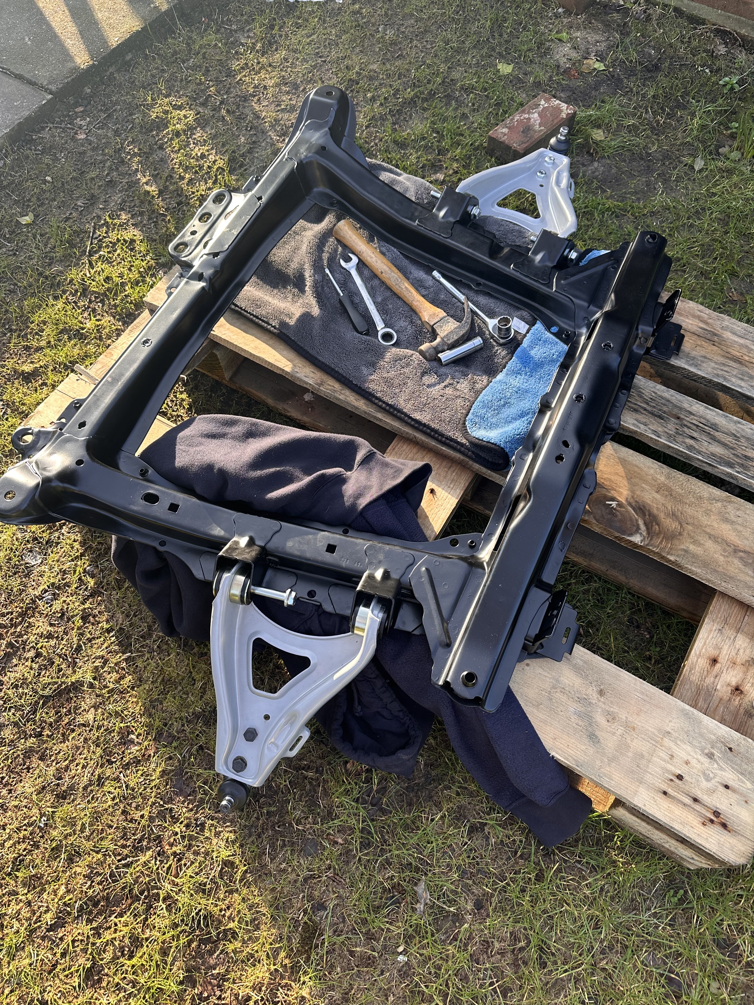

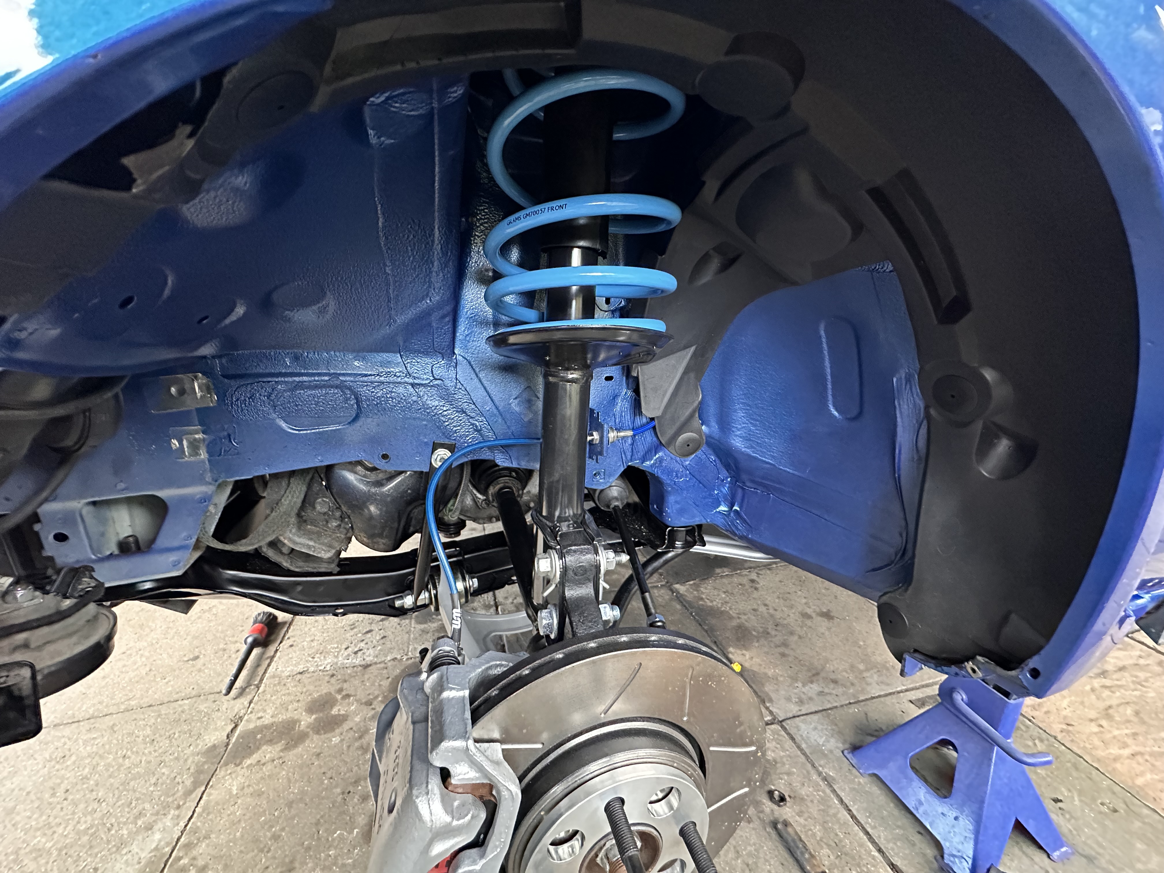

Today, I rebuilt the front subframe. Absolute pain getting these bearings in to the wishbones. We got there in the end with a press kit. Doing my best not to mash up the powdercoat.

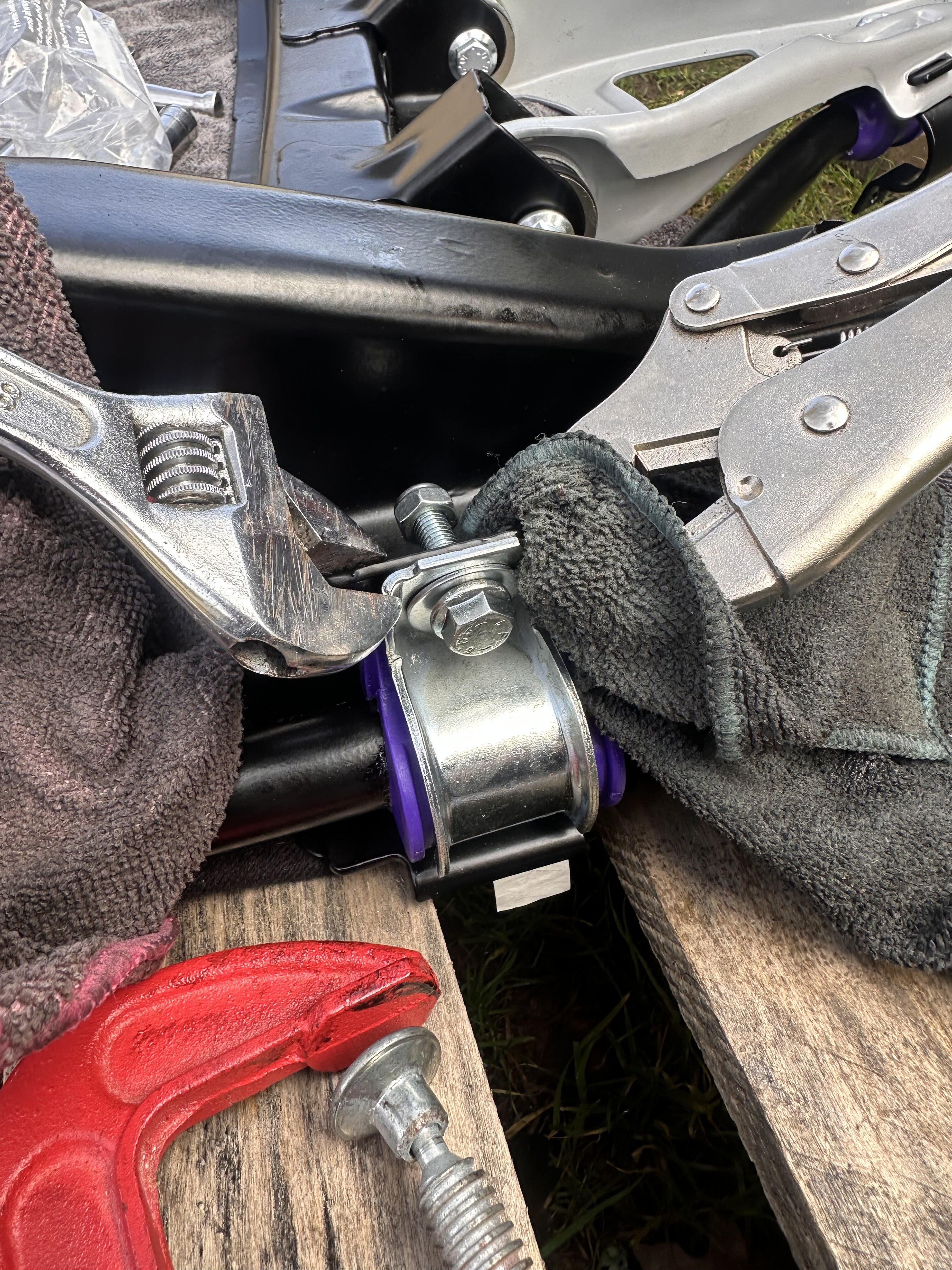

Anti roll bar has been powdercoated. Getting into place was tricky. I found a combo of G clamp, mole grip and bolt worked (basically, whatever I could get a hold of)
Better photos of the rear during the day.
The handbrake cable doesn’t pass through on the rear beam for some reason on the passenger side, so I am going to pop it off the actual handbrake and try and pass it through the other way.
Managed to lift the subframe in first without the supports, then slowly tighten each corner. I’ve used aftermarket bolts and not the stupid OEM design with the cages on the nuts. Getting them in was a lot easier than getting them out!!
And that’s about it for today. Tomorrow I’ll get the supports in, the hubs on and the shocks. Still plenty to do on the engine bay side too.

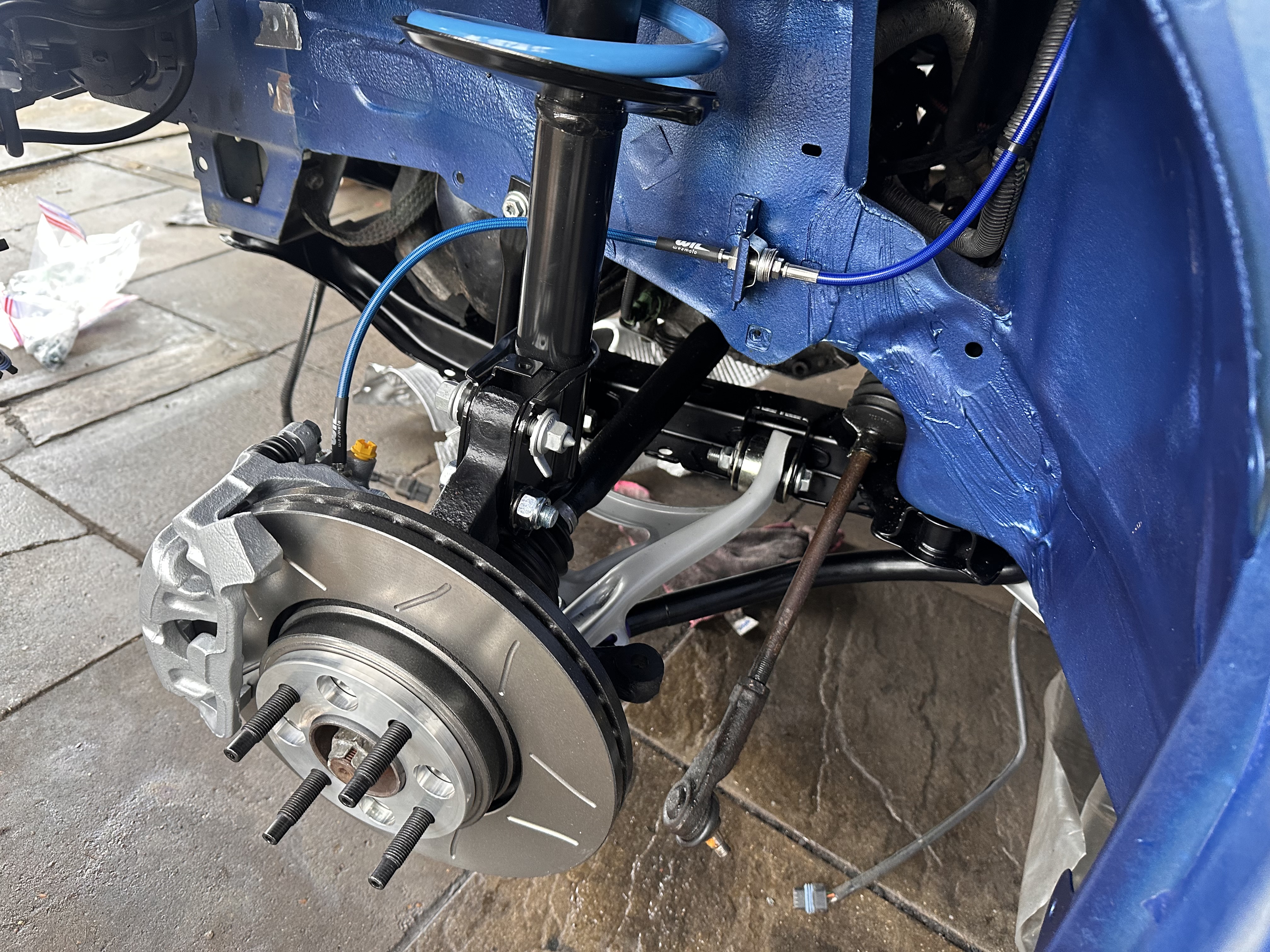

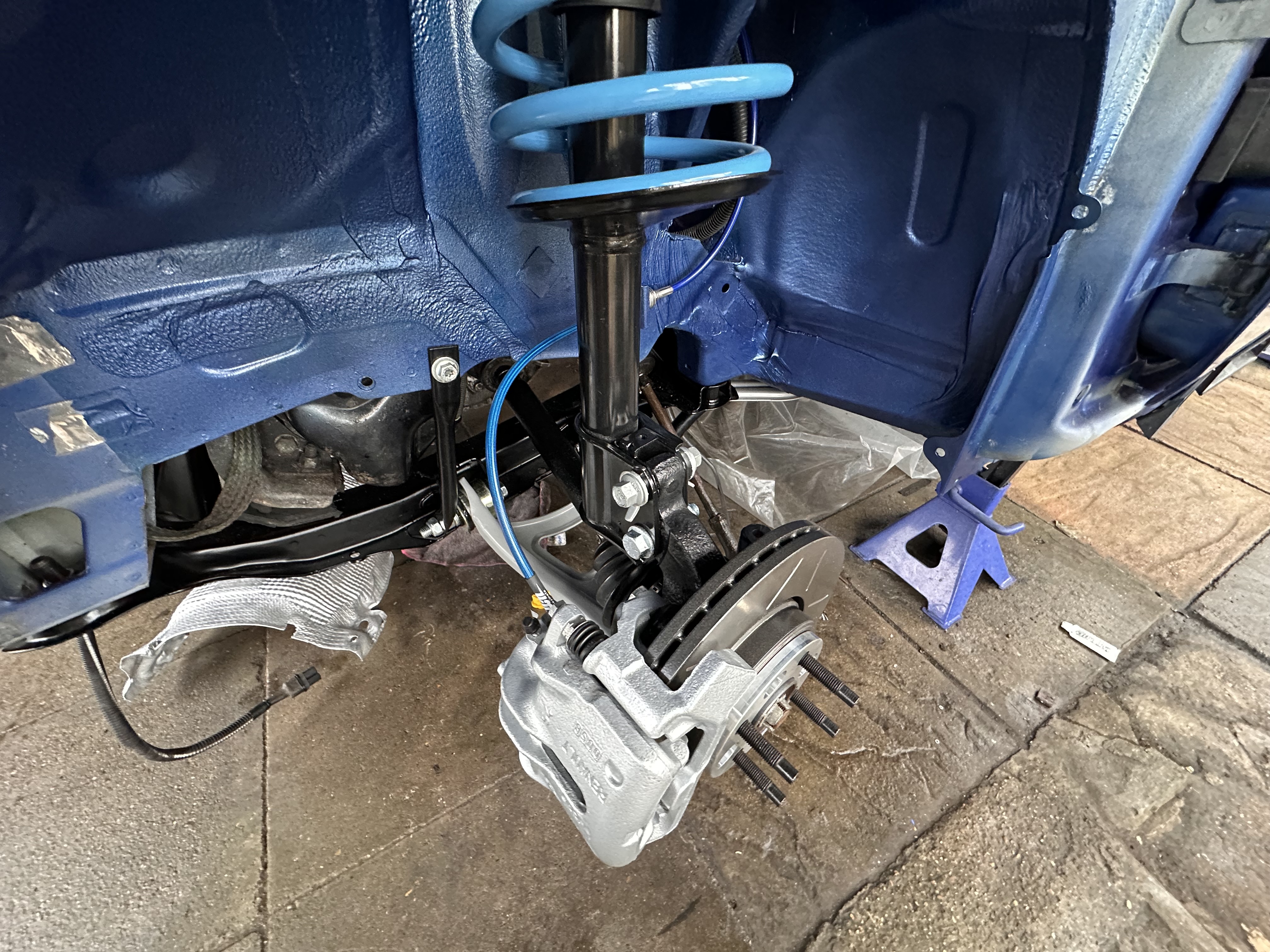

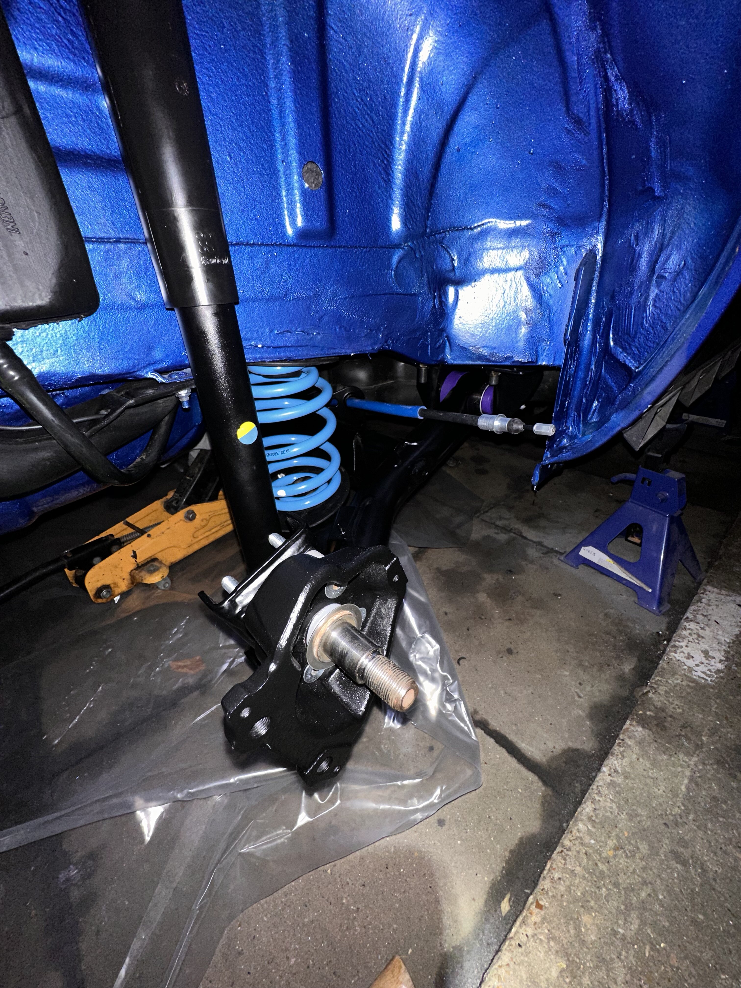

More photos. Had a successful day overall, even with the rubbish weather. Main hurdle to overcome currently is getting the car into gear.
First discovered the issue after trying to tighten the drive shafts to the hubs. Clutch seems to engage/disengage ok. Just won’t quite pop into gear. Might be the linkage that I need to adjust perhaps.
Any ideas appreciated!
Just the pads to go in now.
I’ve got new linkages and track rod ends to go in too, just not the tools at the minute to replace them.

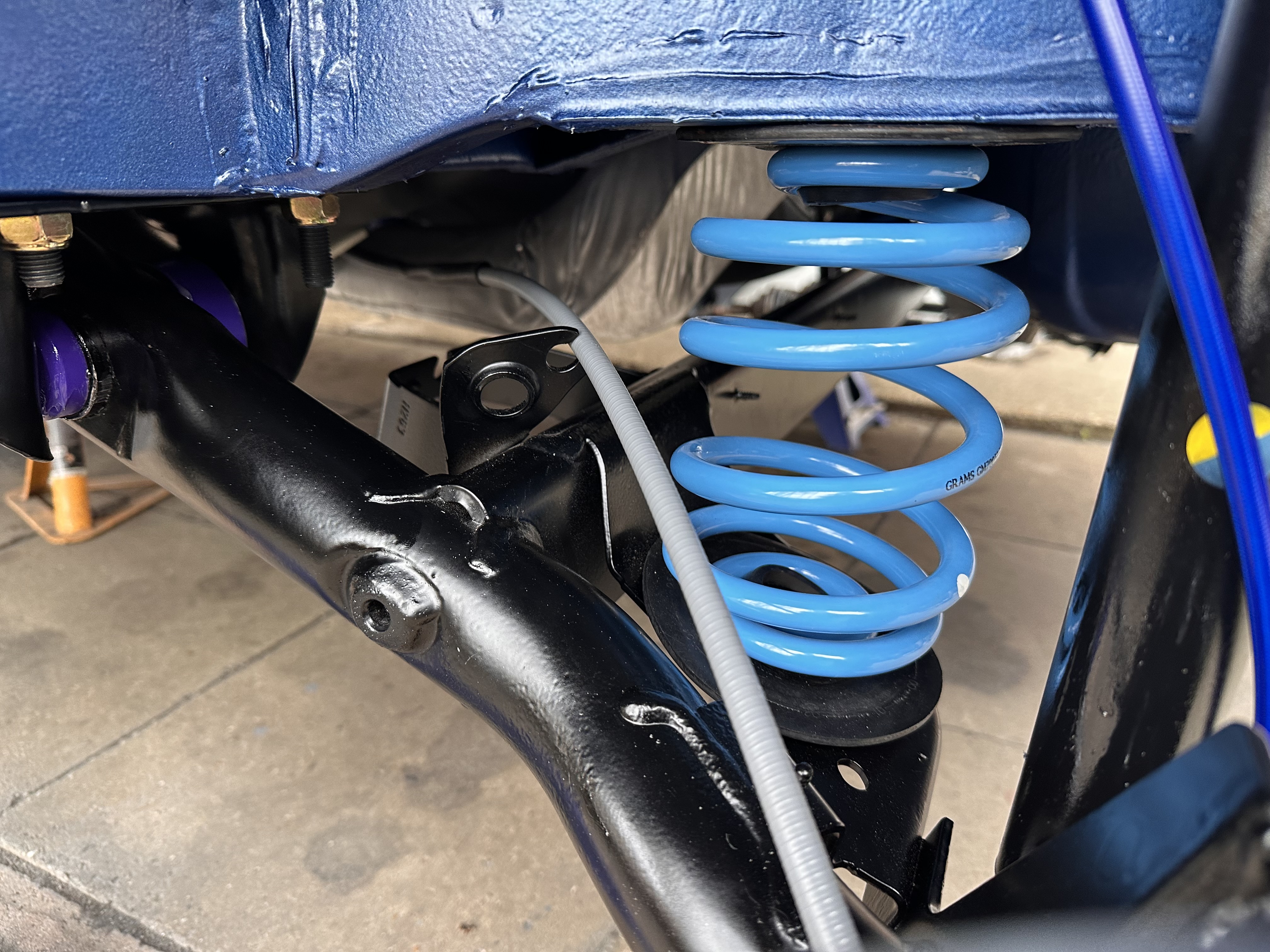

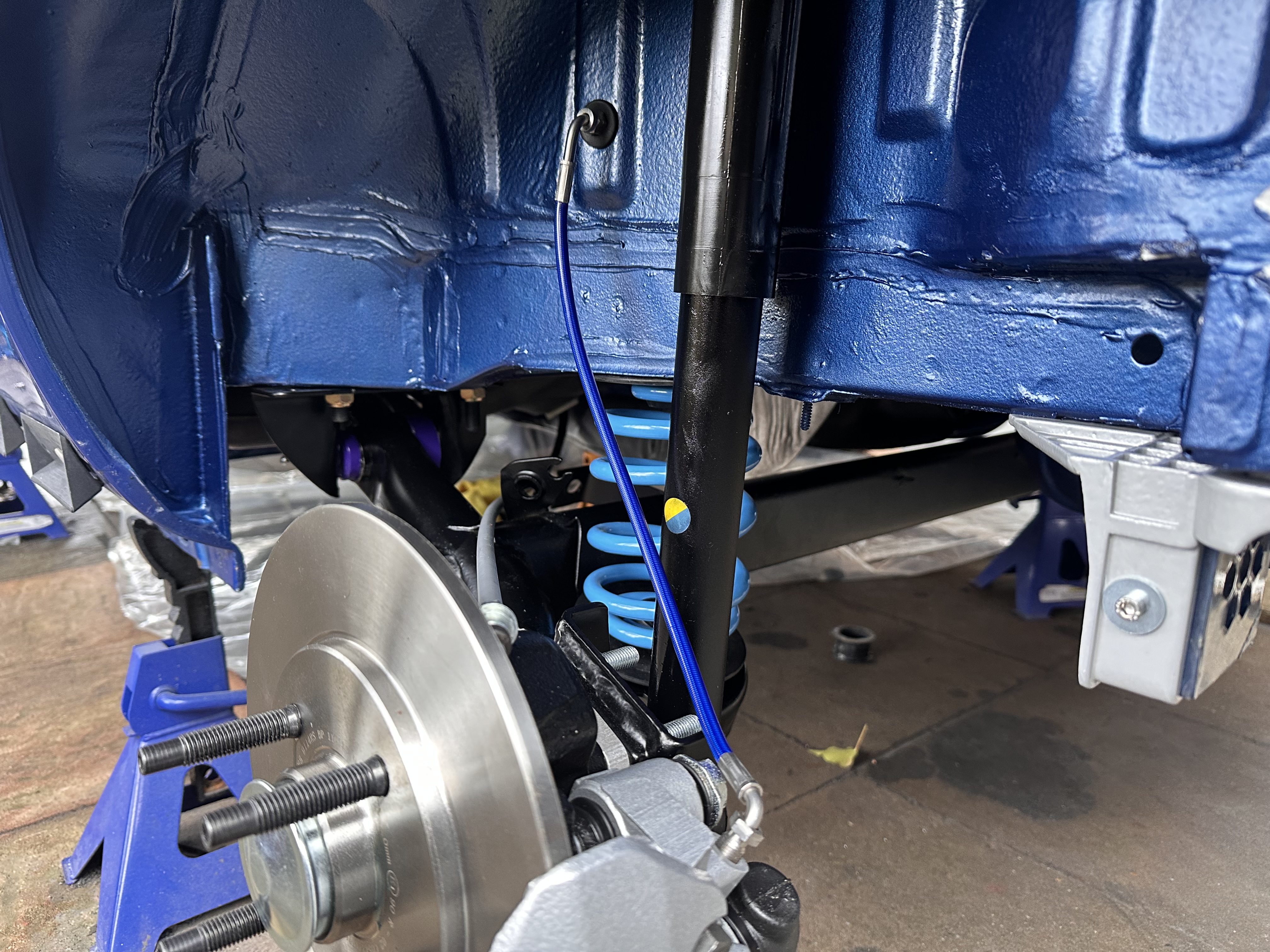

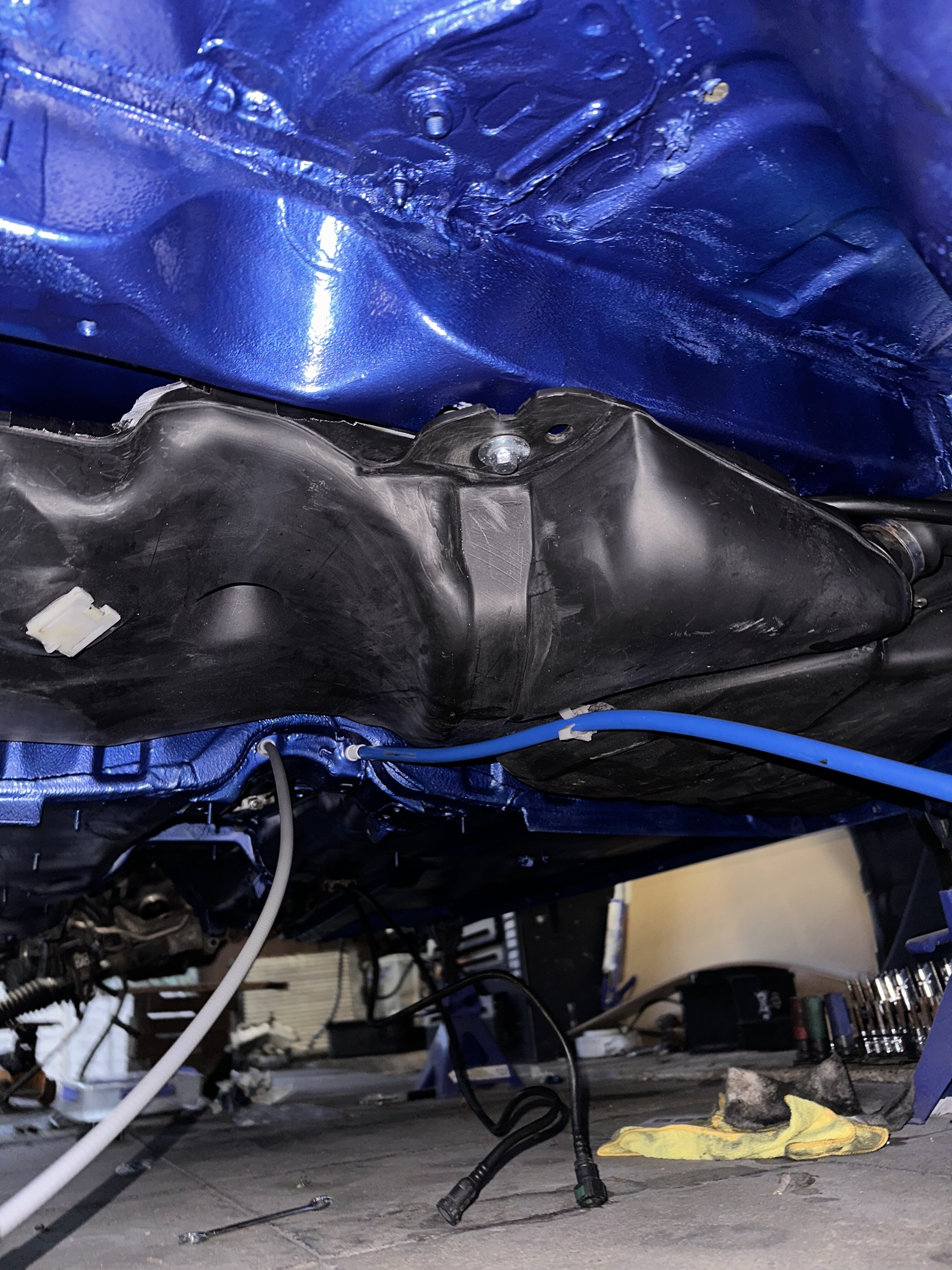

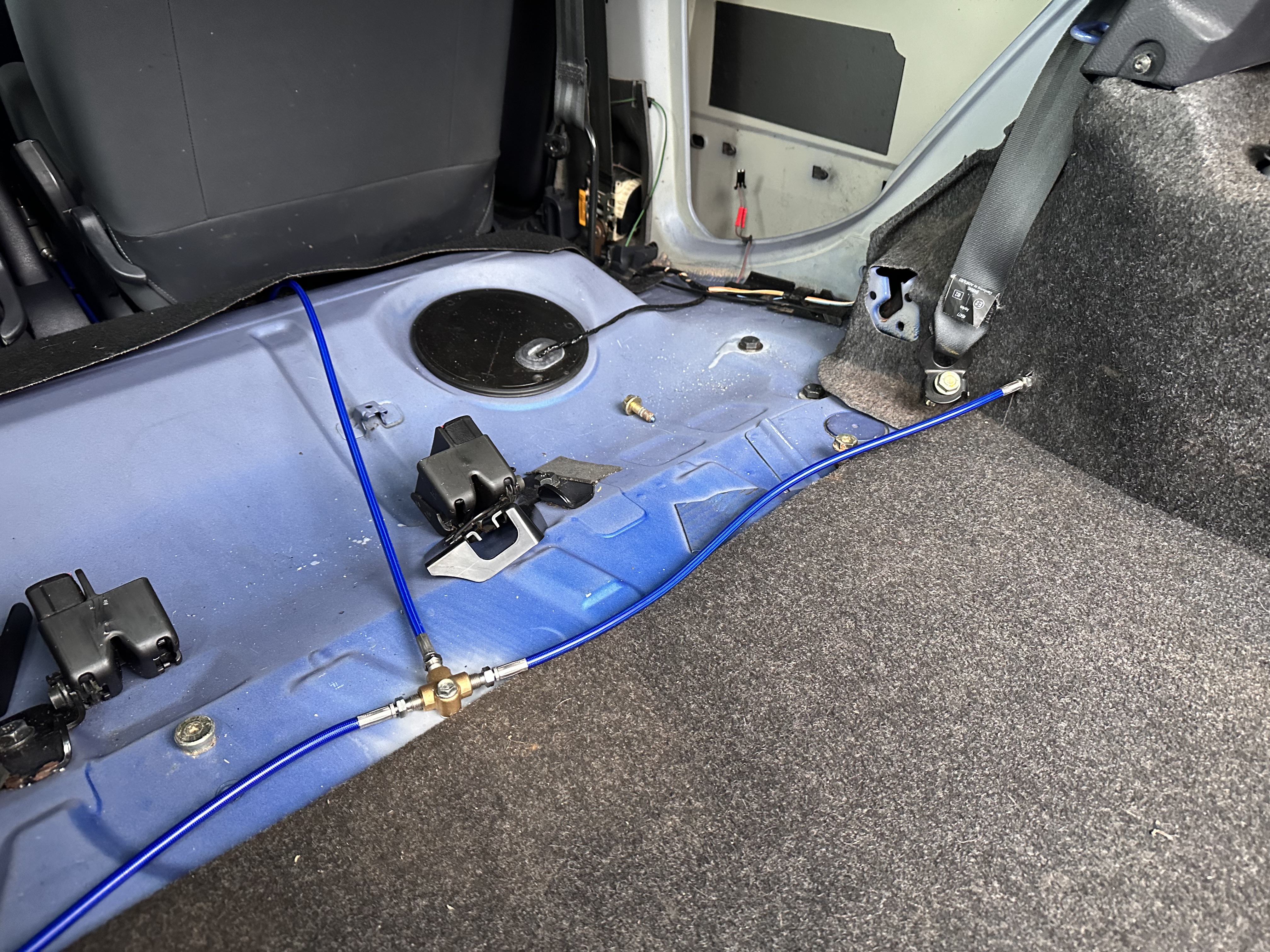

The lines are solid but not ideal when packed with washers. The OEM brackets didn’t seem to work with the braided lines sadly.

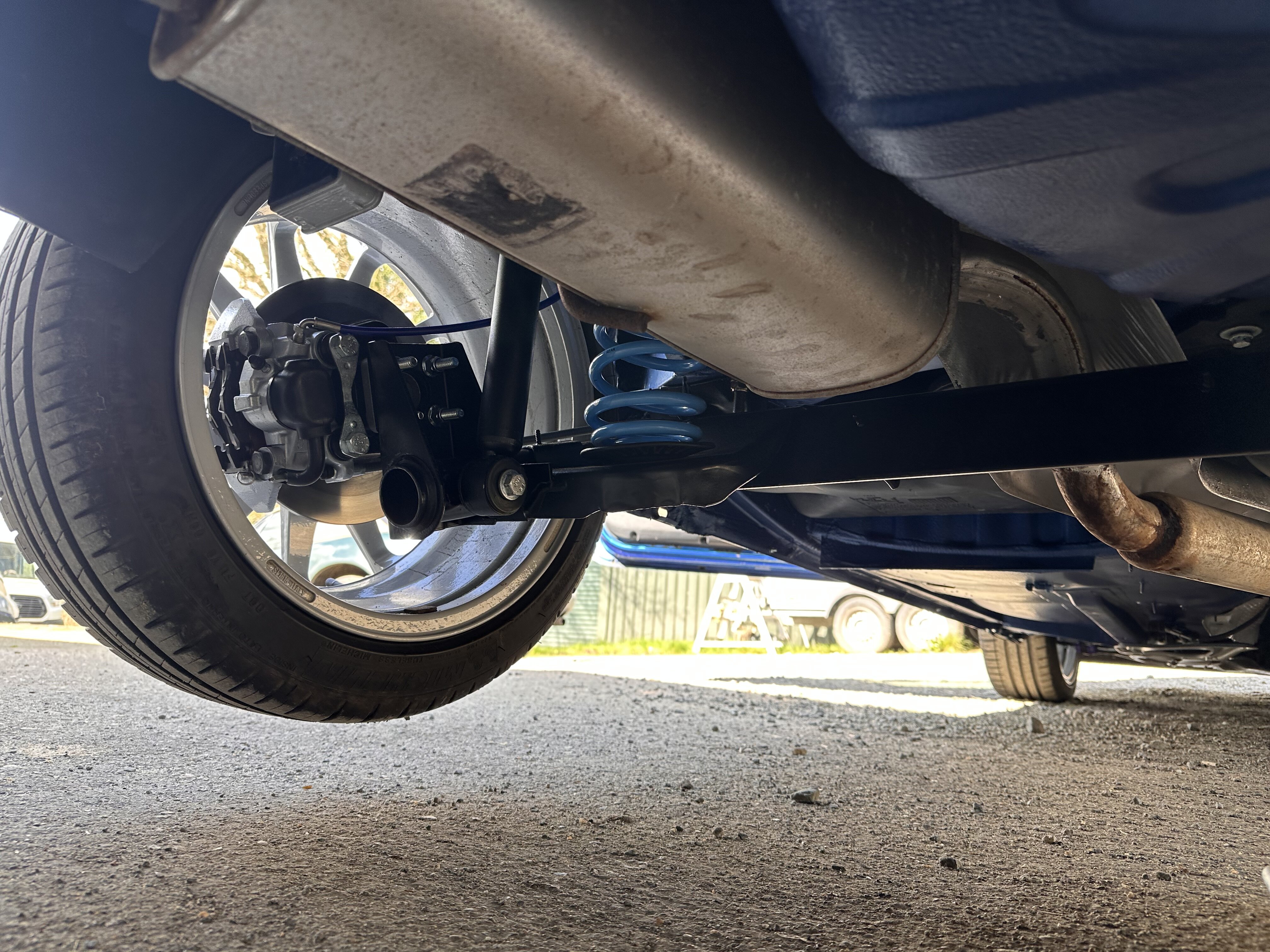

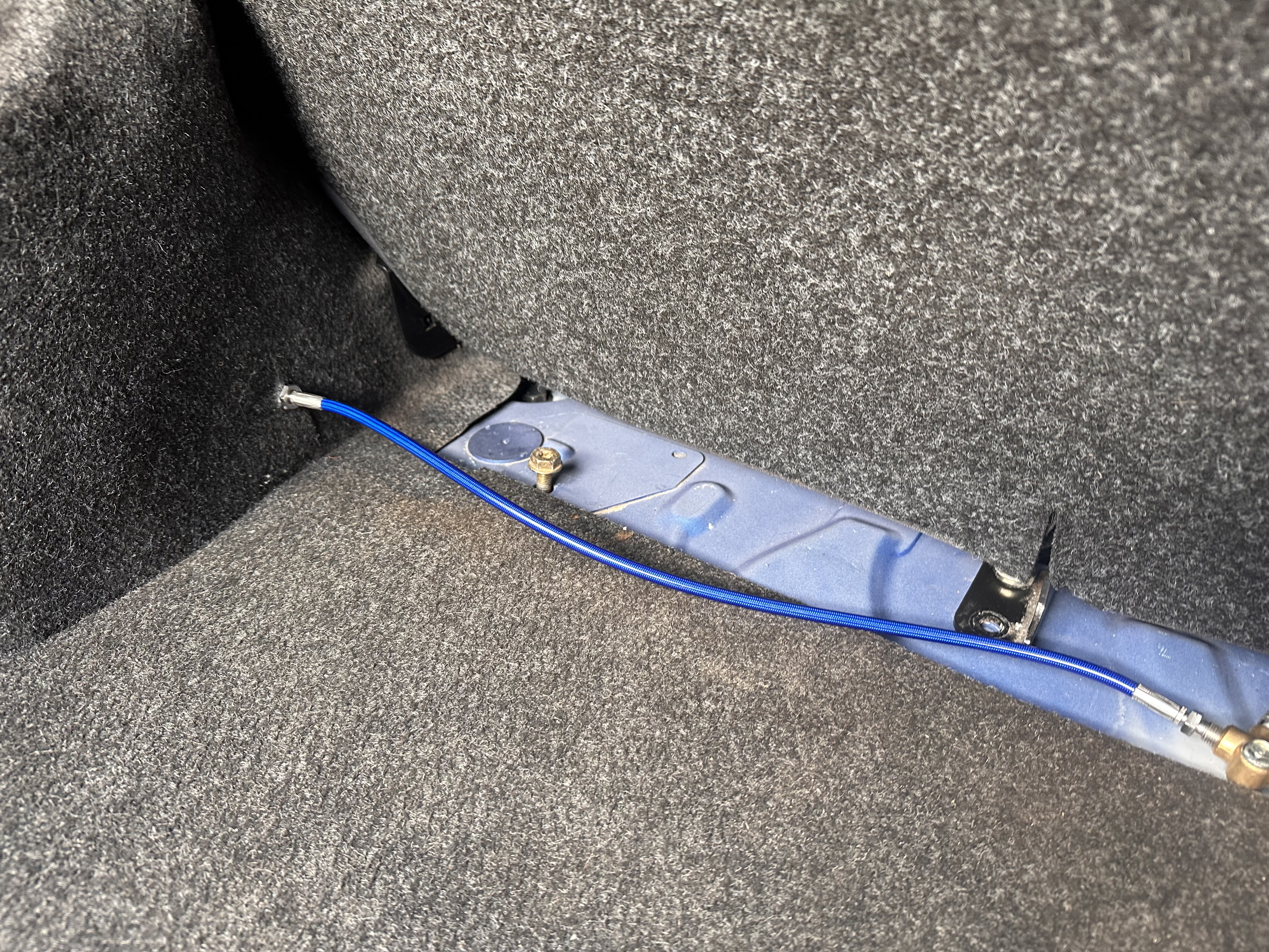

The rear is all built up and lines tightened through the grommets. Really happy with how this has turned out.
Inside the car the T-piece is pop riveted into place and tightened. They are on show in the boot, but this is ok, as it won’t be used as a work horse.

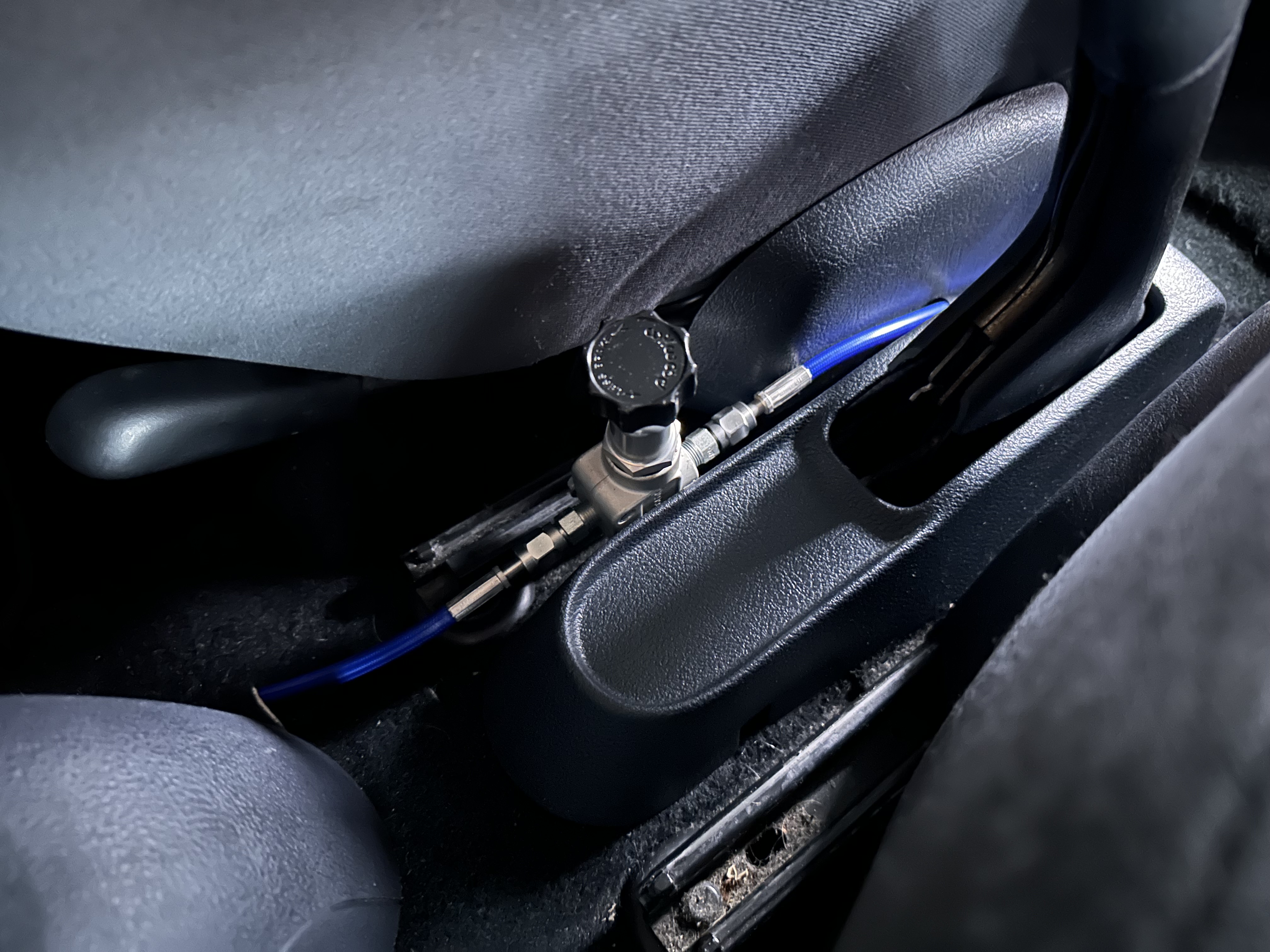

Bias valve mounted to the side of the handbrake housing. Probably the best place for it to go, and doesn’t impact seat/handbrake functionality.

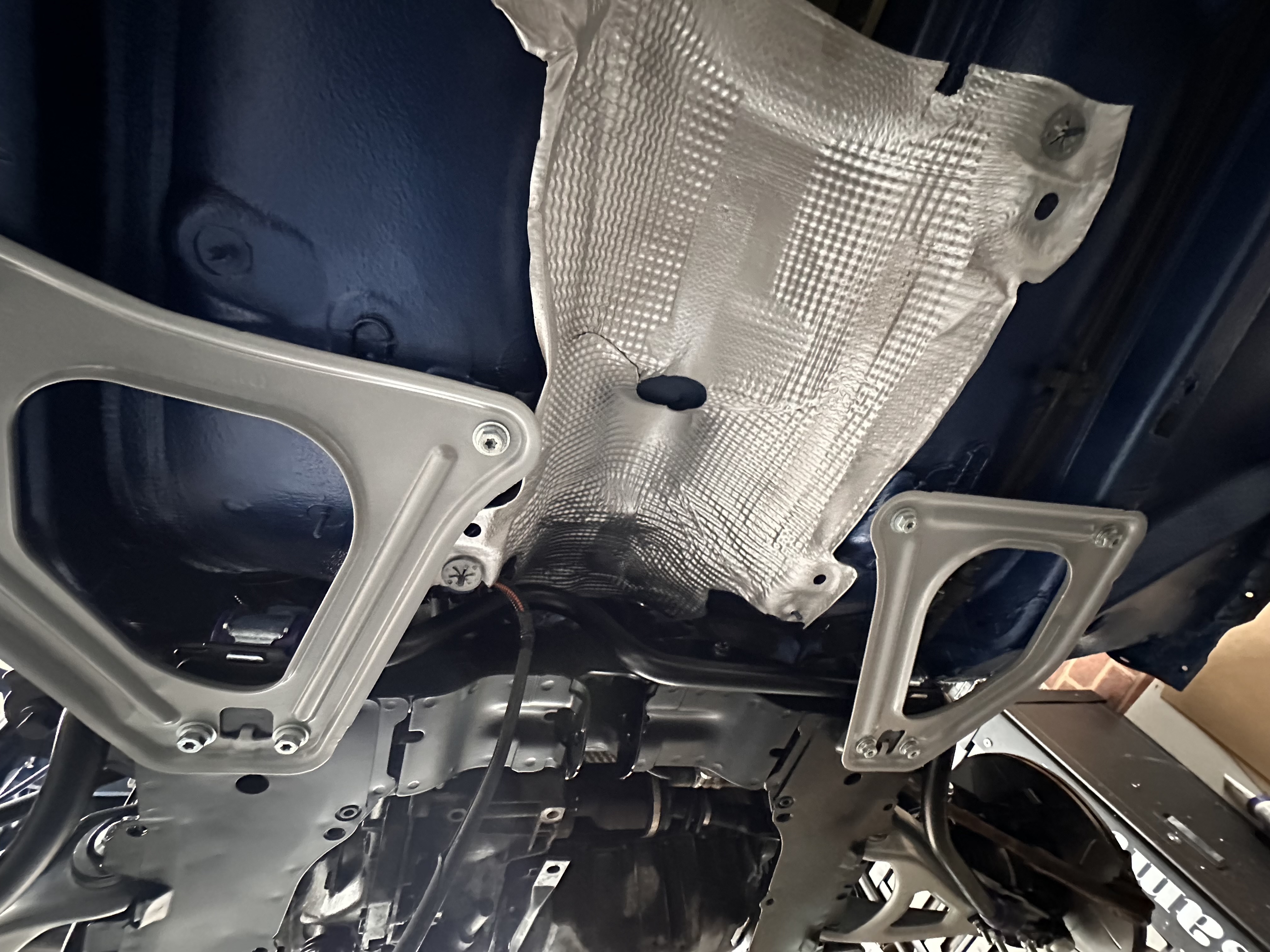

Managed to grab a few photos of the underside whilst trying to fit the poxy gear linkage.

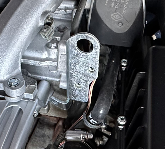

Finally, glossy bits in the engine bay. Including the scuttle panel which I’ve used some ceramic coating on.

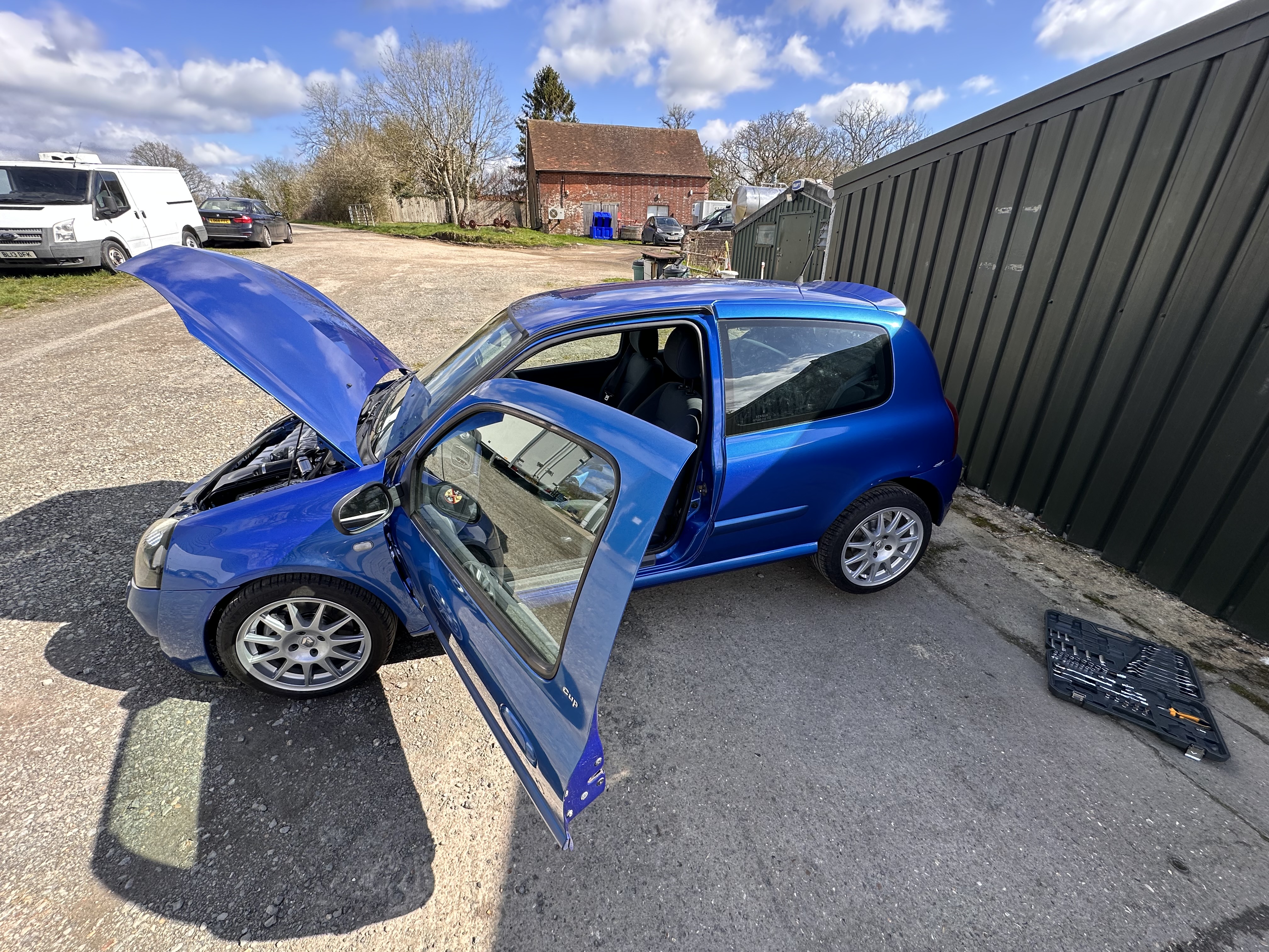

Update on the car, it’s working!
This weekend has been an absolute slog, and it’s not just me that’s been working on the car. I had the help of two others to bleed brakes, tighten rear beam and get the car back to where it is.
Pleased to say that is drives superbly, bar the tracking being way out.

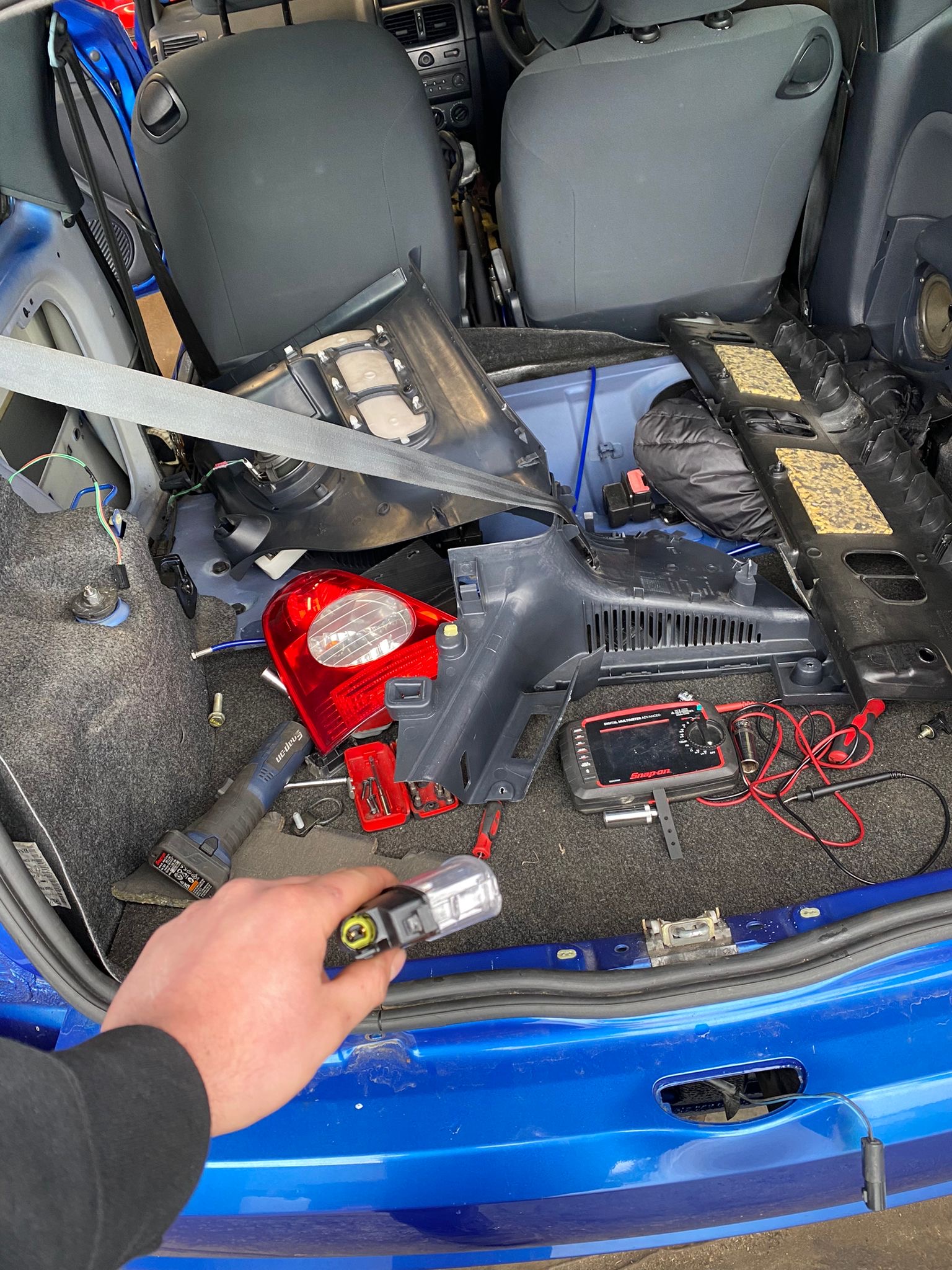

I have working front lights, one rear light and the number plate light isn’t working. Both rear light clusters seem ok. Yet, the dashboard doesn’t light up.
So I’ve tried the usuall. Bridging the dimmer switch to eliminate a faulty component. No luck. Also replaced the relay in the passenger footwell. No luck on that front either. Have checked all 10 & 15AMP fuses. Will check the rest this evening. Not ideal for night time driving :ROFLMAO:

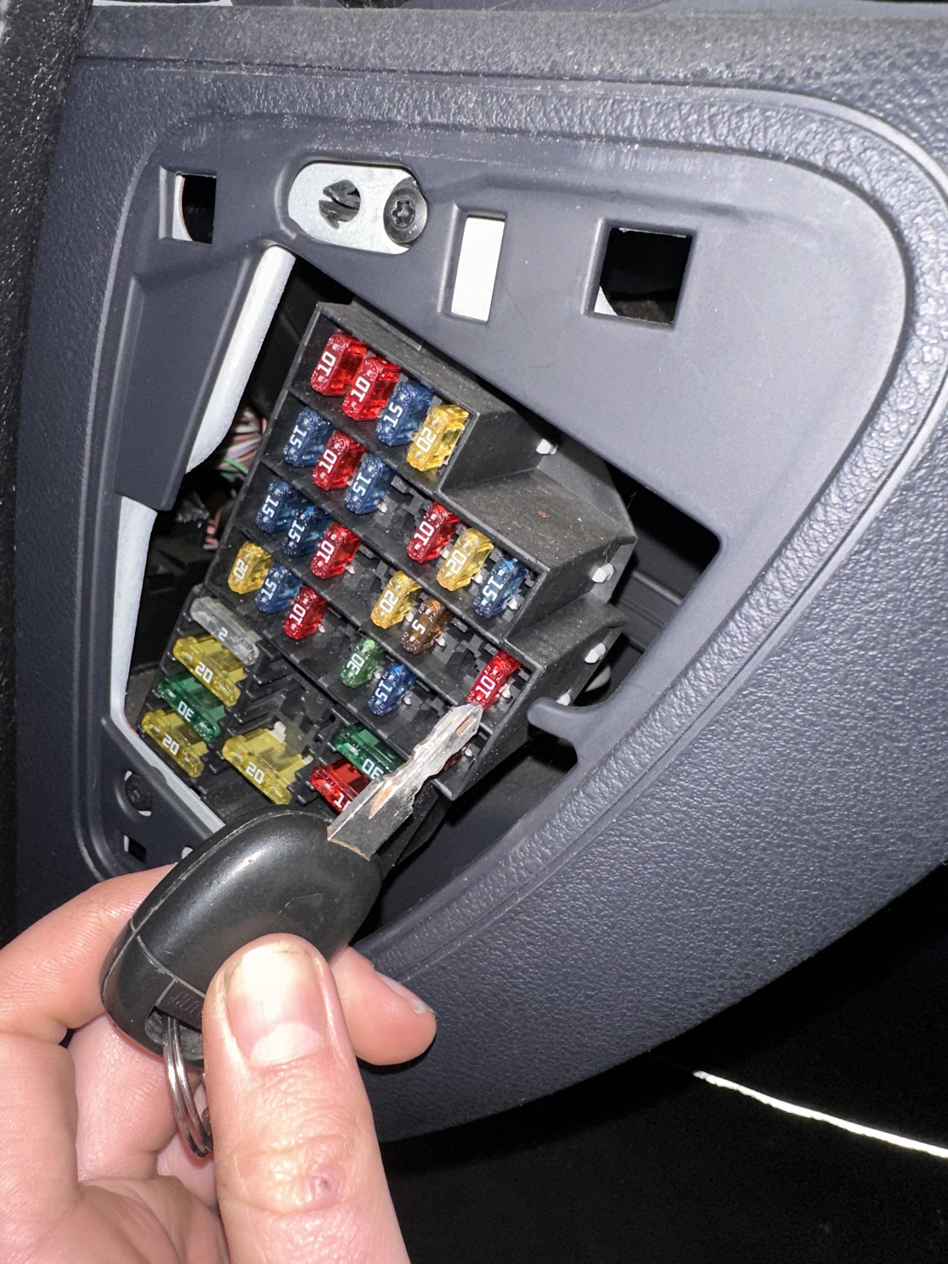

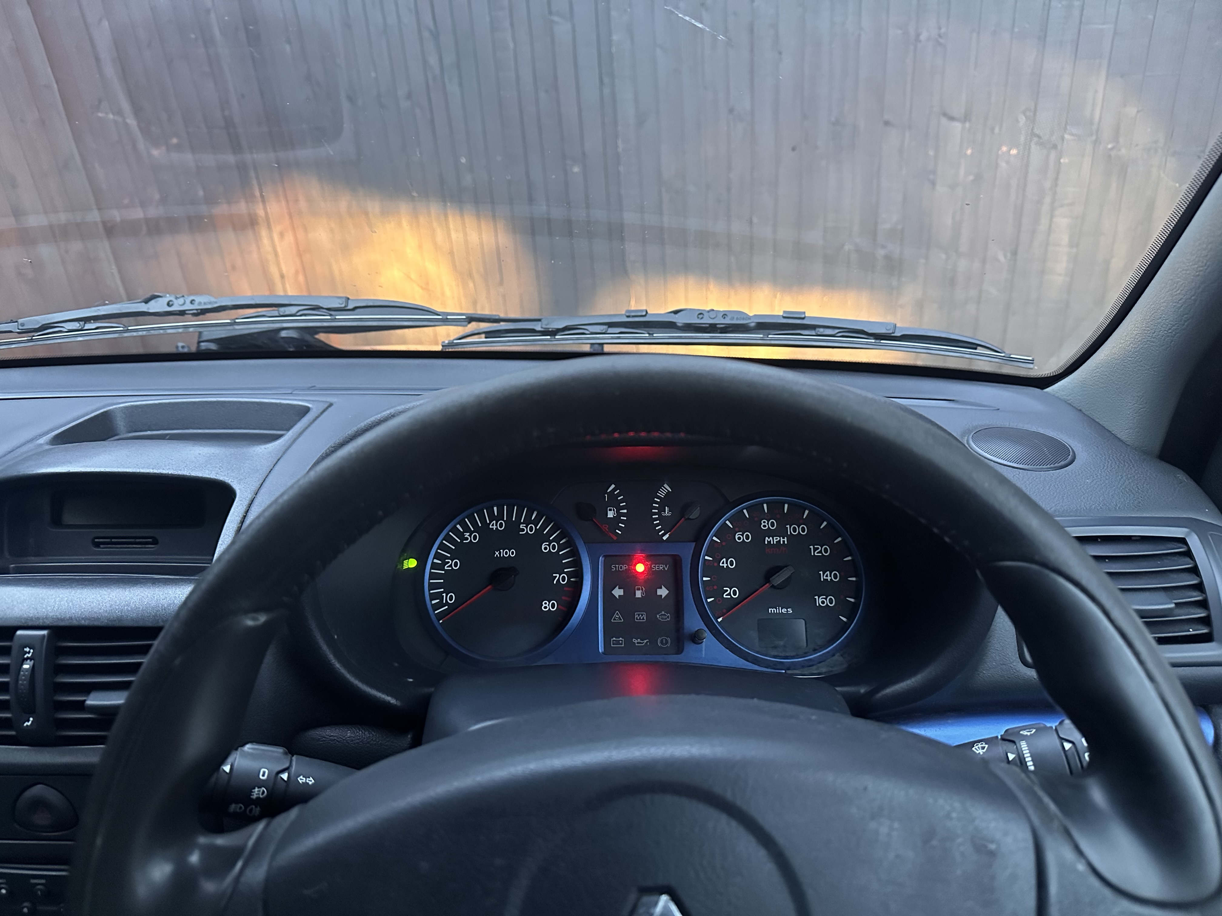

Culprit for the dashboard not lighting up
was a blown fuse.
So, replaced it, dash lights flashed up for a split second before blowing the fuse again. 3 hours of testing various bits until it was traced back to this crappy eBay replacement number plate light. I’ve ordered a genuine one.
Problem solved for now. All good otherwise. I’ve got tracking booked in for Tuesday. Spa is a week tomorrow.

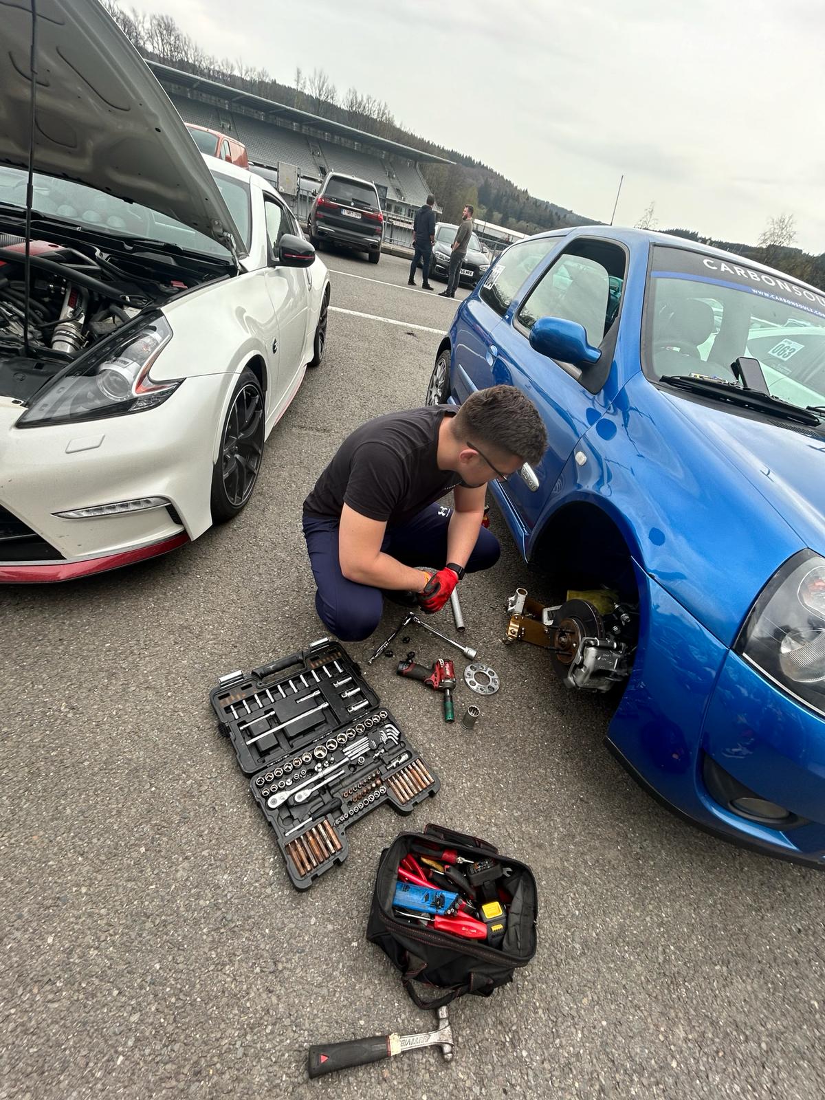

Spa is the best track i've ever driven around. Absolutely mega. The car did 800 miles in total, stopping off at Bruges, Spa, Brussels and then home again, but not without drama.
10 laps / three sessions in, the car developed a knock. I wasn't sure where from, so decided to jack the front up and look for play. This is where it all went wrong. Turns out the one component I didn't change had failed. Wheel bearing had a fair bit of play. I had not choice but to retire for the day.
Really wish I'd done the wheel bearings now, but what's done is done.
This is what a broken man looks like. Figured if I stared at it long enough, somehow it might be fixed.

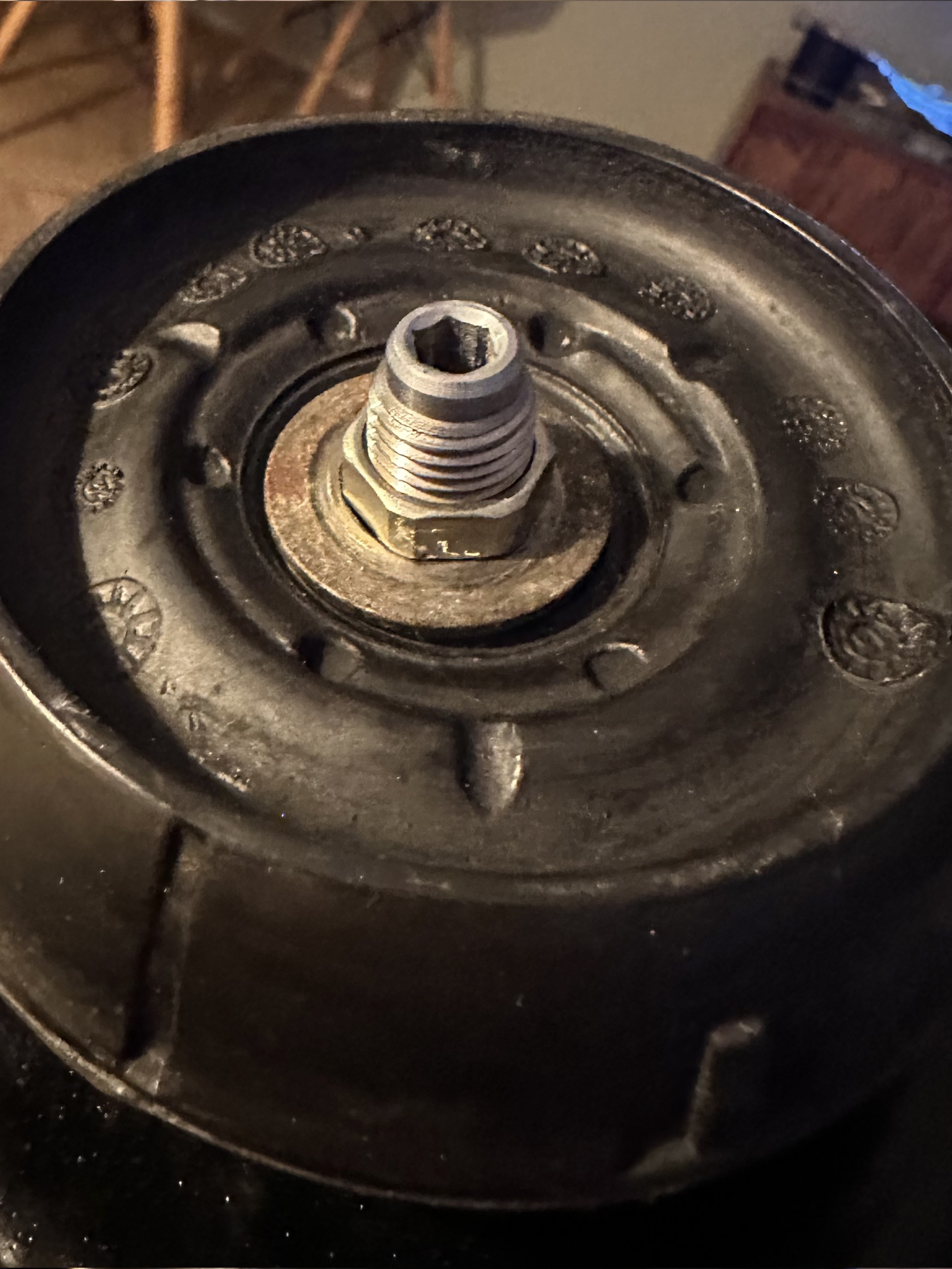

Sooo... asking csnet to look into their crystal balls on this one.
I've replaced the dogbone mount, lower gearbox mount, tightened the bell housing rubber mount, New upper gearbox mount and engine mount with powerflex insert, however, I am getting a major knock and movement motion from the front of the car when pulling away.
Could incorrectly fitted top mounts cause this?
I have these fitted https://www.ebay.co.uk/itm/392658679780
Tempted to purchase new OEM ones. I remember when assembling the Febi ones, there was a fair bit of play. Below is the only photo I have of the assembly.

I had something similar a few months back, a couple of knocks when setting off, or when I came off the accelerator, mainly in first gear.
I loosened the engine mount and moved the engine forward, that stopped it.
Genuinely hadn't considered this. Going to try tomorrow. Thank you

Does ot happen all the time when pulling off or more so on hard lock, febi mounts should be fine. try pushing engine forward, if no luck then you might want to spanner check the front end, and work everything with a pry bar
