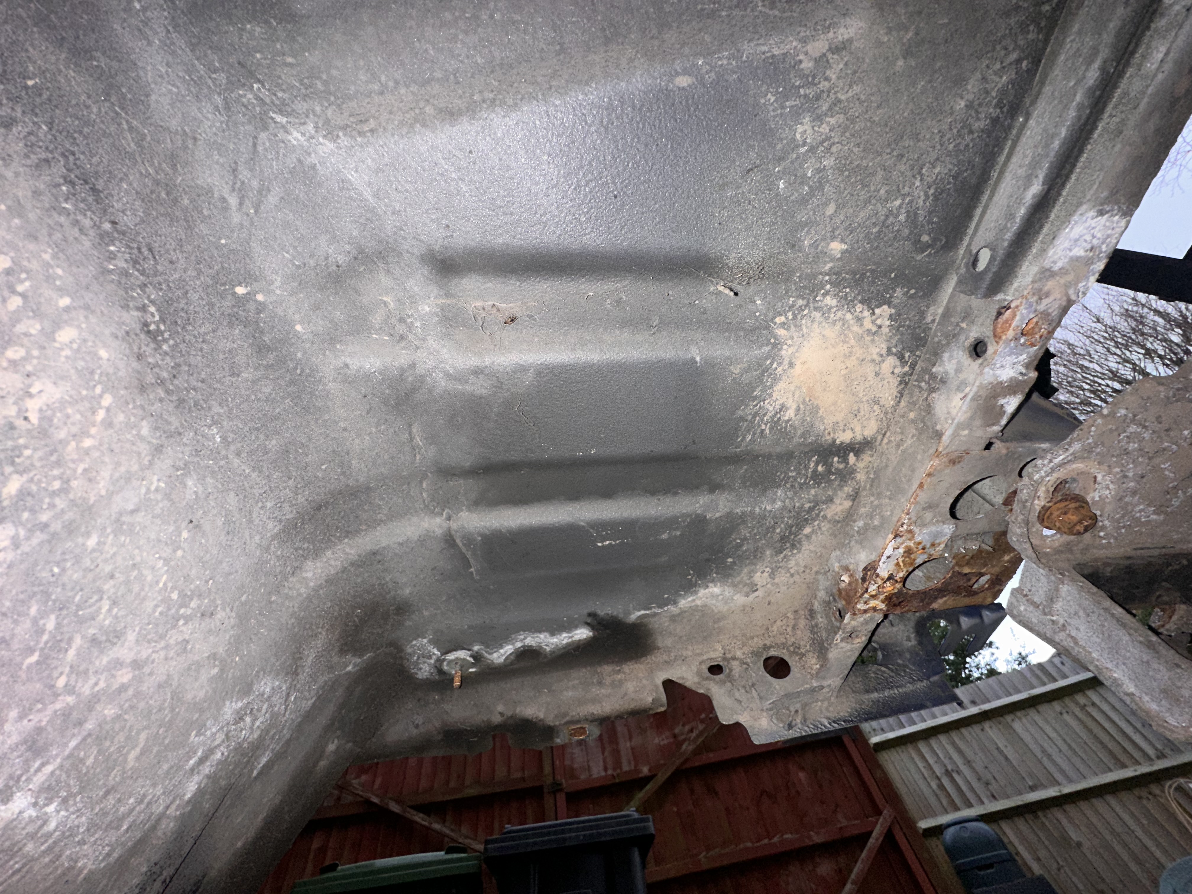

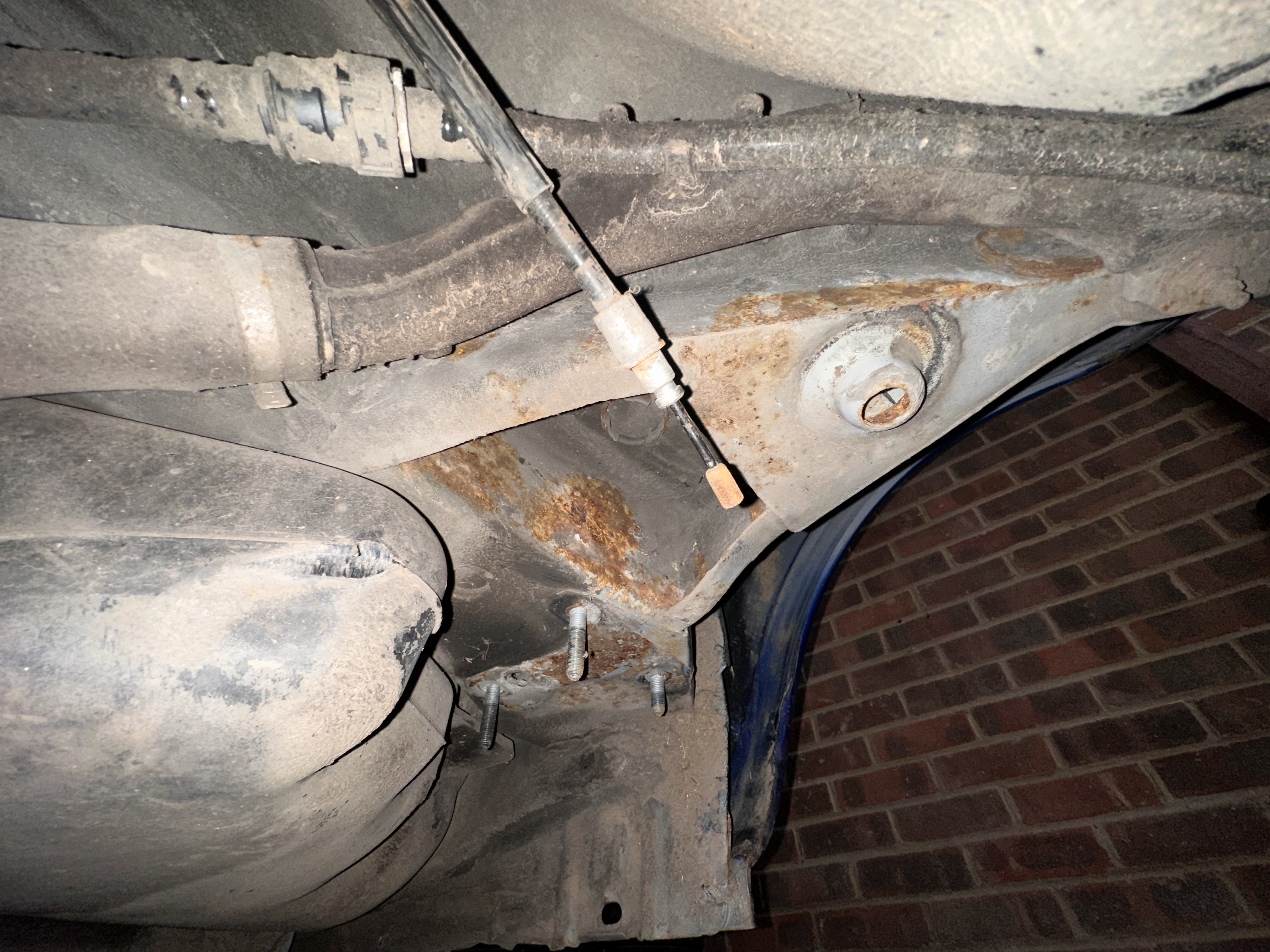

Was pretty happy with the underside. Only appears to be minimal surface rust.
The plan is to get the rust off and probably use lanoguard to protect it.
Was going to use raptor underseal with a RAL colour match close to mondial blue, however, I’m concerned about locking in rust. With the lanoguard, it dries clear, allowing me to keep an eye on things.

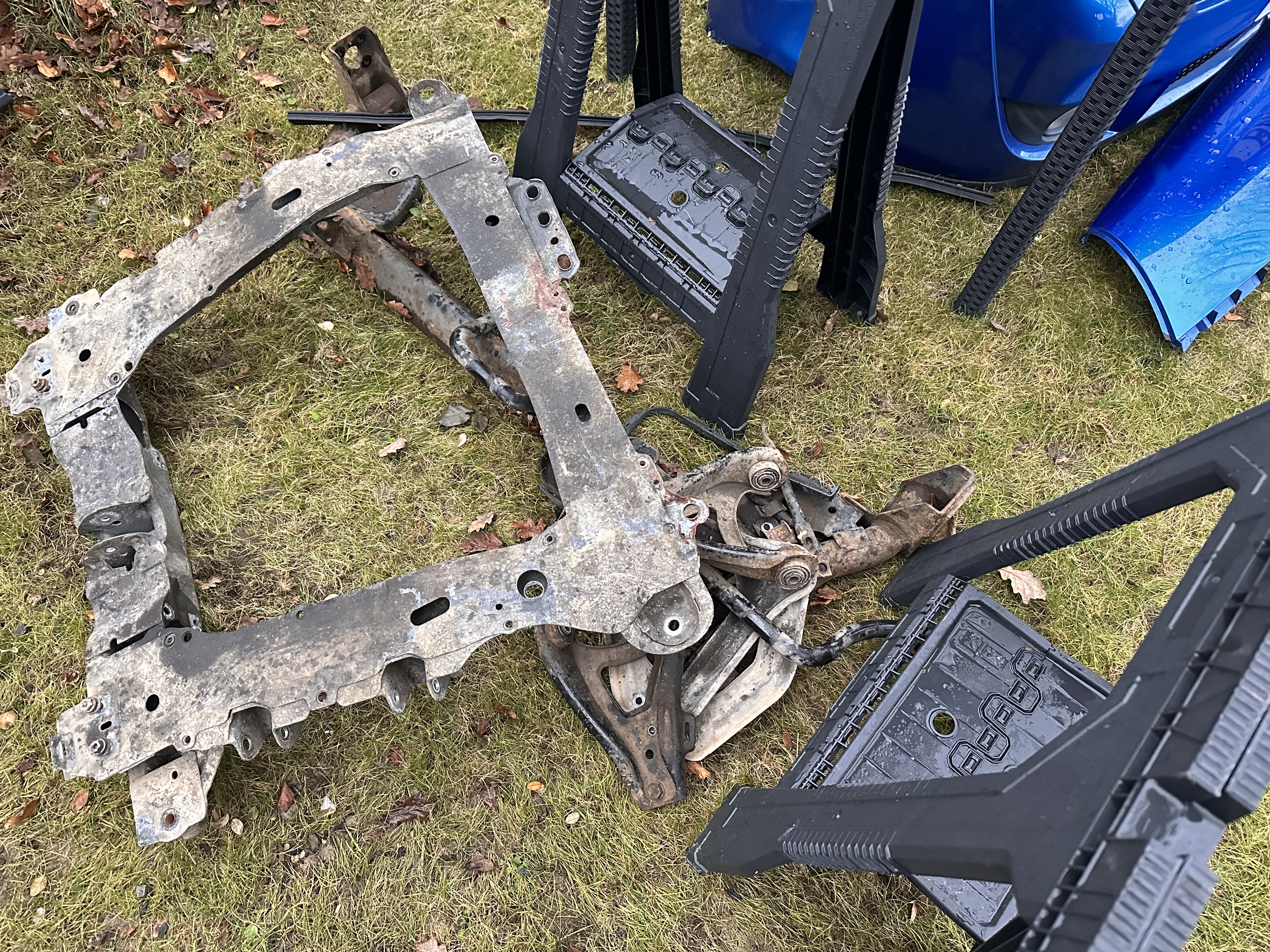

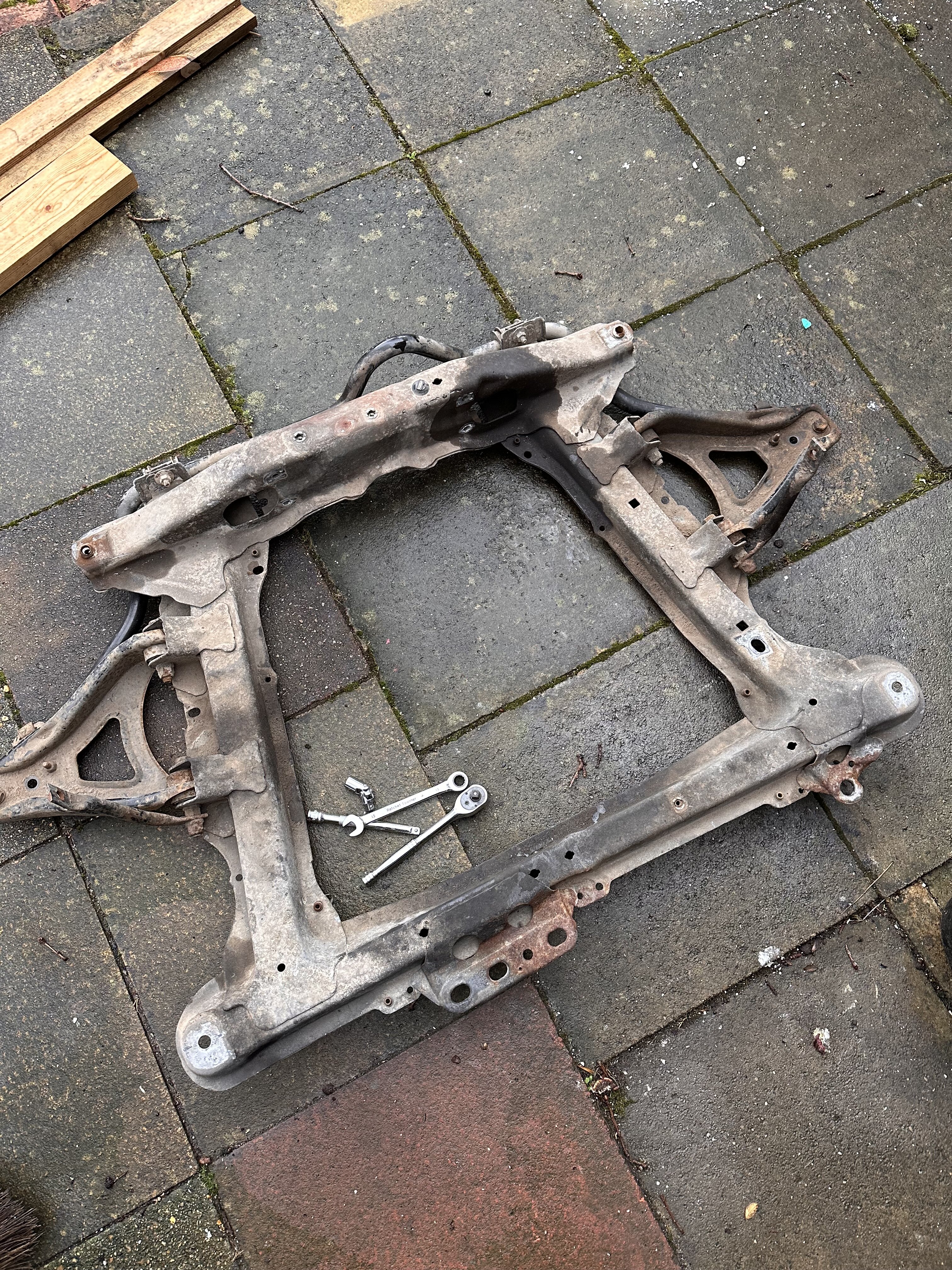

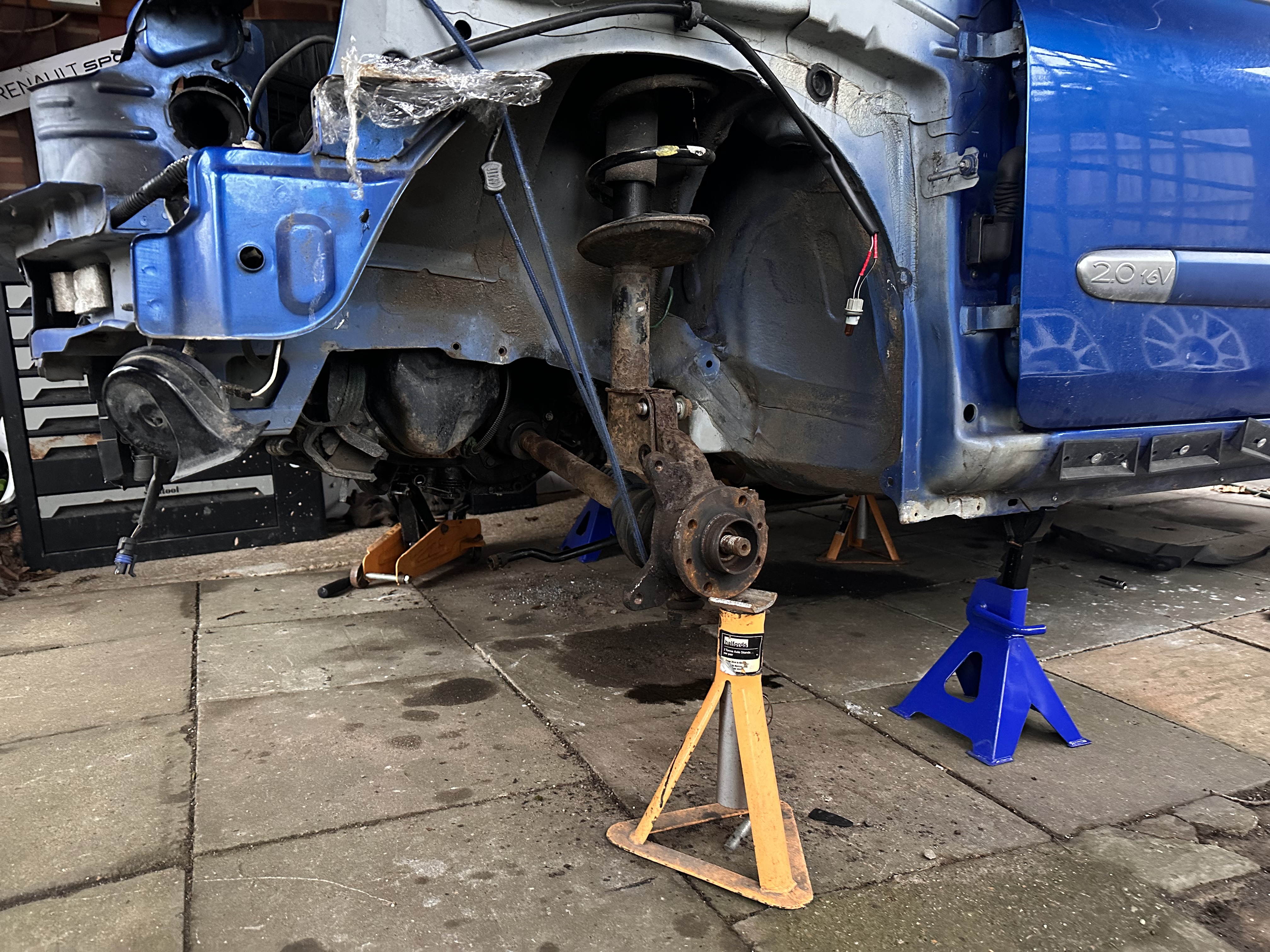

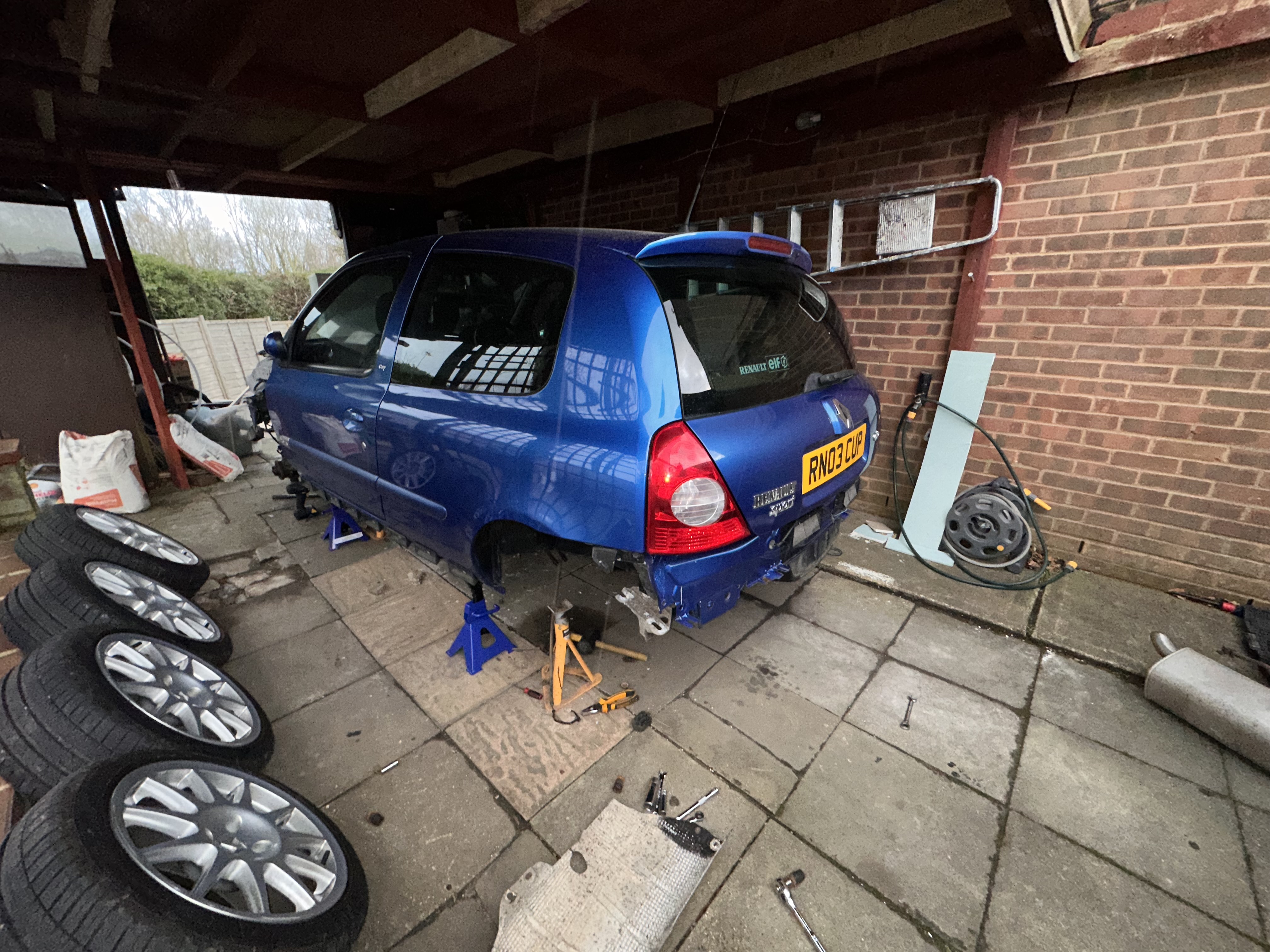

More bits done. The car is completely free of all subframes now, after a lot of drilling and leverage. Just needs to press the old bushes out and they’ll be ready for powder coating.

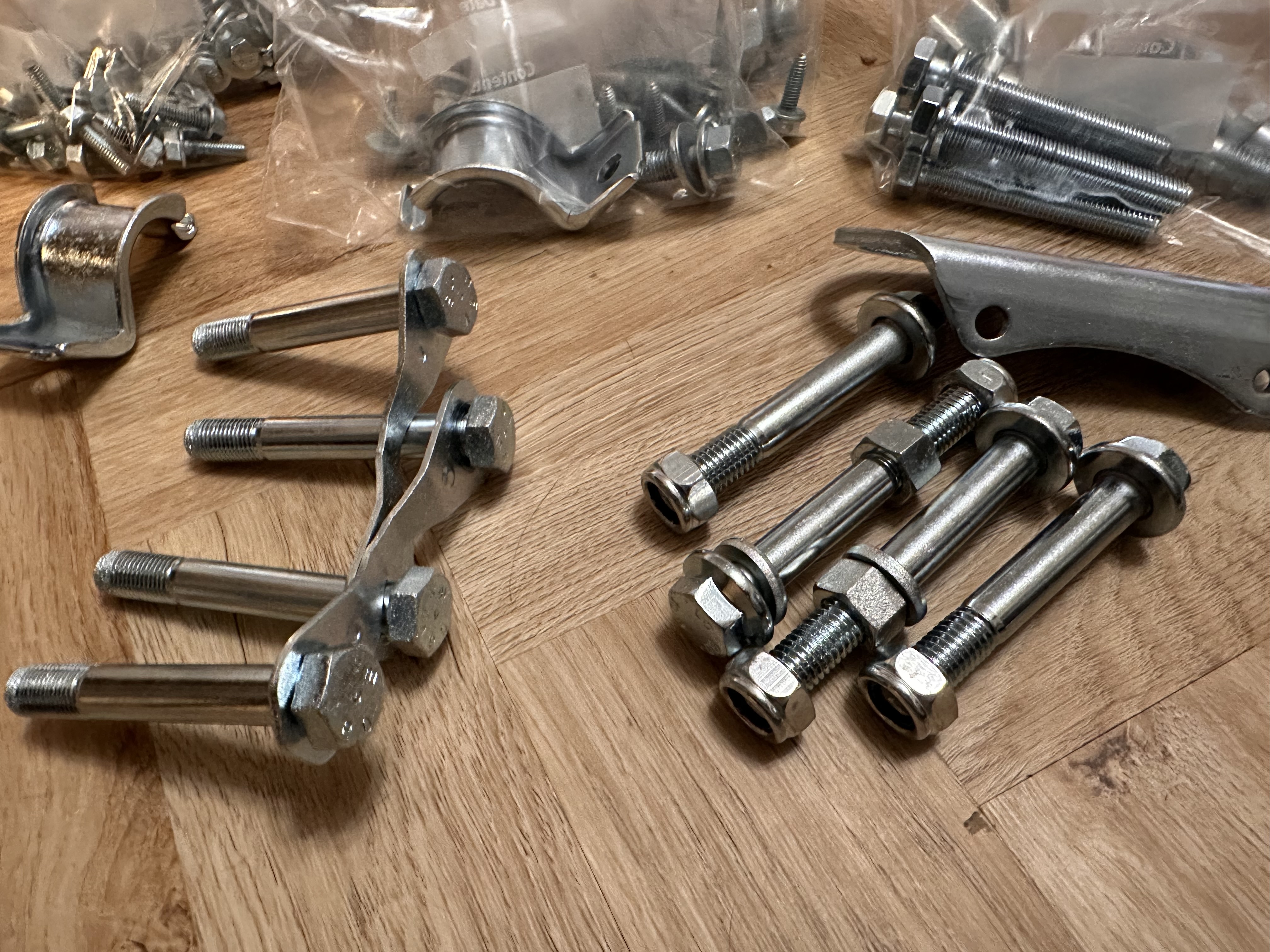

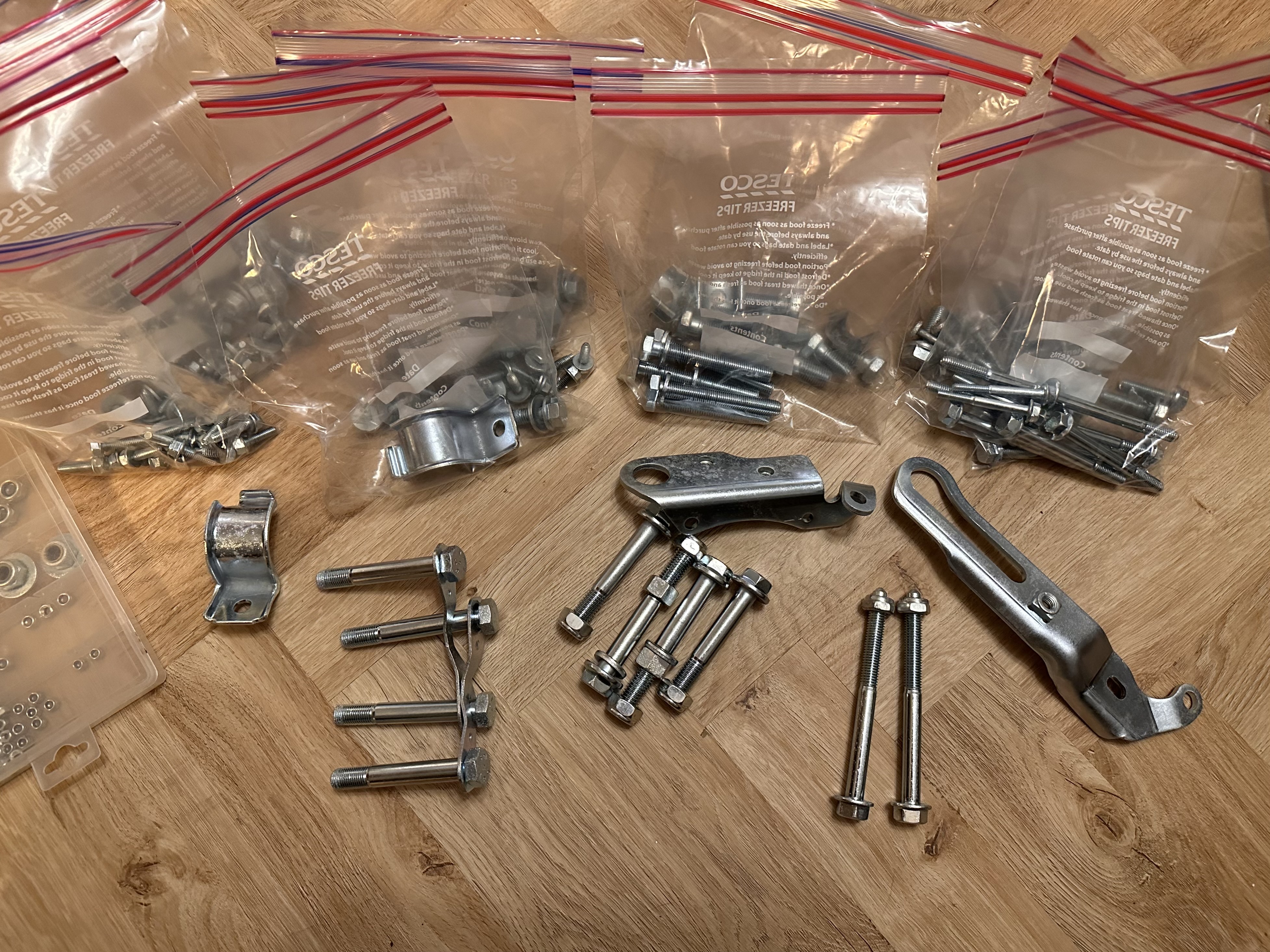

Will also be getting all the bolts plated too. Plenty to do still, and lots of prep to do underneath.
Stripping down the subframe was easy enough once it was off the car.

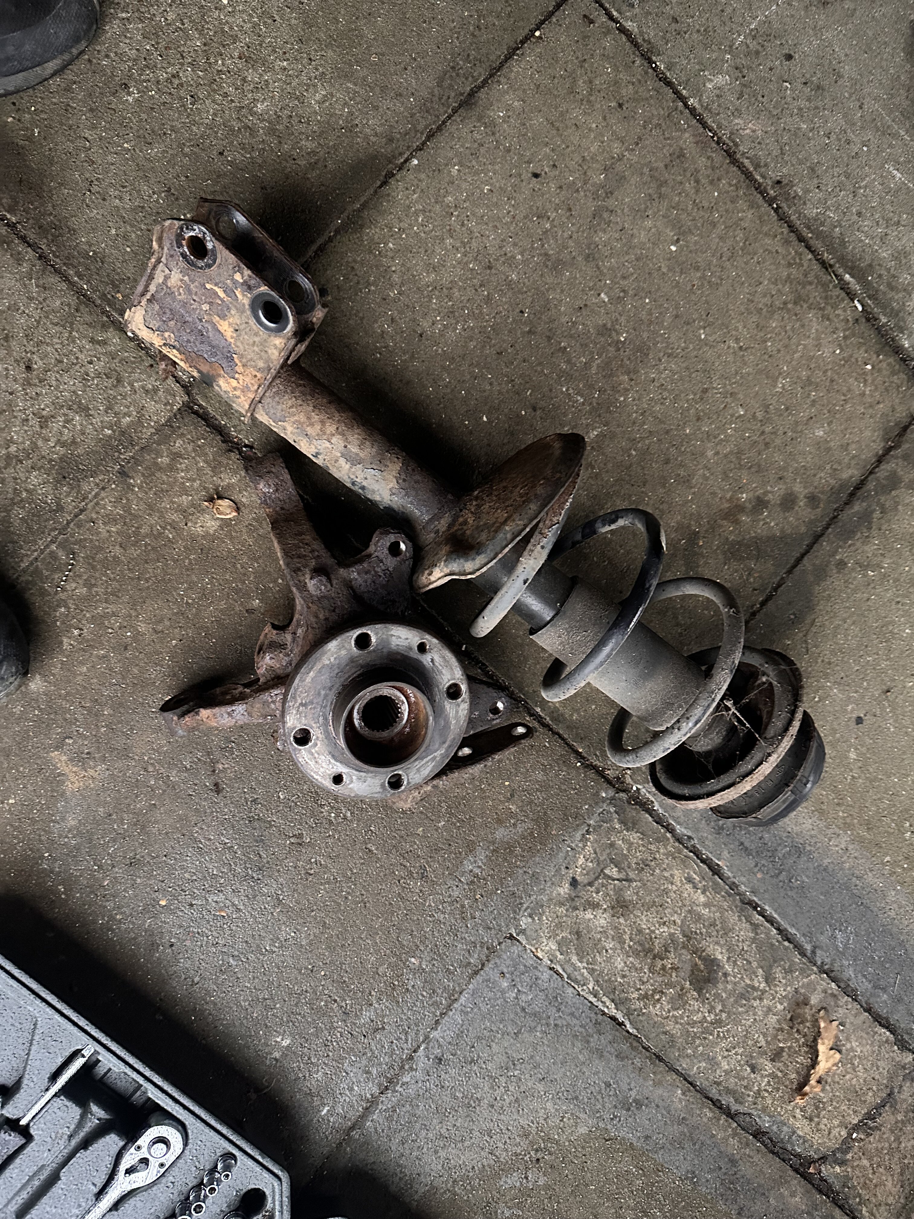

Hub and shock still on this side. Top mount is spinning with the entire shock.
Not sure on how best to do the hubs. Would like them done properly, but new bearings are £80 ish a side.
Turned a section of garden into a cup graveyard.

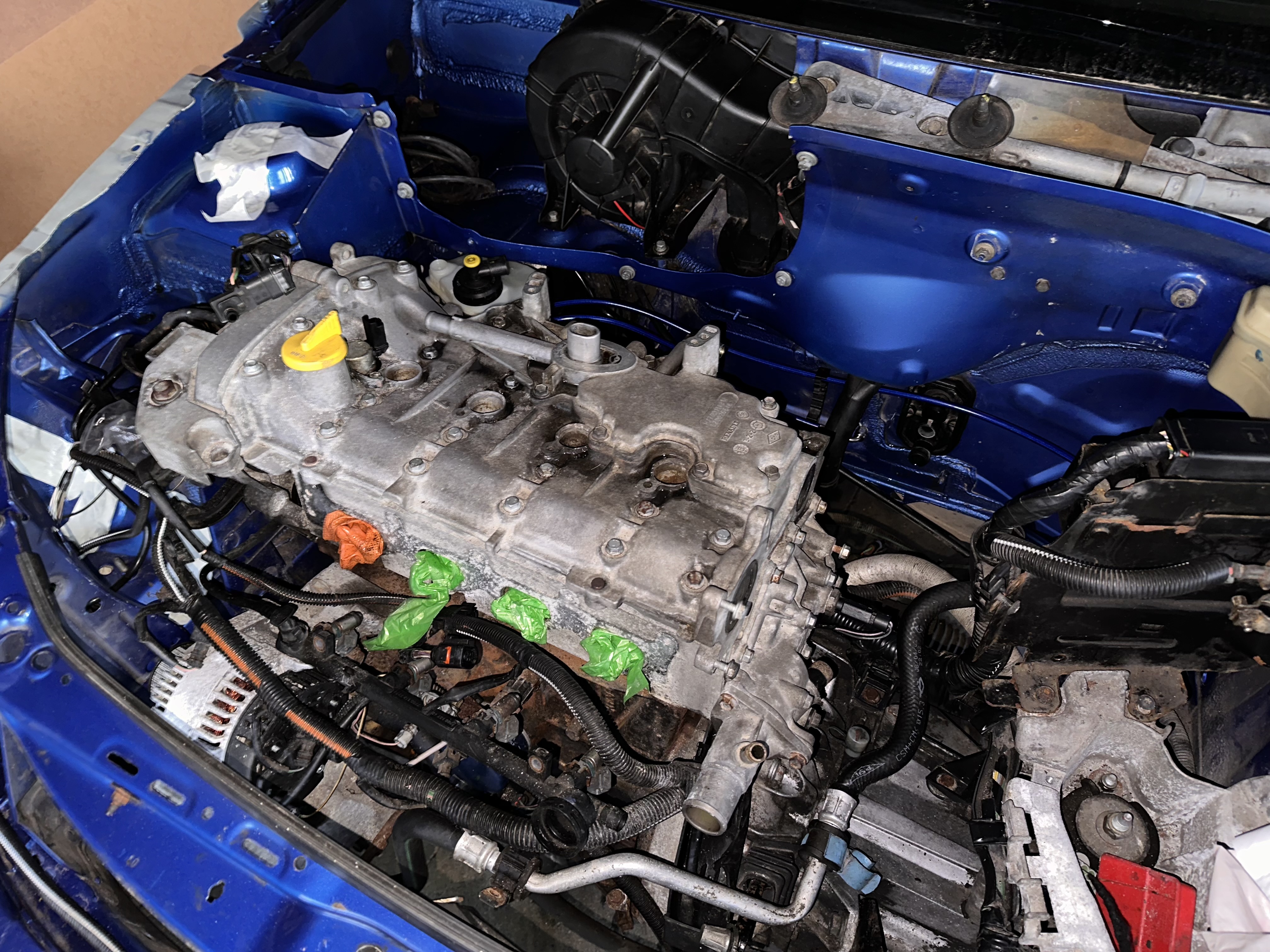

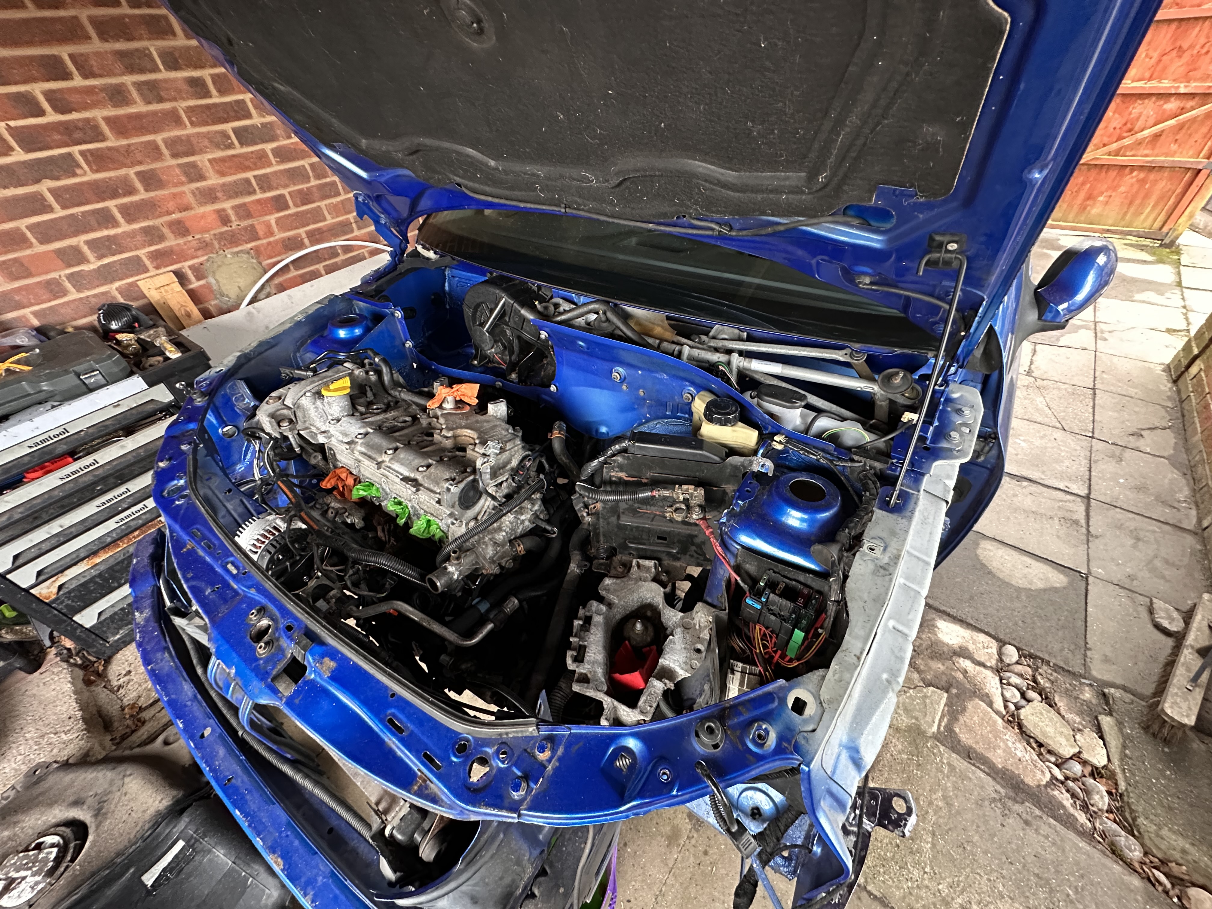

And taken bits off the engine bay to give it all a good clean up. It’s an excellent base, just needs some TLC. Car will be only used in the summer, so will hopefully stay nice once this all freshened up.

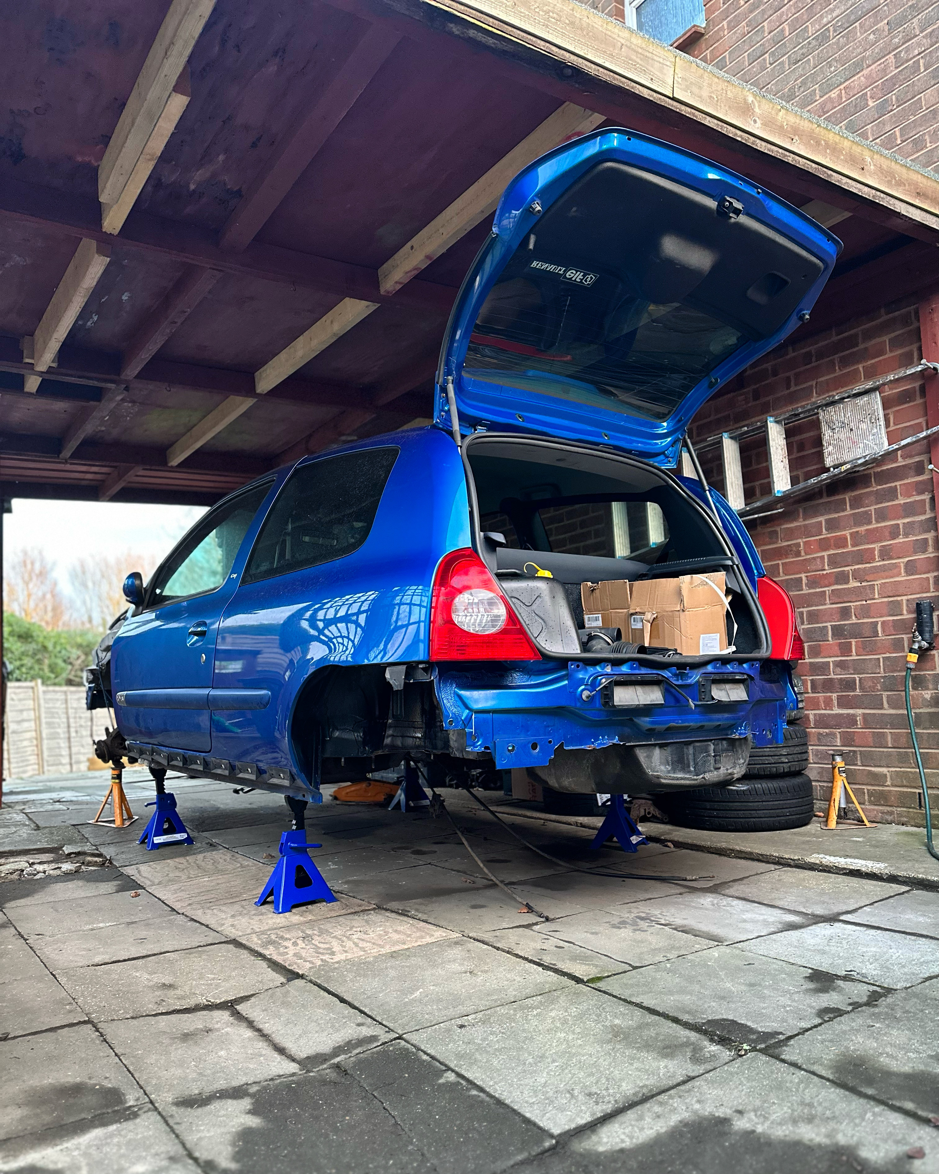

Slow progress on this, however, the car is now free of all subframes, fuel tank, hubs, lines, all of it.

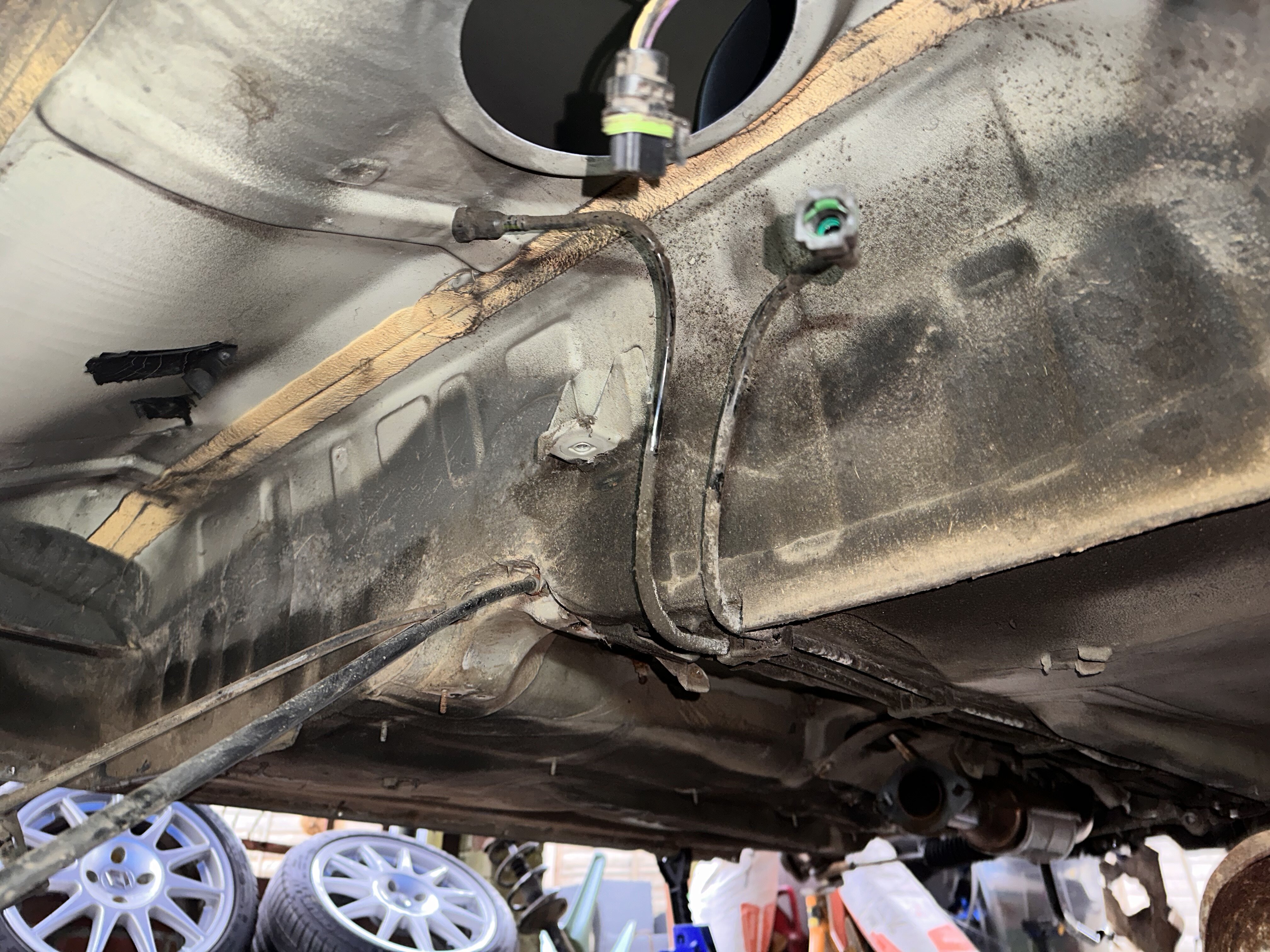

Really pleased with how it’s looking to be honest. I’ve heard bad things about the area behind the tank, but it looks new.
Next up, I’ll be doing a deep clean before grinding back the surface rust and treating.
It’s currently 92 days till Spa. Feeling hopeful it will be back together by March.

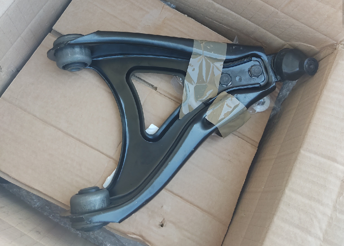

One of the Wishbones (drivers side) has been damaged whilst removing the collar for the old bush.
RPD doesn't seem to sell the generic 1*2 wishbones anymore for the PH2, any suggestions?
Bit gutted as they were genuine cup wishbones with the altered castor.

I think Ktec do wishbones, not sure on what quality is like but presumably would be better than eBay ones and would have the correct castor etc. Or could try and find a decent set of secondhand ones.
I have been enjoying seeing your progress, this is something which I want to do to mine when time eventually allows.
These are the K-Tec ones, not the best quality but sufficient. The bushes and castor angle are NOT Cup spec as far as I can see.
They are made by Optimal.
Tbh I think the extra castor is a gimmick and that these will work just fine. Just mind the balljoint bolts are 10mm not 12mm, but that also does not make any difference and you can use Scenic ball joints when replacing.

I'd personally find a breaker and get them off that.
Thanks all, I've sourced a genuine cup one from a breaker via Facebook. It's crazy how so many items seem to have disappeared from Renault in the past 12 months or less, or put on back order.

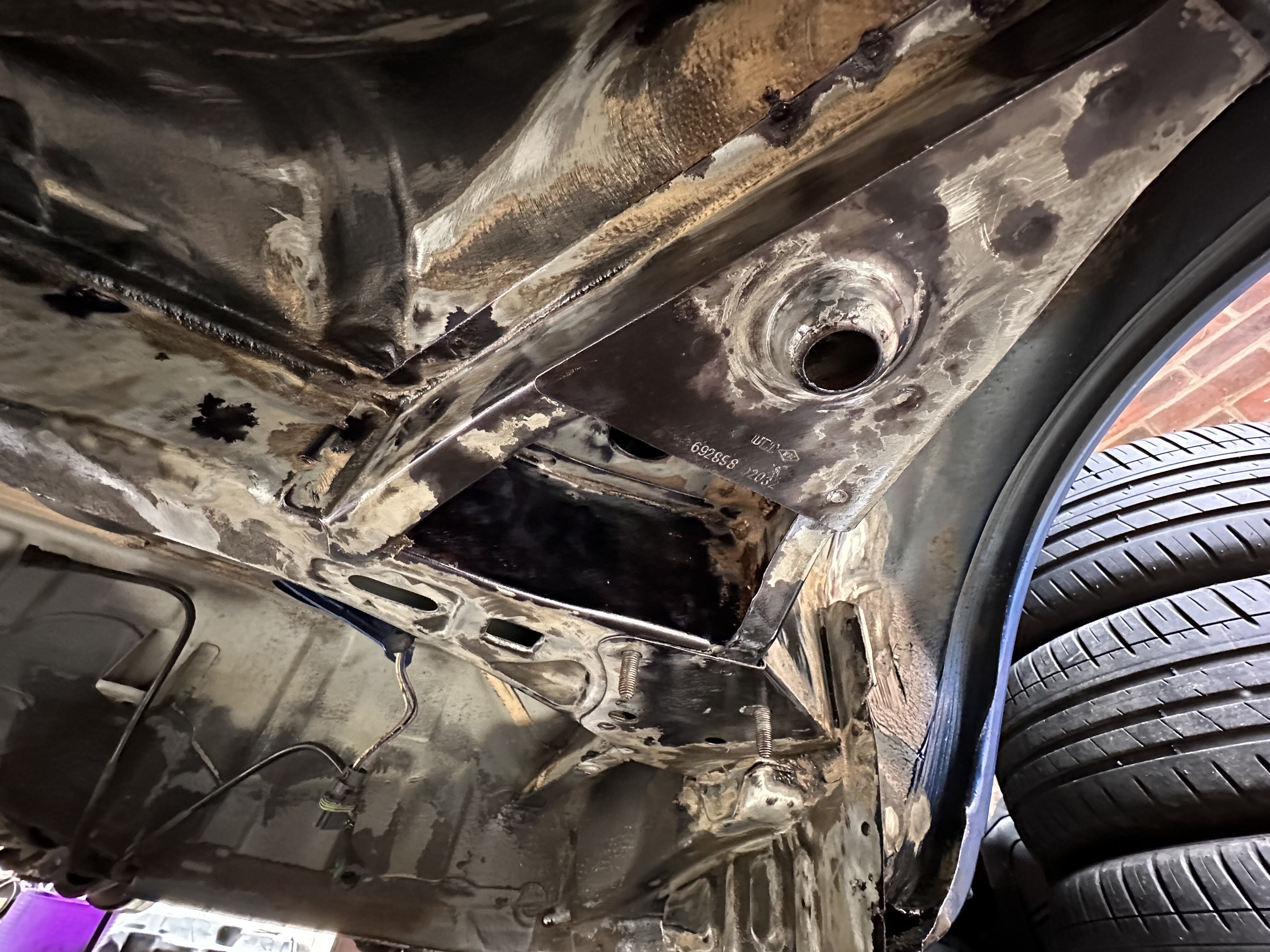

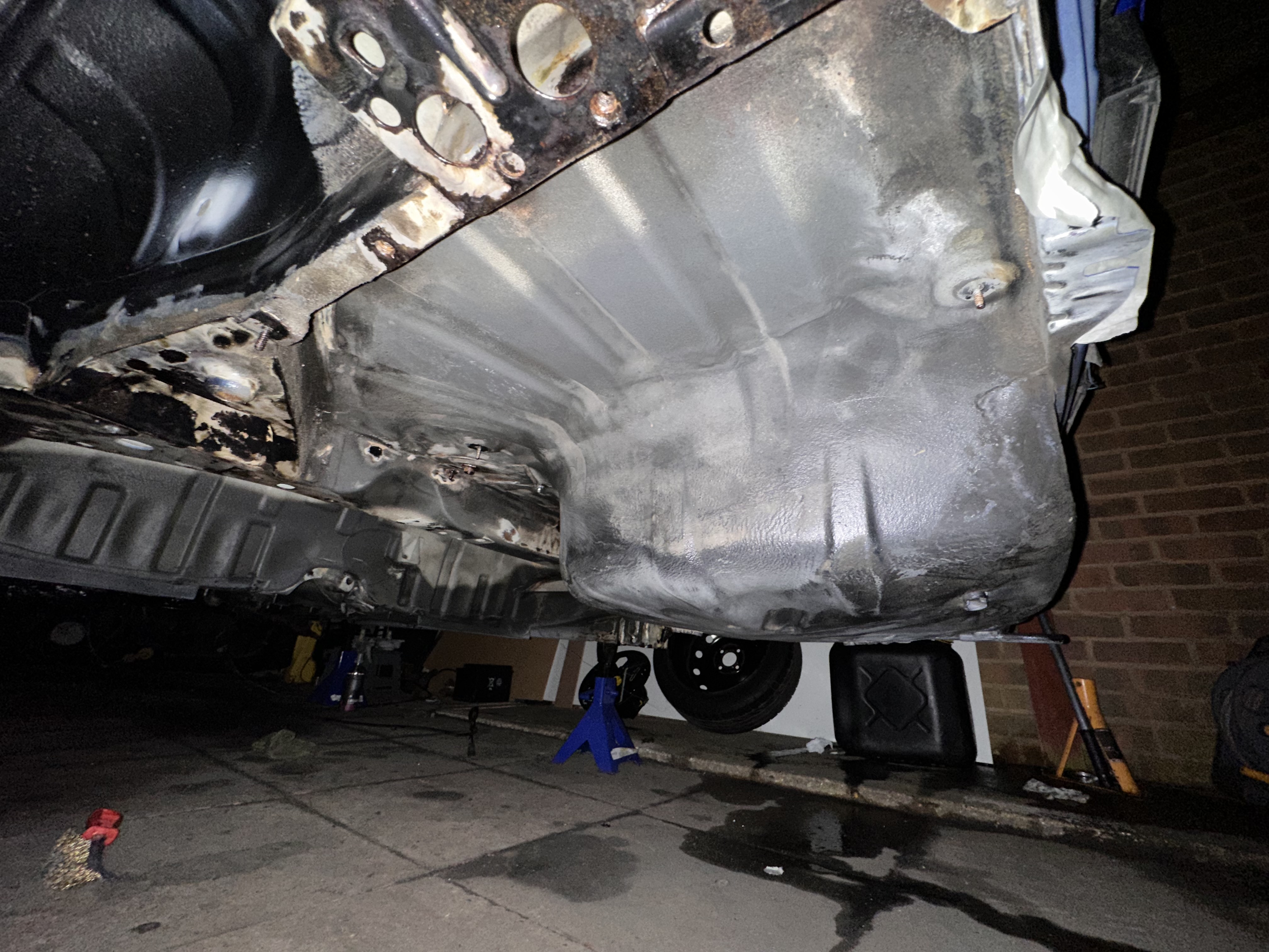

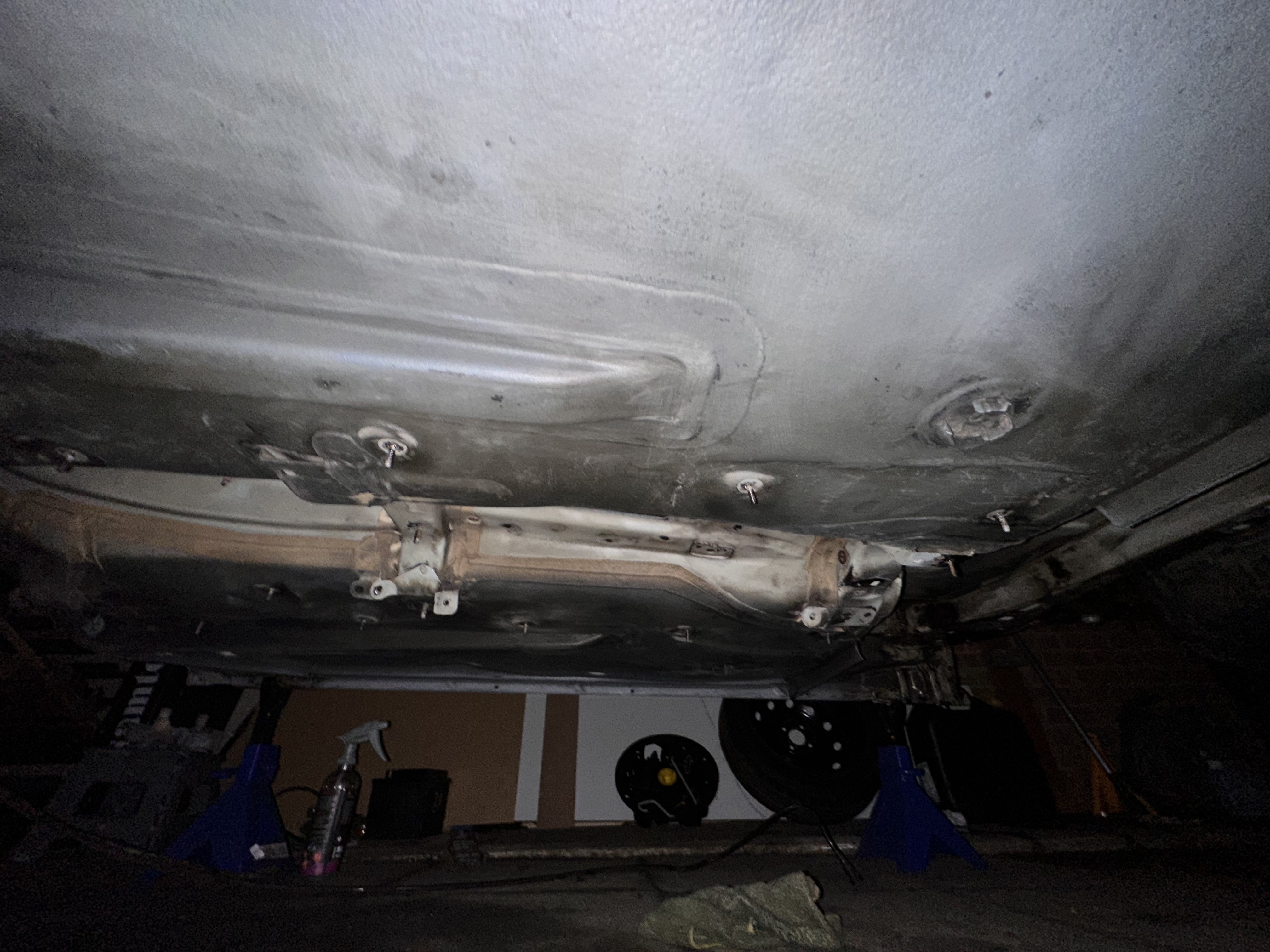

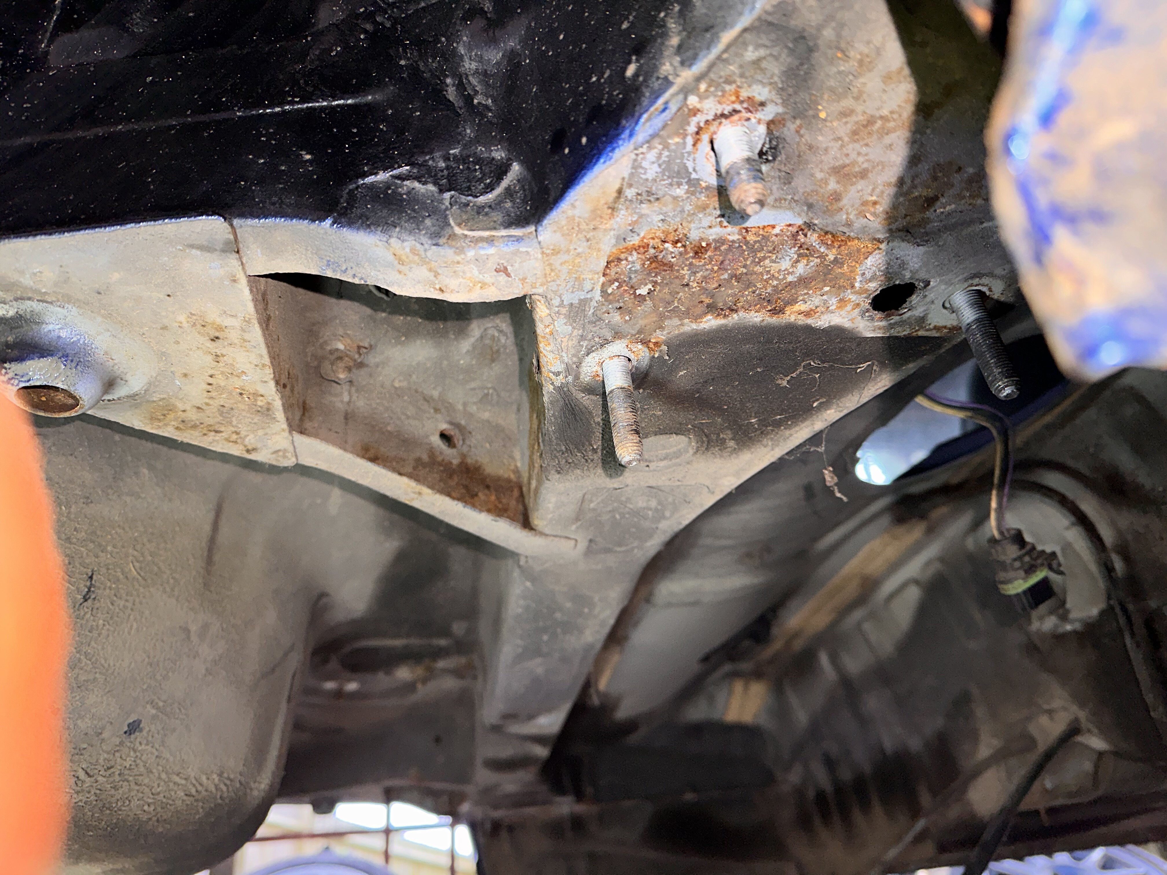

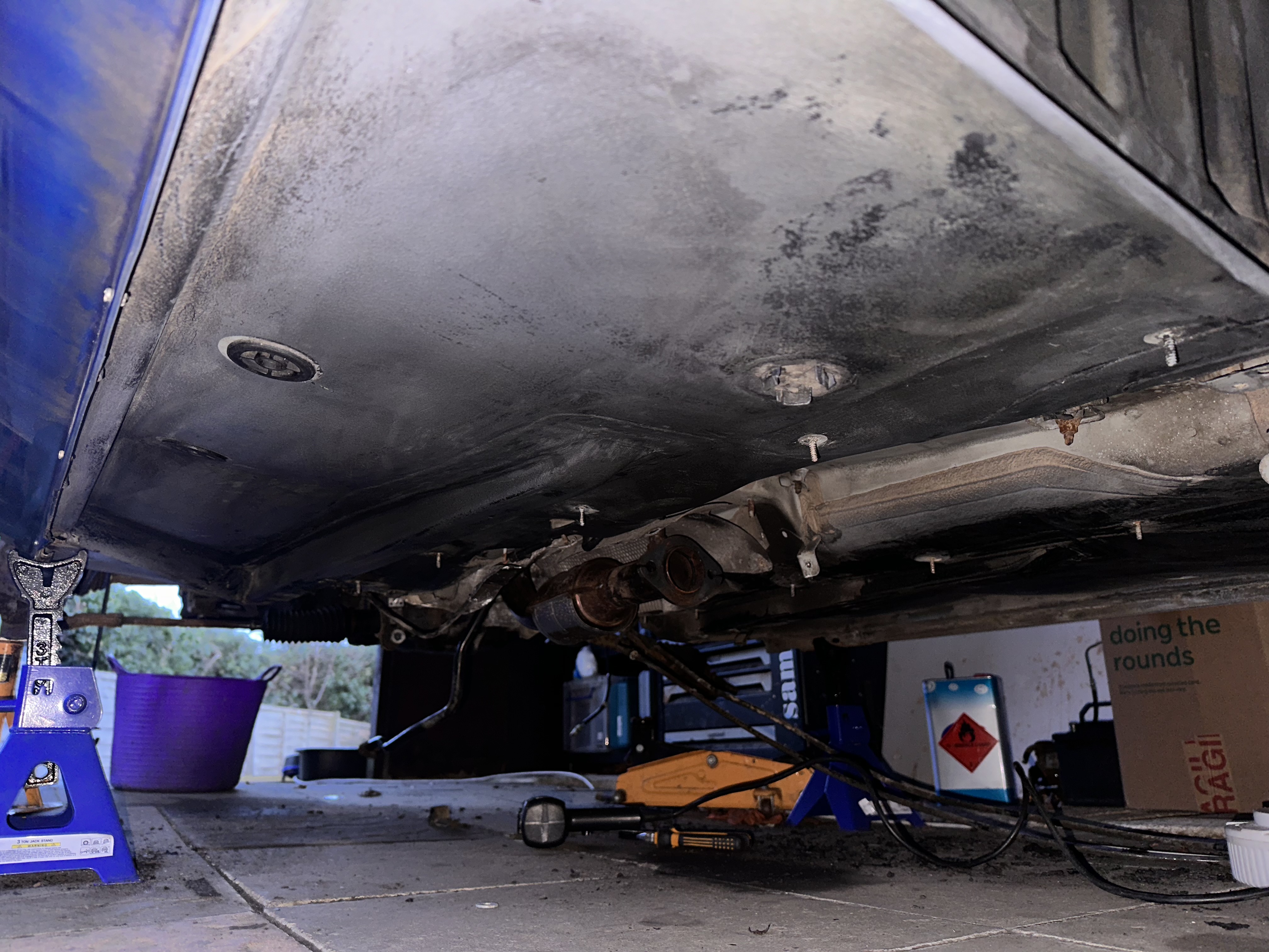

Some more progress on the Cup. What a ball ache to get the underside clean. It’s covered in some sort of rubber in the middle section that responds best to heat.
Ended up with it in my hair which was a pleasant experience. I reckon another day of prep at it will be ready to paint.
Underside wire wheeled back the best I can on just the rusty spots. Treated and sealed with Jenolite Rust converter. Much like hydrate 80 I believe.
More rusty bits treated. The underside is coming up nicely. It’s just very time consuming.

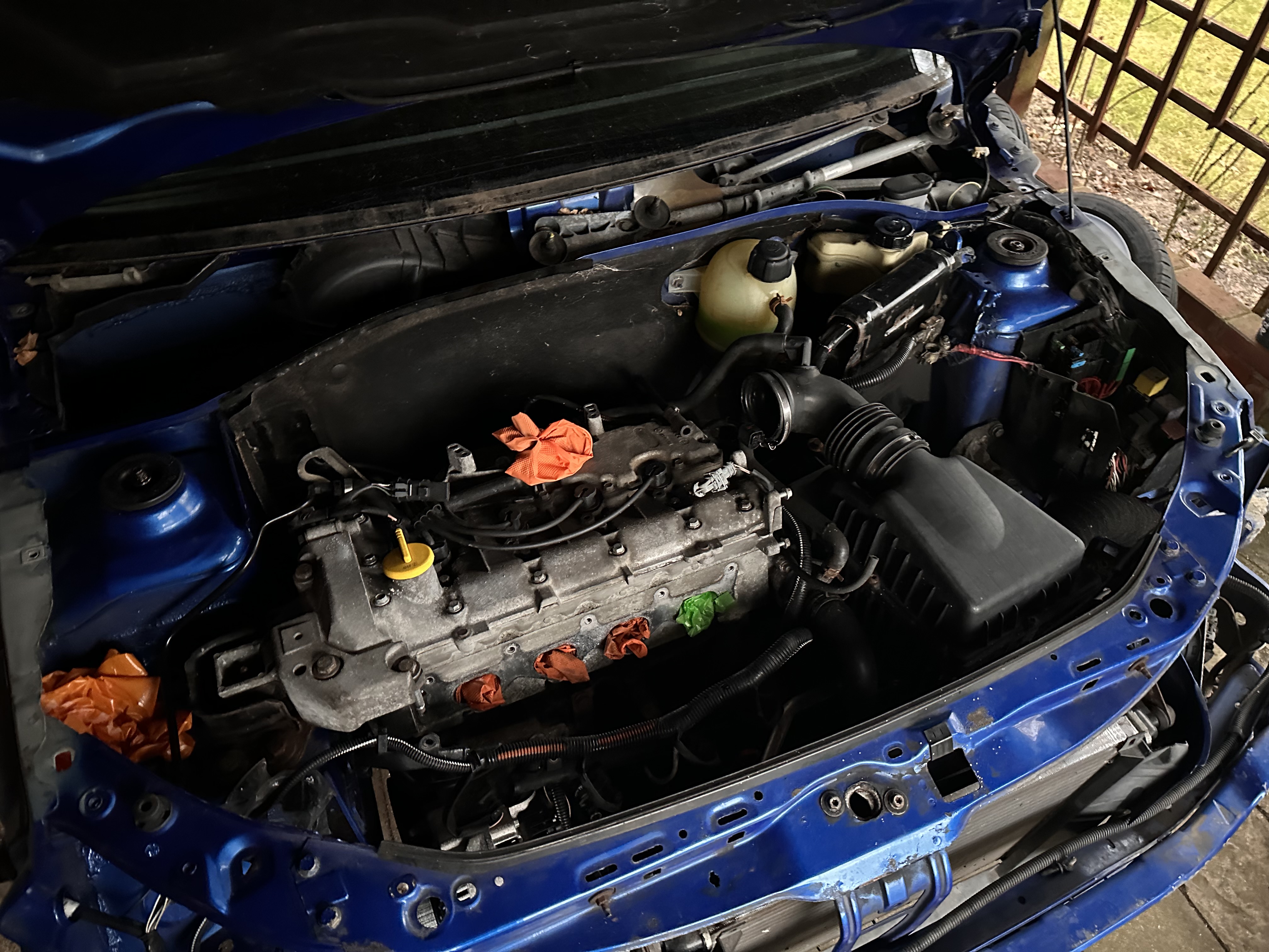

Decided to go all out on the engine bay. Got some MTC hoses coming too. Will retain OEM air box, but give everything else a proper cleanup.

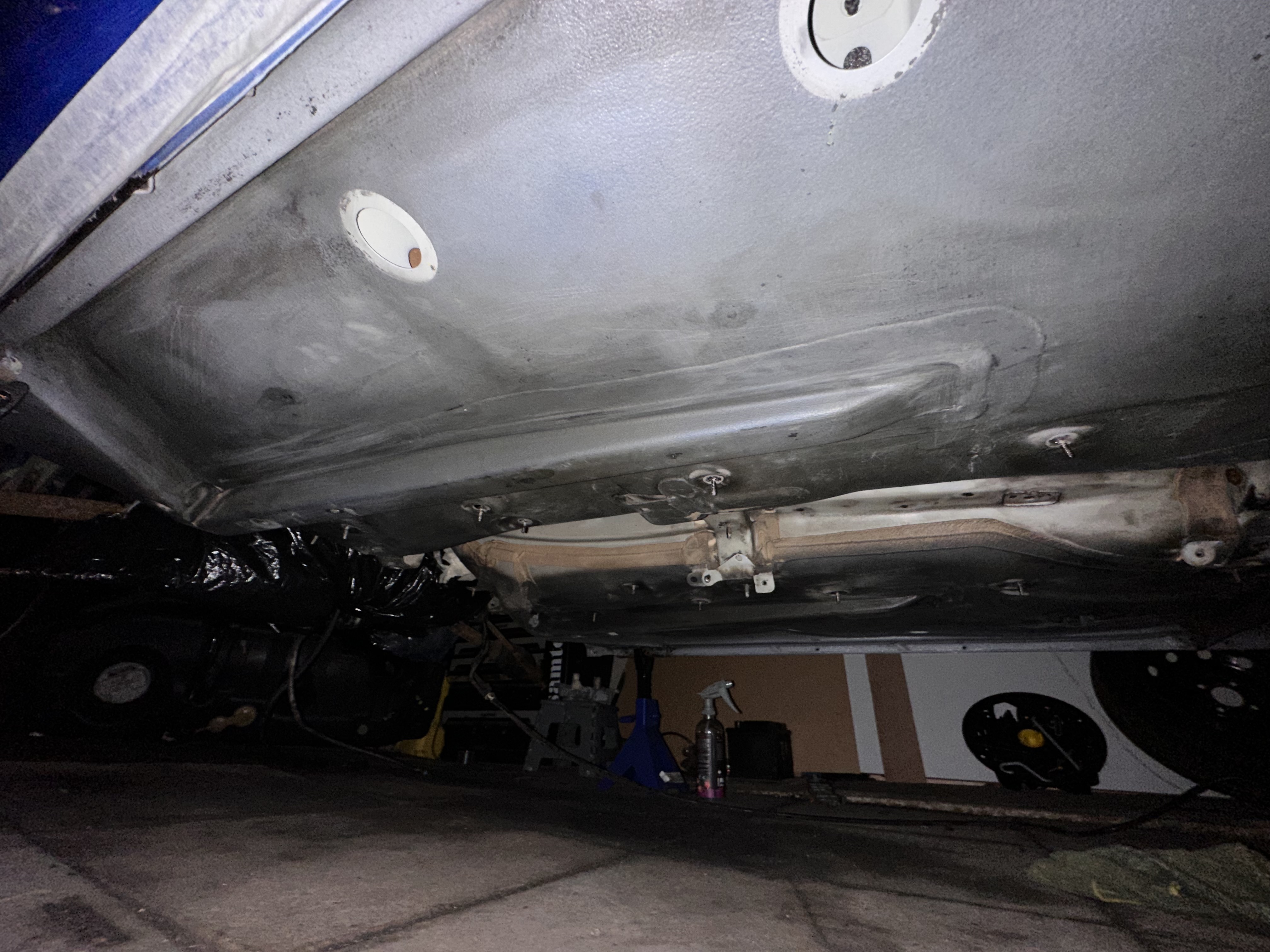

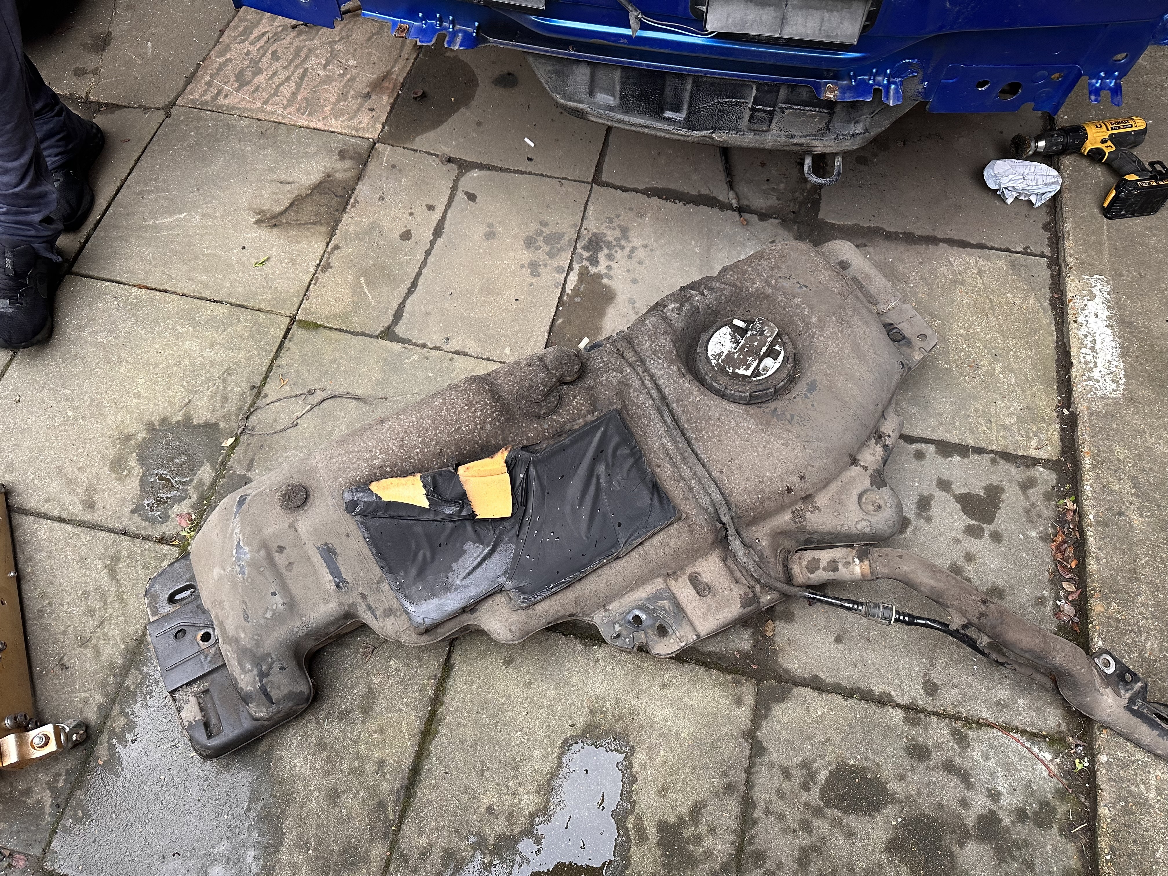

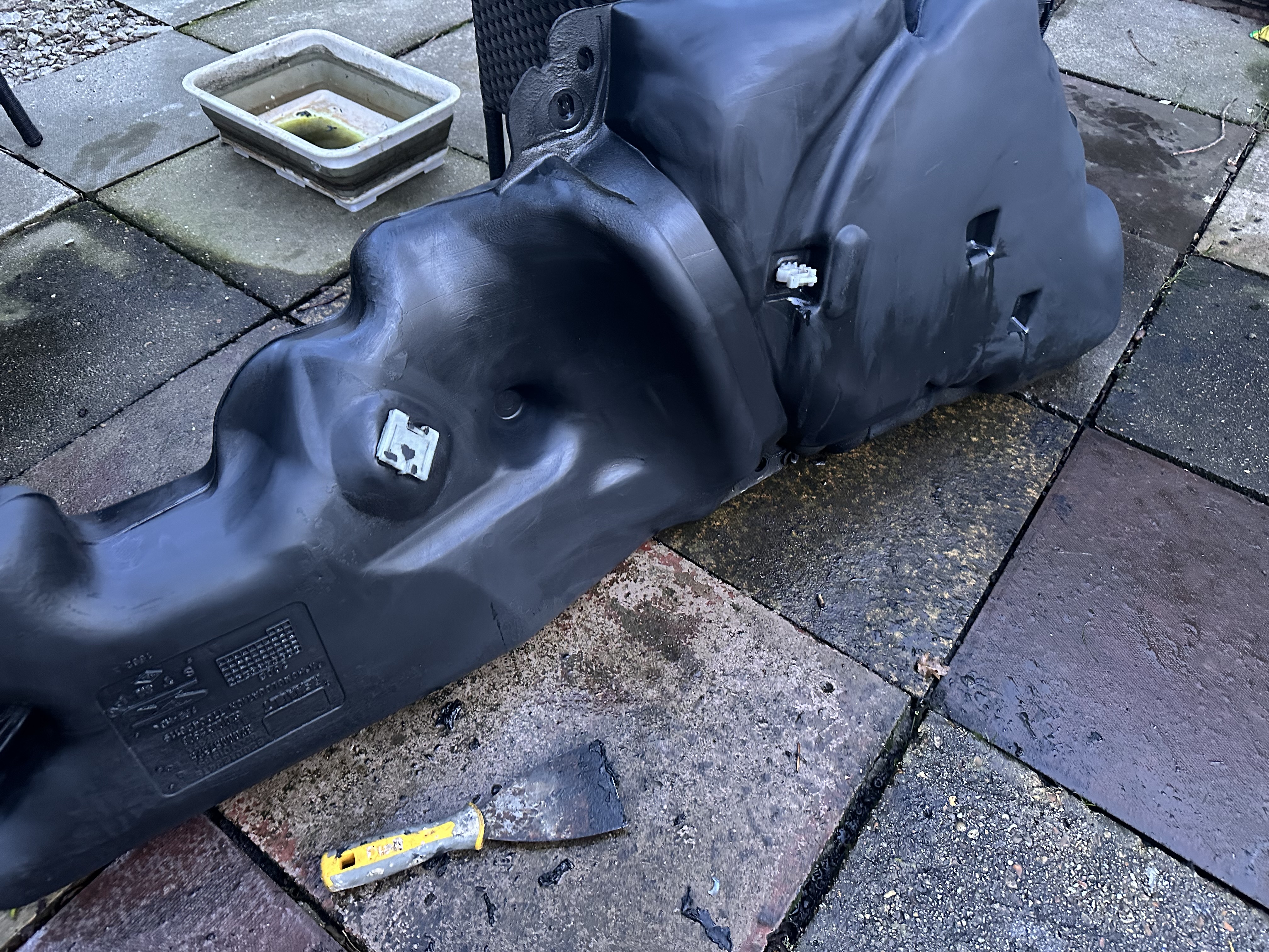

Also gave the fuel tank a bit of a clean. Looking good so far.
Got to get the bolts off to the platers and the subframe components to the powedercoaters next. Brakes are going off for a recon.

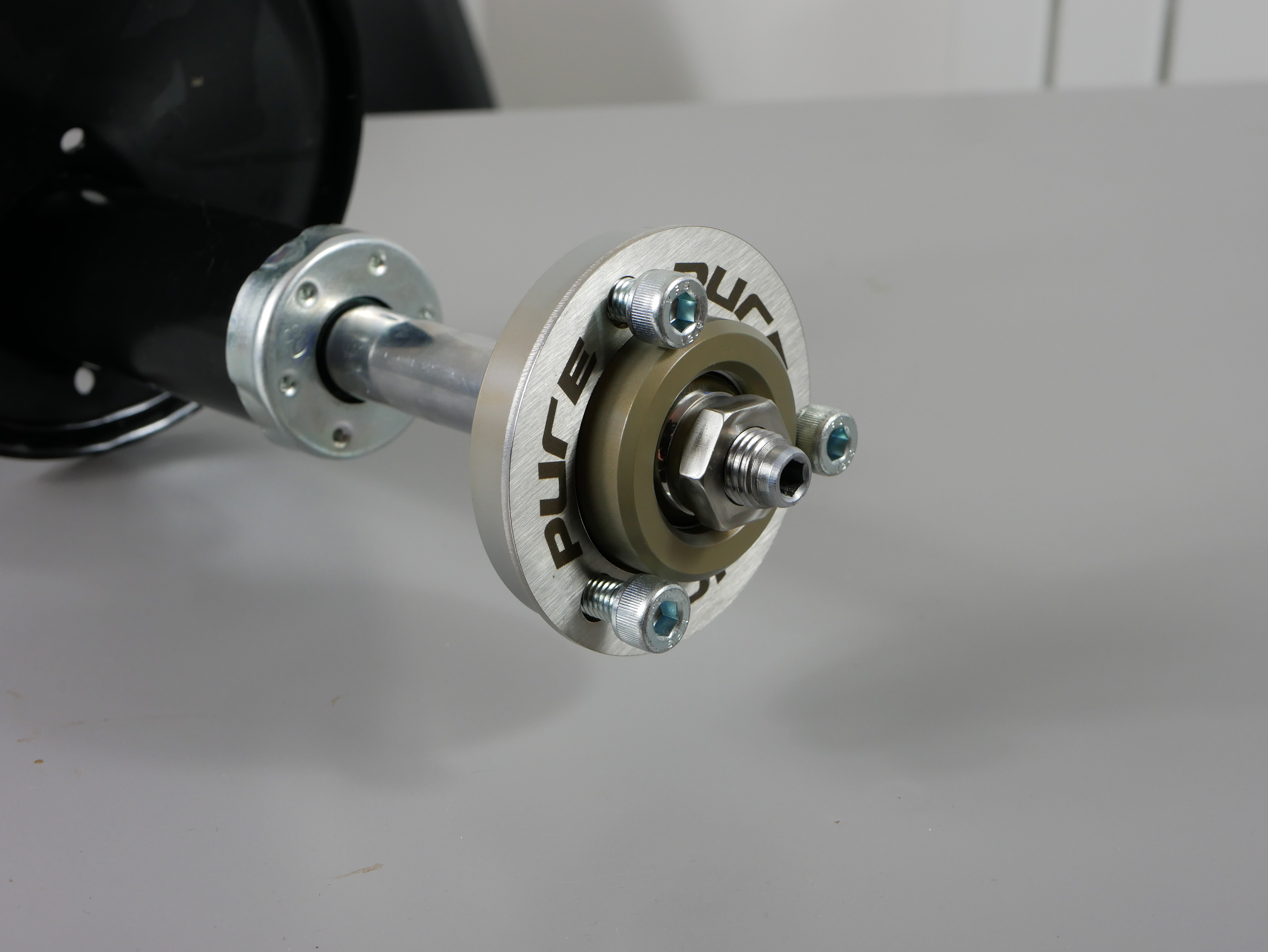

PMS solid top mounts.

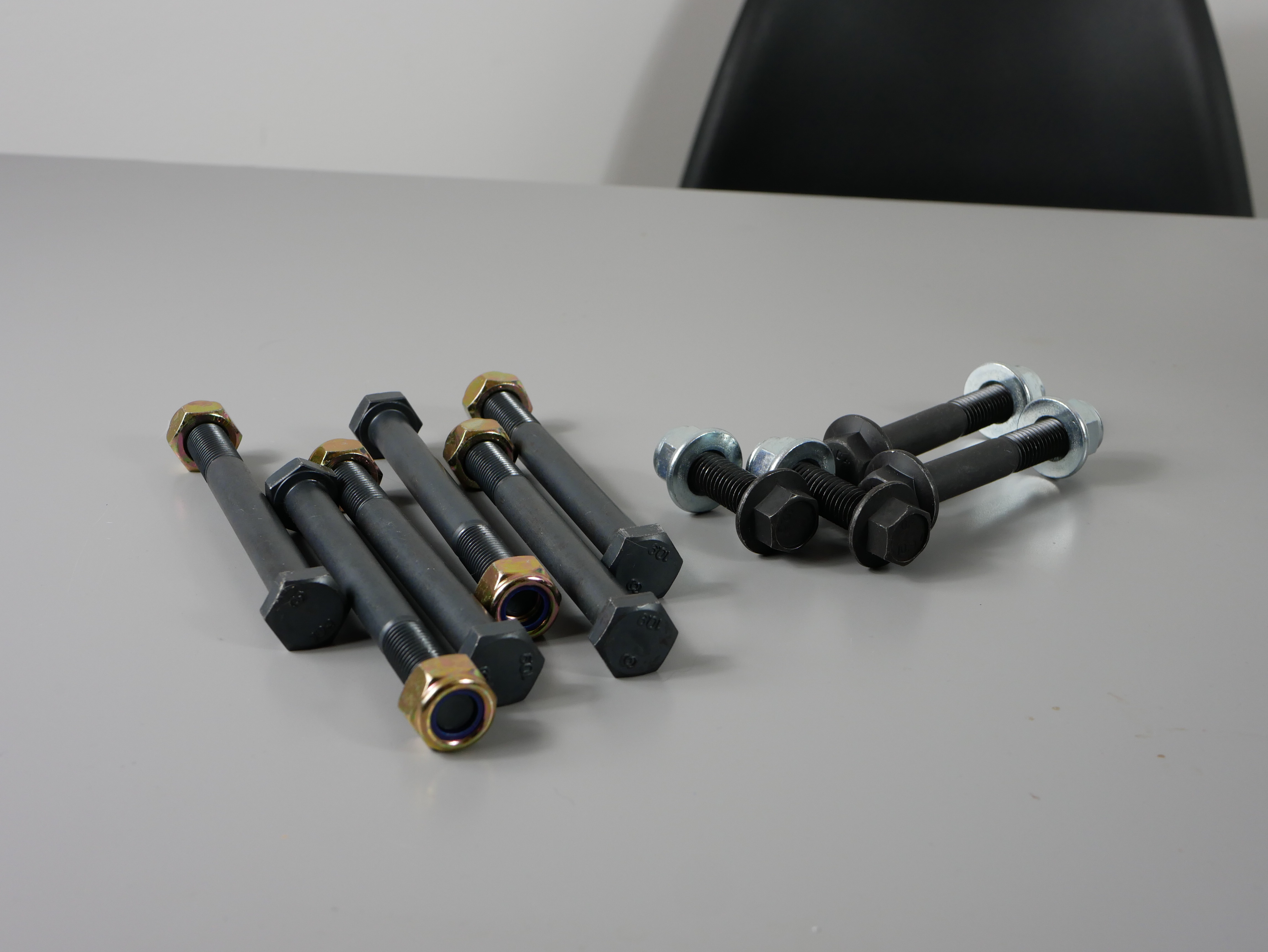

Stud and nut conversion kit.

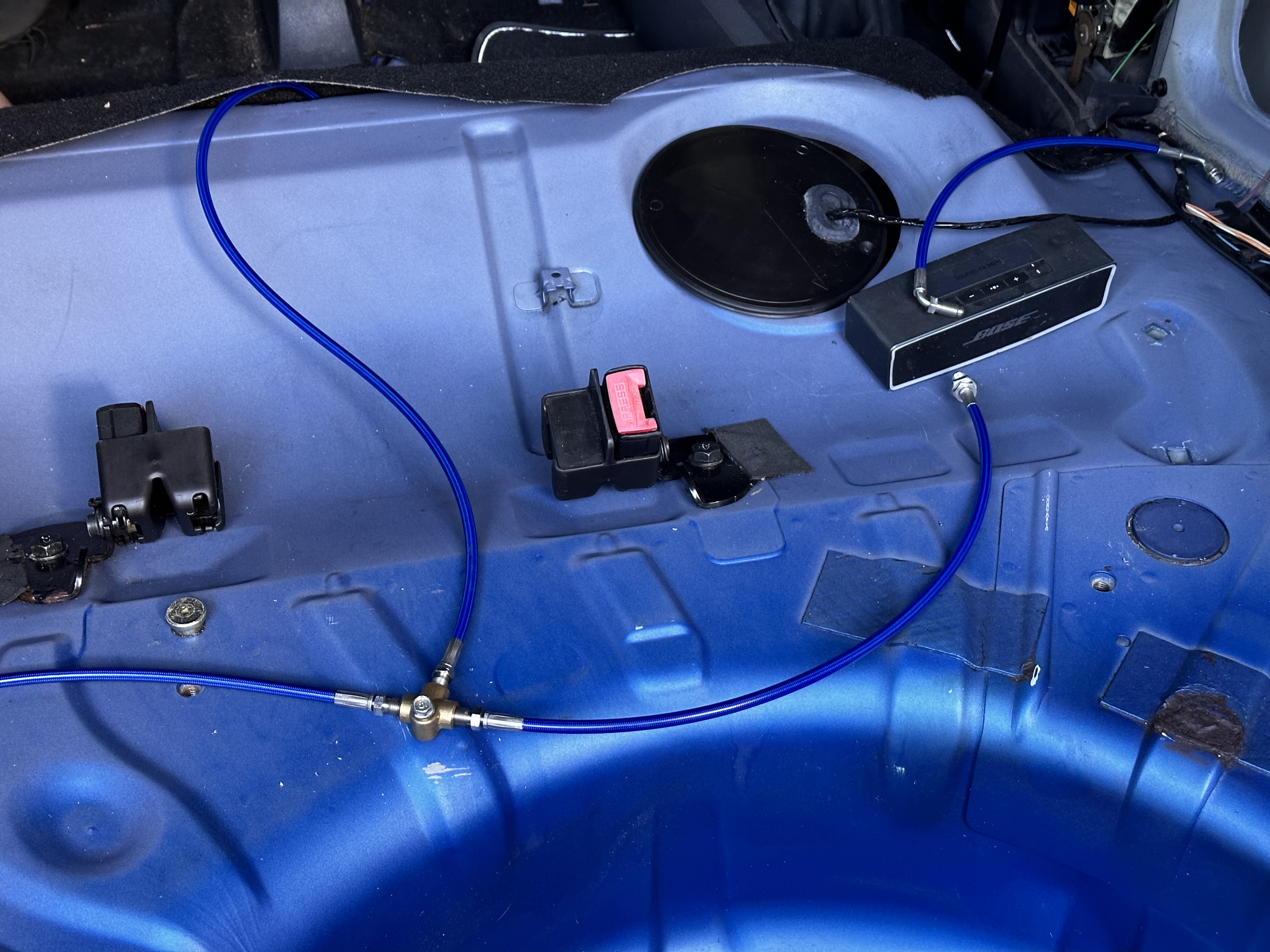

Full braided line kit from master cylinder with bias valve.

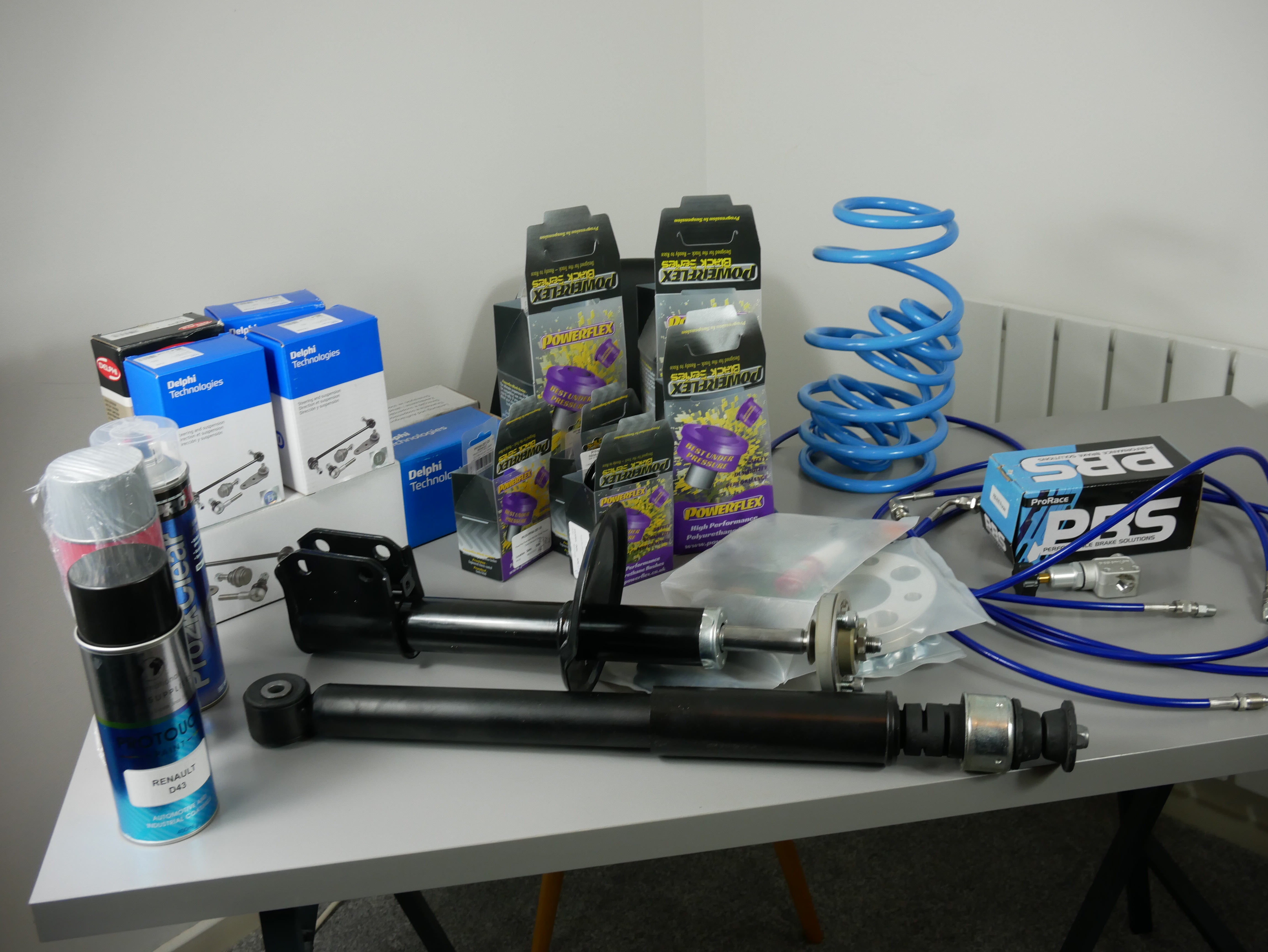

More updates on just parts because it's easier to take photos than it is to actually fit them. Getting on with the cleaning of the underside is proving time-consuming. Hoping to start painting the underside this weekend. Took some shiny part photos whilst filming a vid for YouTube.
Various bits including the fully braided lines. Also, paint for the underside. Planning on D43 mondial blue with 2K lacquer on top.
Powerflex, everything.
Opted for PMS solid top mounts to replace the knackered OEM ones.
New front/rear subframe bolts and nuts.

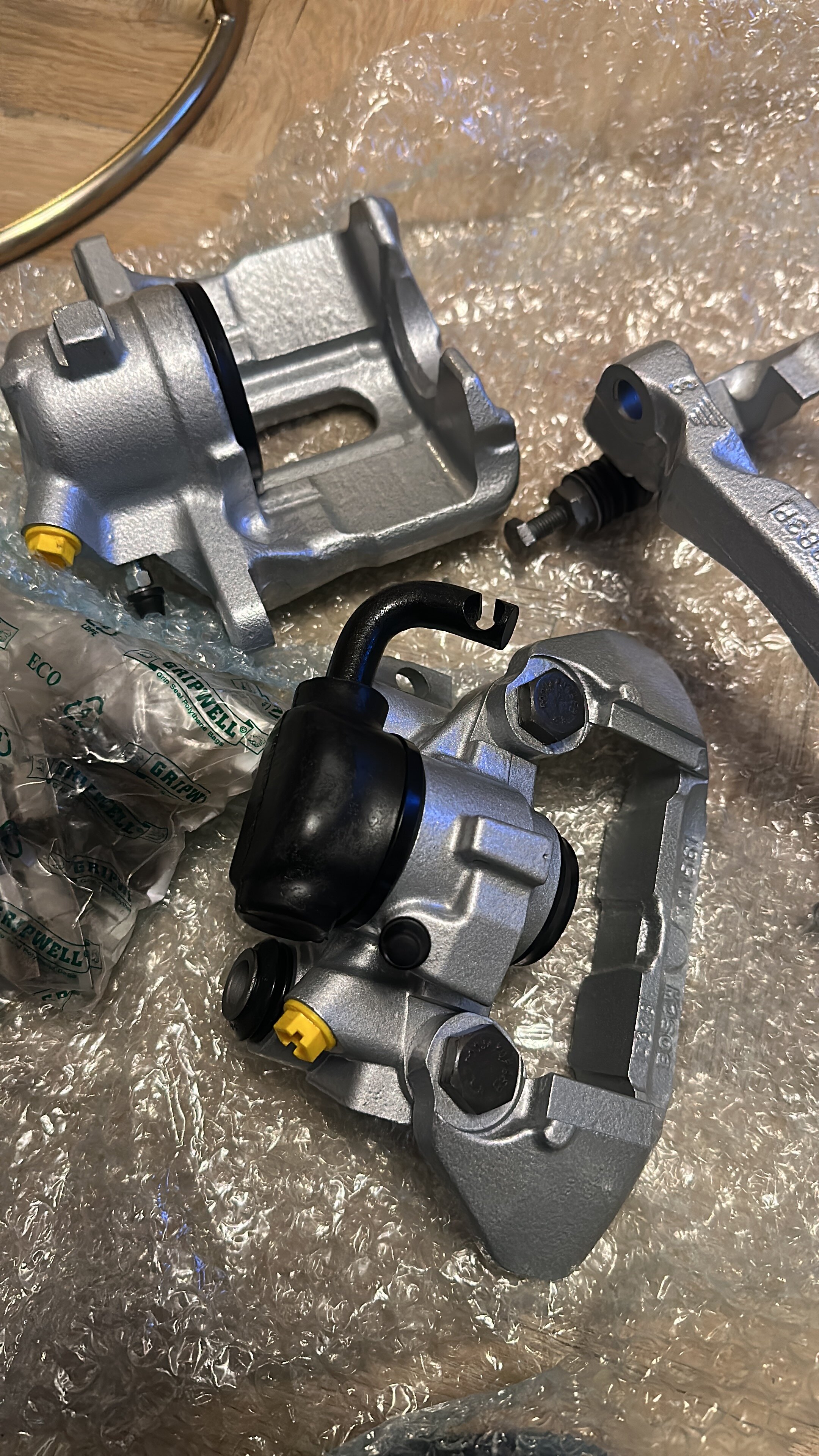

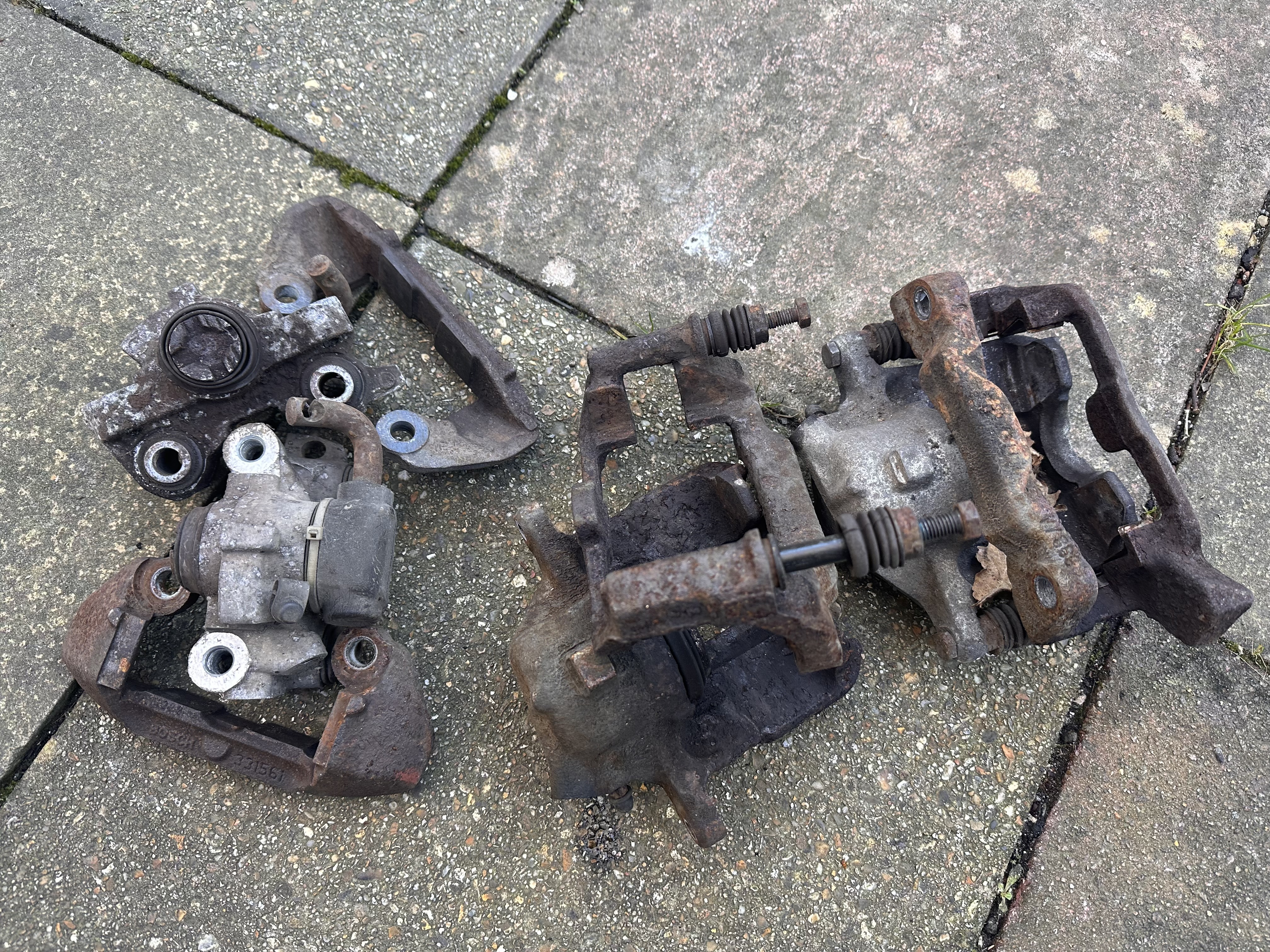

Also, refurbed/exchanged front and rear brakes turned up from SSL Autoparts. I am super happy with these.

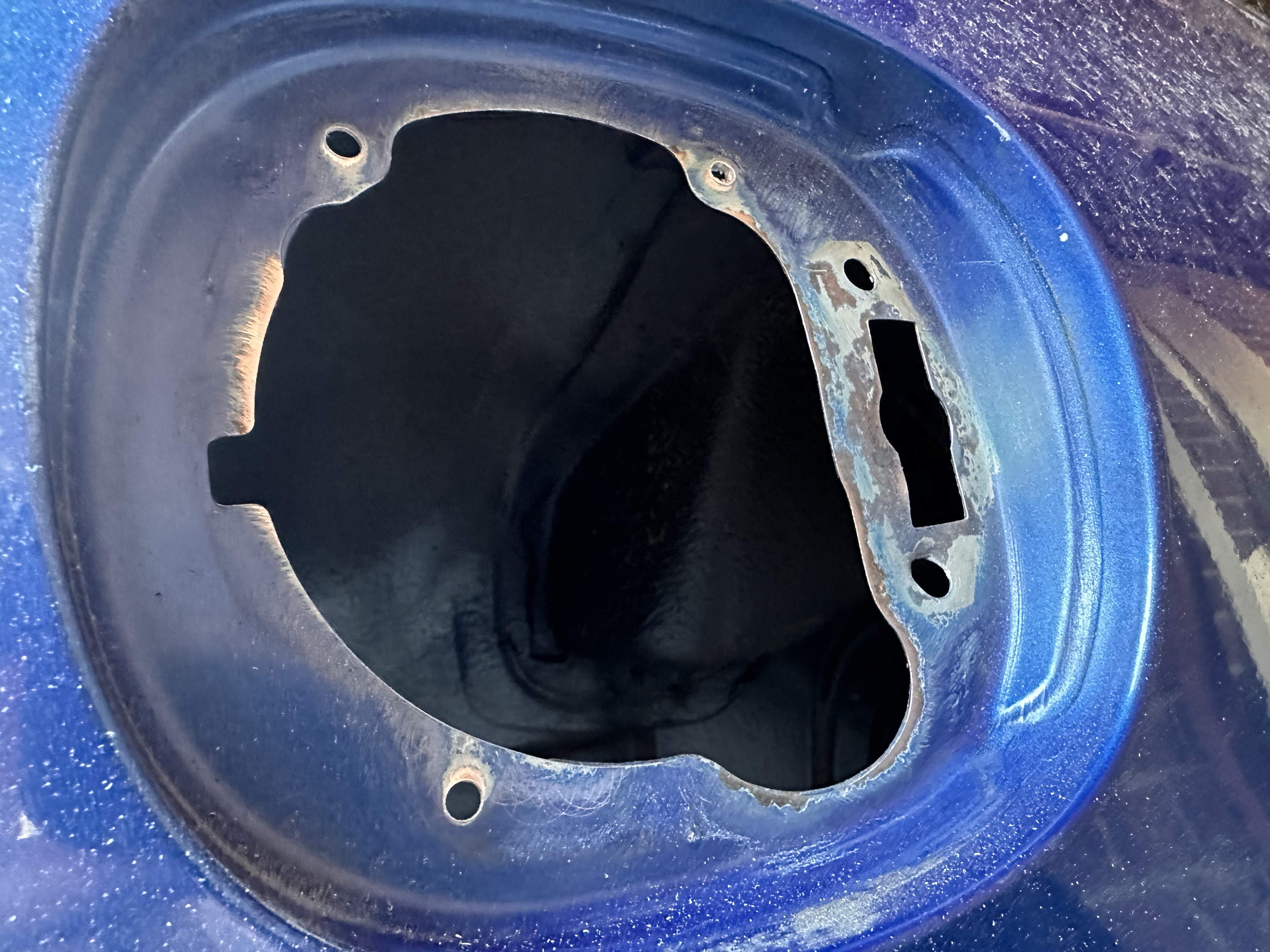

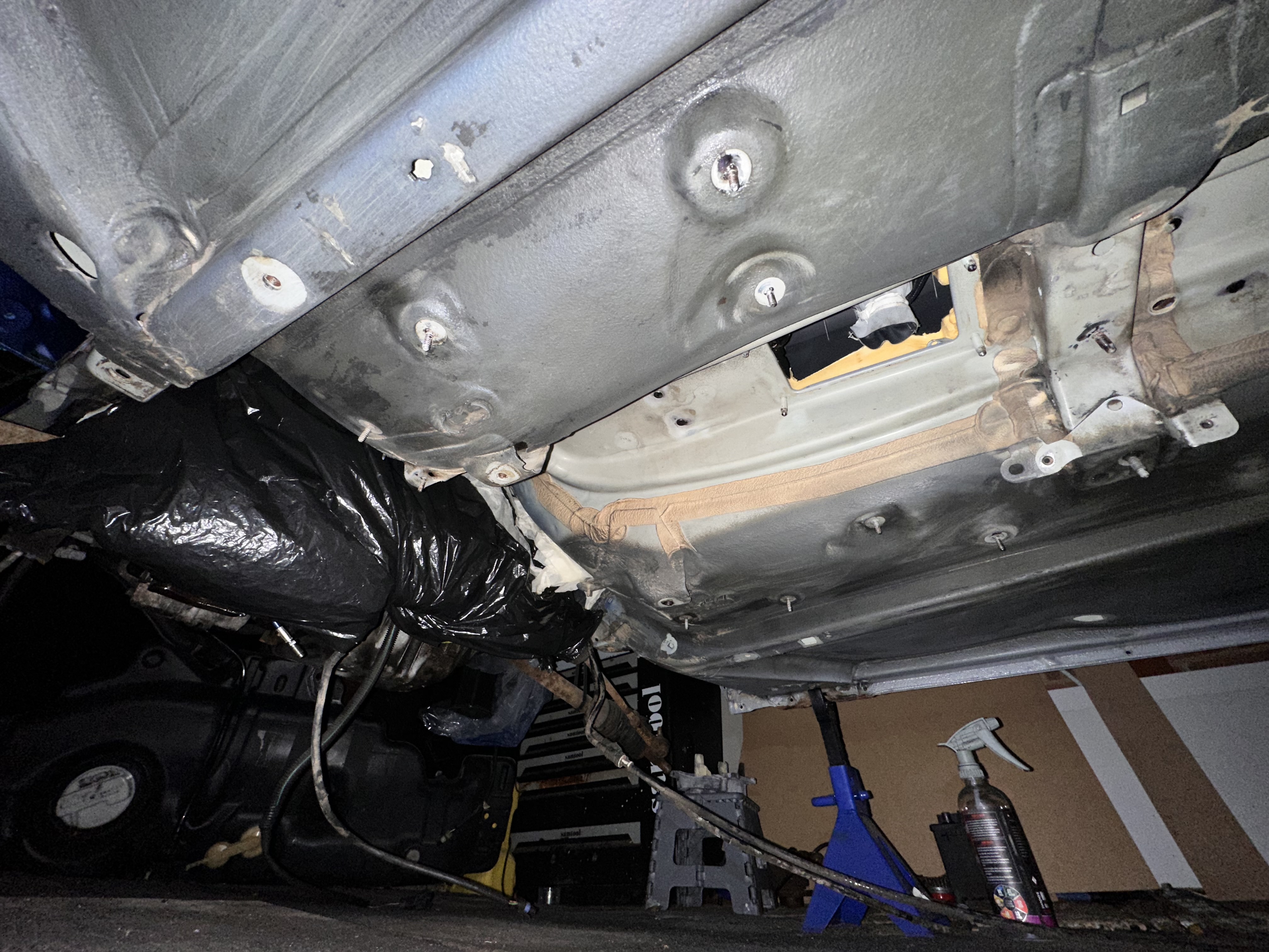

More progress today. I’ve treated the final parts of the rust around the fuel filler cap (what a god awful design that is).

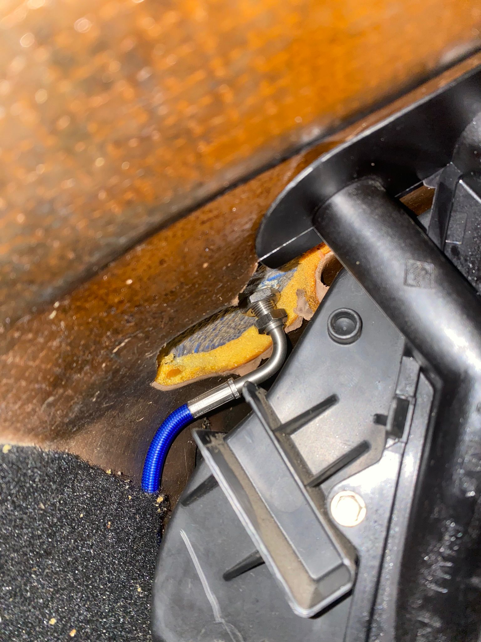

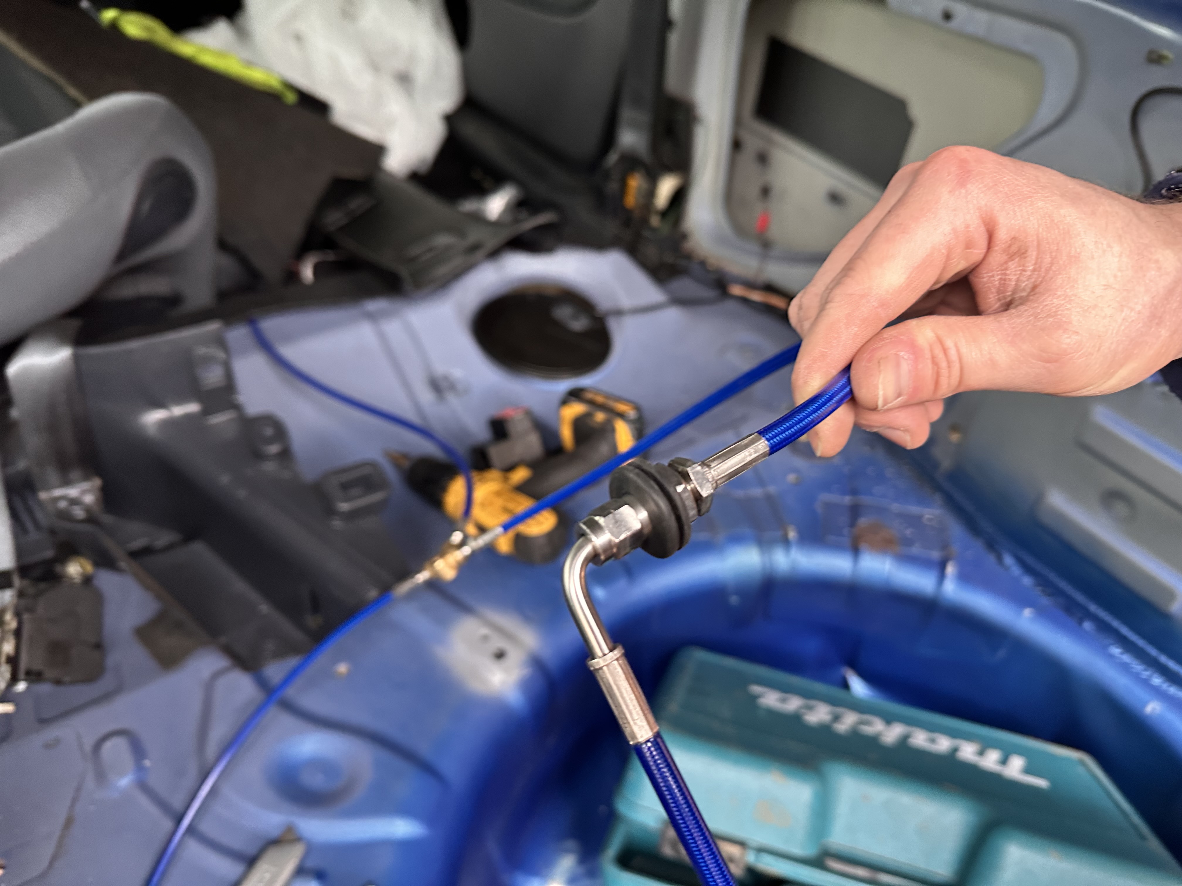

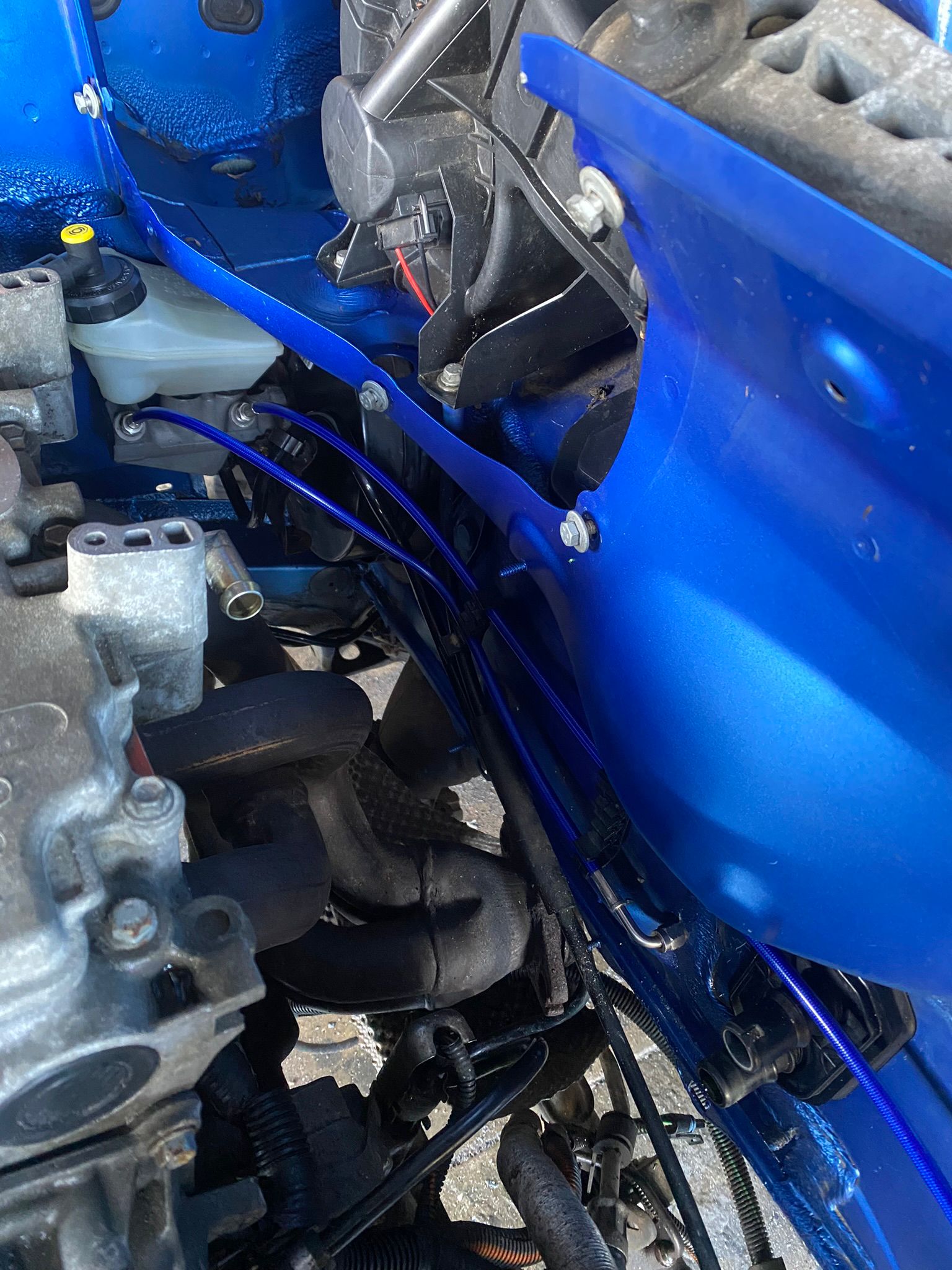

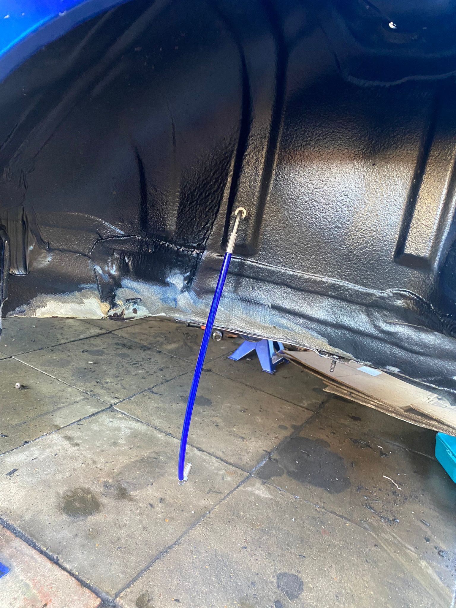

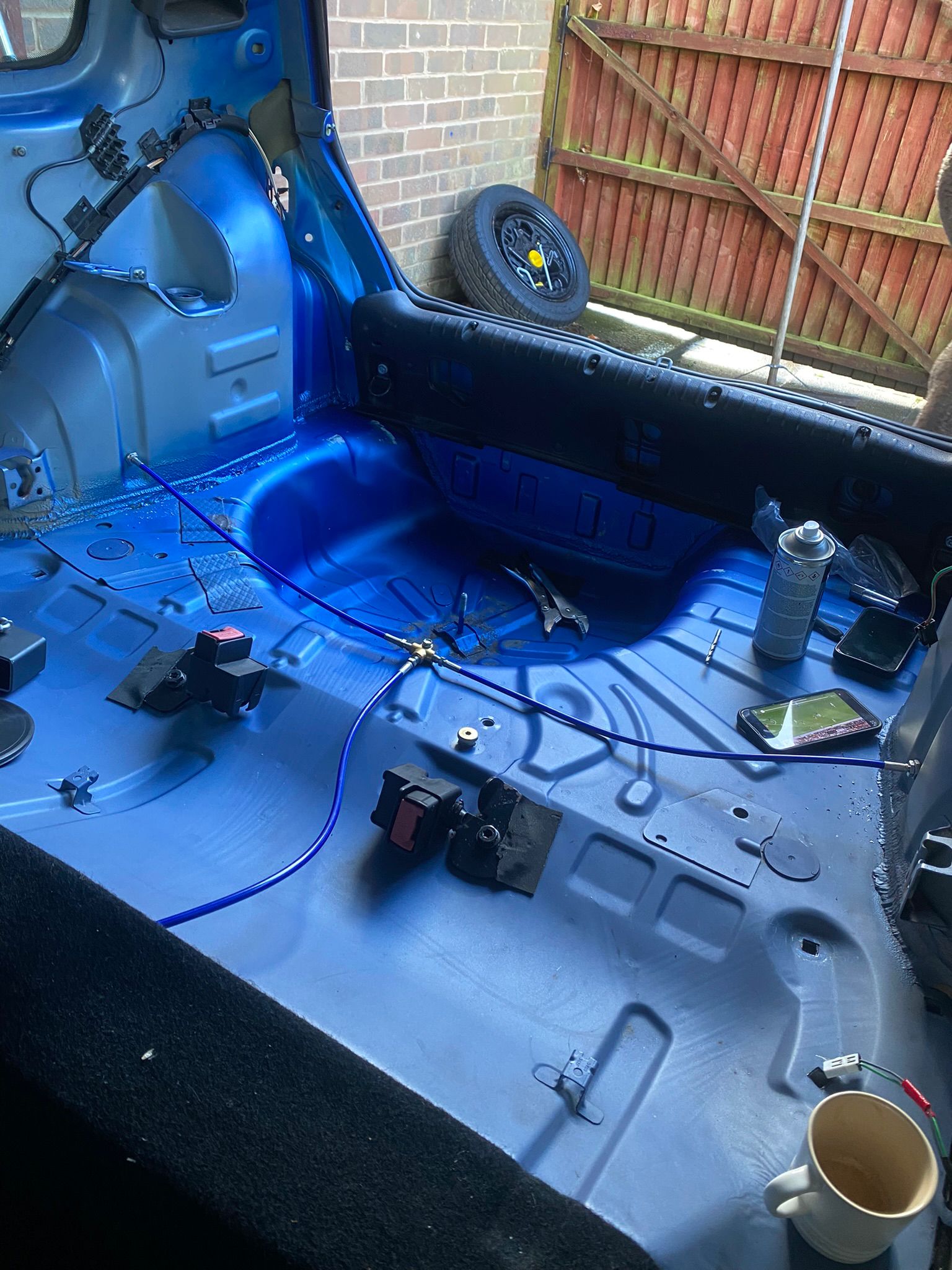

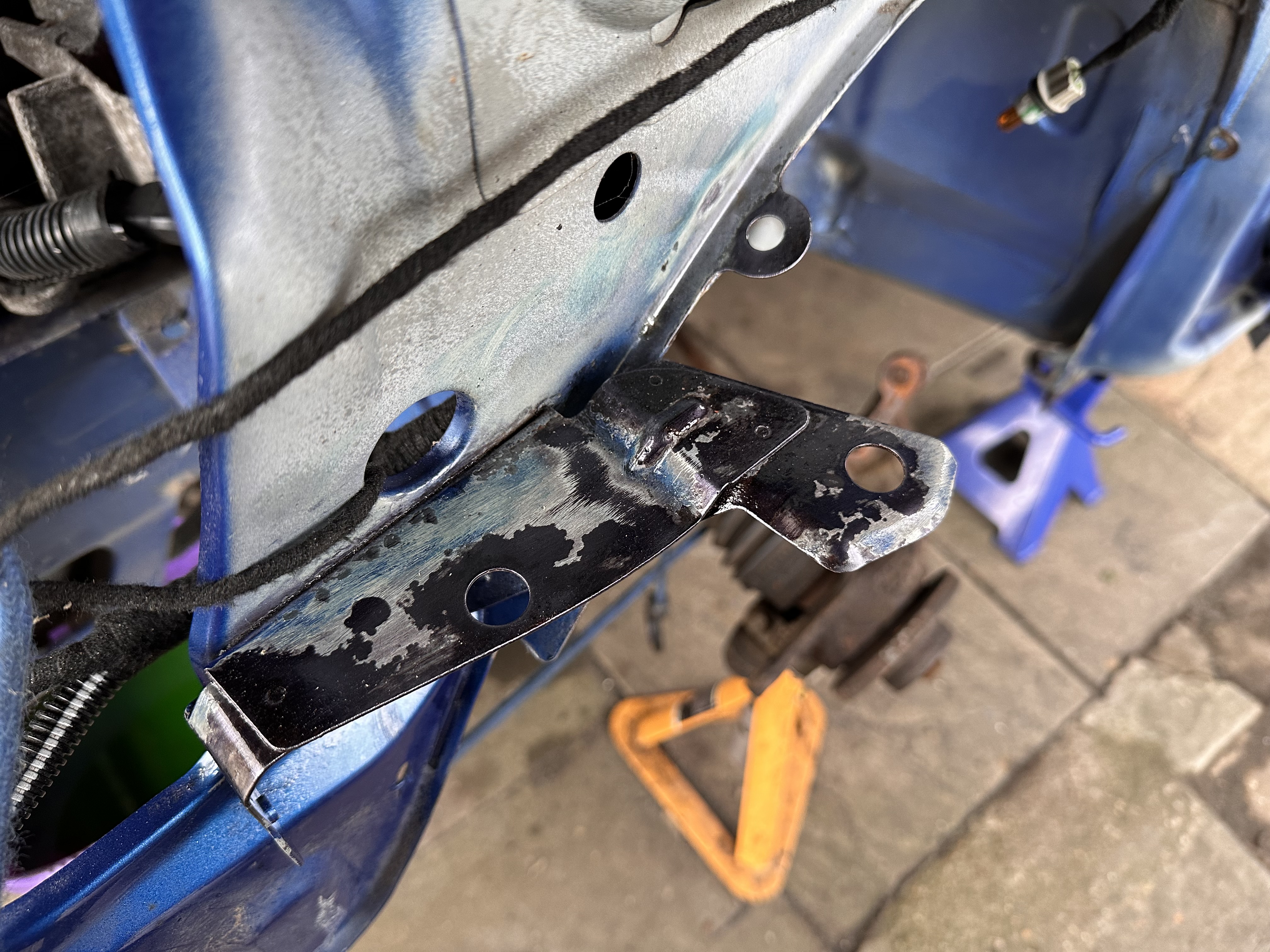

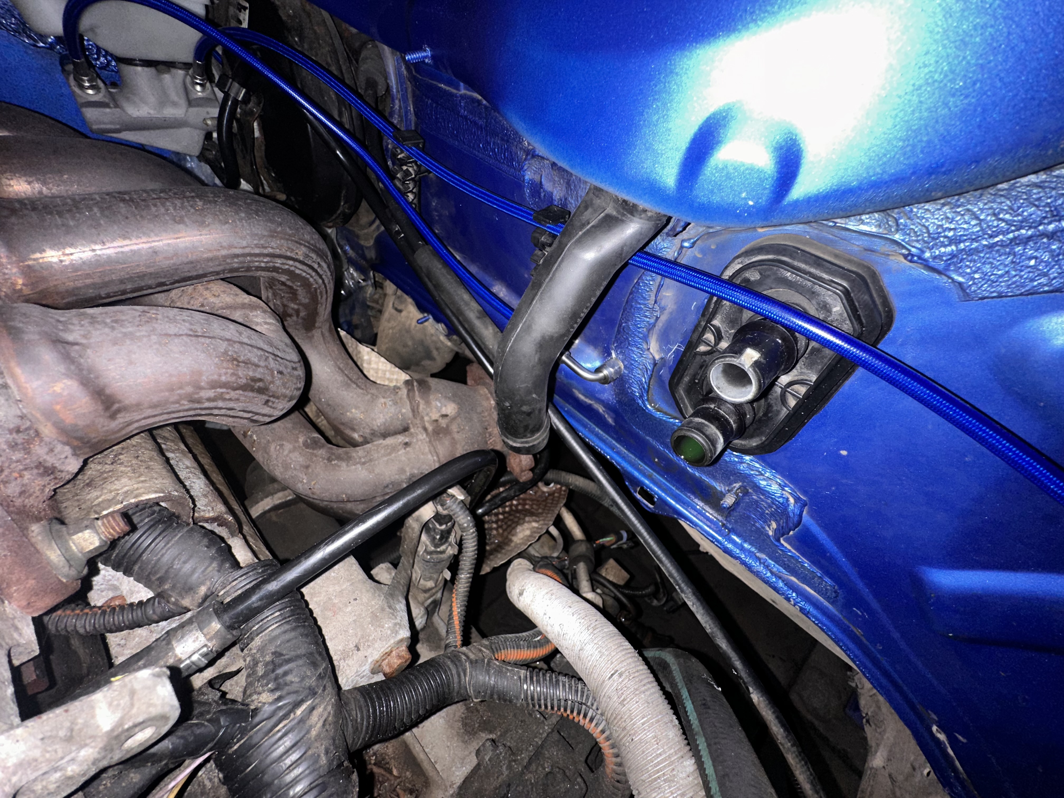

With the help of some friends I’ve also mounted the braided lines in the car and drilled the holes necessary through the bulkhead and rear arches.
This needed to be done first before I could spray the underside properly.
Used degreaser on the head and in the engine bay. This is as good as it will get I feel.
Main line runs through the bulkhead, into the passenger side of the centre console then crosses over and mounts to the side of the handbrake housing.
Then runs to the back, under the isofix which is quite nice, and then into the rear arches. I’ll have to purchase some heat sleeving for these.
Fuel filler cap sorted out. Was actually pretty good anyway, but I wanted to make sure.

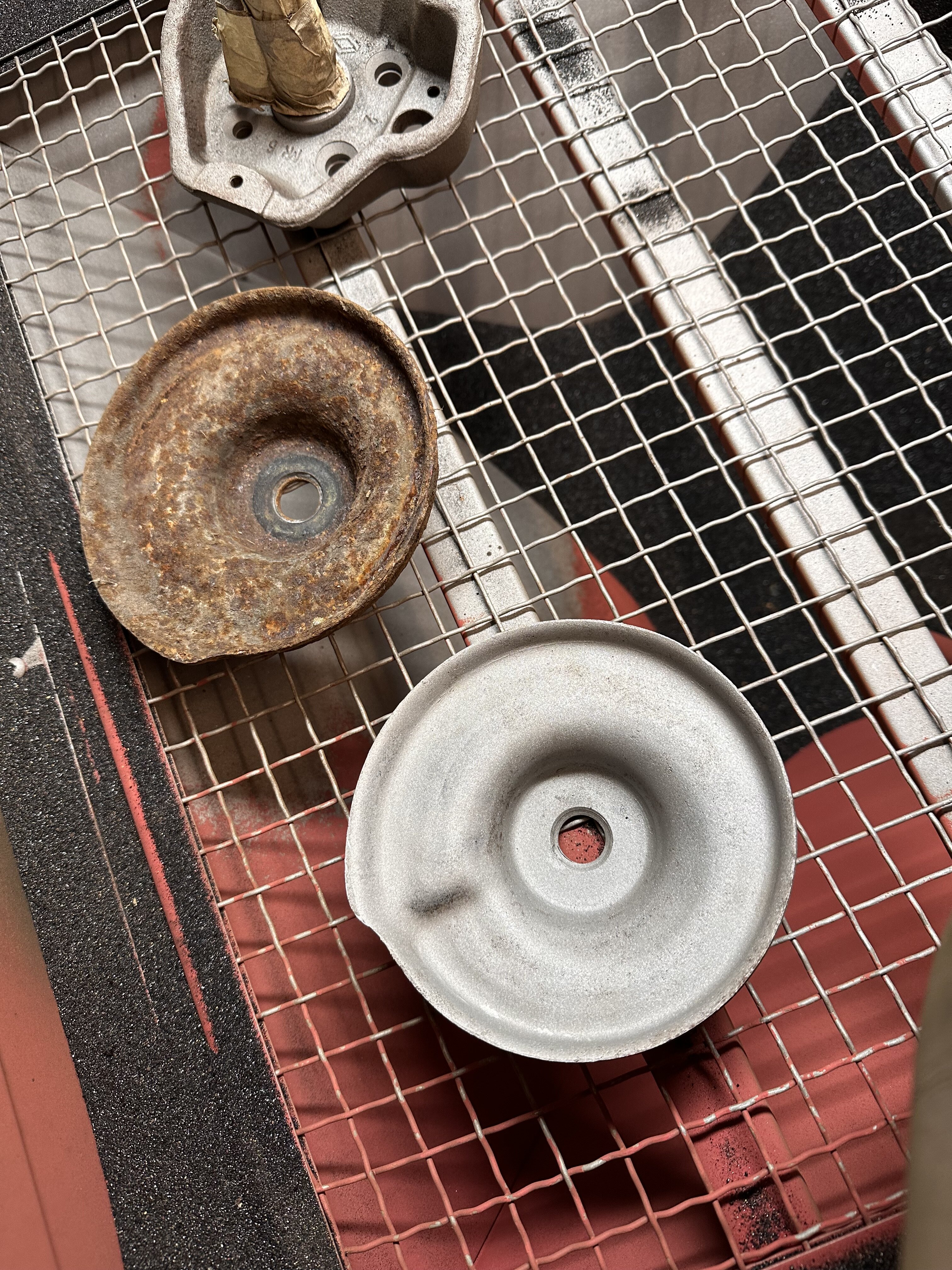

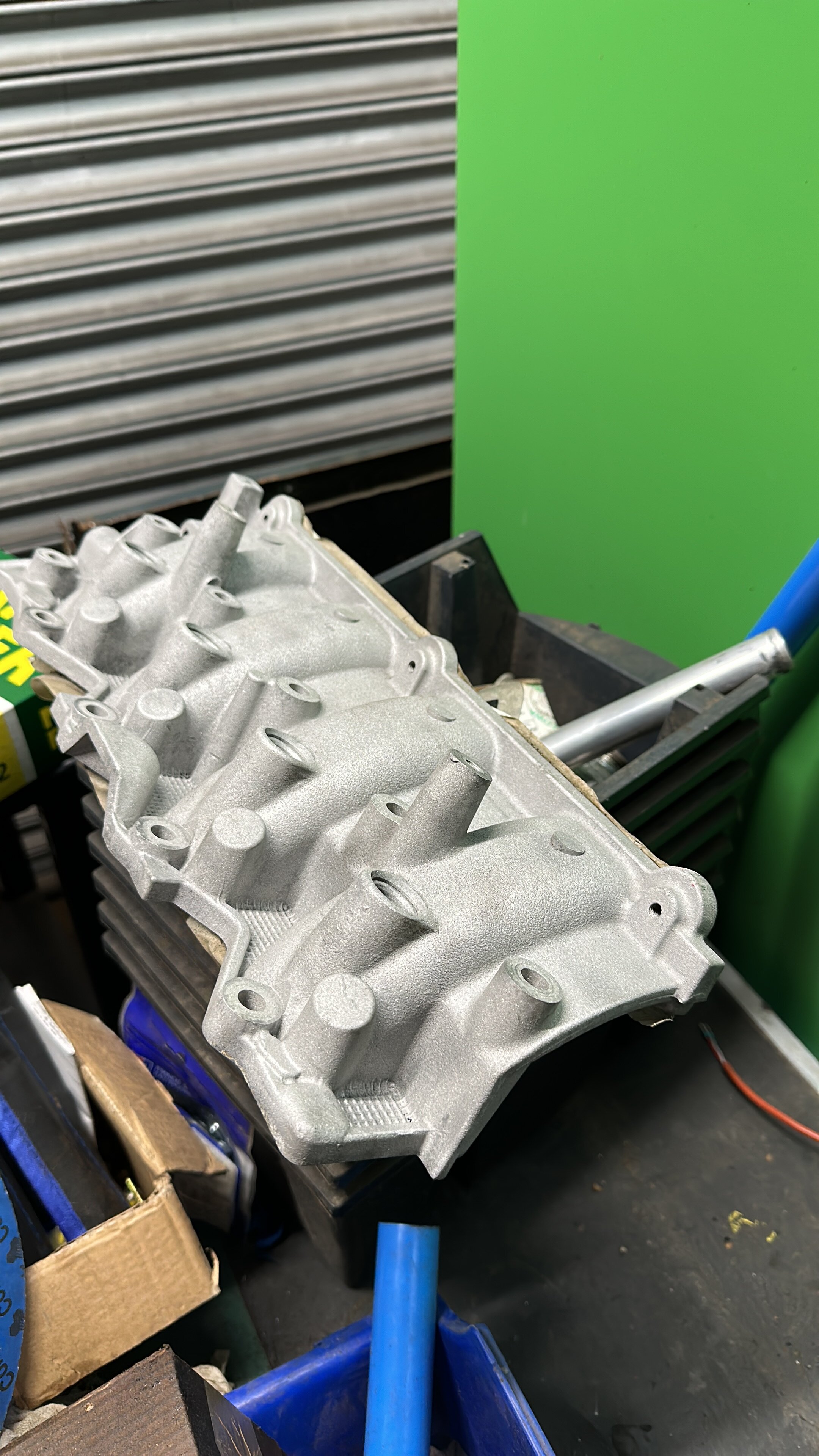

I’ve also blasted some bits. Stub axles blasted, heat shields and the fuel rail/lower inlet.

What’s the reason for the lines being inside the car as opposed to underneath where the factory ones were?
Great work mate 👍🏻
Thanks mate. This is just because it’s easier to run them this way, as the bias valve sits inside the car and can be a adjusted whilst I am driving. It also eliminates the risk of the hoses being damaged by stones etc.
Most people that run this have already stripped their interior as its more of a ‘track car’ mod. But the valve on the rear beam was knackered, so I thought I’d give it a go.
Most people that run this have already stripped their interior as it’s more of a ‘track car’ mod. But the valve on the rear beam was knackered, so I thought I’d give it a go.
Got you, makes sense now.

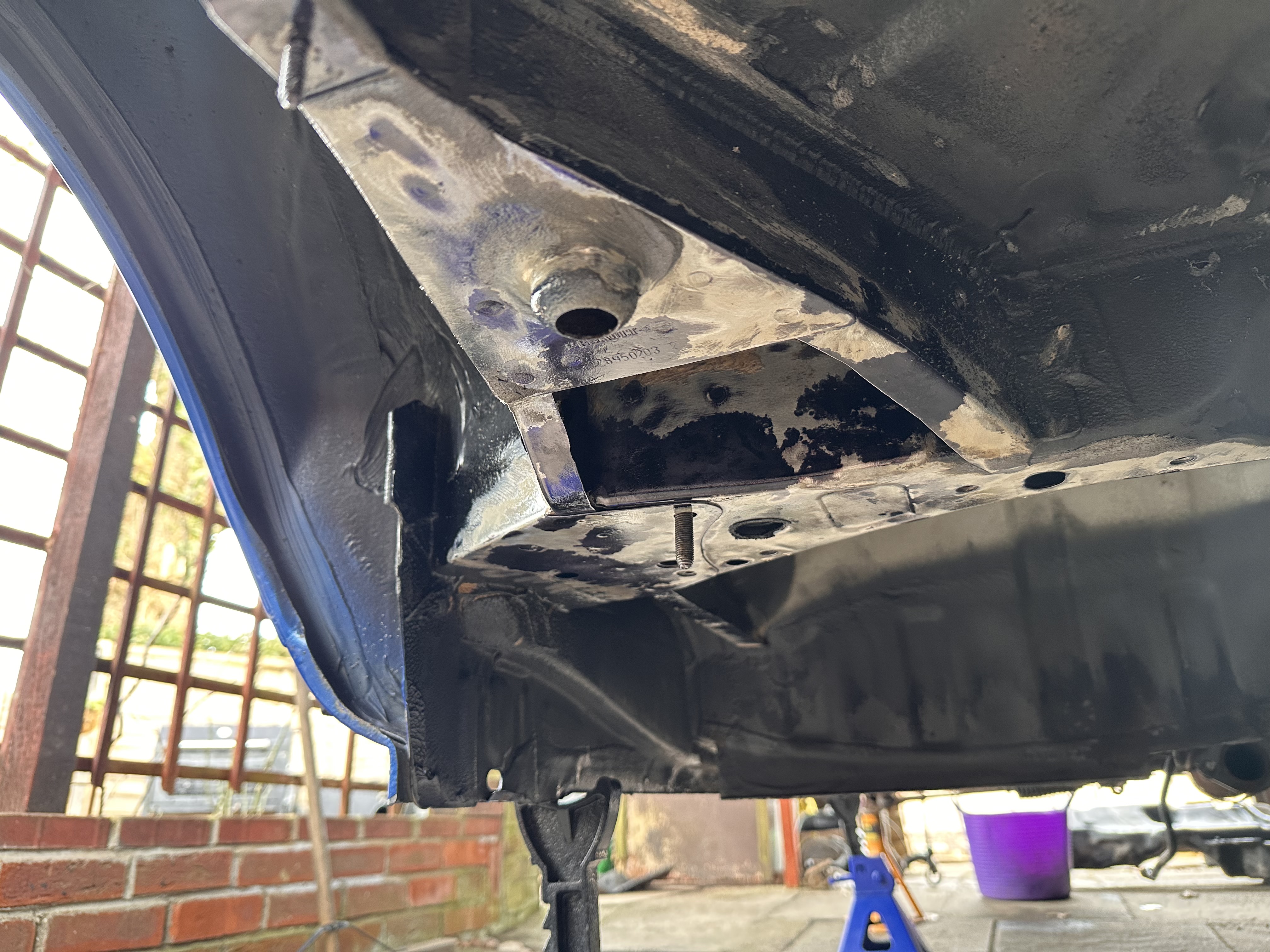

Right, this is how it’s looking after many many hours, maybe even days of trying to treat, prep and clean underneath.
The process has been a combo of grinding, wire brush drill bits and tar remover to get here. All rusty bits have been treated with Jenolite.
Being totally honest, I can’t be bothered anymore. Time to start painting I think.
Also made a slight change to the rear lines and their position, as well as added a rubber grommet to each side to add protection to the fitting.
In two minds about using the PMS top mounts. I feel reluctant to drill the top of the struts. What are others thoughts?
Might seem a bit stupid to some, seeming as I've already drilled holes on the lines. But I am leaning toward OEM top mounts.

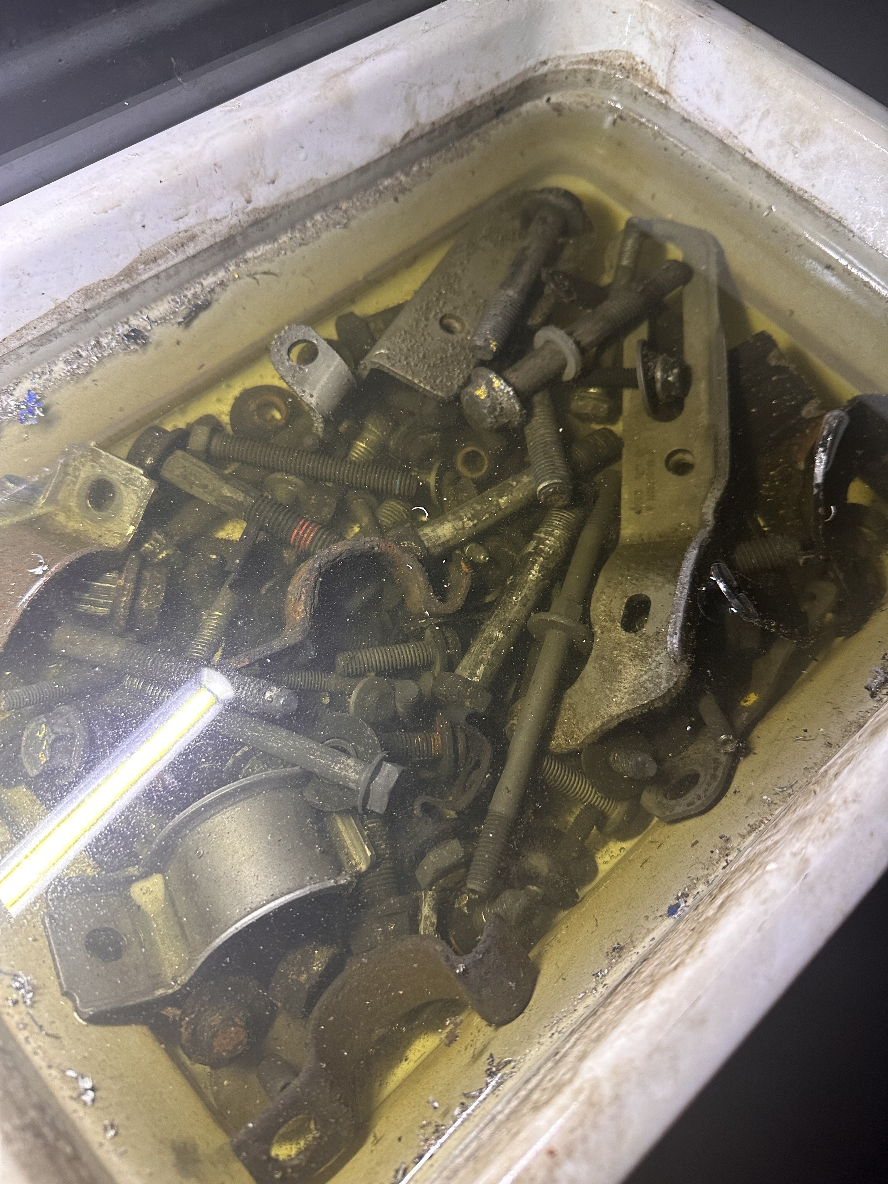

Got the bolts back from the platers. Used Deox C to strip them back and then took them to a local company. Asked for them to be finished in blue zinc. Really happy with them.
