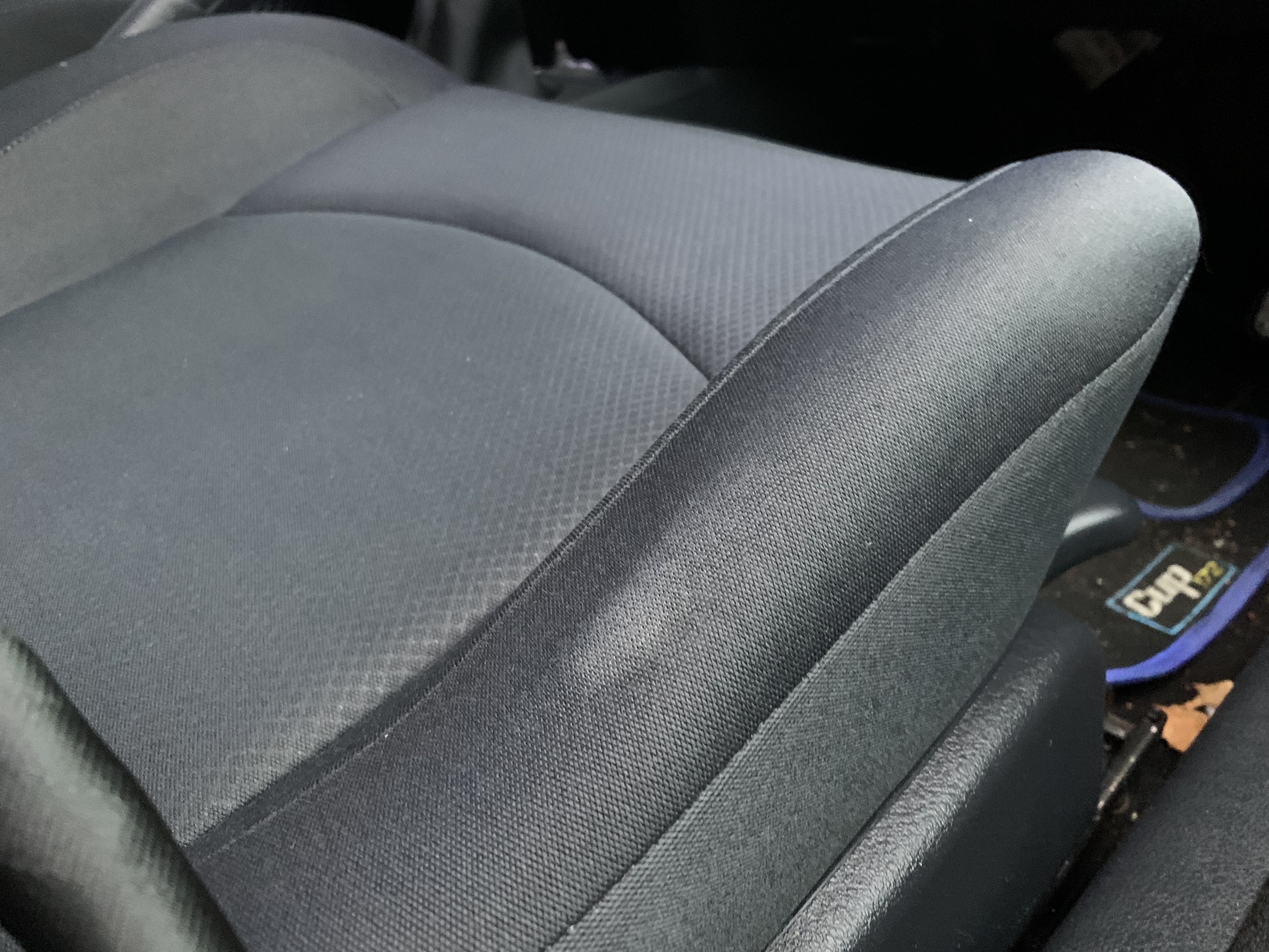

Bolster wear…. Is there anything that can be down to limit this for now?
Trying my best not to cause more wear when getting in and out of the car.
Just have a new patch put in when the time comes?
Otherwise have you tried moving the seat back to let you get in easier? I've found that helps in certain cars.
Yes, probably the best bet to be fair. And no, haven't tried that but will do. Losing weight would probably help too :ROFLMAO:

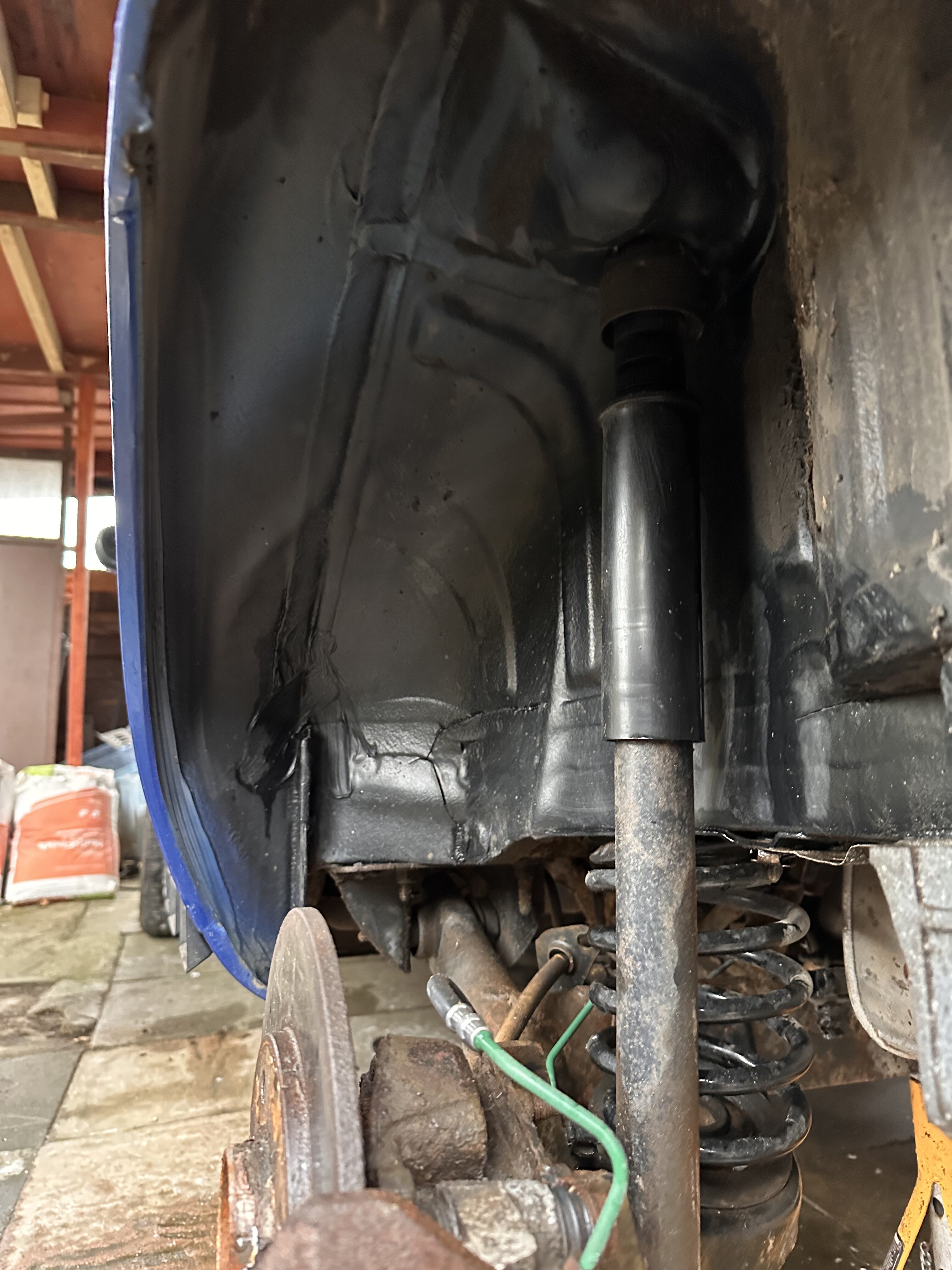

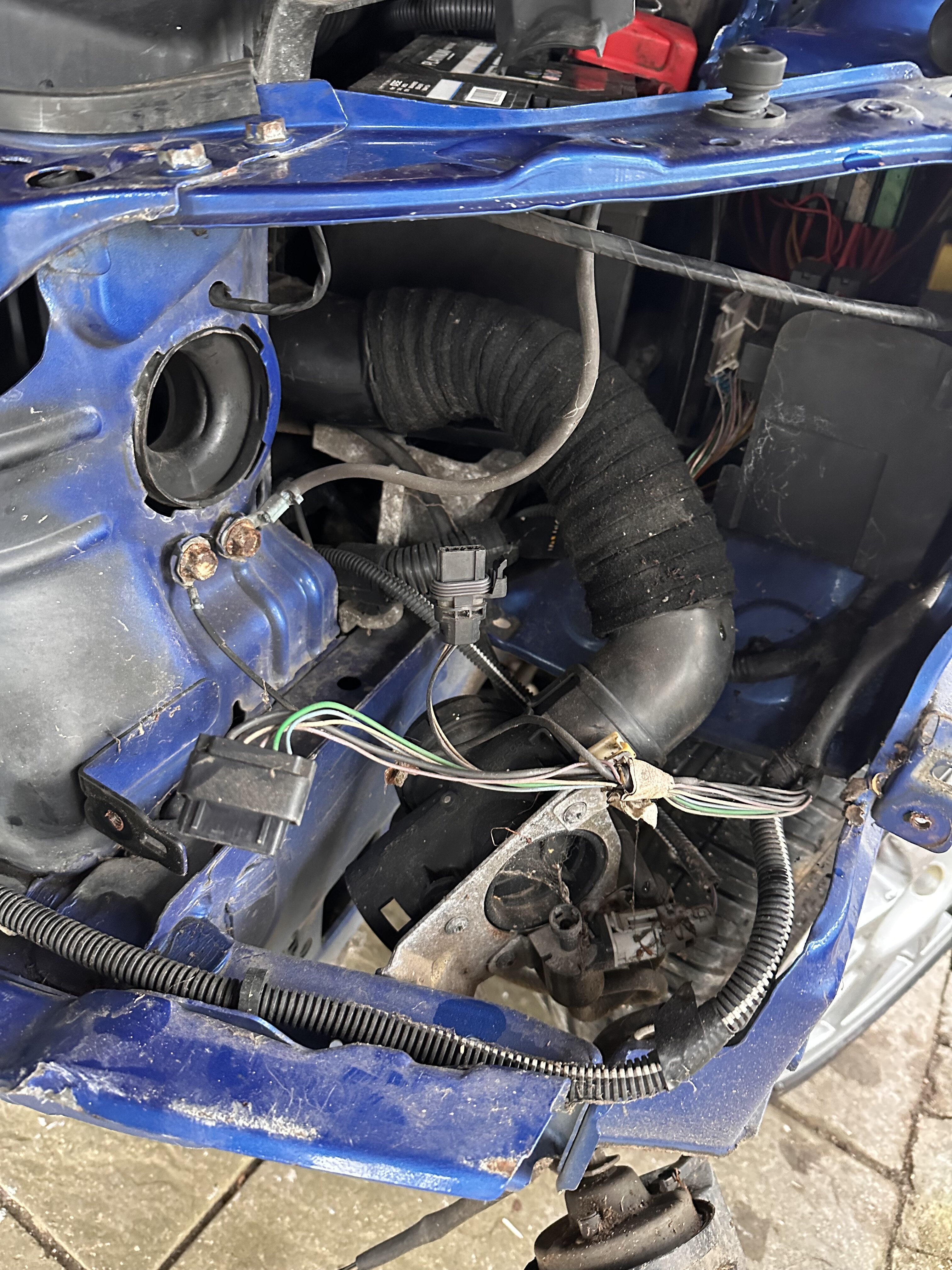

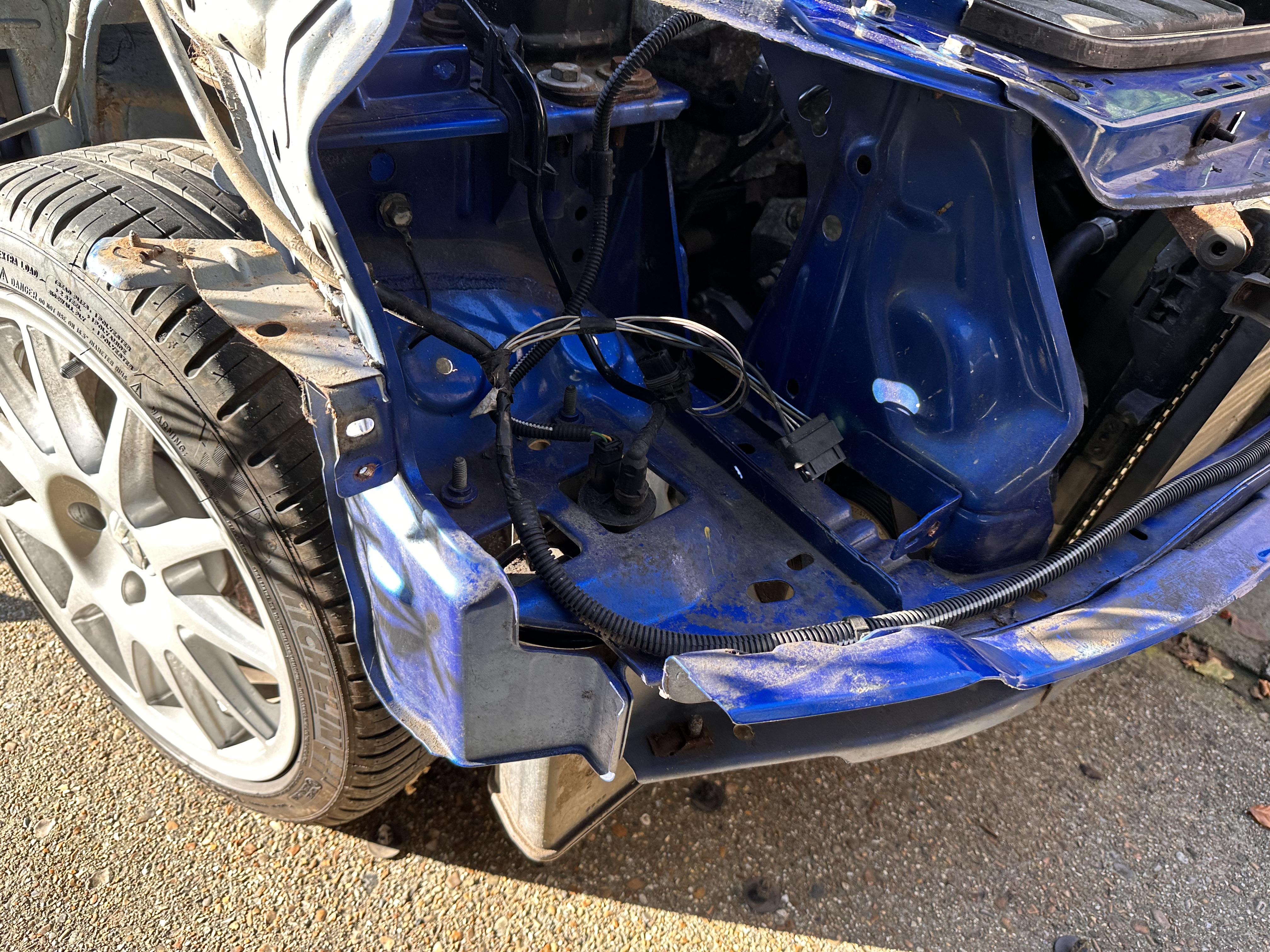

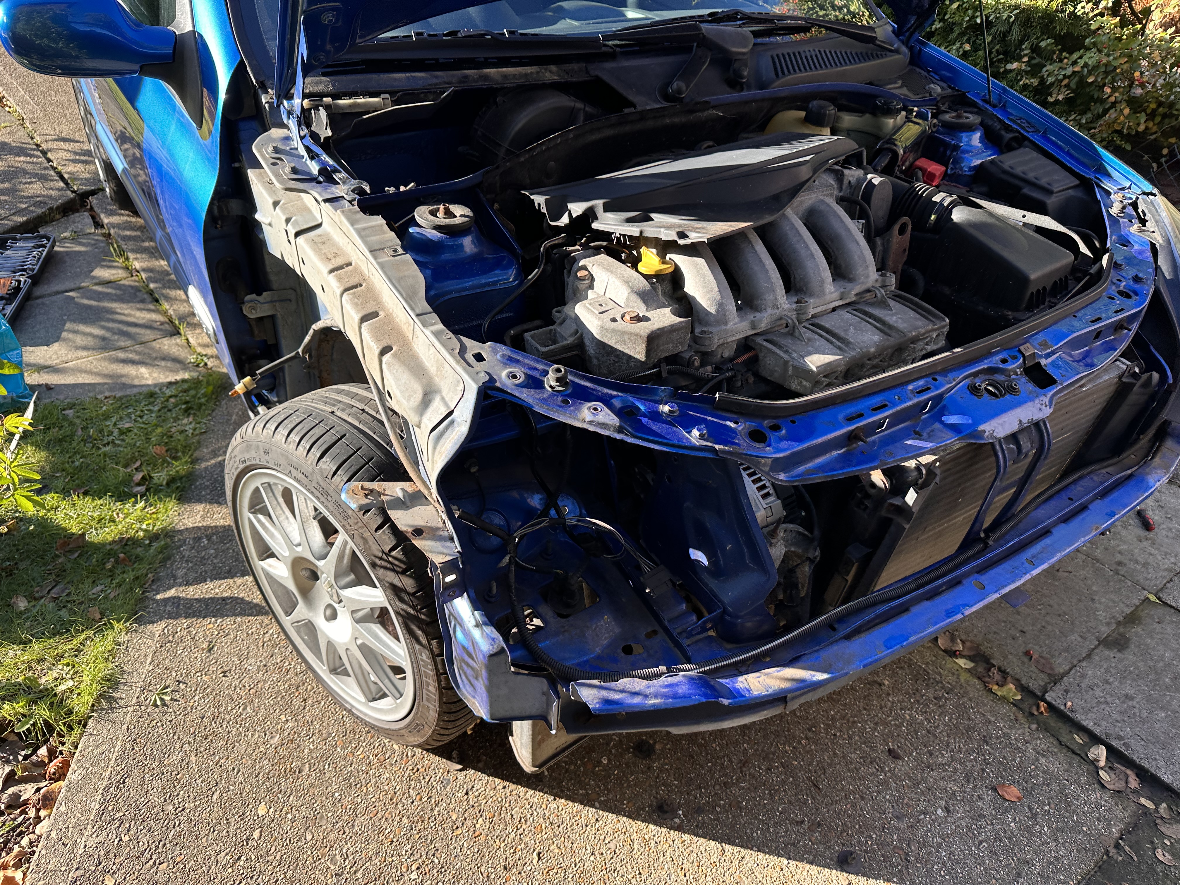

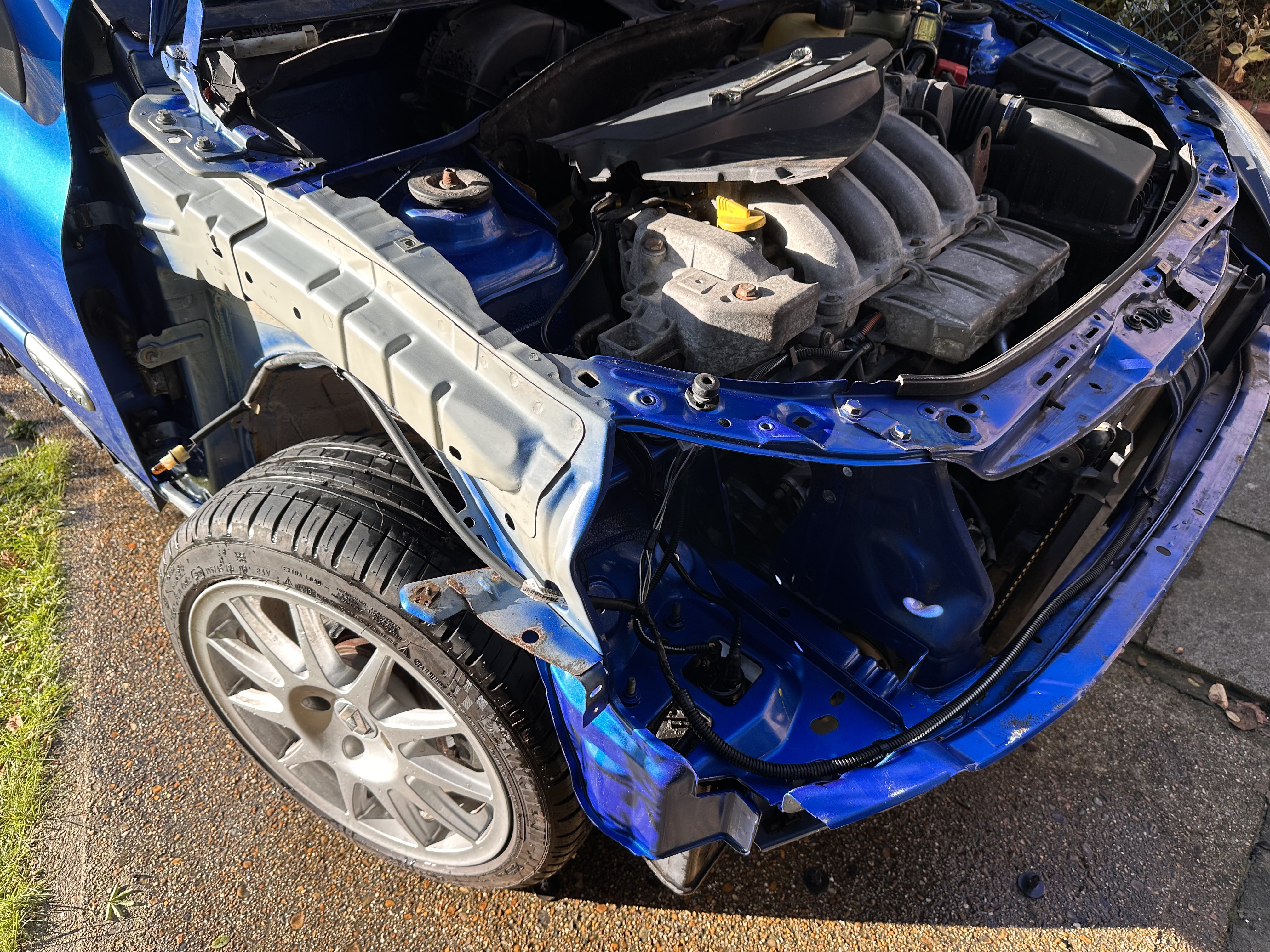

Started stripping off panels today. I know where these cars turn crusty, as many of us do. So it’s important to treat them whilst they’re still not all that bad. Things look ok to be honest.

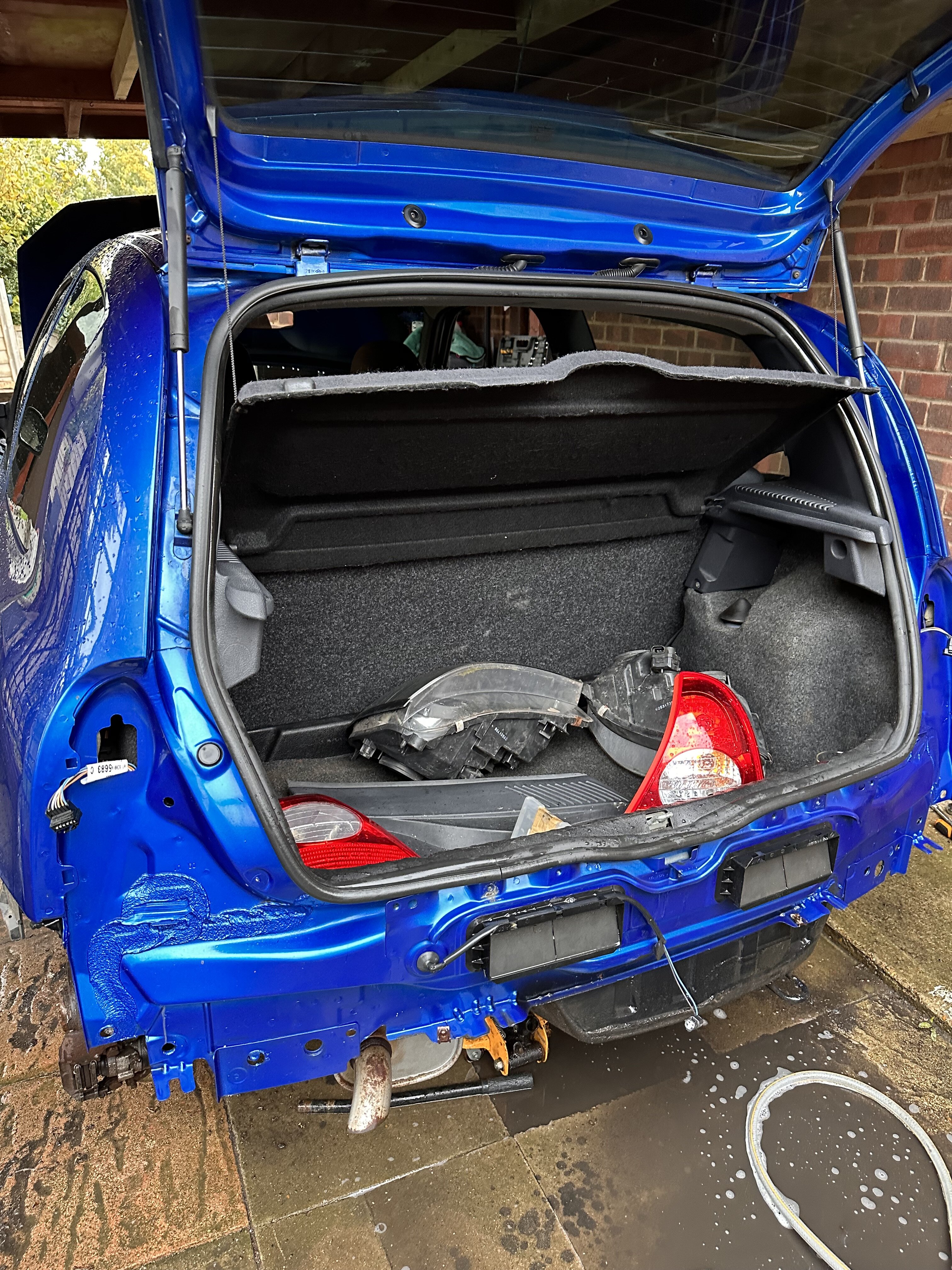

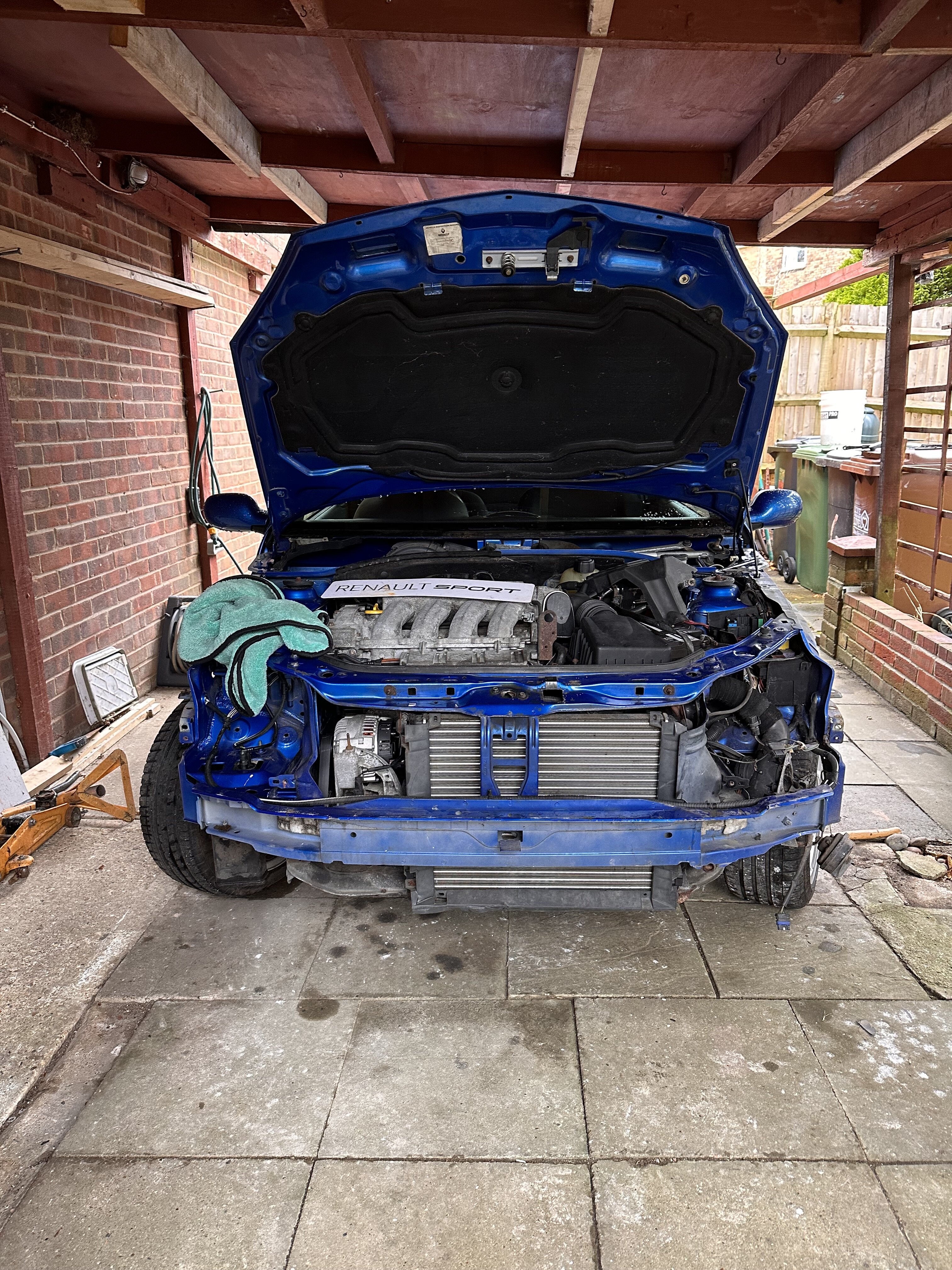

Went into full strip down mode at the weekend to check the car over. All seems pretty good to be honest. I don’t plan on driving the car again this year, so it’s full steam ahead with getting stuff tidy.

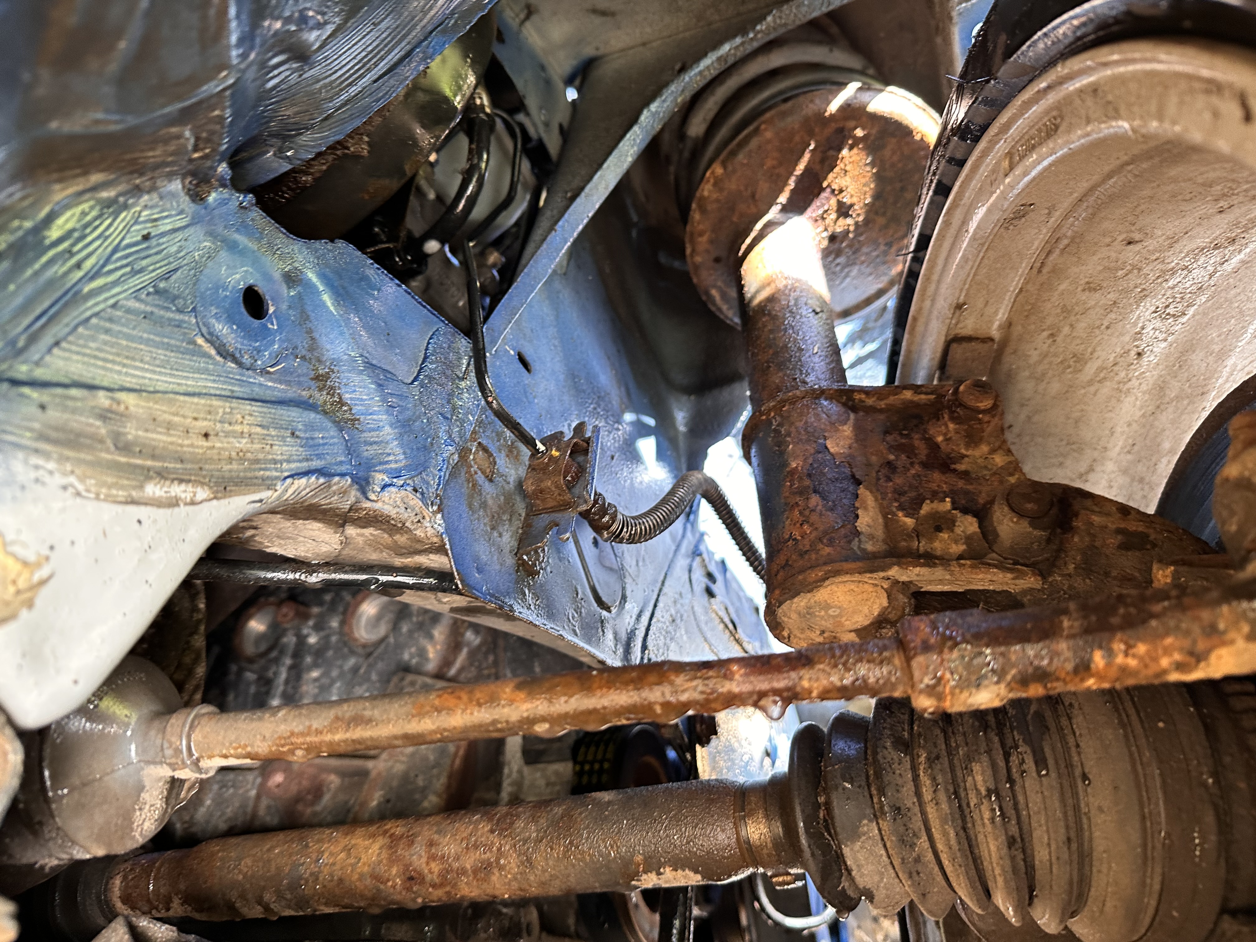

Radiator looks to be in really good shape, and the alternator is new. Good to see all the original parts here too. Will be keeping all of this and just giving it a tidy up. Bits of the the loom are shoddy so will need wrapping properly.

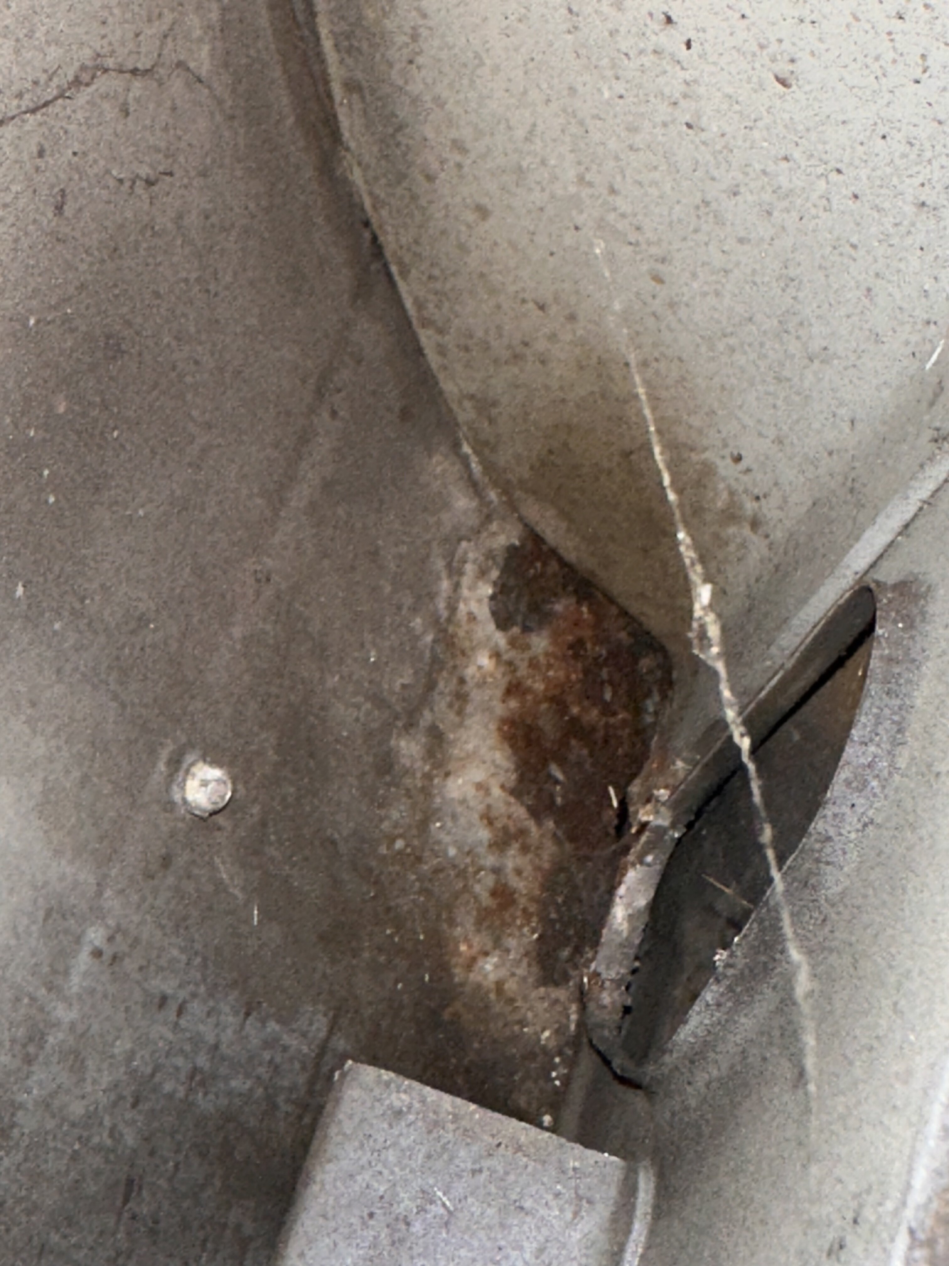

Some corrosion but nothing some Bilt Hamber Deox can’t sort.

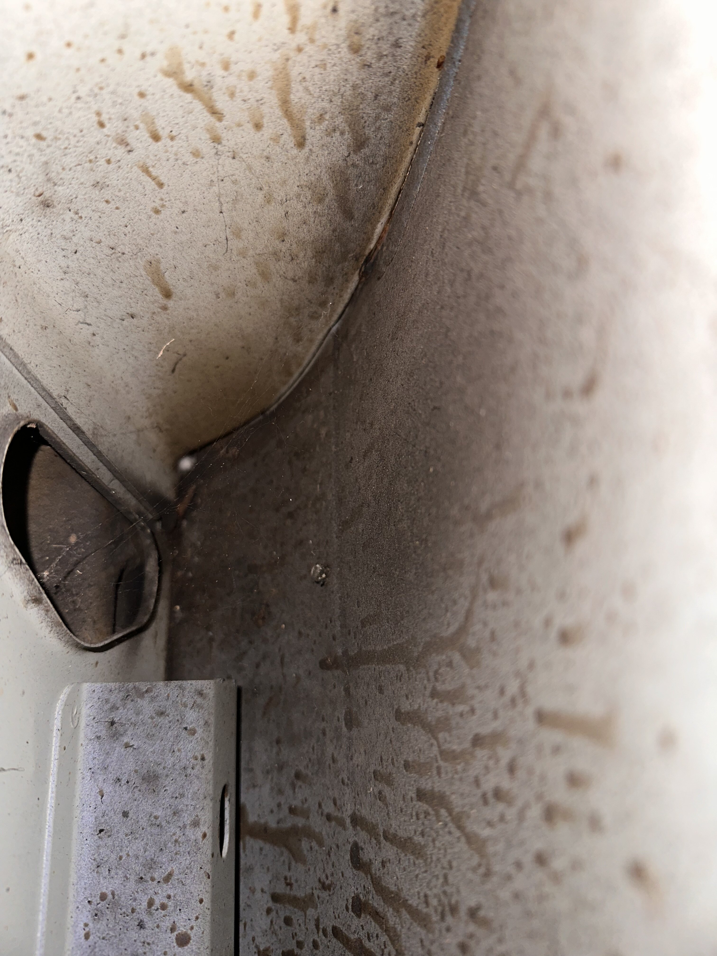

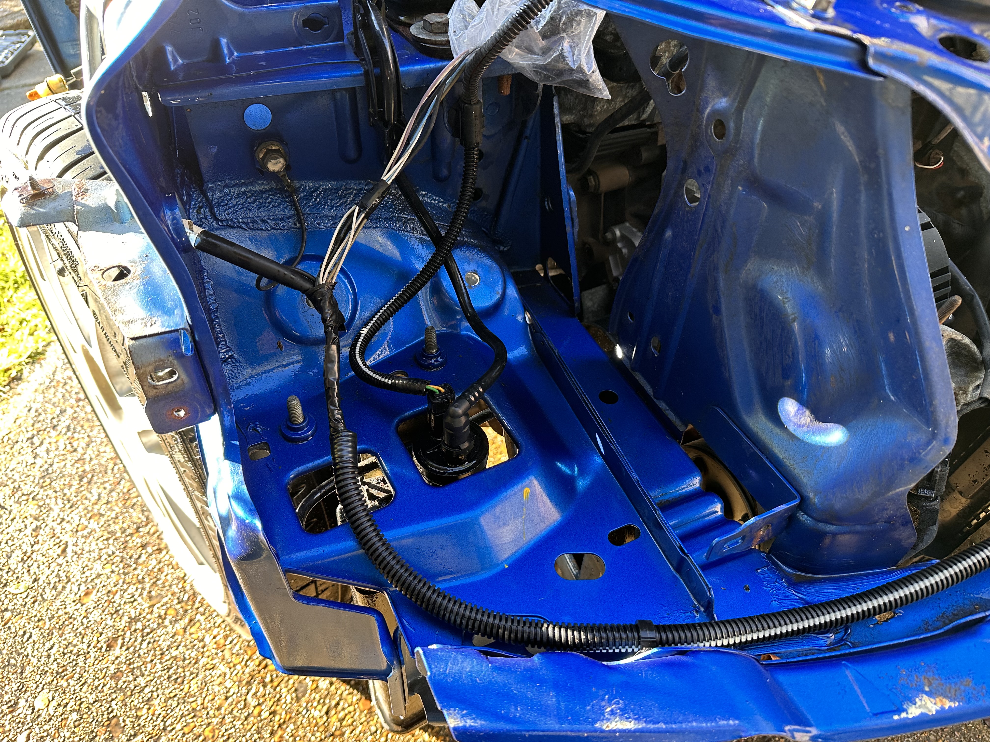

Then it was time for the dreaded rear door cards. No visible signs on the outside. Pleased that there’s zero rust in the passenger side and a tiny patch on the drivers which looks as if it can be stopped.

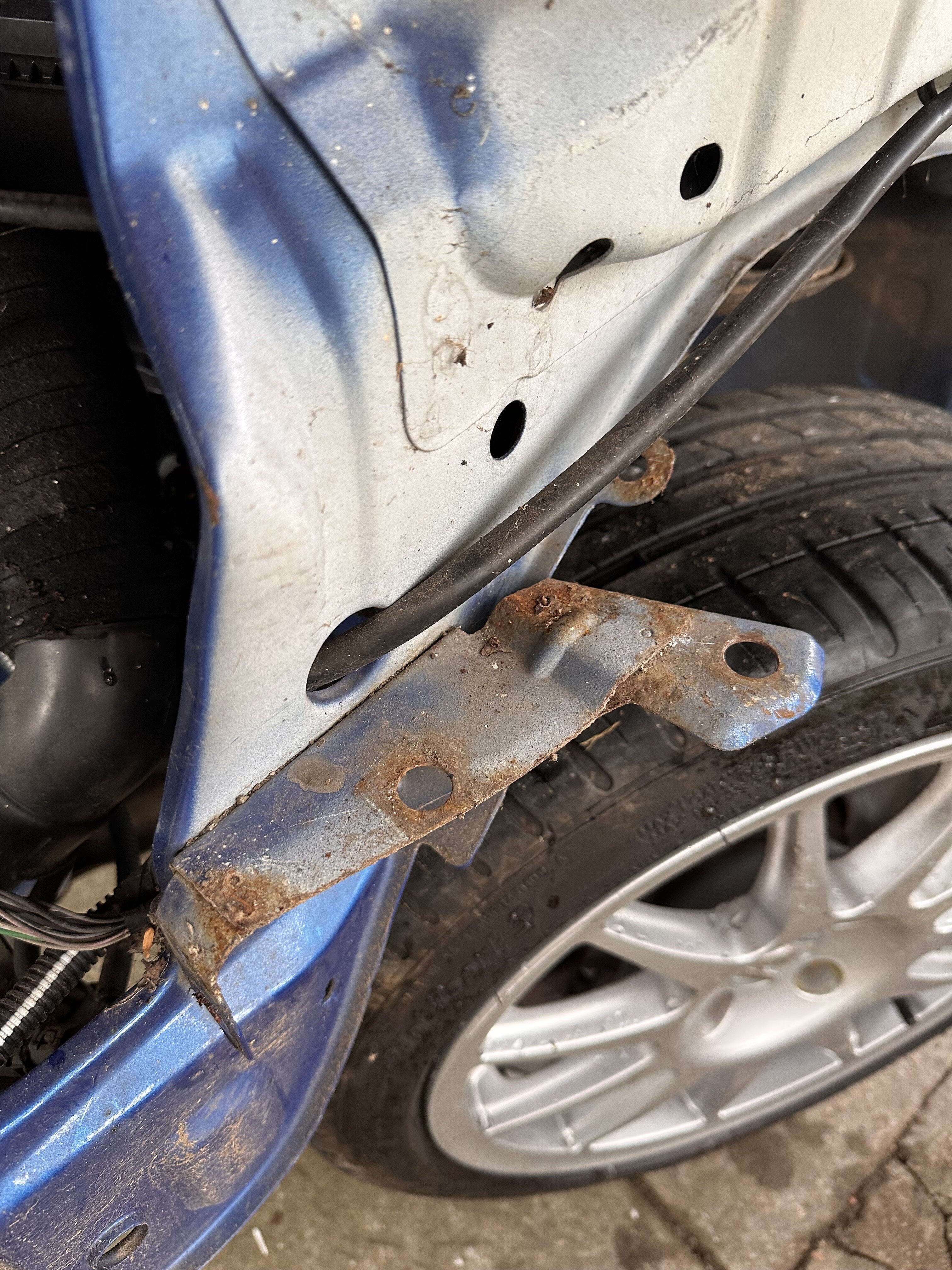

Also took the rear bumper off too for a tidy up. Will be dropping the rear beam next - undecided on whether I’ll take the brackets off too - those captive nuts are horrendous. Cheers for looking.
Just use a nut splitter to take them off, it will damage the bolts but it's easier if heavily corroded, they like to rust under them brackets

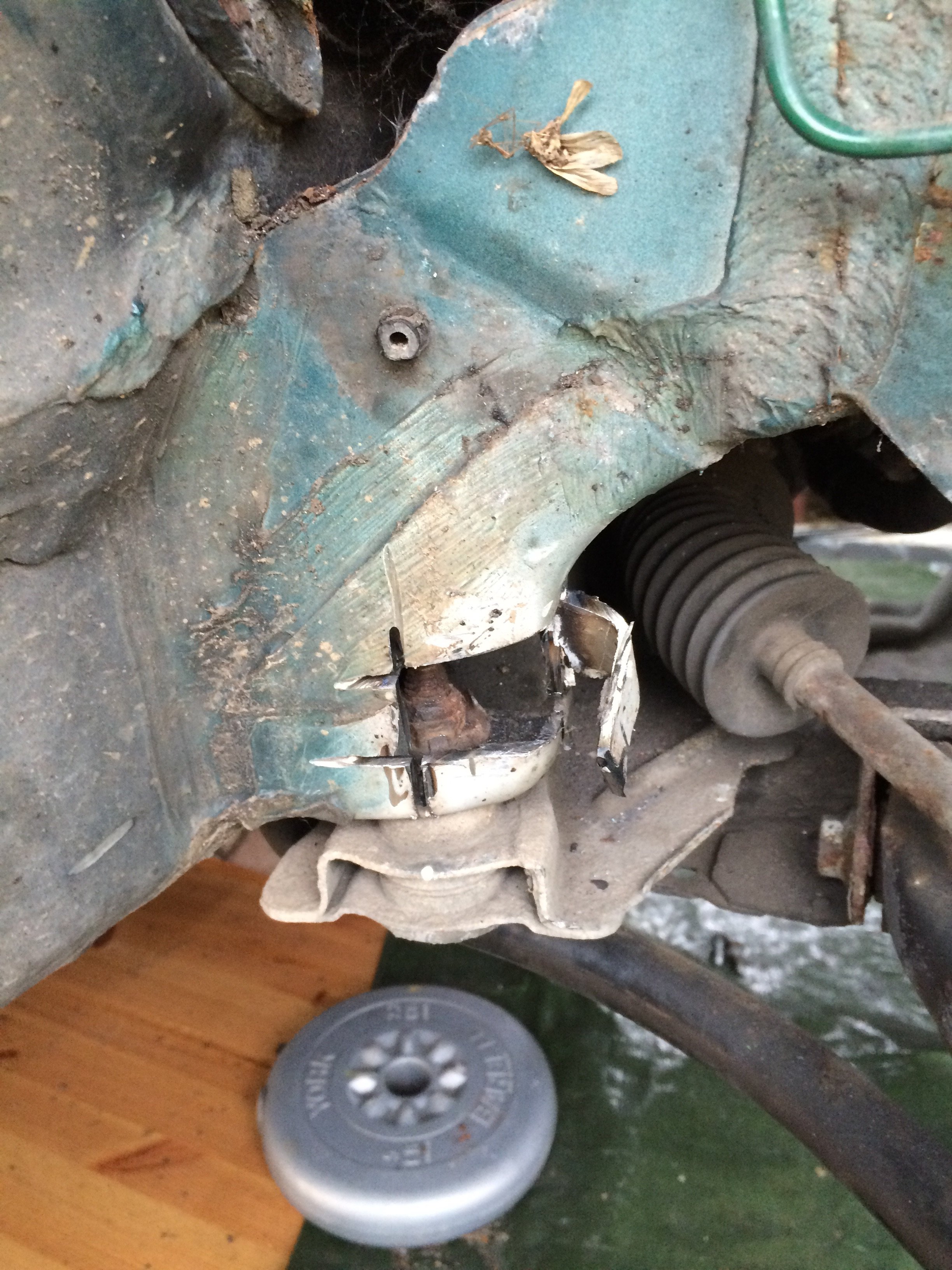

So, as suspected, it wasn’t plain sailing. I’ve got all but one bolt out for the front subframe.
Picture below is taken from the forum. Obviously, it’s a mess - but to get the 18mm bolt out (it’s snapped) and the other side which is spinning.
I have got the one that’s spinning out by using a breaker bar and leveraging between the chassis and the subframe. Doing it up is going to be tricky. Is making a hole here my only option?
Some have said you can replace the nut/cage inside the chassis rail without making any cuts or holes. But how the heck do you get access?

When I was restoring mine, I got 3 out but there’s always one. It was so bad I ended up taking the engine out. A bit extreme but I was getting so frustrated with it I didn’t want to end up butchering it.
With the engine out I managed to get a ring spanner on it, but even that was a pain.
I invested in new captive nuts so some poor soul wouldn’t have to go through it again.
Thanks mate. I’ve seen your resto on your 182. Looks awesome and has served as part of the inspiration for me doing the same.
I didn’t actually realise you could access them from the engine bay side.
I’m not one for botching either. I won’t be cutting anything now I know I have access. If the engine has to come out, so be it!
